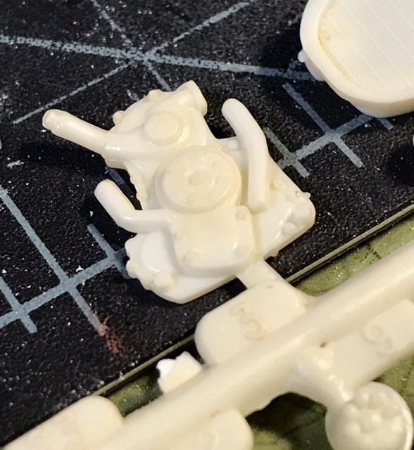

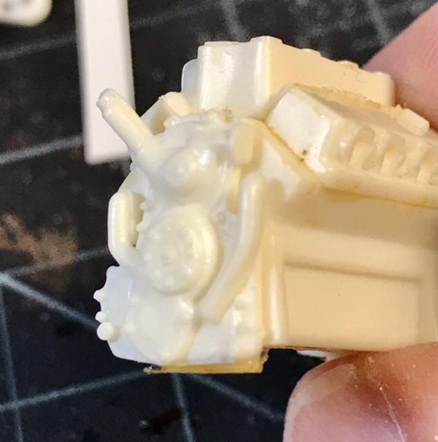

AMT almost certainly had access to the 29 when they did their design work for their 25th scale kit  - but their engine as cast is under scale...  a compromise to the scale ...   but there are some features on the castings that are good. -  example -  the engine cover - it has the correct features and shape - it’s just too darned small ...

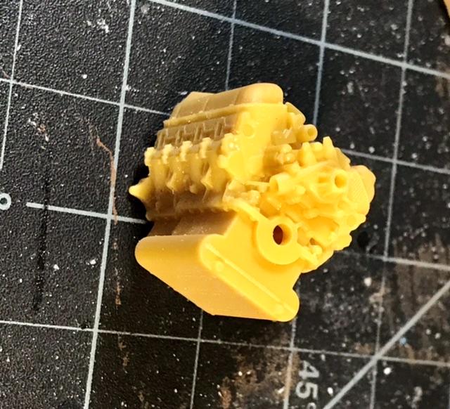

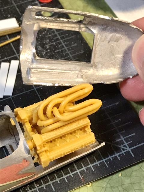

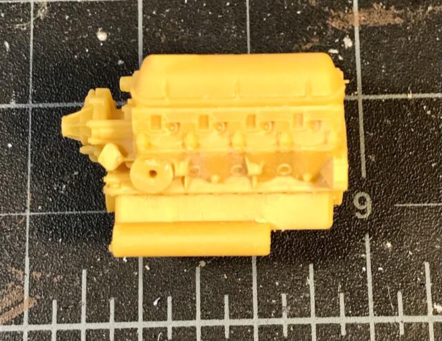

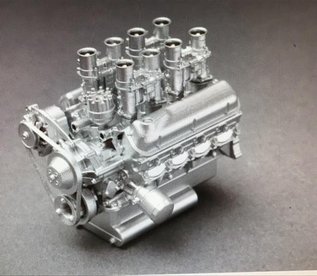

This is a photo of the engine built - from Randy’s website ... it’s super accurate for the Fords used by Shelby - and Chapman used one in his Lotus 30 ...  it’s the best starting point for my build of the 255 Fairlane engine - but with some important mods ...
thing 1.  The sump has to go - see the videos on the Indy Museum Gurney 29 resto - with some excellent views of the sump on the Fairlane engine ...
thing 2 - the Fairlane 255 was raced in the 29 without an oil filter - no, really - read the Car & Driver article ...
Thing 3 -  the engine cover is different on the Fairlane engine - shaped and designed to both serve as the forward engine mounting and also routing the oil and radiator lines ...
thing 4  -  the engine Manifold is different - because the carbs in the 29 were in a line - front to back - like soldiers ...  so when I’m done the Fairlane engine will look a lot different than the 289 - but it’s worth starting here because the engine will have accurate block features and the correct dimensions ...

That’s the plan. The Webers on the 289 were I think 54 mm. The Webers  on the 255 were actually slightly larger but identical in scale. The restored 29 will use smaller Weber’s that are easier to maintain - those are the ones with the intakes closer together - nearly touching - ... but there is so much source material on the car as raced that you can make a race day replica - including some color photos  taken in Gasoline Alley - which were rare in 1963 ...

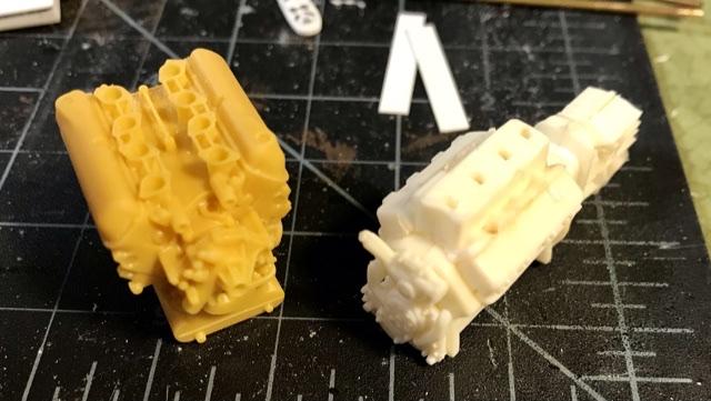

I am a fan of all of the Finecast kits .  But as I’m sure you know - the Grand Prix kits were designed as curbsides .   As for the Lotus 38 - I’ve been messing around with it for years - I tend to do a little work - and then it goes into hibernation -   It may be possible to build this kit with the 25th scale DOHC - but only with numerous mods - massaging - and some incantations - the Finecast kit is nominally 24th scale - it’s actually a bit over-scale - about 1.5 scale inches too wide - which actually will be a blessing - I’ll drag this out of hibernation and we’ll see ...

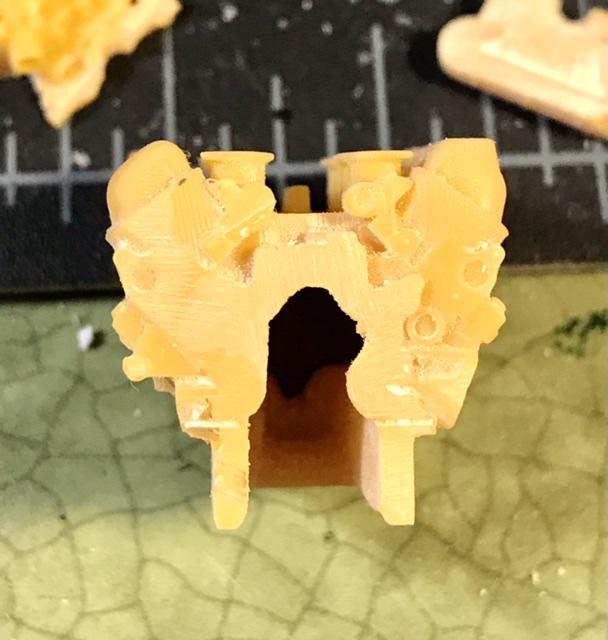

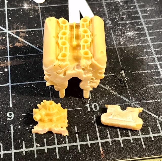

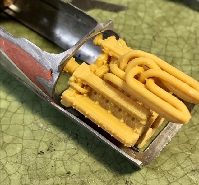

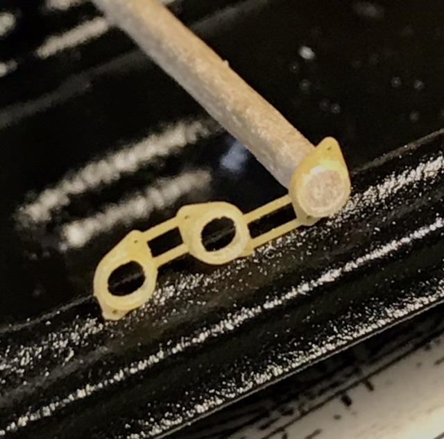

In order to make this as confusing as possible - I’m back to the small block 255 Fairlane engine conversion for the 29 ... these pix show the first mods to the MM Ford 289 engine  ...

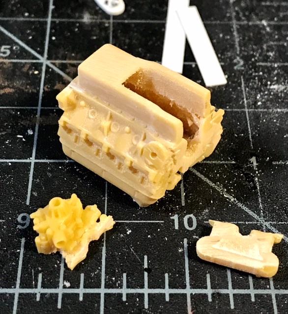

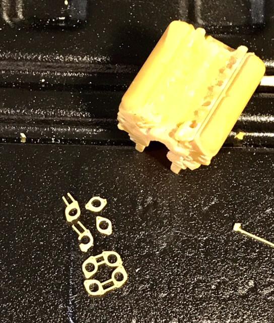

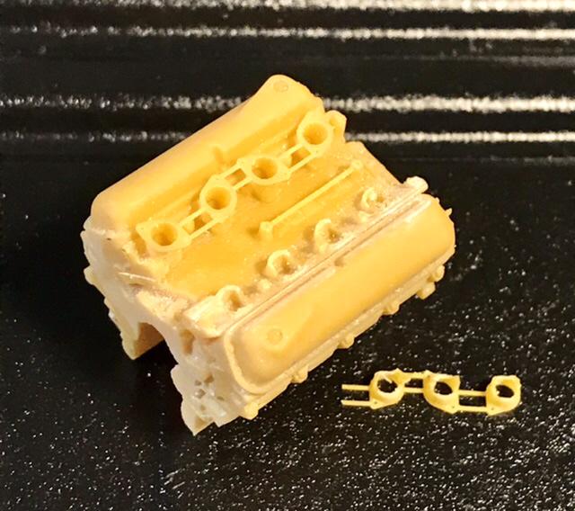

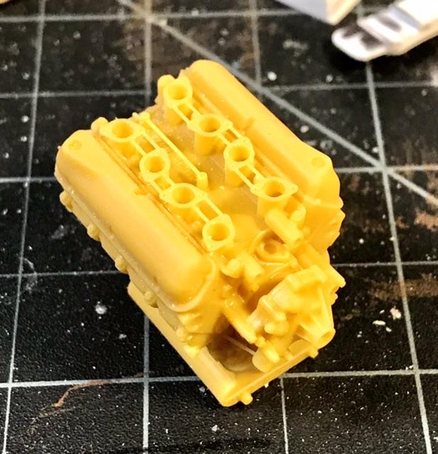

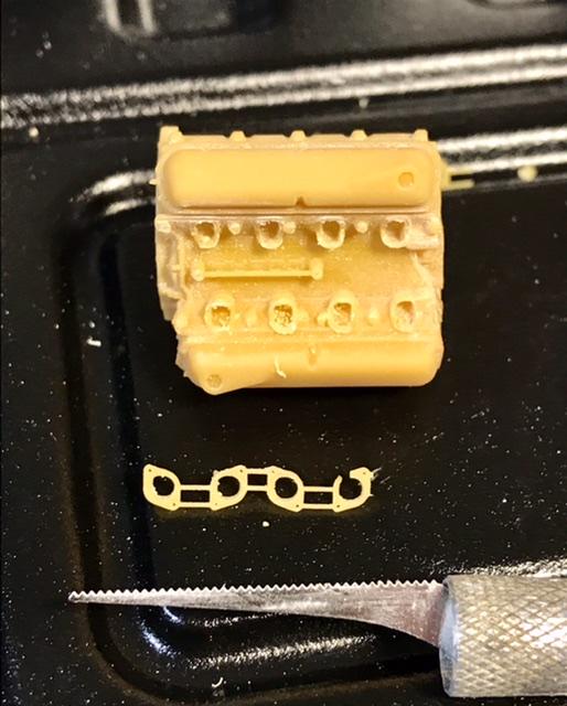

I removed the carb flanges from the top of the block casting - keeping the stems that connect each pair of flanges - well trying to - these will be re-arranged on a new manifold to locate the 4-in-a-row orientation of the Webers on the Fairlane engine ...
the resin used for the printing  is a good combination of strength and flexibility - allowing work with sanding sticks to prep the flanges for this purpose...  if You are just making the kit engine - you’ll remove the connecting stems and you’ll be left with a wonderfully detailed Shelby manifold - complete with Shelby script ...

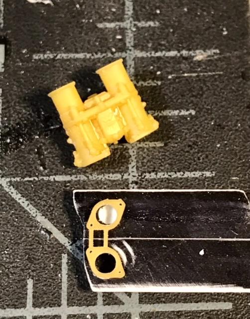

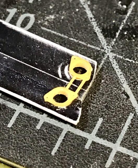

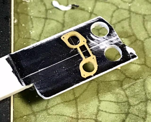

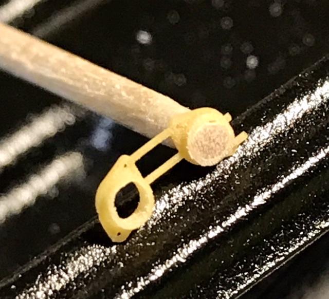

In the Weber carburetor weeds ...  the carbs in the engine kit are really good. And they just dare you to add some stuff ...  so I’m making the manifold and figuring out the flanges and the orientation etc ...   and drilling ....   always drilling. ...

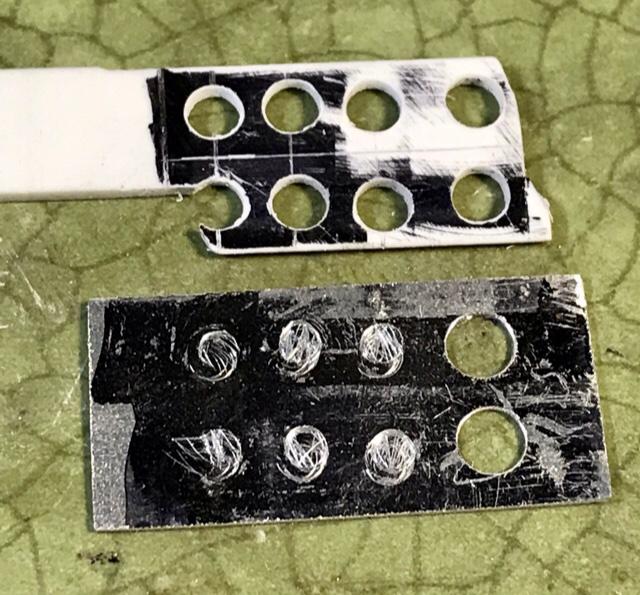

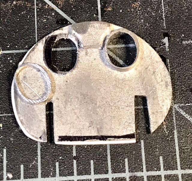

And once the manifold was drilled I scored a sheet of aluminum to Mark openings for the tray that sat on top of the Webers on this engine ...  and with some more research I learned that the fuel lines entered the carbs from above and the the fuel fitting on each carb faced forward - the throttle linkage is cool -  will mess with that once the carbs are painted and in place ...

The holes in the manifold are used to trace the openings in the tray that sits on top of the Webers ...  next  - paint ...

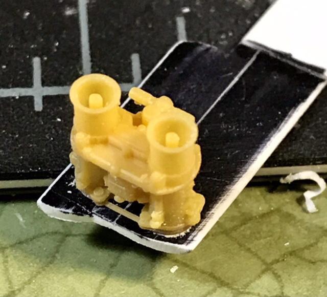

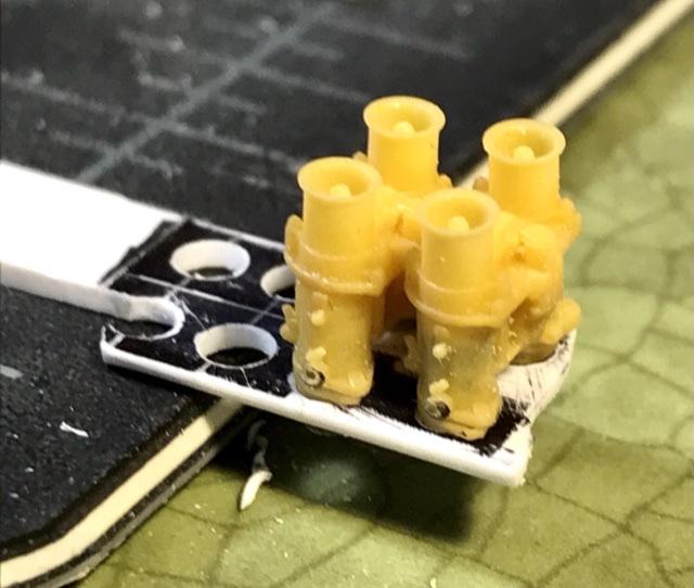

so I got some paint on the Webers -   A mix of steel and gray - Alcad -   I had to modify the Weber castings to make everything fit ... but it really won’t be visible ...
The bells on the carbs were polished - I’ll probably use some Molotov -  haven’t tried to brush it yet but this should be a good app for that ... mite also use Molitow to paint the valve covers - but the block needs a lot more work ...
The fuel entered from a line above  the tray sitting on the carbs - which was unique to this particular Ford Racing engine ... the restored 29 uses smaller carbs with a different fuel line arrangement - so I’ve been peering at the contemporary shots on the Rev’s and the Henry Ford research site to figure this out ...
