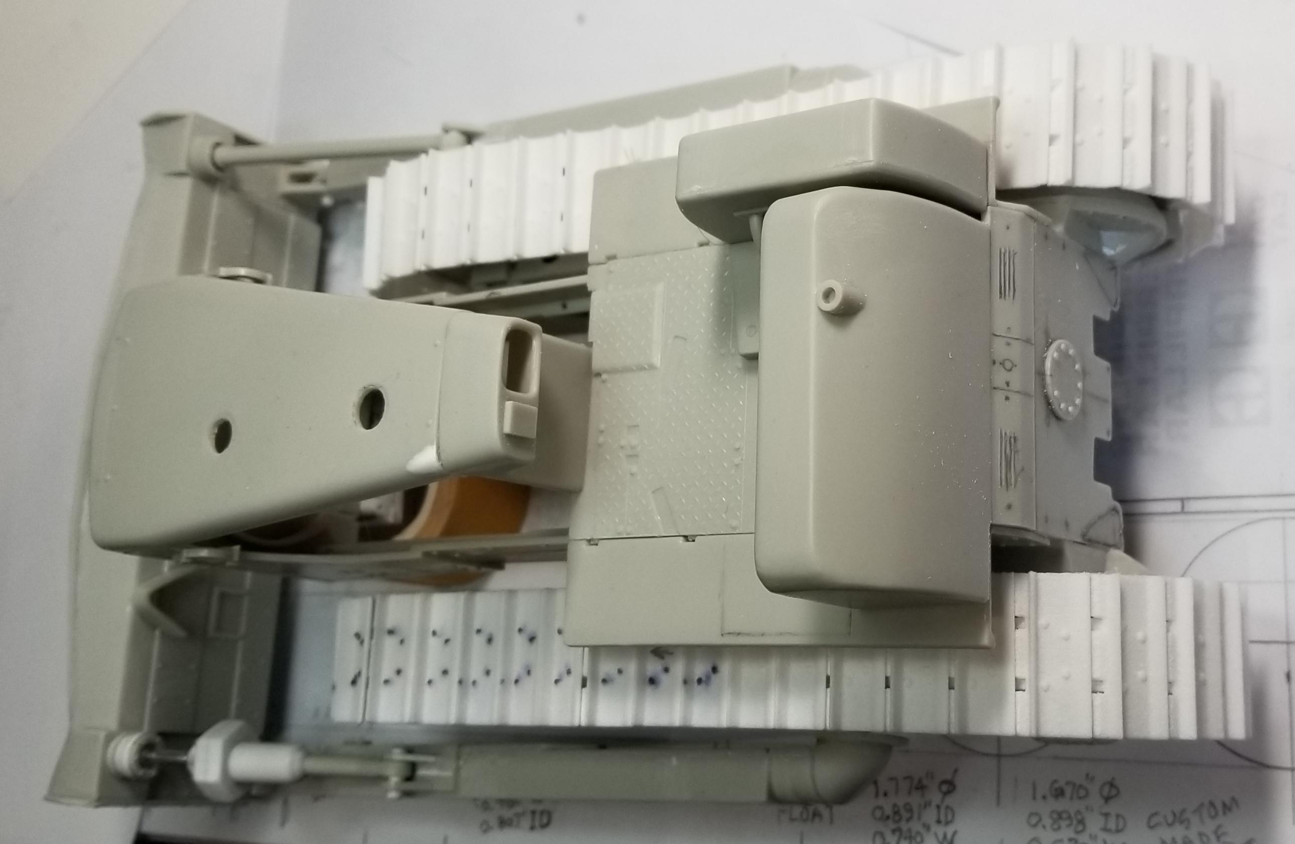

ShakyCraftsman Posted August 24, 2020 Posted August 24, 2020 (edited) Hey all Here is my build of the 1/25 AMT D8H Caterpillar bulldozer. I'm basically building this OOB, but I'm adding a lot of details to make it look more realistic. Things like the tilt cylinder on the left side of the dozer with it's hydraulic lines. I remade the lift cylinders and added the hydraulic lines. I added a hydraulic manifold on the tube between the two lift cylinders that all the cylinders plumb to. From this I added the lines down to the hydraulic pump. I added bolt detail to both the intake and exhaust turbos. Added oil lines from the turbos to different areas on the block. I added the fuel injectors to the cylinder head and the fuel lines from the injectors to the injector pump. I will be adding more detail as I progress on the build. I found some 3D printed tracks from Shapways. I couldn't afford to get them in the fine detail resin (almost $200.00!!!) so I got them in the regular white plastic material and that process made the tracks not very movable. Let ne explain, they were printed assembled into individual side assemblies that if printed in the better material are movable. Mine are very stiff, I'm probably going to have to drill out all the pivot pins and replace them with scratch built plastic rods. All 42 per side?. Well here are some pictures for you to .ook at this view shows the dozer partially put together for pictures only. view looking from the rear forward. view from the front down. top view. view from the front of the blade. this view shows the 3D printed tracks and the modifications I made to the track slides at the bottom. I have more pictures of the engine, cylinders, and the detail I'm adding that I will post soon. Ron G Edited August 24, 2020 by ShakyCraftsman

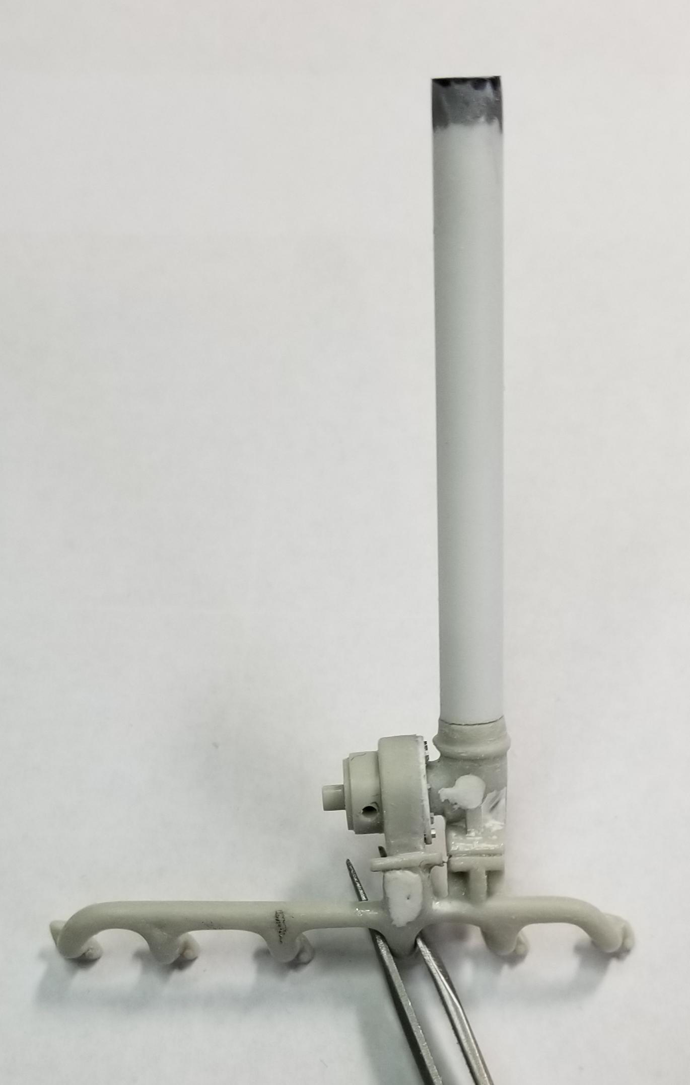

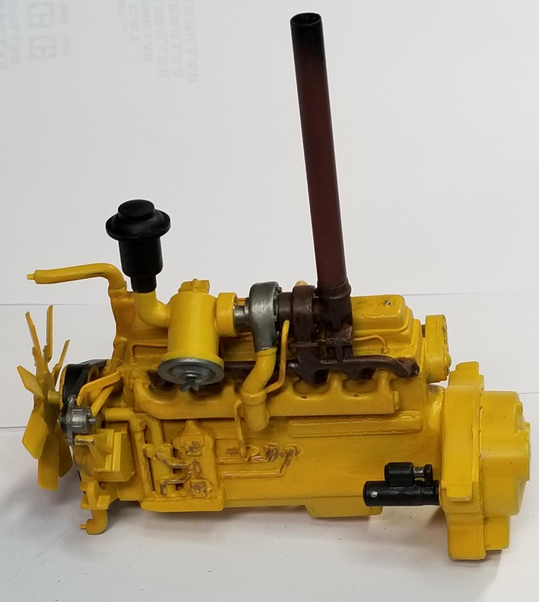

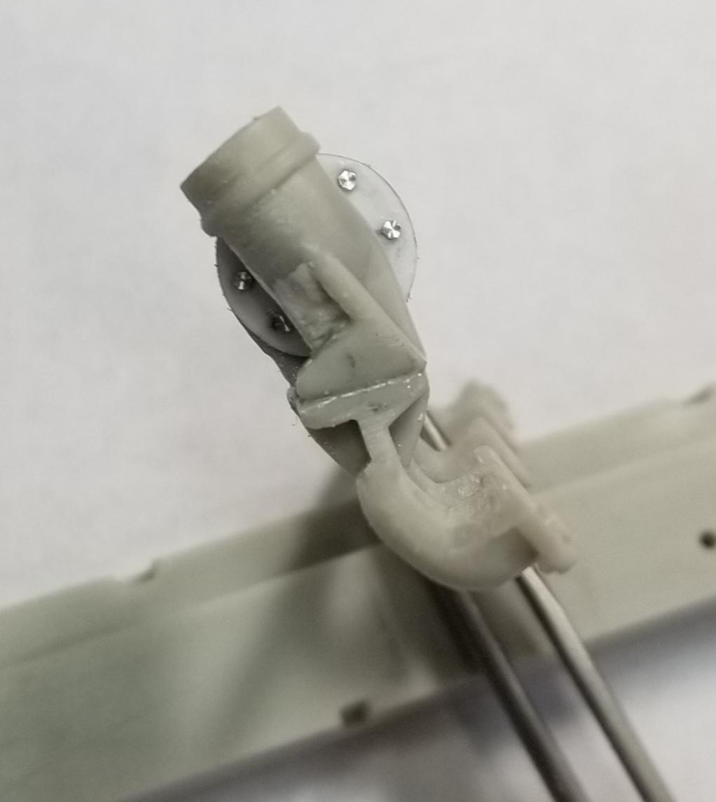

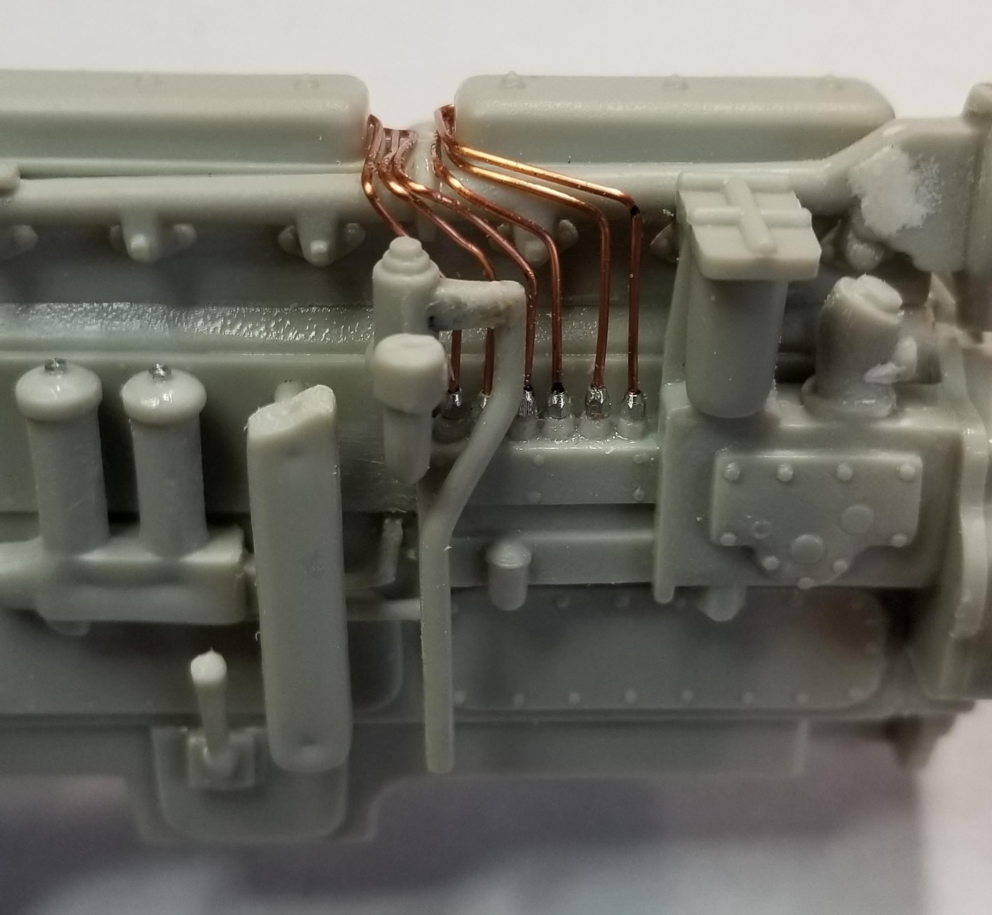

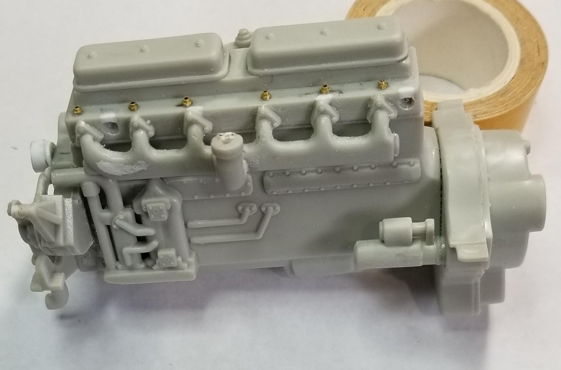

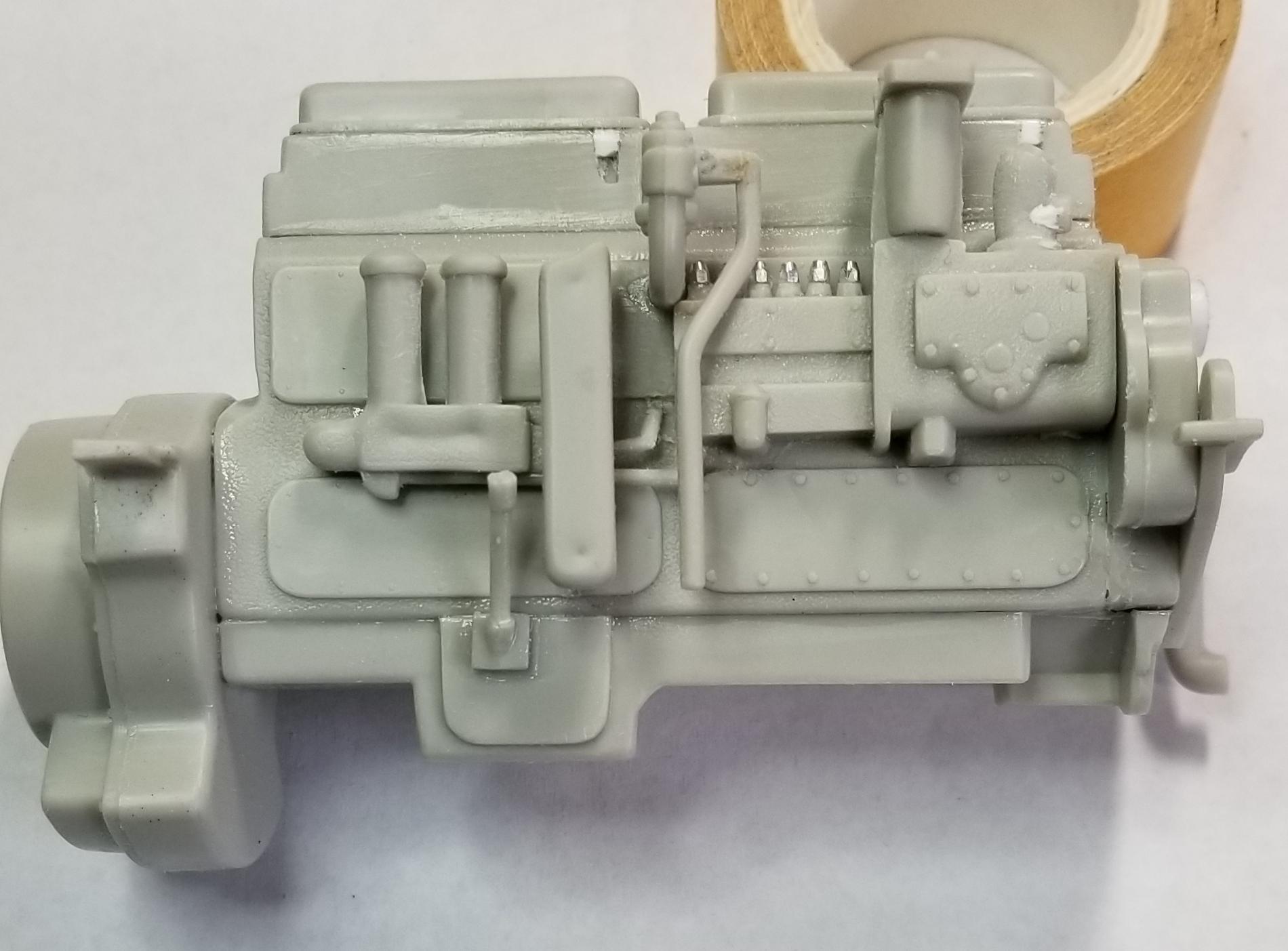

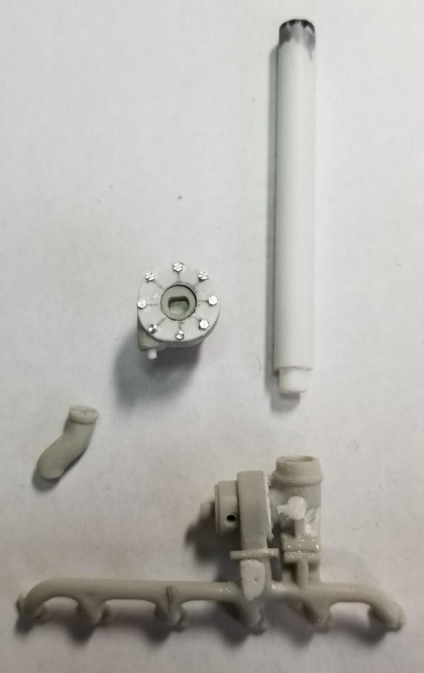

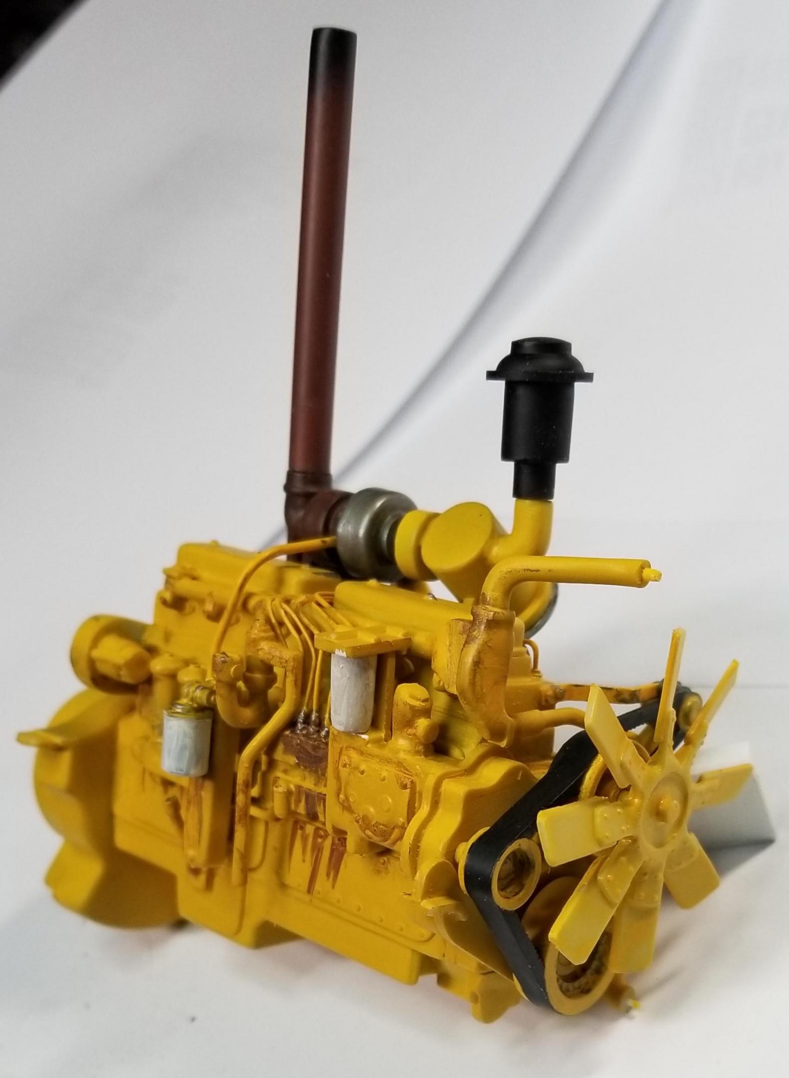

ShakyCraftsman Posted August 25, 2020 Author Posted August 25, 2020 (edited) Hey all Here are some pictures of the D352 engine in the Cat Dozer. this view shows the kit parts and some that I modified. The brass wires are for the fuel lines. this view shows the exhaust manifold, the intake turbo and exhaust stack. The small aluminum bolts are from a guy that does stuff for formula 1 cars in different scales, but I forget his name. this shows the bolts added to the exhaust turbo. this view shows the exhaust turbo and exhaust stack mount. this view shows the exhaust stack in place. this view shows the fuel injection pump, the fittings and the fuel lines. another view of the fuel injection pump. this view shows the fan belt and the bolts I added to the alternator. this view shows the intake manifold and the fuel injectors I added to the head. closer view of the fuel injectors. this view shows the fuel injection pump added to the engine. I added this bracket/mount for the fan belt. view showing the fan belt installed. this view shows the fuel lines added to the injectors. this view shows the fuel lines added to the fuel injector pump. And here it is painted. intake/exhaust side of engine. this view shows the wing nut I added to the air cleaner. And oil line from turbo to block. fuel pump side of the engine. another view of the fuel pump side of the engine. I added a line from the exhaust turbo to the oil gallery. and here it is sitting in the Dozer. I still need to give it a coat of gloss and then weather it. Thats it for now be back with more soon. Ron G Edited August 25, 2020 by ShakyCraftsman

Chariots of Fire Posted August 26, 2020 Posted August 26, 2020 Those tracks are super great! What an improvement over the original kit pieces! Nice work going on here!
CRUSADER2 Posted August 26, 2020 Posted August 26, 2020 Those injector pipes really make a difference, great work on the engine, its all looking good.
gatorincebu Posted August 27, 2020 Posted August 27, 2020 Ron, I really like all the detail you are adding to this dozer . You are taking this kit to another level . Where did you get those awesome looking tracks? I need like four or five sets of those . Will continue following this build thread . Be Well Gator
ShakyCraftsman Posted August 27, 2020 Author Posted August 27, 2020 Hey Gator I found them on Shapways, I forget the guys name right now, but if you look for 1/25 scale Cat tracks I belive they will show up. They are pricey $230.00 per set for them printed in the ultra detail resin. He won't print them in anything else now after I talked to him about how mine don't work. These are printed as a working assembly, that's why they are only available in the expensive resin, the other stuff wont work. I paid $120.00 for my set. But if you hold them out straight there stiff as a board, if you you try to bend/ move them they start to move but they break at the pins. They work really good in the proper material, it's just expensive. Maybe if you contact him you can work out a better price. It's not him but Shapways that sets the price. Ron G

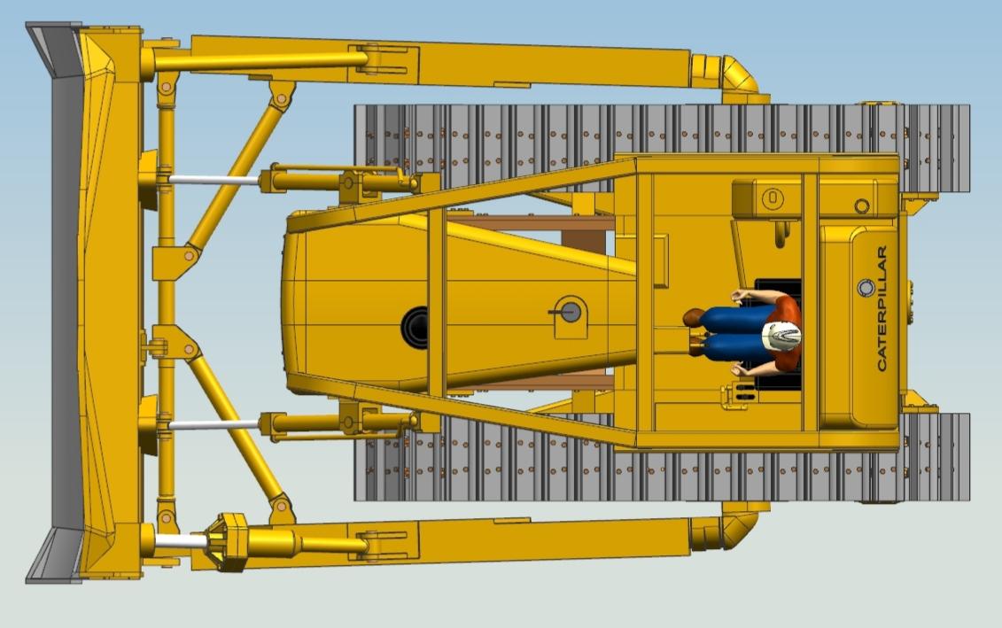

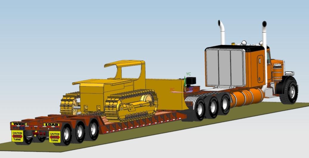

ShakyCraftsman Posted September 15, 2020 Author Posted September 15, 2020 (edited) Hey all Here are some pictures of the Cat D8h I'm doing on Unigraphics NX11. It's only in a preliminary stage, still needs a lot of work to get it to be done. So here they are. this view shows the D8H on the 3 axle Loadking drop nose lowboy trailer being pulled by the lloonngg! Pete 359 heavy haul tractor. same view from the rear. Its only about 50% done. Ron G Edited September 15, 2020 by ShakyCraftsman

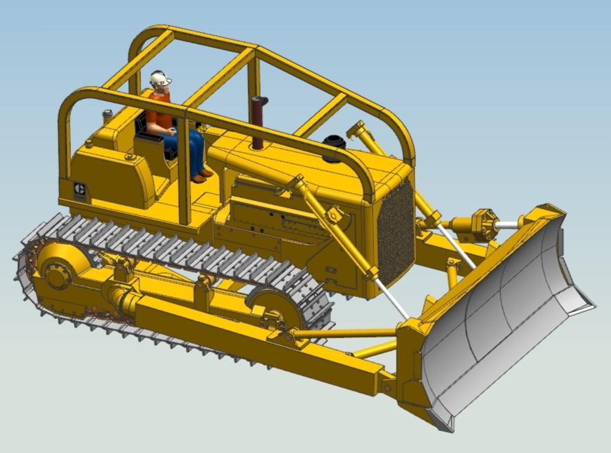

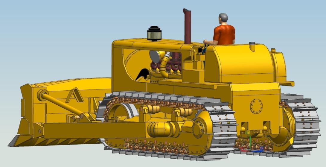

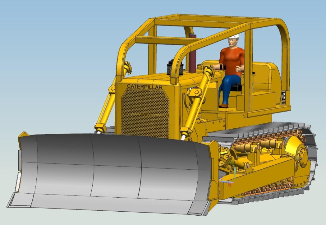

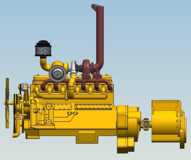

ShakyCraftsman Posted September 22, 2020 Author Posted September 22, 2020 (edited) Hey all Here are some updated photos of the D8H. front isometric view. Rear isometric view.this view shows the grill and all the Gazillion! holes I added to it. this view shows the operator area and some of the controls. view of the D342 Cat engine. side view of the engine and all tge bolt heads that I added to it. other side of the engine. Well that's it for now be back with more soon. Ron G Edited September 22, 2020 by ShakyCraftsman

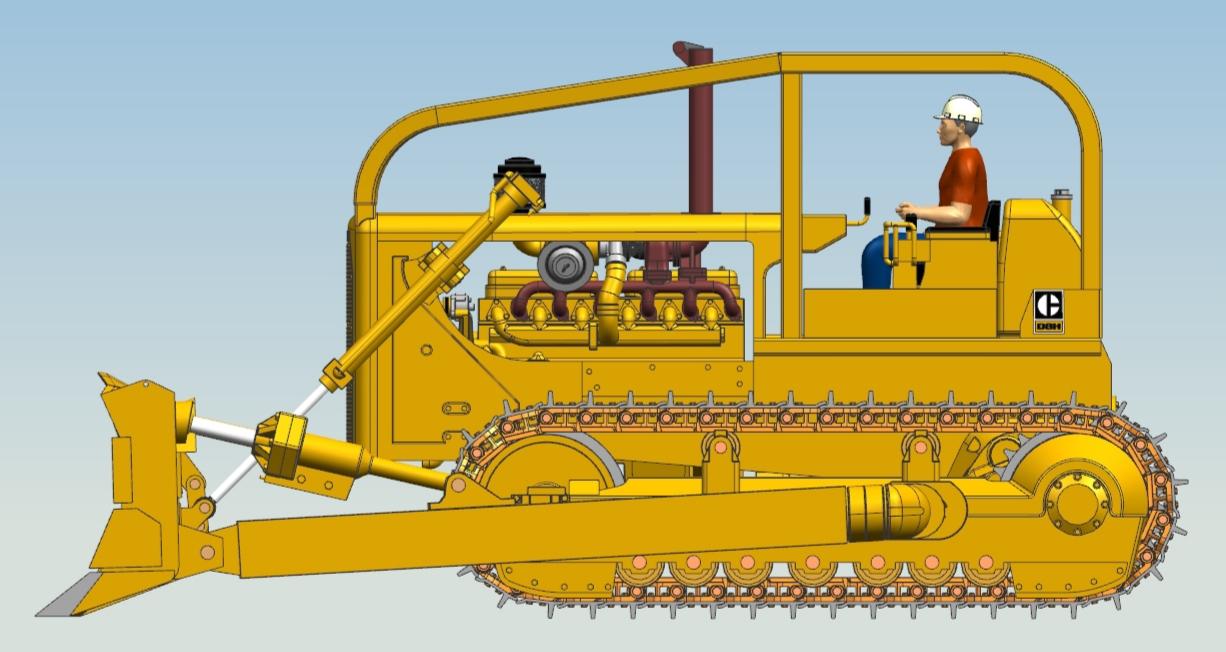

ShakyCraftsman Posted September 29, 2020 Author Posted September 29, 2020 (edited) Hey all Here are some update photos of the D8H I'm doing on Unigraphics NX11. front isometric view. I now have the blade lift cylinders, blade tilt cylinder, air cleaner intake, batterys and battery box done. I also started on the R.O.P.S. (roll over protection system) it still needs the mounting brackets and hardware added. rear isometric view. I also added the Cat logos and lettering to the sides, front and rear. top isometric view. I have to add the wire mesh protection to the R.O.P.S. side view. front view. rear view top view. side view of the engine and transmission. left side view of the engine. right side view of the engine. This view also shows the 3 belt pulley system. That's it for now be back with more updates soon. Ron G Edited September 29, 2020 by ShakyCraftsman
