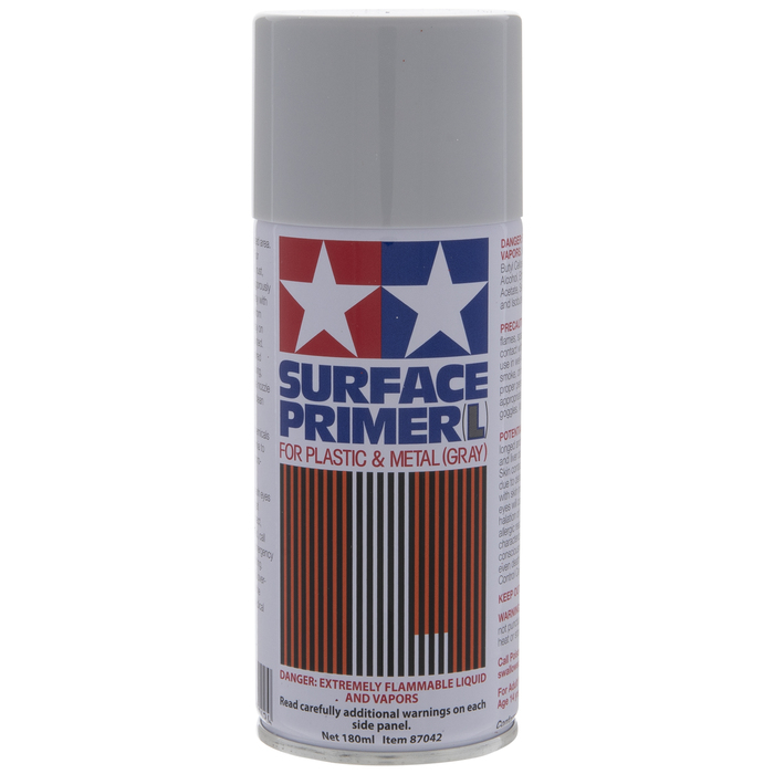

stinkybritches Posted October 12, 2020 Share Posted October 12, 2020 (edited) 1 hour ago, Goodwrench3 said: I'm going to give this a go tonight on my primered body. Soft toothbrush ? Medium? Firm ? Just wondering if this is a real "gentle" thing or if you kind of need to "get after it" a bit ? Any additional info on the process is much appreciated. I'm kind of liking this idea vs. sand paper, as it seems it would be safer on edges, curves, tight areas. Thanks I honestly don't remember if the brush is soft or medium. It's just an old toothbrush I have laying around for jobs like this. I probably used a little more pressure than I use when I brush my teeth. This was the first time I tried it. This is the primer I used Edited October 12, 2020 by stinkybritches Added more Quote Link to comment Share on other sites More sharing options...

Goodwrench3 Posted October 12, 2020 Author Share Posted October 12, 2020 3 hours ago, stinkybritches said: I honestly don't remember if the brush is soft or medium. It's just an old toothbrush I have laying around for jobs like this. I probably used a little more pressure than I use when I brush my teeth. This was the first time I tried it. This is the primer I used Thank you. Are you sprinkling the Comet right on the body ? Or onto the toothbrush ? Thanks for the help. Quote Link to comment Share on other sites More sharing options...
