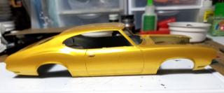

TransAmMike Posted December 12, 2020 Author Posted December 12, 2020 Well I finally did it. Below is the Createx painted body sprayed with Rustoleum Crystal Clear. Not the greatest pictures but I think you can tell the gloss. I will say it sprays pretty liquidy so when spraying it I wouldn't get too aggressive wit h the coats. This is 4 coats. It went on really smooth. By the way, this is the first time I have ever applied clear on any model I've built. Pictures are with no polishing.
Dave G. Posted December 12, 2020 Posted December 12, 2020 8 hours ago, TransAmMike said: Well I finally did it. Below is the Createx painted body sprayed with Rustoleum Crystal Clear. Not the greatest pictures but I think you can tell the gloss. I will say it sprays pretty liquidy so when spraying it I wouldn't get too aggressive wit h the coats. This is 4 coats. It went on really smooth. By the way, this is the first time I have ever applied clear on any model I've built. Pictures are with no polishing. Mike it's pretty hard to screw that stuff up ( humid warm weather might blush it when spraying). It's thin but not really runny. 4 coats is about right. Me being me I'd probably polish that without sanding, the finish looks great at least from here 1000 miles from your home more or less ! No idea if the color is what you had in mind but it came out nice.
TransAmMike Posted December 12, 2020 Author Posted December 12, 2020 Thanks Dave, to me it just seemed a bit thin and I actually had a small bit of sag on one side on the first coat but it kinda smoothed out and after the additional coats it's barely noticible if at all. As for the color, maybe just a slight bit golder than the real color (tho I've read that people painting a 1:1 car in Satin Gold have seen shade differences). And yes, I'm not gonna sand, just fine grit polishing compound and polish. I use higher grade auto products that I use on our real cars. Anyway, thanks again Dave and others that have helped me here to get to this point.
