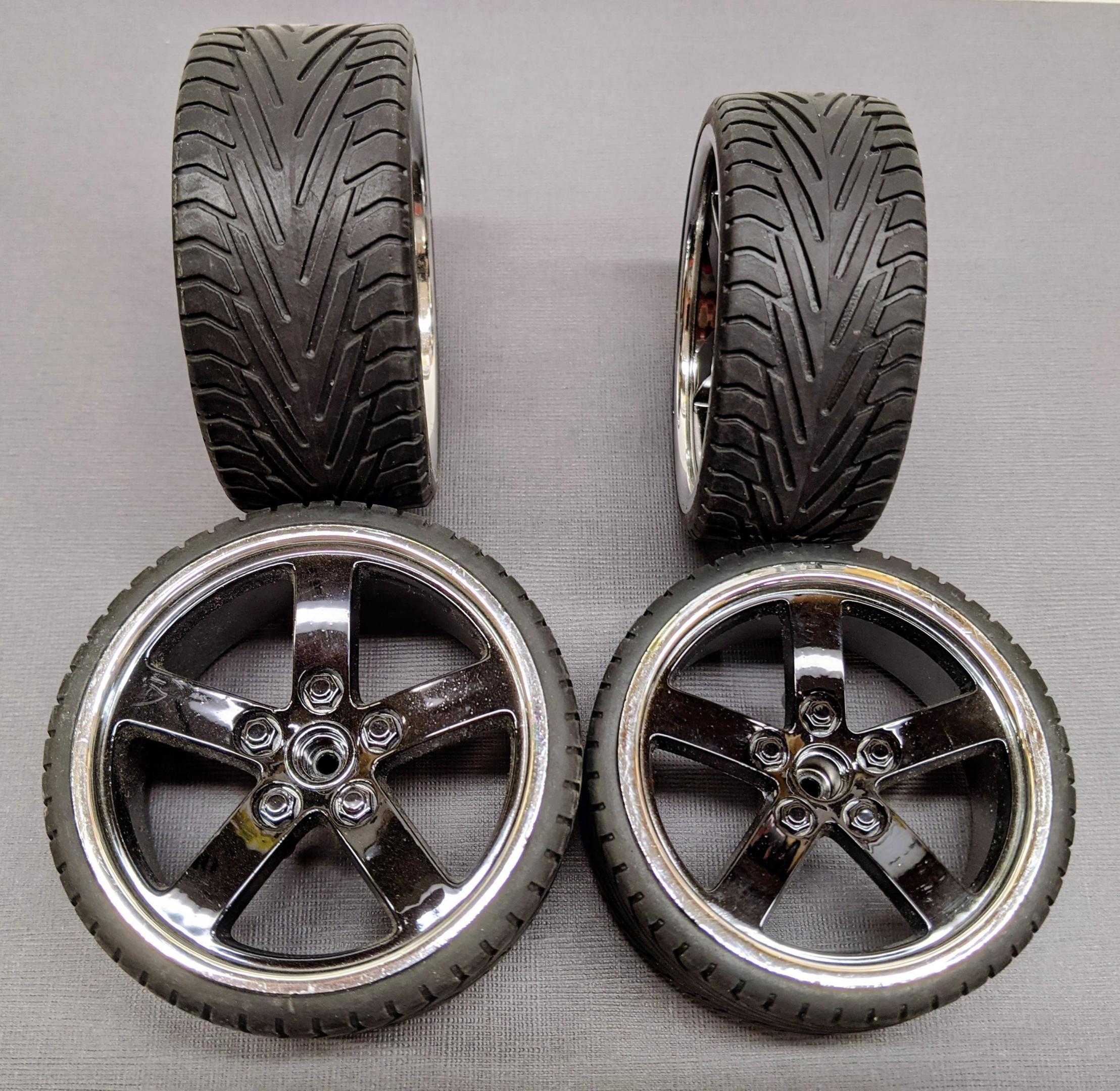

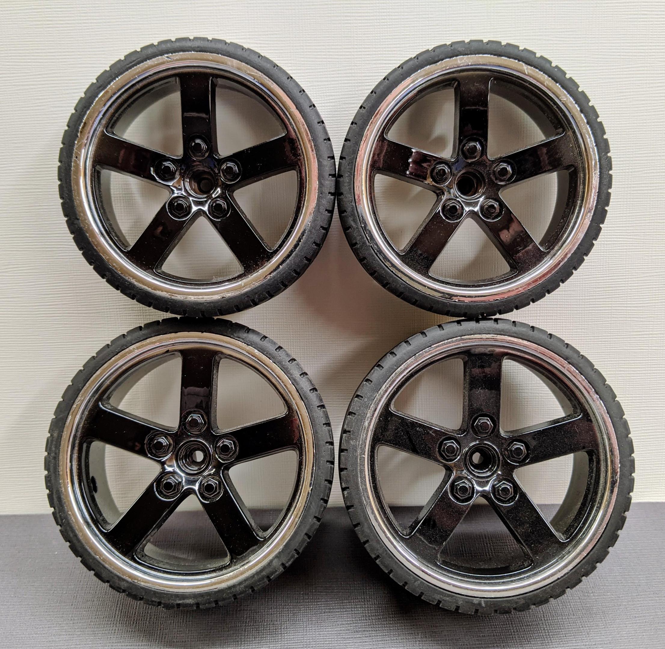

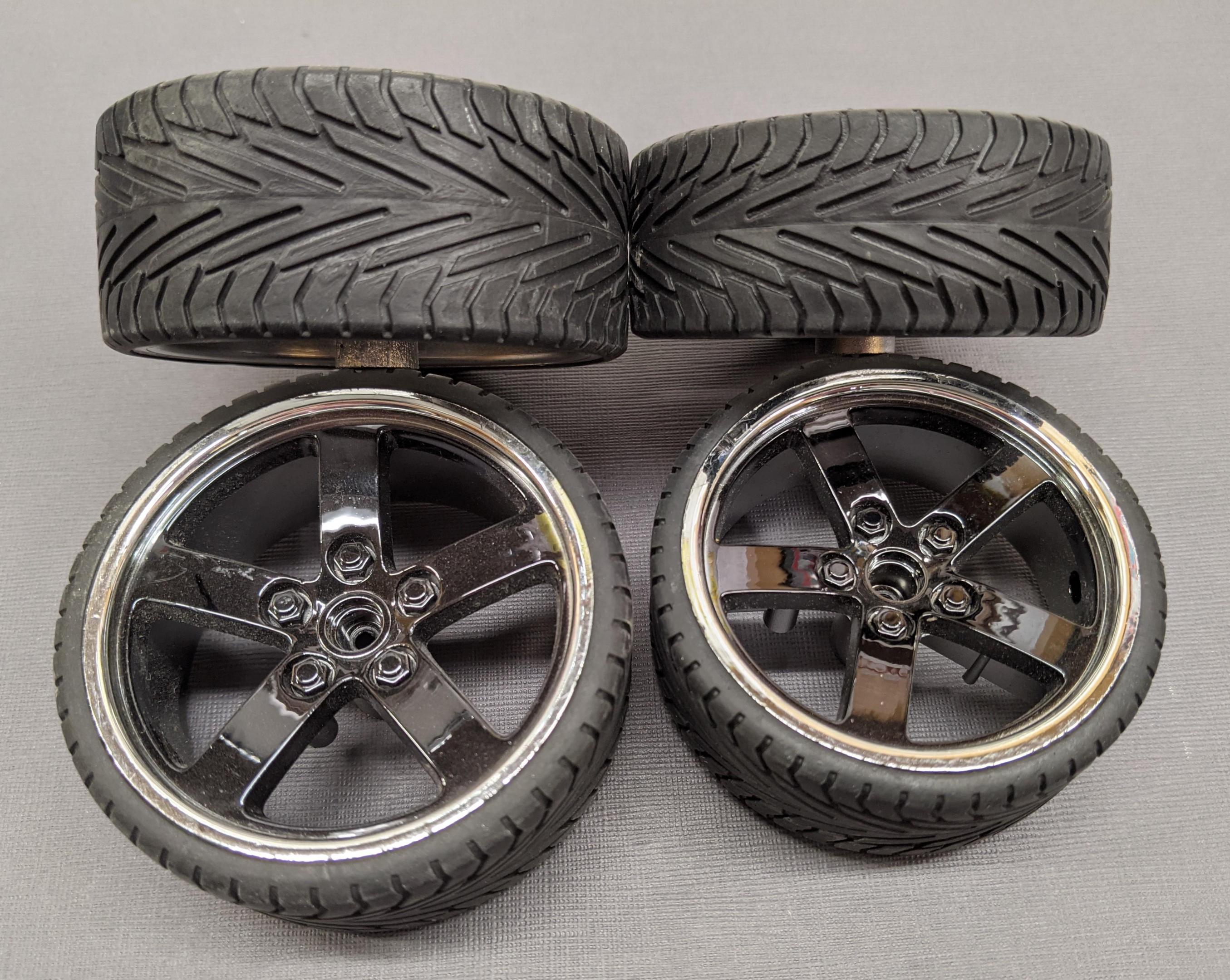

Casey Posted December 31, 2020 Posted December 31, 2020 (edited) 2 hours ago, Mark said: If you only want a couple of sets of tires, and they are ones included in kits, you'll be cheaper off just buying or trading for them. ^This. The issue is there are a very limited number of 1/8 scale tires available. There hasn't been a new 1/8 Monogram automotive kit since 1985 or so, which means Goodyear Gatorback VR50 tires are the newest tires from those kits. They do seem to hold up well over the year, though, and can be found on eBay for a reasonable cost. Pocher has released newer 1/8 scale kits, and the tire set I have from one Ferrari(?) kit is excellent, but not exactly common, nor easy to source. Look at large scale R/C cars, too, as they have modern, low-profile tires which sometimes have a realistic tread pattern...not always, but they are out there of you regularly shop thrift stores. I found these on an Dodge Challenger(?) R/C car at Goodwill: Edited December 31, 2020 by Casey
