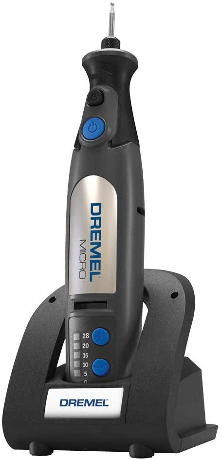

Roncla Posted January 2, 2021 Posted January 2, 2021 I use a Dremel 8050-N/18 Micro 8V Max Tool Kit to knock the worst of the flash off then finish up with the usual fine files and sandpaper. There is a huge selection of different tools available for these rotary tools going from coarse to fine.

StevenGuthmiller Posted January 3, 2021 Posted January 3, 2021 On 1/2/2021 at 11:53 PM, Roncla said: I use a Dremel 8050-N/18 Micro 8V Max Tool Kit to knock the worst of the flash off then finish up with the usual fine files and sandpaper. There is a huge selection of different tools available for these rotary tools going from coarse to fine. Expand This. Steve
