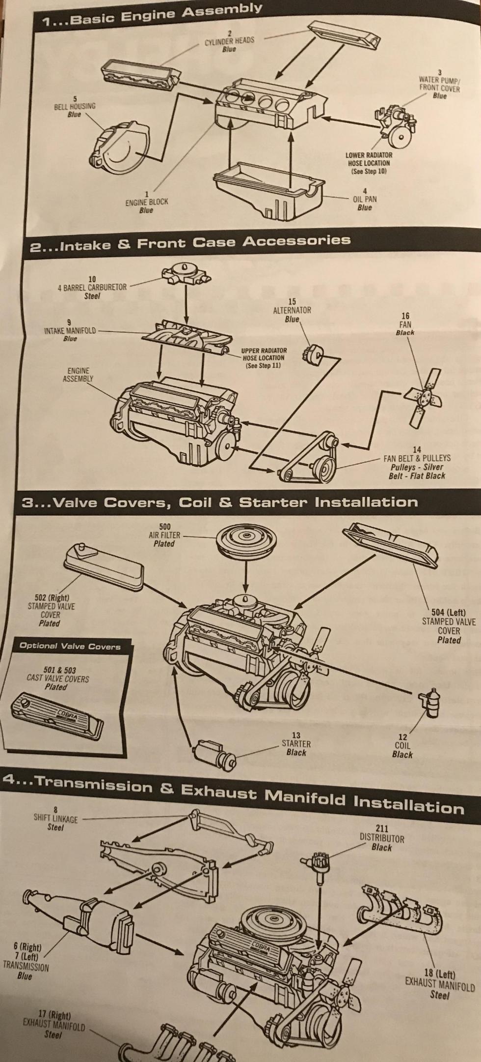

Hws5283 Posted January 6, 2021 Author Posted January 6, 2021 (edited) Heres the complete engine assembly directions for a 1967 Shelby gt350 Edited January 6, 2021 by Hws5283
Casey Posted January 6, 2021 Posted January 6, 2021 Got it. I would recommend gluing the block halves, cylinder heads, water pump, oil pan, and intake manifold (unless the intake manifold is supposed to be aluminum) together, then painting it as one unit. Tamiya cement works great for bare plastic parts, so just make sure you follow the instructions, and give the cement some time to soften the mating surfaces. Then, let dry for 24 hours, clean up any excess glue squeeze out, and prep for primer, then paint. Detail painting the smaller parts is a matter of preference. I think it's best to carefully cut all parts free from the runners, clean up any remnants of the gate (that little bit of plastic which connects the part to the runner), then prep and paint each part individually. If you are hand painting/brush painting the smaller parts, you will have better control over the areas you want to keep paint off of, such as the four flanges where the exhaust manifold mate to the engine block, the underside of the carburetor where it mates to the intake manifold, and so on. When you can glue together and paint parts as assemblies (such as the transmission halves in your kit), I would always try to do that, then assemble the smaller assemblies into the complete engine and transmission, and so on. Follow the instructions as best you can, too, as the kit was designed to be assembled in a particular way. You may discover a shortcut or alternate order as you go, but generally, the instructions are designed to make assembly easy and building the kit a success.
