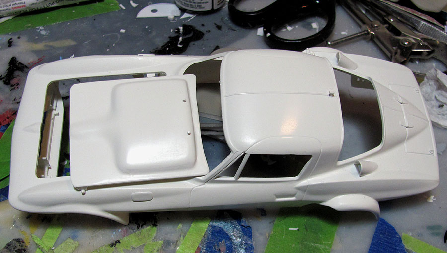

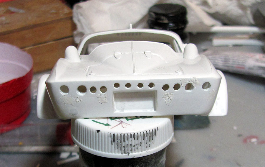

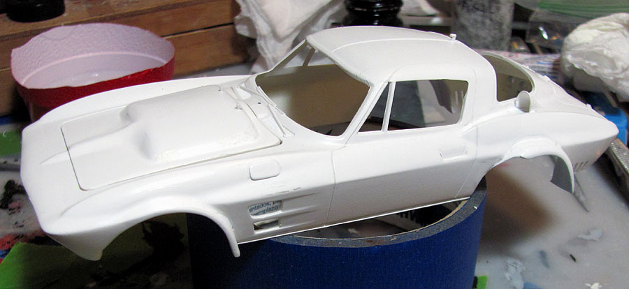

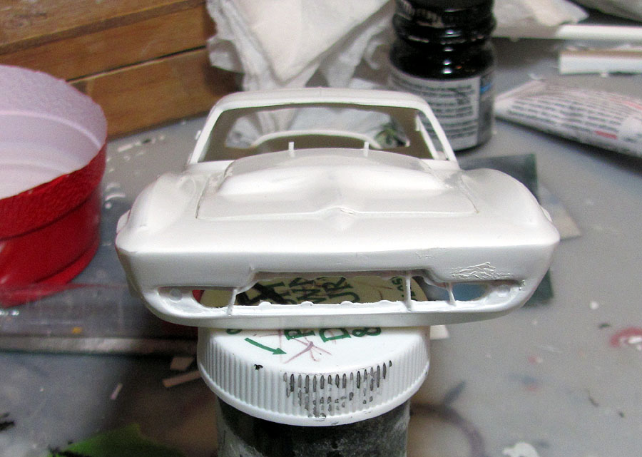

MarkJ Posted February 22, 2021 Author Posted February 22, 2021 Mike, Got the primer done and am sanding it . Finding spots that will need a little putty but pretty happy with it. Try to post some pics of the primered body.
MarkJ Posted February 22, 2021 Author Posted February 22, 2021 Wet sanded the body . Found some pin holes and other flaws. Added some more putty where needed. Will sand putty, re- prime and re-sand and hope the body is ready for paint. Want to move on to engine and chassis.
MarkJ Posted February 23, 2021 Author Posted February 23, 2021 16 hours ago, TransAmMike said: Yep, it's getting there Mark? Slowly, but surely. I'm getting tired of sanding . I want to get back to building.

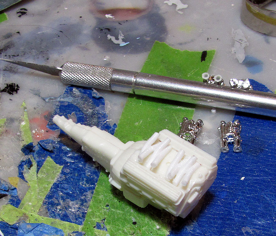

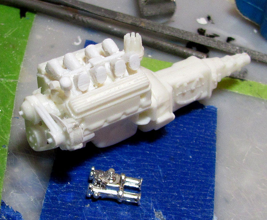

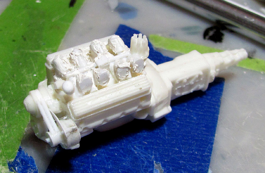

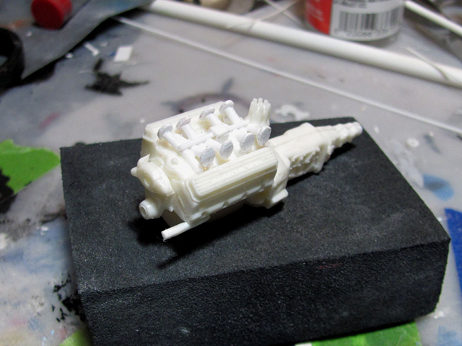

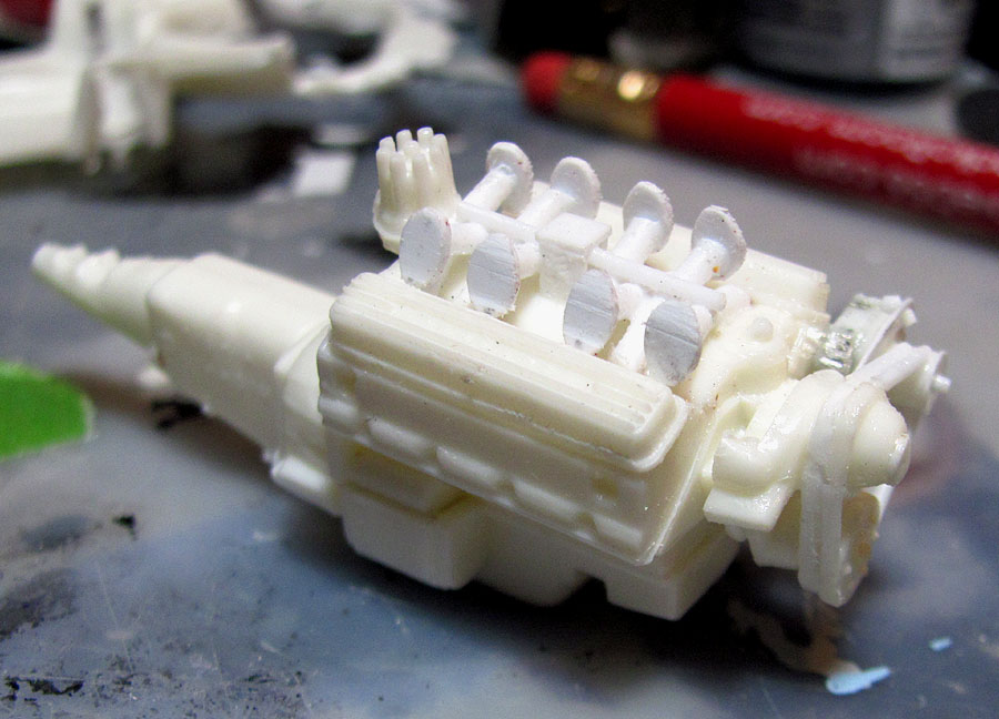

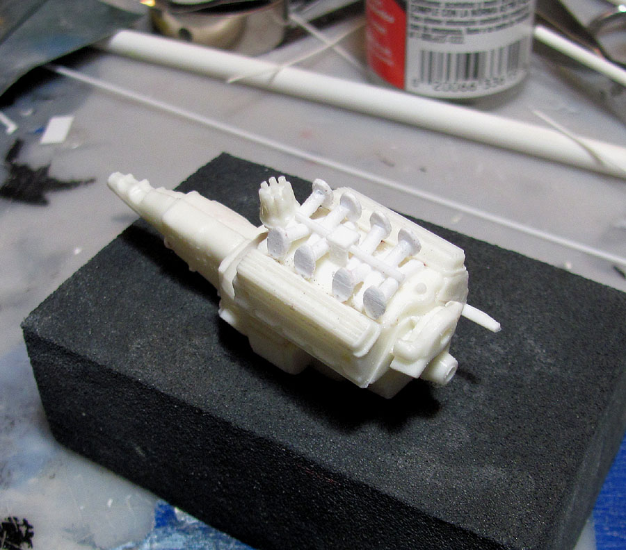

MarkJ Posted February 24, 2021 Author Posted February 24, 2021 Starting on the engine . The kit comes with the webers but no side draft manifold for the small block. I'm scratching one so I can use them . Not real accurate but it will work.

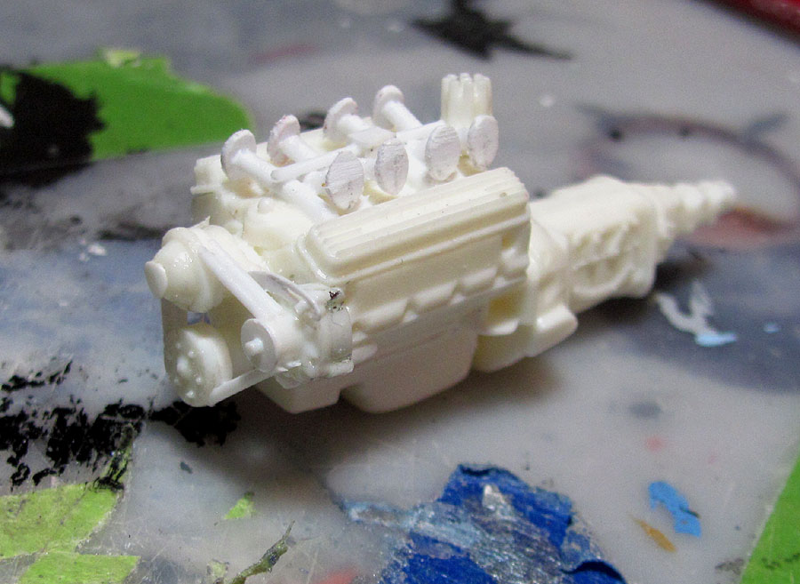

Venom Posted March 1, 2021 Posted March 1, 2021 Mark, I like how it’s all coming together with the scratch work. Did you scratch that alternator bracket also? That’s some pretty fine detail!
MarkJ Posted March 1, 2021 Author Posted March 1, 2021 14 hours ago, Venom said: Mark, I like how it’s all coming together with the scratch work. Did you scratch that alternator bracket also? That’s some pretty fine detail! Thanks, Josh . I had to scratch the bracket, the belts, and move the location of the alternator. The stock location for a regular corvette is on the right side of the engine. I also had to make the pulleys wider to accept two belts and actually just make a new pulley for the alternator. I need to do some more sanding on the belts to get rid of some excess styrene. I bought some liquid model cement hoping it was like plastruck plastic welder but it was not. You have to wait overnight before you can sand anything you glue with it. Nobody sells the plastruck around here and micro mark sells their own version of it . I always get everything from them but i want to find out if their version is chemically the same as the orange bottle plastruck. Hobby lobby used to sell it but they have really cut back on what they sell us modelers. It's really kind of sad.

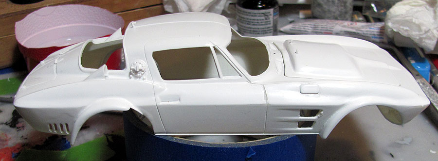

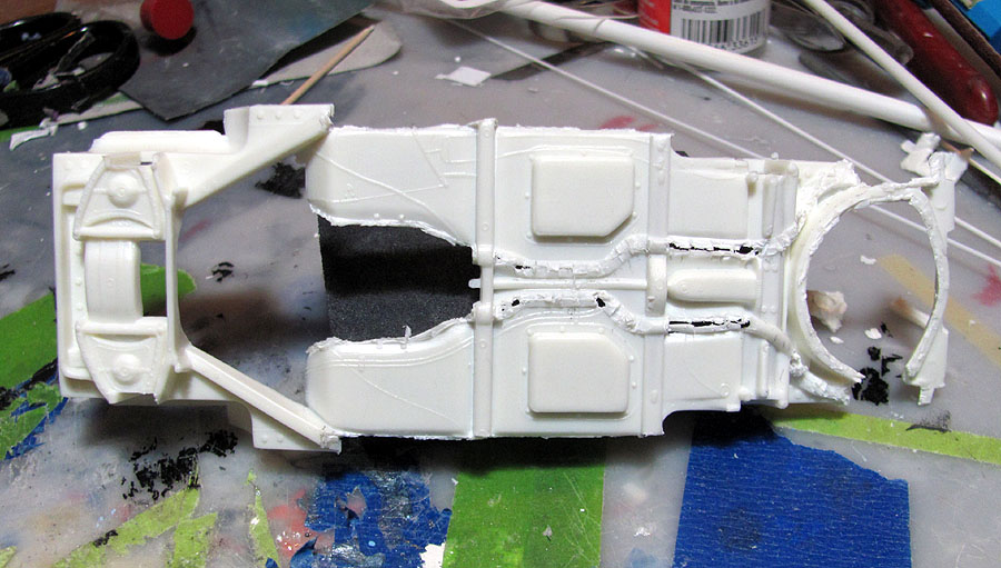

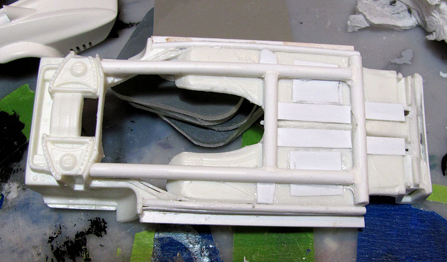

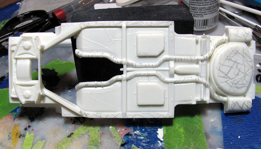

MarkJ Posted March 5, 2021 Author Posted March 5, 2021 Started polishing the body. Got the hood done and the left side of the roof. Also got some more work done on the chassis.
TransAmMike Posted March 6, 2021 Posted March 6, 2021 1 hour ago, MarkJ said: Started polishing the body. Got the hood done and the left side of the roof. Also got some more work done on the chassis. Hi Mark. Very interesting what you did with the chassis. Now I have to rethink not modifying mine. Now I'm anxious to see what you will do about the rear end suspension. The hood turned out great by the way. ?
Venom Posted March 6, 2021 Posted March 6, 2021 (edited) Wow Mark... it is looking excellent! Edited March 6, 2021 by Venom

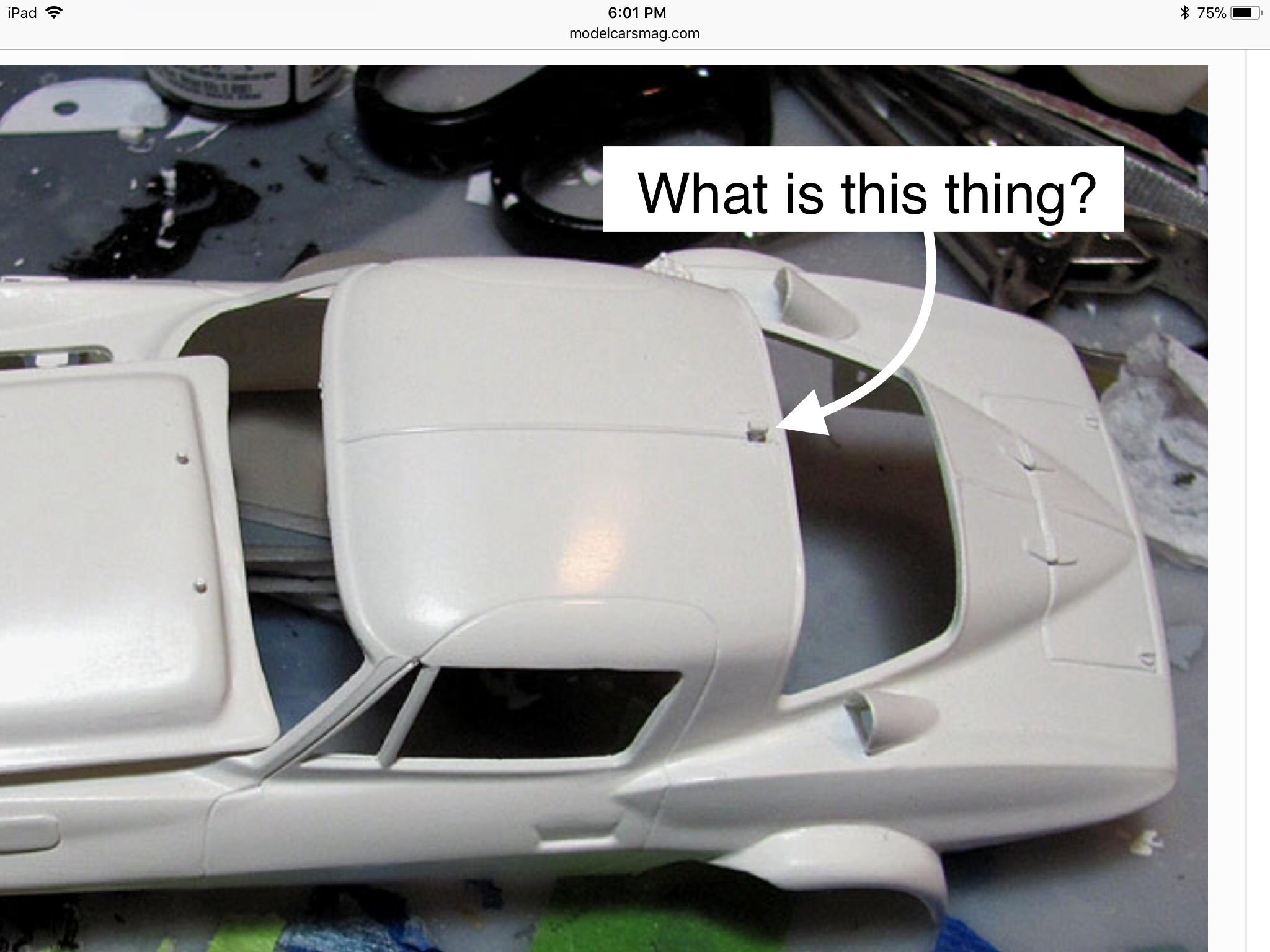

MarkJ Posted March 6, 2021 Author Posted March 6, 2021 Thanks , Josh. I have no idea what that thing is or what function it serves. It kinda looks like a periscope but I'm thinking it might be something for cooling something. But I 13 hours ago, Venom said: Wow Mark... it is looking excellent! really haven't got a clue .Its facing the wrong way to be a fuel tank vent.
MarkJ Posted March 6, 2021 Author Posted March 6, 2021 13 hours ago, TransAmMike said: Hi Mark. Very interesting what you did with the chassis. Now I have to rethink not modifying mine. Now I'm anxious to see what you will do about the rear end suspension. The hood turned out great by the way. ? Thanks, Mike. Thats the trouble with amt kits . You usually have to deal with molded in chassis parts that you have to get rid of but you want to keep the basic chassis. There is not much more i can do to the rear suspension except maybe add a leaf spring. I am however going to add a spare tire and rack to hold it, just to finish off the back part of the chassis. I felt I had to make it a tube chassis, just so I could do the exhaust right. I did an amt 63 chevy once , A Junior Johnson Chevy, where I completely re-did the front suspension, but I'm not going to do that on this one. Way too much work.
