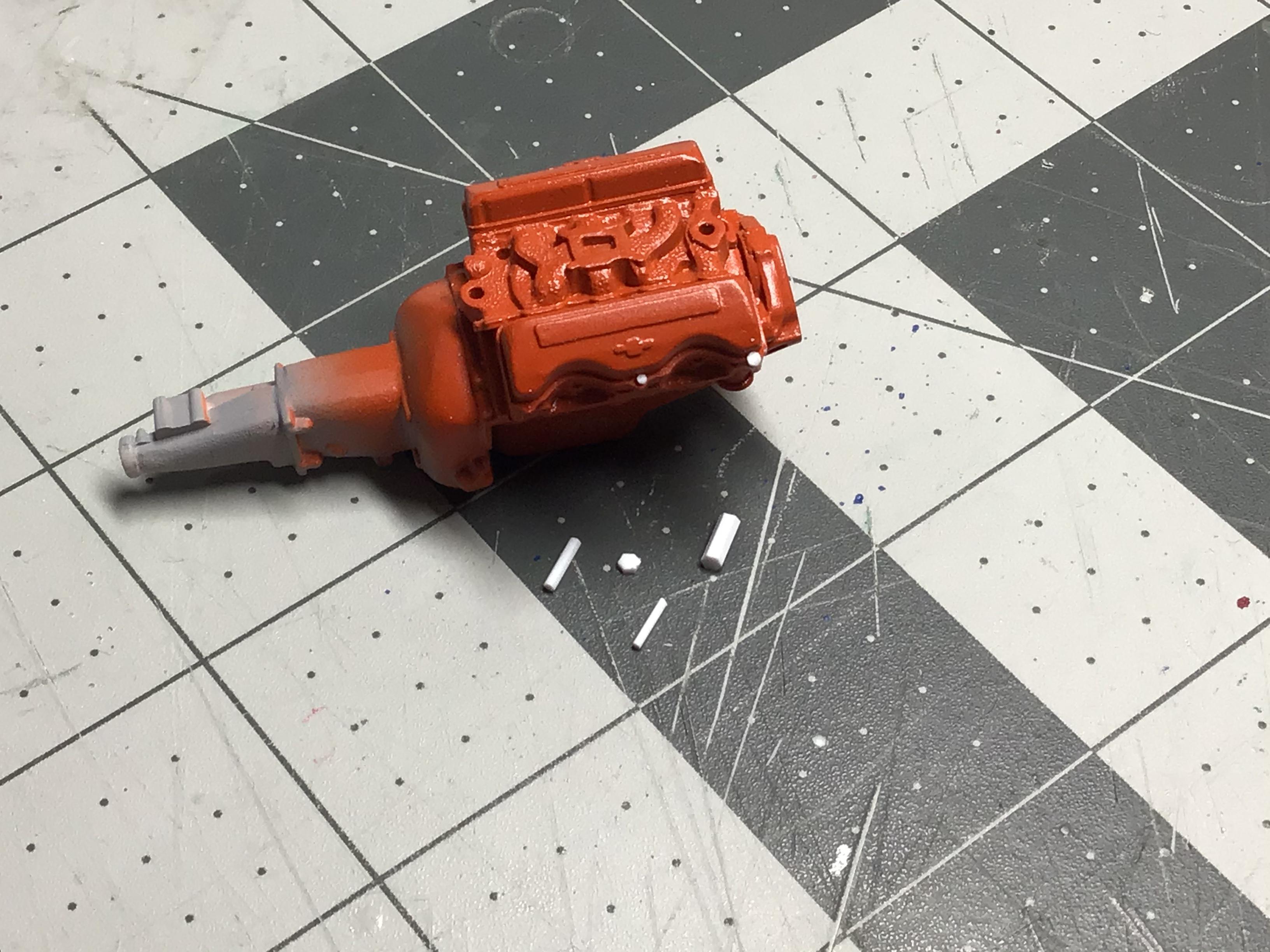

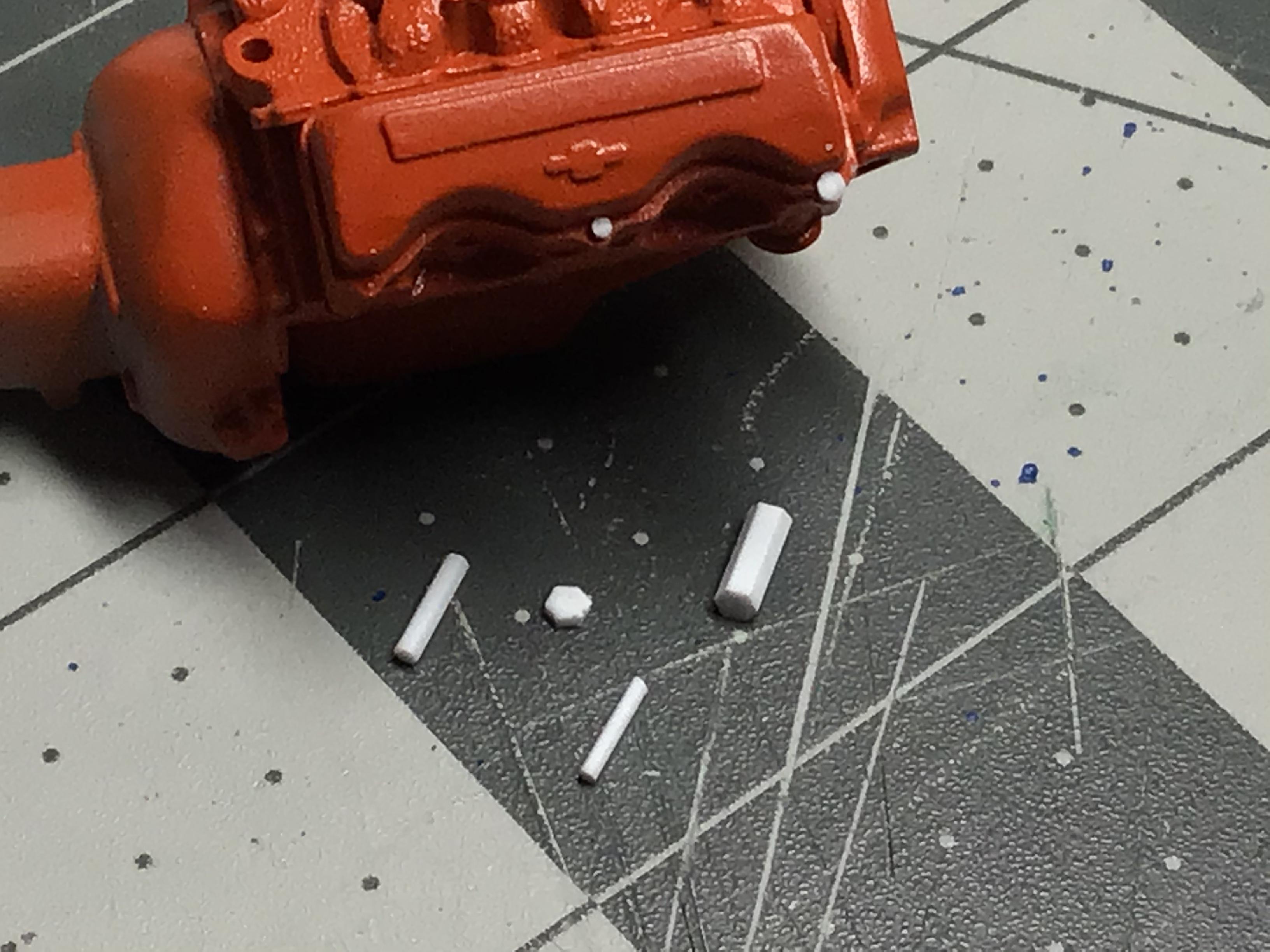

NOBLNG Posted January 28, 2021 Posted January 28, 2021 (edited) I agree the plastruct rod is not easy to work with. This is a 1/25 scale engine. The slice of hex at the center of the valve cover is .030”. The one at the front is .040”. The one on the cutting matt is .060”. And boy was it fun getting those tiny things off the tweezers due to static electricity. And by naked eye I can’t tell that the .030 is hex.? Edited January 28, 2021 by NOBLNG
