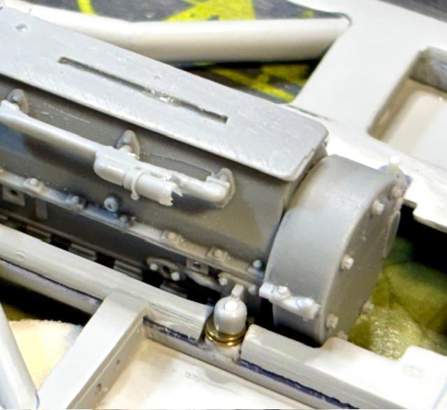

absmiami Posted August 31 Author Posted August 31 The two pulleys appear to be the same size - but have different features … 1

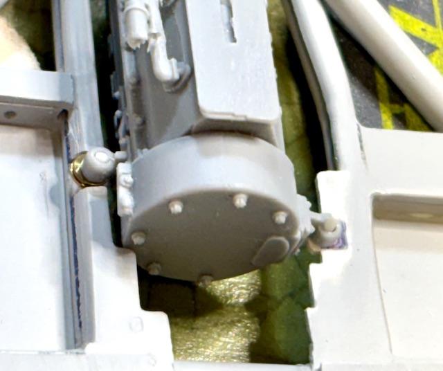

absmiami Posted September 2 Author Posted September 2 Gracias both DB and NOBLNG - styrene gets a break whilst i turn some more parts for the Maser and the Lotus - 2

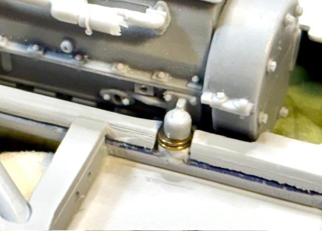

absmiami Posted October 1 Author Posted October 1 Some cyl head details - spark plug boots will be made from short lengths of .08 alu tube - each boot is shaped with a file - they will painted fl red - 1

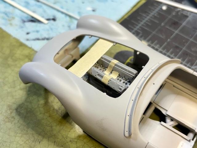

absmiami Posted October 17 Author Posted October 17 Changes to the engine mounts are needed so that the engine sits level in the eng bay - ive raised the mount points - using two washers on one mount - now the block is level and the cyl head sits just below the line of the hood - now i gotta make the eng bay bulkheads … 3
