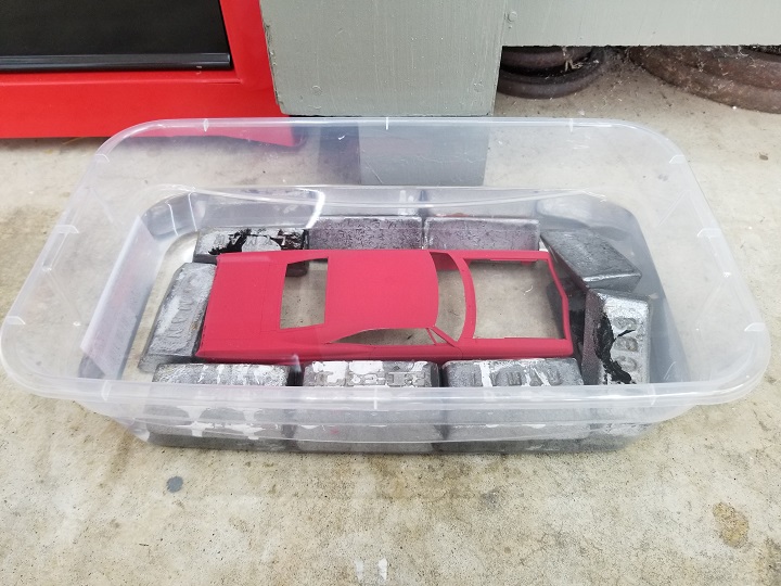

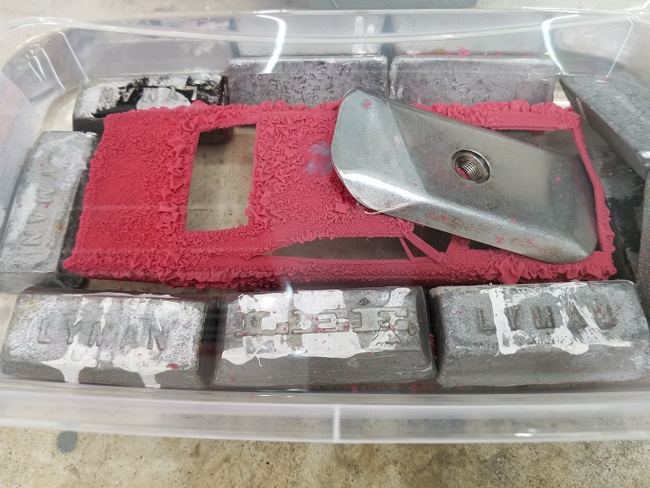

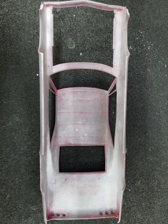

Zippi Posted April 28, 2021 Author Posted April 28, 2021 Test body is in the drink. I bought two 32oz bottles of the Isopropyl Alcohol and it just wasn't enough to cover the top of the body. I had a bunch of lead weights I sat in the tub to take up some of the area to raise the fluid level. I tried putting a weight on top of the car to hold it down and it kept sliding off as the paint was already starting to come off. It's on like Donkey Kong ☺
Zippi Posted April 28, 2021 Author Posted April 28, 2021 (edited) On 4/28/2021 at 5:38 PM, Dave G. said: You need a lid on that container. Expand I have it covered. Just took a pic of how the body was setting in the tub with all the lead weights. Edited April 28, 2021 by Zippi
Zippi Posted April 28, 2021 Author Posted April 28, 2021 This is just after 2 hrs. Seems to be working pretty good. We'll see in the morning.

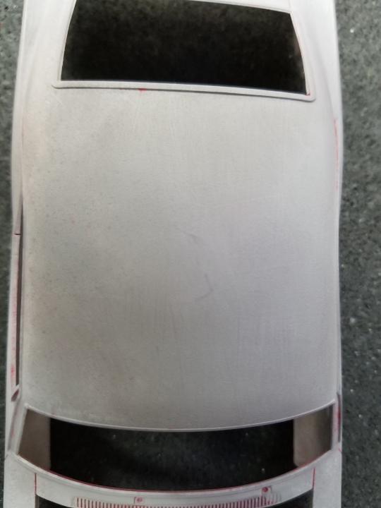

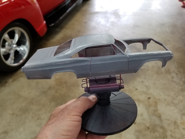

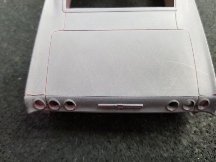

Zippi Posted April 29, 2021 Author Posted April 29, 2021 Ok fellows....here is a video and a few pics of the results of putting the test body in a tub of isopropyl alcohol for about 21 hrs. After cleaning the body up in hot water with Dawn dish detergent it looks pretty good. If I left it in a lot longer it may have taken more of the Rust-Oleum primer off as well but this is good for me. I'll just scuff it up and give it another coat of primer and call it a day.

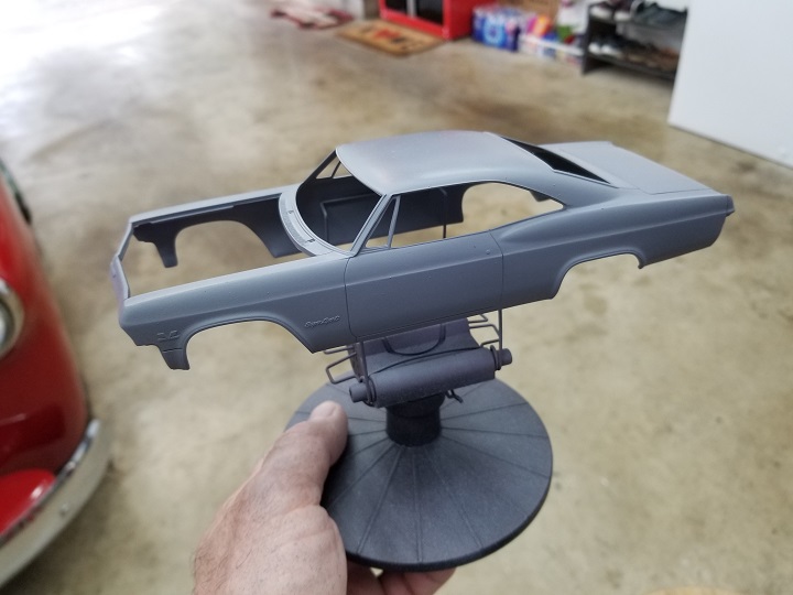

Zippi Posted April 29, 2021 Author Posted April 29, 2021 Got it sanded down, re-washed in Dawn, and re-primed. Came out fine.
Zippi Posted April 29, 2021 Author Posted April 29, 2021 On 4/29/2021 at 4:07 PM, Dave G. said: Looking good. Now what ? Expand I guess wait for a sunny calm day and give it another shot hoping for better results.
