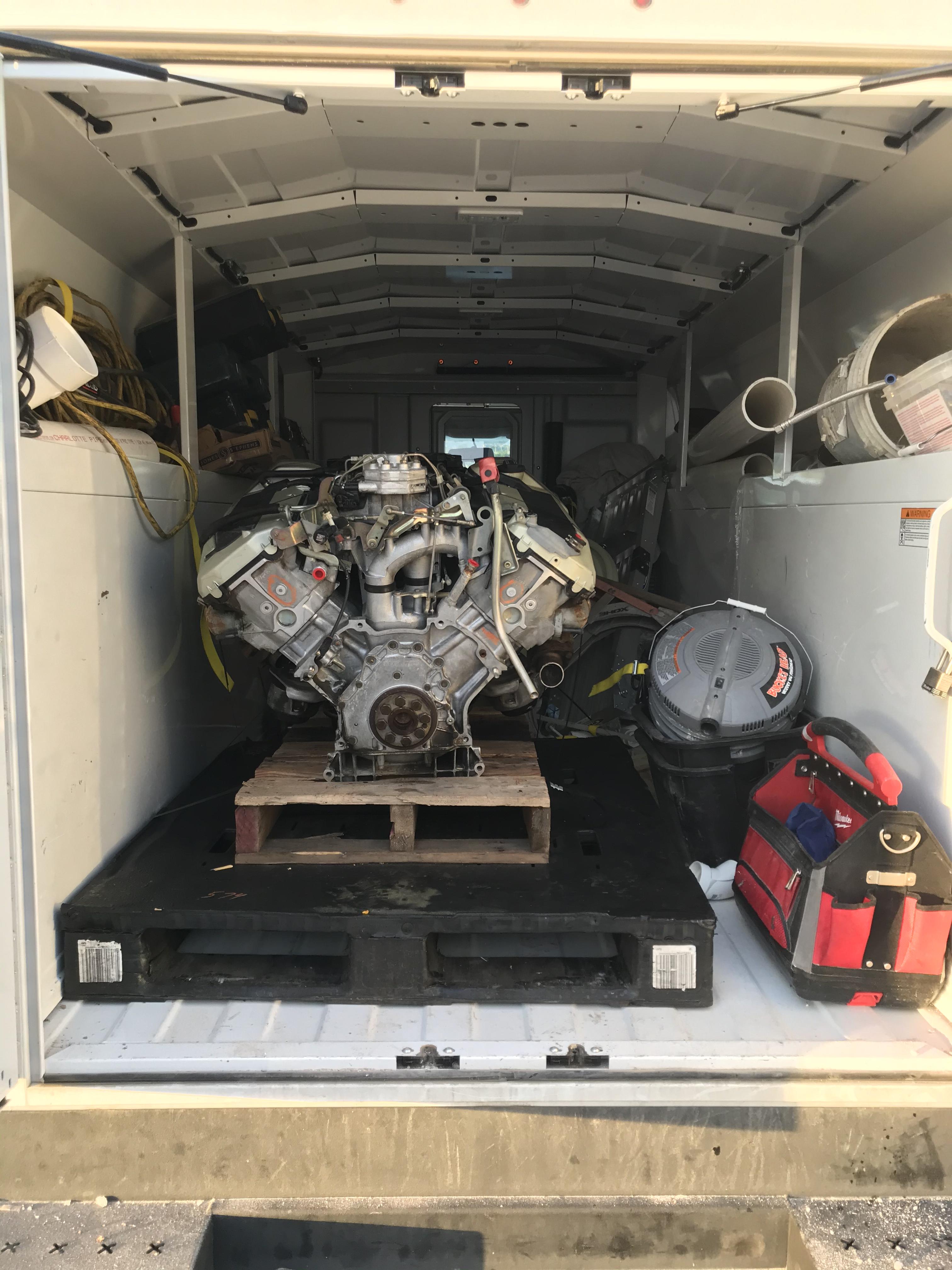

It’s a 1990 Mercedes-Benz M119; a 4-cam 32-valve V8 with forged internals and 322hp. I’m planning on forced induction. Some guys in Sweden got 1000hp from this type engine. The car has a 2.6 liter inline-6 with 158hp now.
Not much to look at while wrapped in plastic. It was shipped to my employer because they can unload it from a big rig. That’s the best photo I can get while not there myself. I’m pretty excited ??
