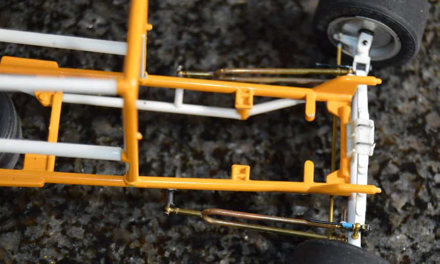

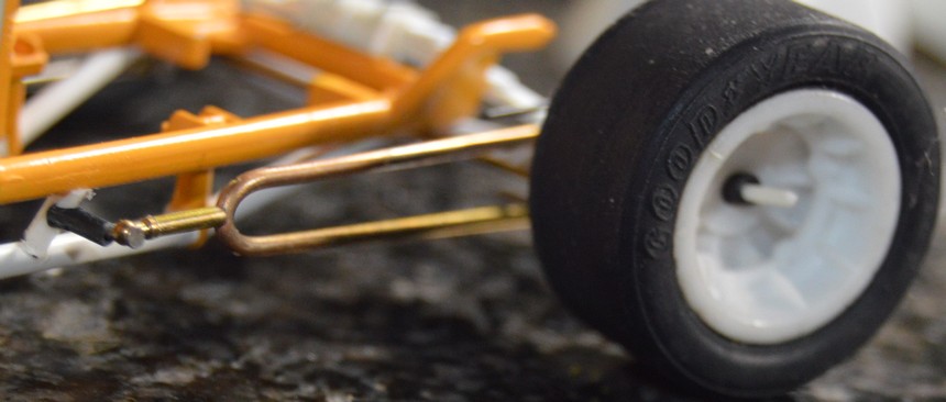

Straightliner59 Posted May 26, 2021 Posted May 26, 2021 Typically, if it looks like it belongs, go for it! Like David said, they play a little fast and loose with their dimensions, at times. I would get everything set up--fit the axle and suspension to the chassis, after you've determined how you're going to mount the wheels and tires. Use a flexible (tacky) white glue to mock stiff up--or better, pin everything together, then it can be taken apart and reassembled, if/when needed. Here's the front suspension I'm building for my supermodified. The pins and wire insulation that are holding it all together are readily visible. When it's ready for paint, I can take it apart to prep and paint it, then reassemble it using the same pins. Once final assembly is made, I will install "nuts" on the pins, glue them, then cut the pins off.

Ace-Garageguy Posted May 26, 2021 Posted May 26, 2021 On 5/26/2021 at 8:31 AM, Straightliner59 said: Typically, if it looks like it belongs, go for it! Like David said, they play a little fast and loose with their dimensions, at times. I would get everything set up--fit the axle and suspension to the chassis, after you've determined how you're going to mount the wheels and tires. Use a flexible (tacky) white glue to mock stiff up--or better, pin everything together, then it can be taken apart and reassembled, if/when needed... Expand Yup. Exactly. NICE hairpins, too.
bob terry Posted May 26, 2021 Author Posted May 26, 2021 Thanks guys. Agreed with Ace, Daniel has some nice work there.
Straightliner59 Posted May 27, 2021 Posted May 27, 2021 On 5/26/2021 at 6:24 PM, Ace-Garageguy said: Yup. Exactly. NICE hairpins, too. Expand Thanks, Bill. Appreciate it. Now, to make another pair, for the rear... On 5/26/2021 at 11:45 PM, bob terry said: Thanks guys. Agreed with Ace, Daniel has some nice work there. Expand Thank you, Bob. You are definitely on the right track!
