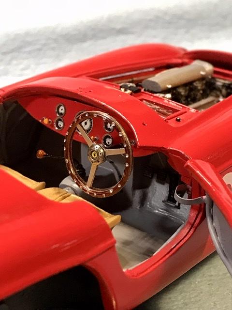

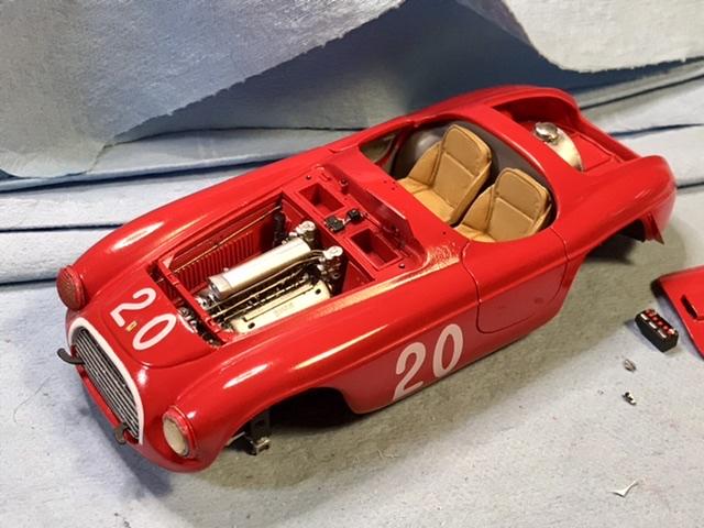

absmiami Posted October 13, 2024 Author Posted October 13, 2024 There’s alot of stuff on the eng bulkhead - here’s the fuse boxes that i made months ago …. 2
absmiami Posted October 16, 2024 Author Posted October 16, 2024 Dash in - epoxy plus some hidden braces installed w CA glue … now for the steering wheel … 1

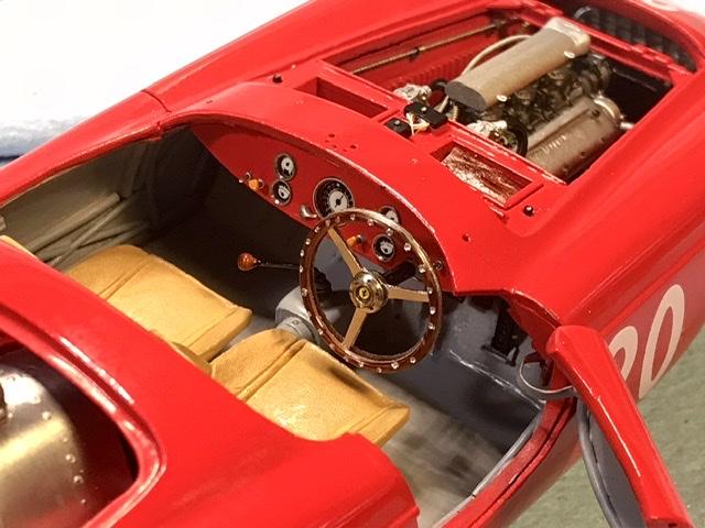

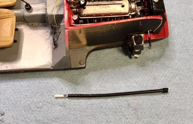

absmiami Posted October 16, 2024 Author Posted October 16, 2024 Steering column presents a problem- it has to thread through the bulkhead to reach the steering box - and i’ve drilled the opening in the bulkhead in the wrong place - about one scale inch too far to the center - so now ive got to make a bend in the column - but the fix is not visible behind the dash - and this is a secret - right ?? 1
absmiami Posted October 16, 2024 Author Posted October 16, 2024 So with the bend i’ve got the steering wheel in the right place - on the the next problem - lurking somewhere … 1
MarkJ Posted October 16, 2024 Posted October 16, 2024 Andrew, really liking the dash and steering wheel very much. Hope the driver was wearing gloves. I won't tell anybody that the steering column is bent if you don't tell anybody that on my latest build a lot of things are bent that aren't supposed to be and some are not hidden from view. I'll just use the same old defense many do and just say it's a shelfer so it doesn't matter. Actually every model I own is a shelfer because they all sit on a shelf. Not the same one of course.

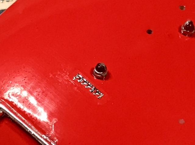

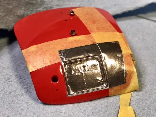

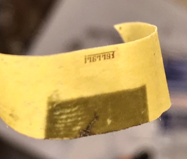

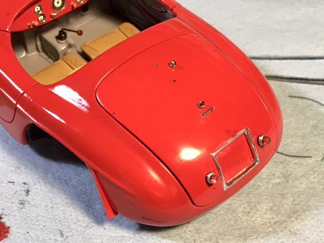

absmiami Posted October 22, 2024 Author Posted October 22, 2024 I’m famous for not following my own advise - the Ferrari script decal that i so carefully placed on the trunk is gone - entombed on a peice of masking tape that was used to mask the trunk to spray some Thinned Molotow on to the trim surrounding the plate recess !! First - i should have sprayed on the trim before i placed the script - two - i waxed the trunk surface before applying the decal - so that sucker came right up when i laid on the tape …. I hate when that happens - and for good measure I’ve got some excess chrome paint that marred the trunk surface above the trim - - -

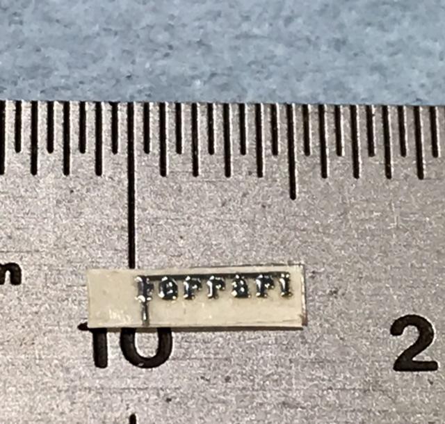

absmiami Posted October 22, 2024 Author Posted October 22, 2024 To replace the first script i used a metal self adjesing sticker from a set of markings that i bought last year on ebay - to add the scripts to the eng cam covers …

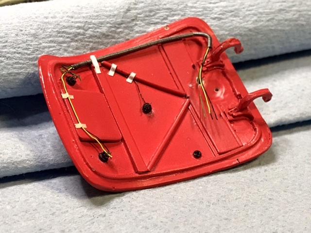

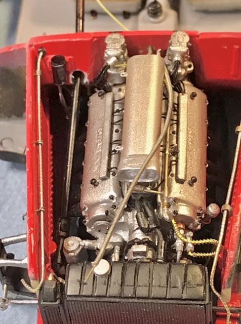

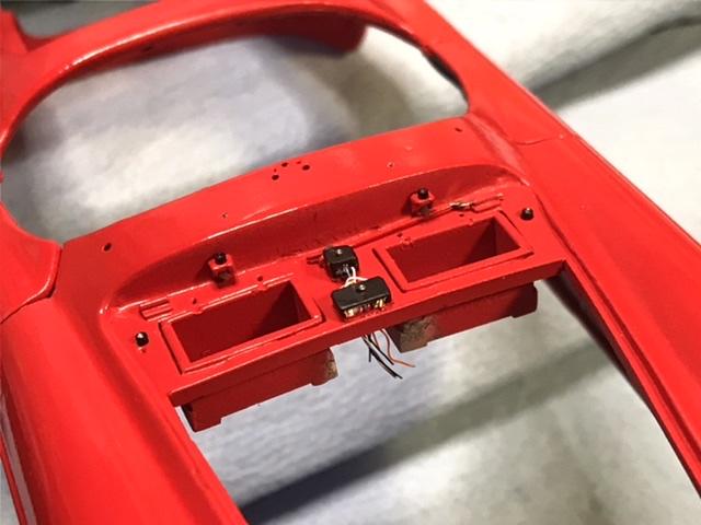

absmiami Posted October 22, 2024 Author Posted October 22, 2024 Wiring the trunk and tail lights…. Some tiny photo-etched eyelits made by a model railroad accesory maker come in handy for this …

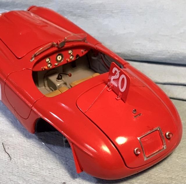

absmiami Posted October 22, 2024 Author Posted October 22, 2024 So what are those last two holes for ??

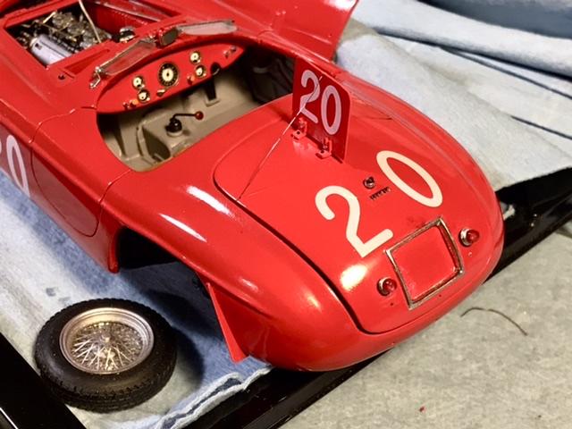

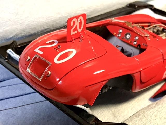

absmiami Posted October 22, 2024 Author Posted October 22, 2024 Spa rules circa 1949 required the use of a vertical number placard - the Shirley family restored 0010 as raced at Spa - with the unique placard ...

absmiami Posted October 23, 2024 Author Posted October 23, 2024 Guinness - or if i can source it - Dogfish Head World Wide Stout …. The stay is .005 steel wire …

MarkJ Posted October 26, 2024 Posted October 26, 2024 Amazing you found wire that thin. I wonder if that number helped the aero on the car at all as far as keeping the car more straight on the straightaways. Kinda doubt it, being a topless car. Of course, they really didn't worry about aero back then anyway. Just wanted a pretty body to look at which they succeeded in doing.
