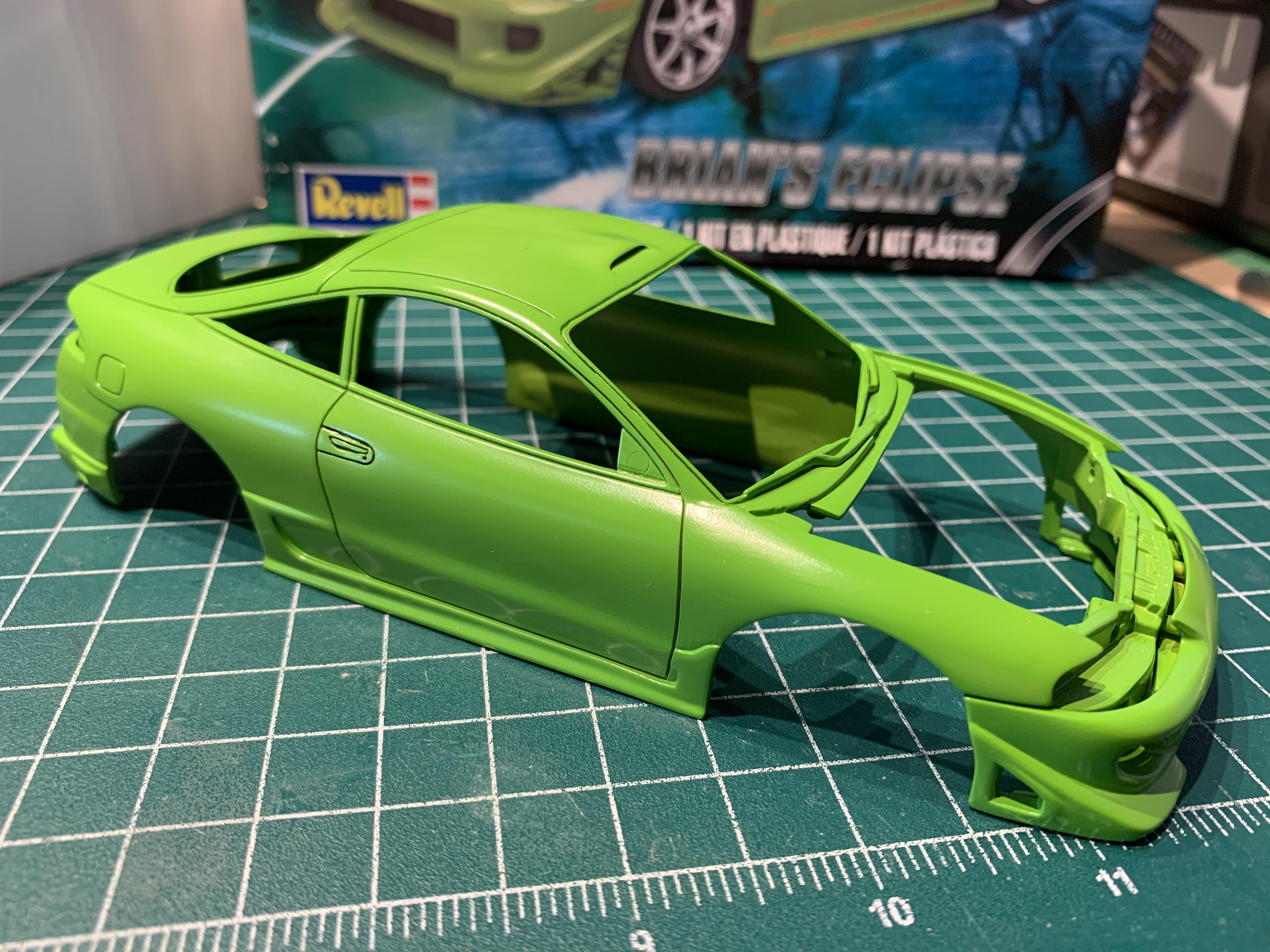

I think the thinners in the Zero paint ate into the plastic. Try trying on your spare body the Zero primer and paint first.
doing an excellent job on the build as well. You’ve captured some great details!!
Yes Chris,  you were correct.  I realize now I was spraying my coats on too thick.   After I stripped & sanded the body, I sprayed Zero Paints grey primer, then about 5-6 thin coasts of the Zero Paints Lime Green with positive results.

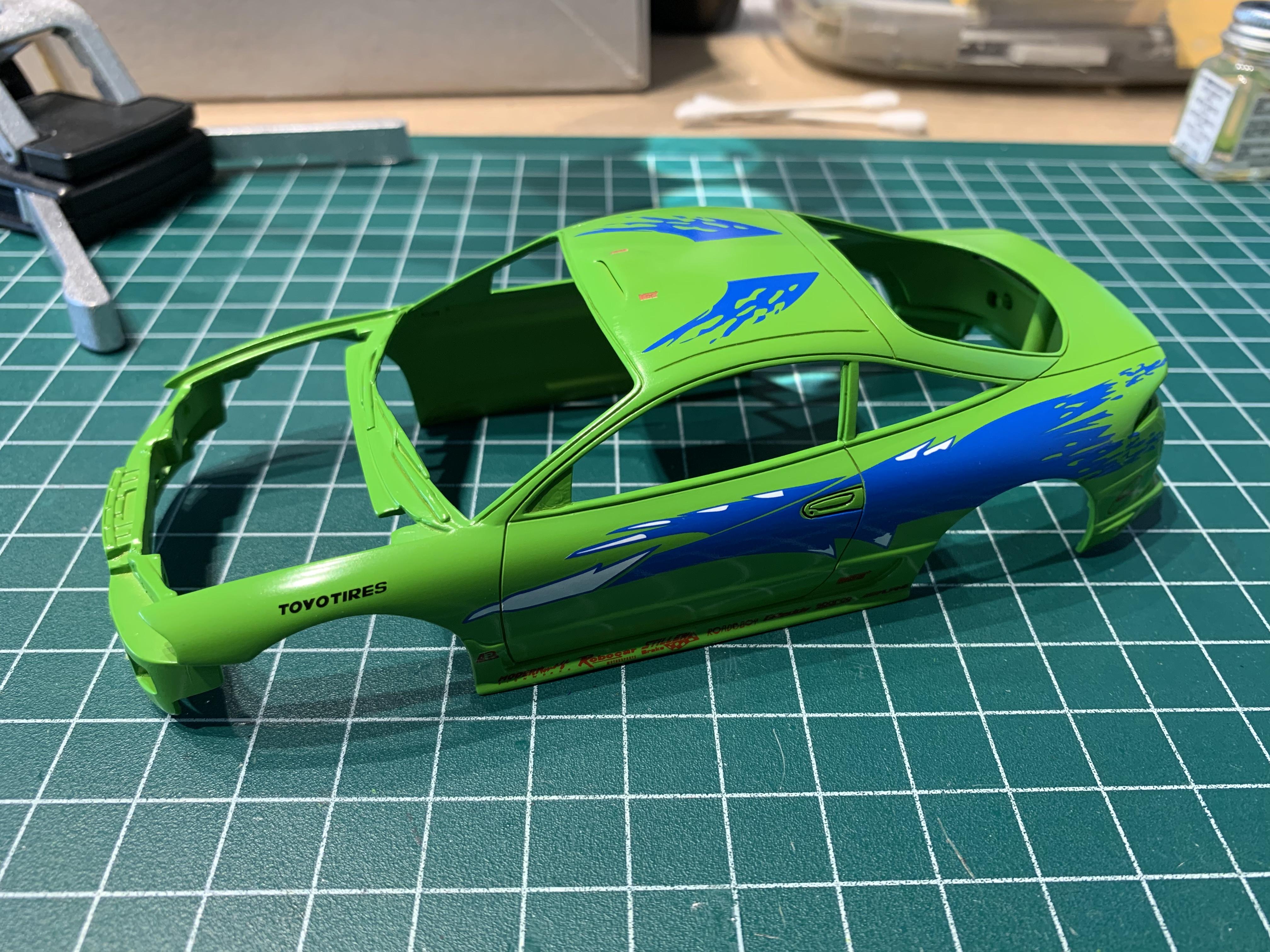

Will do a very light sanding with 4000 to get rid of the dust particles then apply the decals. Let it dry over the weekend and then apply the 2K clear with thin coats.

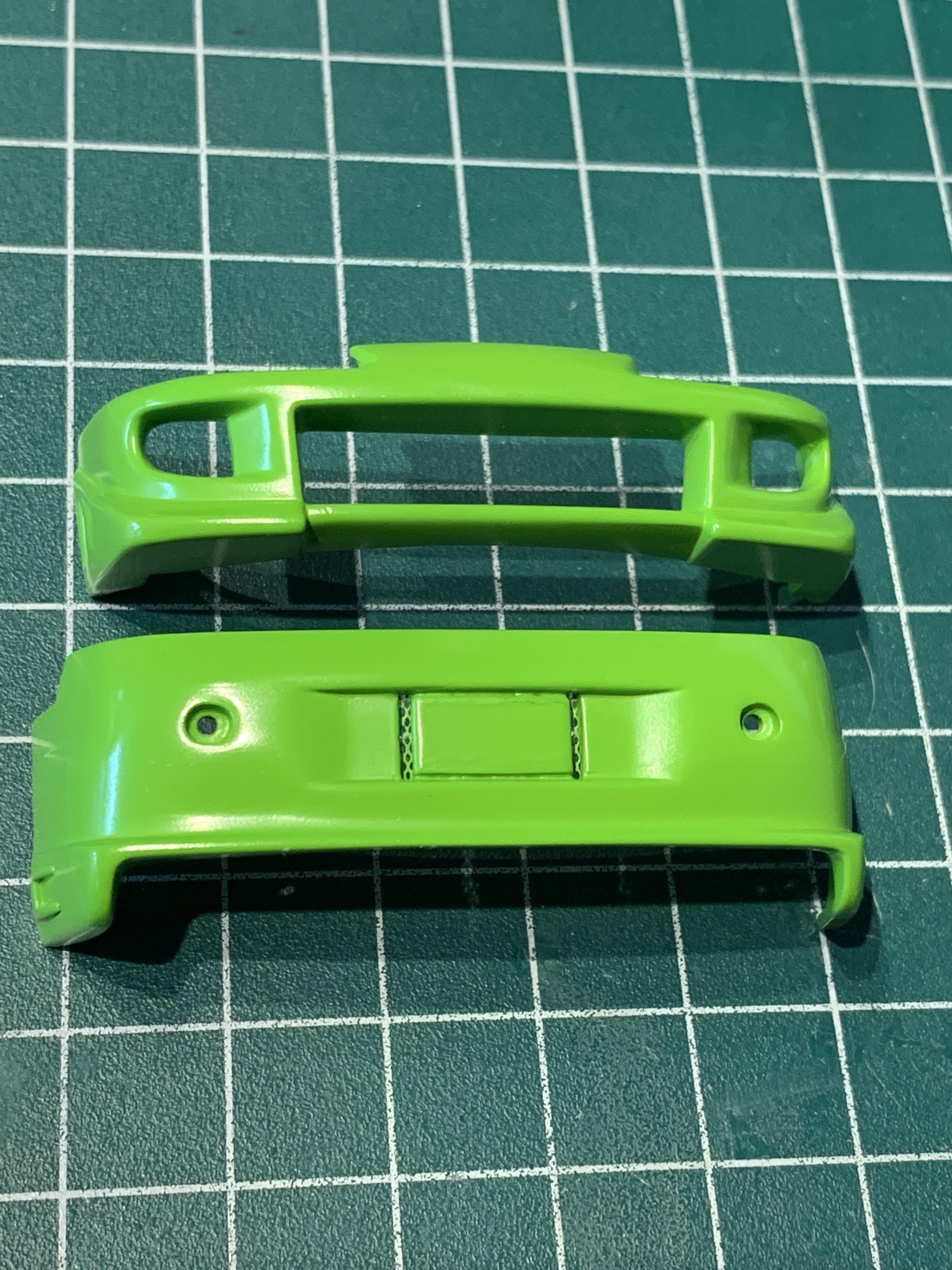

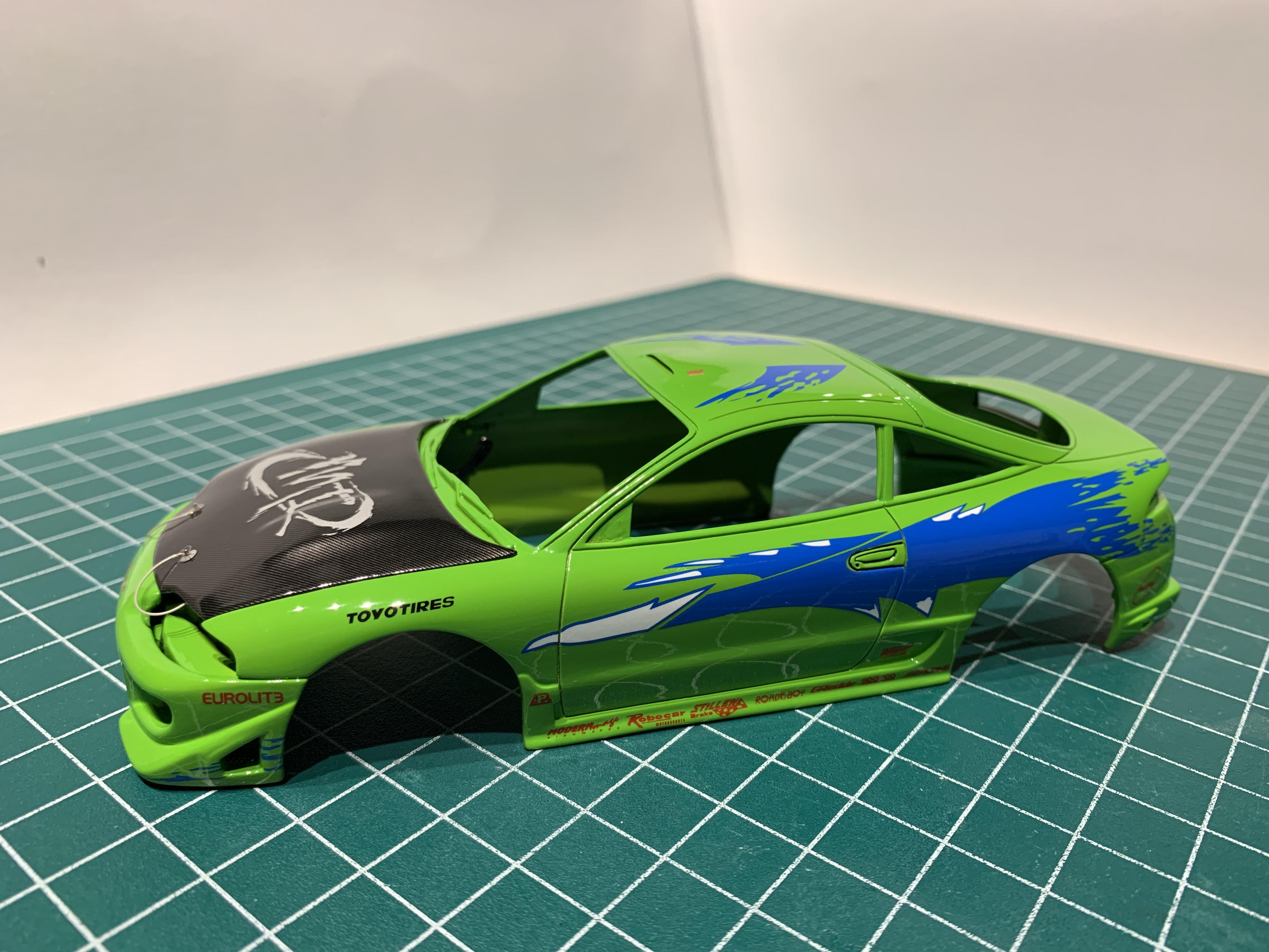

Finally, base coat is finished. Purchased a new airbrush and was very happy with the results. Next steps is to finish the engine assembly and then apply those F&F decals and then the 2K Clear!!

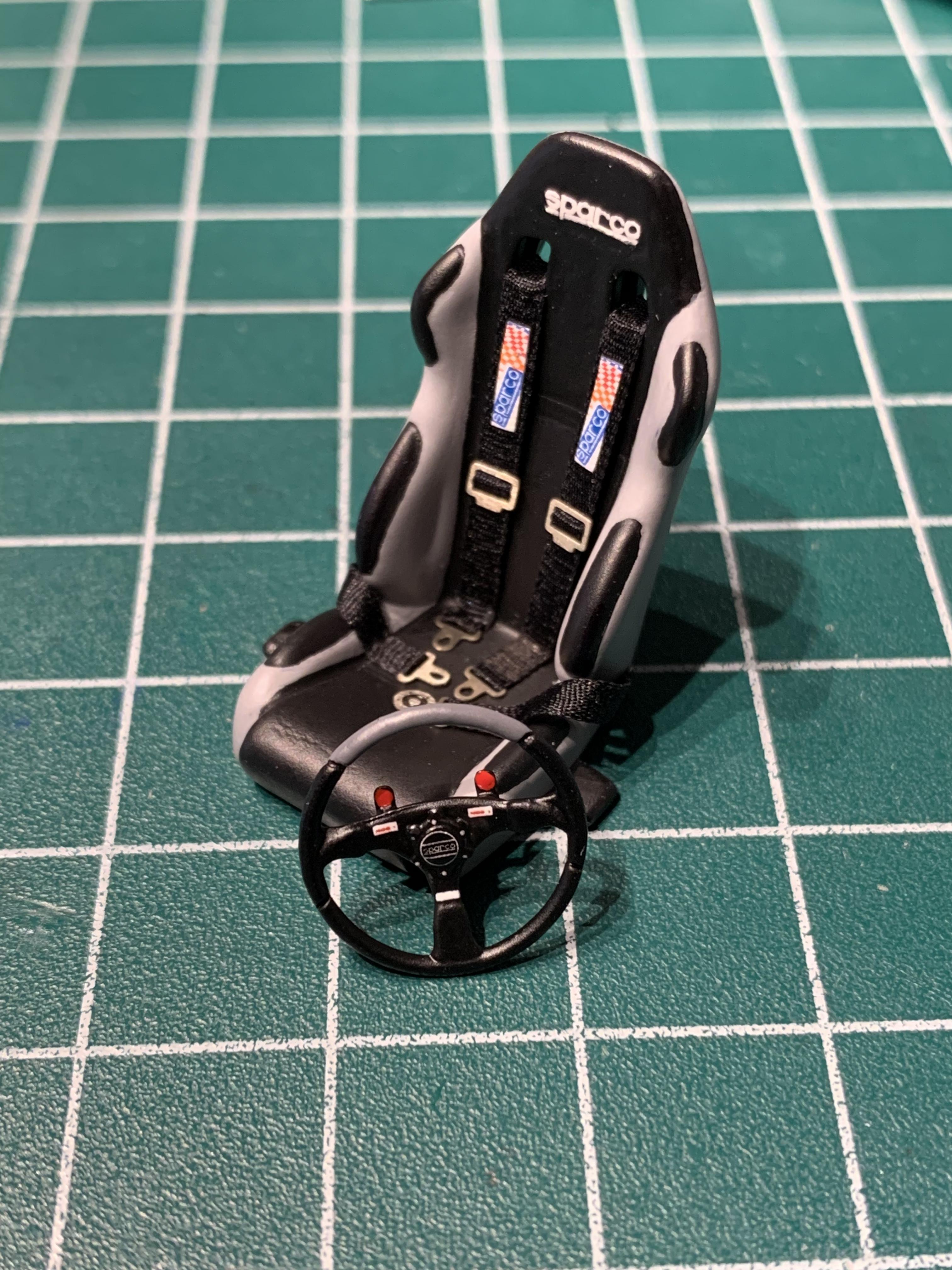

Detailing these seats was a slow & patient process, but I definitely liked the results of the 4-point seatbelt harness.
Added the two buttons for the Nos 1 & Nos 2 shots !!
How did you paint the raised lettering on the seats?   I been racking my brain trying for do white letter tires.  Tried everything up to a gel pen!!  My hands not really steady.   Thanks.
The “Sparco” lettering on the top of the seat is actually a decal.
* FYI - Did you know you can also buy decals of different tire manufacturers? ie: Goodyear, Michelin, Toyo, etc.  You need to sand off the raised lettering on the rubber tire, then apply the decal and finish off with a coat of matte or semi-gloss.
TCB,
Adam

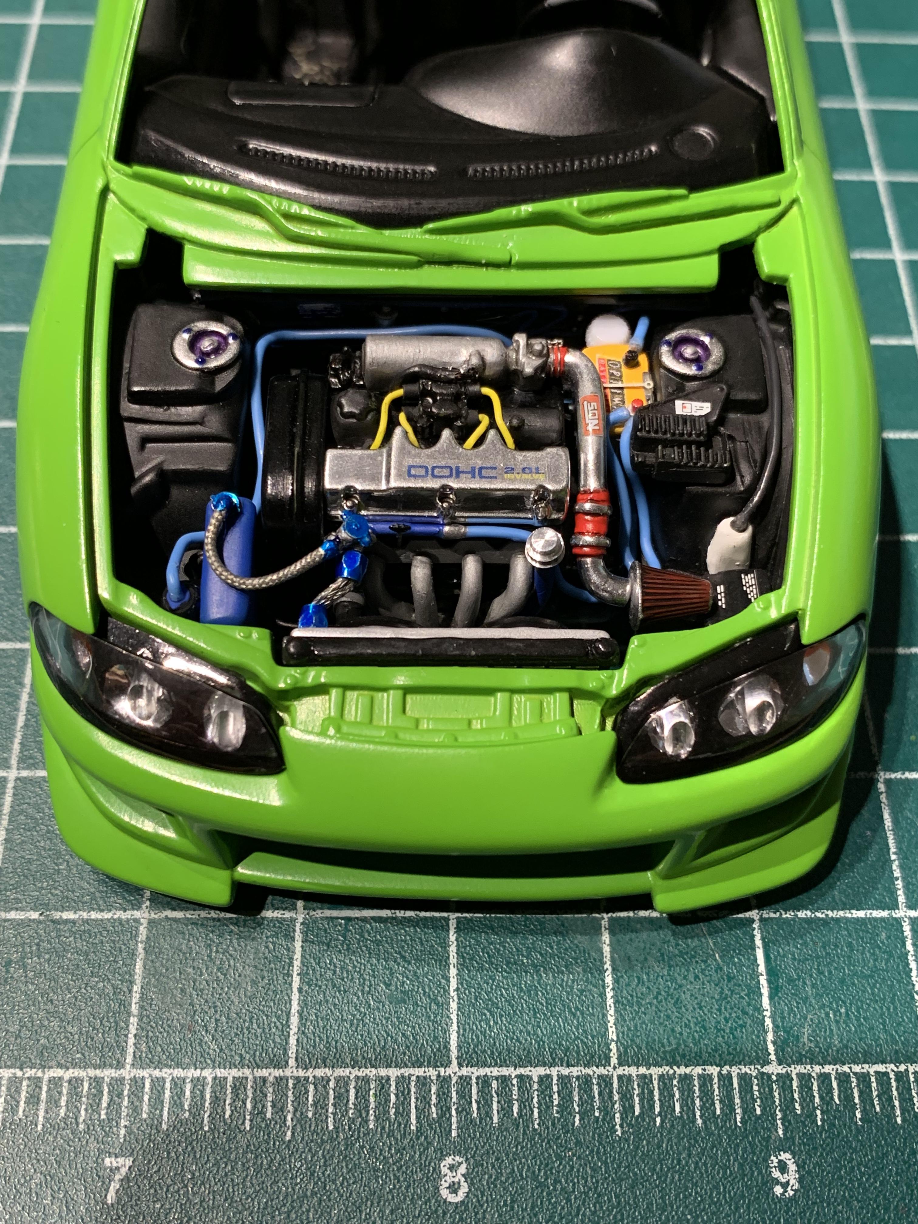

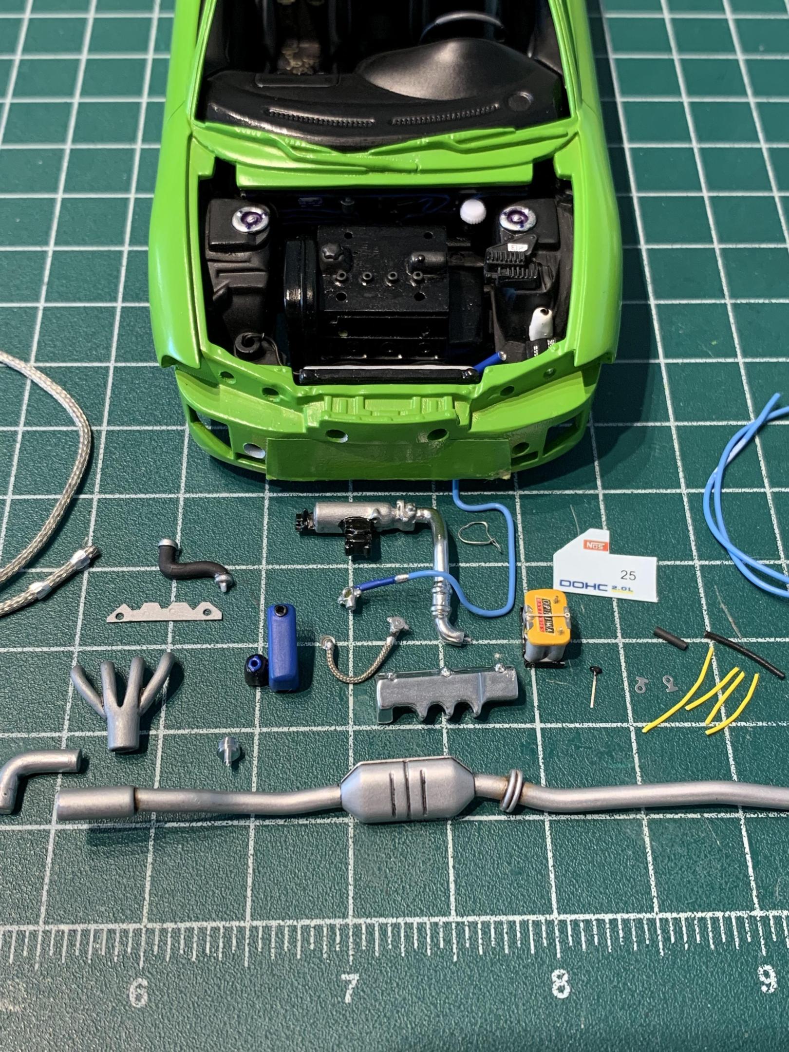

Here is the completed Mitsubishi 420A DOHC 2.0L 16V engine that was in Brian’s Hero car.
To be accurate, I had to take parts from both the AMT and Revell kits and scratch build a new one.

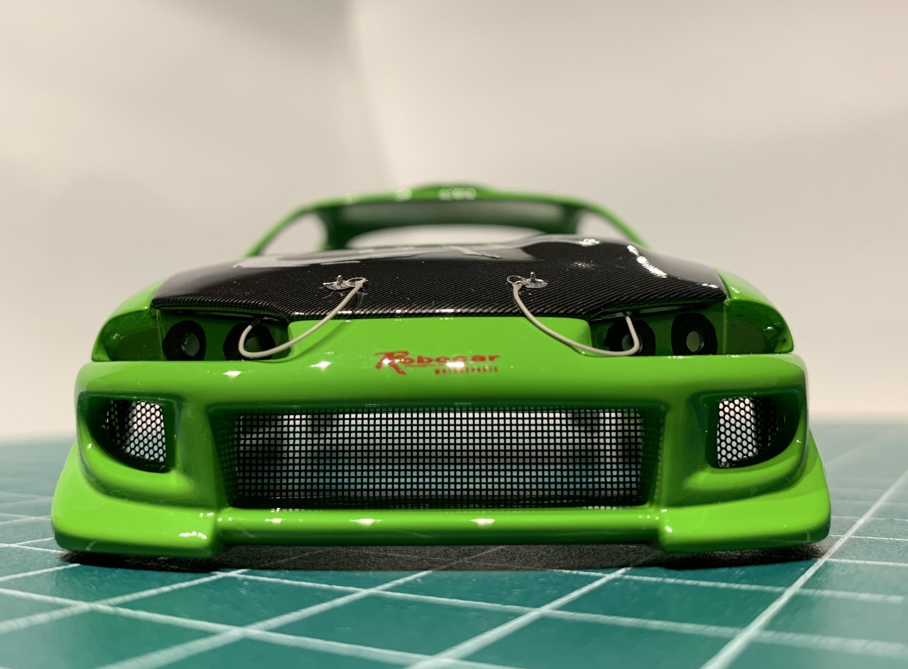

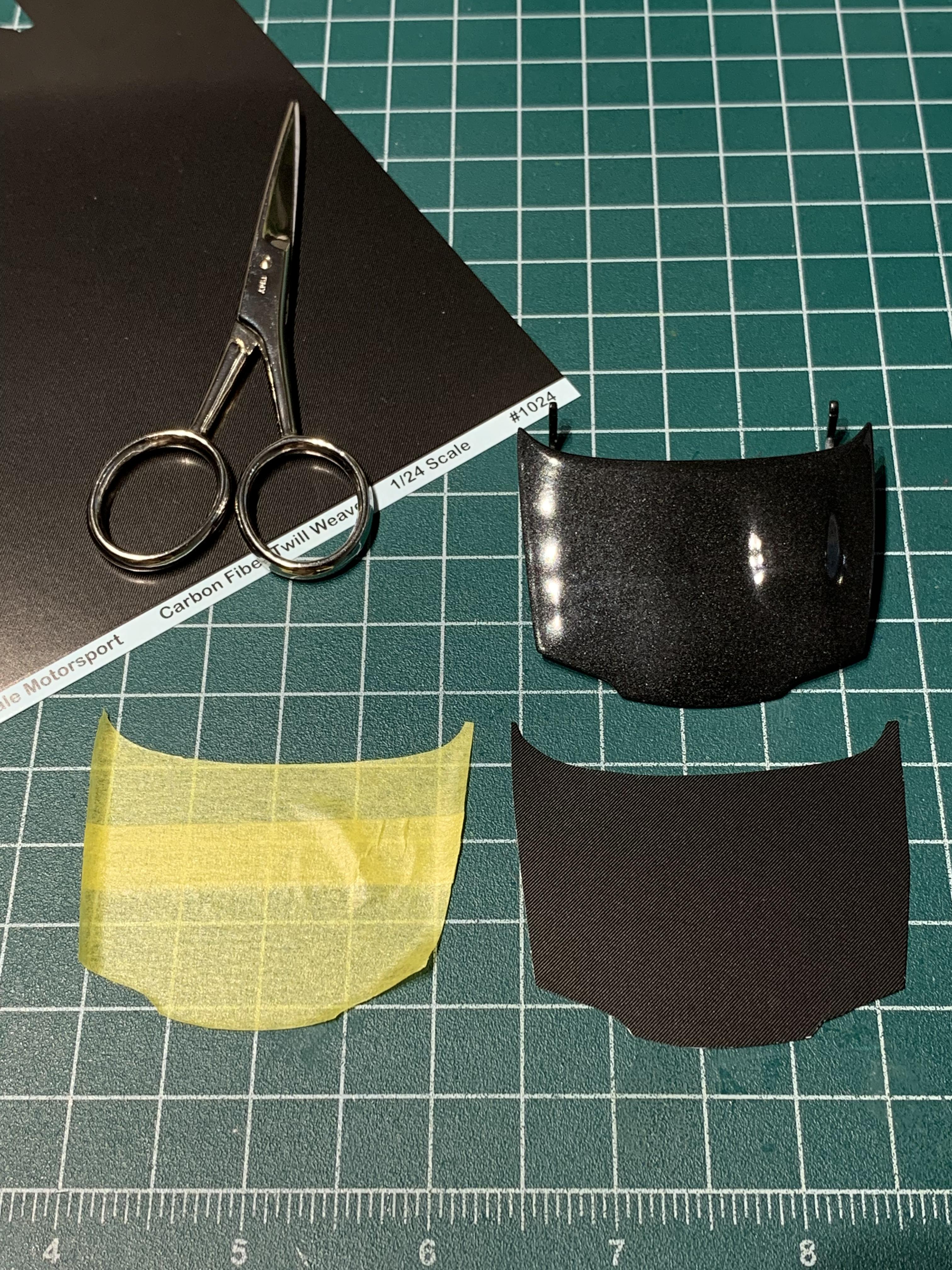

Added my own carbon fiber decal from Scale Motorsport. This is a very popular choice and I recommend you should have some in your stock.
Adam

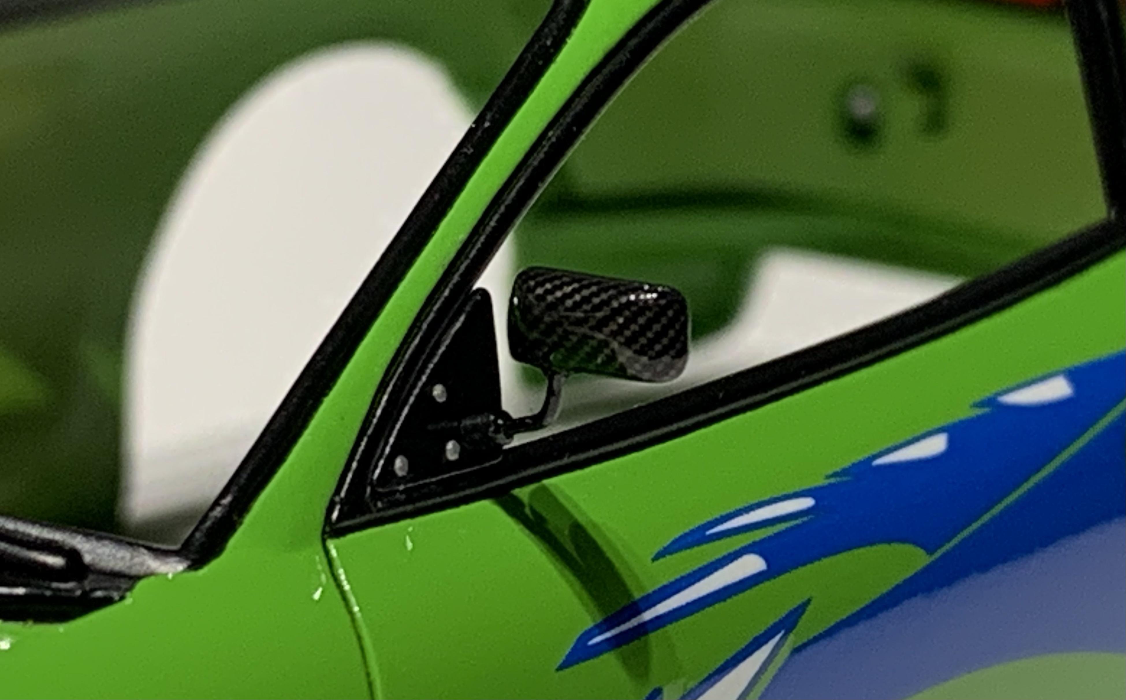

The side mirrors were a bit too small and feeble, so I made a more durable replacement from plastic sprue, a used staple and some rubber hose (spark plug wire boots). Wrapped it in carbon fiber decal and used BMF for the mirror. Created a separate side mounting plate, which was painted semi-gloss black and drilled a small hole for the arm to be glued into.

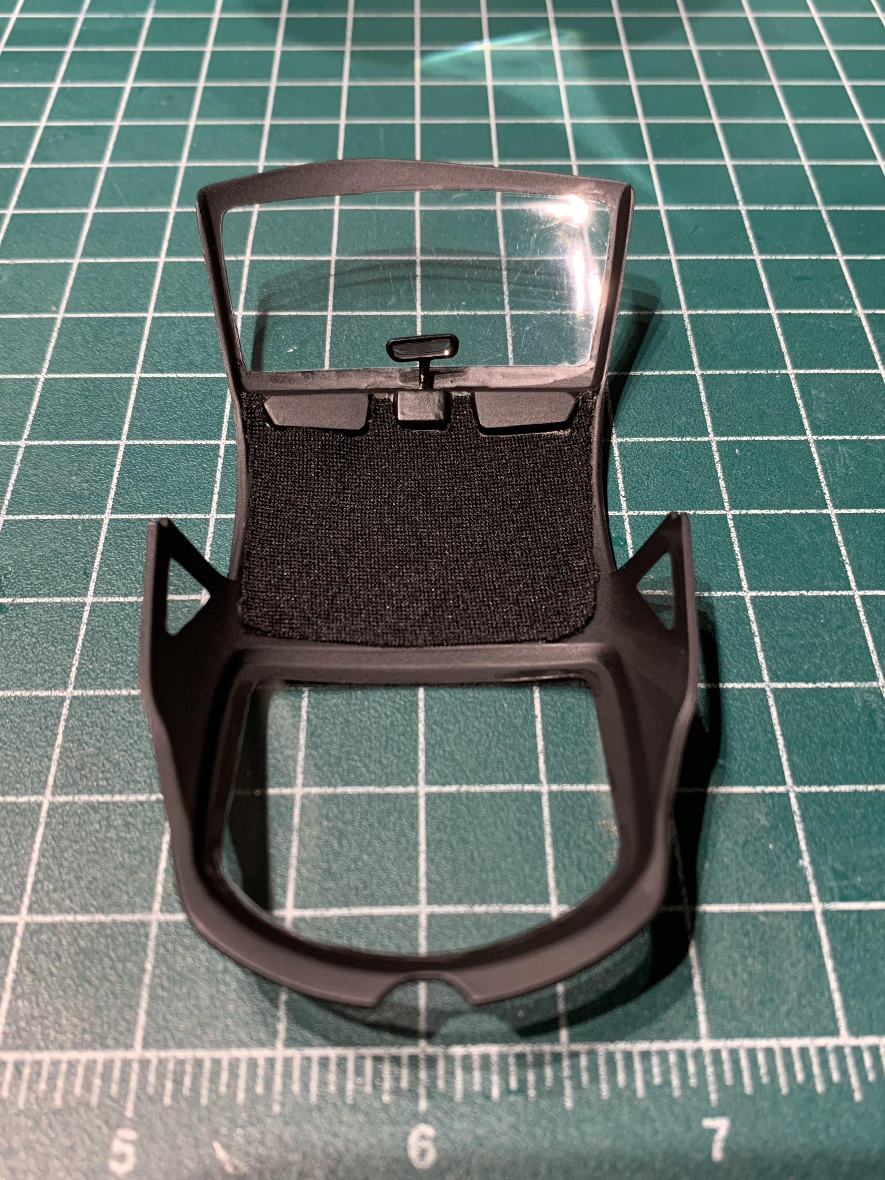

Needed to add my signature roof liner. LOL.
Every car that I have built lately has one installed.  This is the black fabric from a broken set of head phones !
TCB,
Adam
