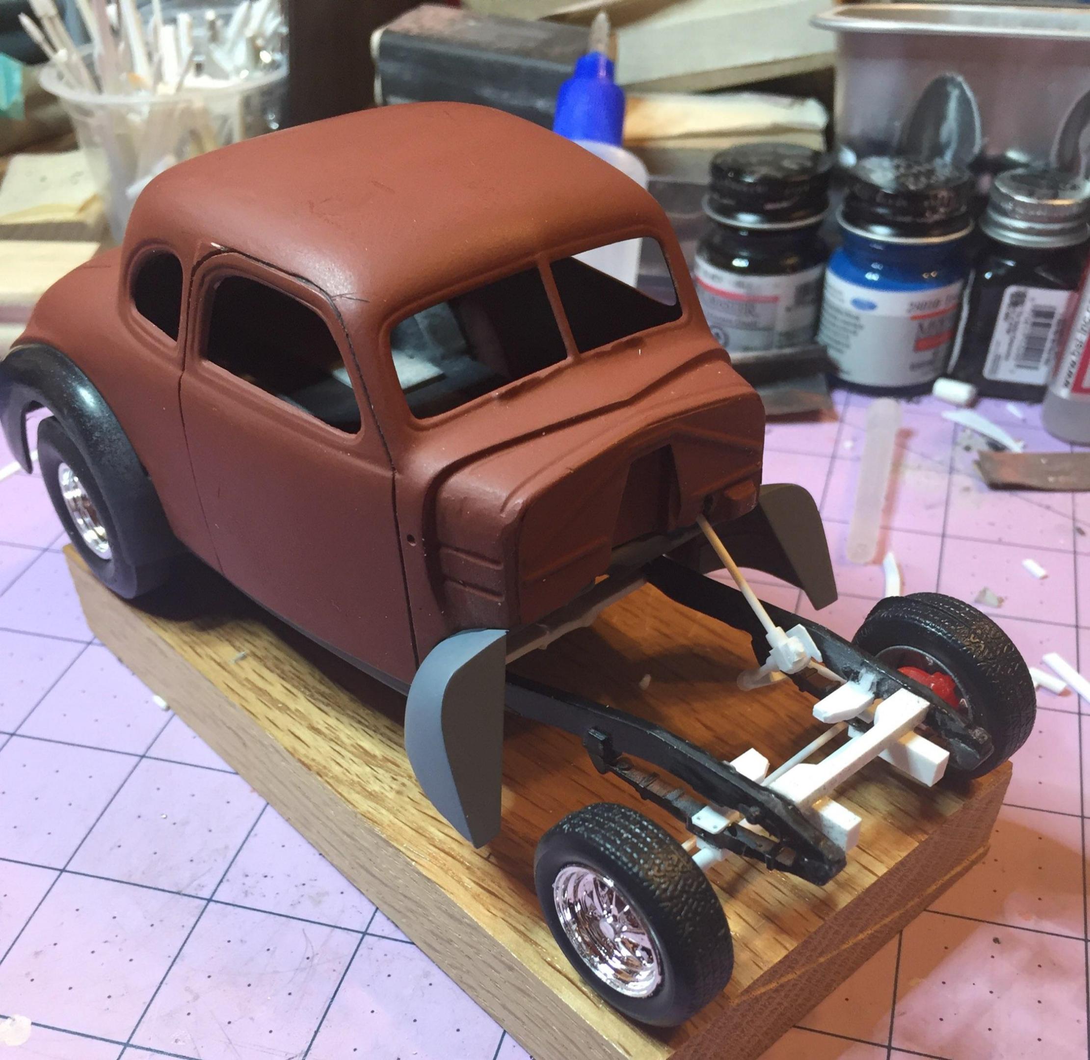

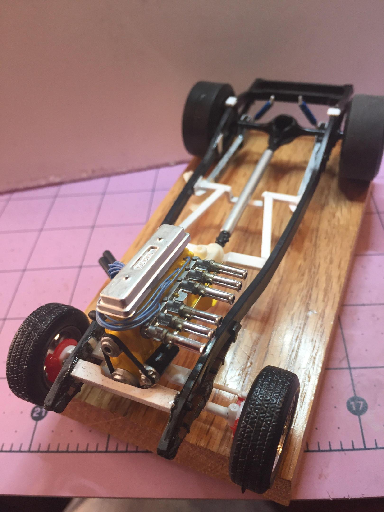

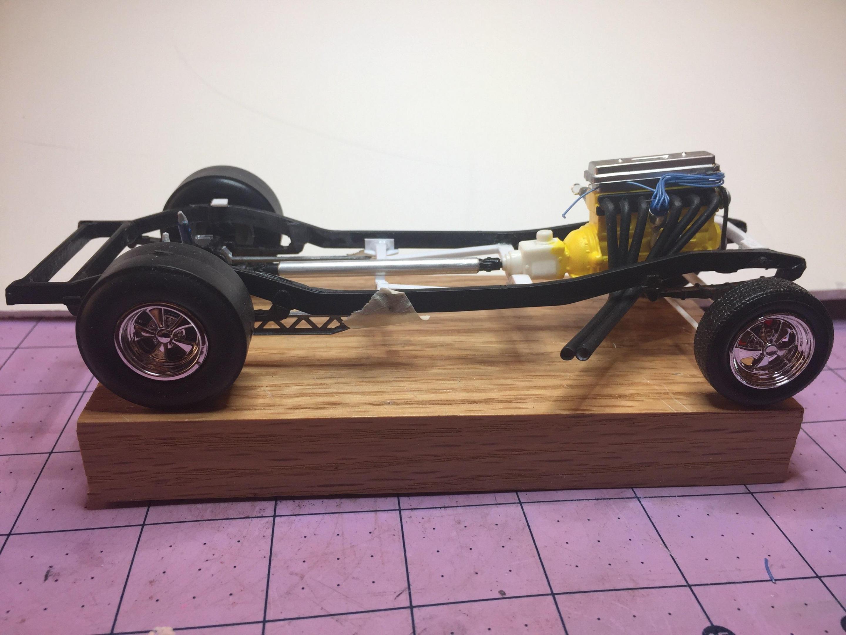

customline Posted January 11, 2022 Author Posted January 11, 2022 A bit of progress. Engine mostly assembled, ladder bars painted with attached shocks, slicks sanded, a little more bondo work done, flip nose work progressing. I'll explain the nose work...sheet stock added to both sides of fender mating area- the body side is flush; this will more or less make up for the ker. Magnets will be hidden behind the .020 material. On the nose side the .030 sheet is recessed enough to accommodate the magnets that will be set there. The nose will be held closed by the magnets. When the hinge is finally set, the nose will be positioned closed. The hidden magnets will be located and glued according to the positioning of the nose magnets that are glued beforehand. Don't worry, I've done this before ?...
customline Posted January 13, 2022 Author Posted January 13, 2022 Mini-update: flip-nose progress. Glued hood to fenders and taped assembly in place. Fabbed hinge from aluminum tube and brass wire and glued nose side in place. Added heavy members to eventually support nose. Glued magnets on nose side of fender and aligned for body side magnets which were allowed to mate themselves in glue (that's as clear as I can make it ?) That's it for now . ? Note: pictures are not in the order they were originally inserted for whatever reason ?lop 1
espo Posted January 15, 2022 Posted January 15, 2022 Great looking fab work on the frontend. I think the inline 6 looks great as well.
customline Posted January 19, 2022 Author Posted January 19, 2022 (edited) On 1/15/2022 at 11:34 AM, espo said: Great looking fab work on the frontend. I think the inline 6 looks great as well. Thanks, David, I did a little more today. Scratched a steering box and such, got primer on body work. Got to get a complete chassis up on rubber so I can further the flip nose hinge placement and then paint it. Much to do....lots of refining . By the way, that steering box is not Legos. Edited January 19, 2022 by customline 1

customline Posted January 20, 2022 Author Posted January 20, 2022 Today's work involved some body work on the nose and RF fender and fastening the nose hinge to the frame. Not much but better than nothing

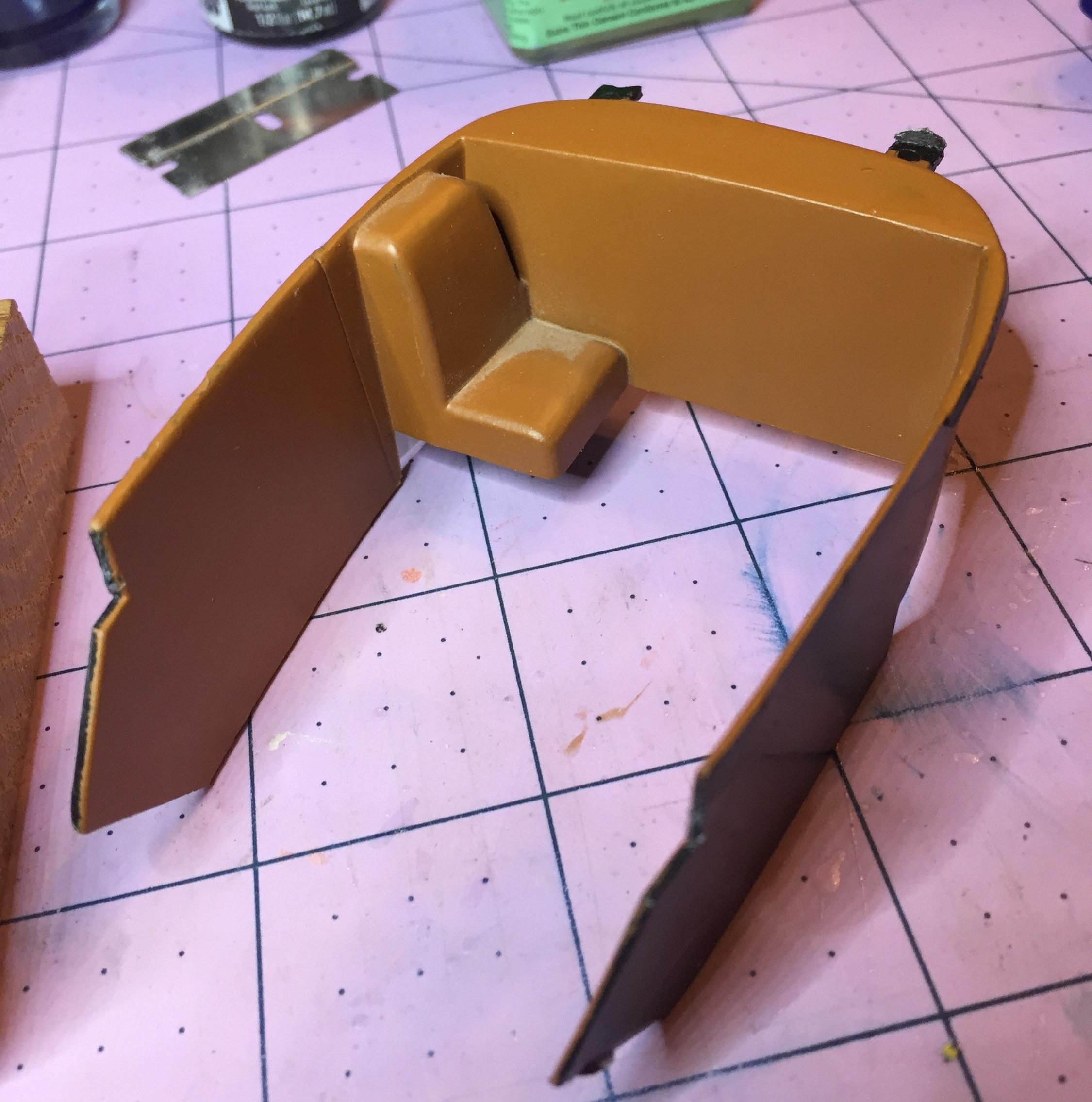

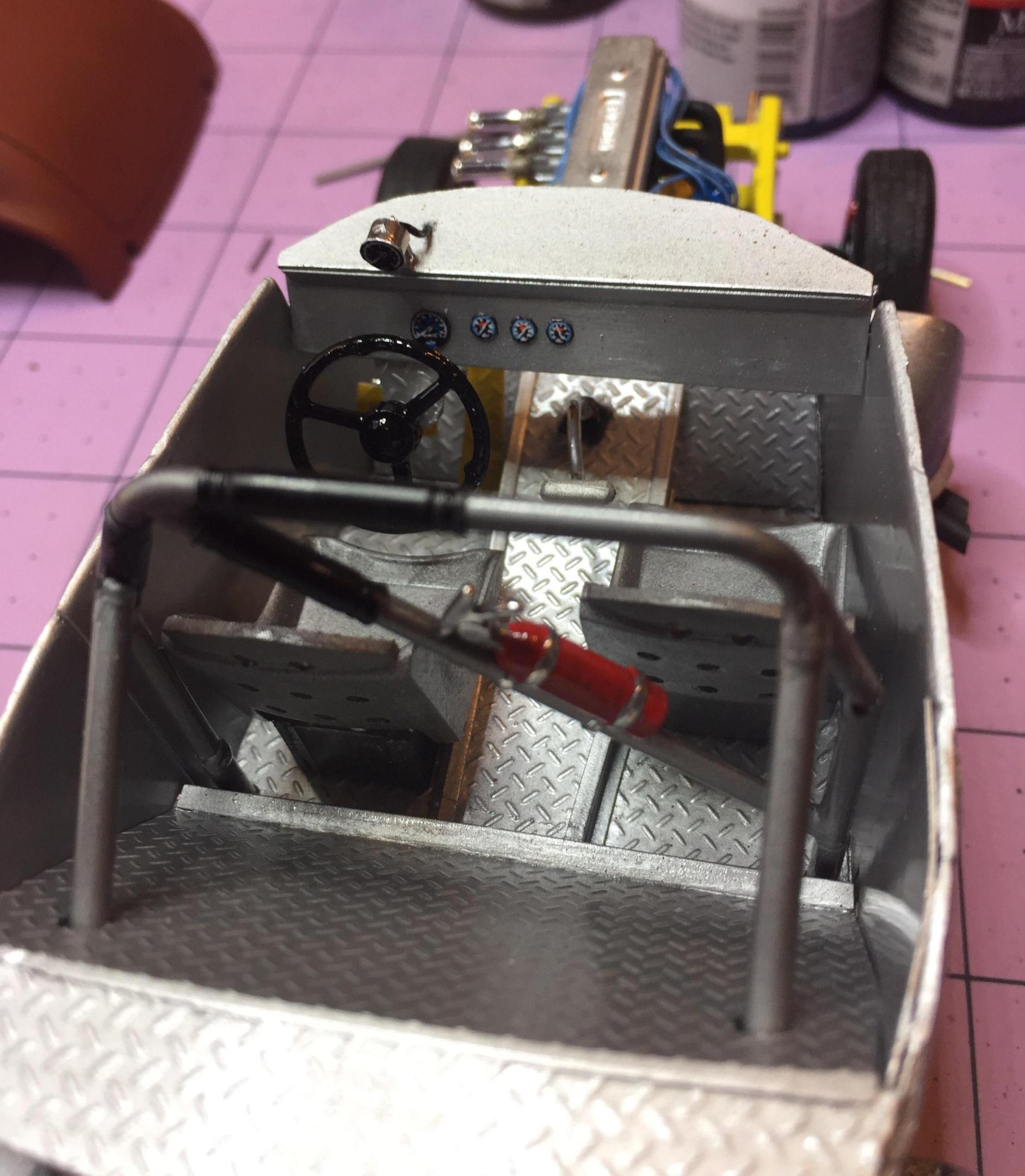

customline Posted February 19, 2022 Author Posted February 19, 2022 Update: Thanks to lobo2me (Steve) for putting me on to Plastruct diamond plate, HO scale, sheet styrene. It's perfect for this application. I think it adds another dimension of realism and detail. I love it!. All I have for this update is the interior construction. The original "tub" had a jump seat molded in and that had to be removed and replaced with sheet stock. Then I went crazy with my new favorite scratch-building material. Sprayed it with rare and precious Model Master Aluminum Plate (buffing) Metalizer. I don't know what I'll do when I run out of it. ?. I installed the bomber seats that I borrowed from my new '30 coupe kit and added the modified roll bar from a Revell '68 Dart kit. The rest is just fabbed up stuff, nothing fancy. The dash still needs some details and then I have more body work to do. Thanks for looking ?! 1
TransAmMike Posted February 19, 2022 Posted February 19, 2022 Lotta great work there Jim. Seeing that hot rod Chevy Stovebolt gives me an idea for an old '53 Corvette kit I have laying around tha tI've been wanting to de as a gasser. Now I just need the engine. Cool build?
Dave72 Posted February 19, 2022 Posted February 19, 2022 Very cool looking build Jim! I really like straight six and gasser look! You are a talented fella! Fab work looks great! Nice job so far.

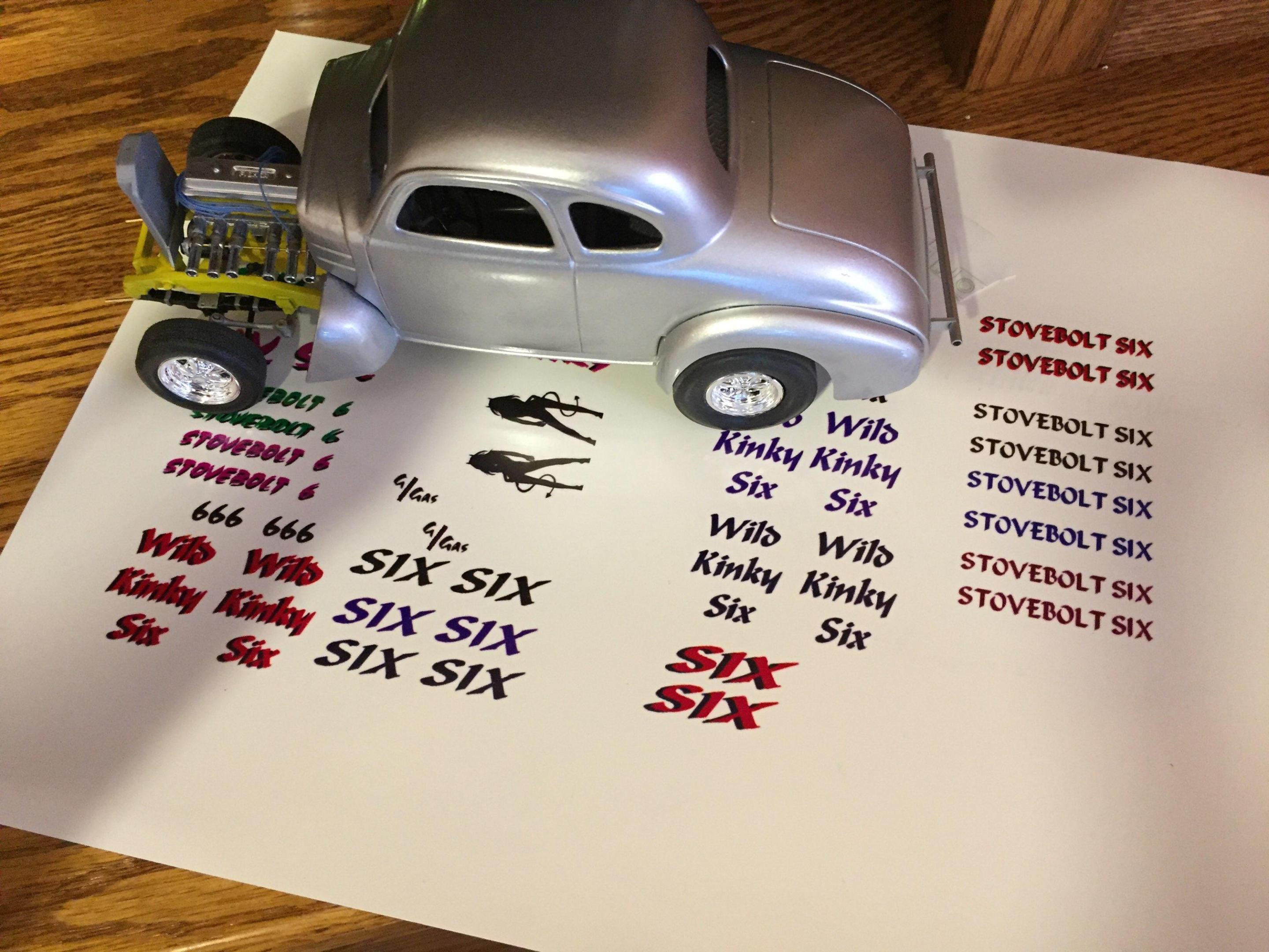

customline Posted March 16, 2022 Author Posted March 16, 2022 Nope. 86 the 'Vette tail light. Not gonna work. It was a great idea but I couldn't make it look right. Bummer. It's getting either '41 Plymouth units or some other nondescript things I picked out of my chrome junk. It's gonna work, though, trust me...? Today I painted the upper shell (for the second time ?) with Duplicolor (see below) and this time I will be covering that with Krylon gloss clear, out of necessity, and again after decal placement. Gotta do it all before the green dust flies because I paint out in nature ?. I'm getting there, but it's not easy these days ?. Thanks for looking. Still some decisions to take.....stand by....
bisc63 Posted March 17, 2022 Posted March 17, 2022 Lookin' good in silver! Almost has a bare metal look. Shame about the tail lights.
customline Posted March 17, 2022 Author Posted March 17, 2022 5 hours ago, bisc63 said: Lookin' good in silver! Almost has a bare metal look. Shame about the tail lights. Thanks, Rusty, I went that way because of the decal situation. The paint was certainly cheap enough! It had to be a light color so I could use clear paper. Even after a second run-through, I worry. In the sun it's pretty glittery and it might help brighten the decal colors.. not sure which ones to use but I gave myself options.
espo Posted March 17, 2022 Posted March 17, 2022 The red lettering should stand out the best against the bright silver color. The body sure looks nice and smooth. One taillight that comes to mind is the '49,'50 Ford from AMT. The part comes chromed, and you would have to paint some clear red is all. They are sort of oblong shaped with a chrome molding and a flat mating surface to the body. I would sand the back side of the housing, so it sits closer to the body. A lot of guys used to run the '49 Pontiac round lights on 1:1's. There are many other possibilities depending on what you have in your parts boxes.
customline Posted March 17, 2022 Author Posted March 17, 2022 2 hours ago, espo said: The red lettering should stand out the best against the bright silver color. The body sure looks nice and smooth. One taillight that comes to mind is the '49,'50 Ford from AMT. The part comes chromed, and you would have to paint some clear red is all. They are sort of oblong shaped with a chrome molding and a flat mating surface to the body. I would sand the back side of the housing, so it sits closer to the body. A lot of guys used to run the '49 Pontiac round lights on 1:1's. There are many other possibilities depending on what you have in your parts boxes. I agree with you on the red lettering, Dave, it's my "gut" choice. I jumped the gun on the chassis color and it's too late to go back and do something else. That yellow engine and frame would, in a perfect world, go better with green. The silver is pretty neutral so purple or magenta or whatever would work with it. But that yellow.....I dunno. ? I really need to plan better. This build was a departure from my usual thought processes and kind of an experiment. You all have helped with it and it was a way to get out of my rut. But the yellow was all me. ? I don't know what I was thinking (maybe it was the booze ?) my glass is covered no matter what I decide. I have all the colors of the rainbow in acetate (a gasser gotta have colored glass!)
espo Posted March 18, 2022 Posted March 18, 2022 16 hours ago, customline said: I agree with you on the red lettering, Dave, it's my "gut" choice. I jumped the gun on the chassis color and it's too late to go back and do something else. That yellow engine and frame would, in a perfect world, go better with green. The silver is pretty neutral so purple or magenta or whatever would work with it. But that yellow.....I dunno. ? I really need to plan better. This build was a departure from my usual thought processes and kind of an experiment. You all have helped with it and it was a way to get out of my rut. But the yellow was all me. ? I don't know what I was thinking (maybe it was the booze ?) my glass is covered no matter what I decide. I have all the colors of the rainbow in acetate (a gasser gotta have colored glass!) I wouldn't beat your self up over the yellow frame. While I might not have done that thinking in advance, looking at the frame and the engine colors together I kind of like the contrast between the body color and the chassis. I think if you get to many colors going on it becomes jarring to the eye. The more I look at this it really looks planed and goes together well.
customline Posted March 18, 2022 Author Posted March 18, 2022 2 hours ago, espo said: I wouldn't beat your self up over the yellow frame. While I might not have done that thinking in advance, looking at the frame and the engine colors together I kind of like the contrast between the body color and the chassis. I think if you get to many colors going on it becomes jarring to the eye. The more I look at this it really looks planed and goes together well. Well, thanks for talking me off the ledge, Dave. ? There was a time when the body would be painted yellow as well as the rest. I had a bad experience with my home-made decals and it gave me second thoughts about yellow messing with decals printed on clear paper. White or silver or a very light gold shouldn't be a problem. The can of Tamiya white pearl I currently posess (and was saving for a special build) might have made it to this project had I not started the '66 Riv. I've had that can sitting on the shelf for 2+ years and the Riv will get that paint job. So the red- headed step-child got the $2.00 can of Duplicolor I scored from Ollie's a few weeks ago. ?. I tested one of my decals on the silver and there won't be a problem regardless of what color decals I apply. I wish I hadn't used that one though. I only made 1 set of each type . Today the sun is shining and it's 64...gotta go clear the body!
