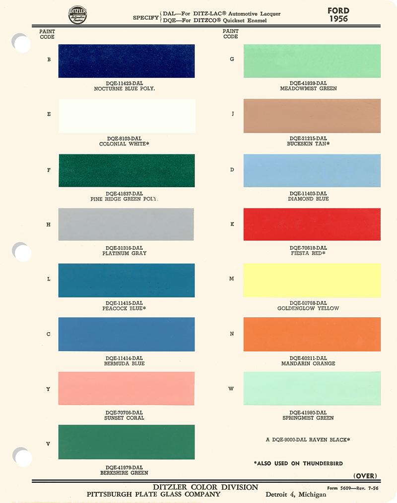

landman Posted January 19, 2022 Posted January 19, 2022 My neighbor across the road asked me if I could build a replica of his friend's car . It is a 56 Ford Crown Vic. I'm planning to use AMT Kit no.6547. However, his friend's car has a continental kit. Where could I source this, short of making one? Also is that color Meadowmist Green? 1
Fat Brian Posted January 19, 2022 Posted January 19, 2022 You've got a few options, in 1/25 scale you've got the AMT/Lindberg 53 Sunliner and the AMT 58 Edsel "ultimate" kit. Then in 1/24 scale there is the upcoming reissue of the Monogram 56 Thunderbird. The closest tire cover to the picture is in the Thunderbird kit but it might look a tad out of scale. 1
SfanGoch Posted January 19, 2022 Posted January 19, 2022 That Crown Vic is painted in Berkshire Green (Code V, Ditzler PPG 41979) and Colonial White (Code E, Ditzler PPG 8103). 1
