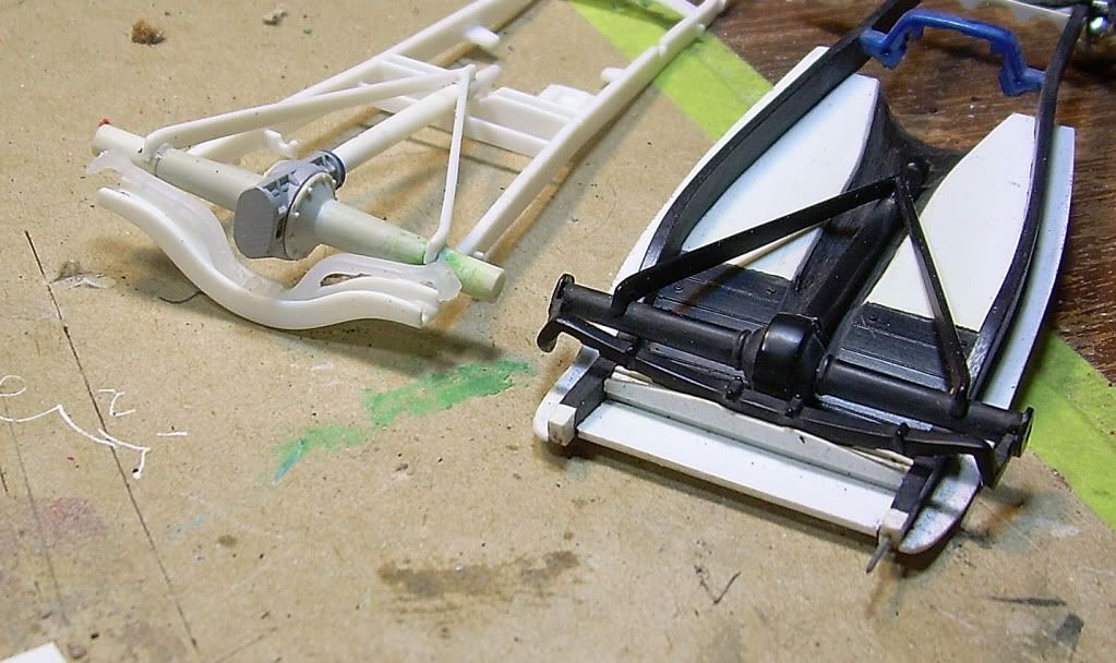

Ace-Garageguy Posted January 26, 2022 Posted January 26, 2022 (edited) 1 hour ago, Bullybeef said: ...much appreciated Bill i'll dredge through my kits and hope i come up a winner. I'm reasonably sure the AMT rear ends...with good one-piece axle bells that still need thinning to look right...can also be found in the double-dragster kit, and the double T kits as well. Photo below shows the referenced nicely detailed AMT unit, LEFT, with the rear face "machined" flat to receive the "change-gear" cover from a Revell assembly, and the axle bell flanges thinned to look more like the real deal. For more on adapting it to chassis it wasn't made for, see page 3 of this thread: Edited January 26, 2022 by Ace-Garageguy
