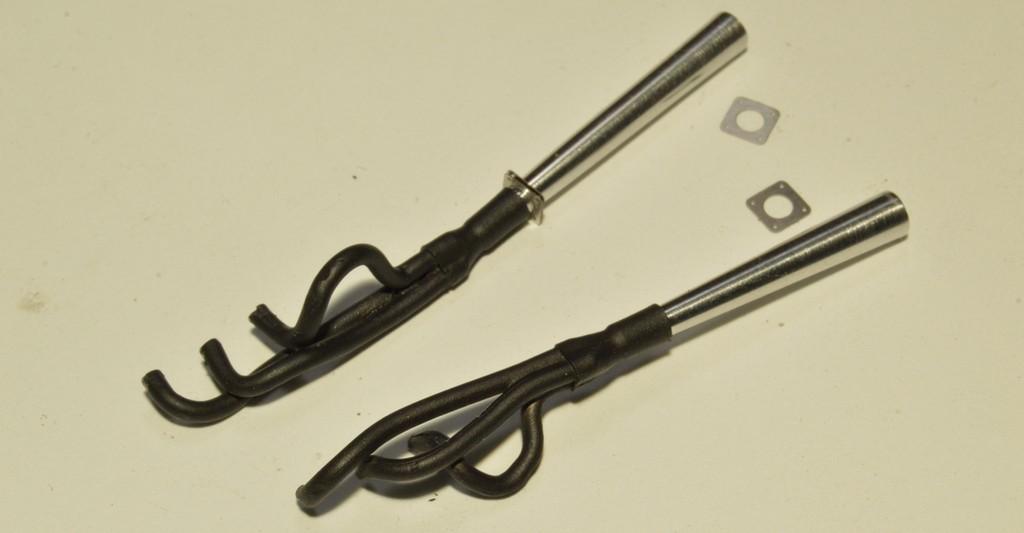

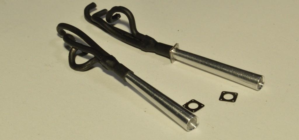

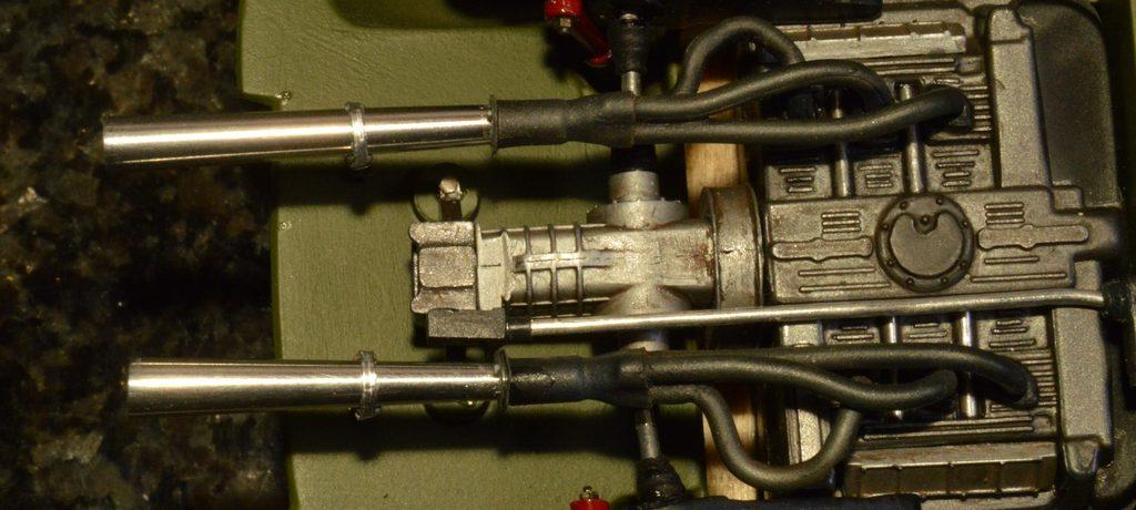

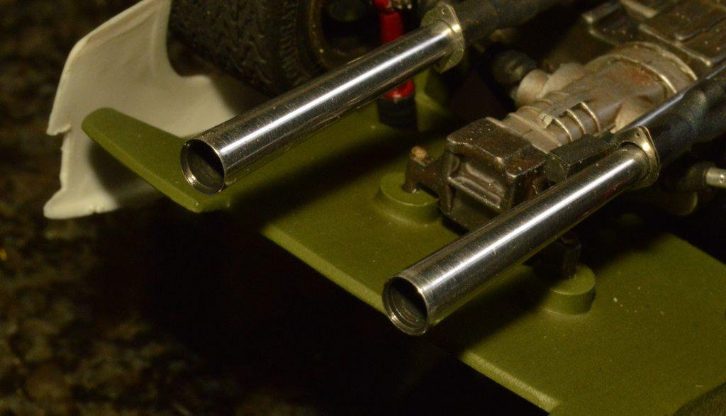

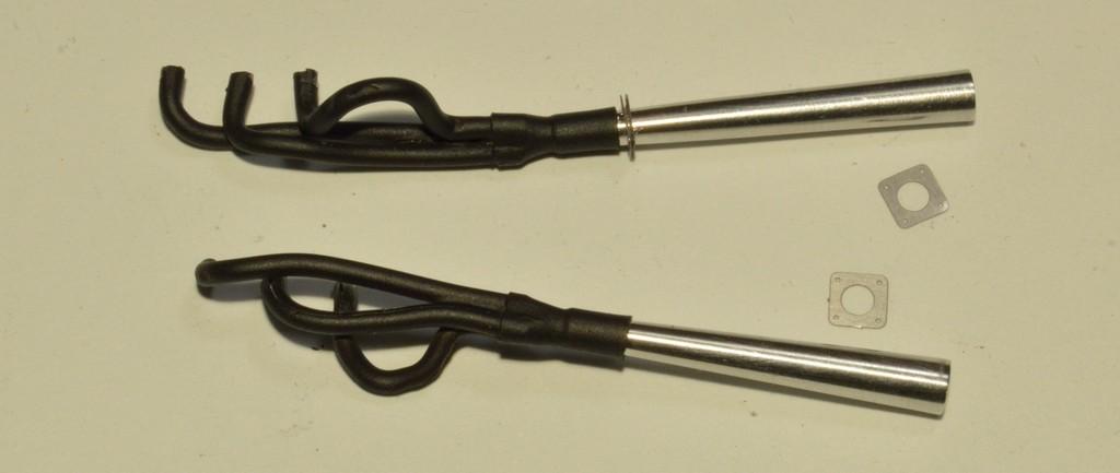

Straightliner59 Posted September 7 Author Posted September 7 I turned the megaphones. I need to start some work on the body, so I can see how I like the length of these. Otherwise, I like 'em! I need to make hangers, and be sure they're adjusted, so that they end up along the same vertical plane, given the offset of the cylinders. I'm going to work a little more weathering, on them. Your comments are always welcomed. Thanks for looking! 7
Mark W Posted September 7 Posted September 7 Nice lathe work. Do you use your compound for the taper or offset the tailstock? Also, did you make the header flanges? 1
Straightliner59 Posted September 7 Author Posted September 7 (edited) 7 minutes ago, Mark W said: Nice lathe work. Do you use your compound for the taper or offset the tailstock? Also, did you make the header flanges? I bought a compound slide for tapers. I have done it, before, rotating the headstock. It's much better, this way. I can use a RH cutting tool, and push it down, turning between centers. The flanges are Detail Master. Thanks, Mark! Edited September 7 by Straightliner59 1

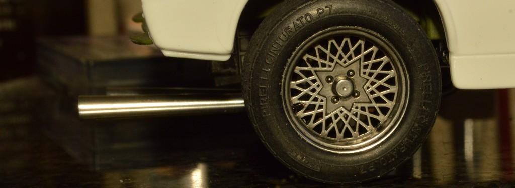

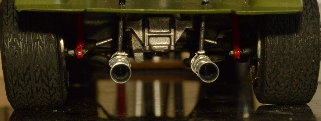

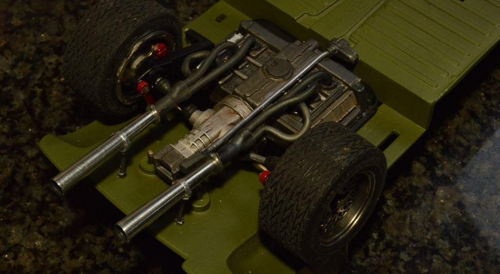

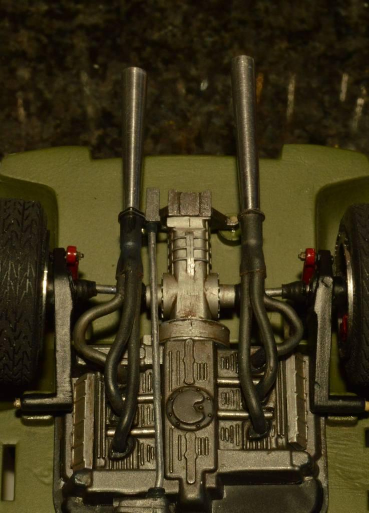

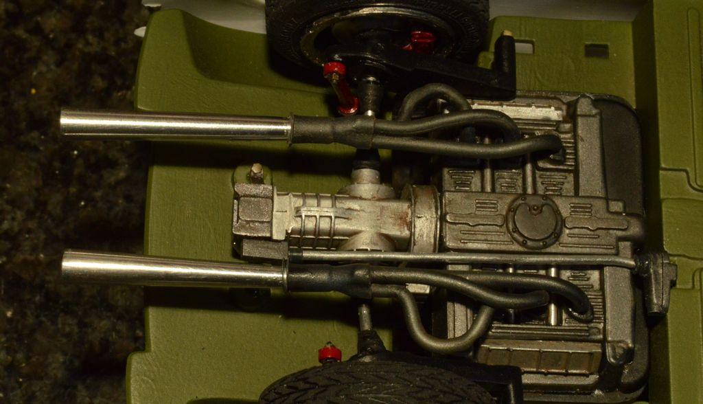

Straightliner59 Posted September 9 Author Posted September 9 They're mounted, and the megaphones are in place. Next task is to make the hangers, which will line them up, nicely! I ended up using Detail Master's square flanges, and sanding two corners off and rounding them to make the flanges, here. I also changed the front tires. I'm not sure what they're from, but they're Centuratos, like the rears. They're a tad shorter. I had to trim material from the inside edge, so that the tire would slip far enough back, onto the wheel. It's not really visible, though, so, good! Thanks for looking! 5

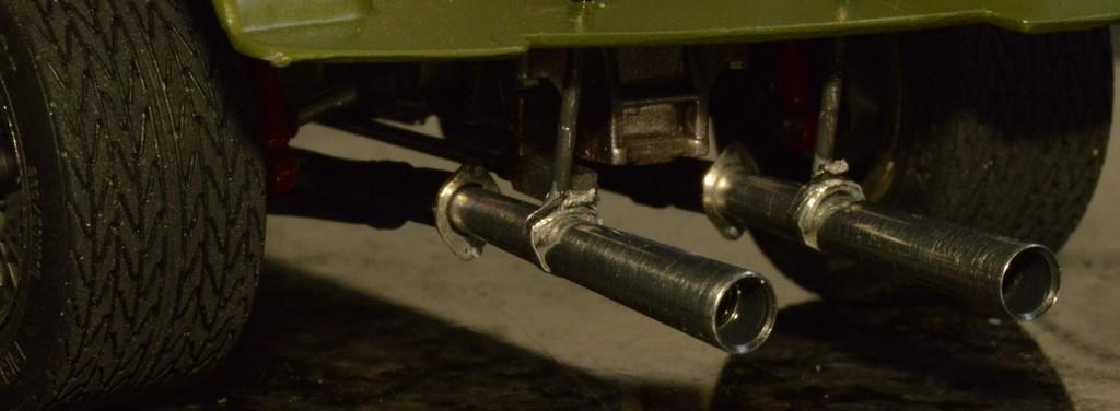

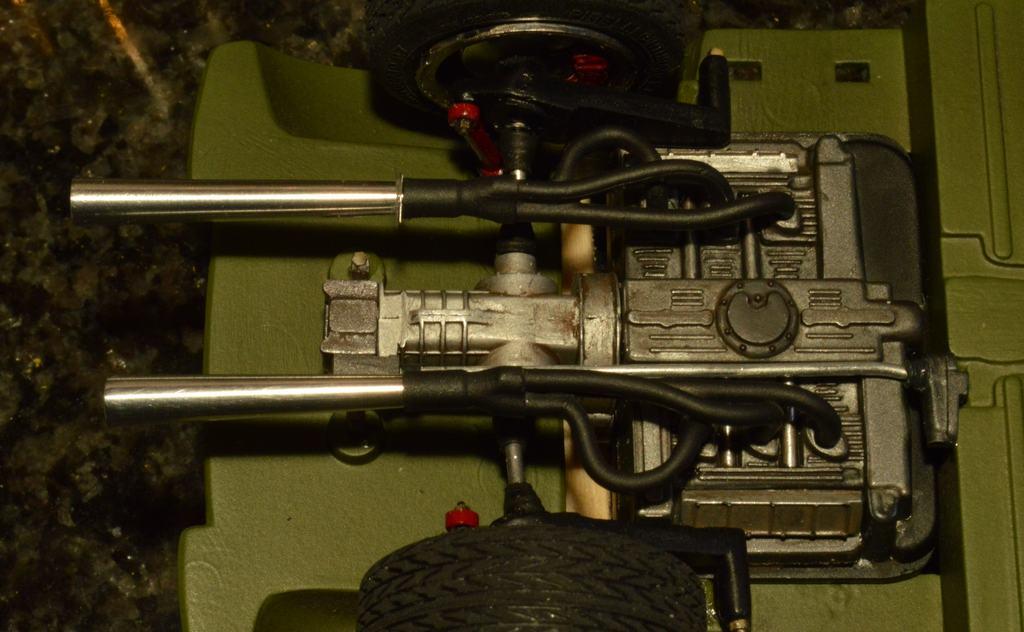

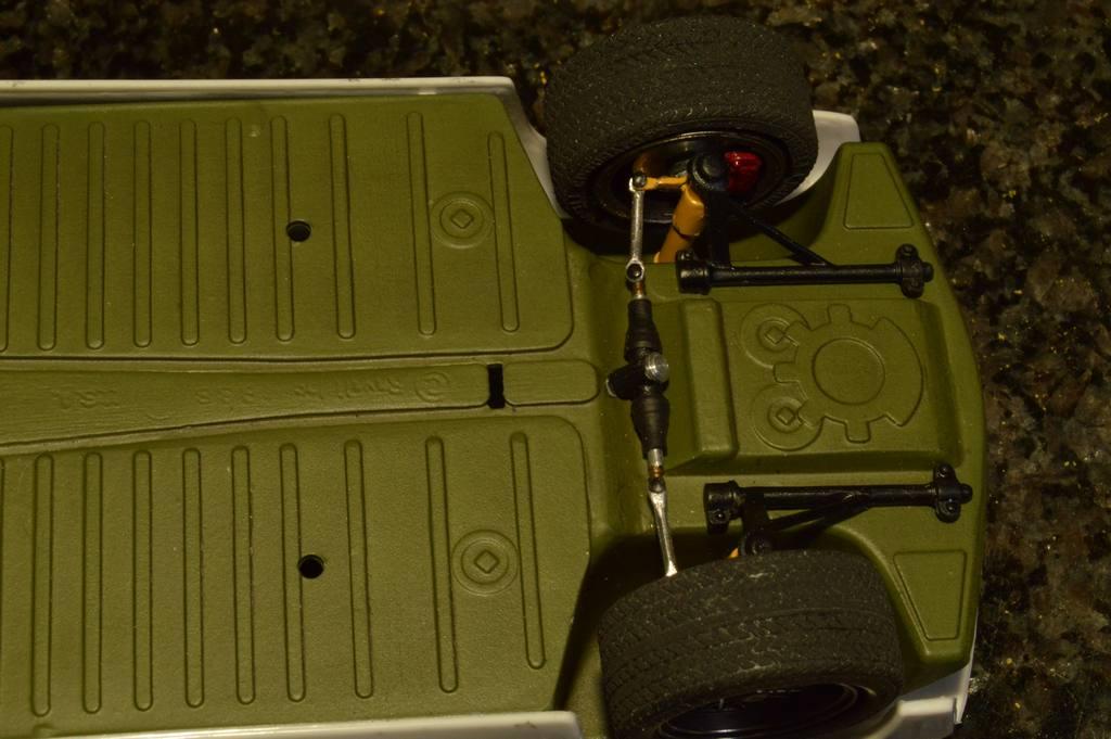

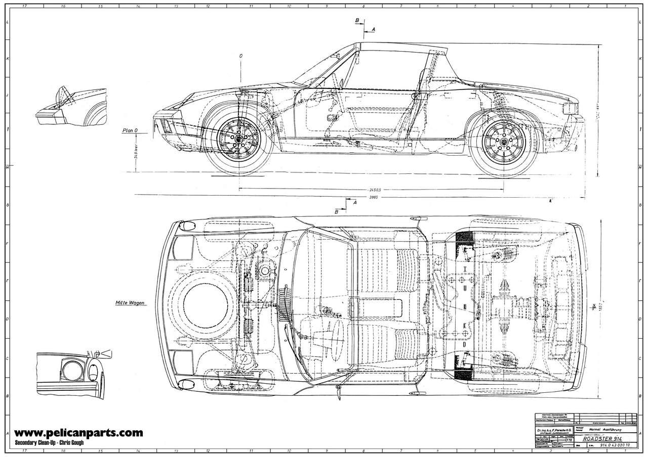

Straightliner59 Posted September 11 Author Posted September 11 I made the hangers, and got the pipes done. I saw a similar setup, using a hose clamp, so I went with that. I fudged the mounting, a bit, because to mount them to the rear of the tranaxle case still seemed too far forward--especially for the model, so I went through the pan. I'll have to figure out something for the topside, but, it shouldn't be too difficult. I've been comparing the body to the drawing, below. It lines up, nicely, once the sail panels are fixed. The only other real glitch, is that the fender openings should be slightly more squared, but, they don't detract too awful much--for me! Otherwise, lining up any section of the model with the drawing (to avoid parallax distortion), it's pretty dadgum close. I'll be working on the carbs, next. Your comments are always welcomed. Thanks for looking! 1

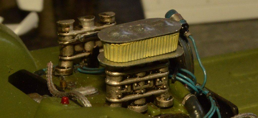

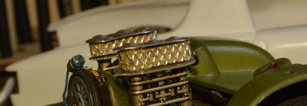

Straightliner59 Posted September 17 Author Posted September 17 I got the carbs finished, except for getting the fuel inlet nipples trimmed down, to slip a bit of hex and "hose" over them, without them being so long, as they are, in these photos. That said, the carbs aren't glued in place yet, either. I added tabs to mount the throttle cross-link, because, I can't ignore something that huge! It's a prominent feature, so it needs to be there. I finished the carbs by shooting them with Krylon Nickel, then washing them with a mixture of Vallejo Oiled Earth wash, mixed with a little sepia tone India ink. The main fuel line is sinking-core braided, 18 lb. test trolling line (it's in such wide use on the internet, that they can barely up with production!). The carb fuel lines are 1mm aluminum and .3mm brass tube. While I can make the rest of the components, assembly will not be completed until the firewall is painted and installed. Comments are always welcomed. Thanks for looking! 4

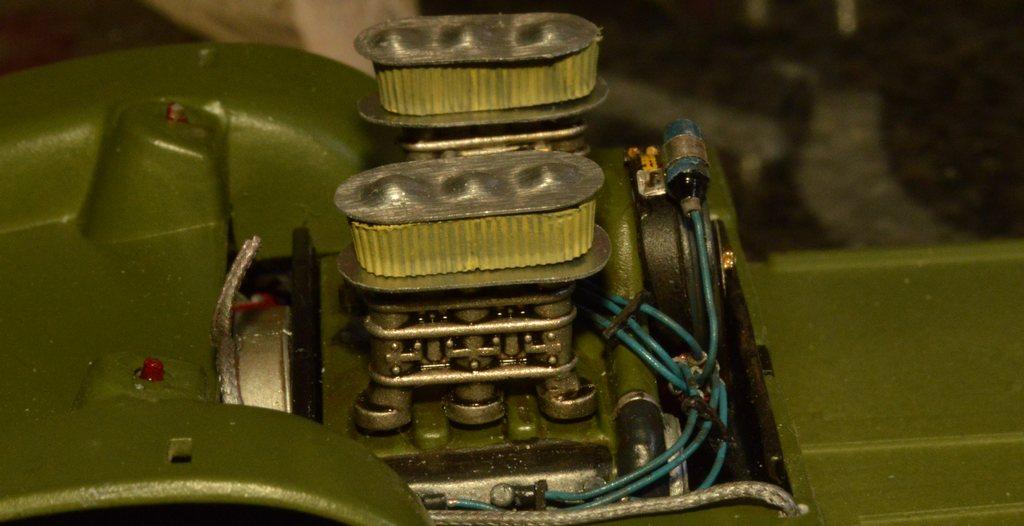

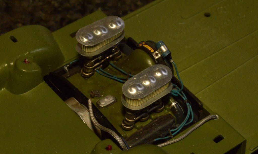

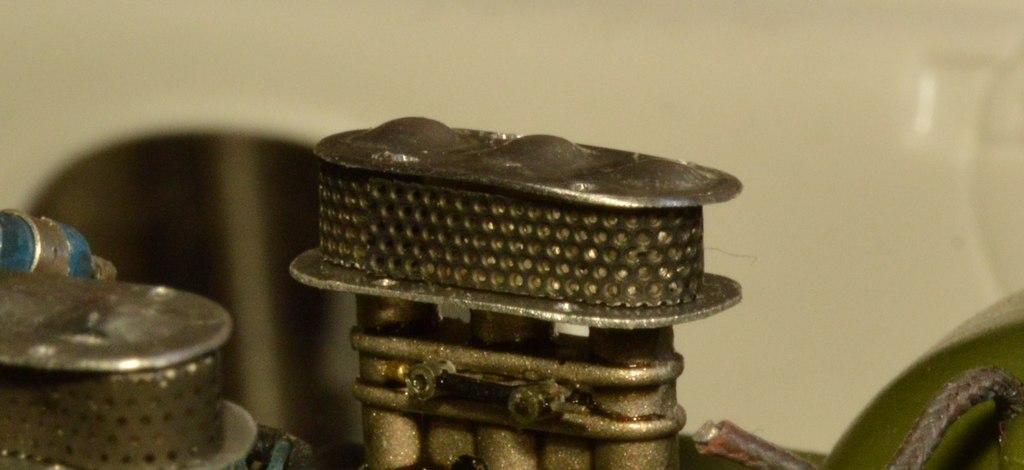

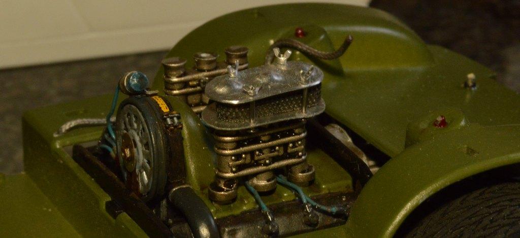

Straightliner59 Posted September 21 Author Posted September 21 I have been working on some air filtration for the Webers. I used aluminum flashing for the top and bottom plates. The filters, themselves, were cut, and spliced-together from some "modern" Monogram sprint car kits. I am debating about whether I am going to add screen, to them. I kinda like the pale yellow "paper". The domes are for appearance, only--to generate visual interest. I will add some hold-downs for the tops, and some dry-brush, and wash to the filters (probably not in that order), to punch them up, a tad. So...still some work to do there, but it's coming along! Thanks for looking! 2

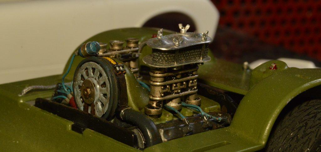

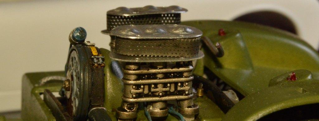

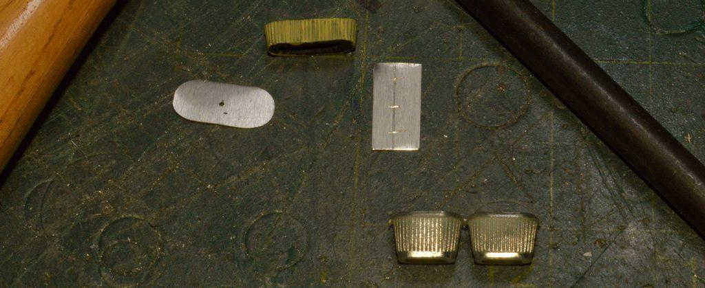

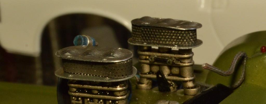

Straightliner59 Posted Tuesday at 07:31 AM Author Posted Tuesday at 07:31 AM Third time's the charm, it's been said. In this case, anyway, it's true! After scrapping the first attempt at air cleaners, I made a second set using strips of an old, foam dryer sheet. I made a "cage" for the foam element from expanded mesh from a grease splatter screen. I didn't like the looks of that, either. Finally, I made a form for the metal surrounds using Evergreen 1/8" tubing and some strip stock. Next, I formed the "cage" around the buck. Currently, the elements are fabric that is kind of "ribby". I am experimenting with foam, as well, but, I'm not sure it makes a ton of difference, given that whatever ends up, in there, won't be readily visible. The next couple of things I'll be working on will be the throttle cross-shaft, and linkages, and the hold-downs for the air filters. I think I like the way these look! Comments are always welcomed. Thanks for looking!

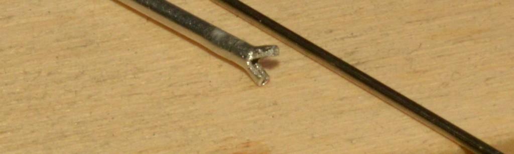

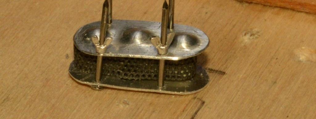

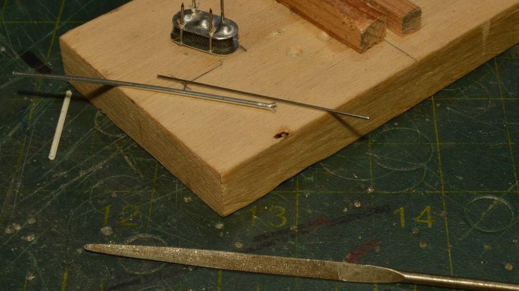

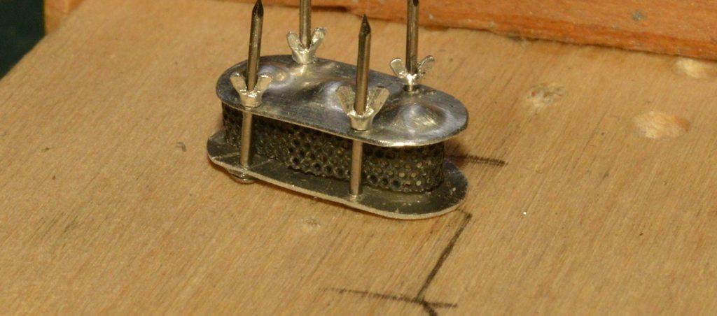

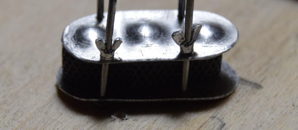

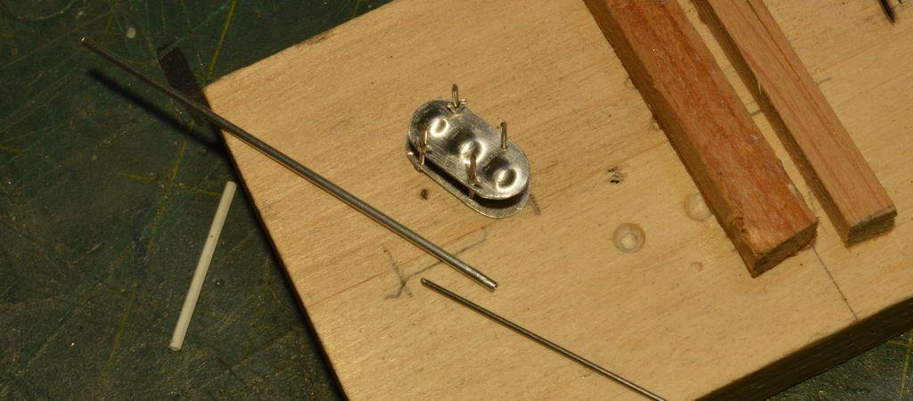

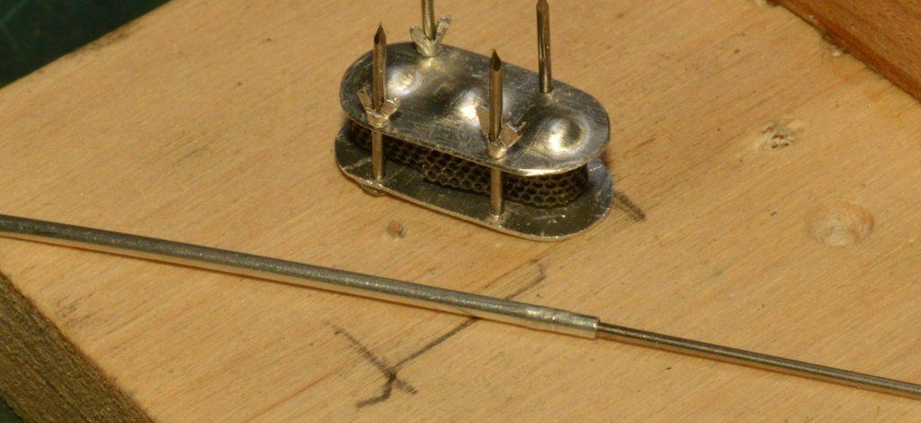

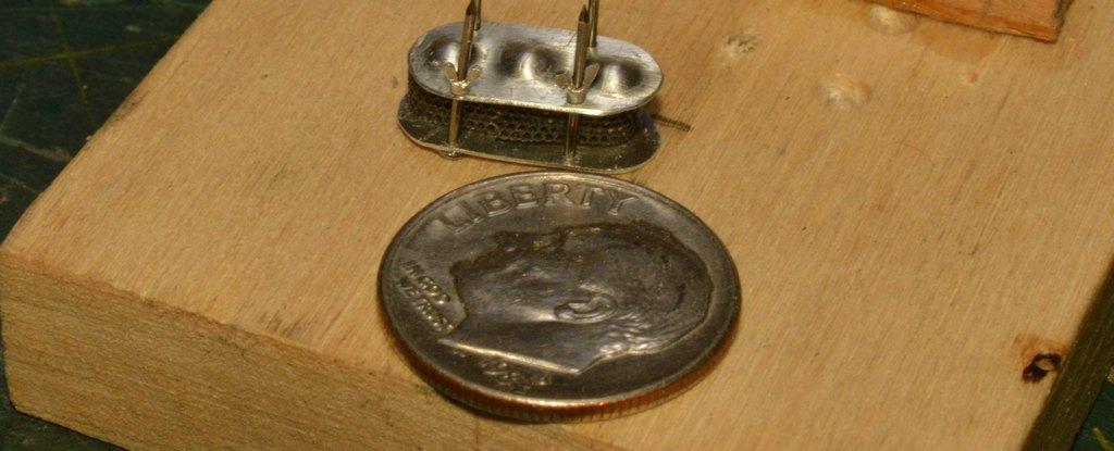

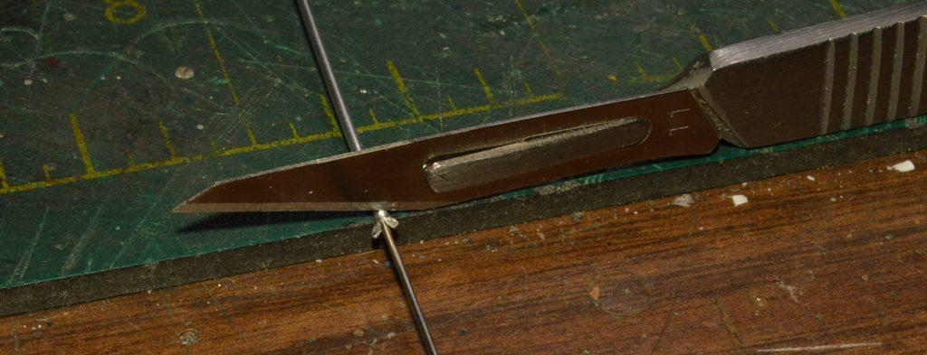

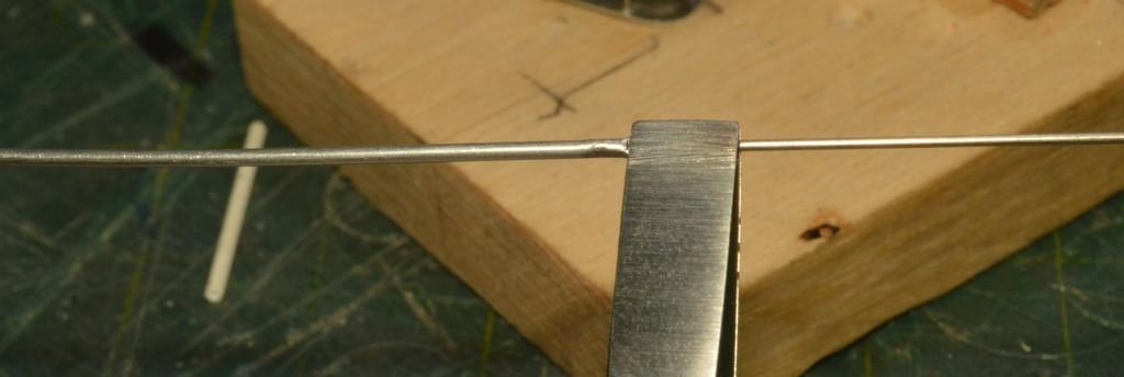

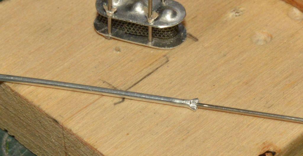

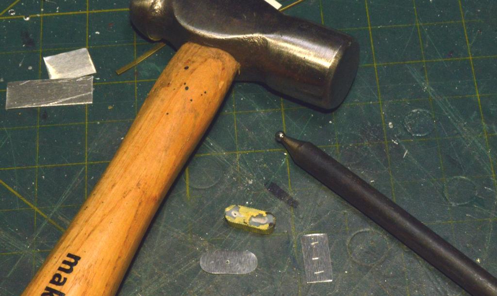

Straightliner59 Posted Thursday at 11:22 AM Author Posted Thursday at 11:22 AM (edited) For a long time, I've wished I could make wing nuts. I've seen some aftermarket ones, but never really had an opportunity to buy any. Recently, somebody on this forum posted a link to the "easy Modeler's Room" YouTube channel. In one of his projects, he showed how he made wing nuts. I was pretty excited! I watched it again, and gave it a go, using some 1mm aluminum tube. I first bored it to accept the .024" music wire I would be using to make the wing nuts (my "bolts" are tiny brads, and are .023", in diameter). Next, I inserted the music wire into the tube, and crimped it. I flipped it, and crimped it, again. I then removed the music wire, and used a smaller than mini half-round file--it was small, and had the sharpest edge of any of my files. I used that to clean the middle from the now-crimped tube, forming the "wings". Next, I drilled the tube open, againg, re-inserted the music wire, and removed the nut from the tubing, using a scalpel. I like the scalpel, in this application, because the steel feels harder, and sharper, and, I feel, creates a cleaner cut. Finally, I cut the bolts to length, sanded them smooth, and slipped the nuts over them. I dabbed the nut/bolt interface with superglue. It took a few tries, to find a practical way to go about it. Once the frustration of that prcess worked itself out, I found myself having a lot of fun making these, and, it turned out to be pretty simple, too! In the first photo, the first nut I made was the one on the right. I determined they needed to be smaller, so I went at it again, and come closer. I think they look cool! Thoughts? Thanks for looking! Edited Thursday at 11:25 AM by Straightliner59
