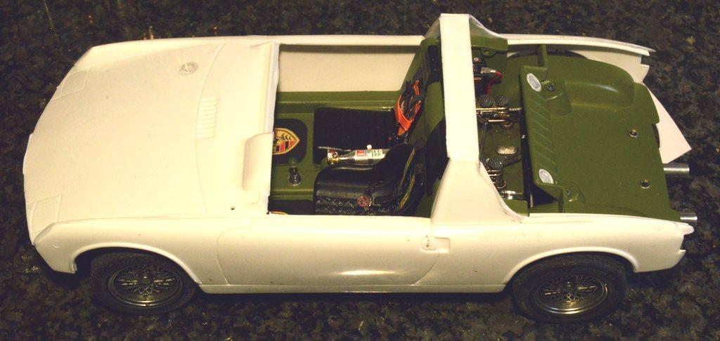

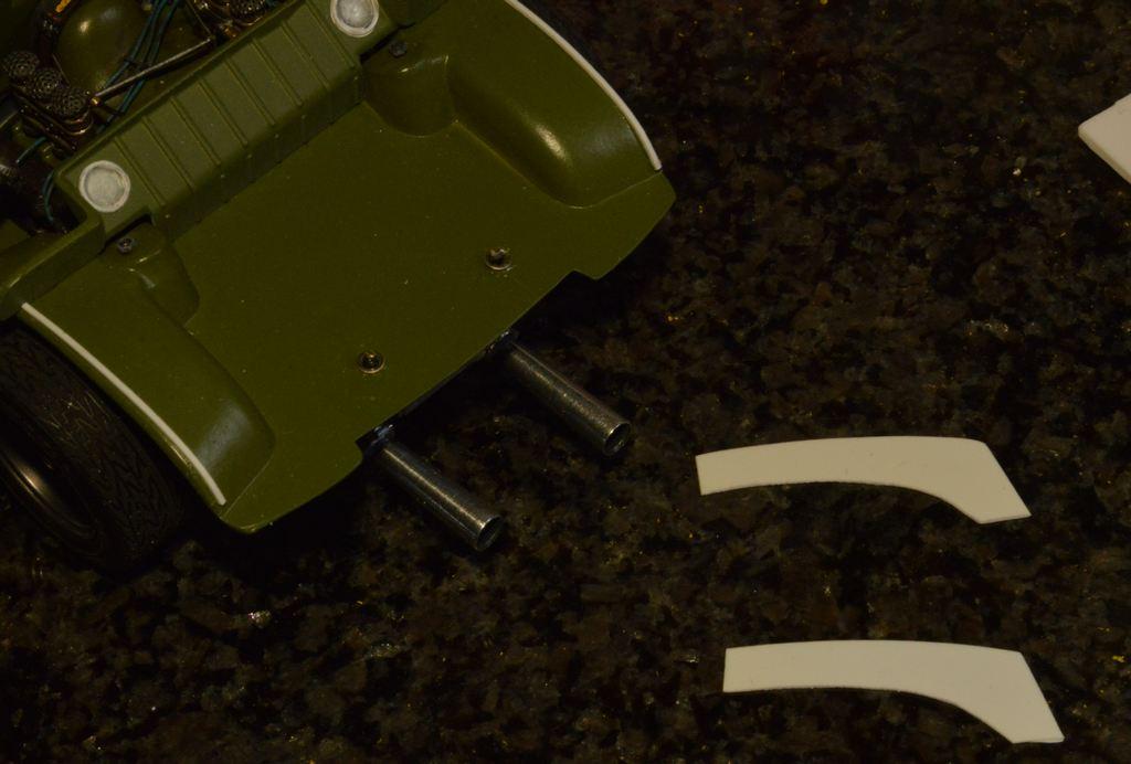

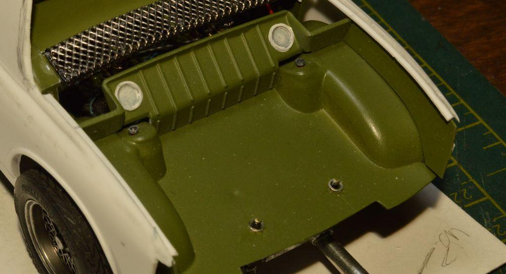

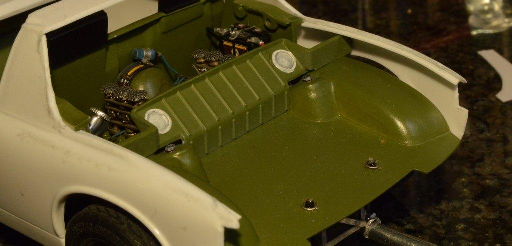

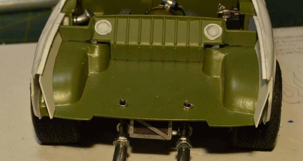

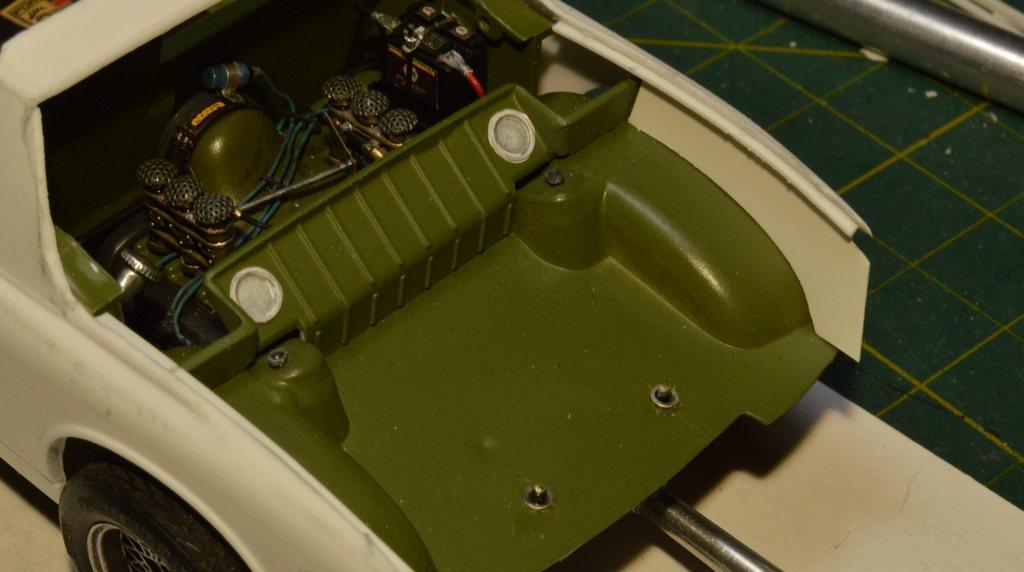

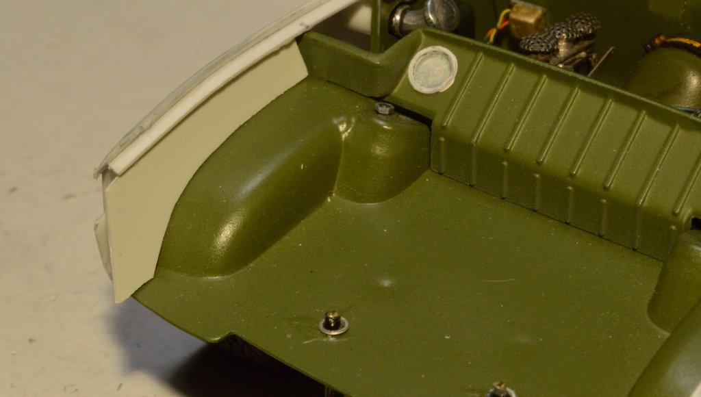

Straightliner59 Posted November 16 Author Posted November 16 Moving to the trunk area, I started cutting on some card stock to begin make a template for the filler panels inside the quarter panels. Once I felt like that was getting close, I set it aside, and glued some rails, for the trunk lid to sit on. Getting that done really seems like it will help this all come together, back here. Having these two panels lift off, rather than hinge will make the engine much more easily seen. Once this immediate area is done, I'll build the same inners, for the engine bay. If you don't hear from me, in the next three weeks, I'll be working on the removal of those ejector marks, on the underside of the cover! Yikes!😂Thanks for looking! 8

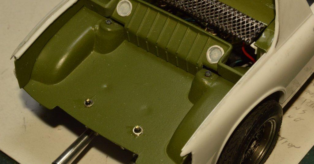

Straightliner59 Posted November 19 Author Posted November 19 On 11/17/2025 at 5:27 PM, SSNJim said: Love your build so far. All the detailing is wonderful. I'm looking forward to seeing the completed project. Thanks, Jim! I appreciate that. I'm getting close, with the inner fender panels. A bit more fine-tuning, and I can paint them. I can't understnd why Revell didn't have them in the kit. Those gaping openings to the tires should have been enough to illustrate their importance.😄Anyway, here's where we're at. Thanks for looking! 3

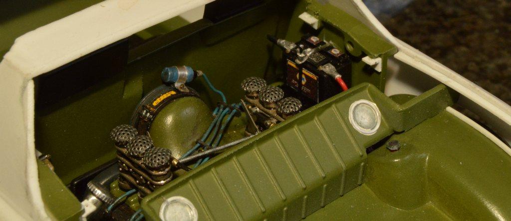

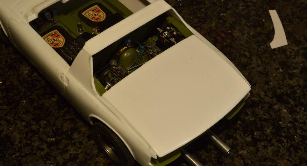

Straightliner59 Posted November 22 Author Posted November 22 I made tabs for the hood pins for the engine cover from .080" Evergreen angle. There's still some work to do on the trunk lid, but, everything looks satisfactory, for now! Now, to figure out how to clean up that mess around the rear "cap". Thanks for looking! 3

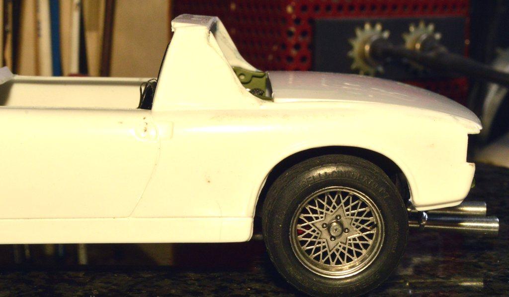

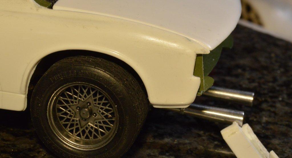

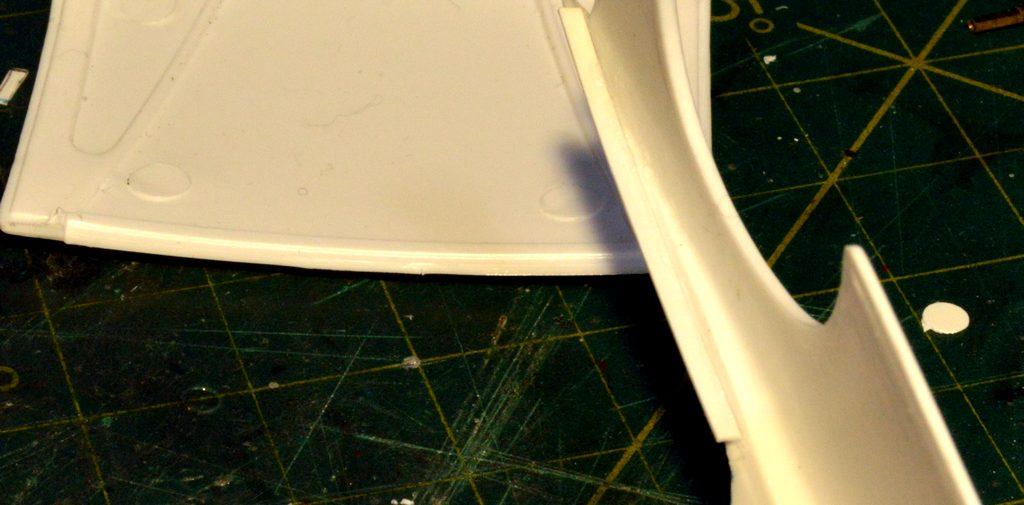

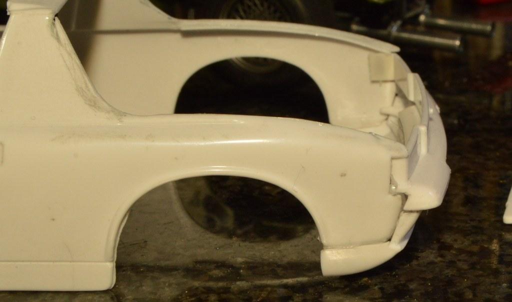

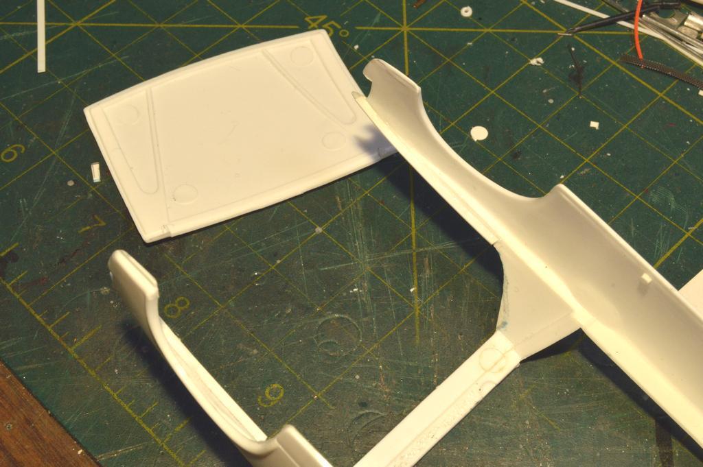

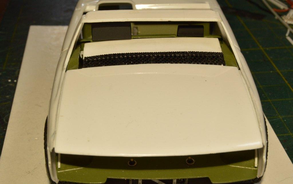

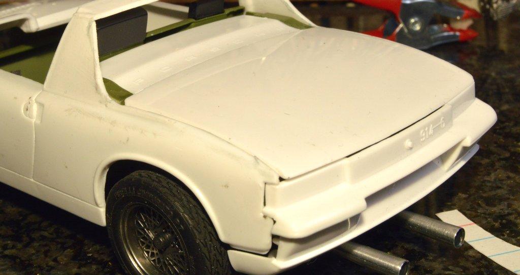

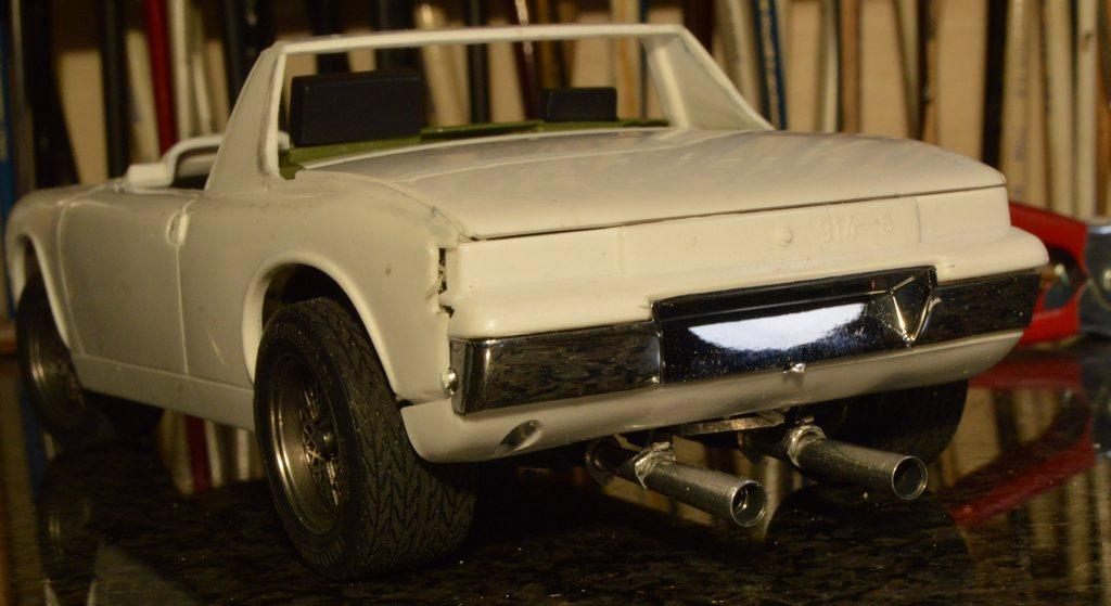

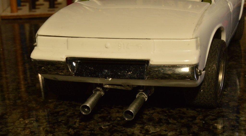

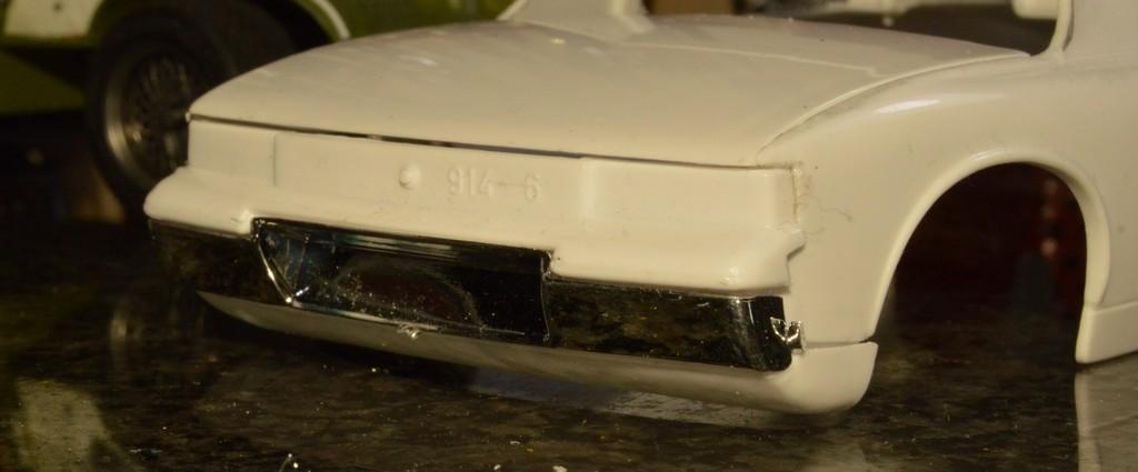

Straightliner59 Posted November 23 Author Posted November 23 I have a pretty decent start on fixing the ill-fitting rear "cap" of the kit. Looking at photos of 914s illustrated that the portion above the bumper is a separate piece. Cutting off the bumper area and roll pan immediately improve the ability to align the two sections with the body, without disturbing how they fit together. The roll pan aligns much better with the quarter panel, as does the taillight section. Now, on to fine-tuning this. Thanks for looking! 4

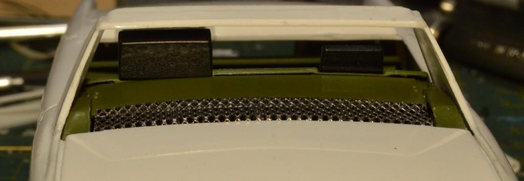

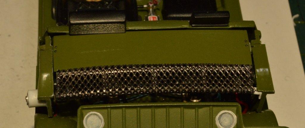

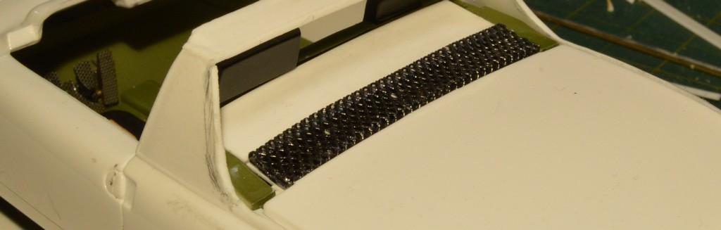

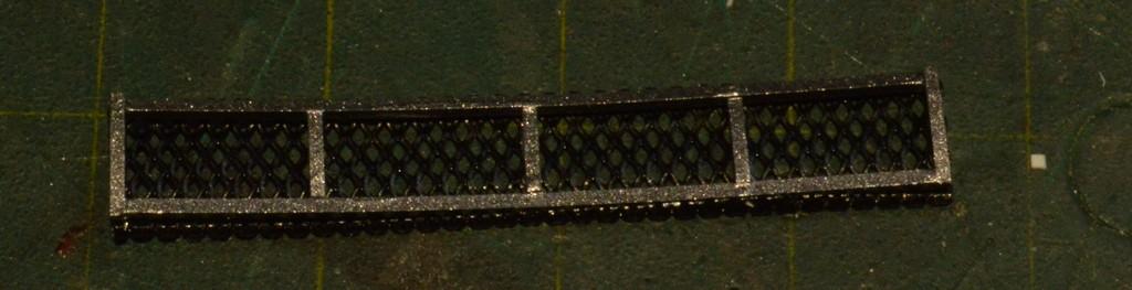

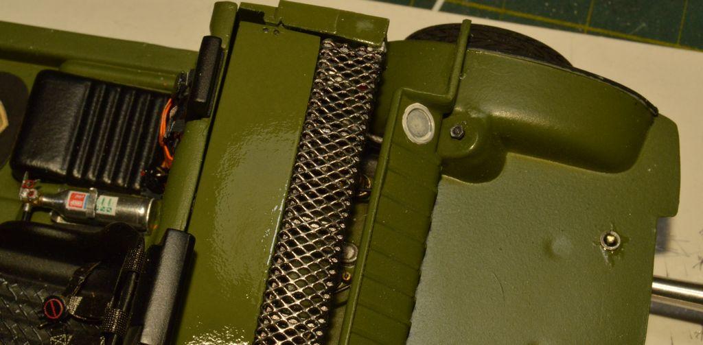

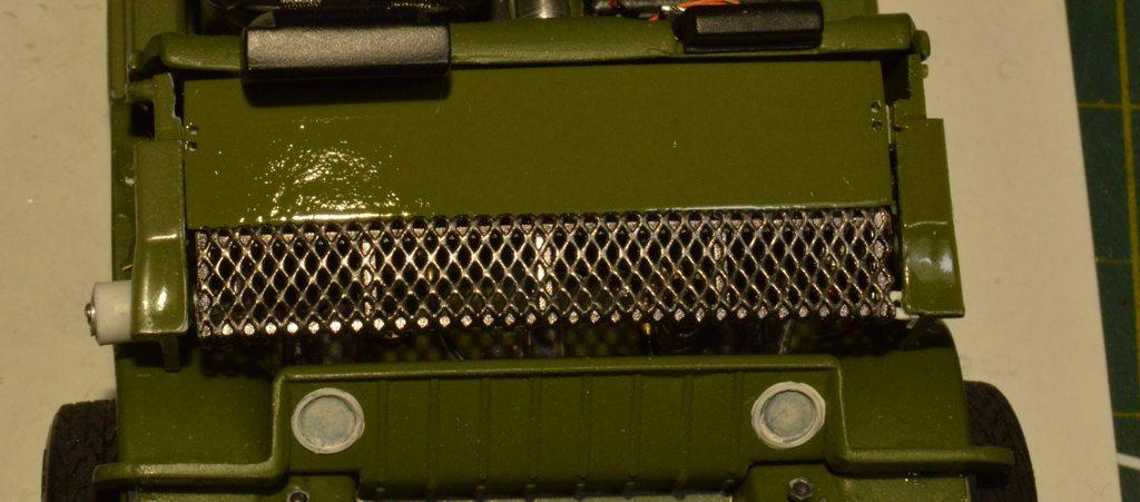

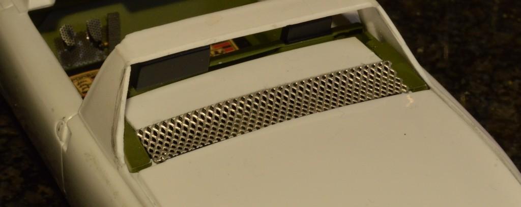

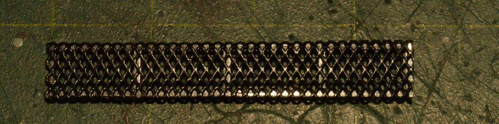

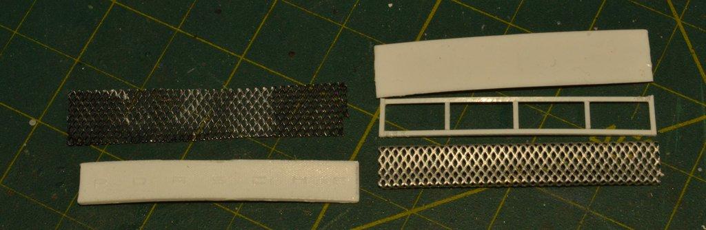

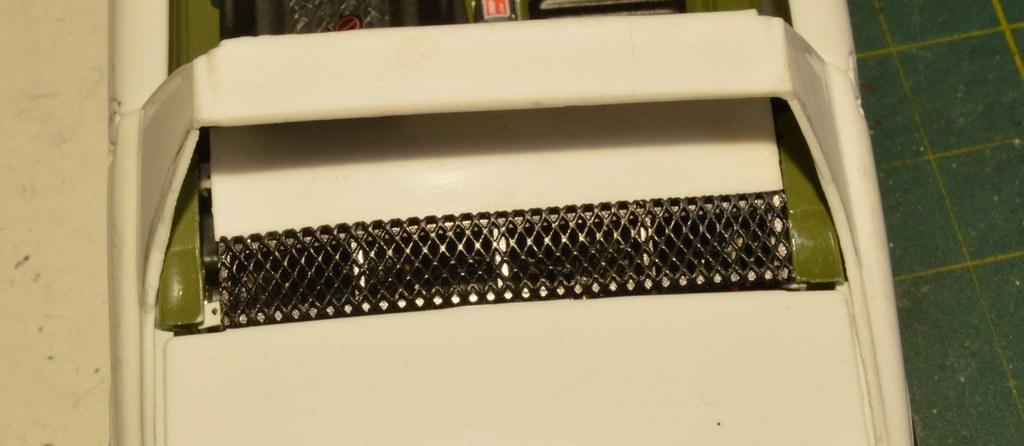

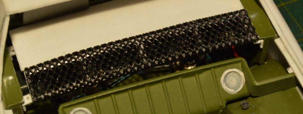

Straightliner59 Posted November 25 Author Posted November 25 I made the rear section of the engine cover from a piece of an aluminum, expanded-mesh splatter screen. I flattened it in the vise to take the vertical bias out of it, leaving a flat, diamond-mesh screen. I built the frame from .030" square stock. The screen is painted with Krylon Semi-Flat Black. The frame is Tamiya Light Gun Metal. Next, I'll be fixing the main section of the cover, widening it to fit better. I'll then need to place the pins, and locate the holes for them in the cover. I really like the way this looks! Thanks for looking! 4

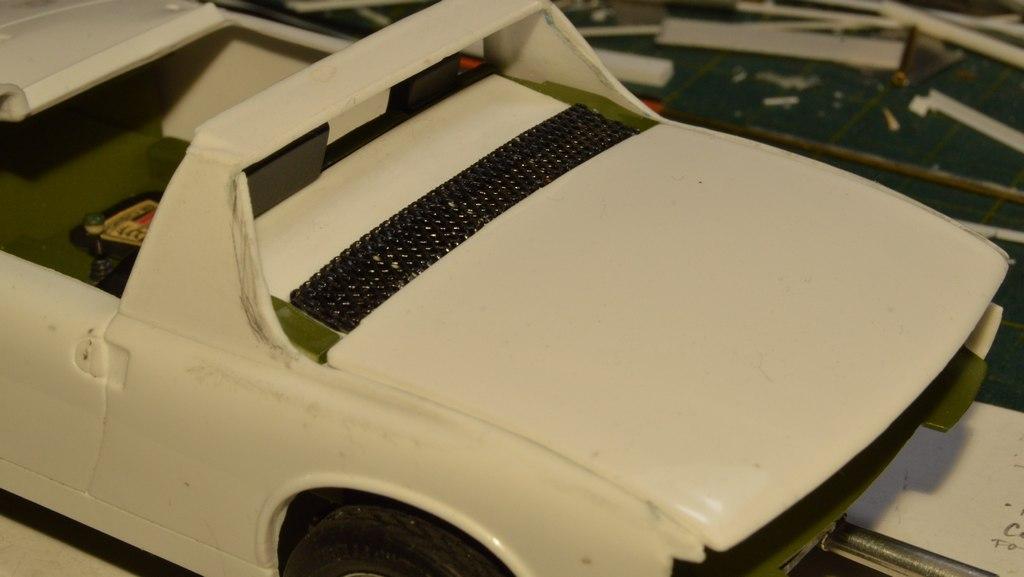

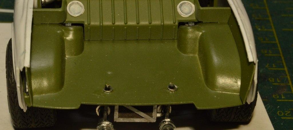

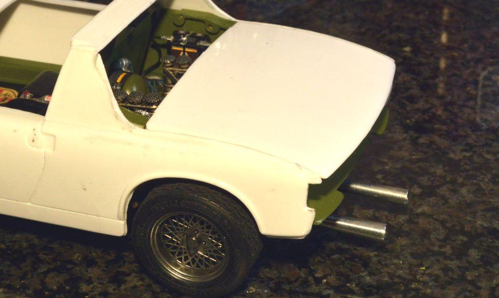

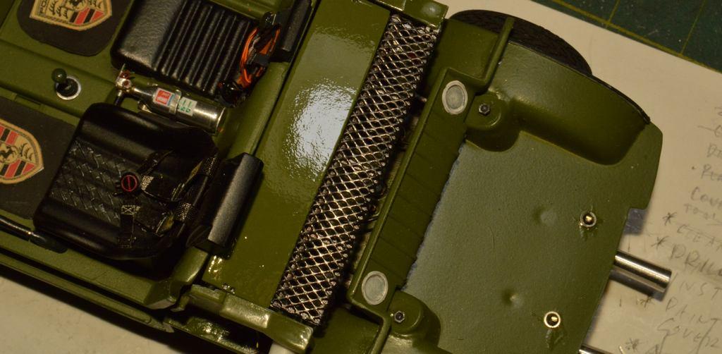

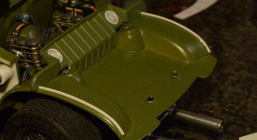

Straightliner59 Posted November 28 Author Posted November 28 I got some paint on the engine cover. I also painted and installed the side panels for the trunk. This feels like a pretty good step! Thanks for looking! 4

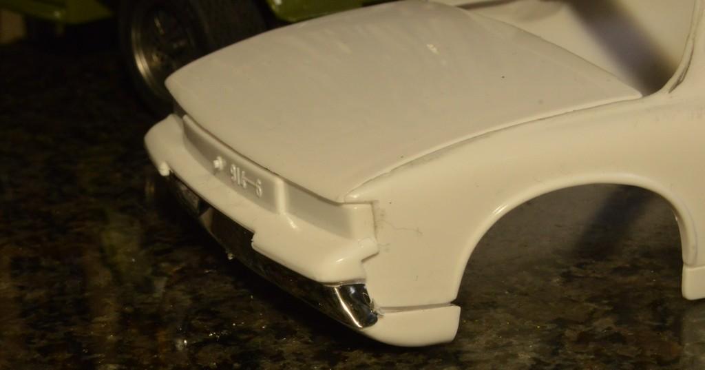

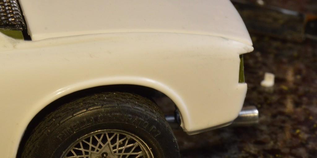

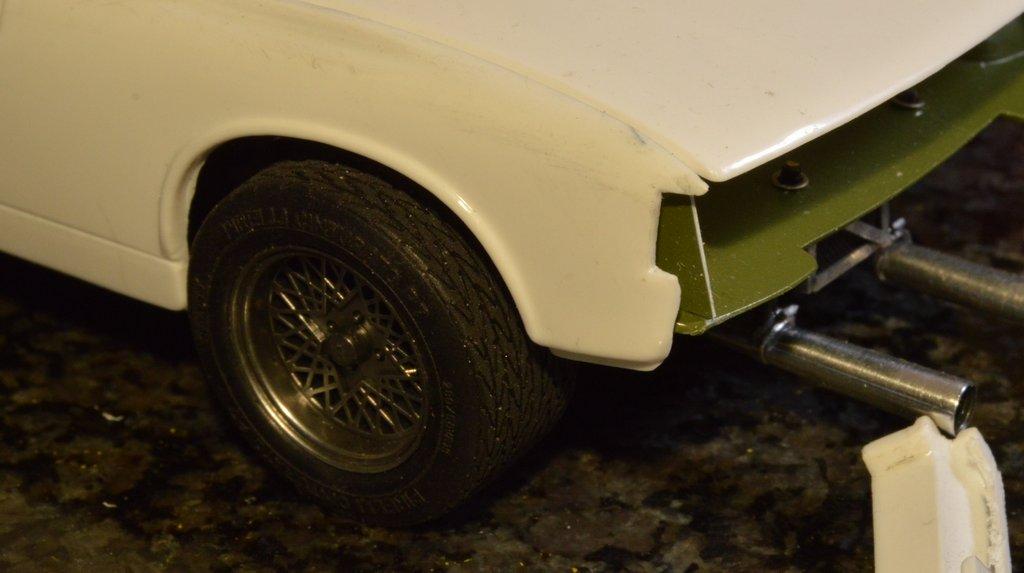

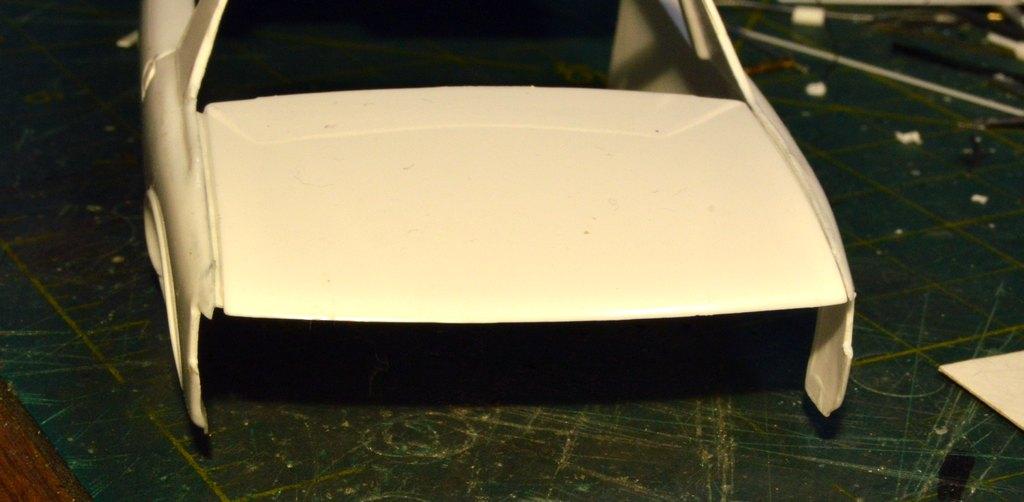

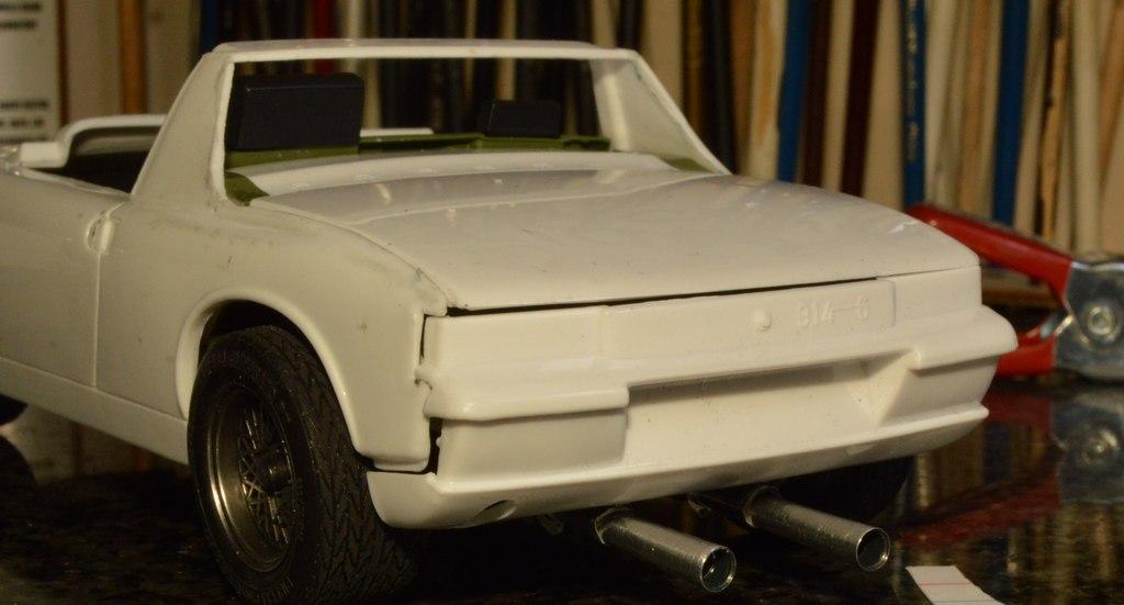

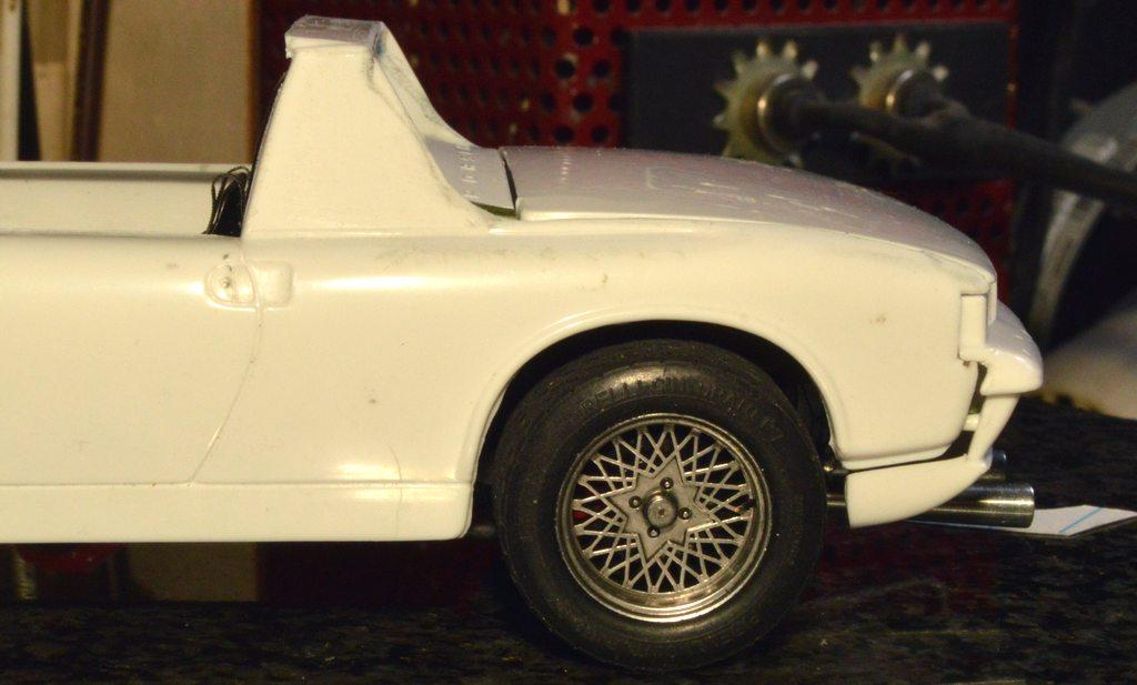

Straightliner59 Posted December 3 Author Posted December 3 On 12/1/2025 at 2:54 PM, Mike Holland said: Looking great, Daniel. I agree fully what others mentioned, combining different materials to reach an inspiring result. Especially in this scale. Respect. Mike.. Thanks, Mike. I appreciate that! Somehow, I'd ground off the point above the taillight, on the left side of the car. I've avoided using sprue goo for filling, because I don't trust it not to shrink, over large areas. However, I decided it would be the perfect medium to repair the damaged point with, as it would more readily become a part of the body than attaching a piece would. I made a fairly heavy batch, and applied it to the damaged area with a toothpick. I let it set for a couple of hours, then dabbed on another bit. It worked like a charm! The high viscosity allowed me to pull the toothpick away and form the point. A bit of light sanding later, and here we are. Thanks for looking! 3
Mike Holland Posted December 4 Posted December 4 Daniel, great fix there. QUESTION; 'sprue gloo', is that a trade name, or your own concoction? I make my own liquid filler. The reducer for styrene is ethyl acetate. Using a small jar, cut a mess of sprue leads, like maybe 1.5" altogether. Pour in just covering the styrene bits, wait 20 minutes, then you have applicable goop. Is quickly thinned out if needed, immediately. Apply with a toothpick, works great. Dries in 30 minutes max. But, I just looked online, the stuff in the US is very expensive. Germany is famous for chemicals, so a quart of the stuff is super cheap here. I know of no other liquid filler for styrene, hence the question. Looking good. 1
Straightliner59 Posted December 4 Author Posted December 4 39 minutes ago, Mike Holland said: Daniel, great fix there. QUESTION; 'sprue gloo', is that a trade name, or your own concoction? I make my own liquid filler. The reducer for styrene is ethyl acetate. Using a small jar, cut a mess of sprue leads, like maybe 1.5" altogether. Pour in just covering the styrene bits, wait 20 minutes, then you have applicable goop. Is quickly thinned out if needed, immediately. Apply with a toothpick, works great. Dries in 30 minutes max. But, I just looked online, the stuff in the US is very expensive. Germany is famous for chemicals, so a quart of the stuff is super cheap here. I know of no other liquid filler for styrene, hence the question. Looking good. That's exactly what I did. I used Weld-On 4 to dissolve it. It's the same stuff I use for cement. I'm not sure what it is. I don't think it's MEK, though.
Mike Holland Posted December 4 Posted December 4 14 minutes ago, Straightliner59 said: That's exactly what I did. I used Weld-On 4 to dissolve it. It's the same stuff I use for cement. I'm not sure what it is. I don't think it's MEK, though. Yep, that would be the stuff. Solvent for styrene as well as glue. Nice and smelly! Hey, if it doesn't smell (like paint) it won't work! lol. 1
