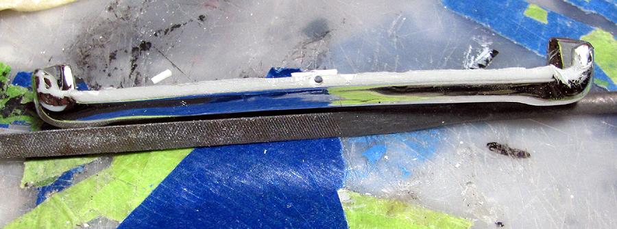

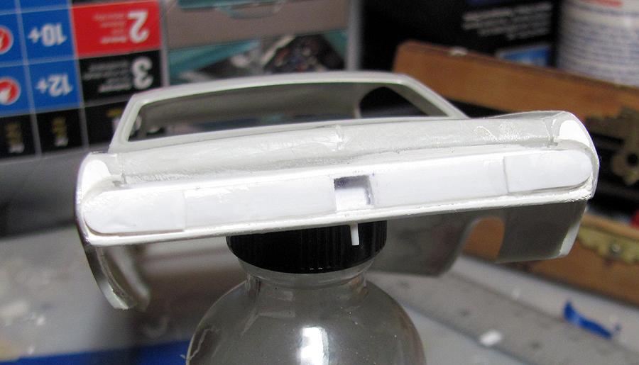

MarkJ Posted March 8, 2022 Author Posted March 8, 2022 (edited) I added a pin and hole to the rear bumper area, to help locate the bumper to the new rear panel I had to model, so when I glue it after the painting is done, it will be in the right location, and at the right angle. This glue cures really fast. Edited March 8, 2022 by MarkJ

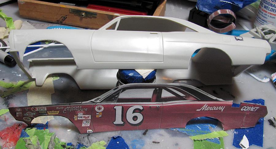

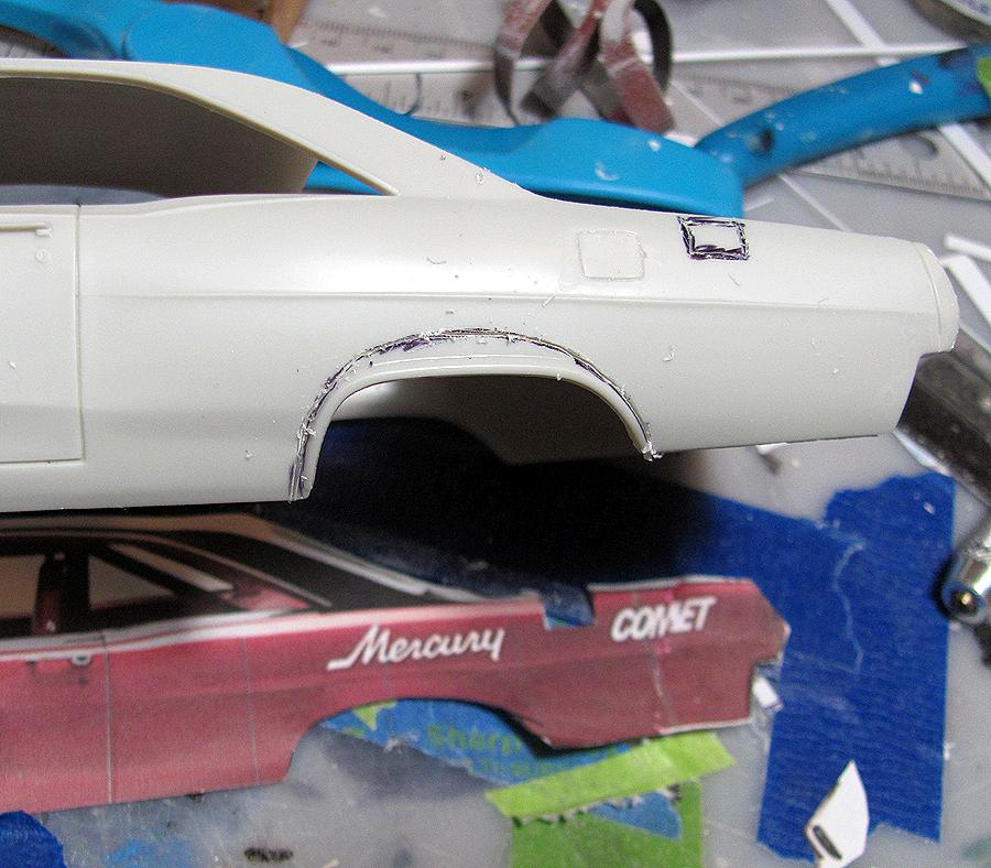

MarkJ Posted March 11, 2022 Author Posted March 11, 2022 Now that the cats out of the bag. I was crazy to think I could keep the identity of this build a secret. It was probably the only 66 comet driven in 1966. Any who, I thought I would show you the body images I made to help with the decal creation and also to help cut out the wheel openings. You just tape them on the side of the model and use them as a pattern. It's surprising how close they get these model bodies to fit a 1/25 scale picture of a real car. it has to be a really good, centered profile shot which I was lucky to find both sides of the car. The pictures are of a museum car, but the guy says he used the real Bud Moore Comet to make it, and he has the serial numbers to prove it. I have the link to the article if anyone is interested.
