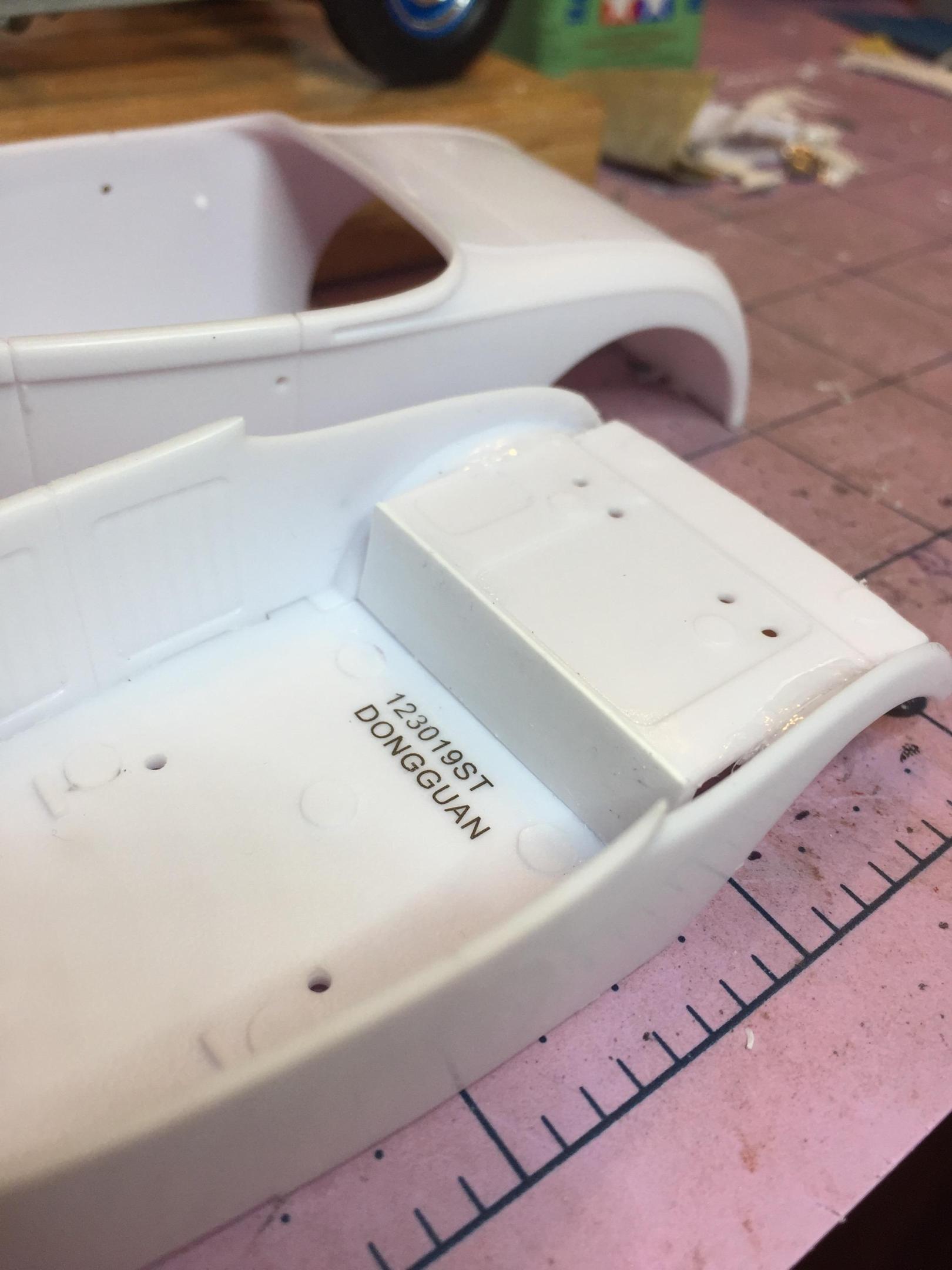

customline Posted April 27, 2022 Author Posted April 27, 2022 Ok....did a little re-engineering today. There ain't much paint left in that little can but it might be enough to hit this roadster body with enough to do the job. This body is a '29 and is quite a bit narrower at the firewall, making the engine look immense. I like it ?. I zeed the floor to match the existing (coupe) frame and modified the interior panels in the wheel well area. The firewall was a little tricky as there was less room in the floor @ firewall for the big torqueflite but a little tweeking with the Dremel worked that out. I used a piece of the kit "Highboy" firewall and added it to the floor and created a foundation for my diamond plate facia. I sectioned the deuce shell so it didn't drag on the pavement. It's amazing what can be done with thick CA and accelerator ?. I'll add more pics later tonight but I wanted to get these up now.

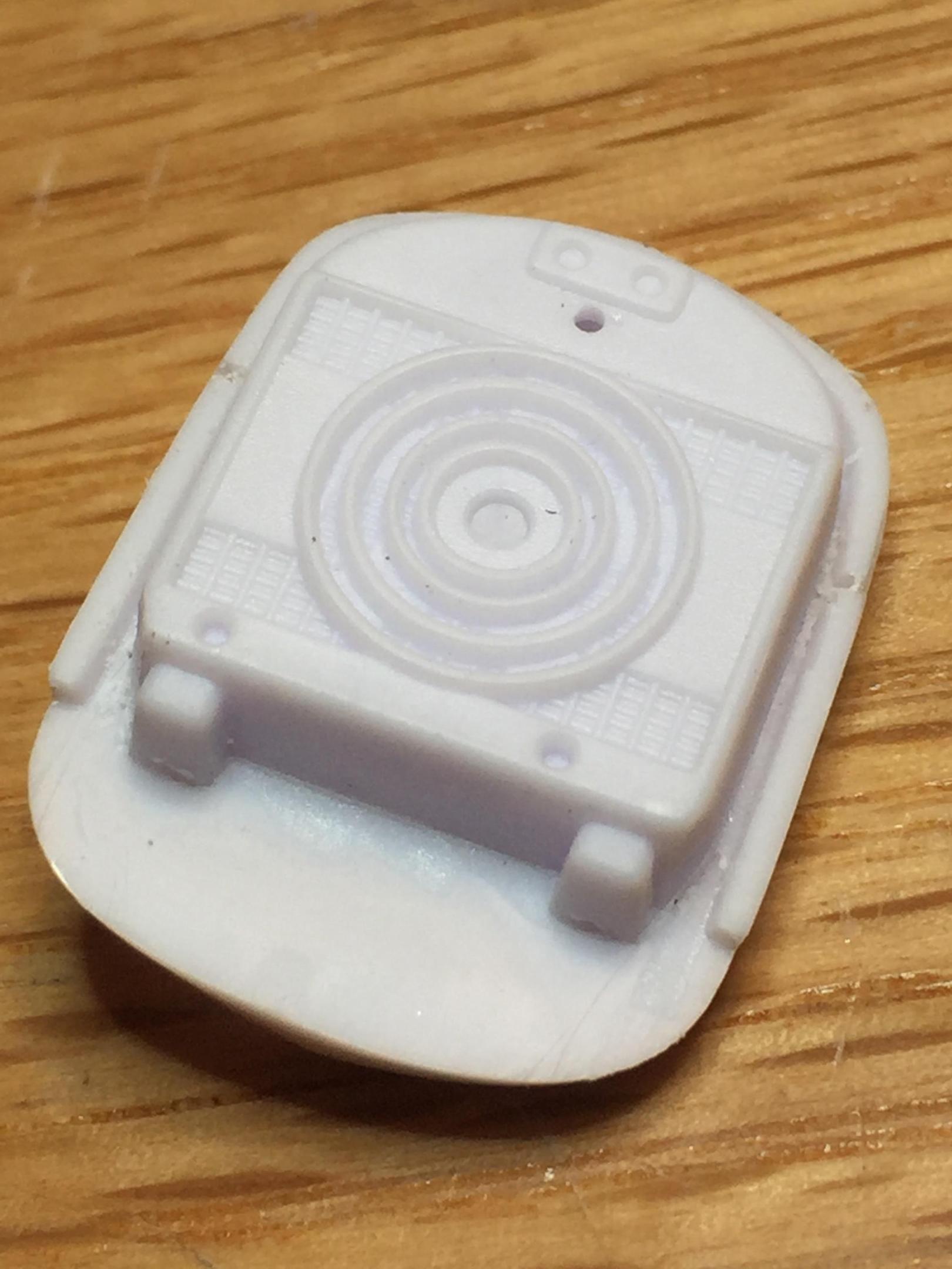

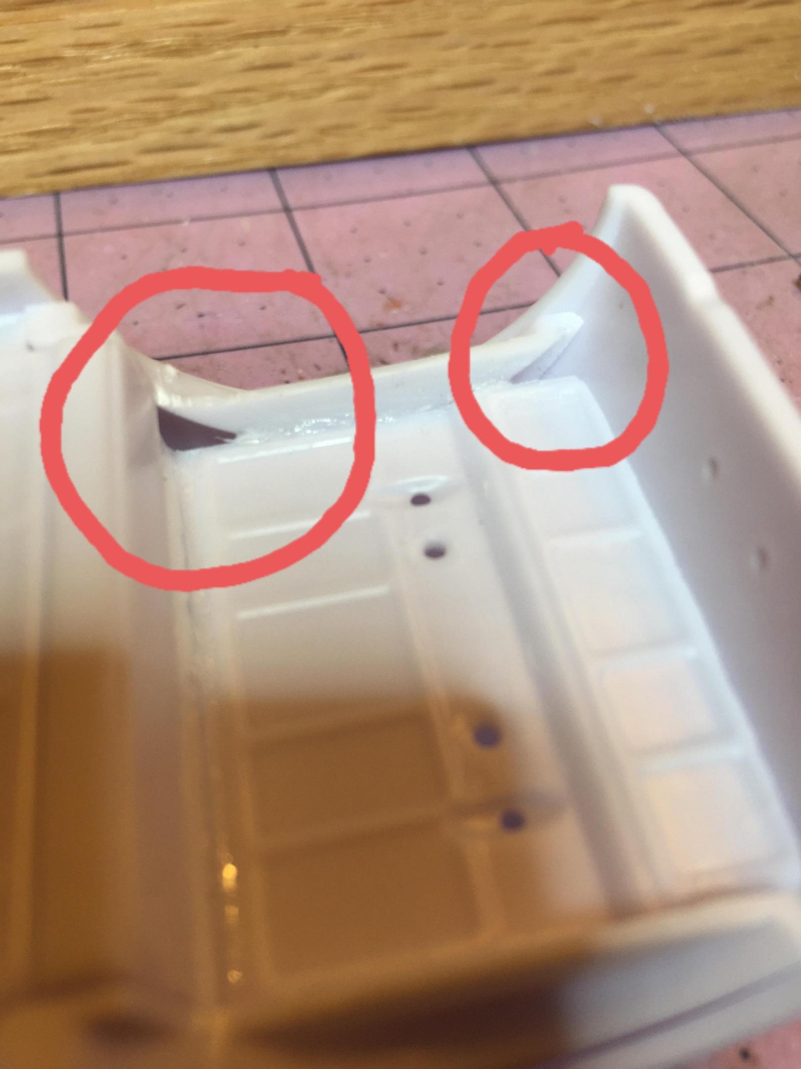

customline Posted April 27, 2022 Author Posted April 27, 2022 (edited) My first hurdle was the firewall/floor junction. I cut a section from the kit firewall and grafted it to the floor. This gave me something to eventually mate my chrome diamond plate facade to. Some drum sanding ensued. Then I just whipped up another chrome firewall using Plastruct HO Guage material and BMF "ultra bright" chrome foil. ?. Next the deuce grille. I sectioned it down to the size of the kit '29 shell and used the kit radiator on the back side. The grille was ground down on both ends very gradually, checking often for close fit. The re-engineering of the floor and interior panels necessitates filling the circled areas Edited April 27, 2022 by customline
