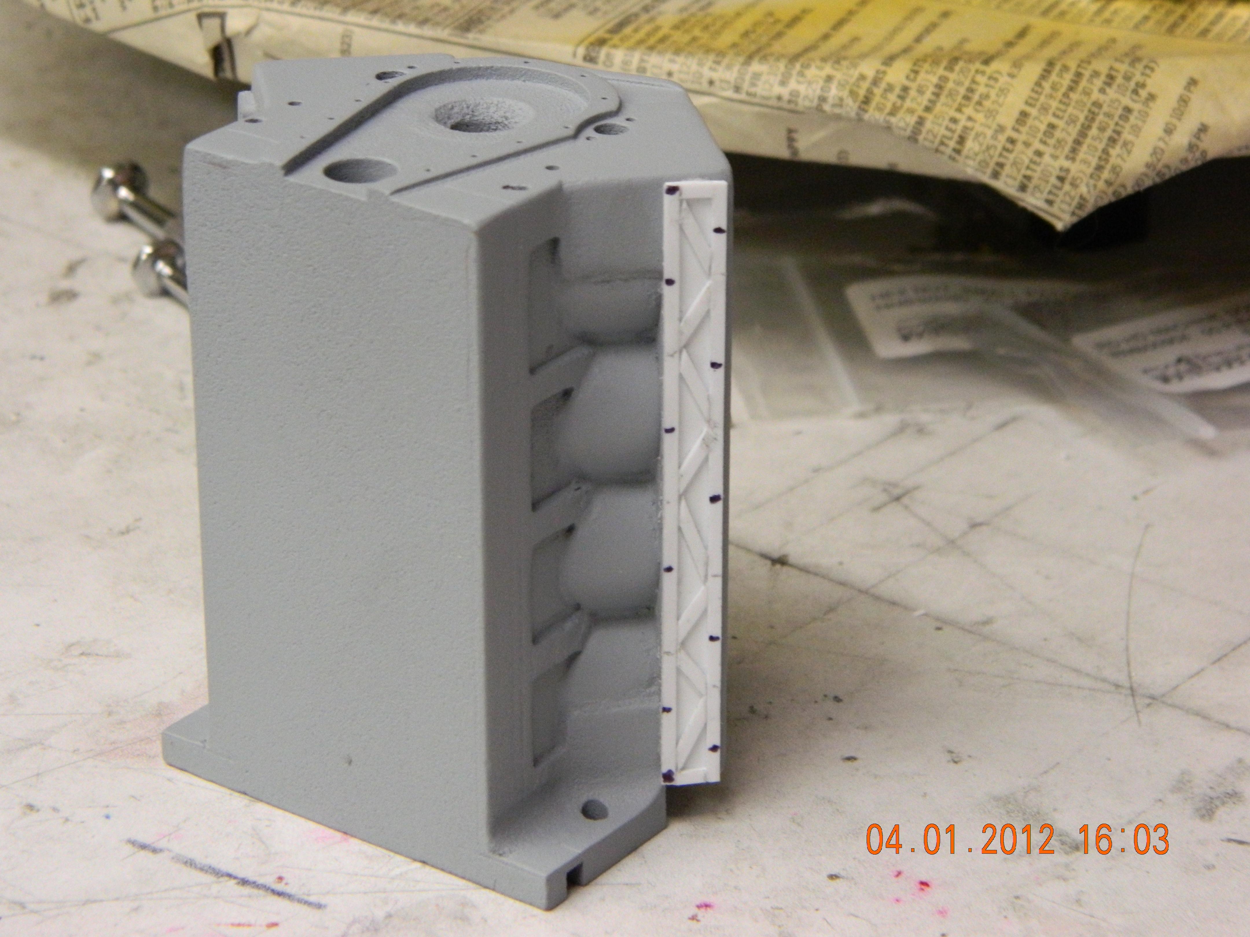

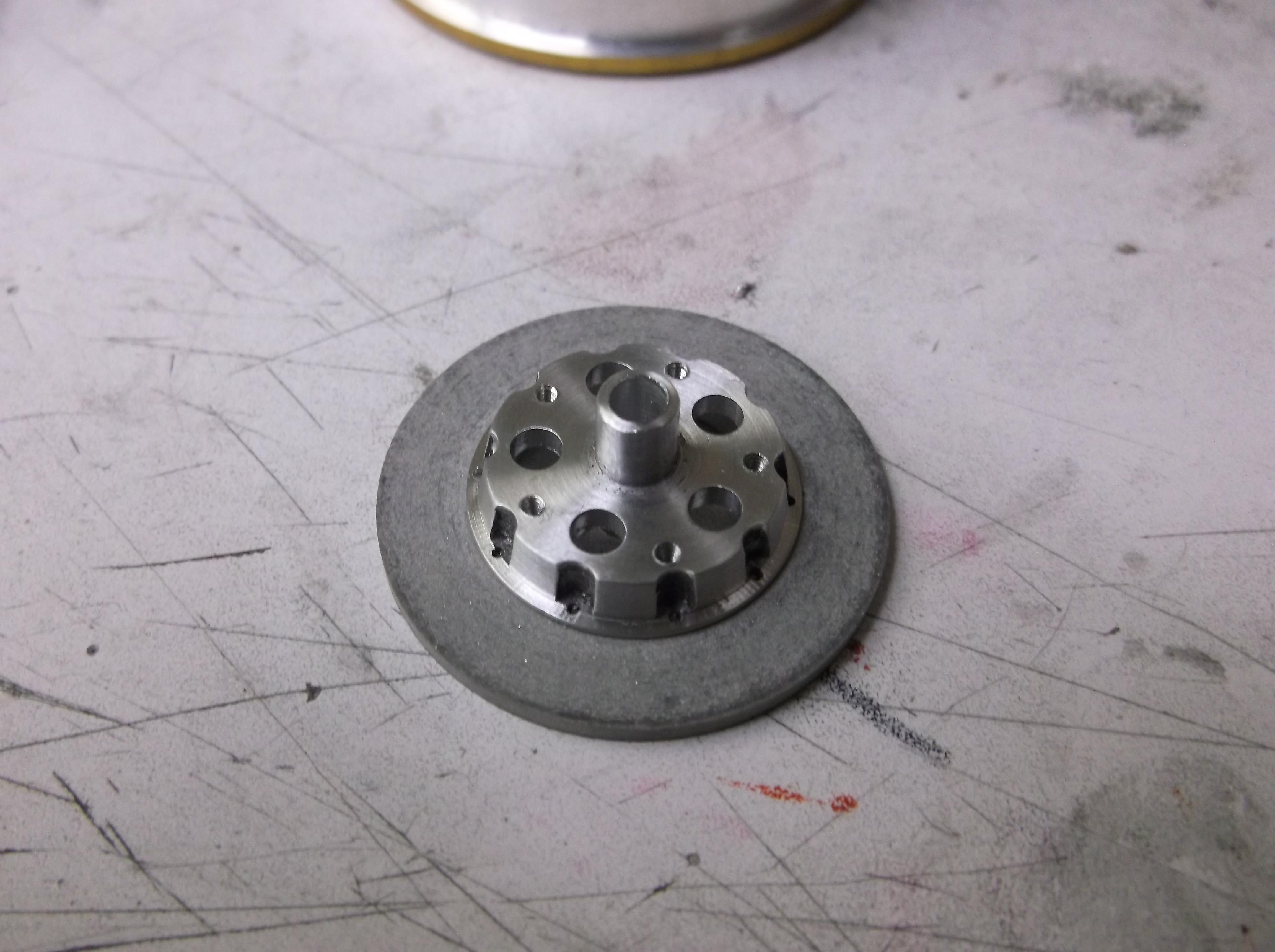

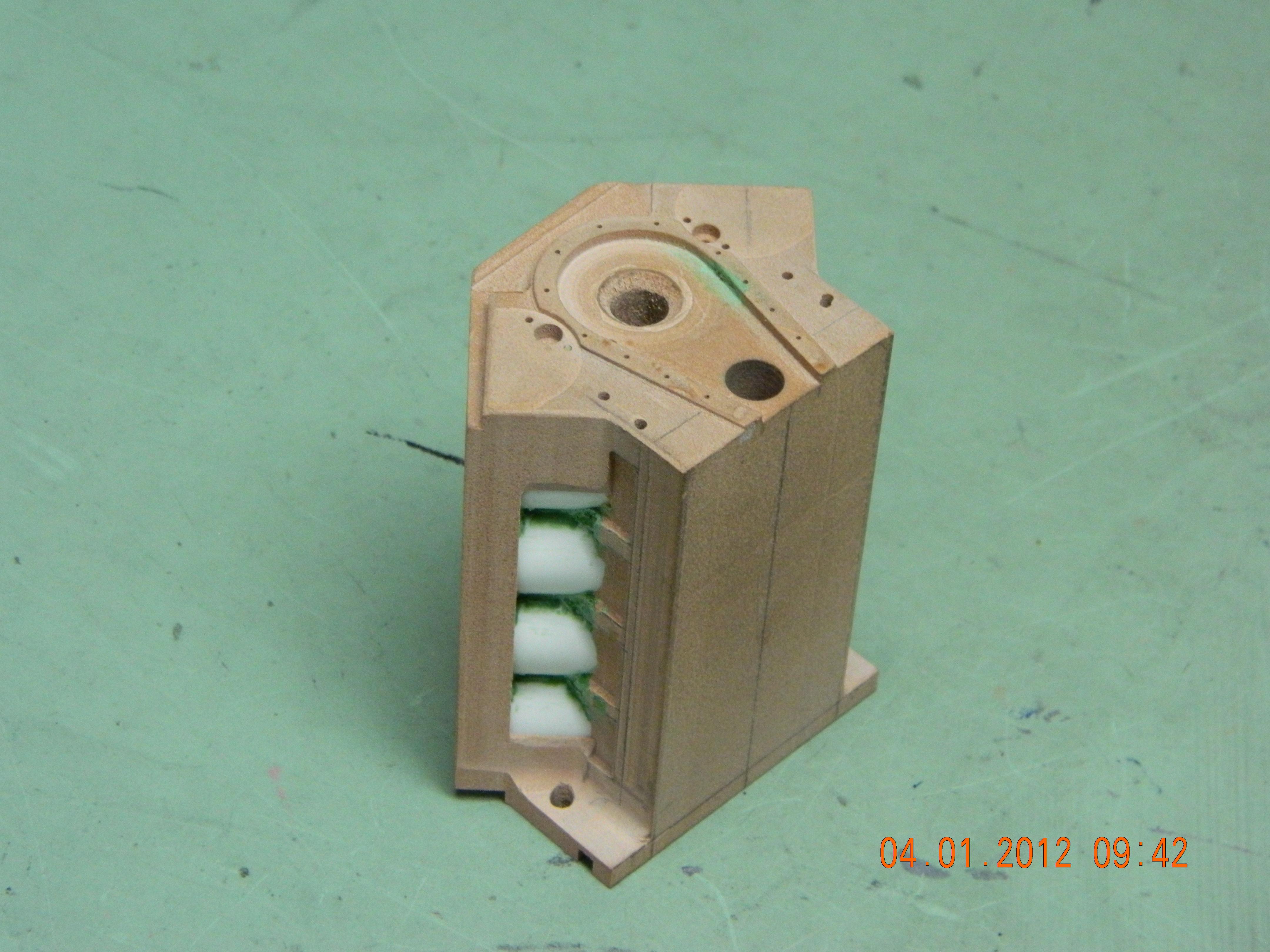

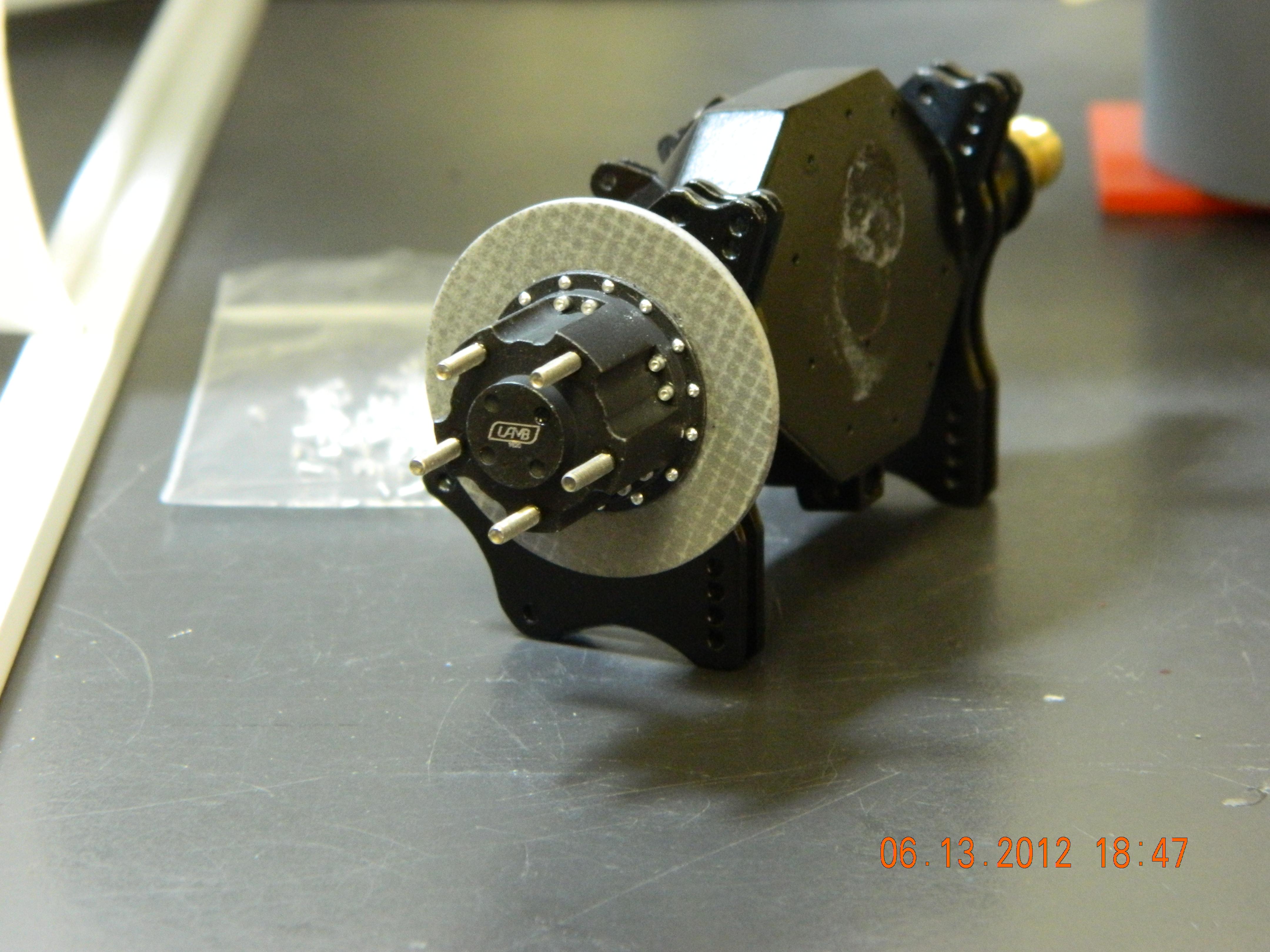

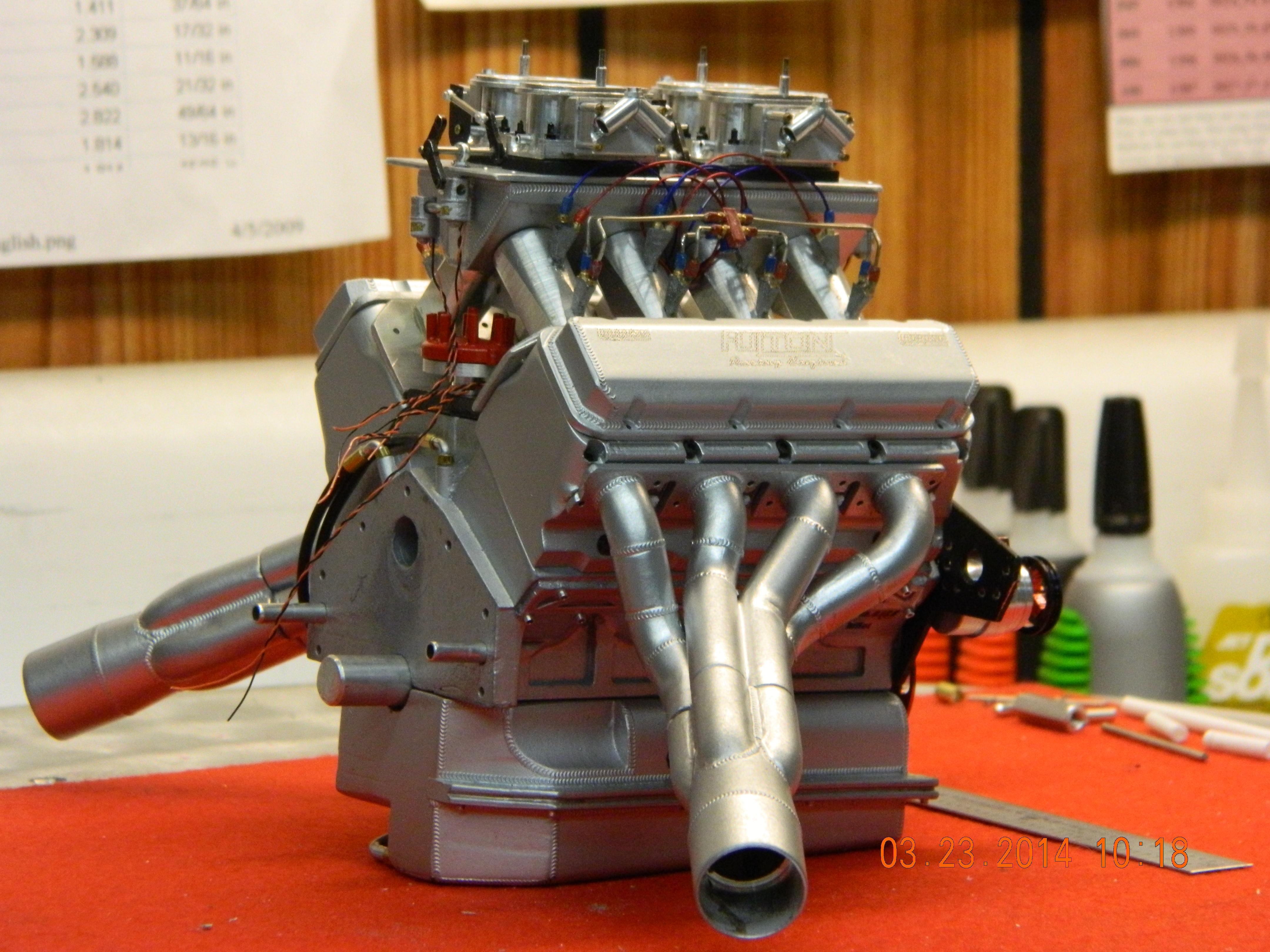

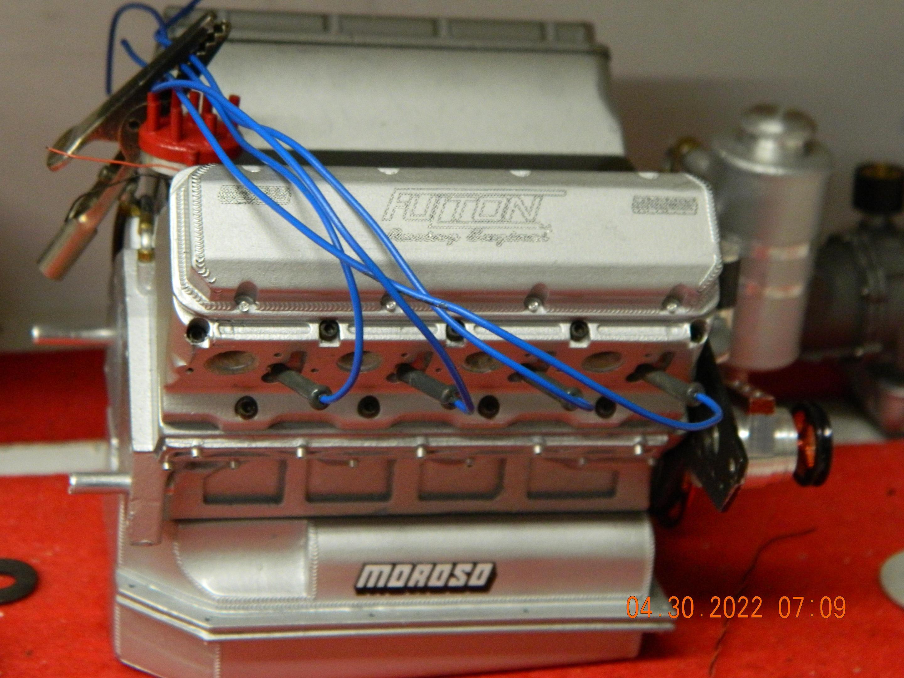

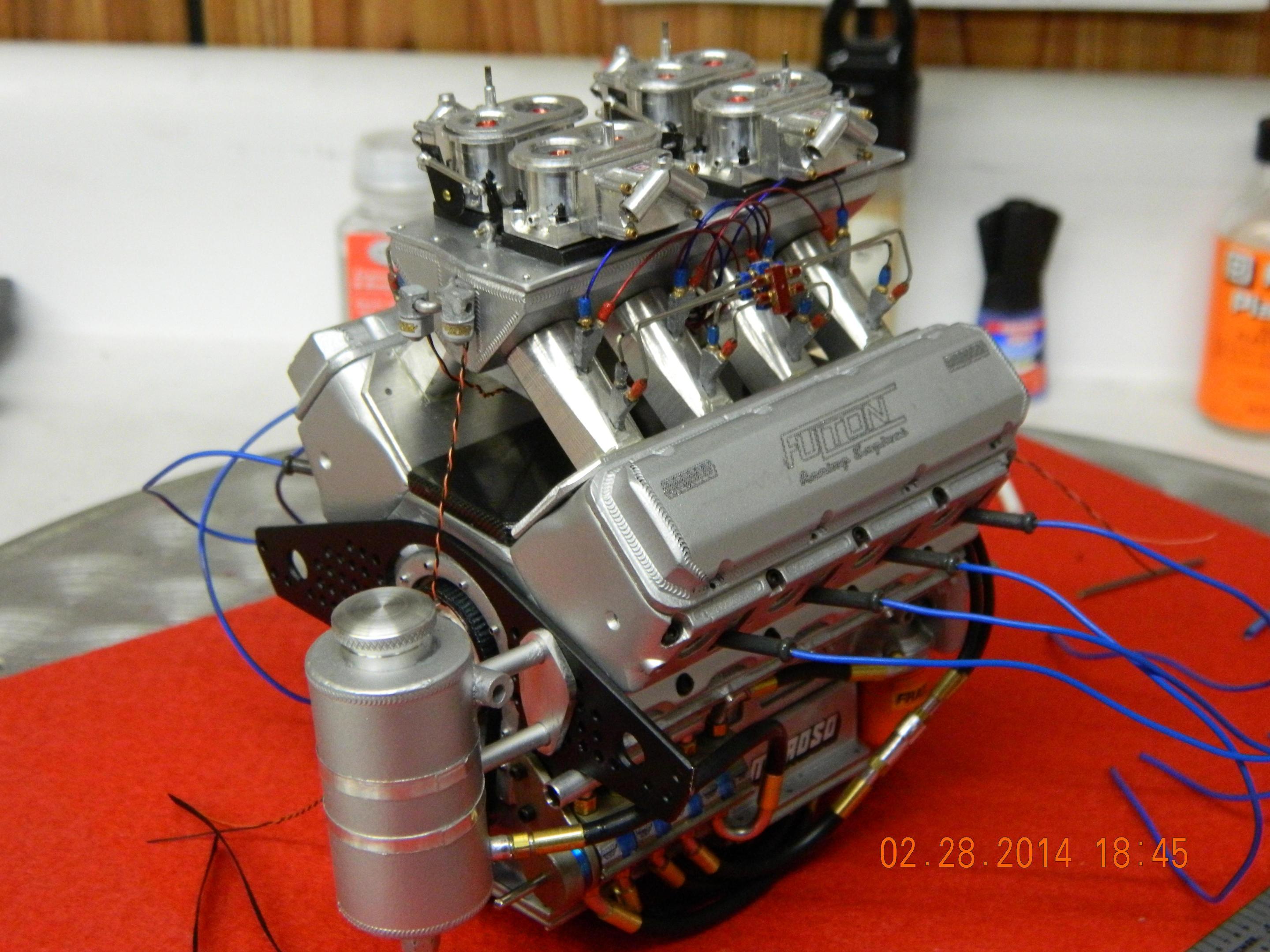

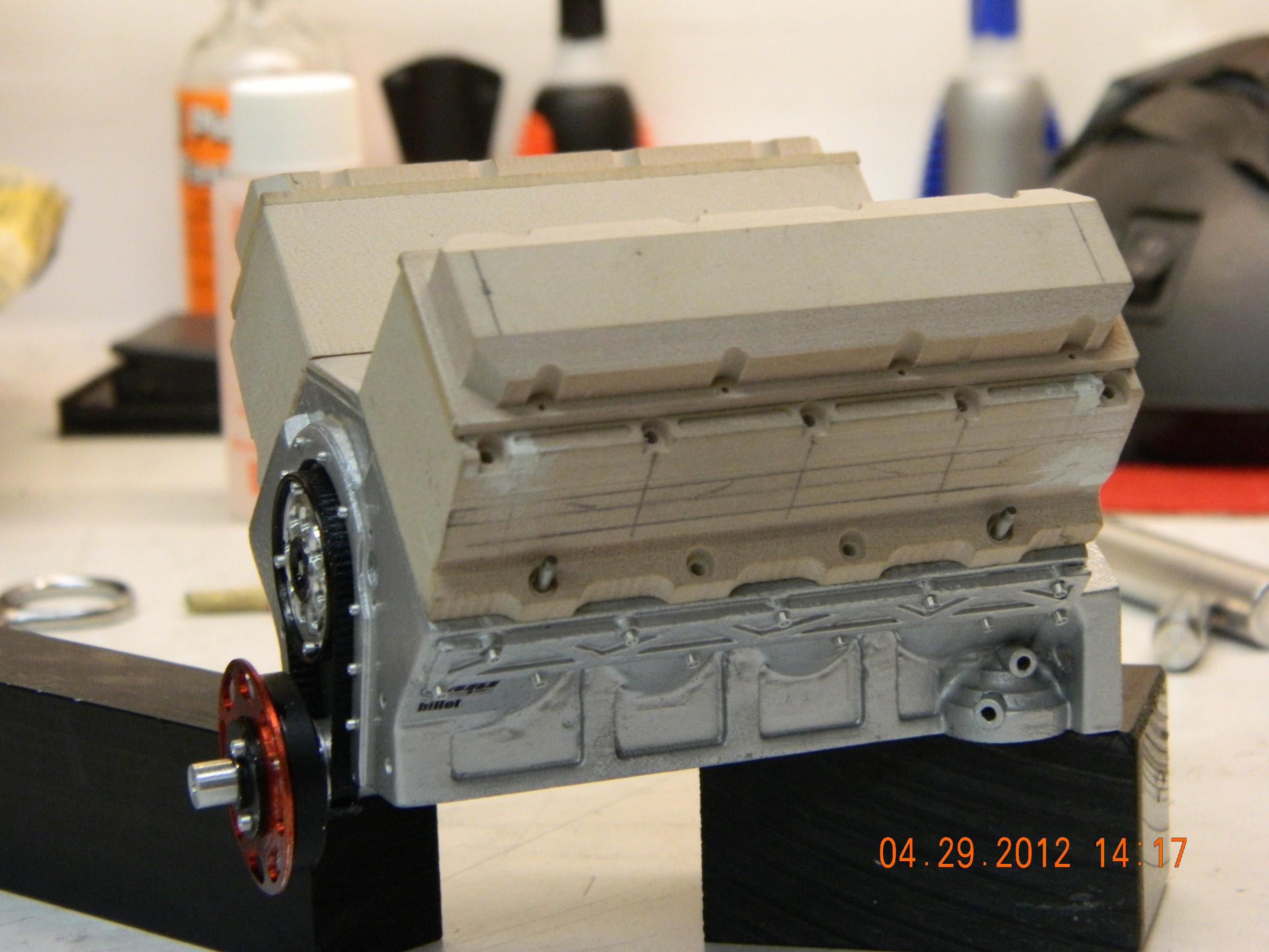

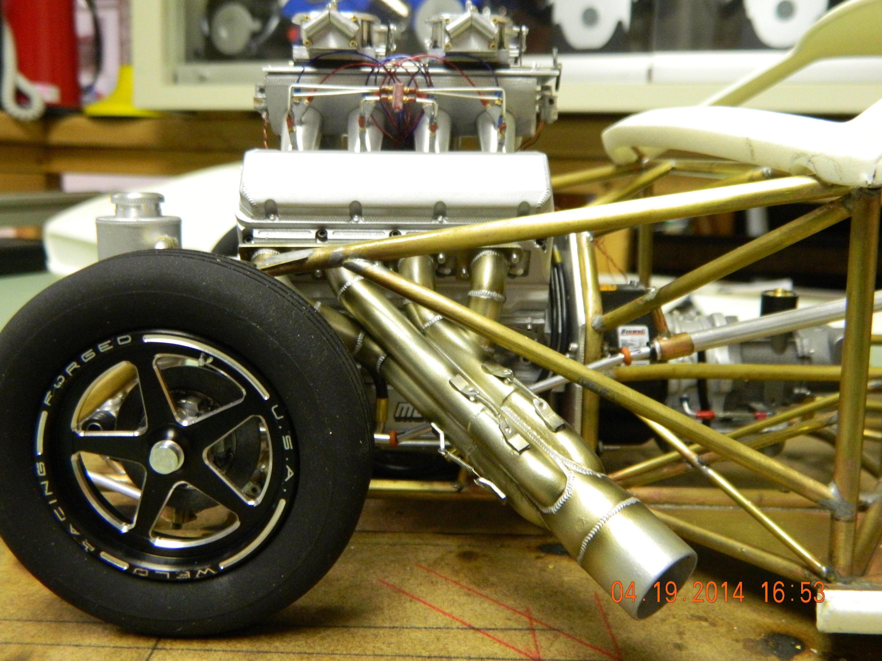

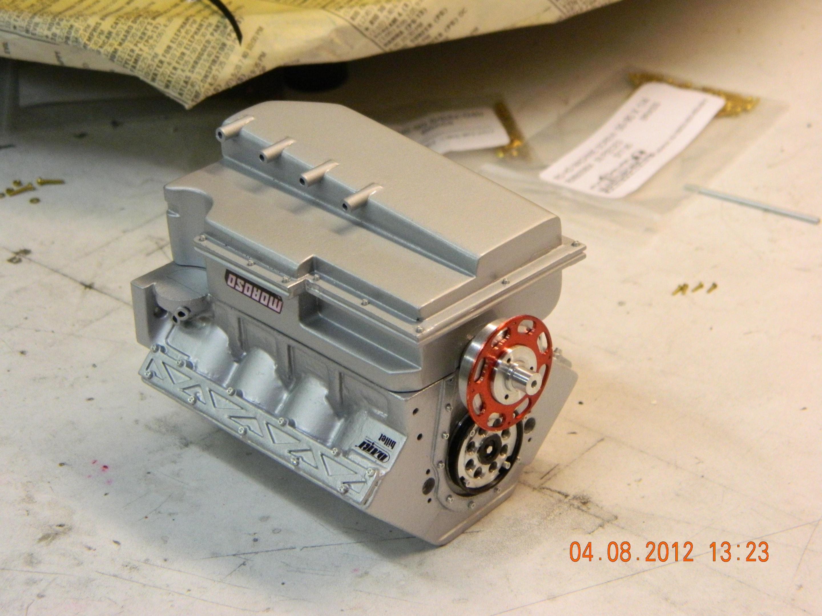

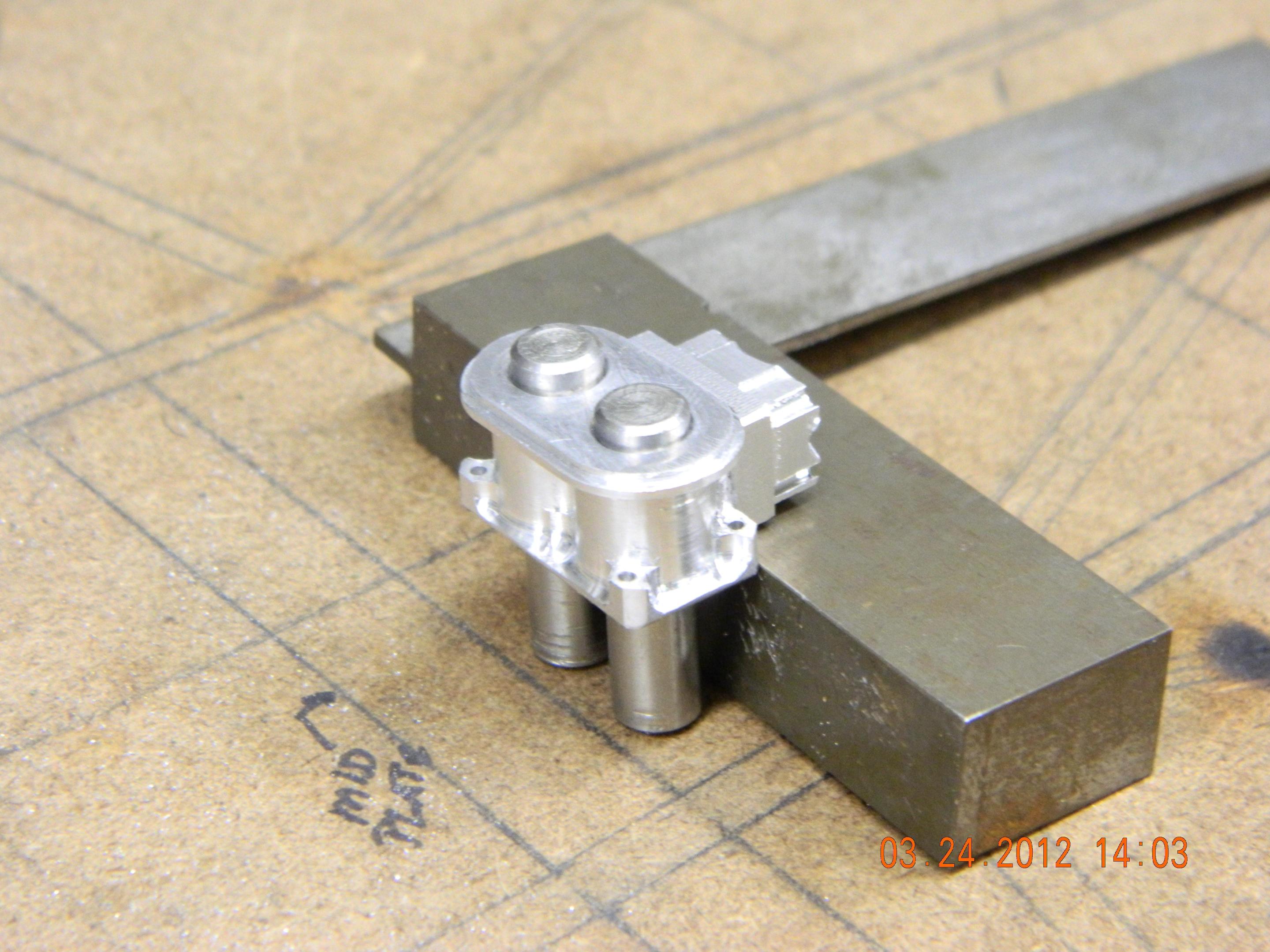

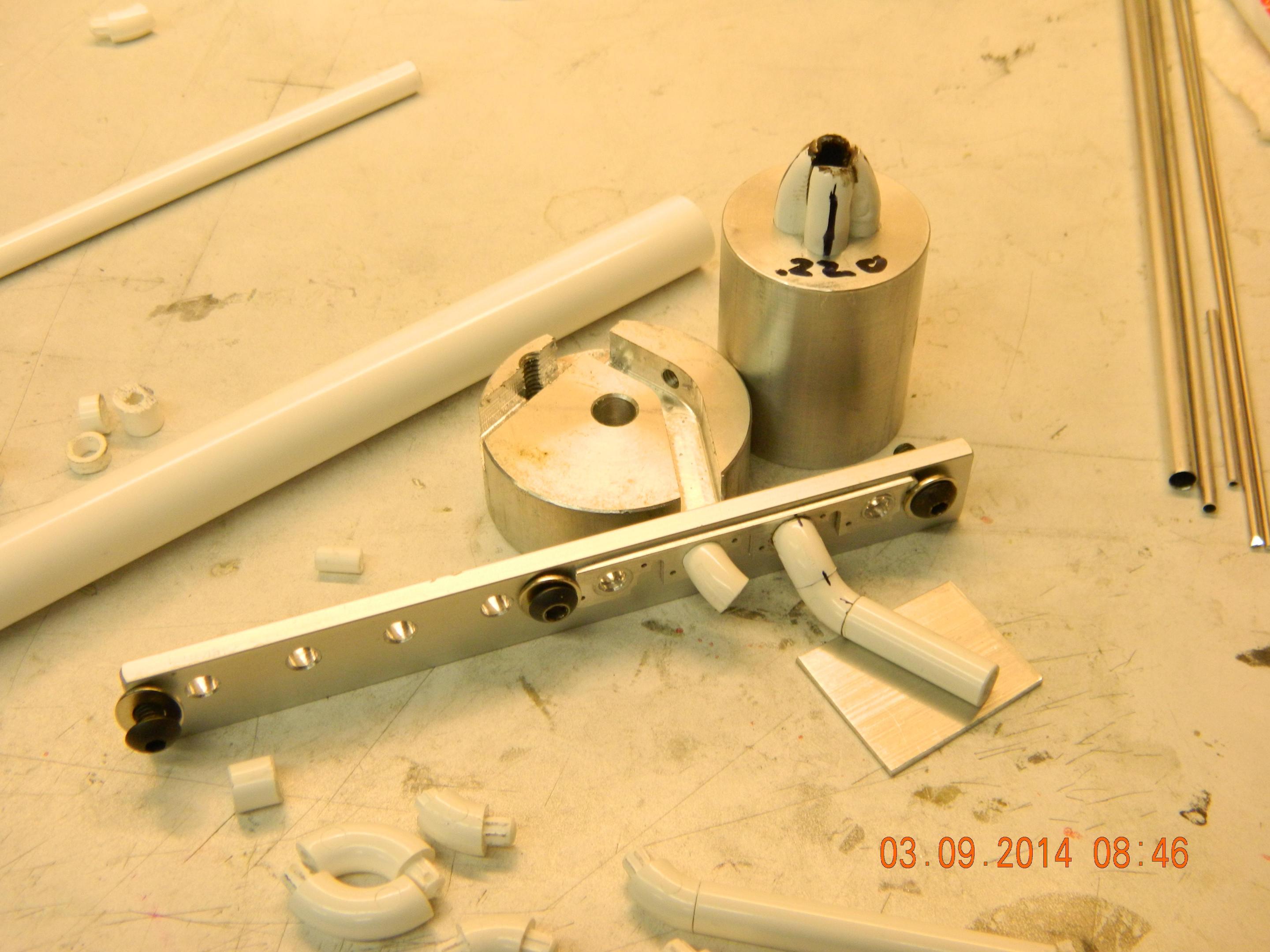

comp1839 Posted April 21, 2022 Author Posted April 21, 2022 my absolute favorite part is the engine. this engine is based on a 5.2 inch bore space 822 cube Gene Fulton nitrous motor.it is all scratch built and fairly accurate. 2

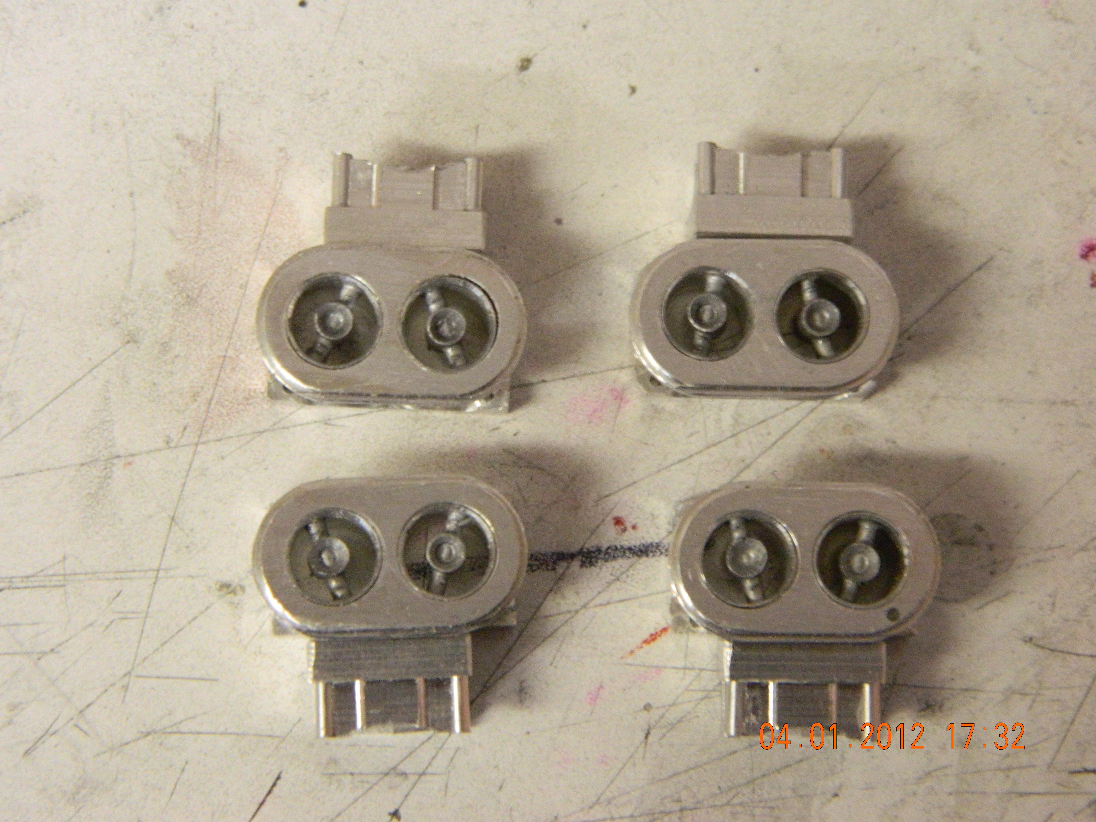

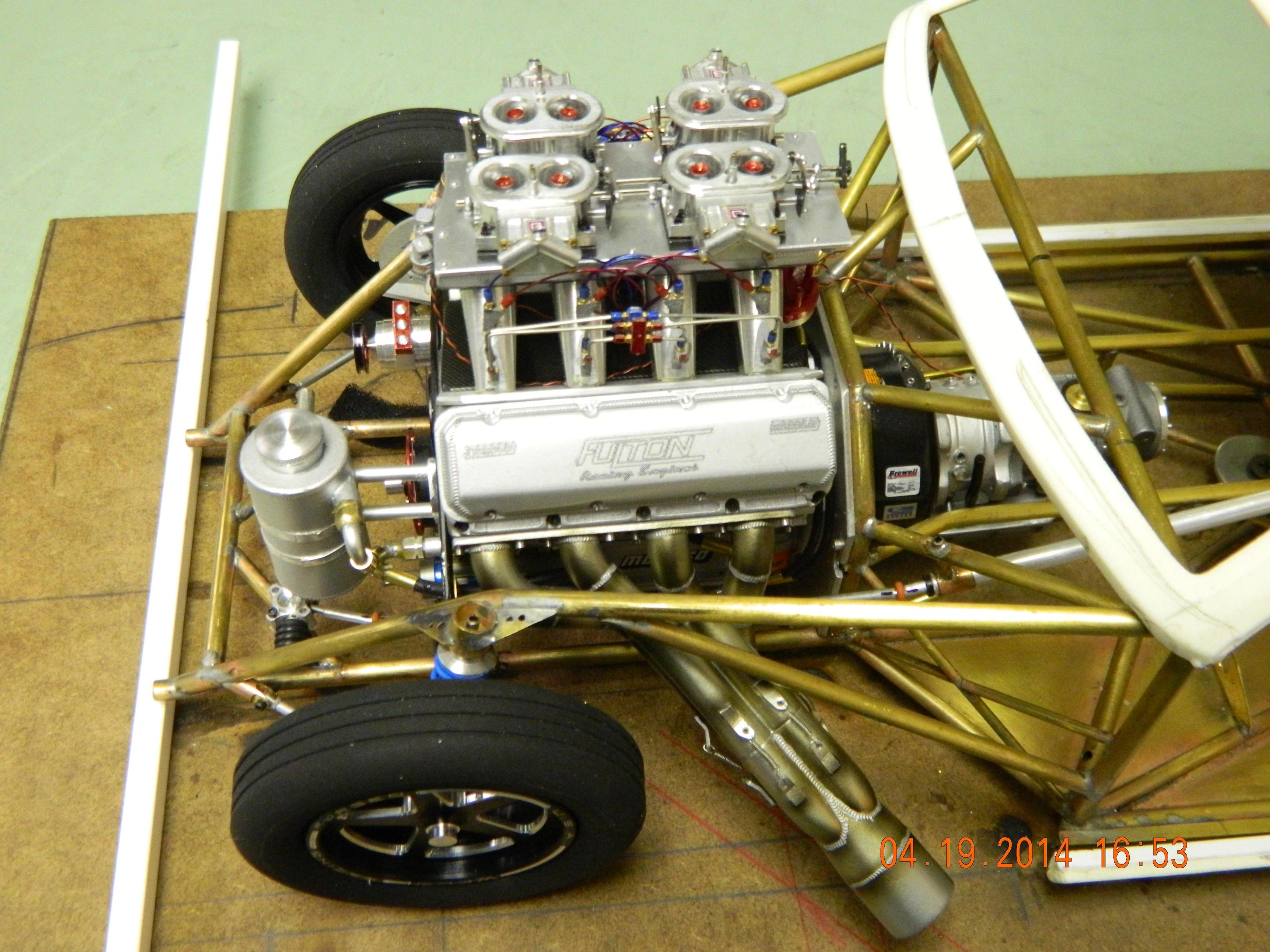

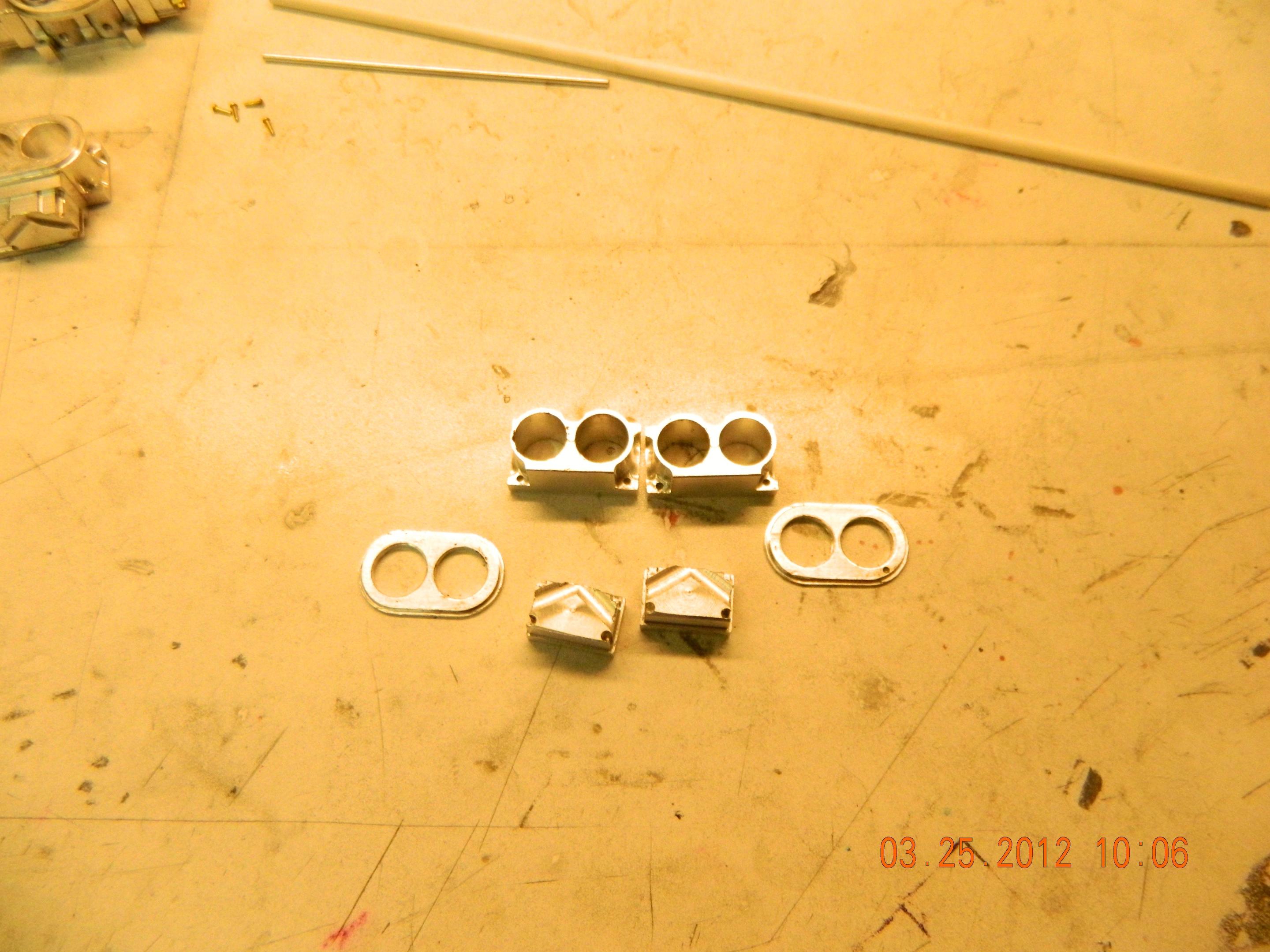

comp1839 Posted April 23, 2022 Author Posted April 23, 2022 (edited) Henry, thanks. couple of more shots. the carbs. Edited April 23, 2022 by comp1839 4

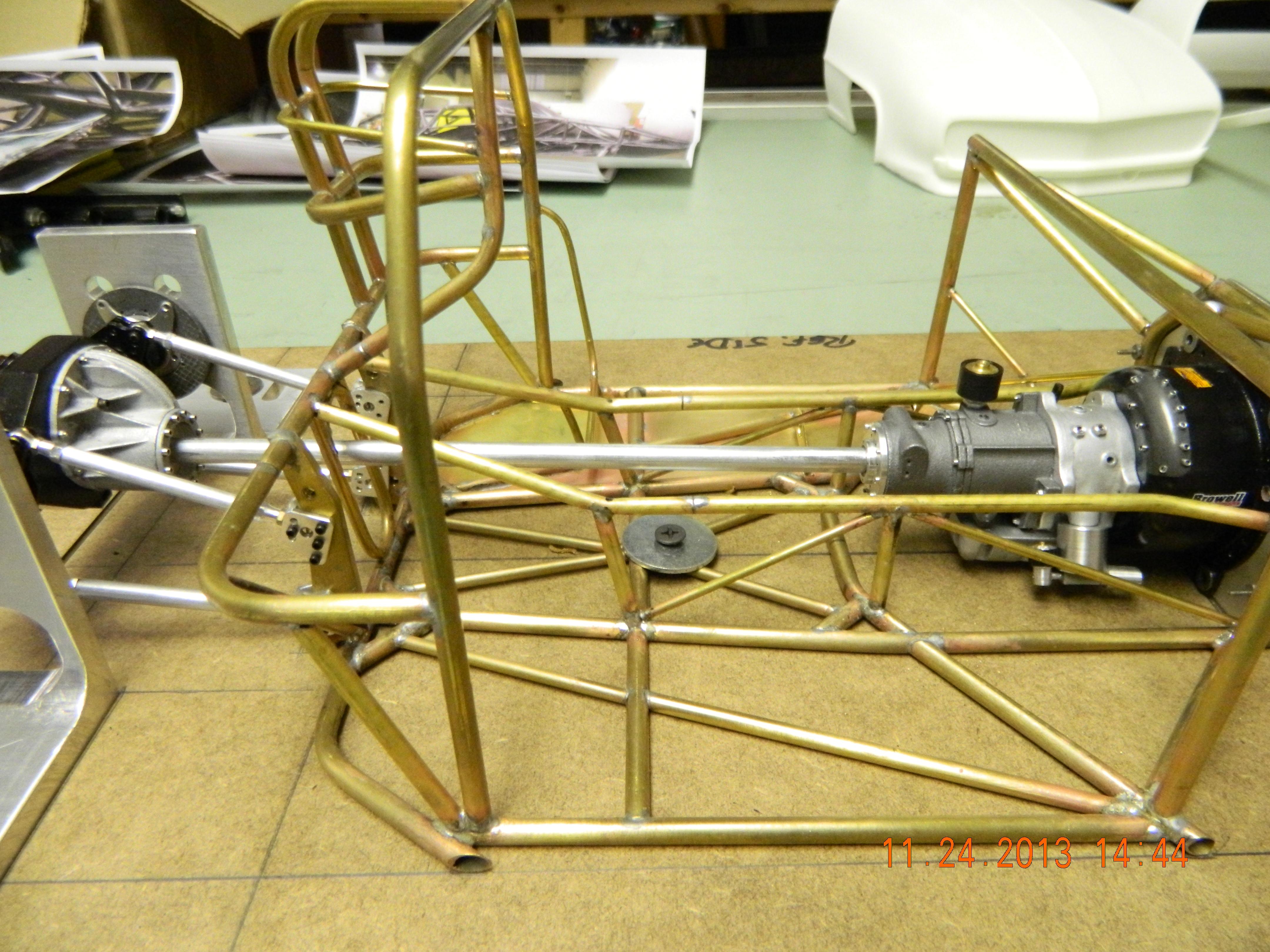

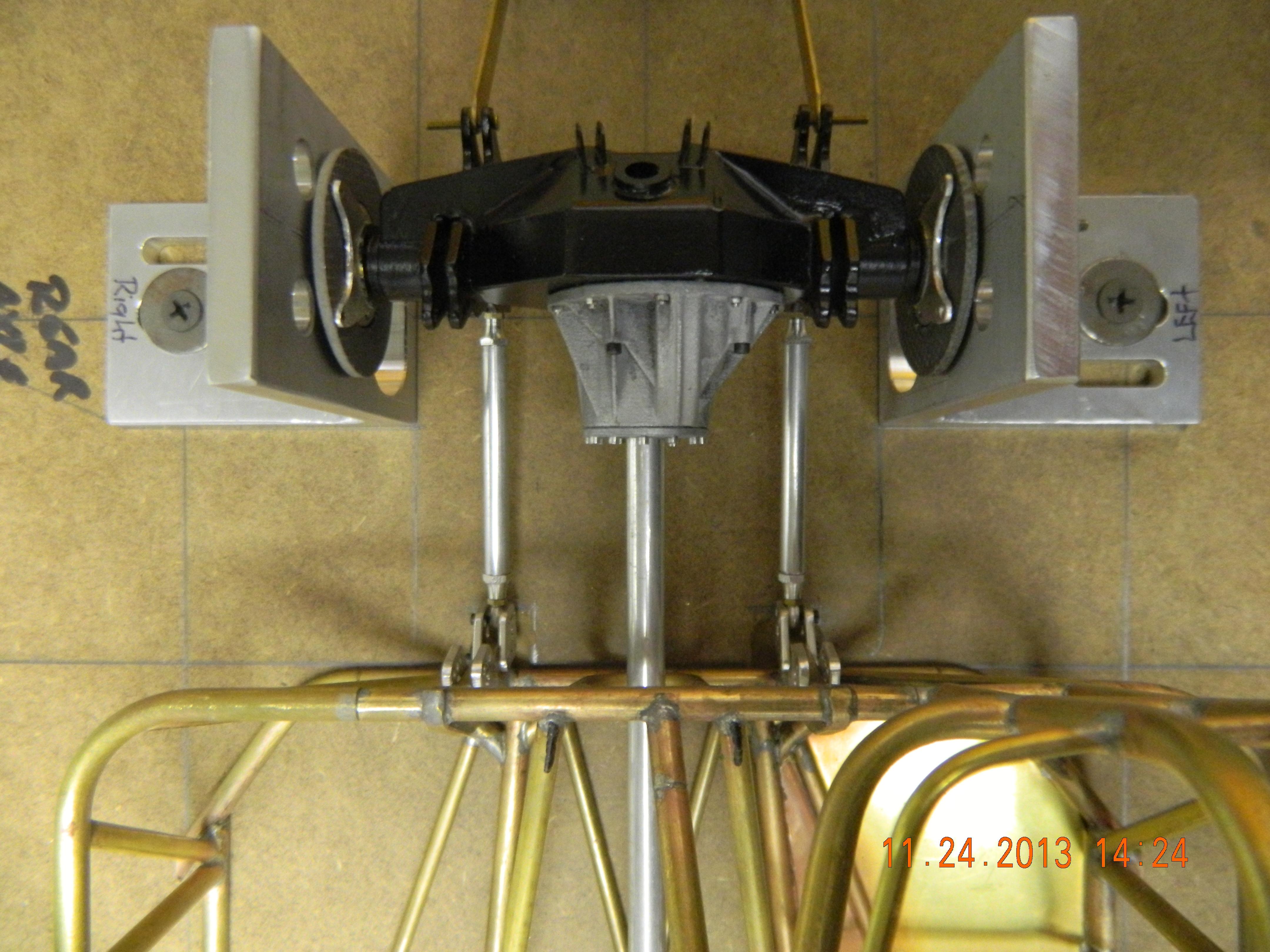

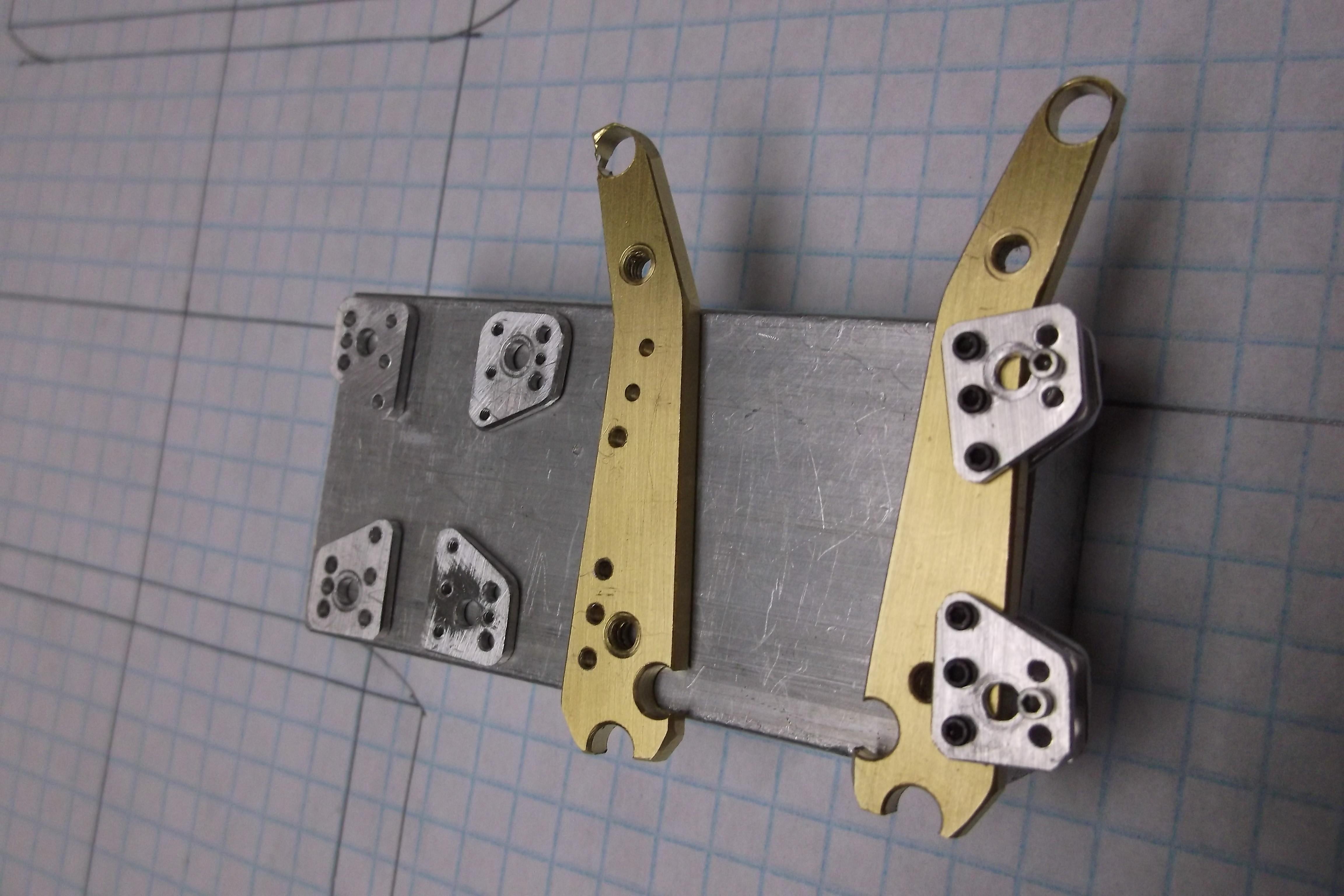

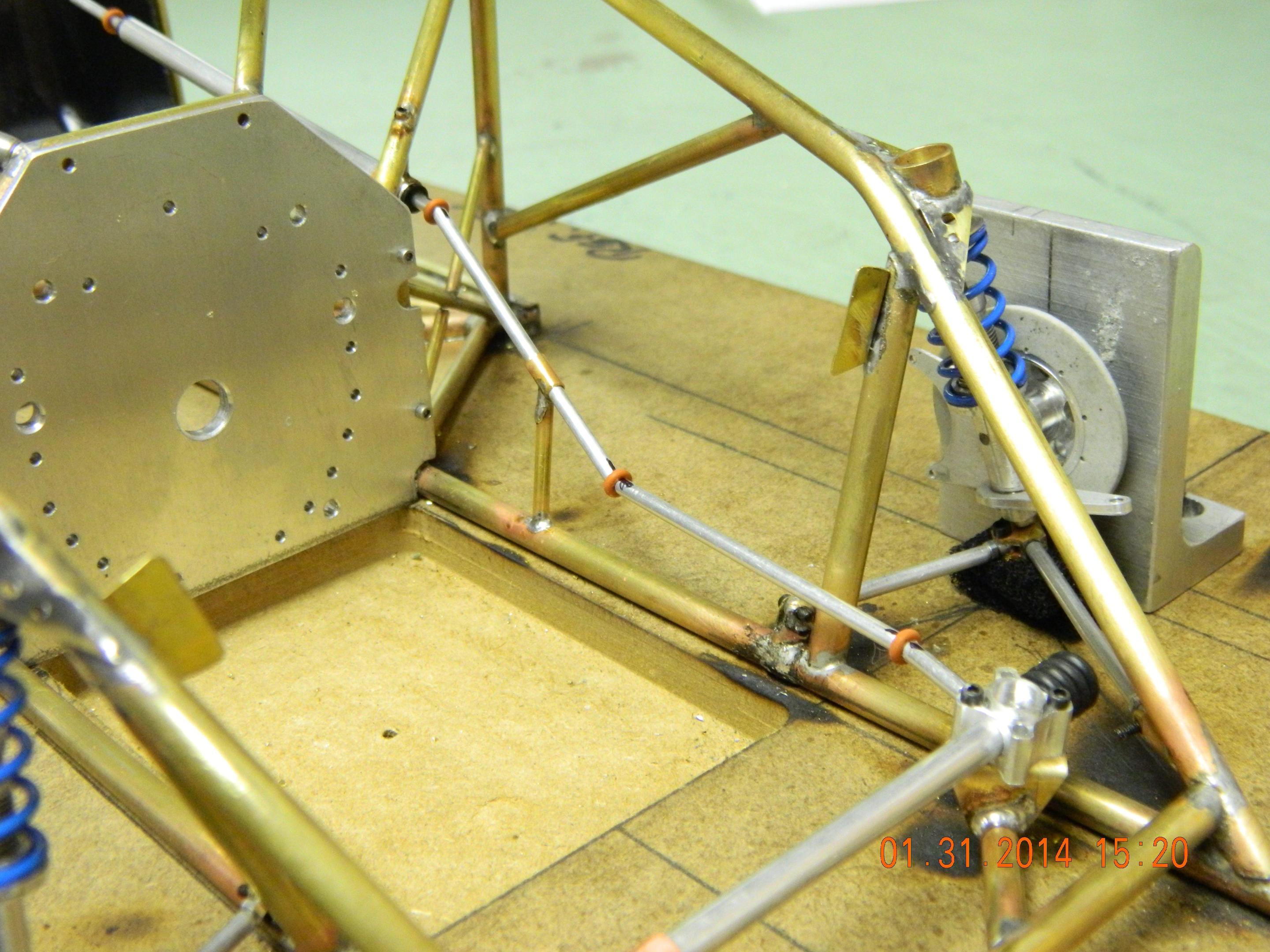

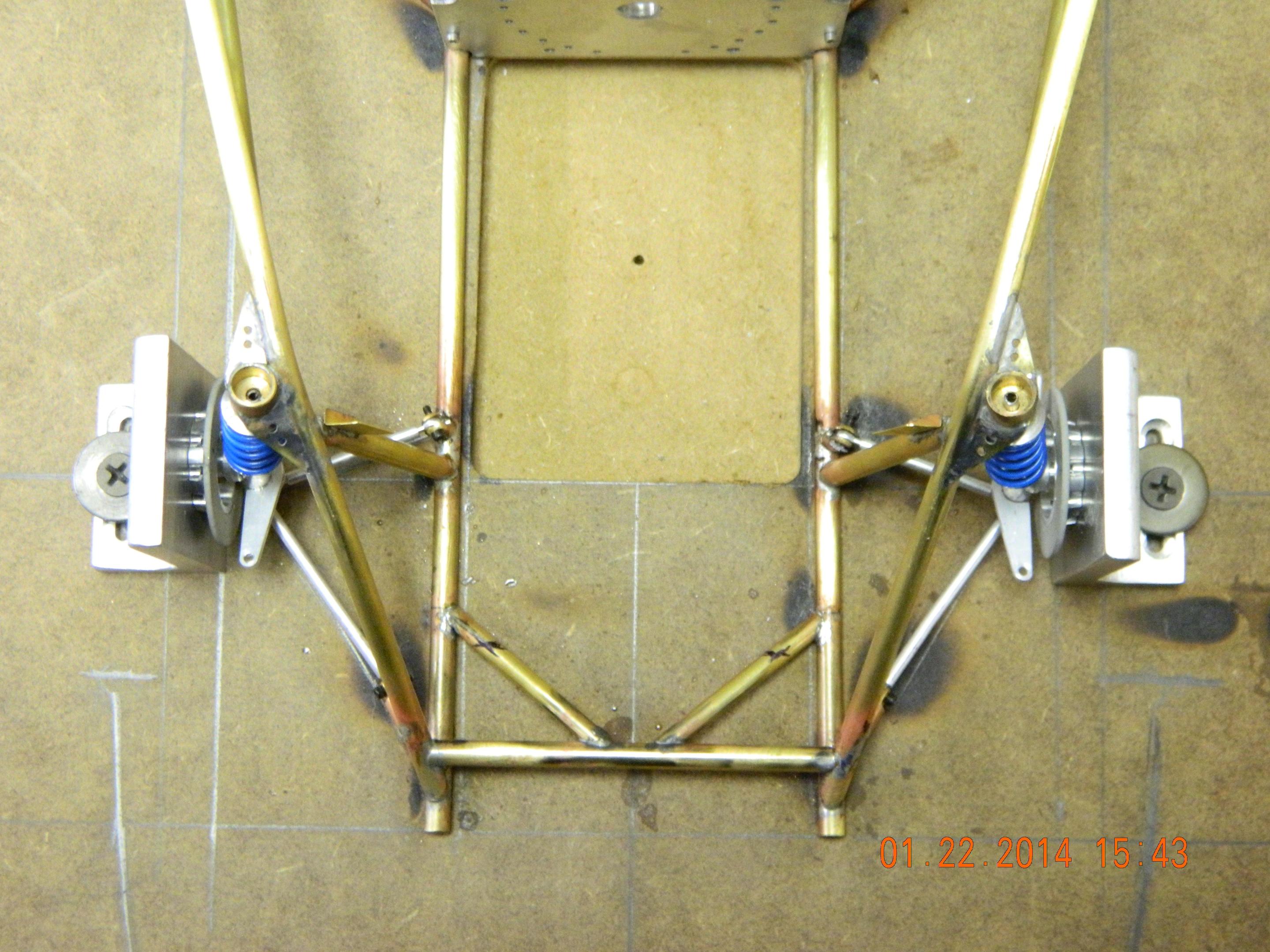

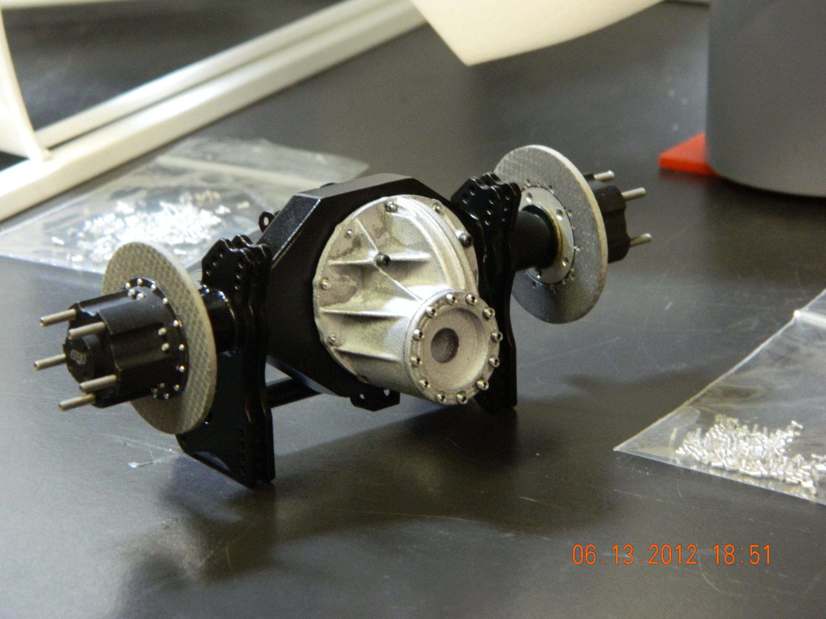

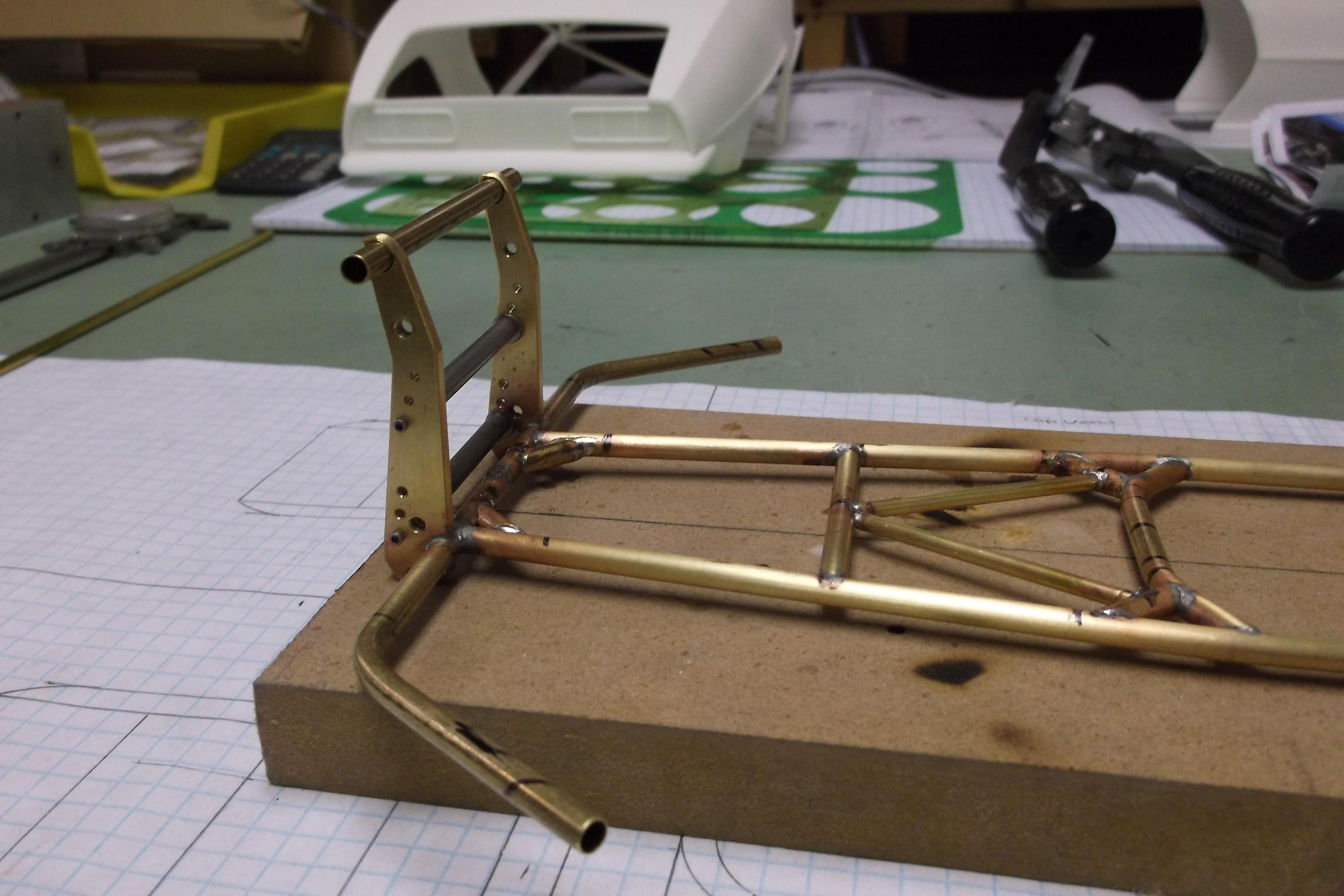

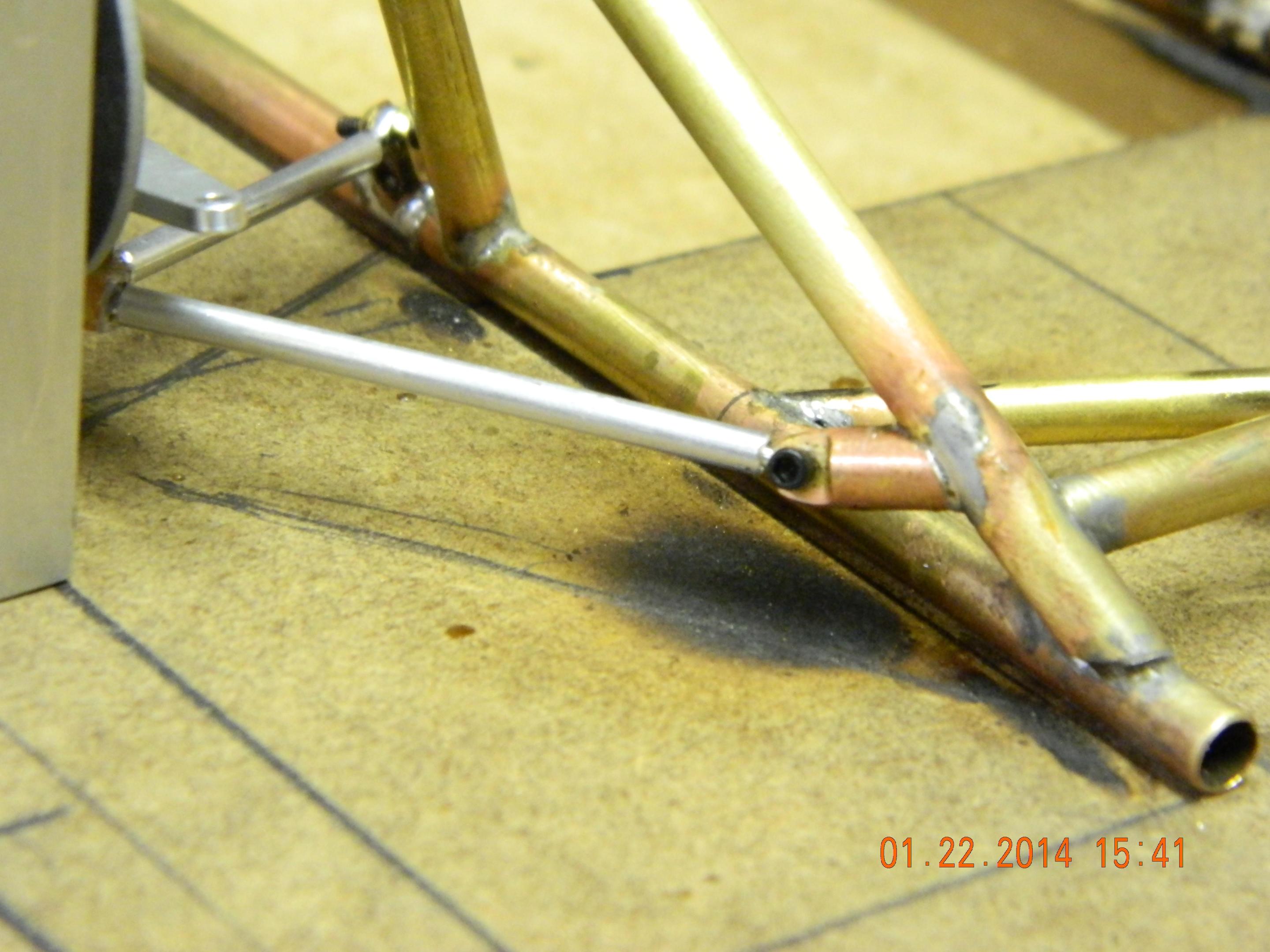

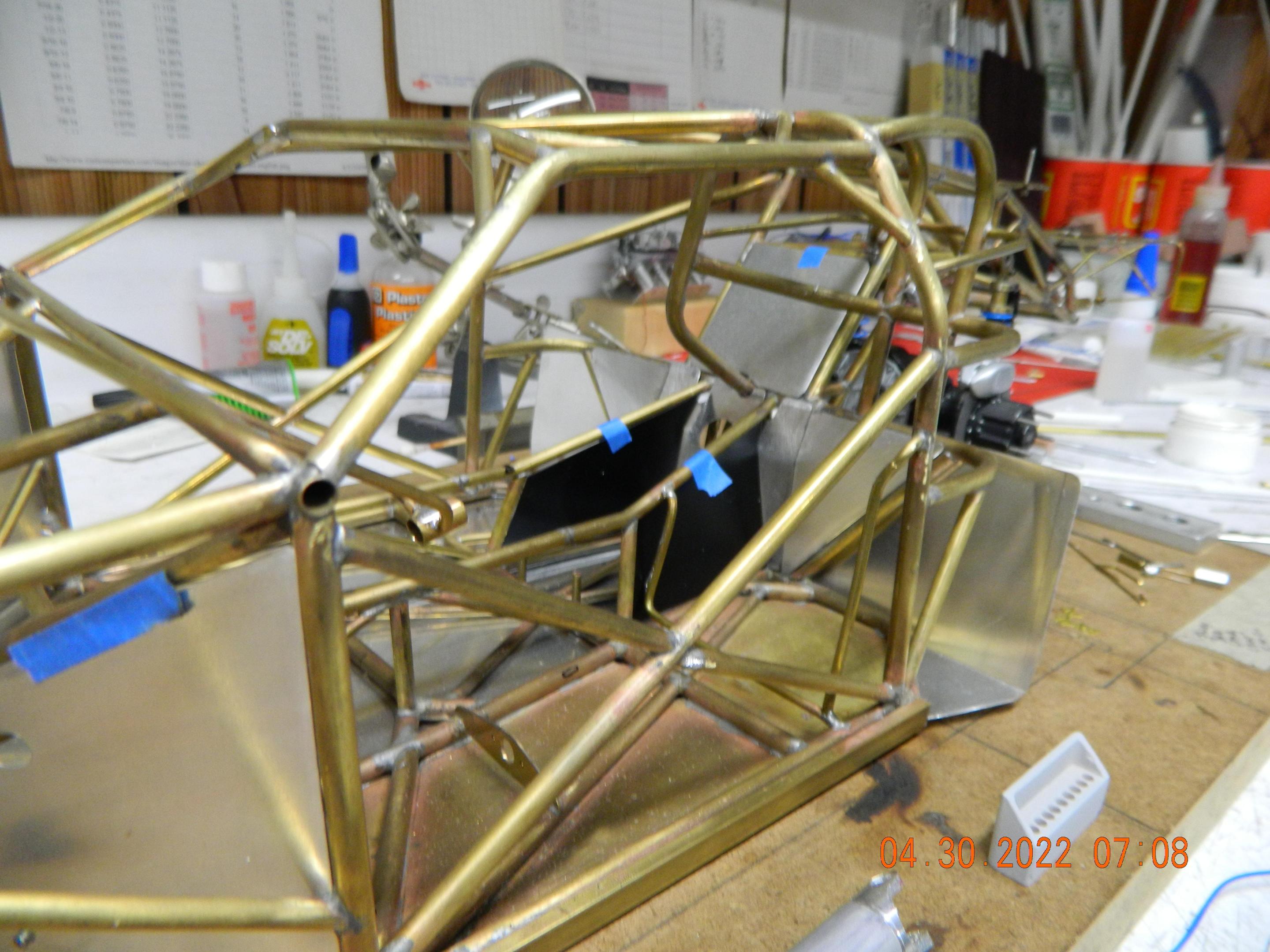

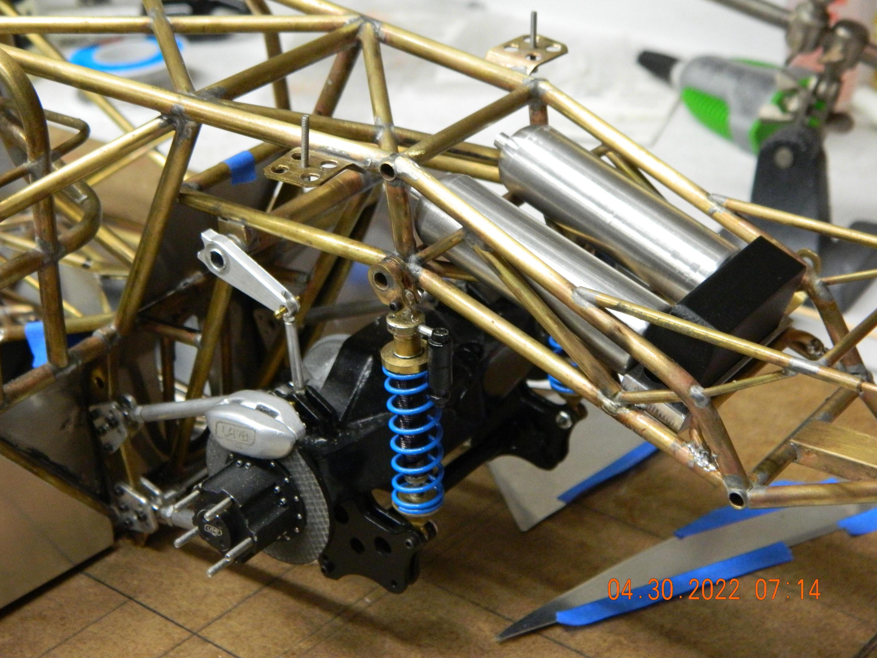

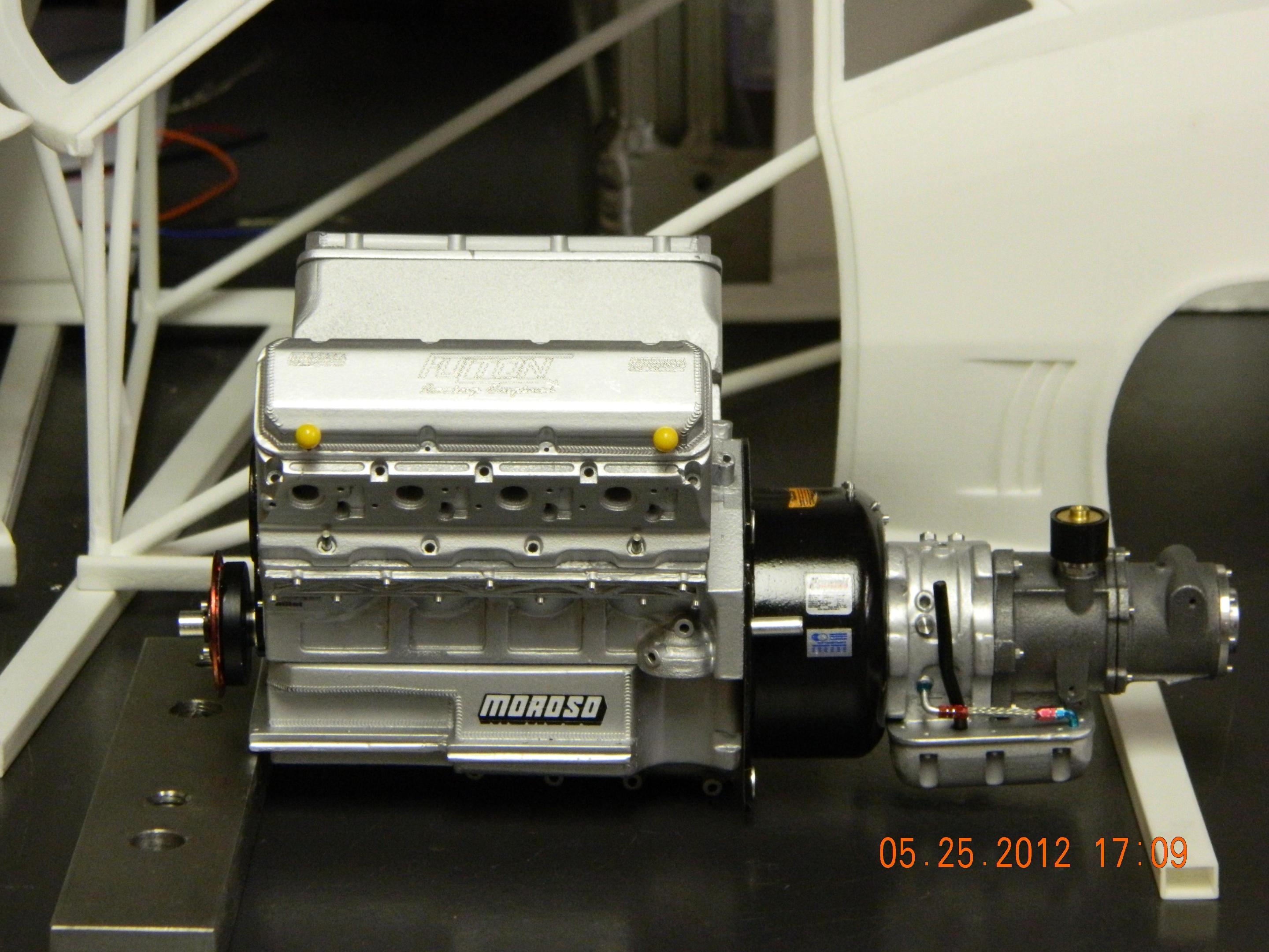

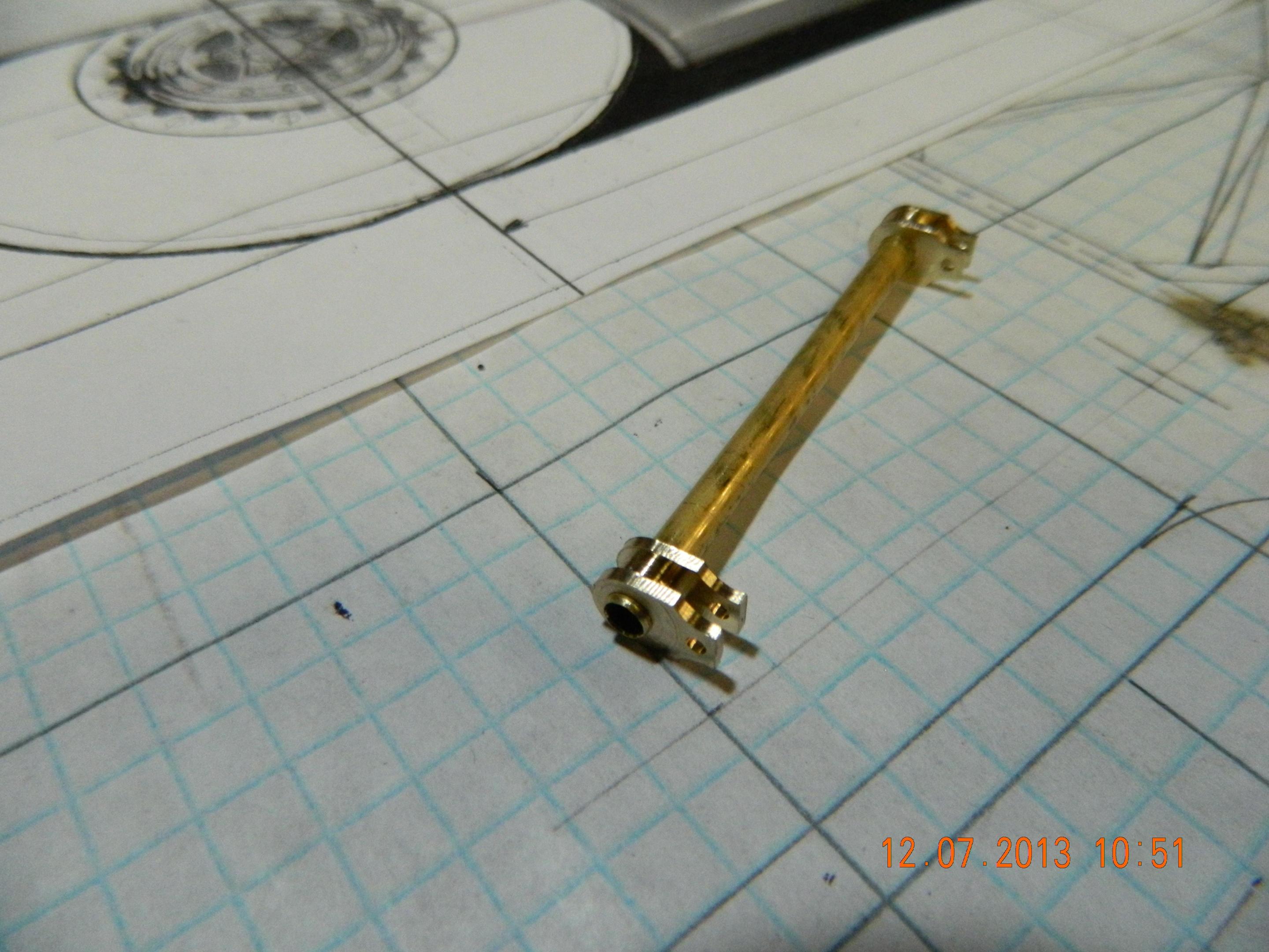

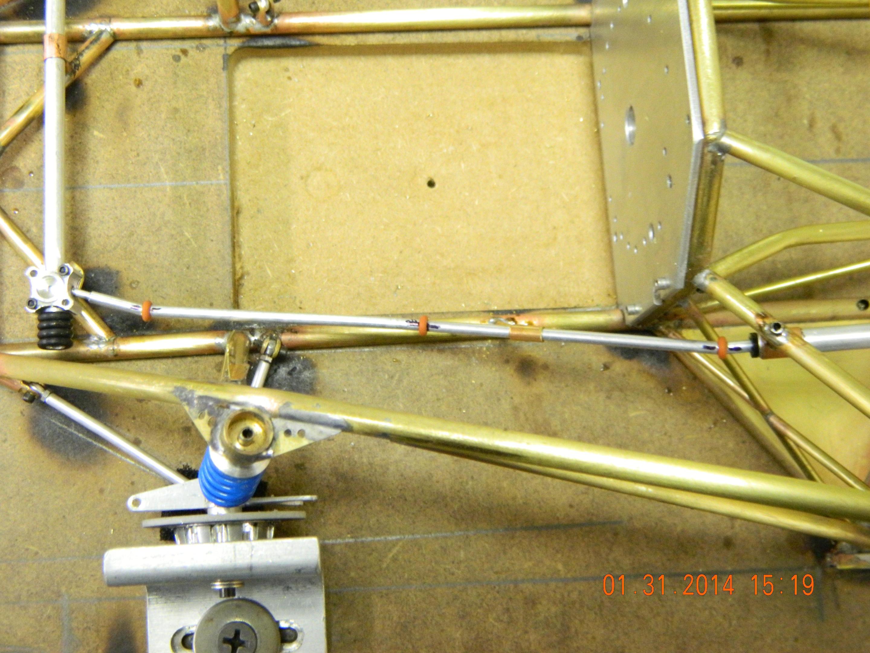

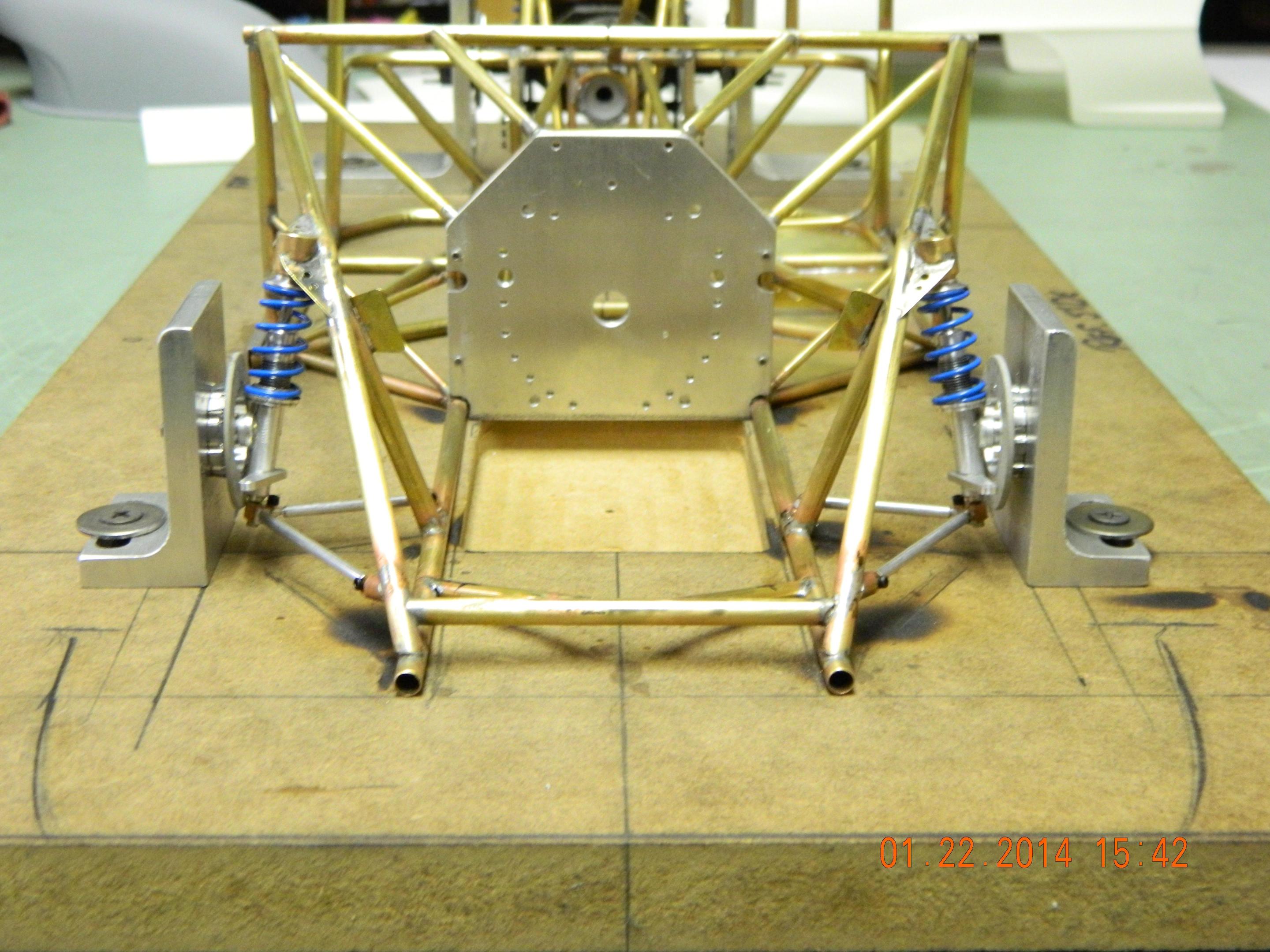

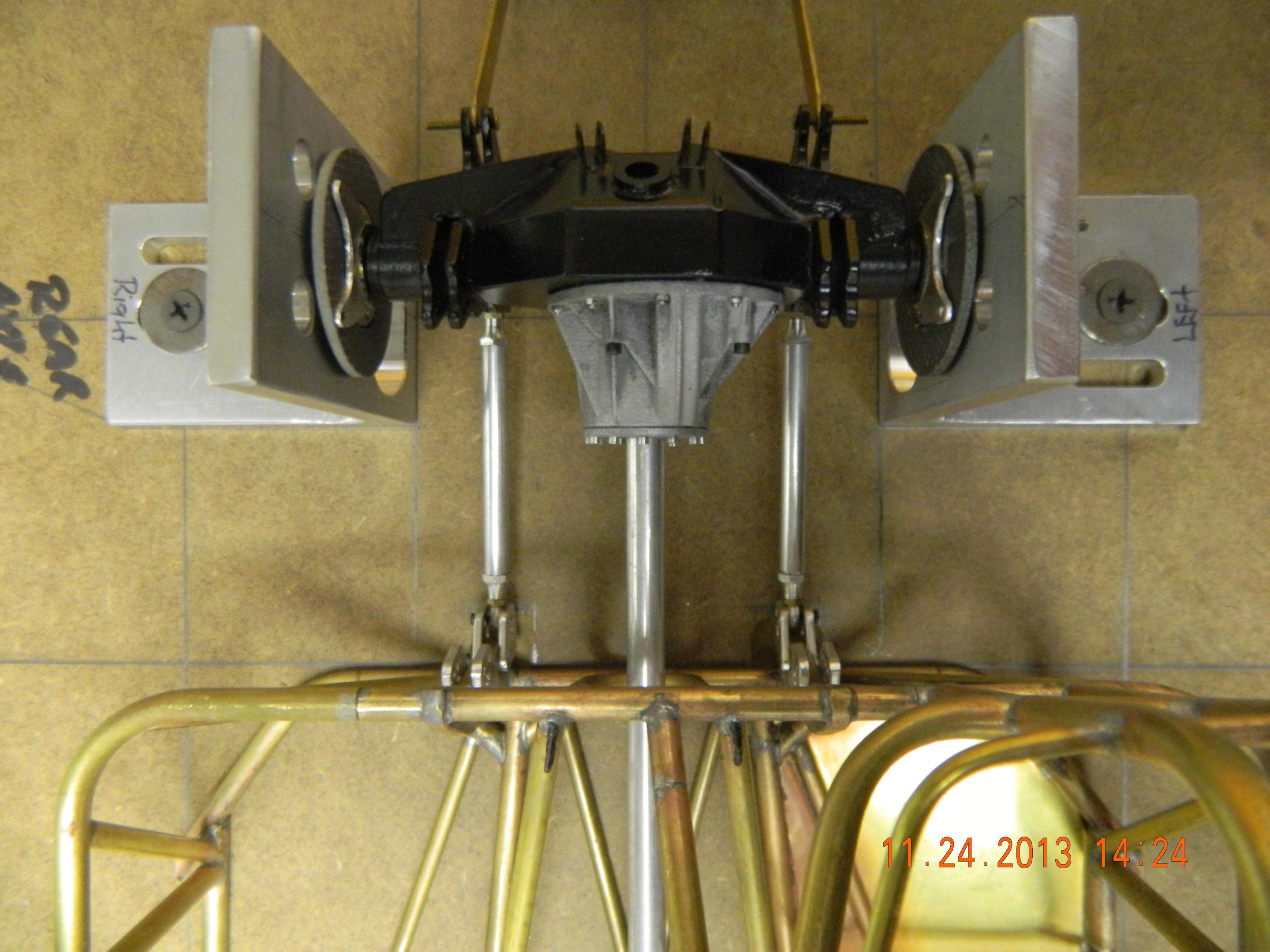

comp1839 Posted April 23, 2022 Author Posted April 23, 2022 rear and susp. i seem to have lost my photos of the rear housing assy. the entire rear is put together like a real one. each plate is a separate piece and soldered together. rear axle spindles are turned brass and soldered in place on a small fixture i made. 3

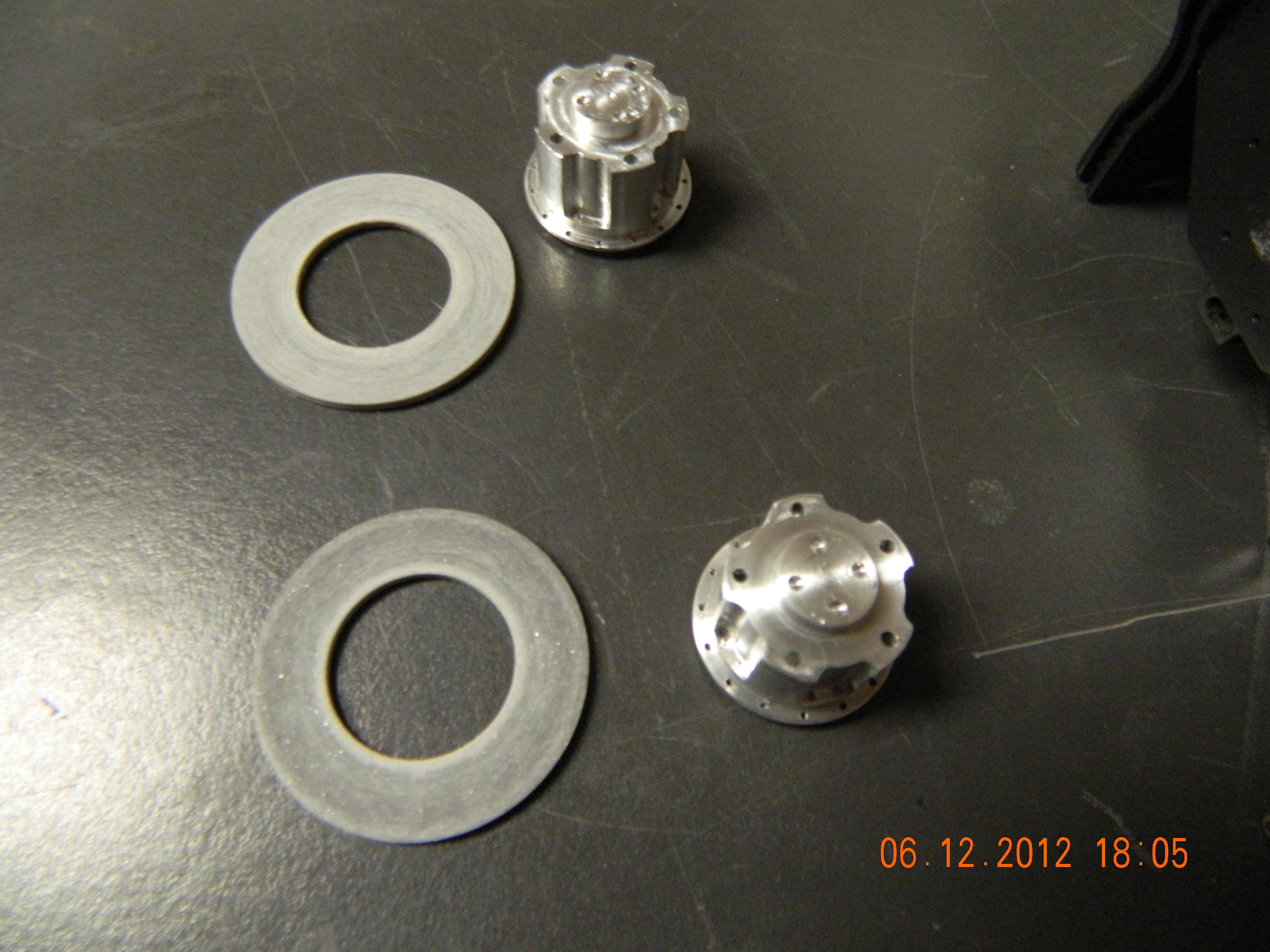

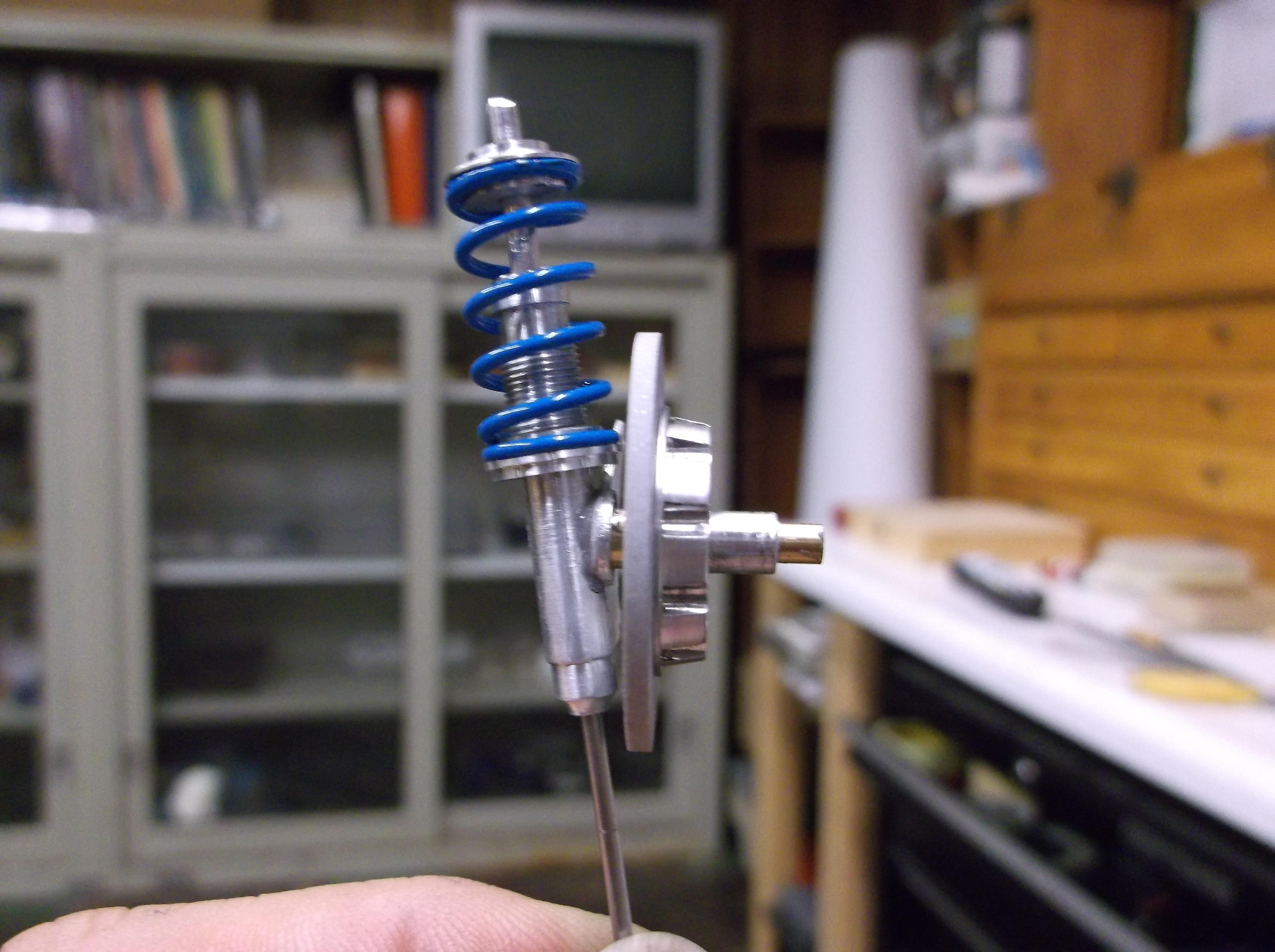

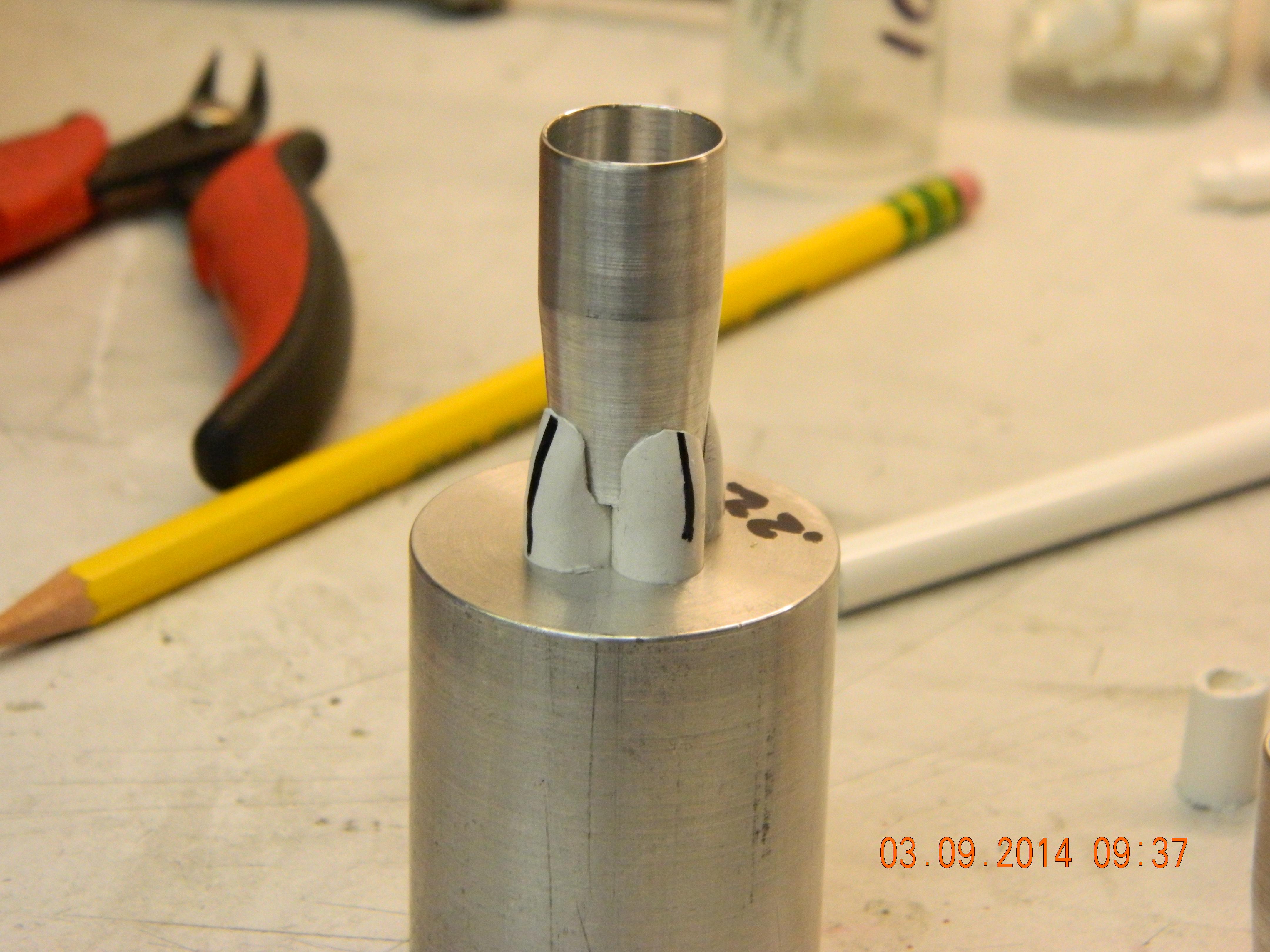

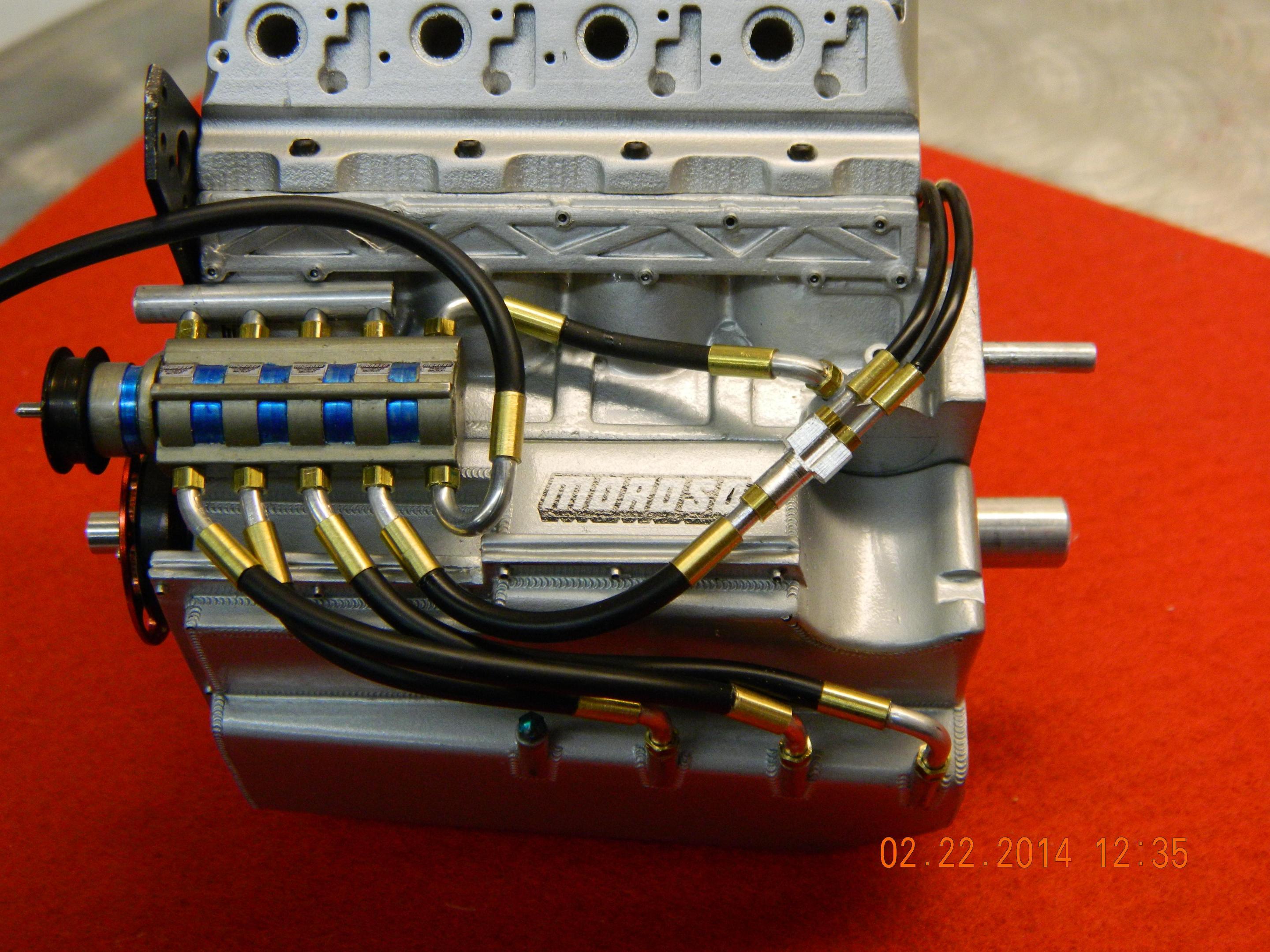

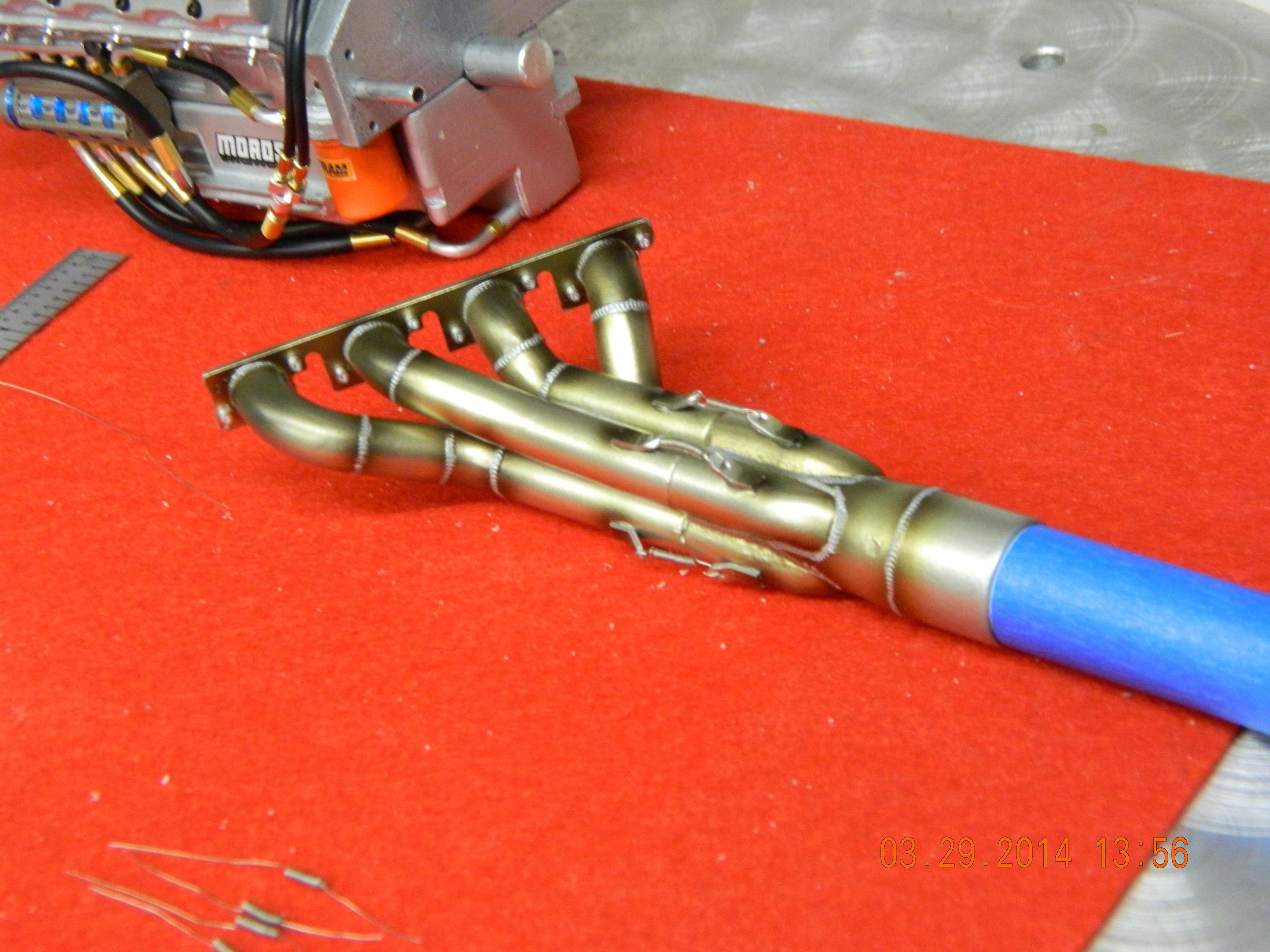

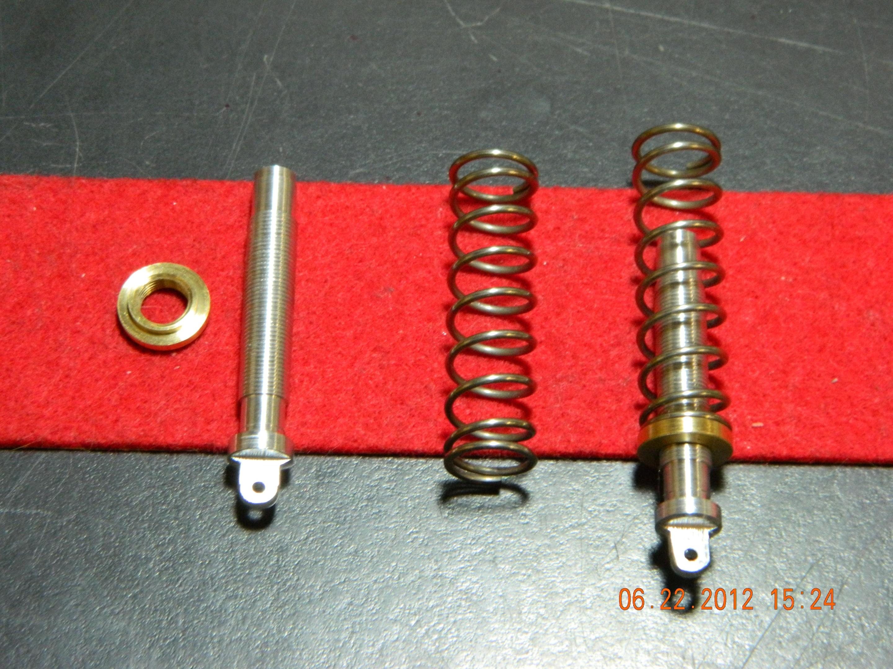

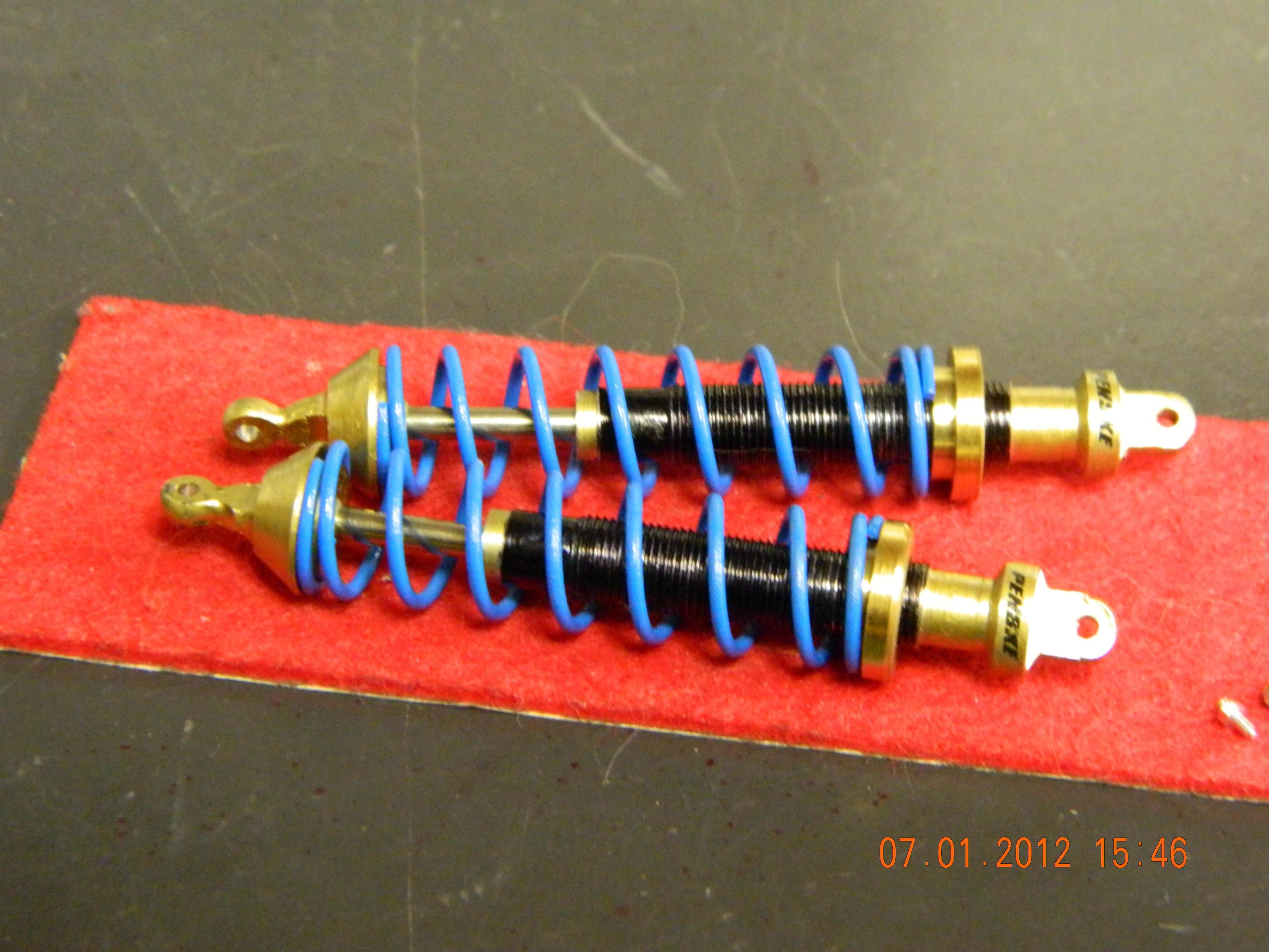

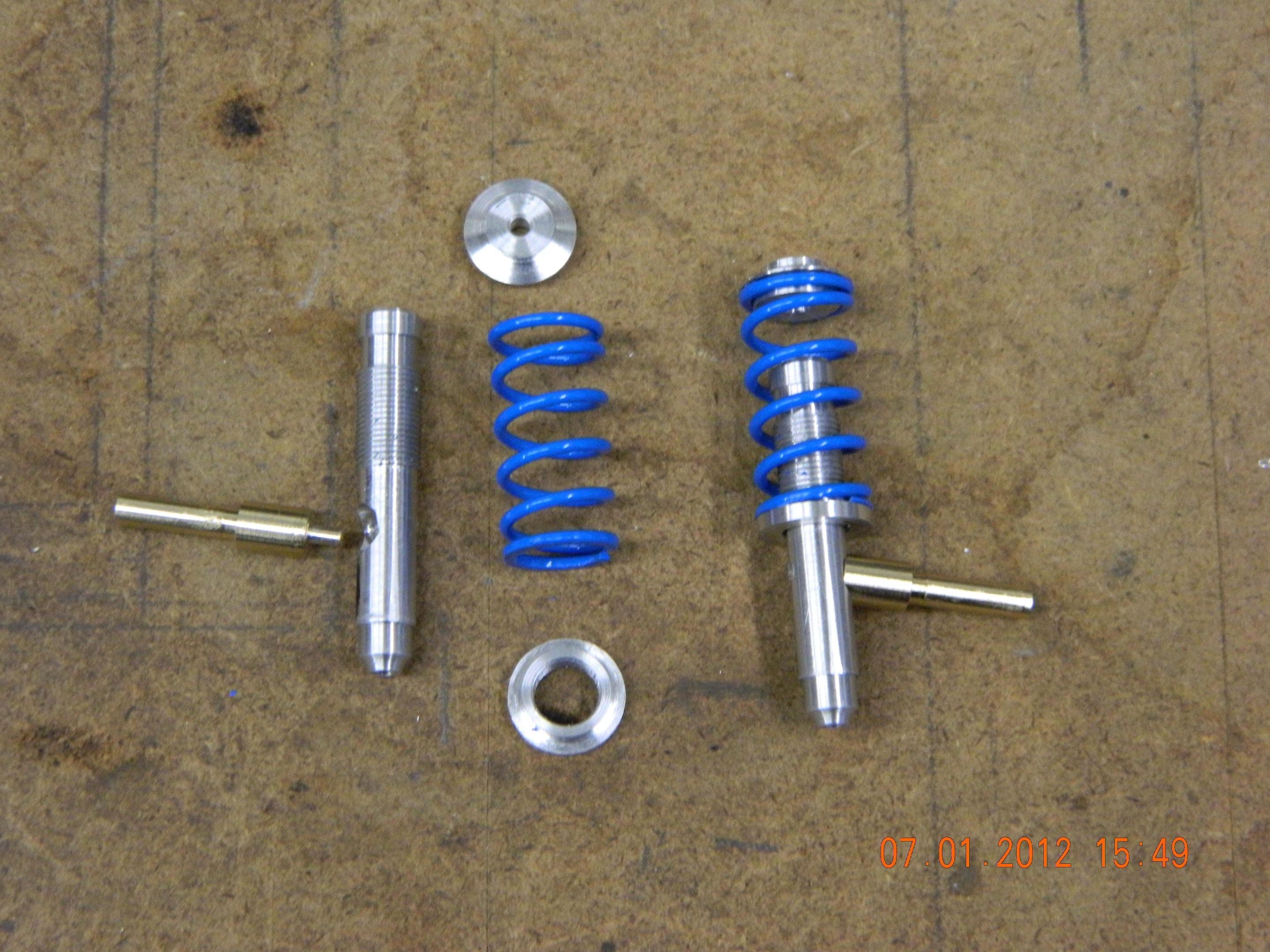

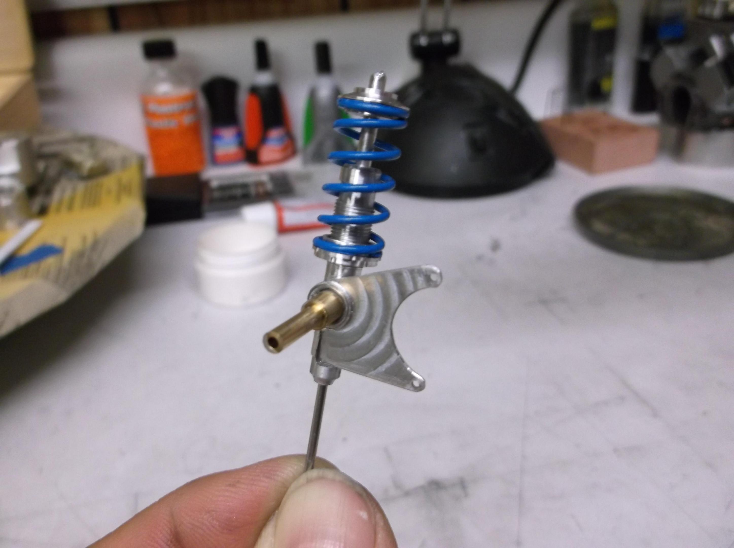

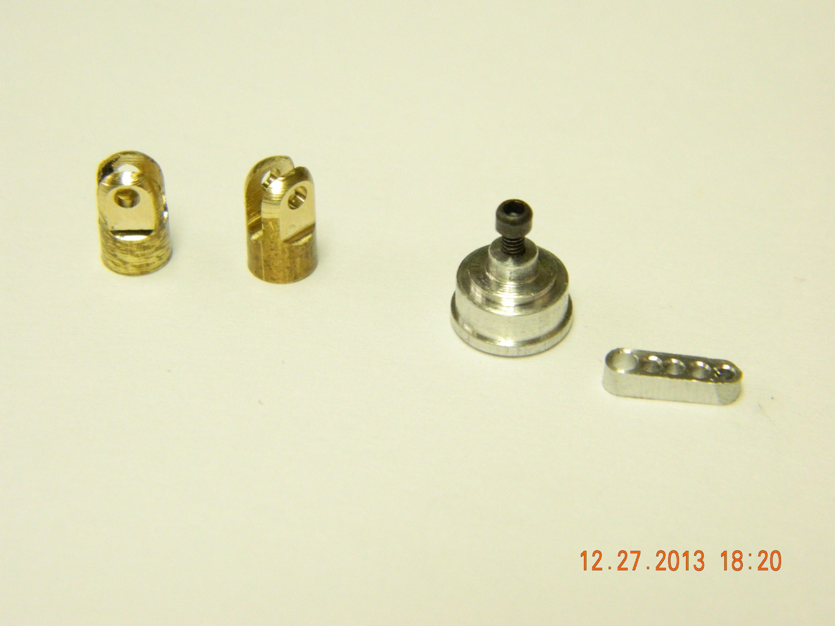

comp1839 Posted April 23, 2022 Author Posted April 23, 2022 (edited) here's some random parts. dry sump system / vacuum pump / frame clevis' and batt. shutoff/ upper rear shock mounts Edited April 23, 2022 by comp1839 2
Ralph Henderson Posted April 24, 2022 Posted April 24, 2022 Geez Dave, your scratch building chops are second too none...... Thanks for the tutorial....

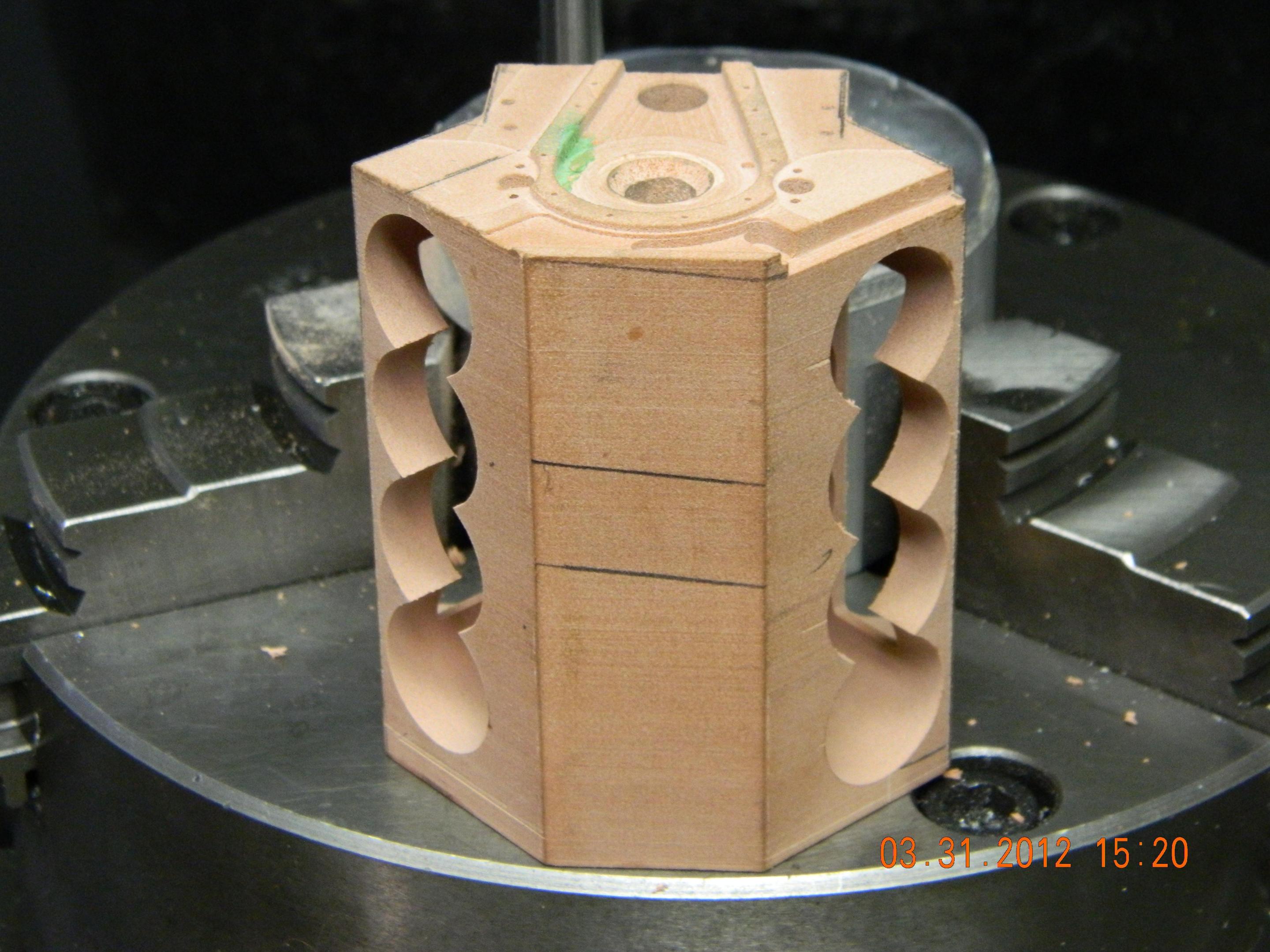

AmericanMuscleFan Posted April 24, 2022 Posted April 24, 2022 Thanks for showing us all these fantastic parts Dave, your attention to recreating the true details is unquestionable. ? I love the engine block machined in Renshape, one day I'll have to try this material if I can end up getting a small piece of it at a decent price...
comp1839 Posted April 24, 2022 Author Posted April 24, 2022 Francis, renshape is a treat to work with. i got so tired of breaking my small end mills on aluminum. it machines great, sands and files great. a little primer w/ filler and you're good to go. sent you a PM.

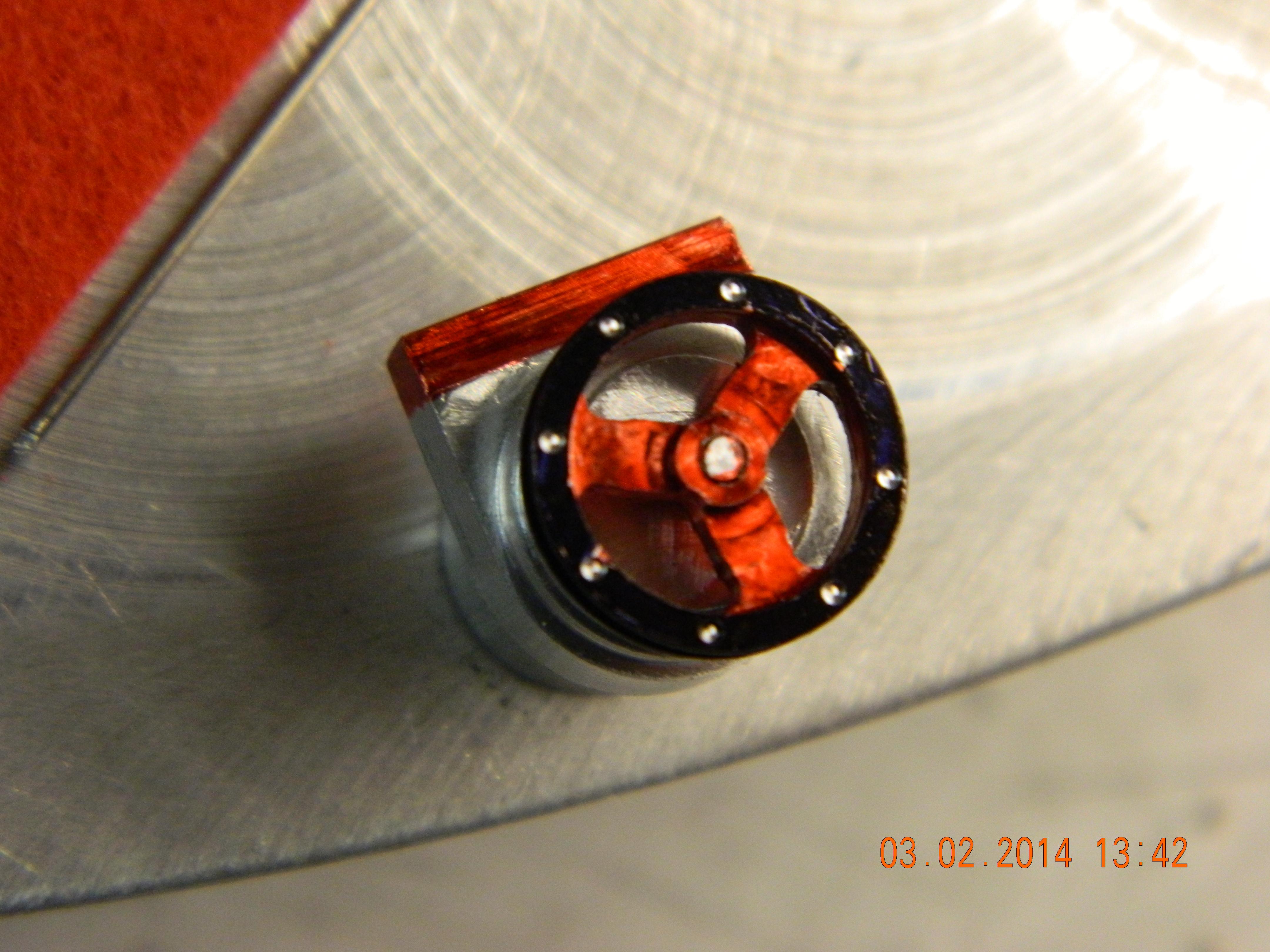

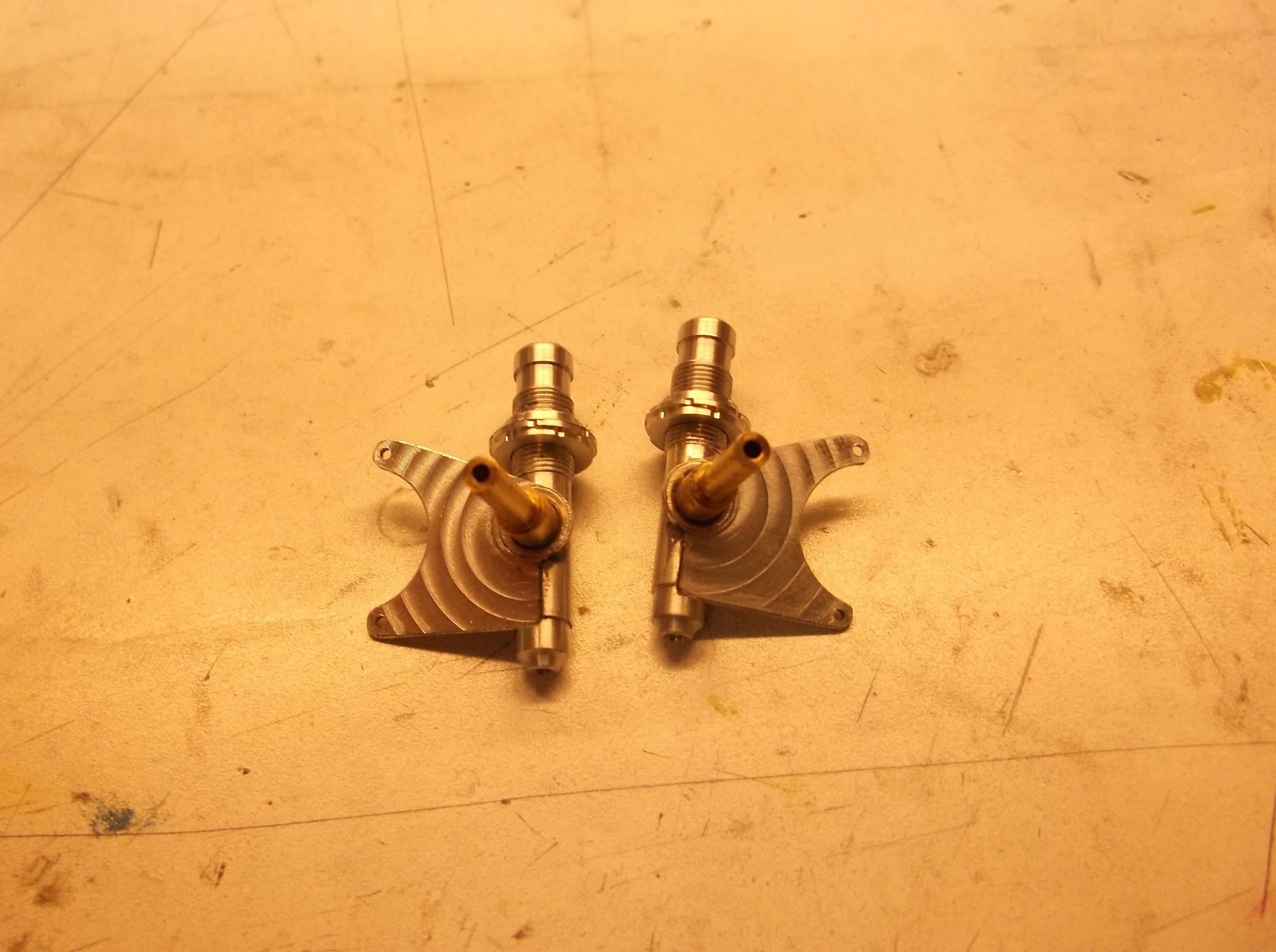

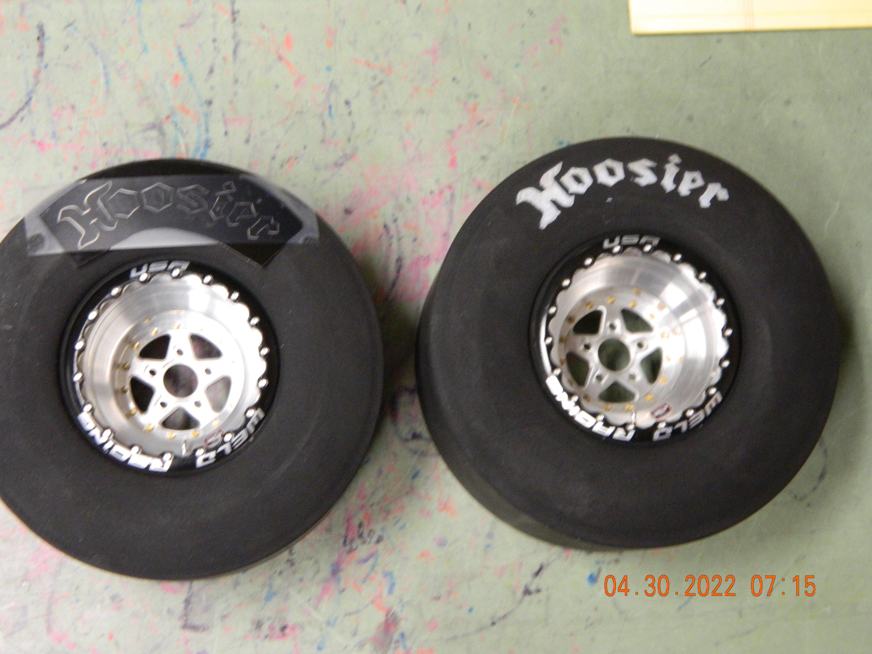

mr68gts Posted April 29, 2022 Posted April 29, 2022 On 4/21/2022 at 2:05 PM, comp1839 said: i promised to give some earlier shots of the camaro's build. if you want more details on any thing ...just ask. one of the parts i enjoy the most is doing the wheels. fronts are 15x3.5 spindle mounts and were black anodized and then machined. talk about pressure. zero room for error here. then the were the back wheels 16x16 double bead locks. i'm hoping the effort shows through. Couldn't imagine doing that in the mill. I have a cnc engraver sitting here I'm going to try out when I get to my beadlocks. See how well it works. Its designed for pet tags and many other things so it shouldn't be a problem with the anodize and with a 12"x12" table, it's big enough for my uses!

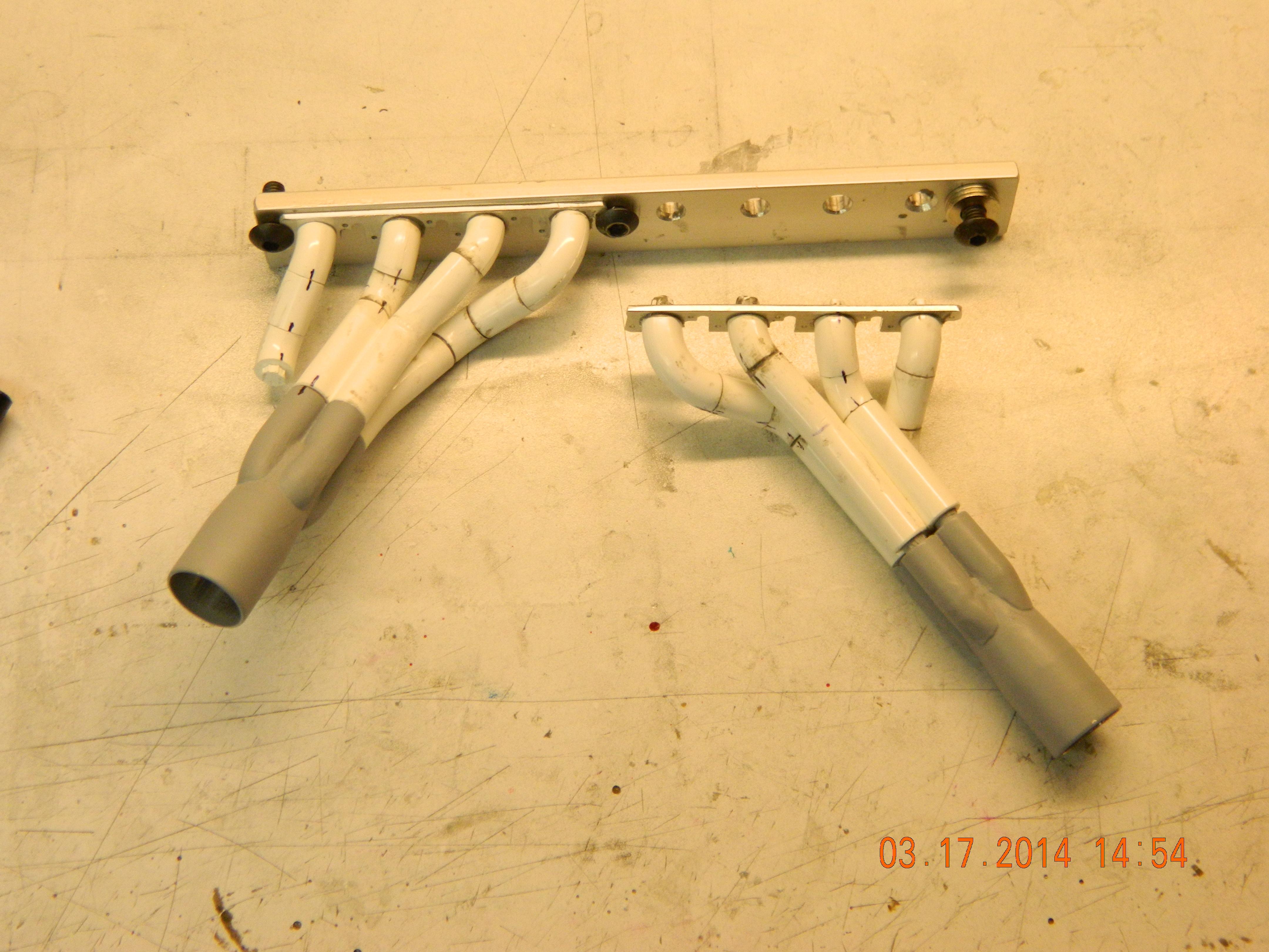

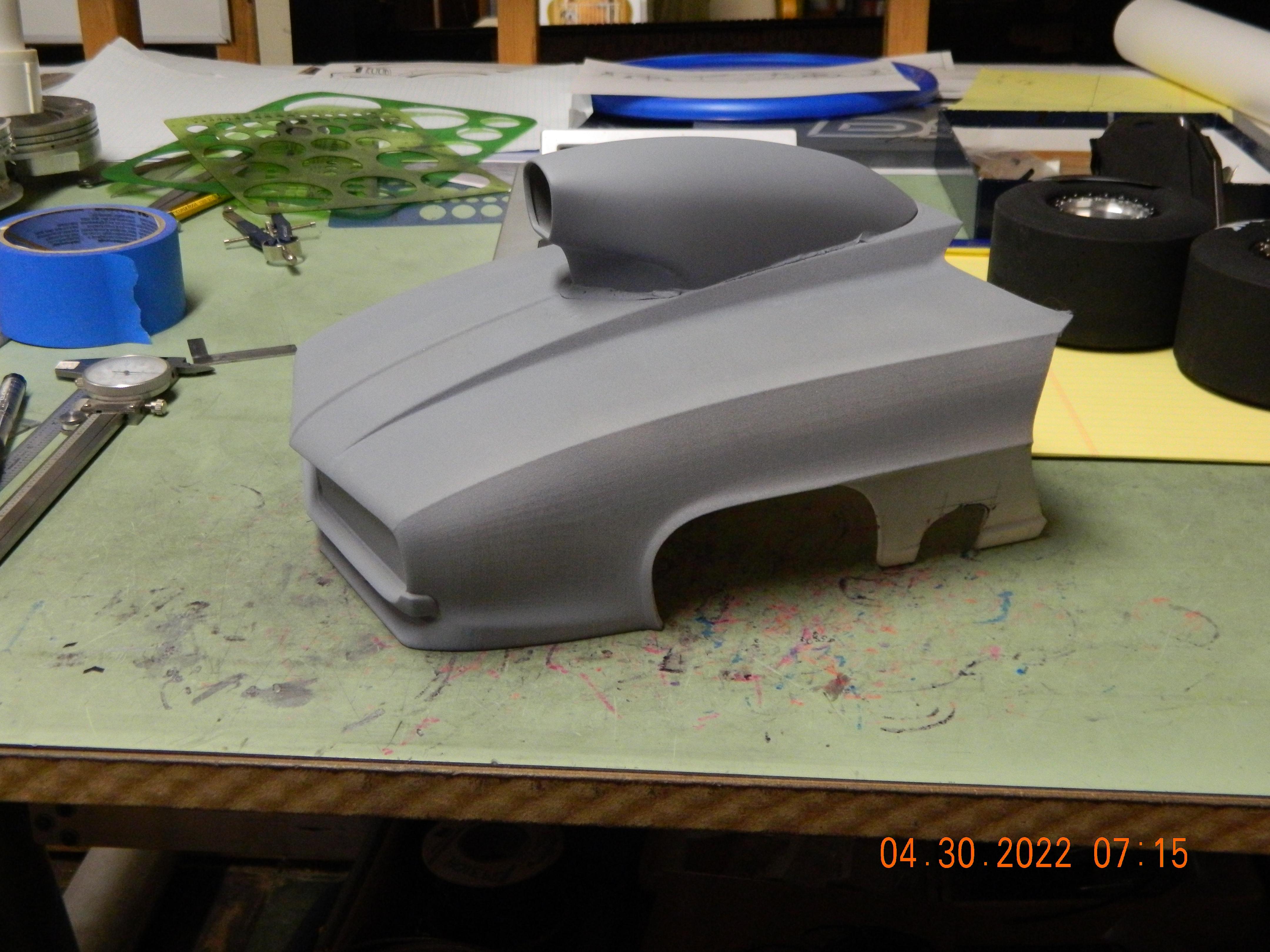

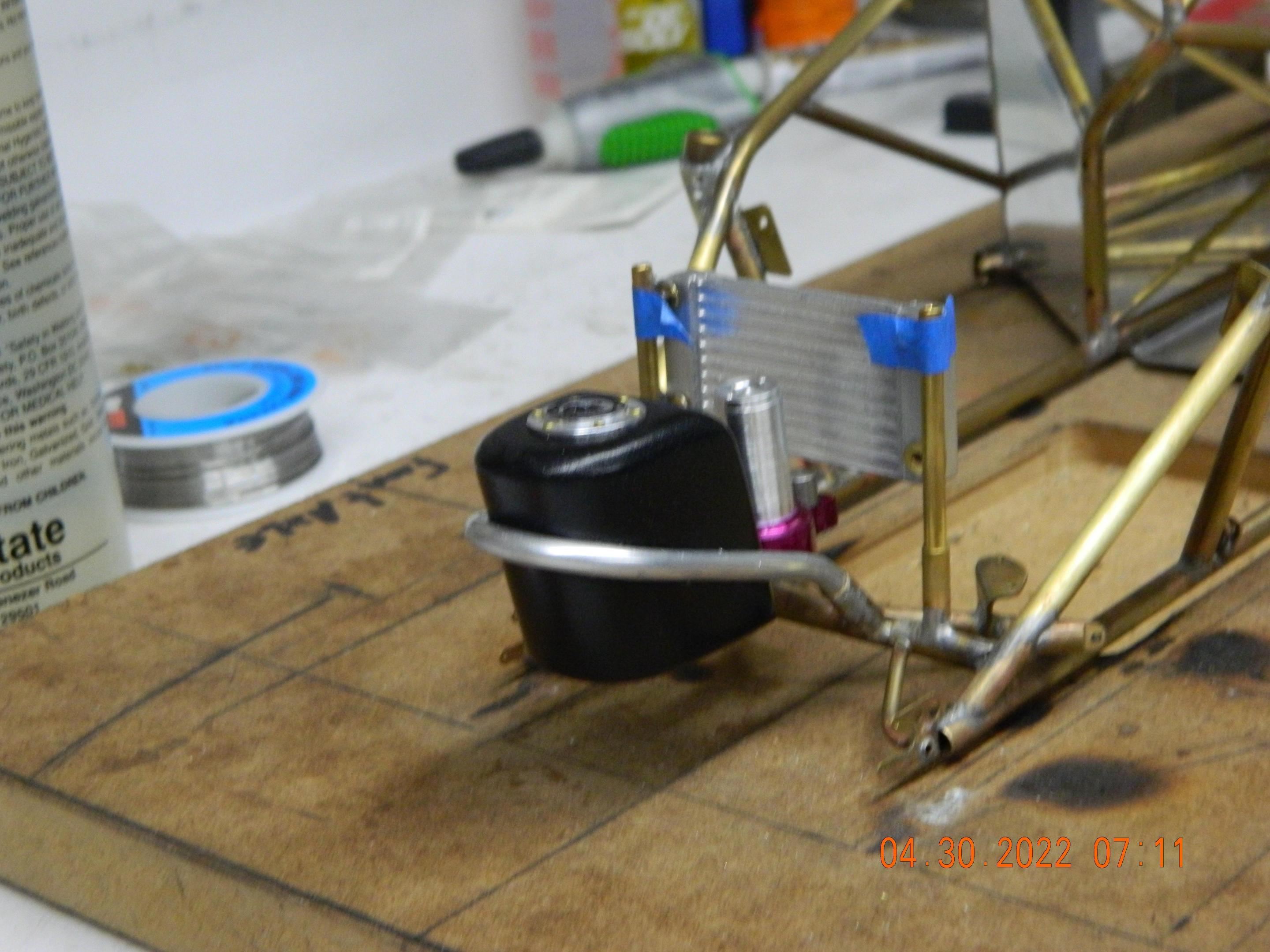

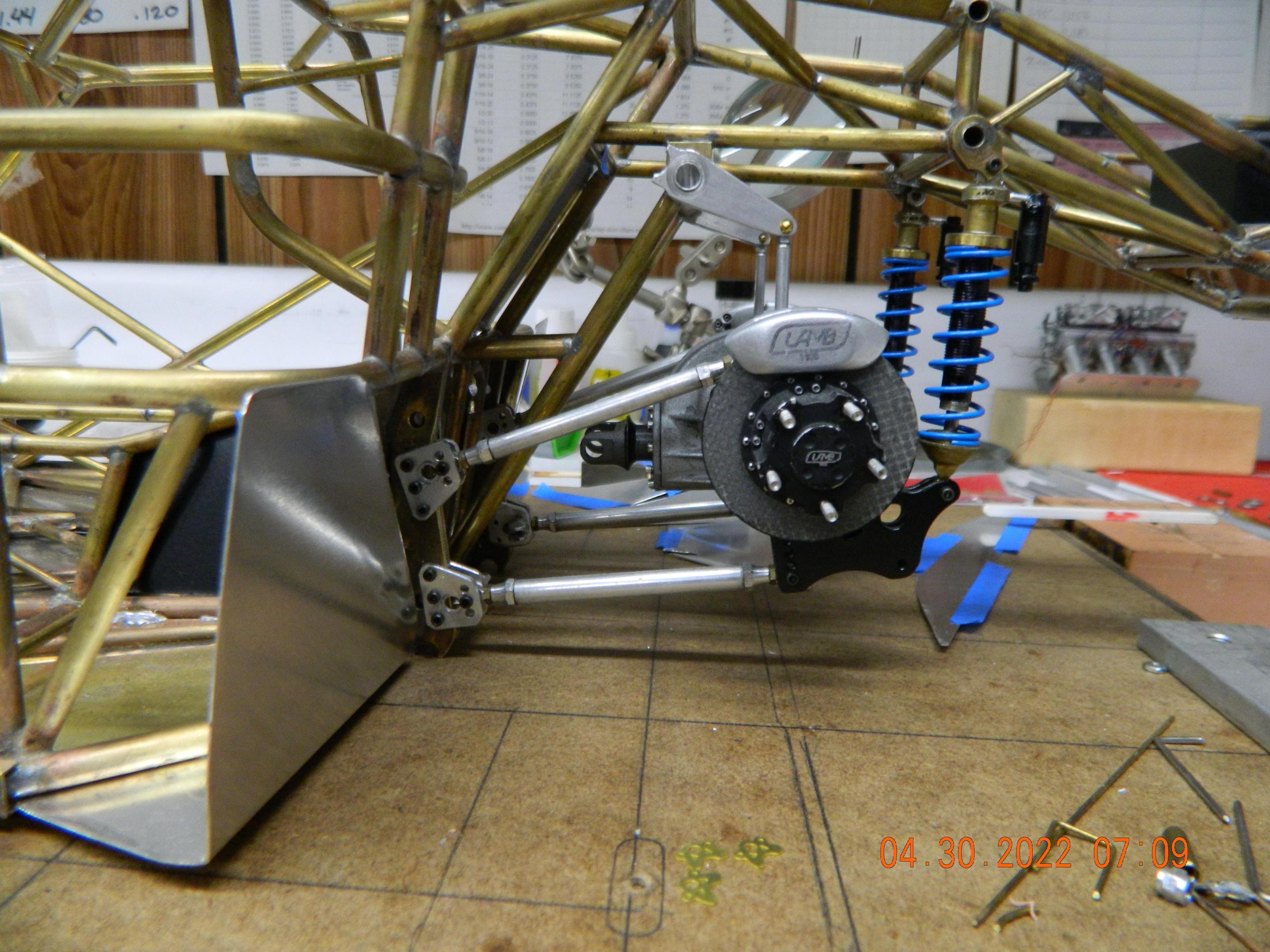

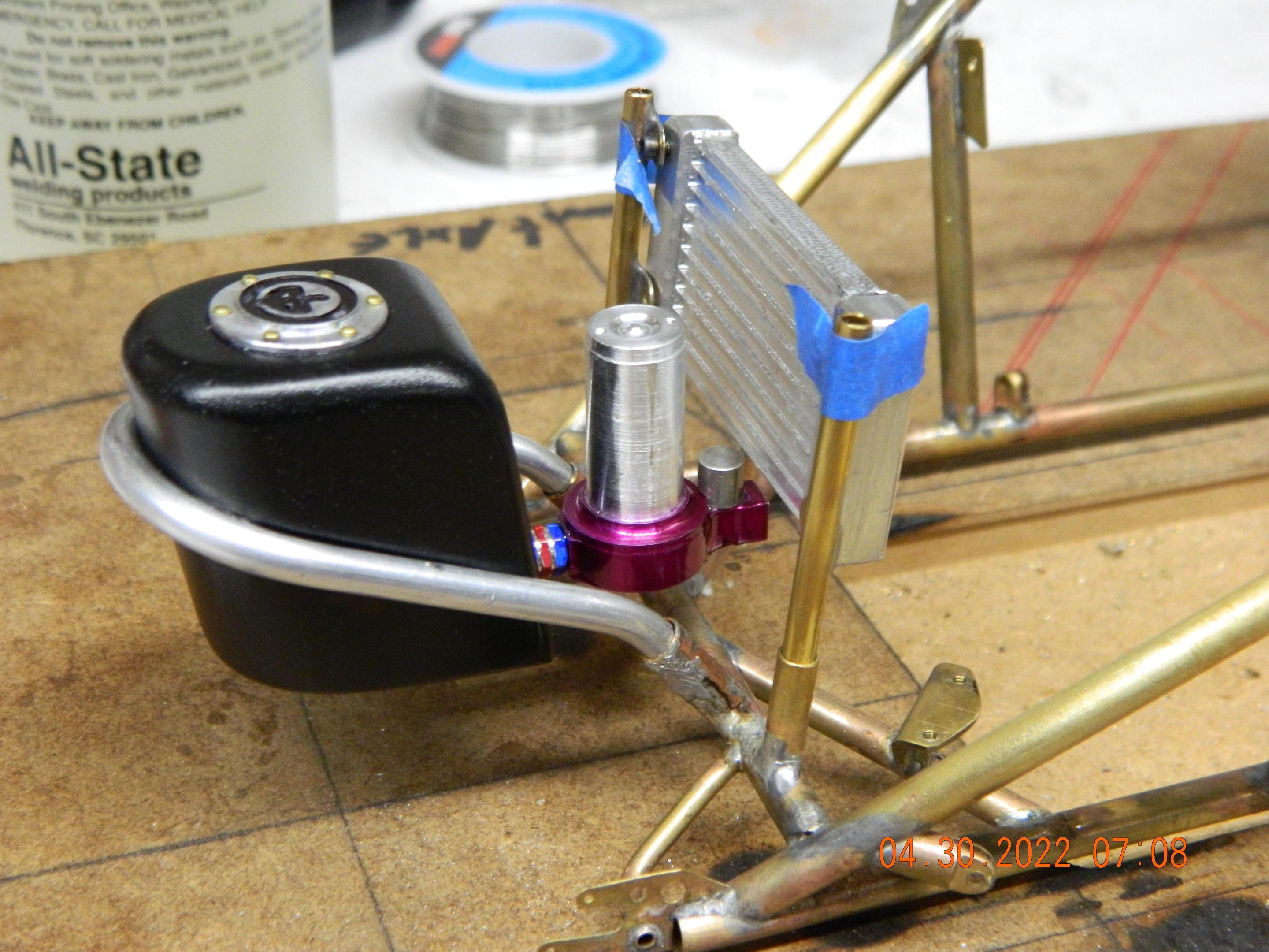

comp1839 Posted April 30, 2022 Author Posted April 30, 2022 (edited) so, i got some more stuff done. i'm working a lot faster than normal. some of the details may or may not get put into the car. i'm just really dis appointed in the thickness of the body and i don't want to put an extreme amount of effort into a build that, in the end, will not look right with body that is 1" thick in scale. any way.... fuel system plug wires more interior panels fire bottles hoosier mask bonded the scoop to the body Edited April 30, 2022 by comp1839 3
