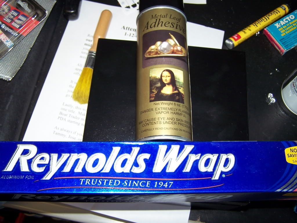

tuffone20 Posted January 15, 2009 Share Posted January 15, 2009 Here is a photo of the can Mona Lisa adhesive I picked up. Quote Link to comment Share on other sites More sharing options...
