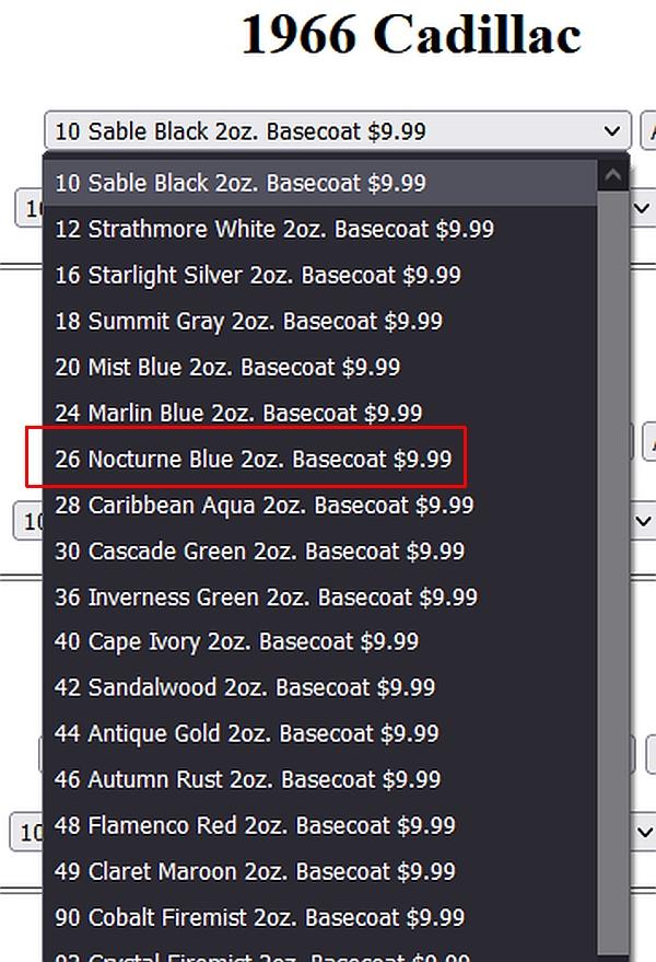

Scale Finishes has GM Code 26 Nocturne Blue, 2 oz. @ $9.99. Paintscratch.com also has Nocturne Blue Poly available (1 oz bottle @ $16.95 and 2 oz. @ $26.95).

I included the paint code in my post. The GM/Cadillac color code for Nocturne Blue is 26. A custom paint from MCW will cost $18.00, twice as much as the paint from ScaleFinishes,com, more than the 1 oz. bottle and almost as much as the 2 oz. bottle from Paintscratch.com.

Oy vey! Why even bring up that ScaleFinishes has Danube Blue when It has been confirmed that Nocturne Blue is available. I said as much in my post:
Quote
Edited by SfanGoch
Just to eliminate any confusion, 1966 Cadillac, Code #26 "Nocturne Blue",  GM code WA3503, Ditzler PPG code 13149, Dupont code 4718L, 181-97687........all the same color.  :)
