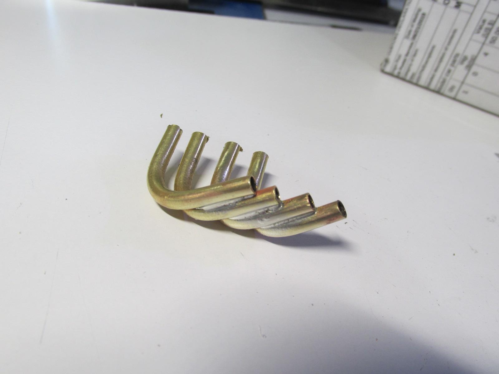

After the last set of zoomies I built I swore that I would not build another set!  This thing just won't leave me alone. Every day when I think I can  begin assembling parts I notice an area that just doesn't measure up to some of the things that are already started and or being finished off.  Headers case in point, brass 2 1/2 inch with thermocouples than go with the electronics suite.  Just nailing the lengths and radius required to clear the body side skirts

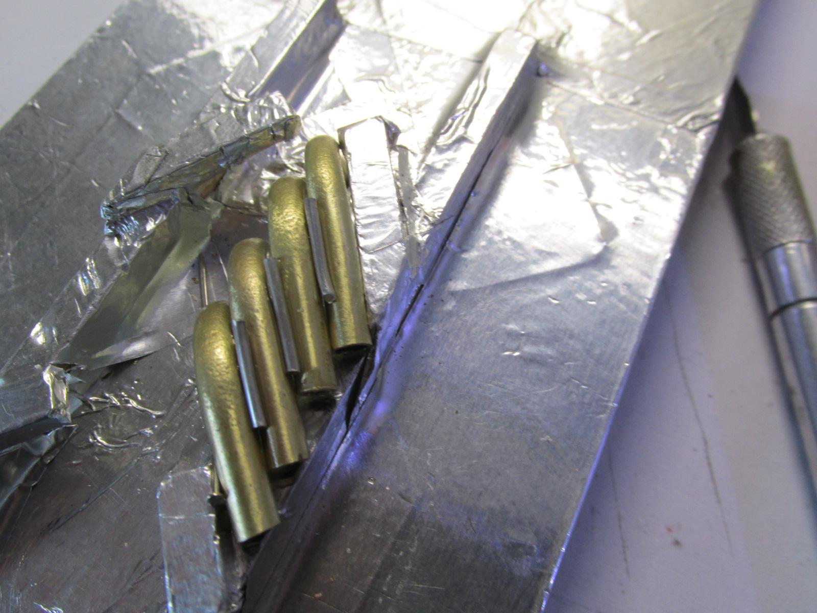

Well the zoomies are official.  Photos show the jig I made up to build them. tube sitting in the jig with the solder sitting between the tubes.  Heat the whole thing with a Butane torch and you have these.

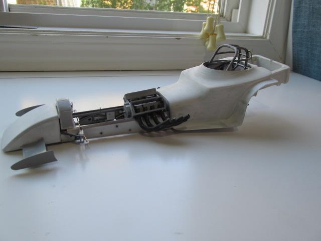

Headers have the thermocouple holes drilled and the outer braces installed, Headers painted, engine position finalized so that the engine clears the body when it is lowered and the headers clear the body when opening. test fit of the thermocouples.

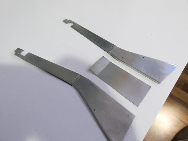

Progress today, All of the aluminum panels car cut and fitted. Just need the fastener holes drilled in the panels and the plates mounted on the chassis. Then the panels will be test fitted and if that goes well, I will apply the self etching primer to make sure the paint really sticks to the aluminum as there is going to be a lot of masking required on this one. Front rotors and calipers are painted and lines fitted, just have to build a dual reservoir master cylinder. Scratch built dash is ready for paint and gauges. Most of the switches are mounted and the wiring can be completed.

Tin mounting holes drilled in panels, dzus plates mounted on chassis, waiting for adhesive to cure before drilling matching holes for panels and profiling the plates.

Drivers compartment tin now located, all three pieces. Front sections now installed and trimmed, just have to finish profiling the chassis plates. The panels can now be removed, replaced and worked on without damage to them or the chassis. They will also be removeable for display purposes.563318797_IMG_0032(1).JPG.8eb3d22e65f7206cf800f6e5c4339407.JPG

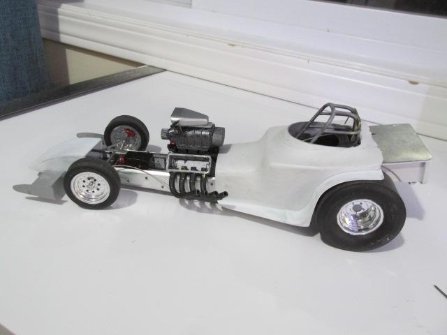

Regrouped from this afternoon and took all of the major sub assemblies and made sure they still fit. Fuel tank/rad is off getting modified for better fit and also getting some bling added,14-71 shown is just a place holder unless I put a bag on it (not wasting a perfectly good 14-71 if you can't see most of it) If Scott gets me the blower retainer plate, I have a very nice fully detailed 14-71 to use as well as an updated hat. You can see the front rotors and calipers in place as well. From this point forward it's basically clean up, add detail, get out the airbrush and start to finish this one off.
