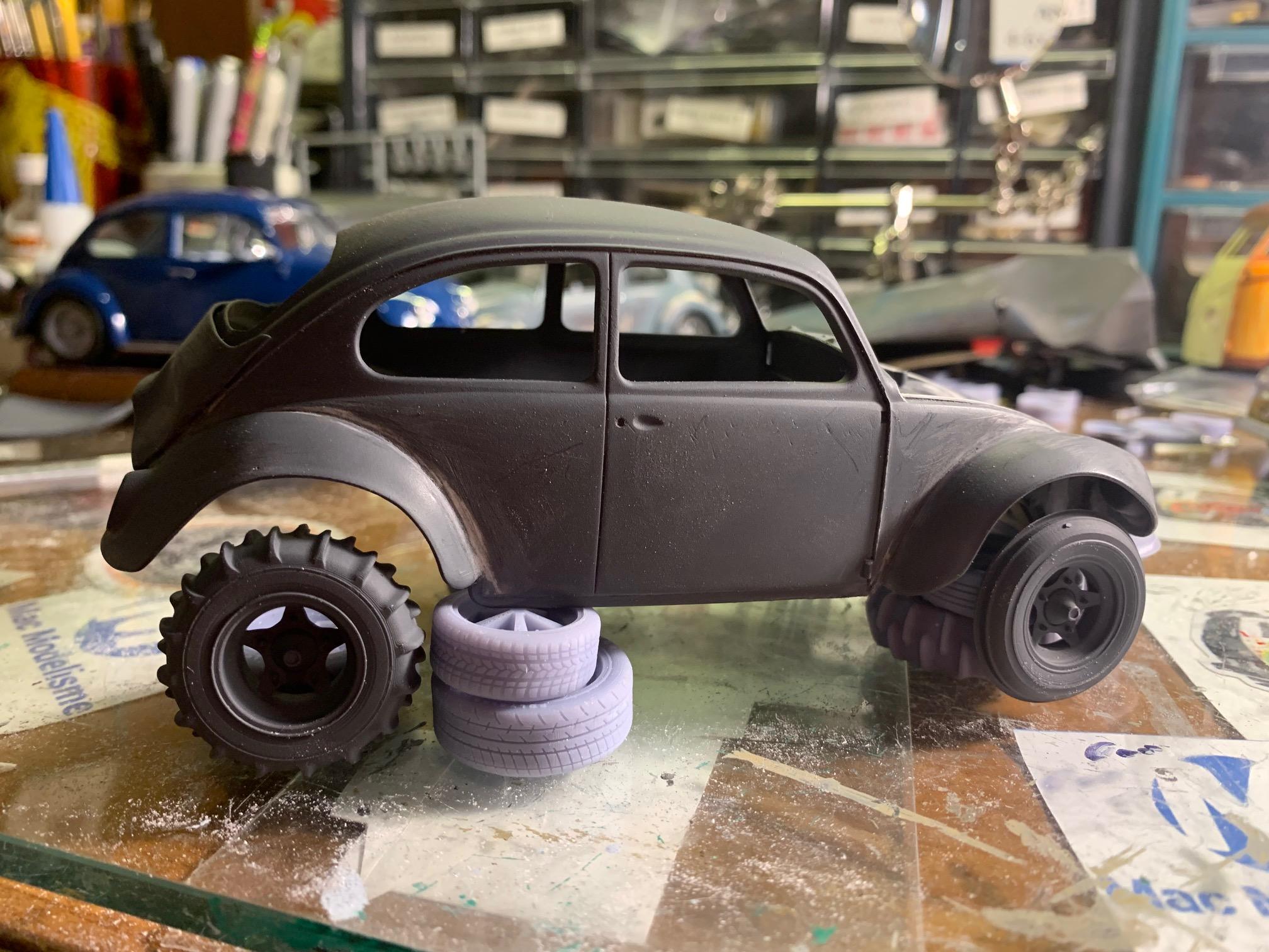

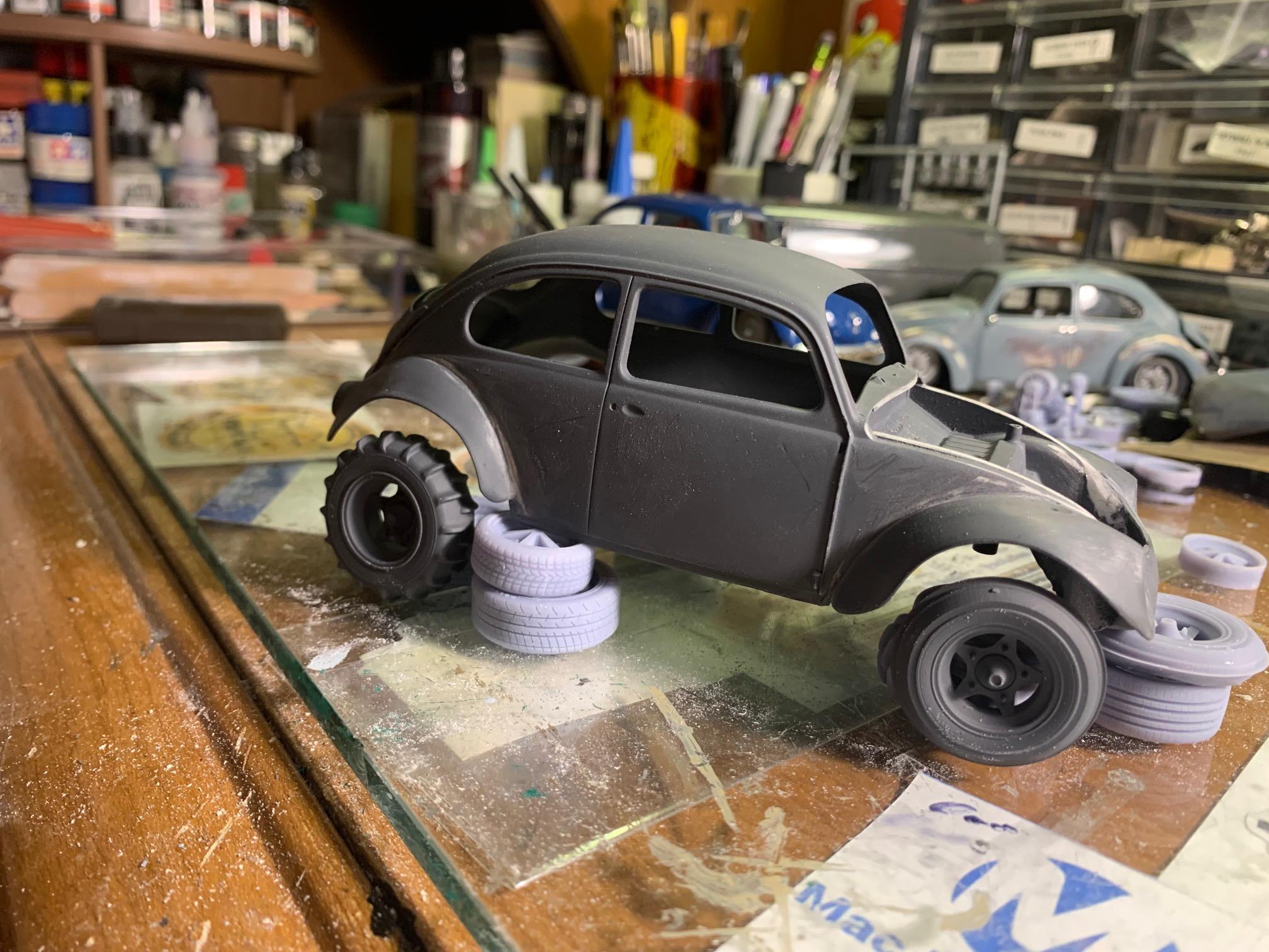

Texas_3D_Customs Posted September 24, 2022 Posted September 24, 2022 So here's where I am. Suspension done with only one small change to make with the front toe, I am not sure who committed me to a stinger exhaust but perhaps but not today. 20220924_163222.mp4 4

Texas_3D_Customs Posted September 26, 2022 Posted September 26, 2022 So after looking at these close ups I am not worried about my rear cover at all. Its so makeshift that just getting close enough is really all it ever was

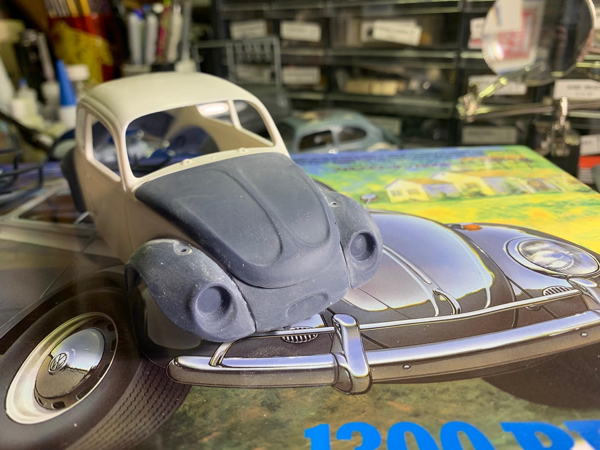

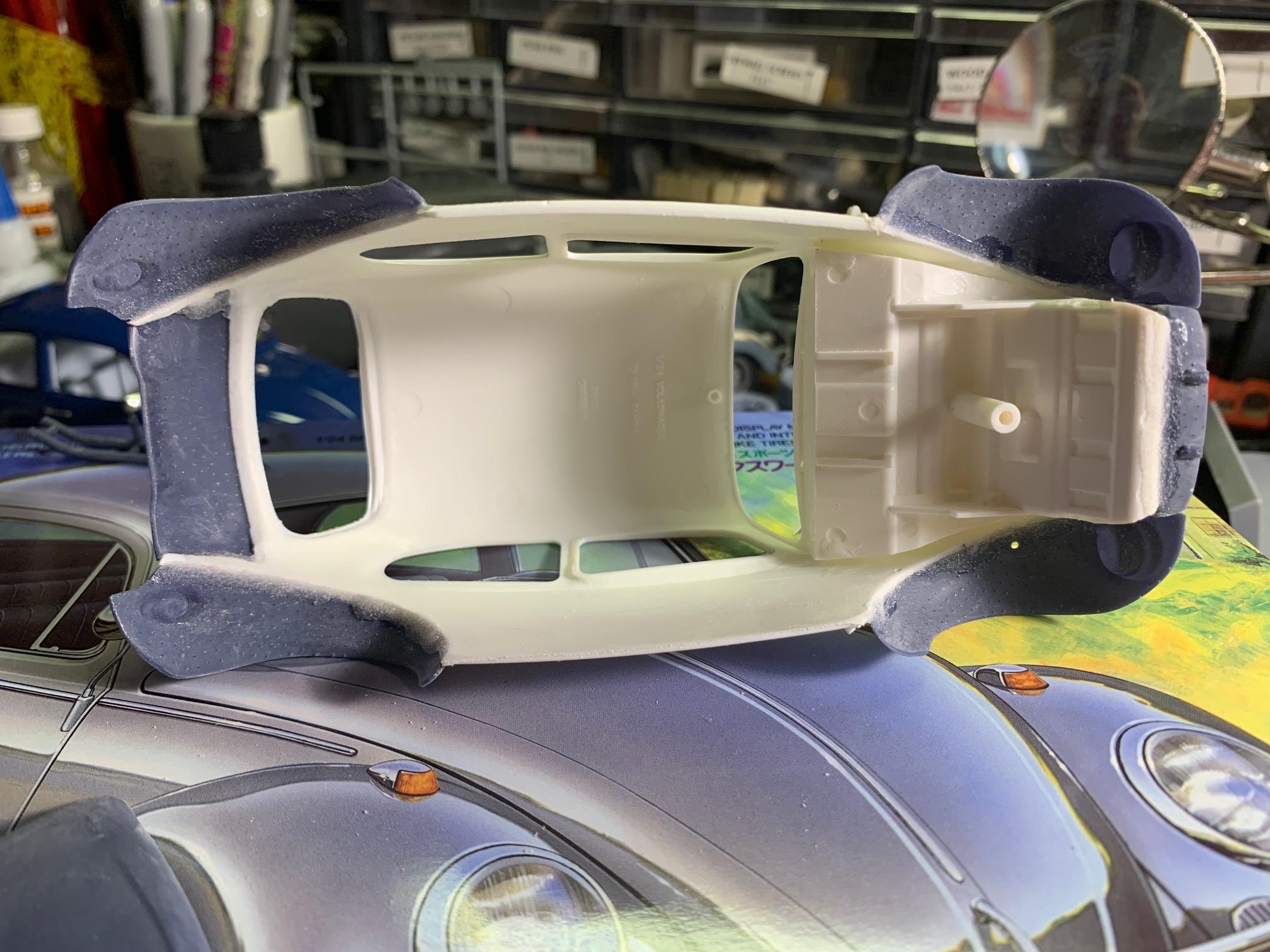

Finks Garage Posted October 24, 2022 Posted October 24, 2022 (edited) I got some bench time this past weekend and worked the kit onto a Tamiya Bug. I choose it as it gives me the option to detail under the bonnet and to use the Blackbox 3d printed motor and transmission. Took a little work to get the fenders to fit in the front, sanding and shaping, as well as the back fenders. The biggest adjustment came to the engine cover. I had to narrow it on each side to line up proper on this body. Easily done, and anyone who has done any sort of scratch building/modifying can do this. I think in all from cutting off the fenders of the plastic kit to adjusting the 3d parts to gluing them on was less than an hour total. The photo with it in primer is with 1 coat of spray can primer to see how thinks lined up and look. I have been mocking up/modifying suspension height on this and have printed a set of one-off directional sand tires for the rear and skinny balloon style tires for the front with a set of my Jackman rims. I will keep posting here as progress is made. Great transkit from Texas 3d Custom/Charles, much needed in the VW builder's community! Thanks!! Edited October 24, 2022 by Finks Garage 2

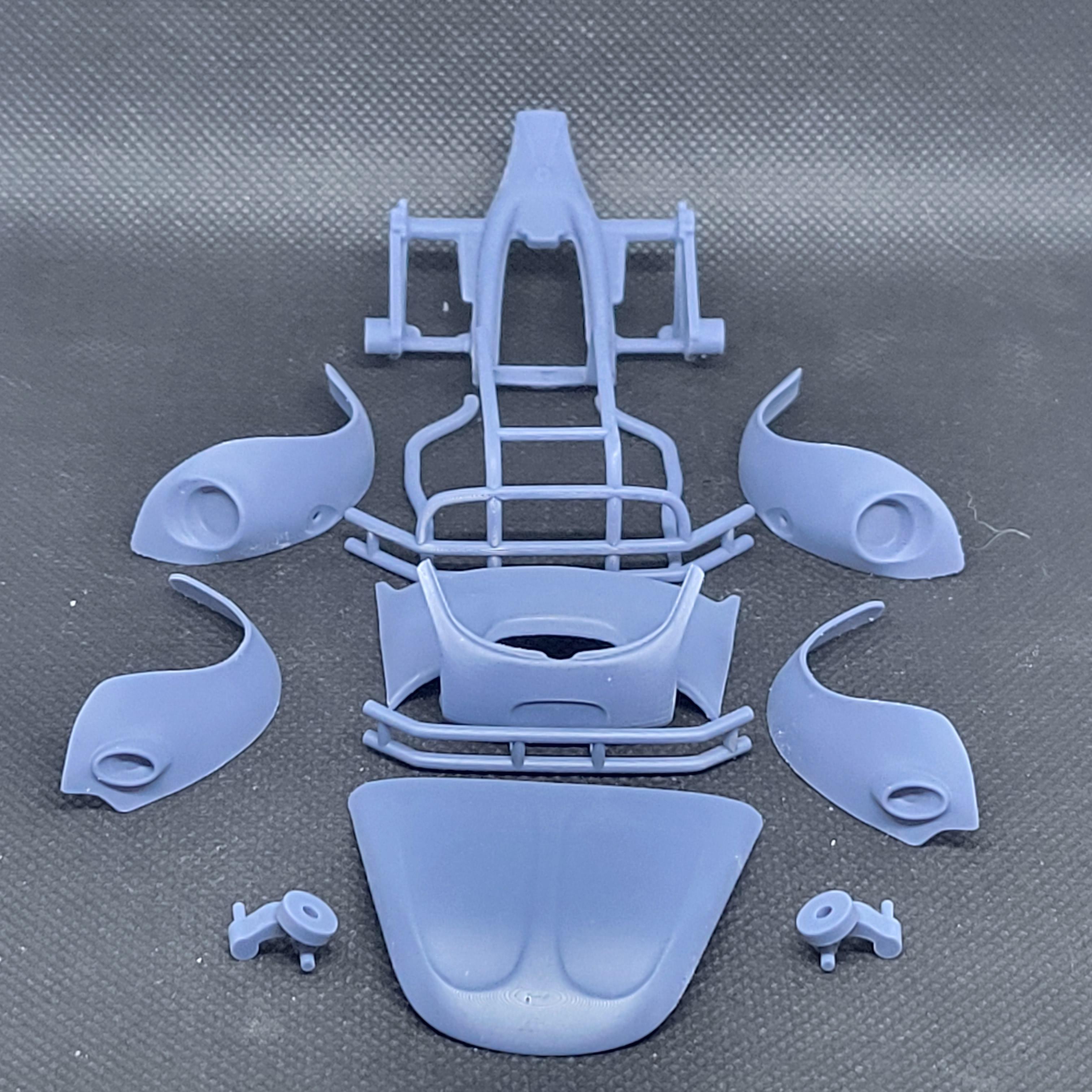

Texas_3D_Customs Posted June 9, 2023 Posted June 9, 2023 So really long time since this all started but I finally finished up the Narrow Eye version, hard to do new stuff and fulfill all my orders and take care of normal life, but its on my site and heres a picture of the parts. 5

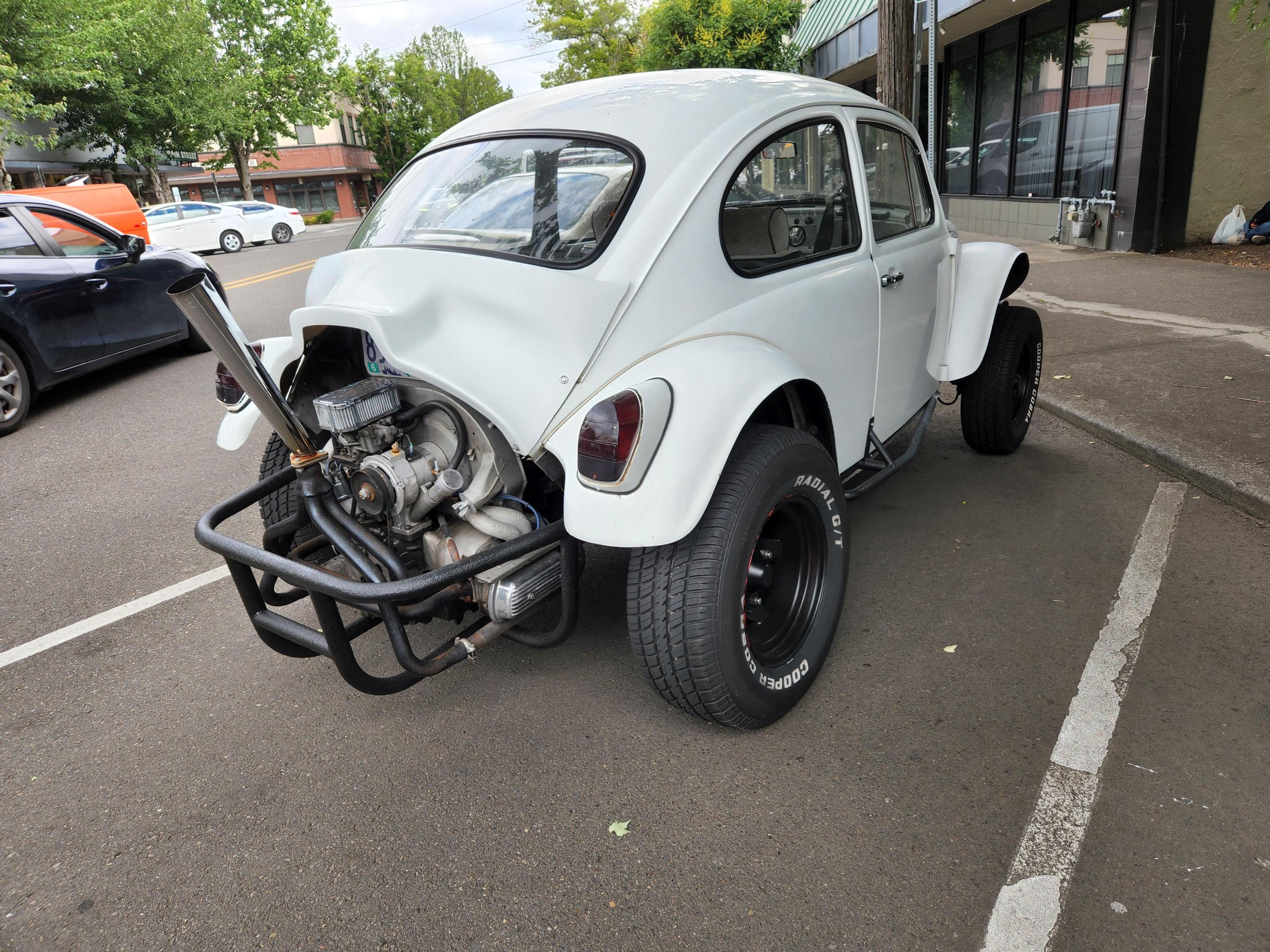

espo Posted June 9, 2023 Posted June 9, 2023 4 hours ago, Texas_3D_Customs said: So really long time since this all started but I finally finished up the Narrow Eye version, hard to do new stuff and fulfill all my orders and take care of normal life, but its on my site and heres a picture of the parts. I'll be wanting one of these kits to recreate my old Baja from when I lived in the Pismo Beach area. 2
