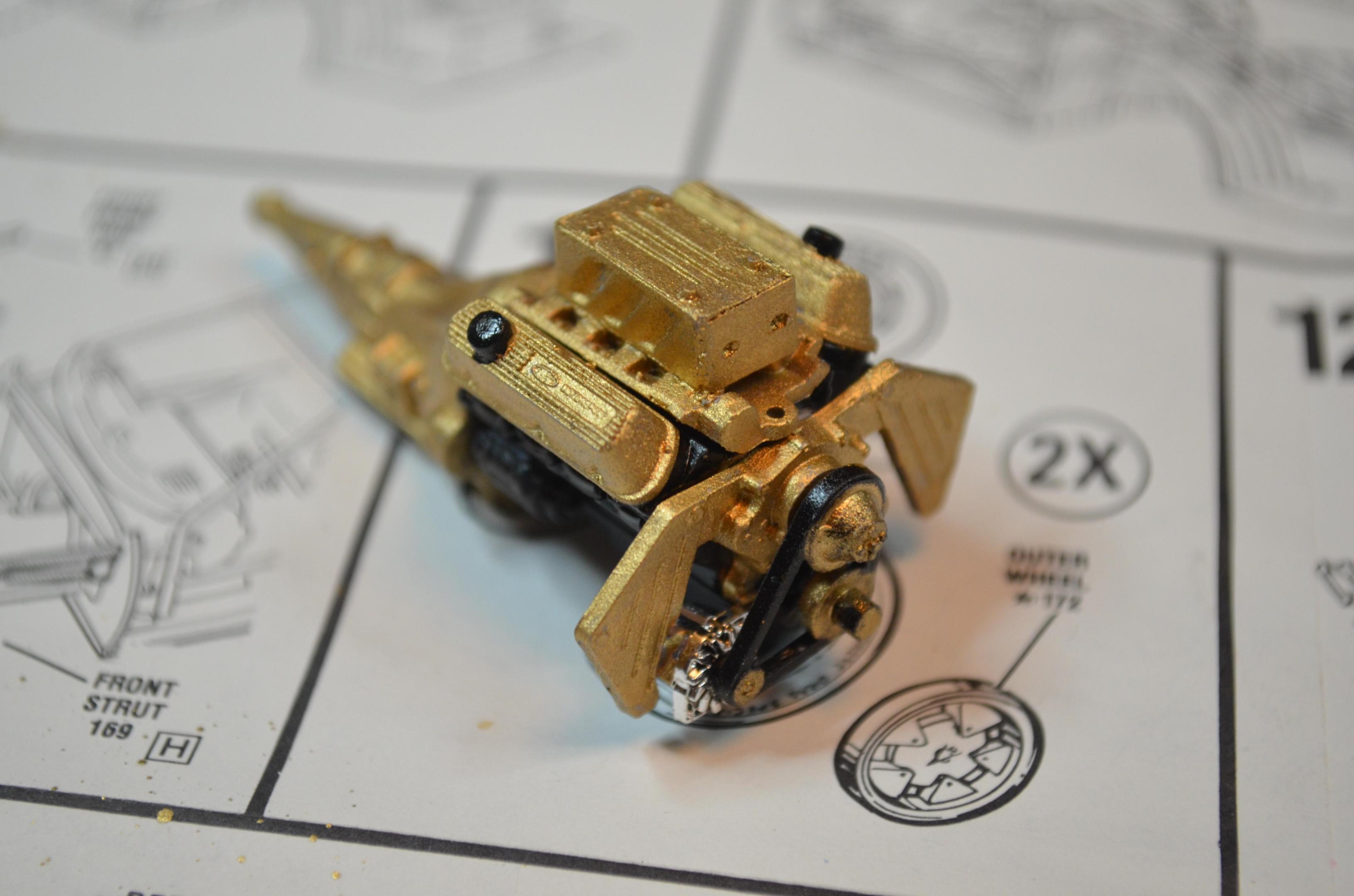

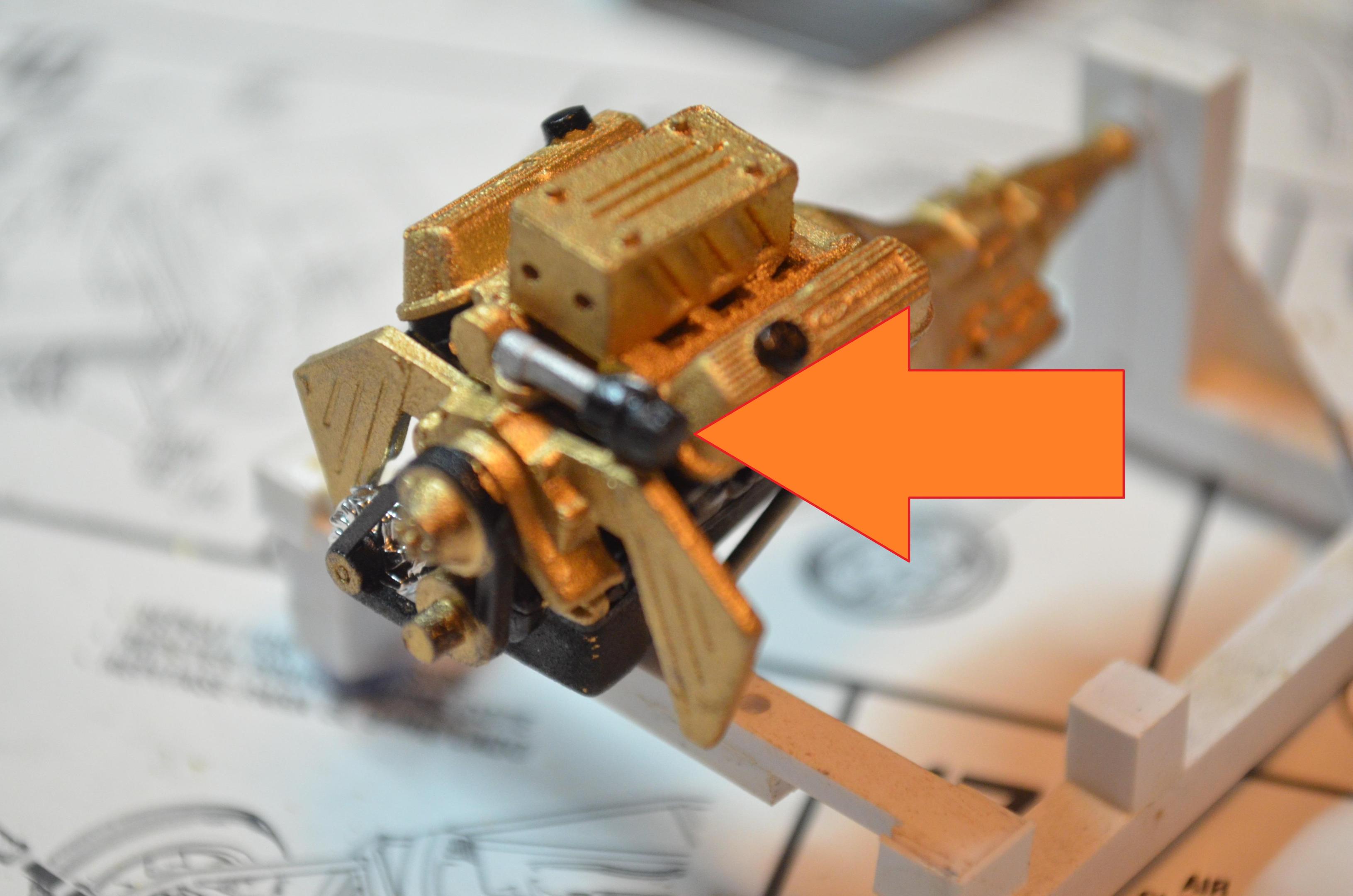

Work is going slow on the Lincoln but its still moving forward so I guess that's a good thing. Since I am not making any specific car I'm taking some creative liberty on this one. So the colors are of my own choosing. I was also planning on wiring up this motor but it turns out the distributor is way to small for me to get 8 wires in it so...

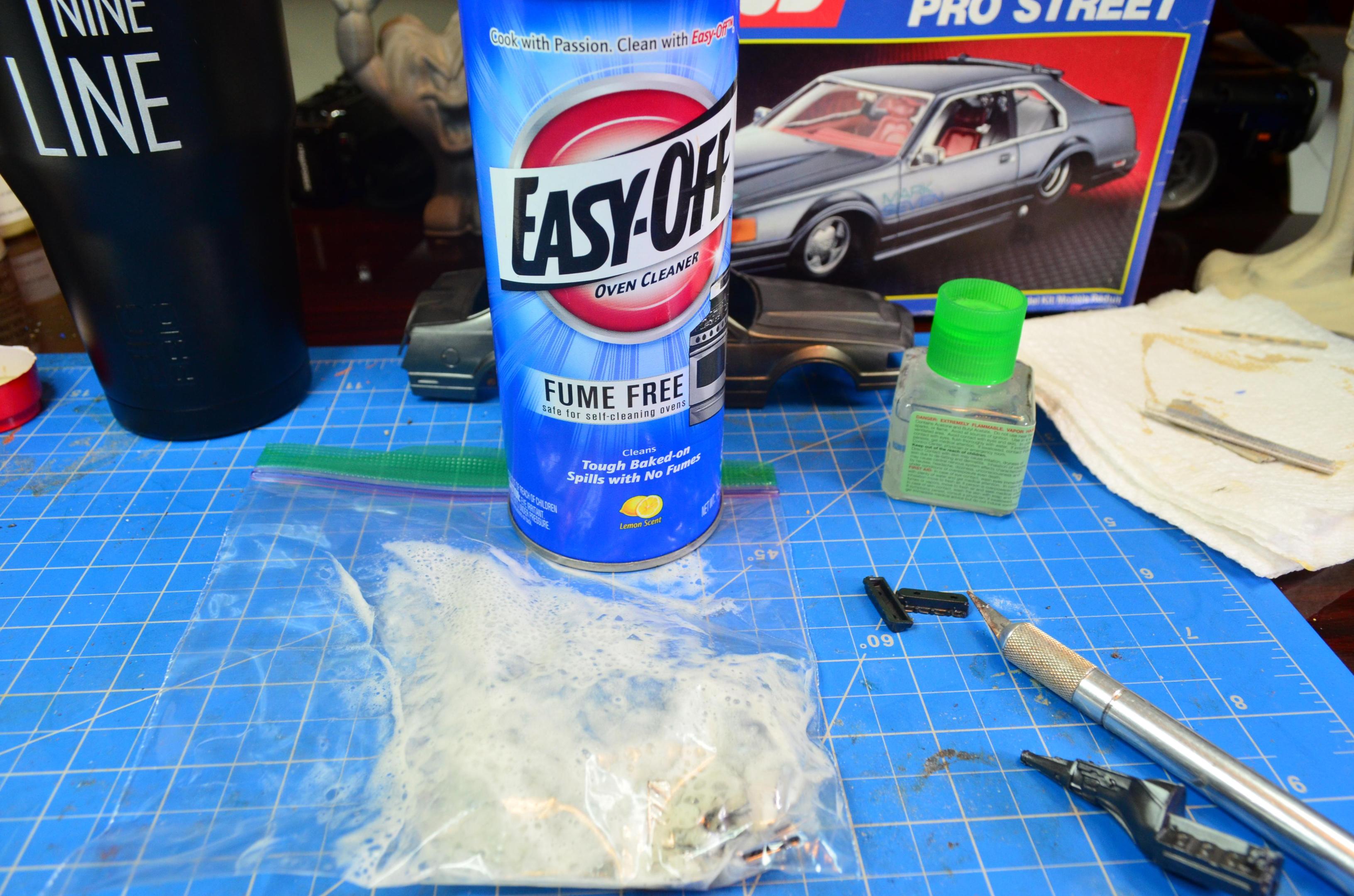

Before painting the engine bits gold I had to strip off the factory chrome paint with some Easy Off Oven cleaner. within 20 minutes we the parts were stripped and washed.

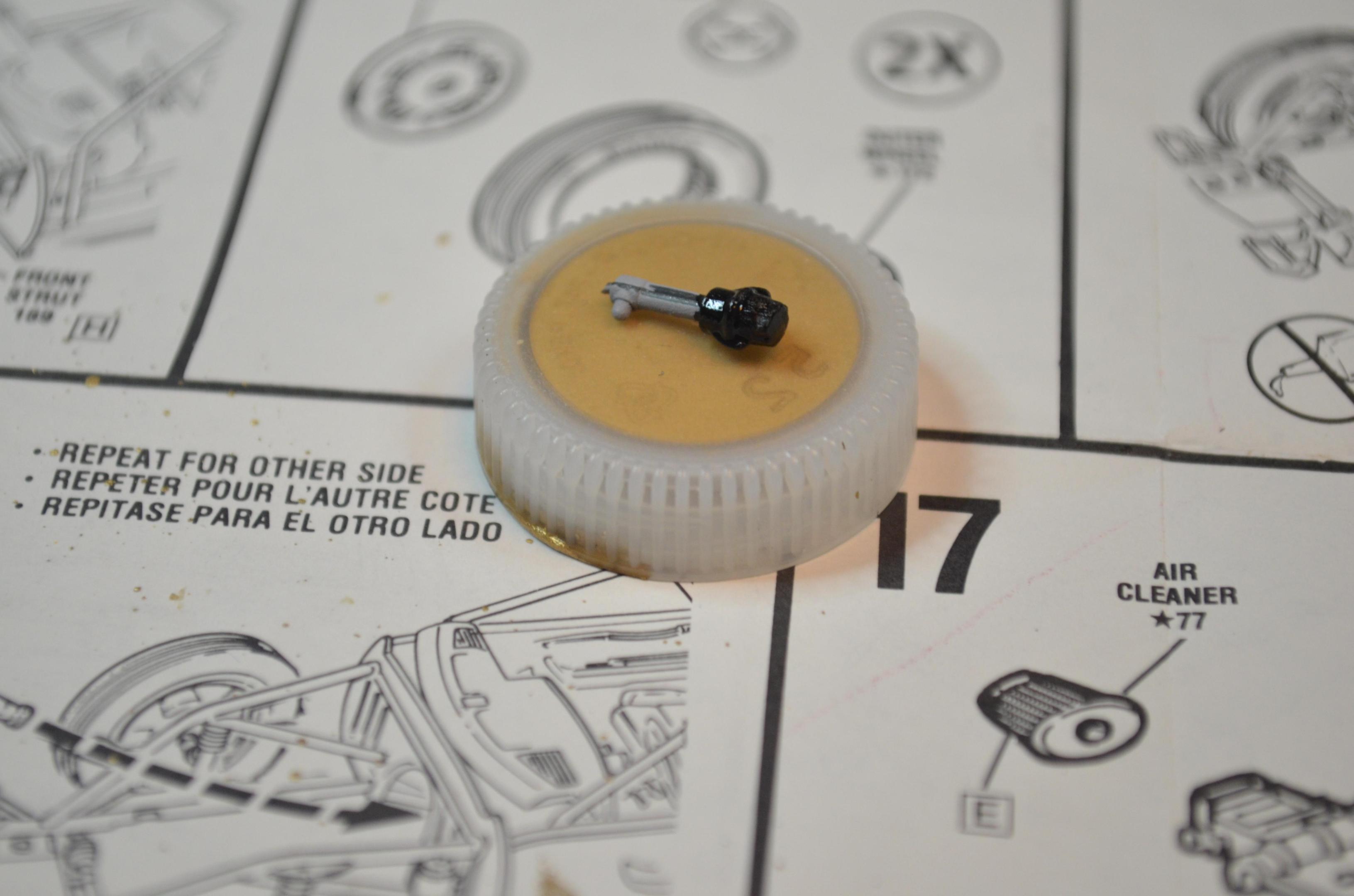

I got the distributor installed. I never saw a distributor mounted on its side like this. You can see how small this is and why I decided to not wire this motor

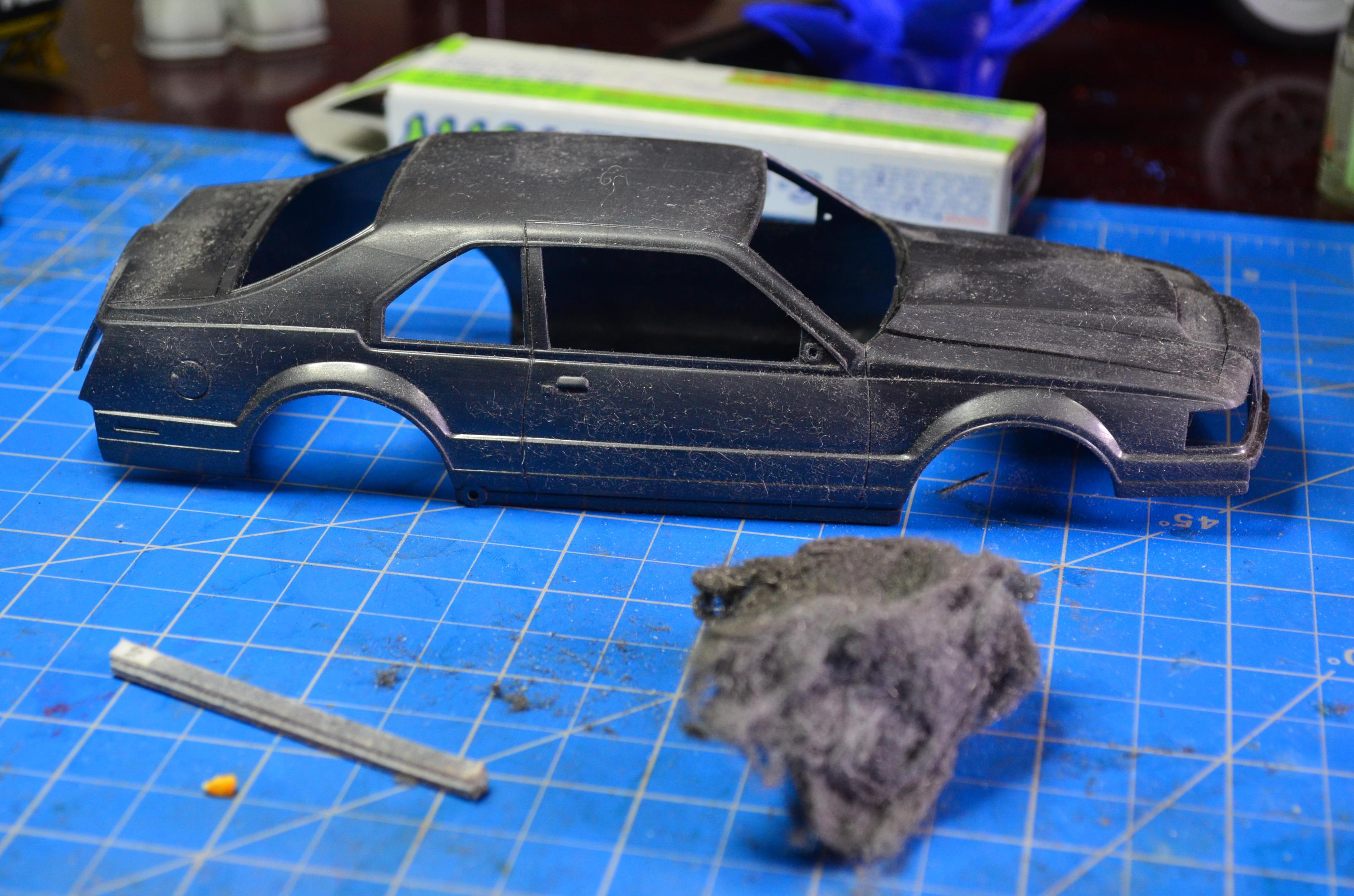

Lets take a look at this sexy body.

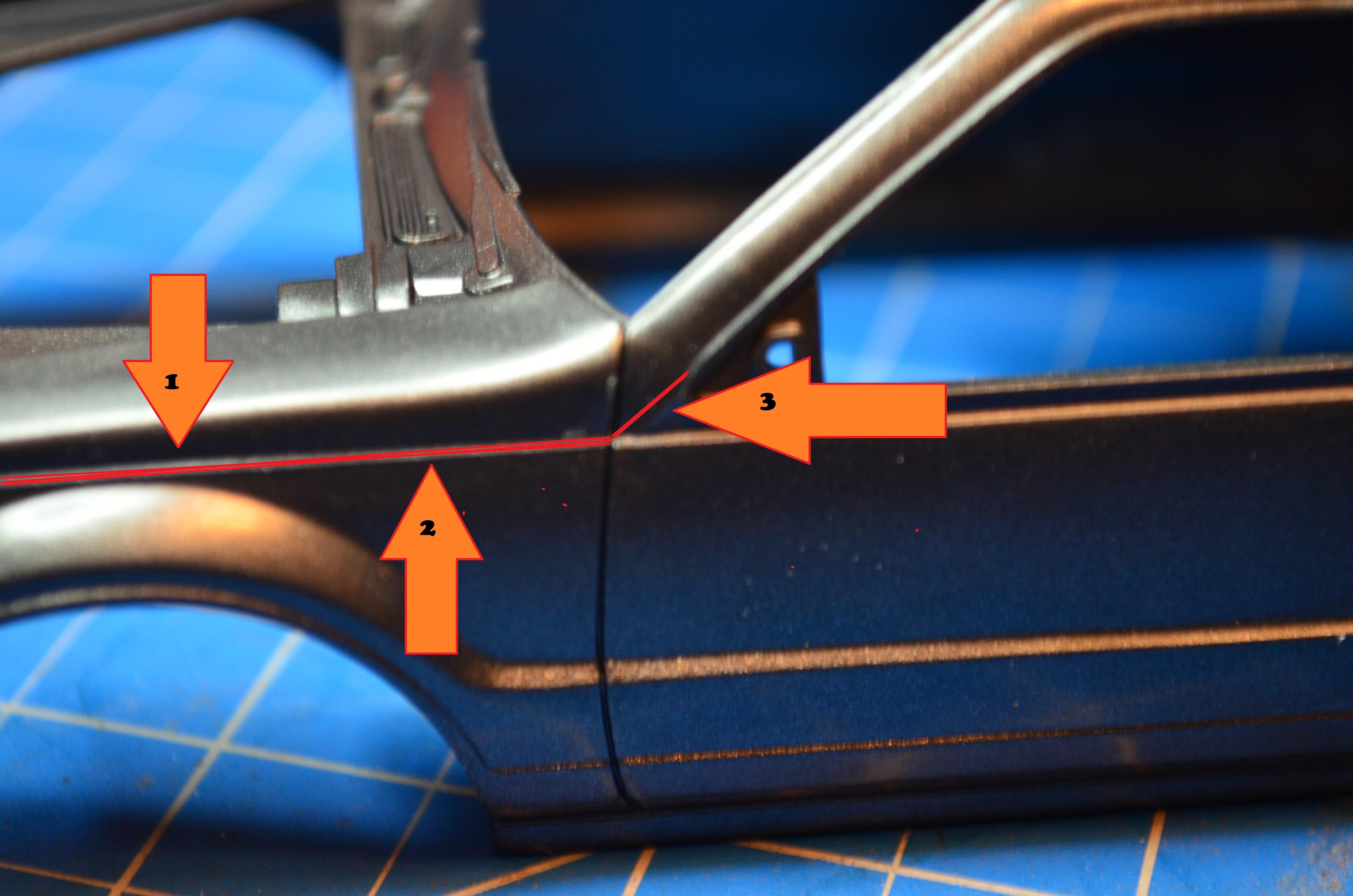

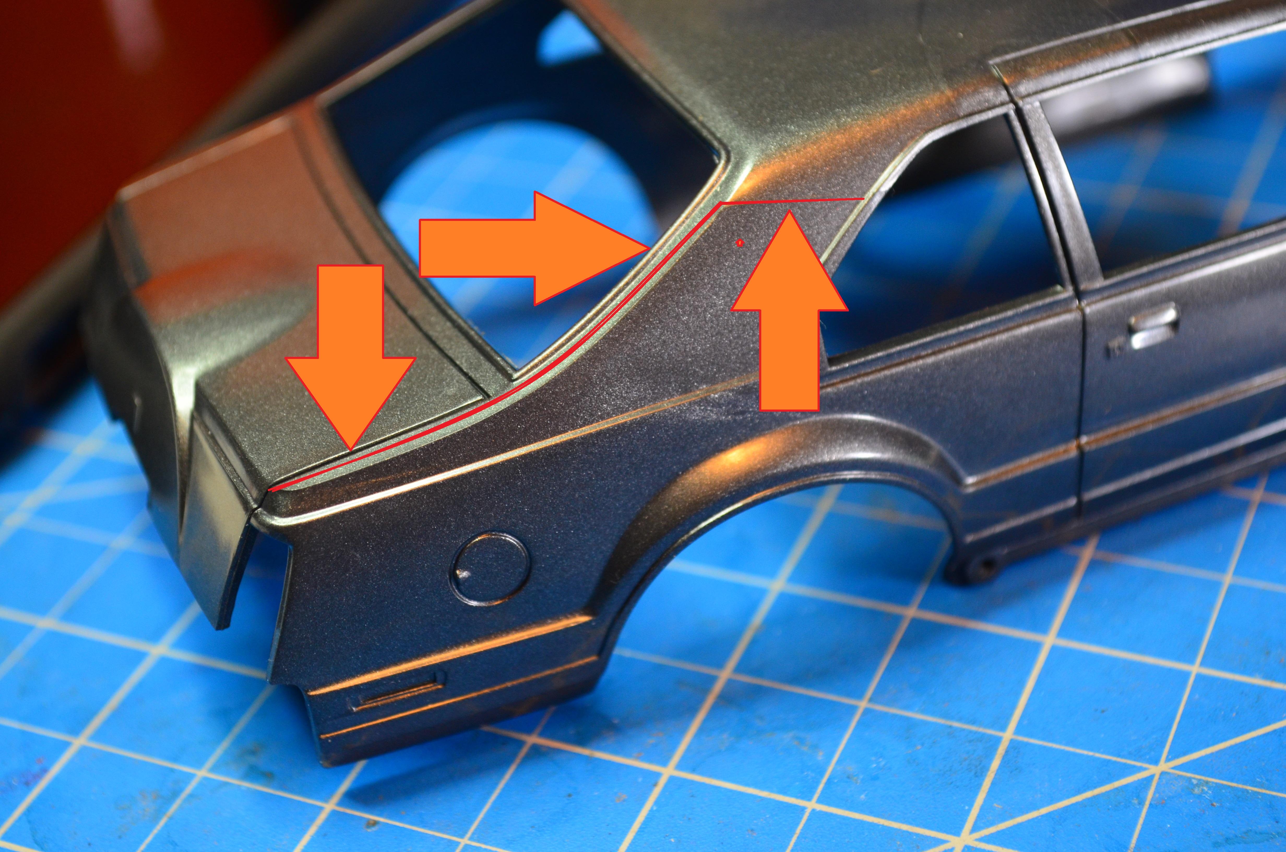

The only real noticeable mold line crosses between the back window and the rear side window. The rest follows the body line down to the trunk
In the front the only visible mold line in the area between the drip rail and the body line (3). it then flows down the panel to the headlight. Invisible to the eye but felt by the fingers. I used a sanding stick to get rid of the mold lines and cut the edges where the lines followed the panel lines. You don't want to leave sharp edges like that or the paint could pull away leaving an ugly line of plastic color .

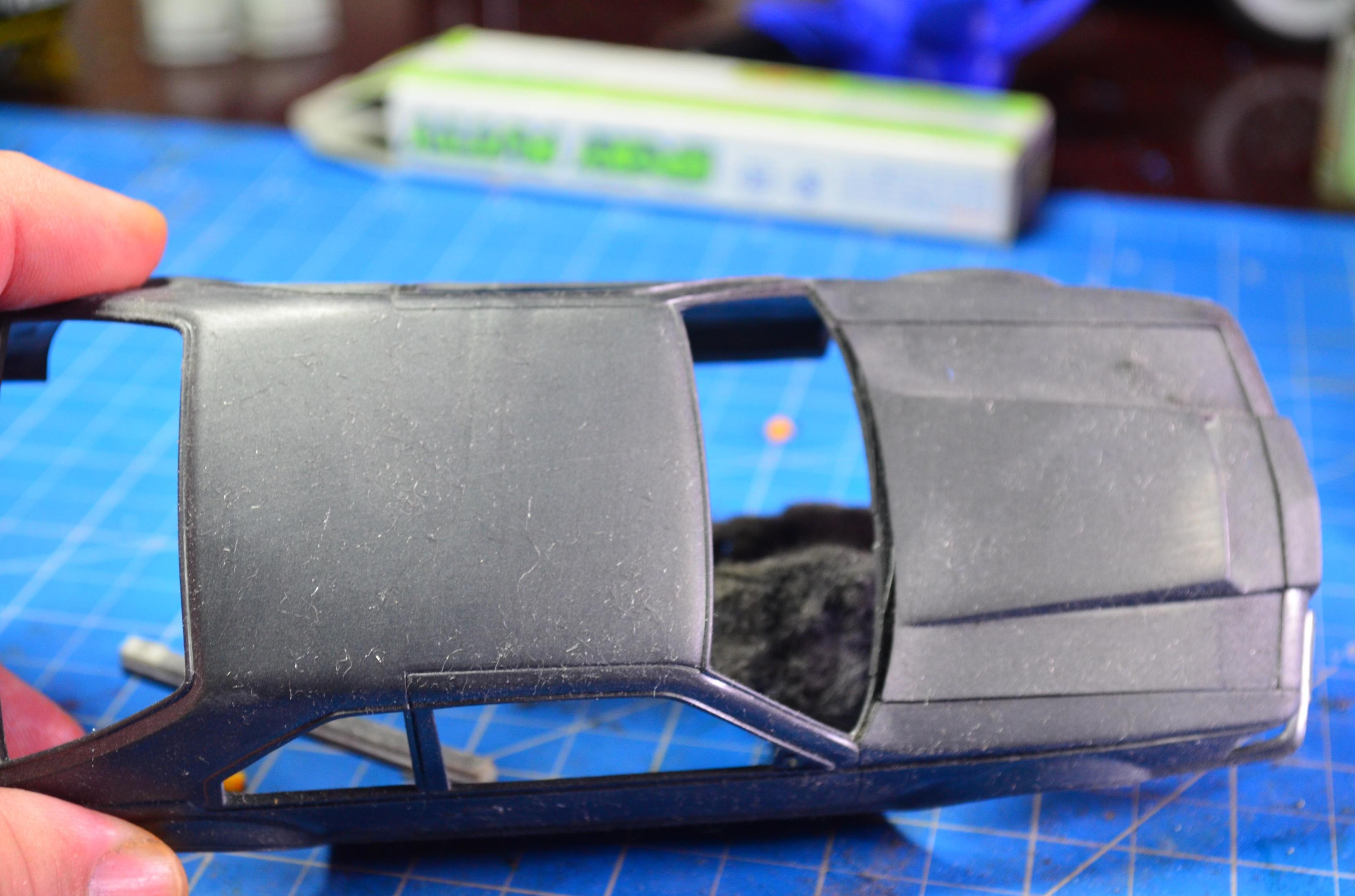

Next I scrubbed down the entire body with some steel wool. Just to give the paint something to hang on to

This kit is derived from the Matt & Debbie Hayes T-Bird (which is why the body is a little short) and on the 1:1 car they came up with a 90 degree drive for the distributor so it would clear all those blower drives and hoses.

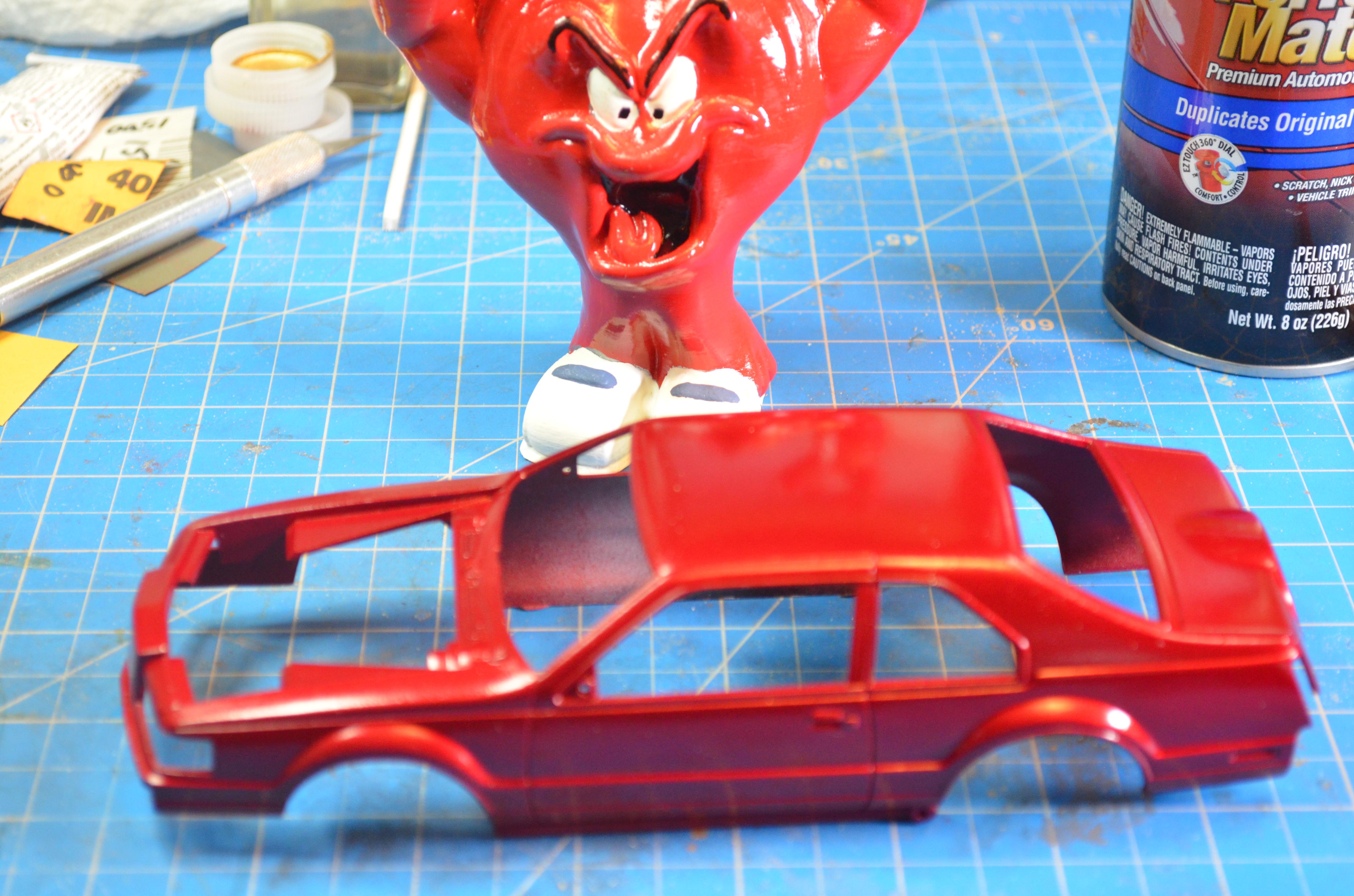

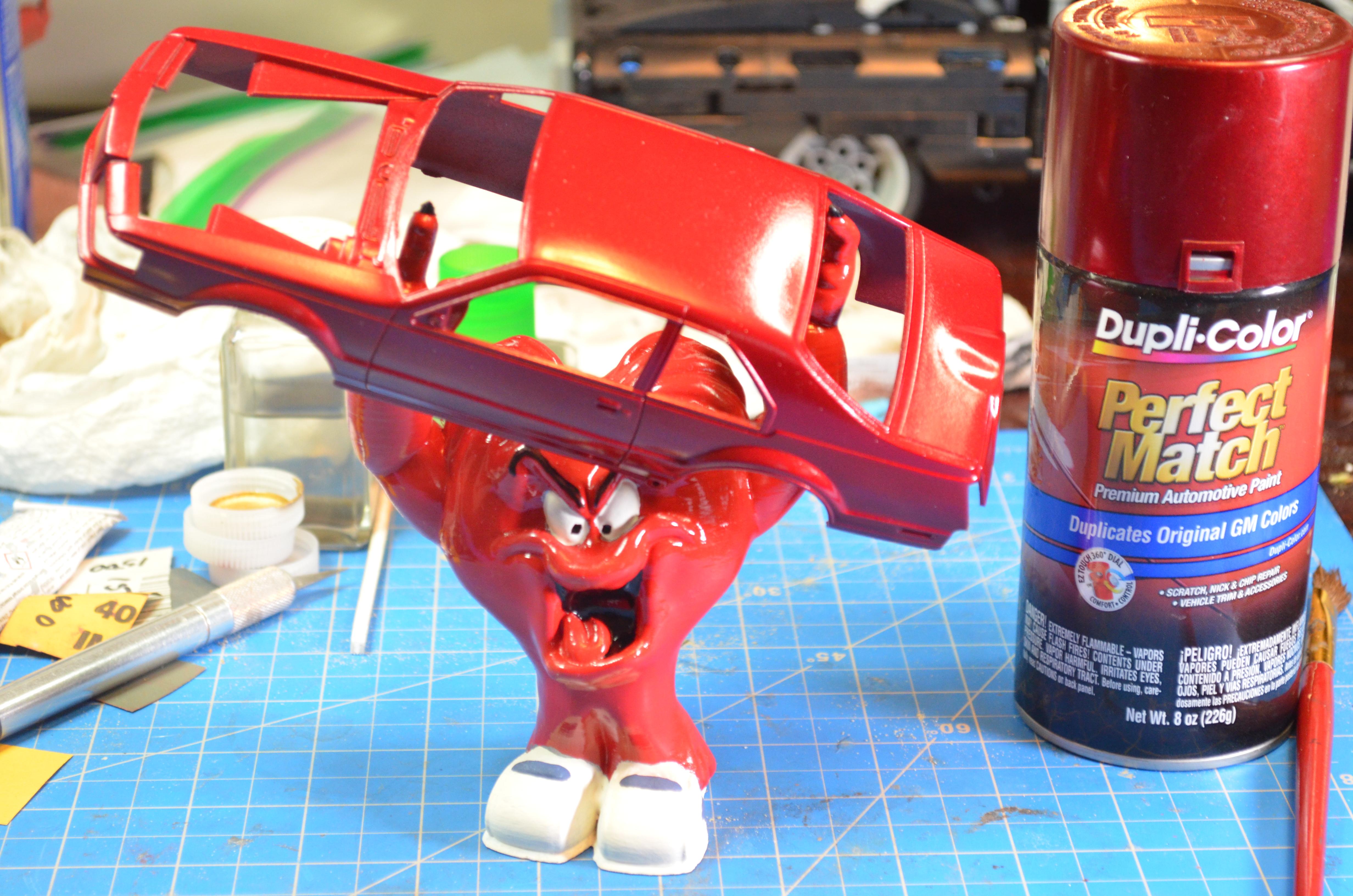

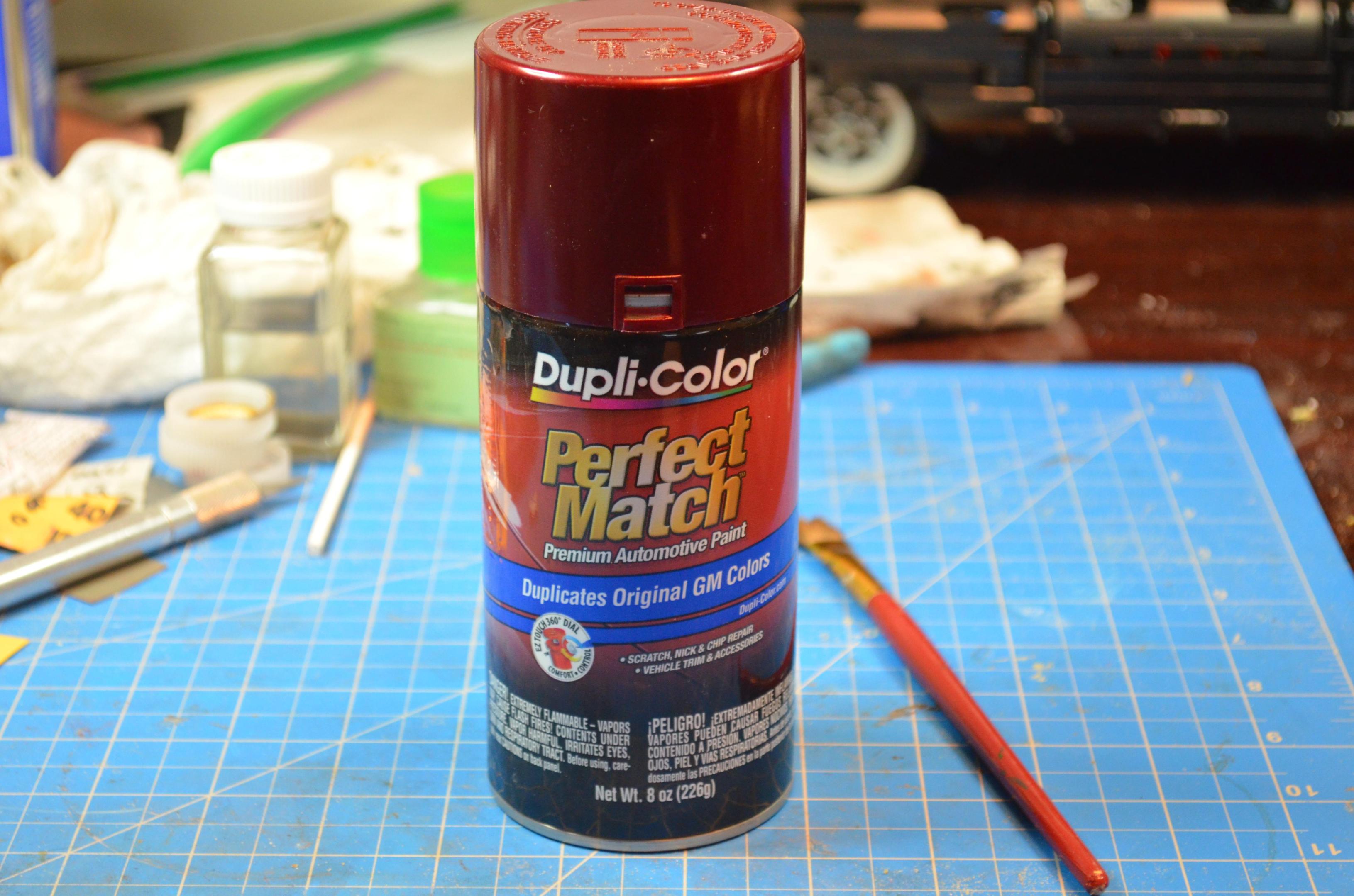

Time for some color. My plan was for something in a dark deep red/maroon, preferably a nail polish. Its been quite some time since I sprayed nail polish and I figured I'd be overwhelmed with all the deep rich colors nail polish has to offer. Well after a couple or 4 stops and nothing to show for it I gave up. The next stop was Advanced Auto where I found this Dark Cherry color, It was love at first sight. I didn't even care that the price on this paint has doubled since I bought my last can about a year ago. The pictures don't do justice to the actual color
Here we are with bench assistant, Gossamer. Like a little kid he can't help but get into the middle of everything

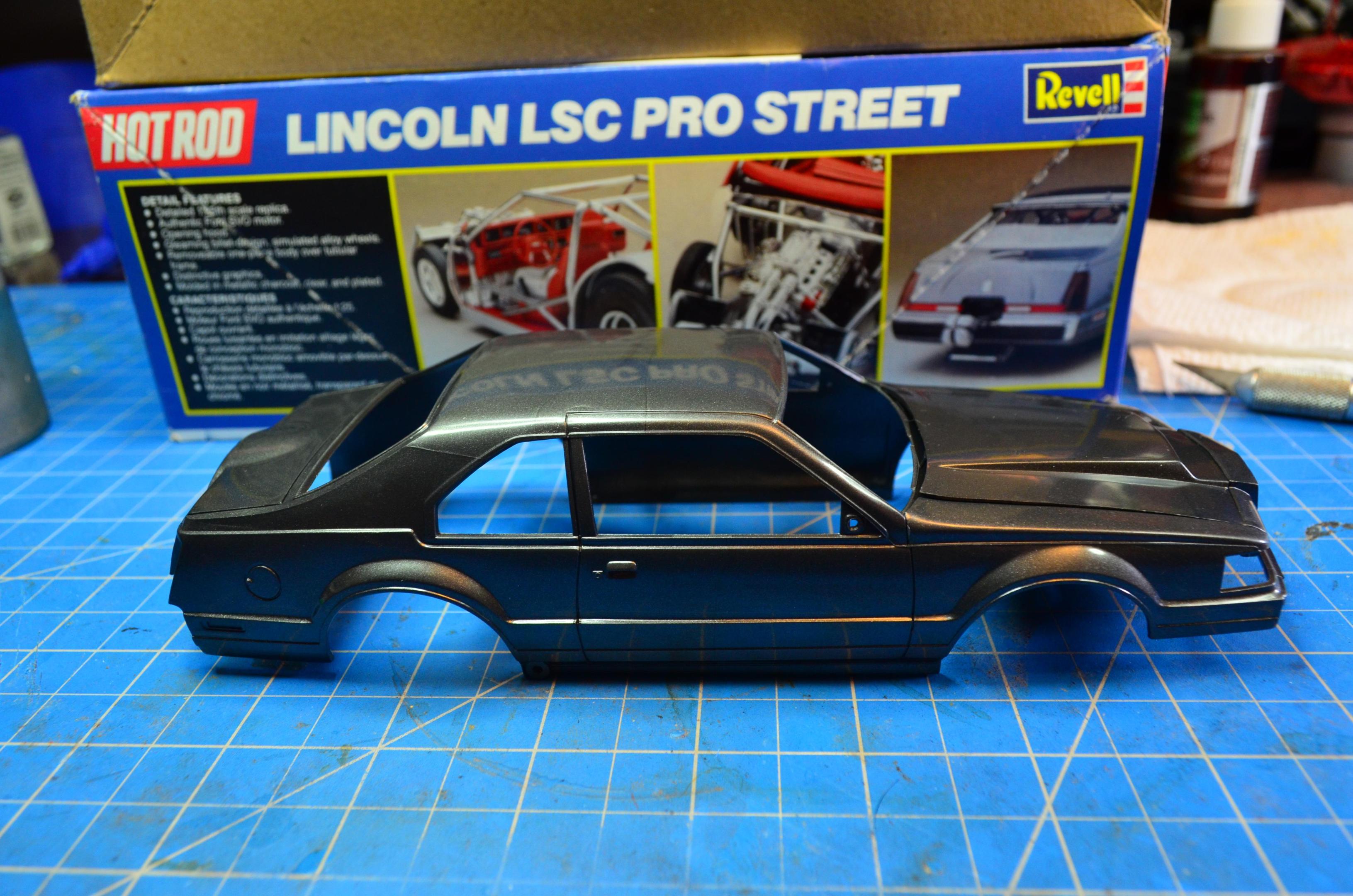

I gave the car about 4 coats of paint over gray primer. I sanded it down, first with 1000, then, 1500, 2000 and then 2500. I could go finer but I can't seem to find my box of micro-mesh at this time... Go figure  But to be fair its good enough at this point. Next I clear coated it. I think I might do another coat.

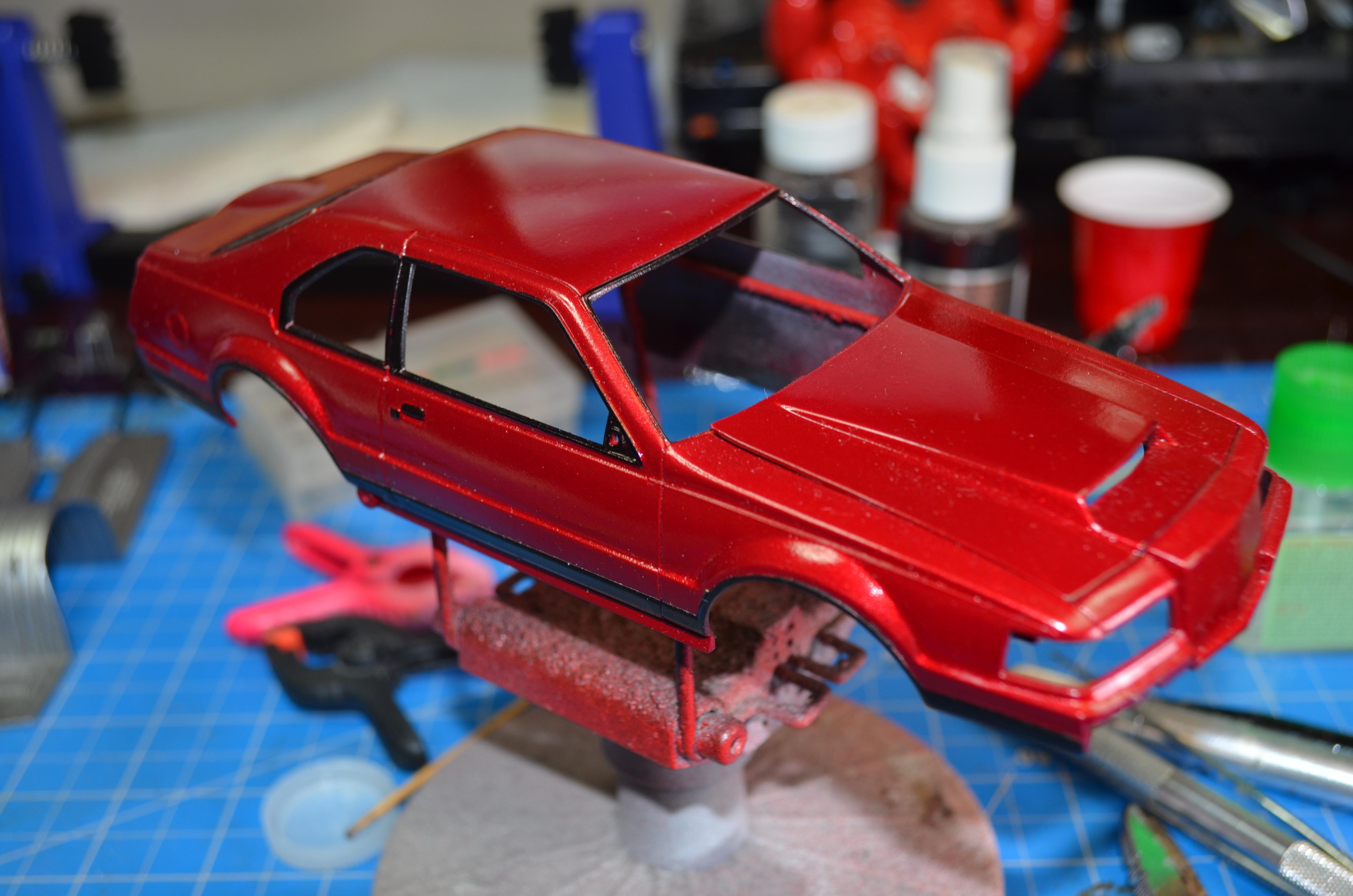

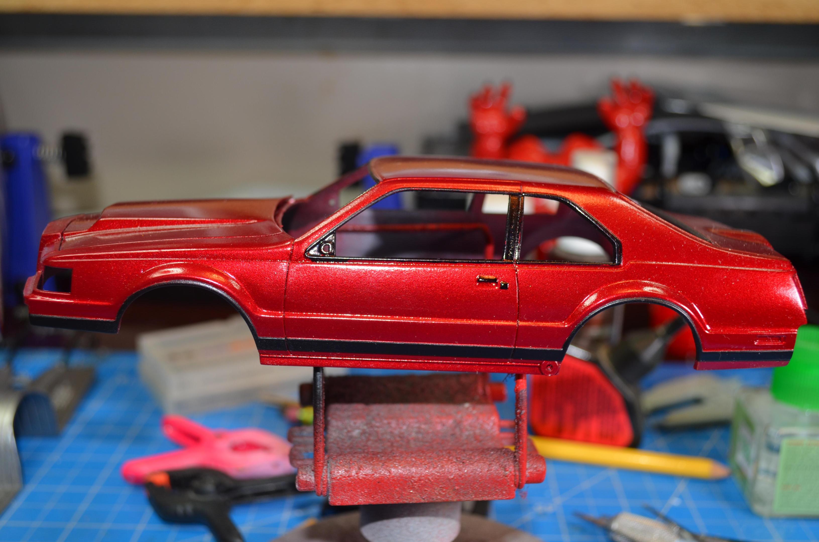

I added the trim work to the Lincoln, I originally planned to use the black Bare Metal foil for this but I got lazy and decided to try a trick I've seen on the Youtube from time to time. I used a black Sharpie pen. It worked great. I still need to buff and polish the paint but I'm pleased so far.

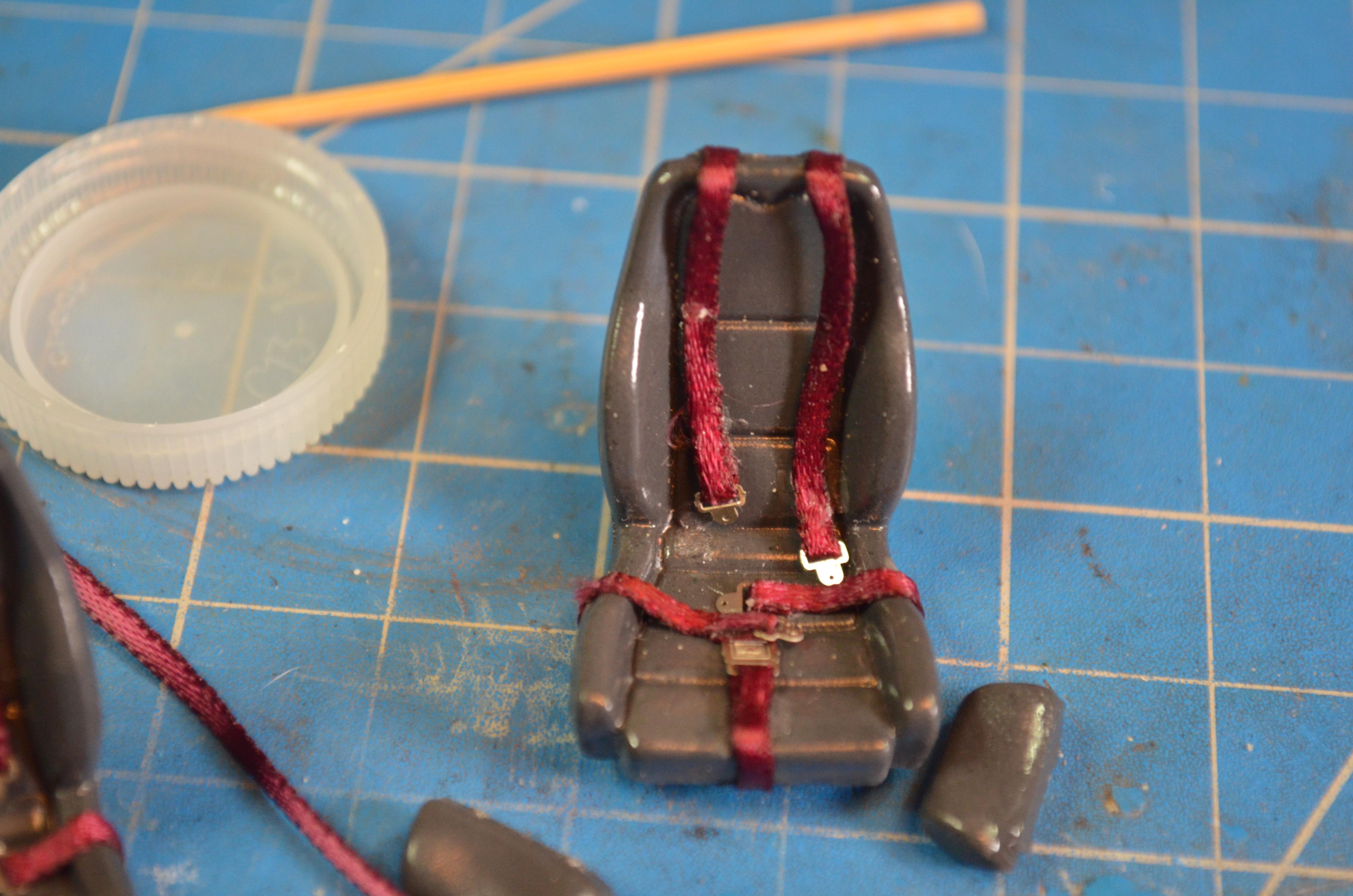

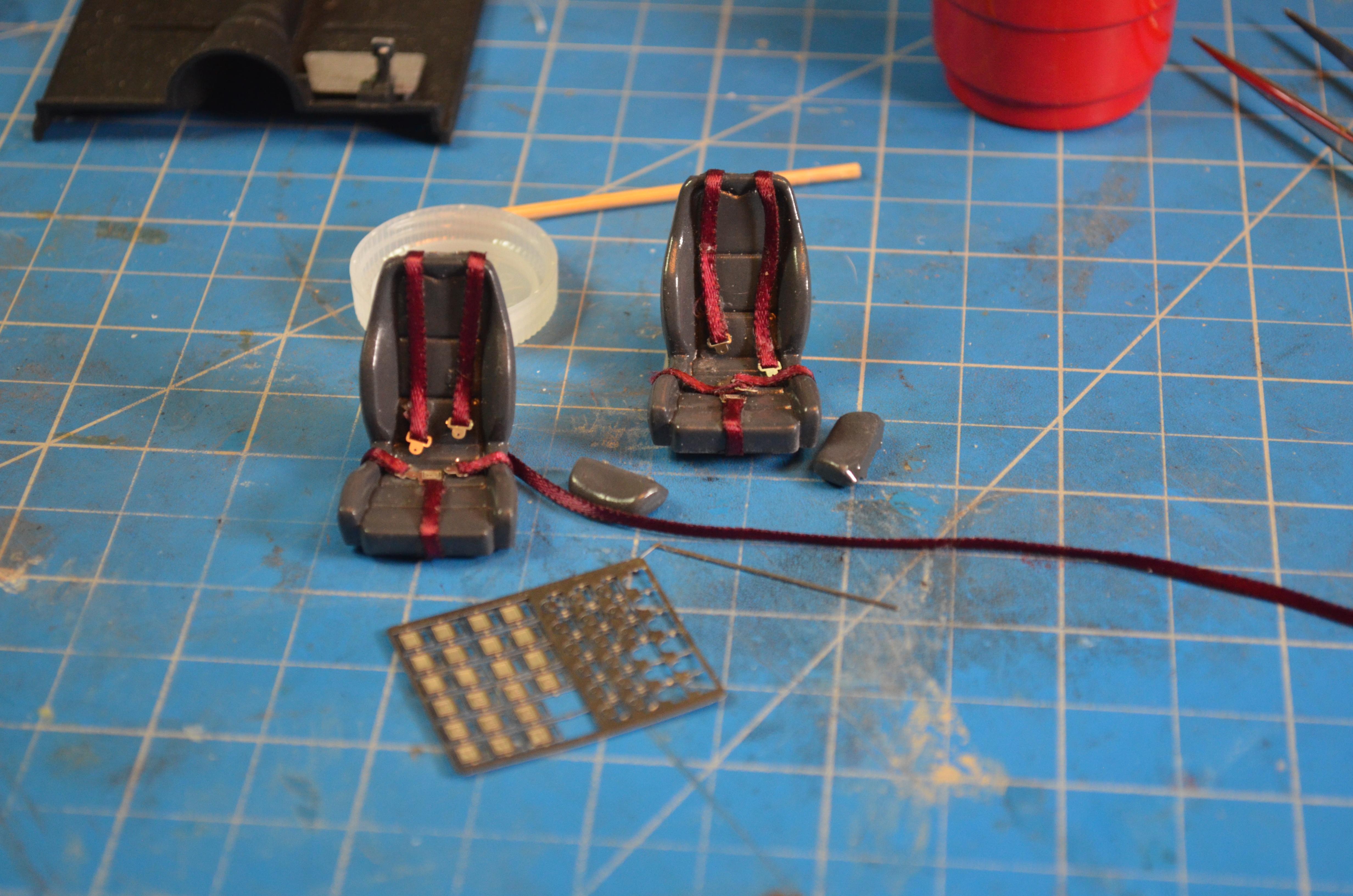

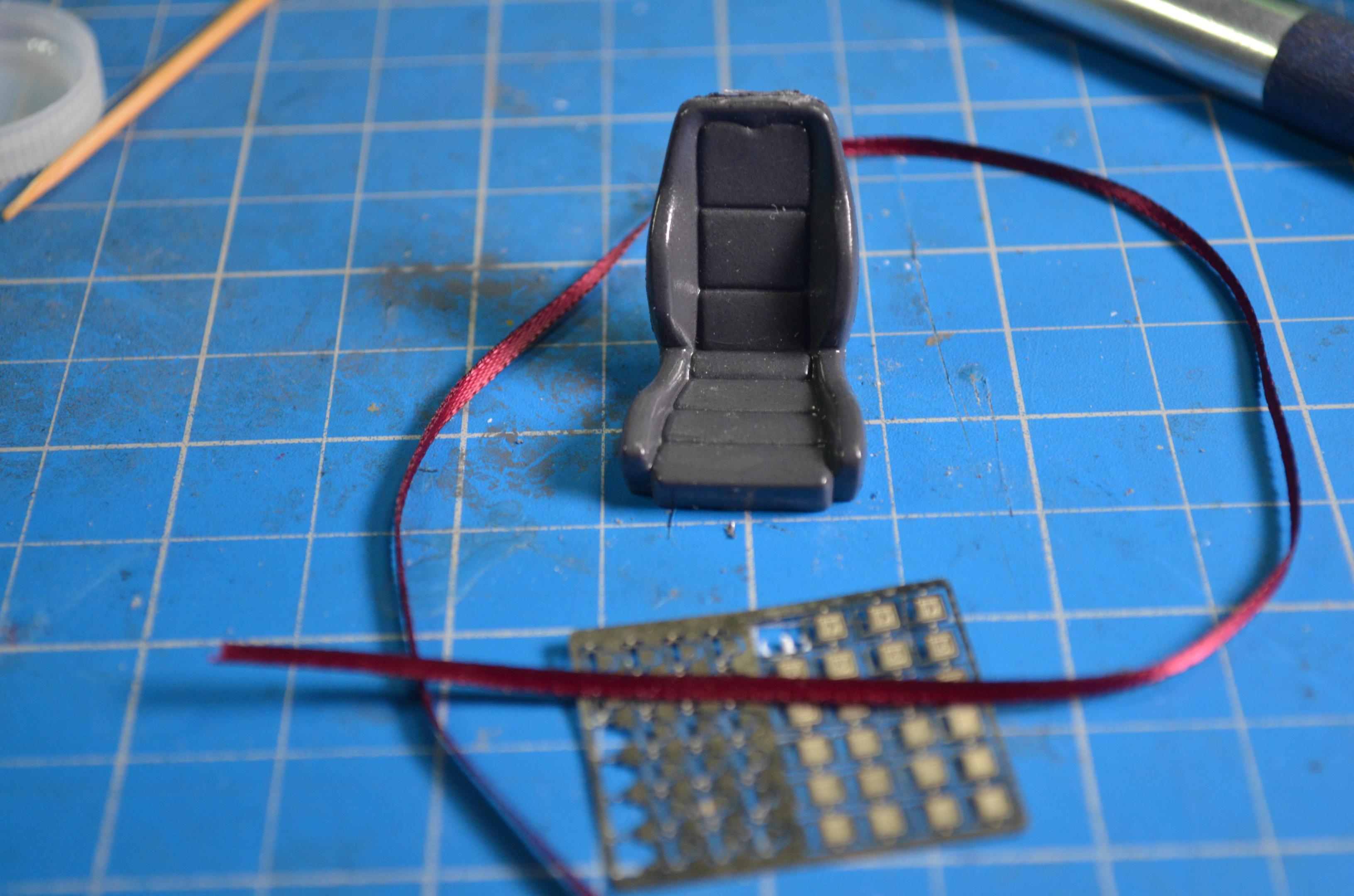

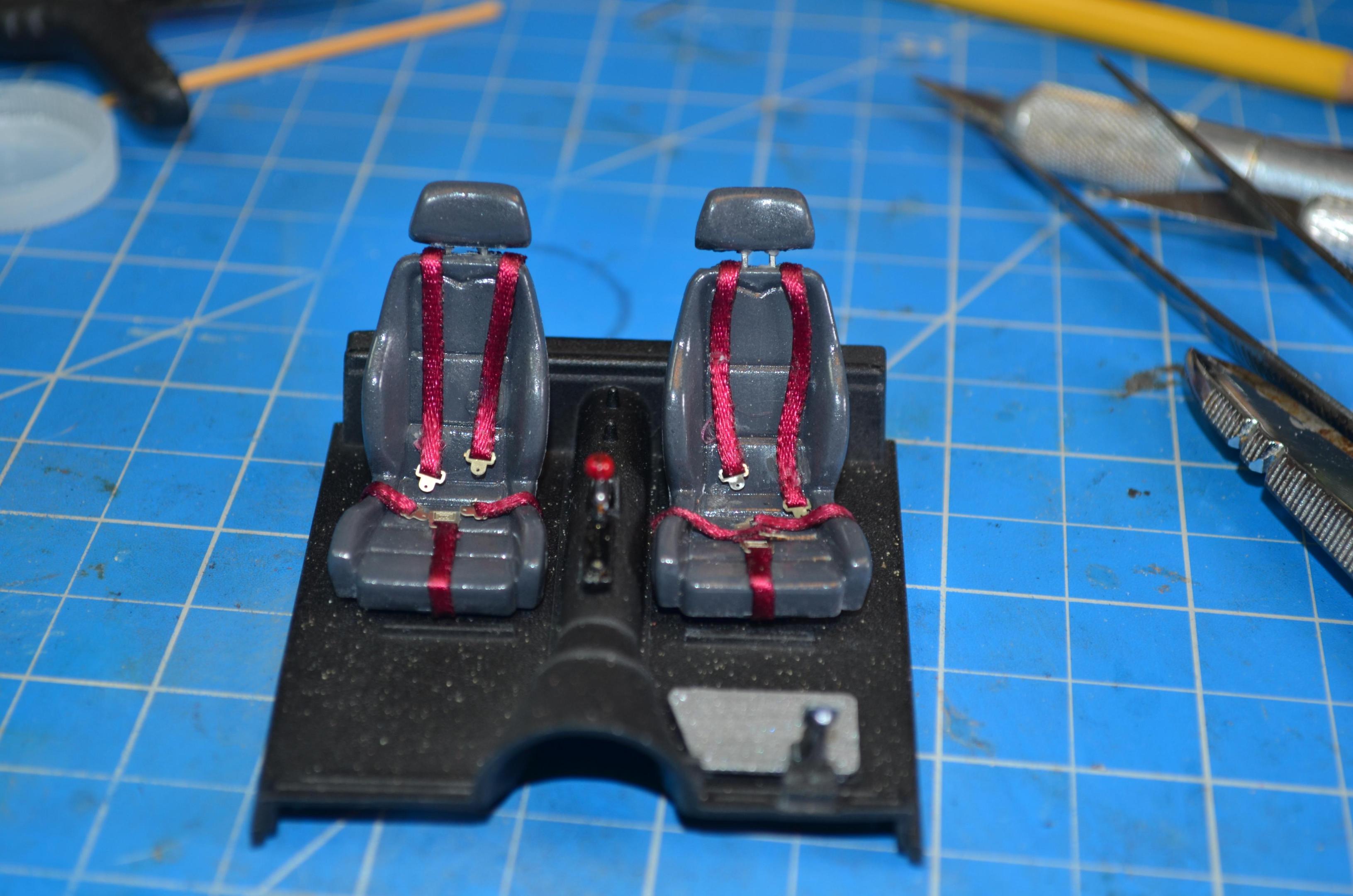

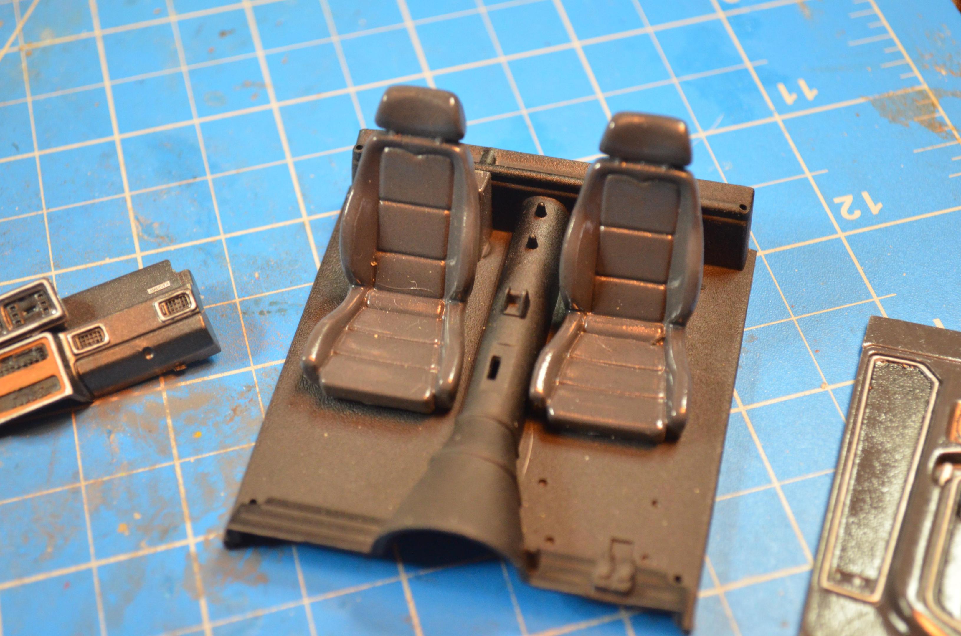

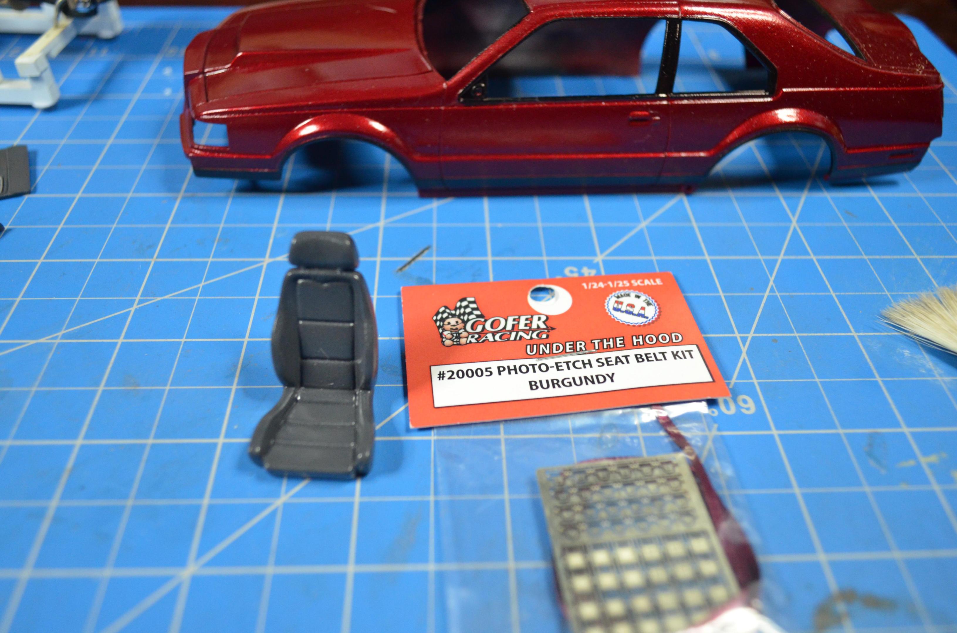

Next its time to change direction for a little bit while the paint continues to cure. I started to work on the interior and the seats. After I had painted the seats and other interior components I realized that the color was too dark and I wasn't happy with it. But I'm to lazy and didn't feel like back tracking and starting over so I decided to leave it as it is. But I feel like I need to break up all that dark gray. My solution was to add a 5 part harness setup that matched the exterior of the car. Here is what I found. Gofer Racing parts.
The kit comes with a fret of photoetch buckles and catches for several seats and a length of maroon fabric for the belts

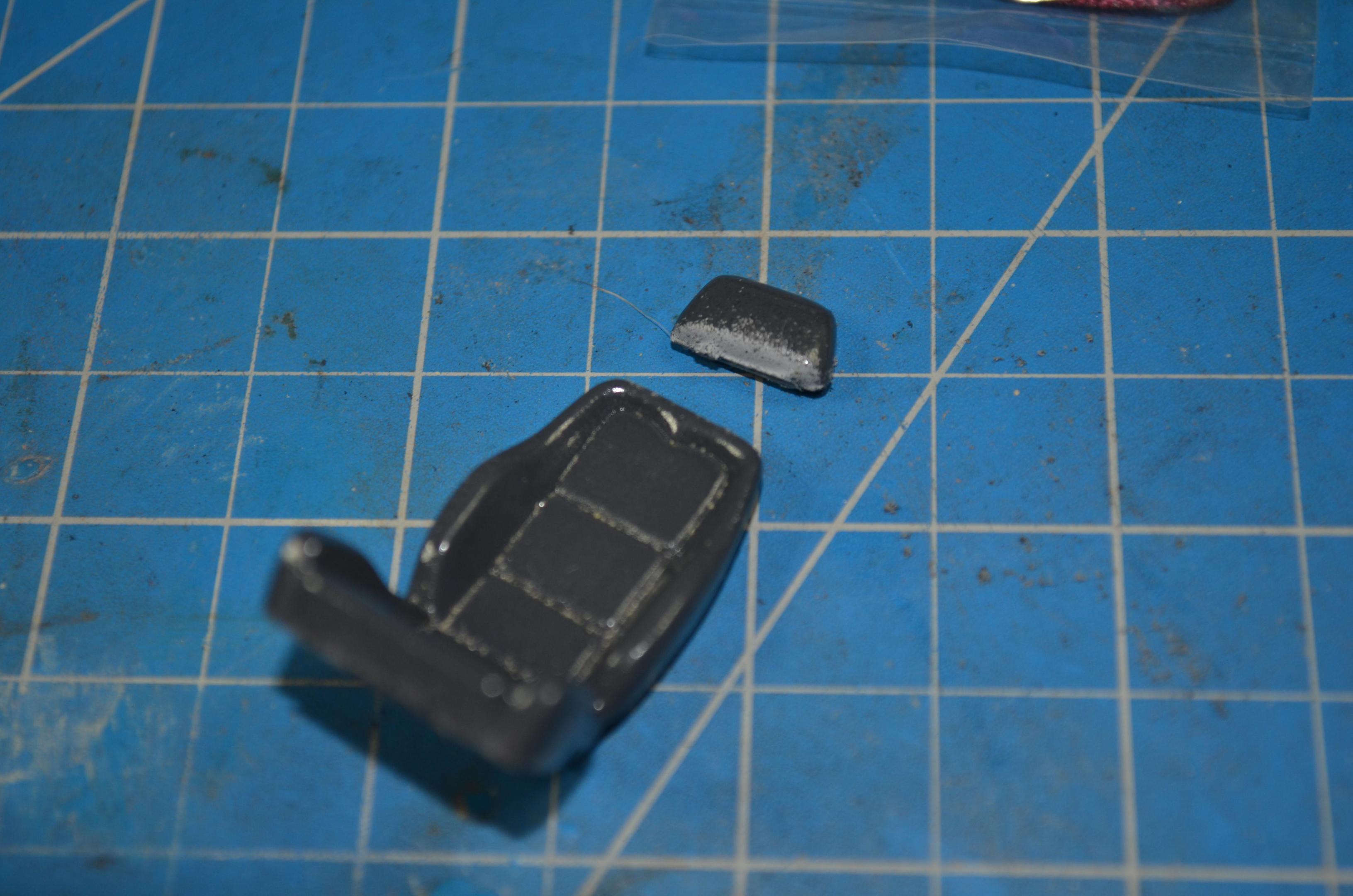

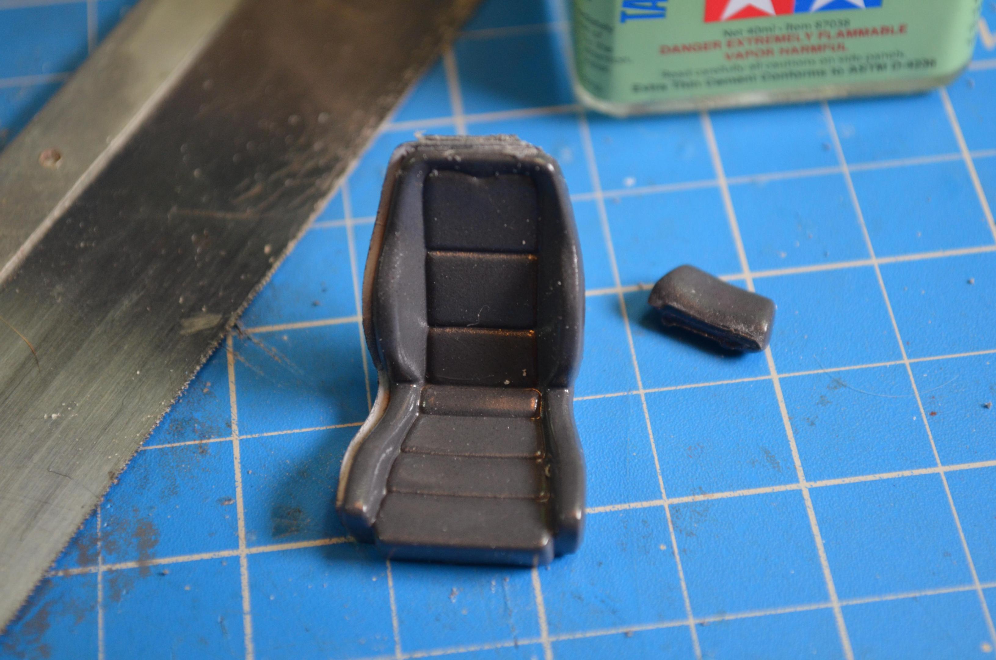

The problem I have is that the head rests get in the way. So that means we have to preform some plastic surgery. Using my razor saw we cut off the two head rests

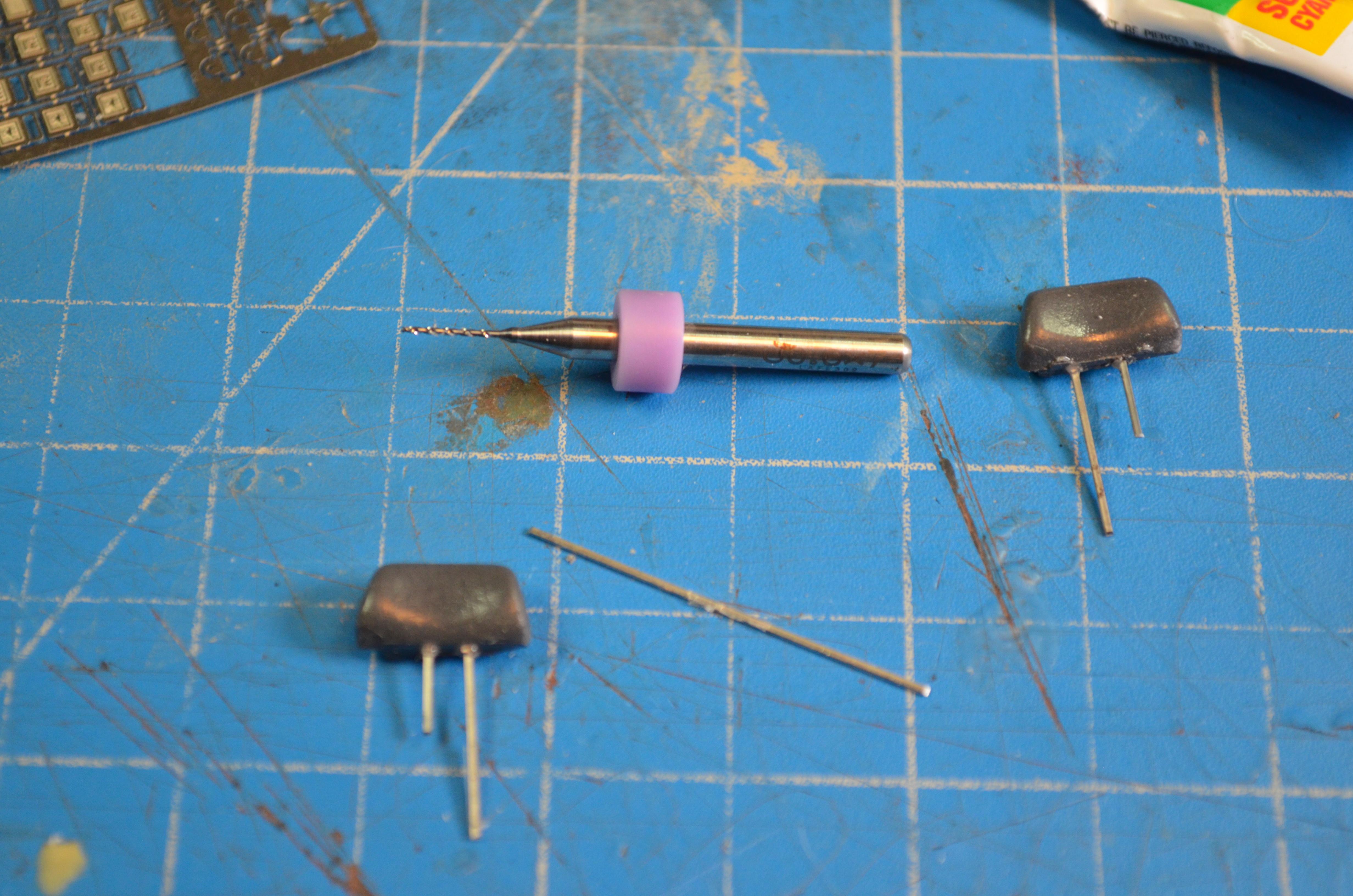

Now that the harnesses are in place its time to reattach the headrests. With the harness in the way the headrest no longer will sit right on the seat. So to fix this I decided to make some posts for the headrest. I used staples for this
Once the posts were dried and firmly in place I trimmed them up and placed them into the seats. I think this should help break up the darkened interior and add some points of interest
