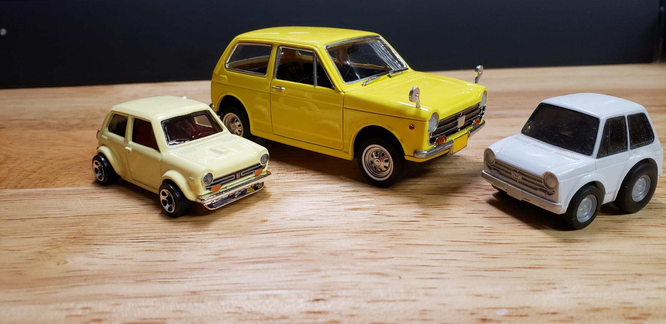

I've been using an olfa circle cutter and stick on mailing labels to make mine. Theres a video on YouTube. This is my 1/32 Honda N360 so the tires are tiny
1 hour ago, Hondamatic said:
That looks amazing
Thanks! Your tires also look good!
