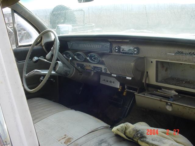

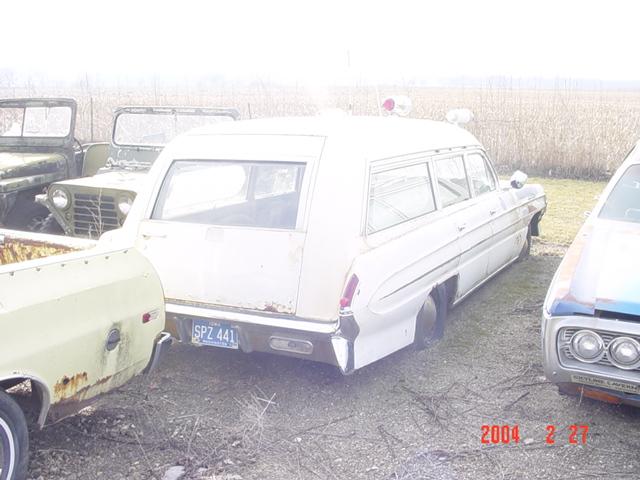

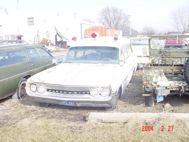

7 hours ago, Carmak said:
The missing 394 could be a blessing since it might direct you to a newer engine/trans and that way you will replace the horrific Slim-Jim Roto Hydramatic.
This is a 61 Olds C/B ambulance I had MANY years ago.
 Craig, thanks for the photos. You are right about the Slim Jim trannys but mine has had no problems yet.  But I did have to get a rebuilt one for the 63 I had as a teenager.

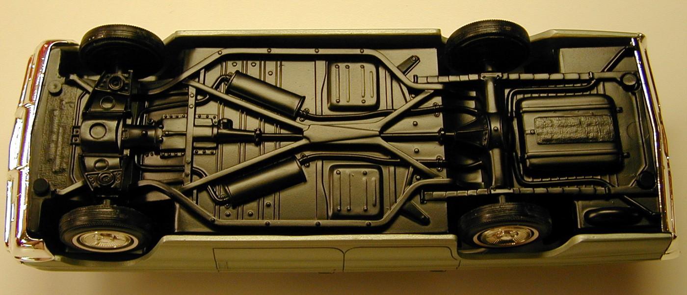

If the wheels aren't glued yet, I'd like to make a suggestion:
Here's my '62 built from a Promolite (Tom Coolidge) resin kit. In order to get rid of the typical JoHan too-narrow wheel track, I used brass tube for the axles (.047" I think) cut at lengths that brought the wheels and tires out - closer to the body. So that the wheels/tires/axles wouldn't flop back and forth on the narrow chassis, I made four spacers from Evergreen styrene tube that had an ID to allow them to slip over the brass tubes. Painted black, one spacer was slipped onto the tubes/axles before the wheels were attached.
John
John, I appreciate your advice but as I mentioned in the description, I did widen the track. Compared to your photo, mine looks just about the same as yours. Most, if not all of the early Johan kits needed the track widened. I also added wheel wells to the chassis on the 59's and 60's that I've built.
 Your 62 looks great. Here's a photo of the 59 I have in progress. I already widened the track. It's painted the correct Golden Mist Metallic.   -Rich
