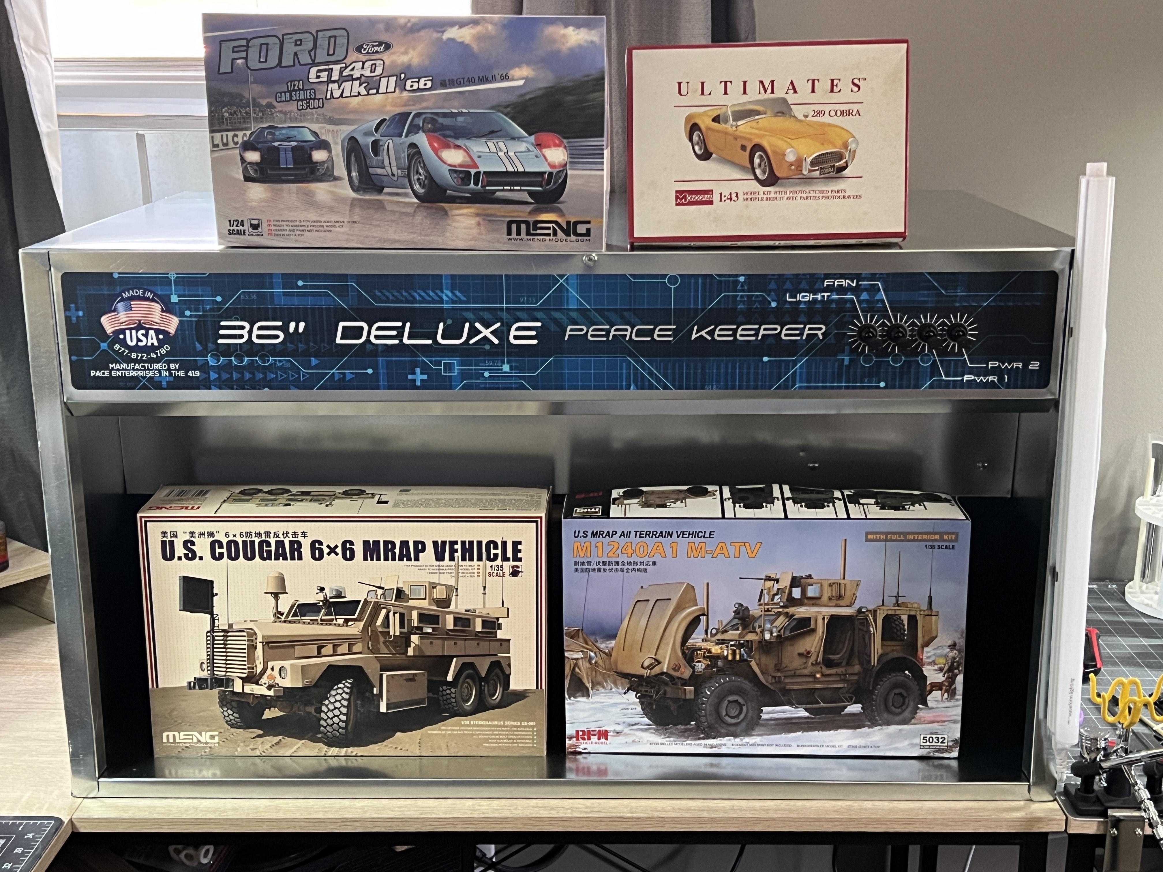

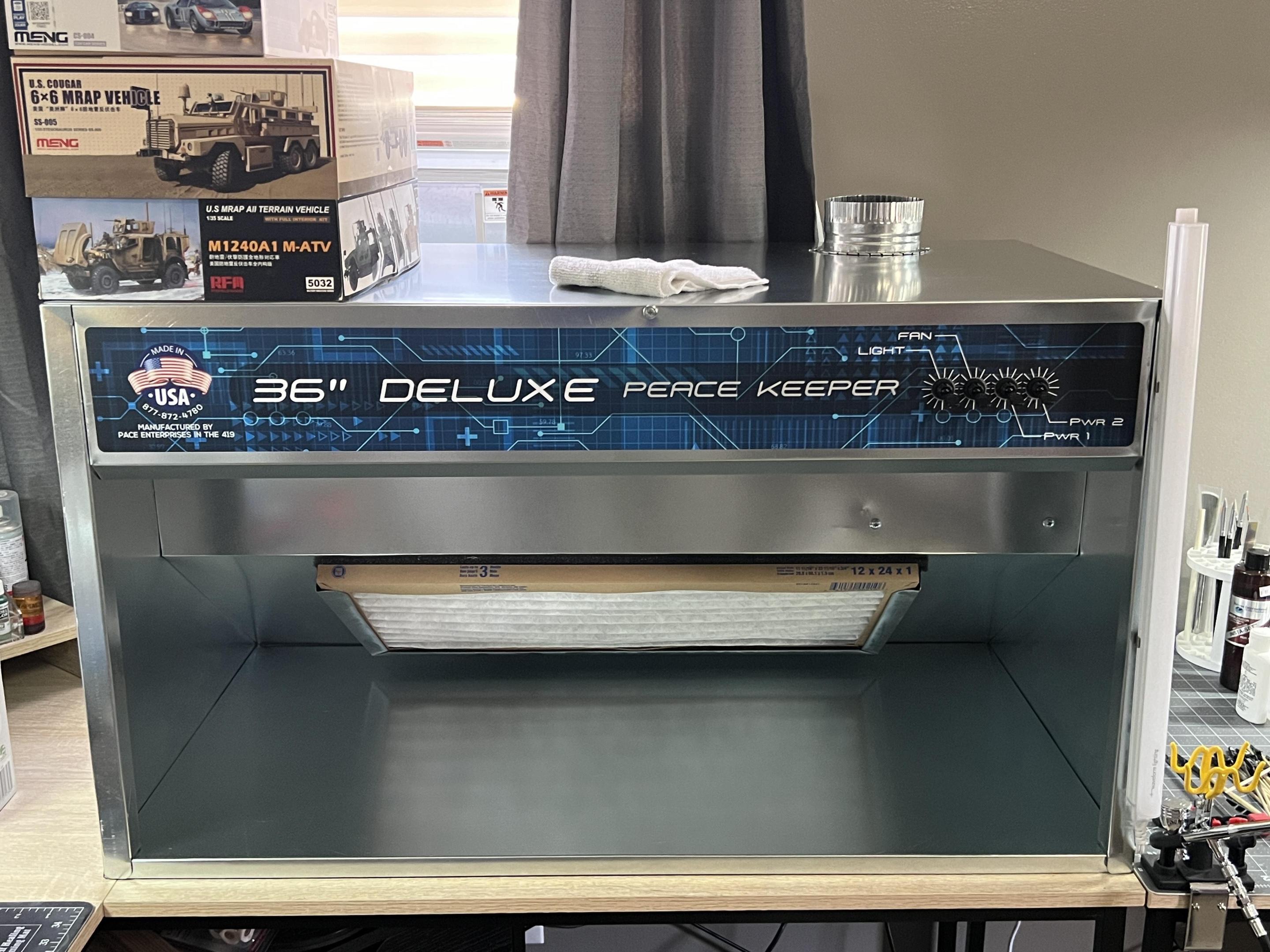

I had a custom built 24 inch booth i built using the same dayton blower the 36 inch pace spraybooth uses.  It was a good booth just ended up being too small just needed more space to move plus try to imagine painting big rig trailer kit in that size.  I kept my dayton blower as it cost more than it did to build the booth i had so now i have a spare.  But if you're like me than you'll want that 36" booth as it'll be the last you ever need for any model up to 33-34 inches long.  It's pricey because he includes shipping in the price, and also look at it this way - it happens with fish tanks all the time you get a 55 gallon thinking its huge, but week later you're like man should of got a 75 gallon or bigger.  Here are two pics of the booth the day i got it, and he does take about a good week or so to ship it out cause there not pre built least i don't think they are, and i got mine within 2 days after it was shipped out via UPS and packaging is pretty good too.  Barbatos rex on youtube has a video of his he got as well if you wanna see a video of it.
I would also recommend good lighting for it as well.  I use waveform lighting bulbs Waveform Lighting bulbs there expensive but you get what you pay for and 95CRI and they do have the 60watt versions and they only use like 10watts.  You can also use a light bar too whatever you fancy.
IMG_0792.thumb.jpg.ee48e92a965f5cd3121debdc5e68309c.jpgIMG_0791.jpg.1c27e54f2b6fcd9a3f57d49c5b729edf.thumb.jpg.52bafe3c03b875b86616fc0911e54012.jpg

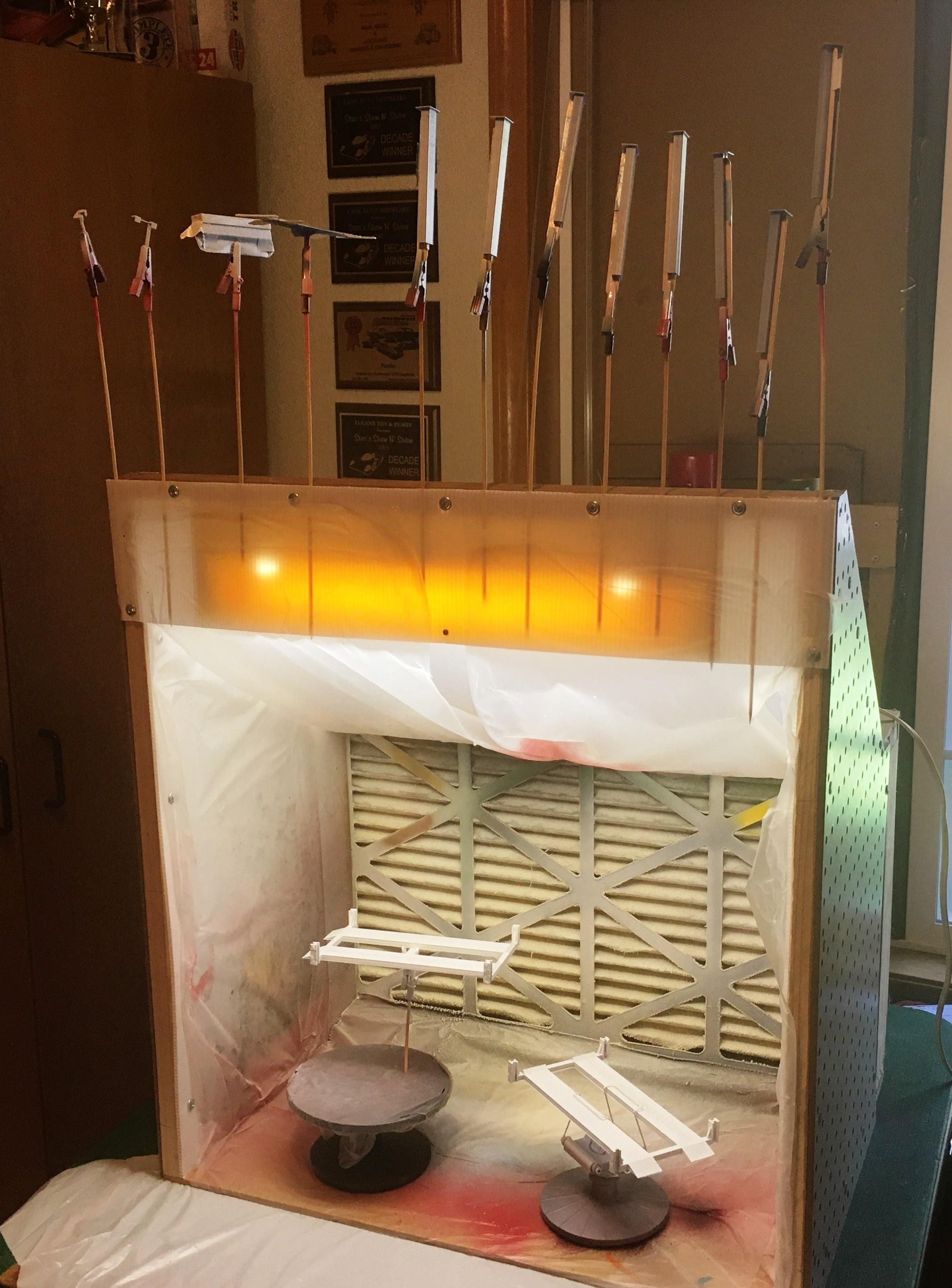

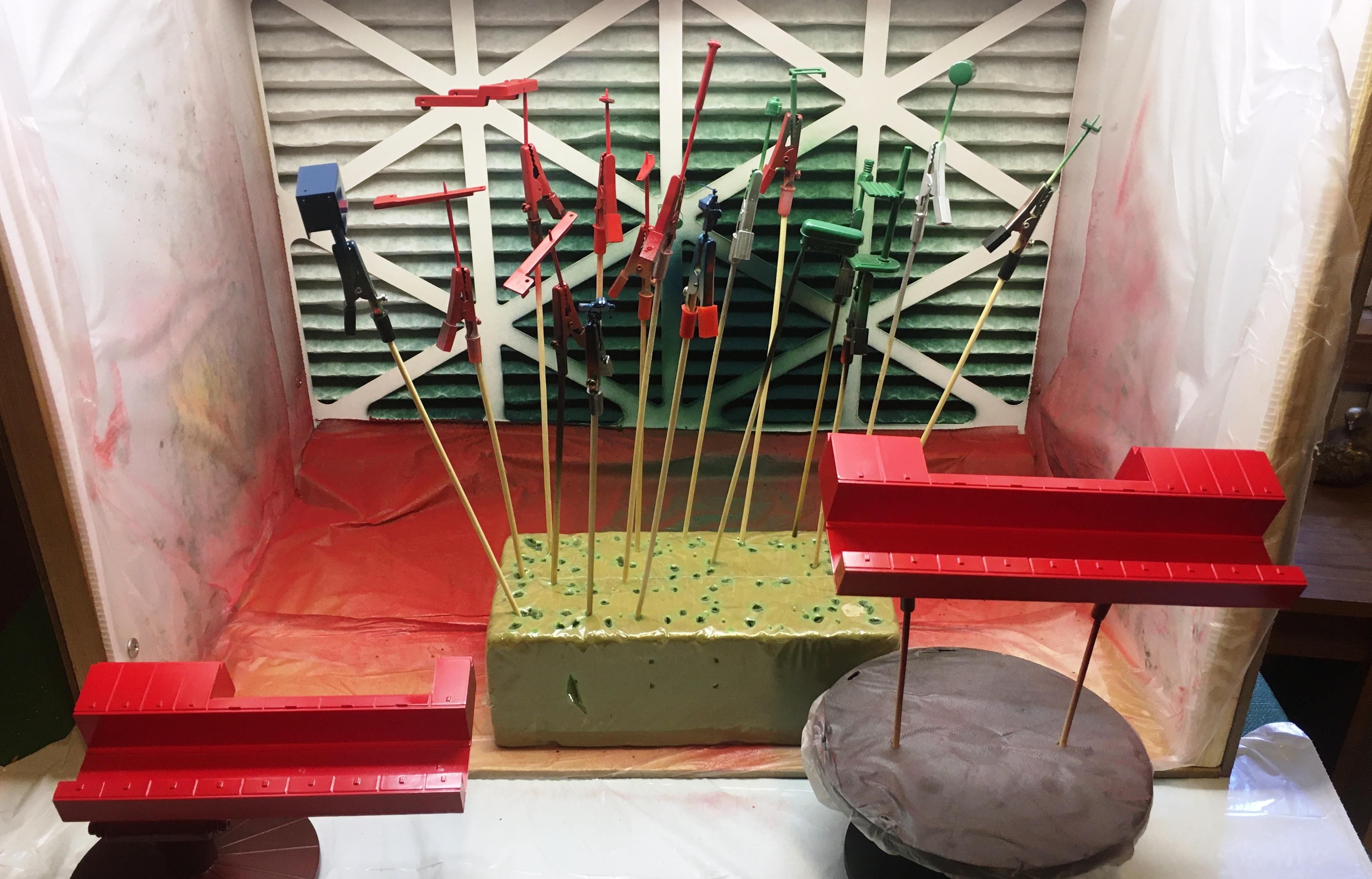

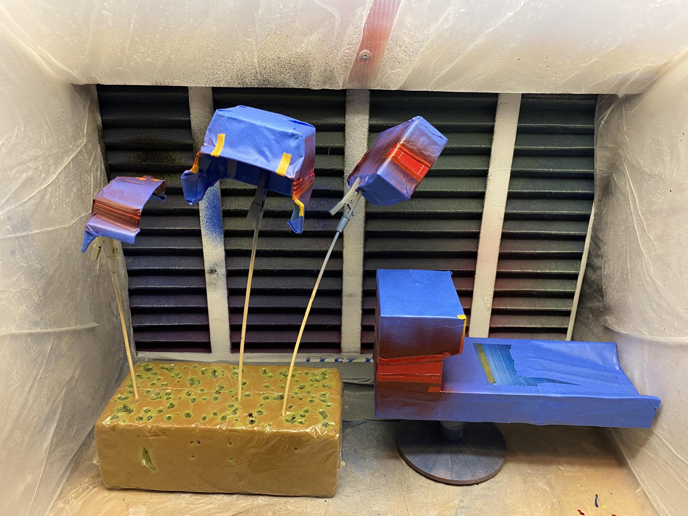

I made my own from materials I had on hand. The key is width and lighting. Fan/Airflow requirements will depend on how long and skinny your exhaust is.
Mine is about 25" wide. Before you use it, do your self a big favor and skin the inside with GLAD press-and-seal film. It keeps your inner walls and deck clean over the long run. When it is dirty. Peel it off and apply a new batch. Works for the table you put it on too. I had an unforeseen fortunate choice of materials when it came to using corrugated plastic sheeting. It holds freshly painted parts on bamboo skewers right above the action, making assembly line painting require much less motion (and boo boos) on my part. Note: Multiple parts IN the booth were staged there for in-progress photography purposes but, show how much width 25" can provide.
