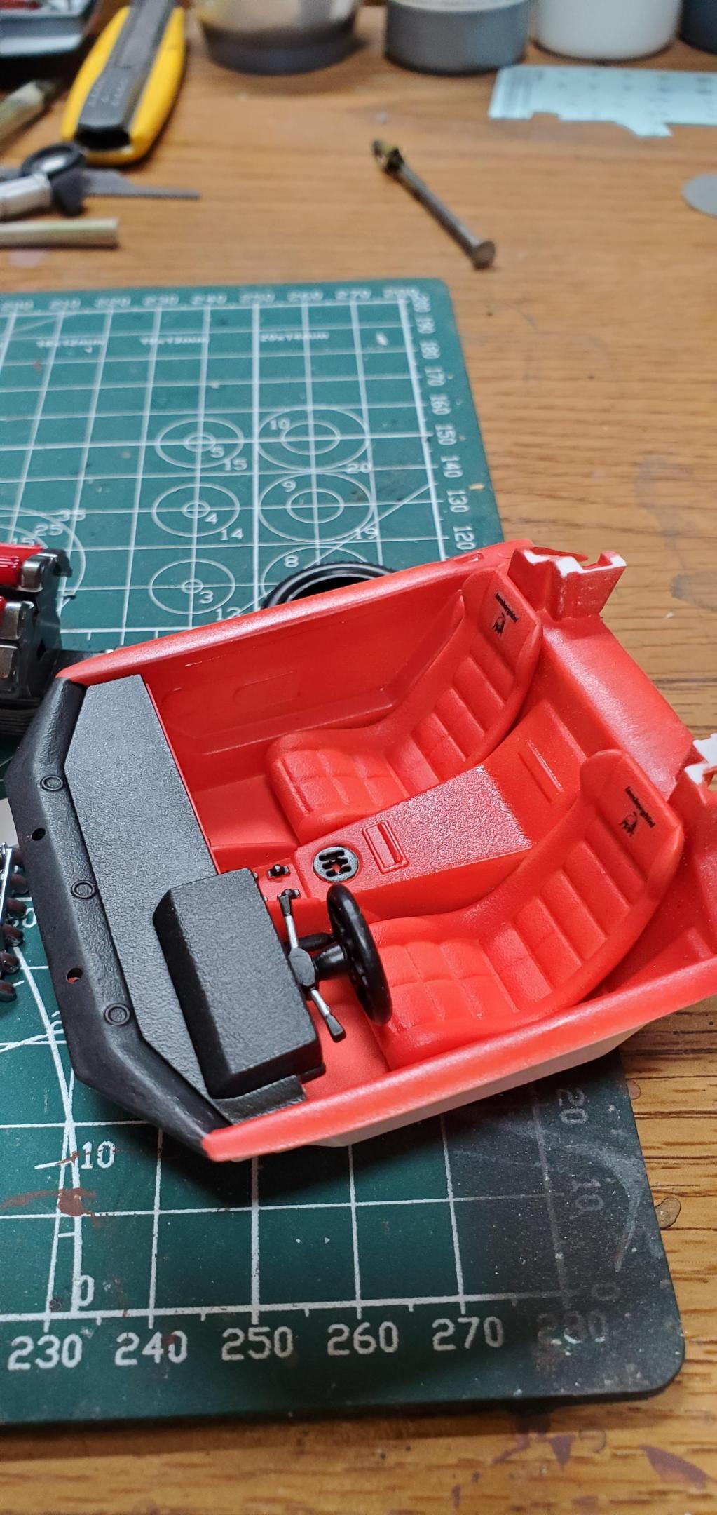

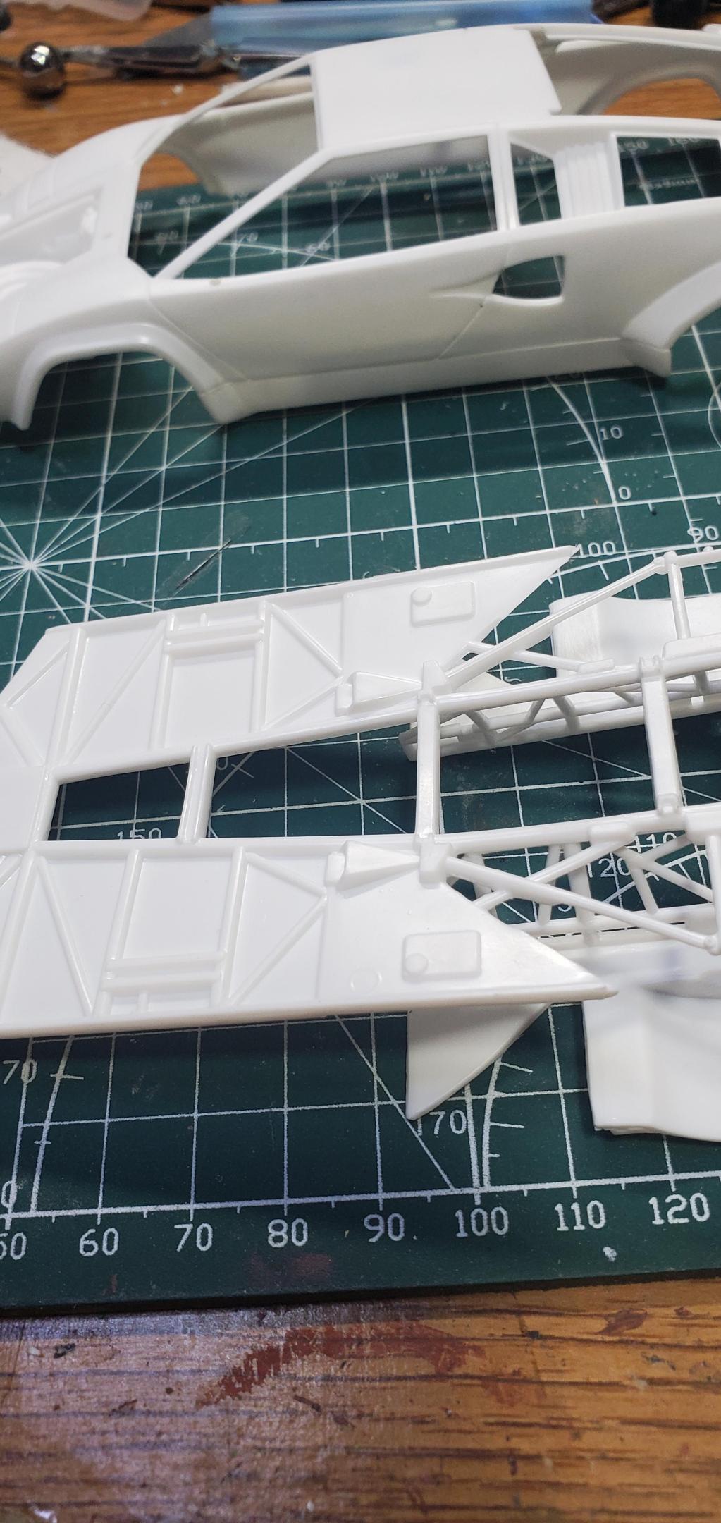

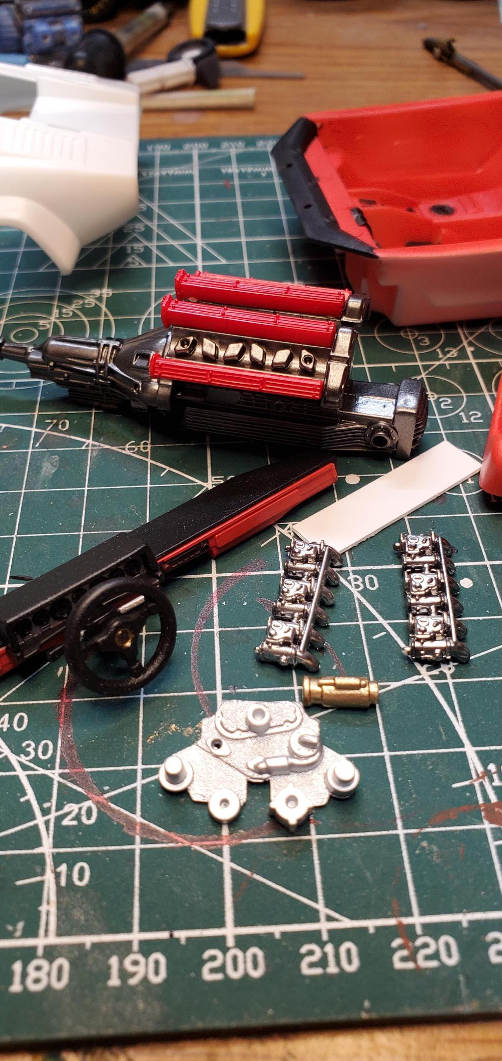

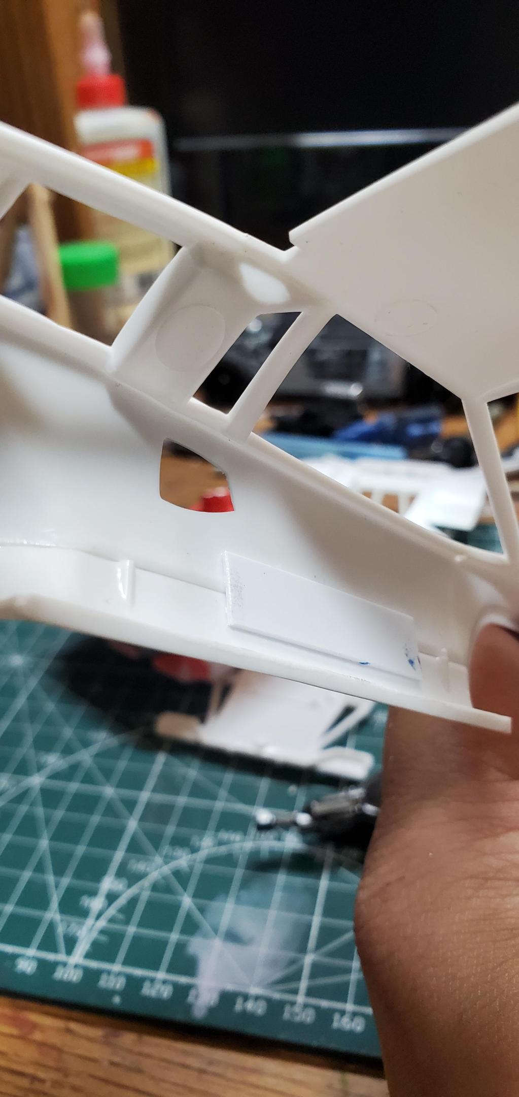

LL3 Model Worx Posted November 15, 2022 Share Posted November 15, 2022 Started this a few days ago... got the kit in a trade a few years ago. Figured I'd try and do it basically box stock... it will be a warm up for another Countach coming up soon. I started by sawing the lower body panels off the chassis pan and attached them to the body, it made no sense why they were made this way. My chassis pan was warped, so had to heat it and straighten it out. Its basically flat now. I scabbed a piece of styrene in the backside so I could keep the panel gap intact. I've been working on the engine and interior today, I've got most of it in base color... I grabbed Steel Alcad instead of aluminum and didn't realize before I started spraying the engine... but I kinda like the darker appearance, so left it. I've been adjusting the height of the interior tub because the top bulkhead where the rear glass goes stops the tub from sitting flush to the roof. I'll post more as I go along. Quote Link to comment Share on other sites More sharing options...

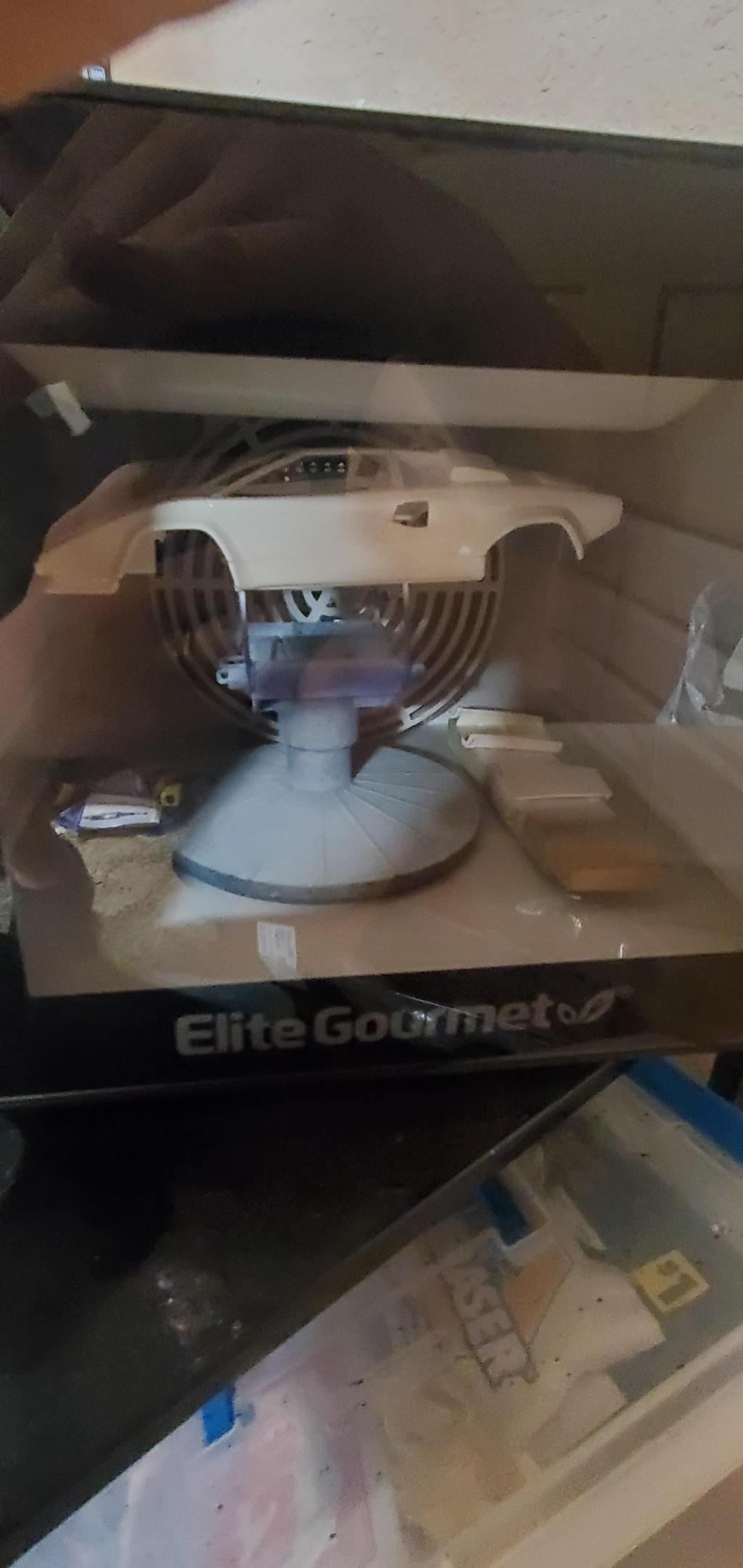

LL3 Model Worx Posted November 20, 2022 Author Share Posted November 20, 2022 Decanted and laid down some Testors "classic white"... Now it's in the new dehydrator, trial run... fingers crossed 🤞 I'm figuring 104° for 6hrs to start.... Quote Link to comment Share on other sites More sharing options...

FLHCAHZ Posted November 21, 2022 Share Posted November 21, 2022 Bummer! Engine looks great! 1 Quote Link to comment Share on other sites More sharing options...

Andrew McD Posted November 23, 2022 Share Posted November 23, 2022 I quite like the dark engine color. How did you heat the chassis to straighten it? I attempted to straighten a Foose Cadillac warped chassis with a heat gun and the results were somewhat less than satisfying. Your Lambo is looking great. 1 Quote Link to comment Share on other sites More sharing options...
LL3 Model Worx Posted November 23, 2022 Author Share Posted November 23, 2022 46 minutes ago, Andrew McD said: I quite like the dark engine color. How did you heat the chassis to straighten it? I attempted to straighten a Foose Cadillac warped chassis with a heat gun and the results were somewhat less than satisfying. Your Lambo is looking great. I past it over a candle very quickly... took several passes and incremental adjustment to get it straight. Thanks for looking I got the body out of the dehydrator last night. Will have more photos hopefully by this evening. Quote Link to comment Share on other sites More sharing options...

LL3 Model Worx Posted November 25, 2022 Author Share Posted November 25, 2022 (edited) Paint came out fairly decent... got a few spots that need buffed but serviceable. I am impressed with the new mini dehydrator! I love how the kit includes dual coils but only has a spot for 1 wire cap instead of 2... wich is certainly an option as some cars were converted to dual coil and dual cap adjustable ignition. But it also includes no cap at all, just a nub. So I had to do the down and dirty and break out the styrene tubing. Edited November 25, 2022 by LL3 Model Worx 1 Quote Link to comment Share on other sites More sharing options...

Oldcarfan27 Posted December 8, 2022 Share Posted December 8, 2022 On 11/15/2022 at 12:50 PM, LL3 Model Worx said: I started by sawing the lower body panels off the chassis pan and attached them to the body, it made no sense why they were made this way. Maybe the roll under was too deep for the tooling design to release from the mold that way? Just a guess. Quote Link to comment Share on other sites More sharing options...
LL3 Model Worx Posted December 8, 2022 Author Share Posted December 8, 2022 4 minutes ago, Oldcarfan27 said: Maybe the roll under was too deep for the tooling design to release from the mold that way? Just a guess. Hadn't really thought about that, but it sounds reasonable considering it is pretty deep. Quote Link to comment Share on other sites More sharing options...
