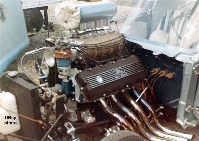

Ace-Garageguy Posted November 29, 2022 Posted November 29, 2022 (edited) Below is the only photo I've seen that clearly shows the water lines on the blue Mustang supercharged incarnation. There is a roughly Y-shaped pair of small diameter hard lines that run to the timing cover, on either side of the blower drive. Passages through the chain (timing) cover connect to the water jacket ports in the cylinder heads. These appear to be "steam" lines, vented into the reservoir tank, with no return connections visible. What IS visible is a small diameter "burp" or overflow hard line connected under the coolant pressure cap on the reservoir. This line runs down to a transverse tubular catch tank (edit) which appears to be the front frame crossmember. Edited November 29, 2022 by Ace-Garageguy CLARITY 1
