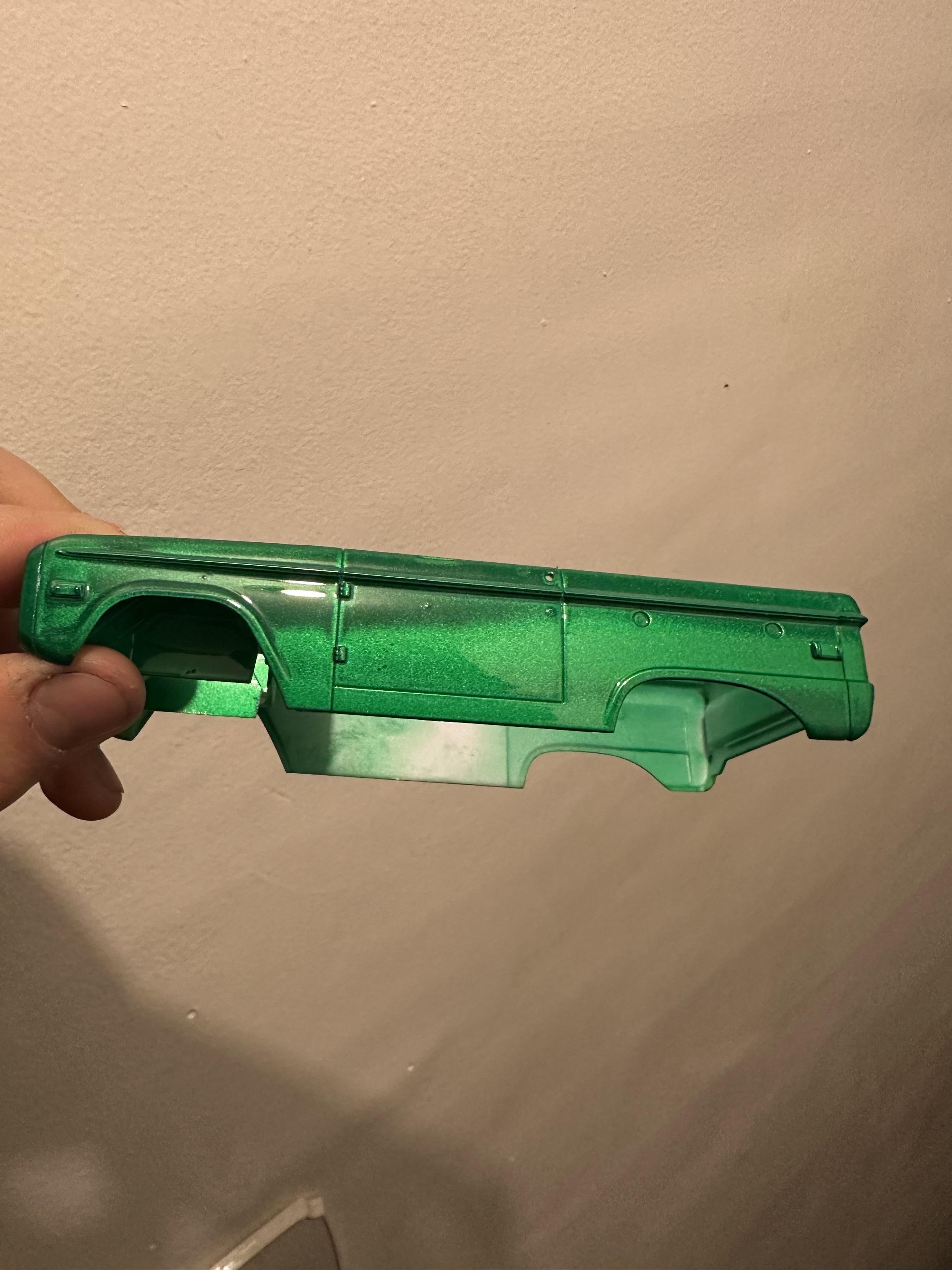

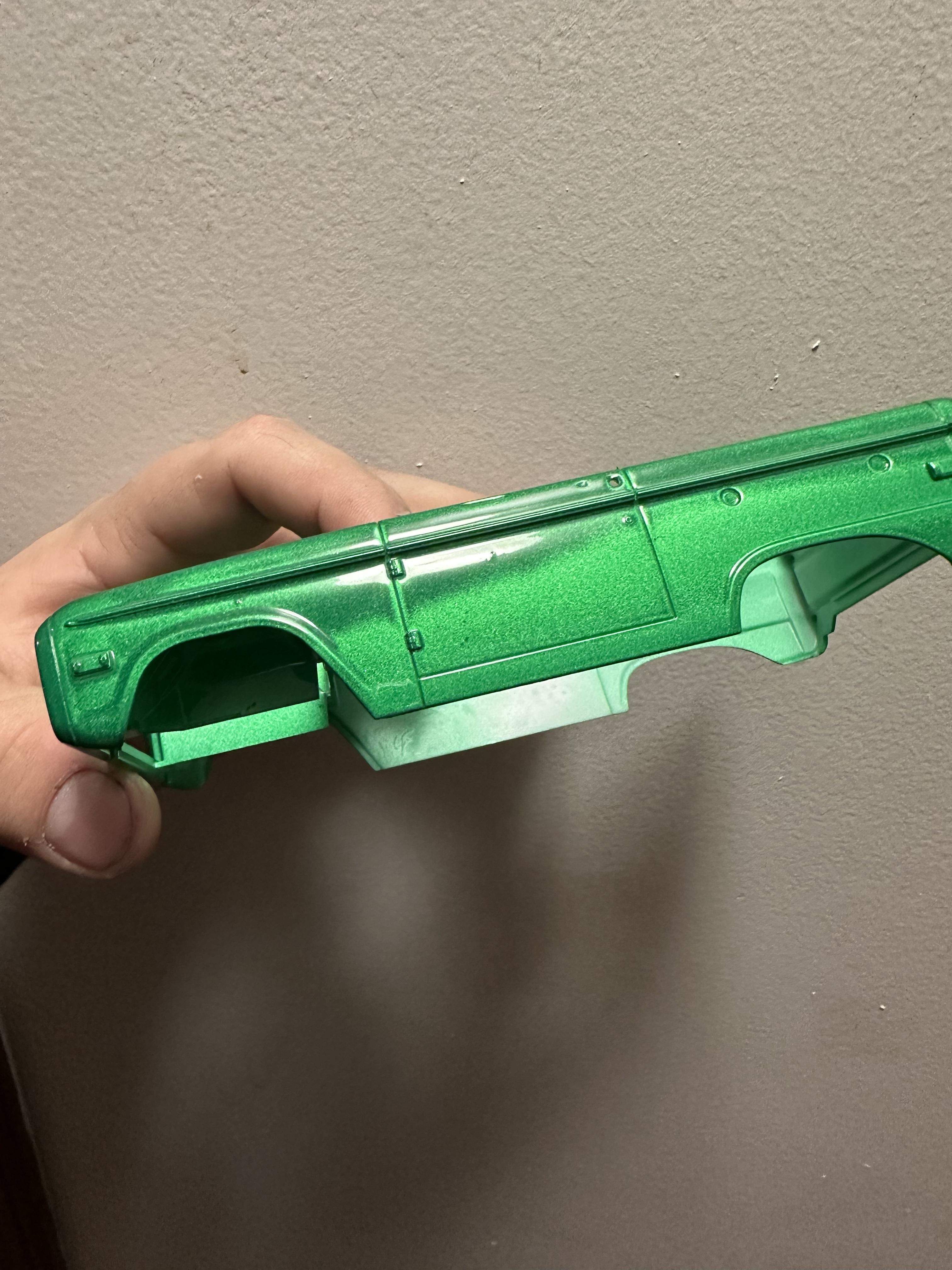

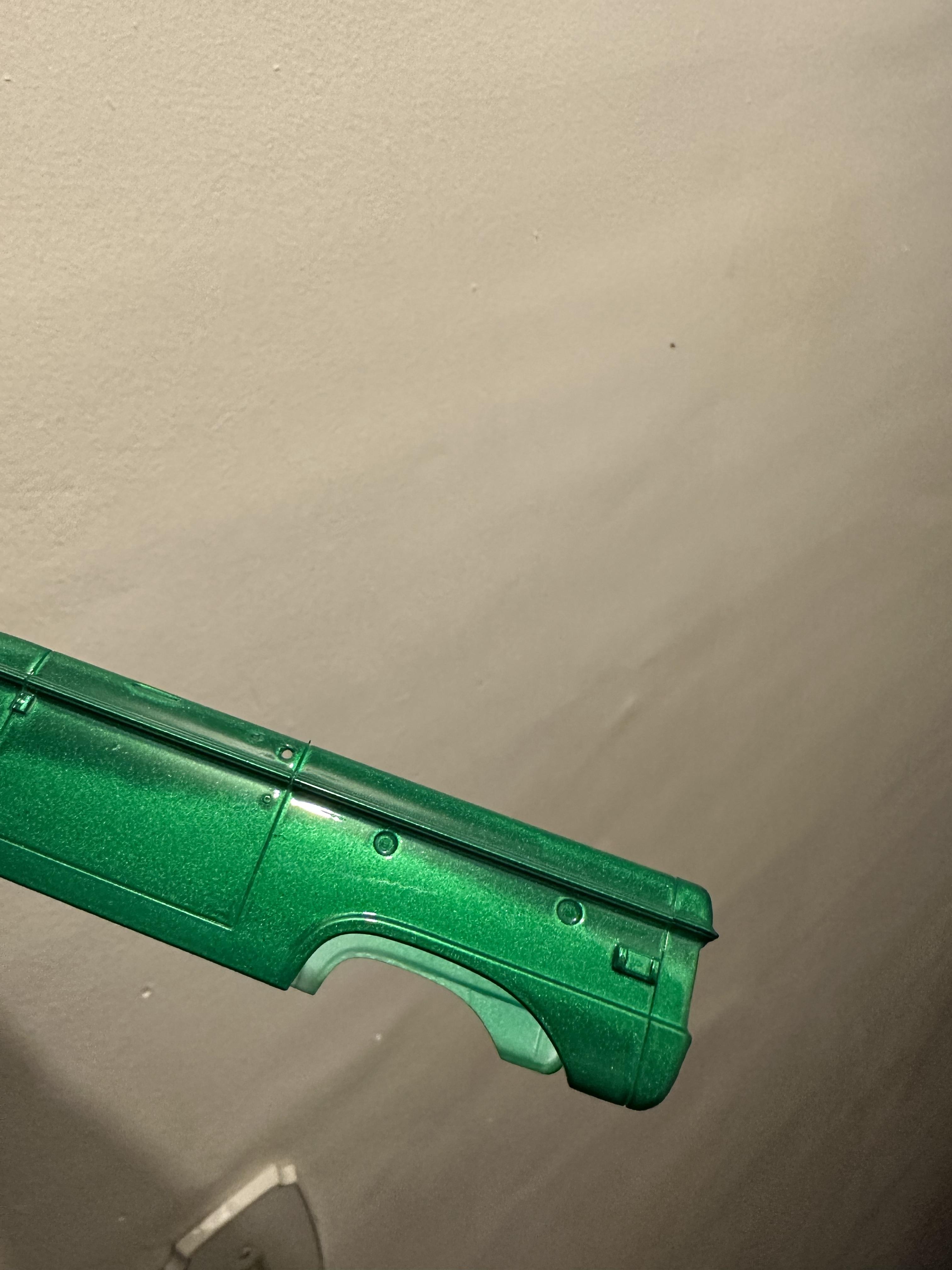

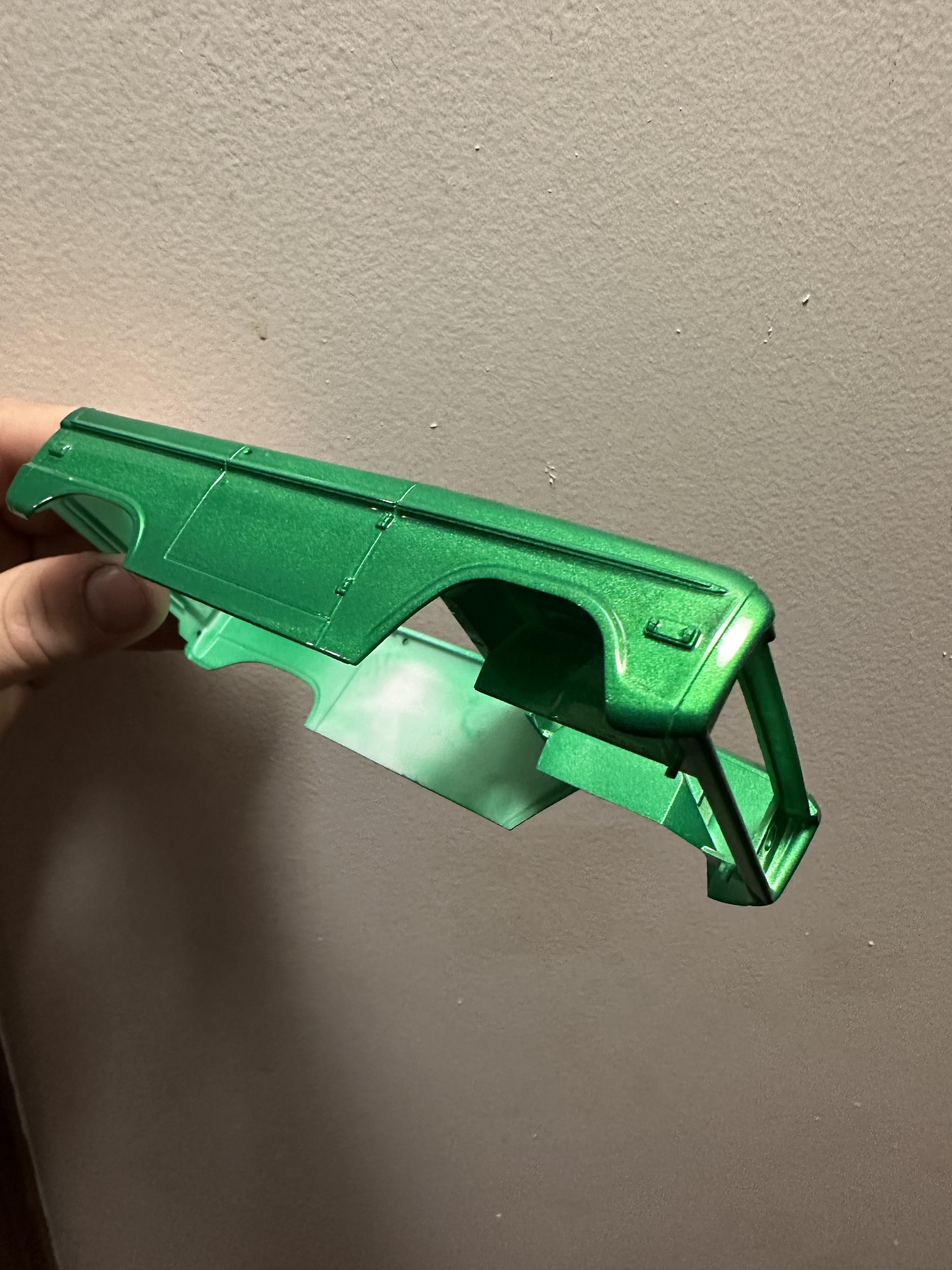

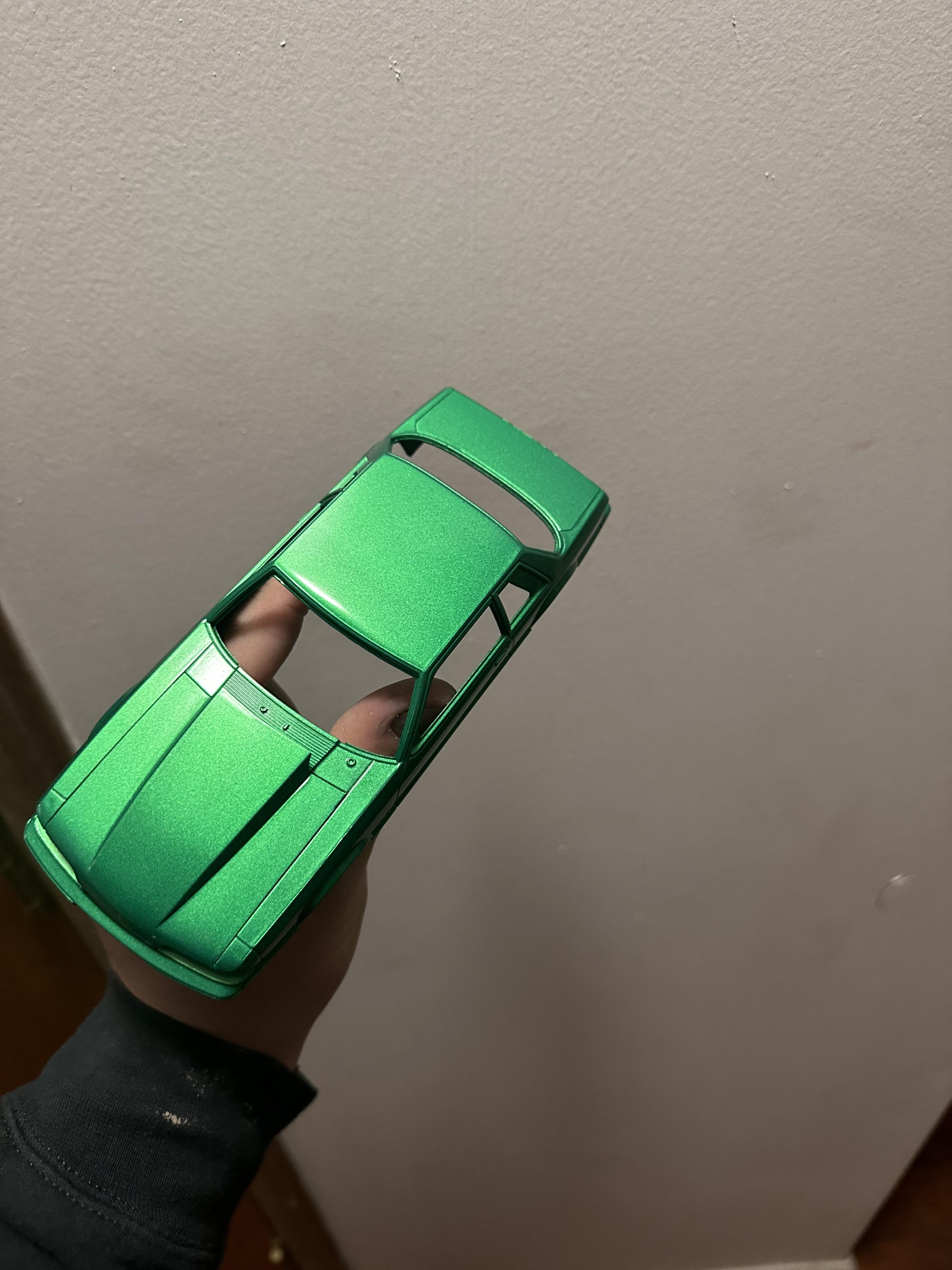

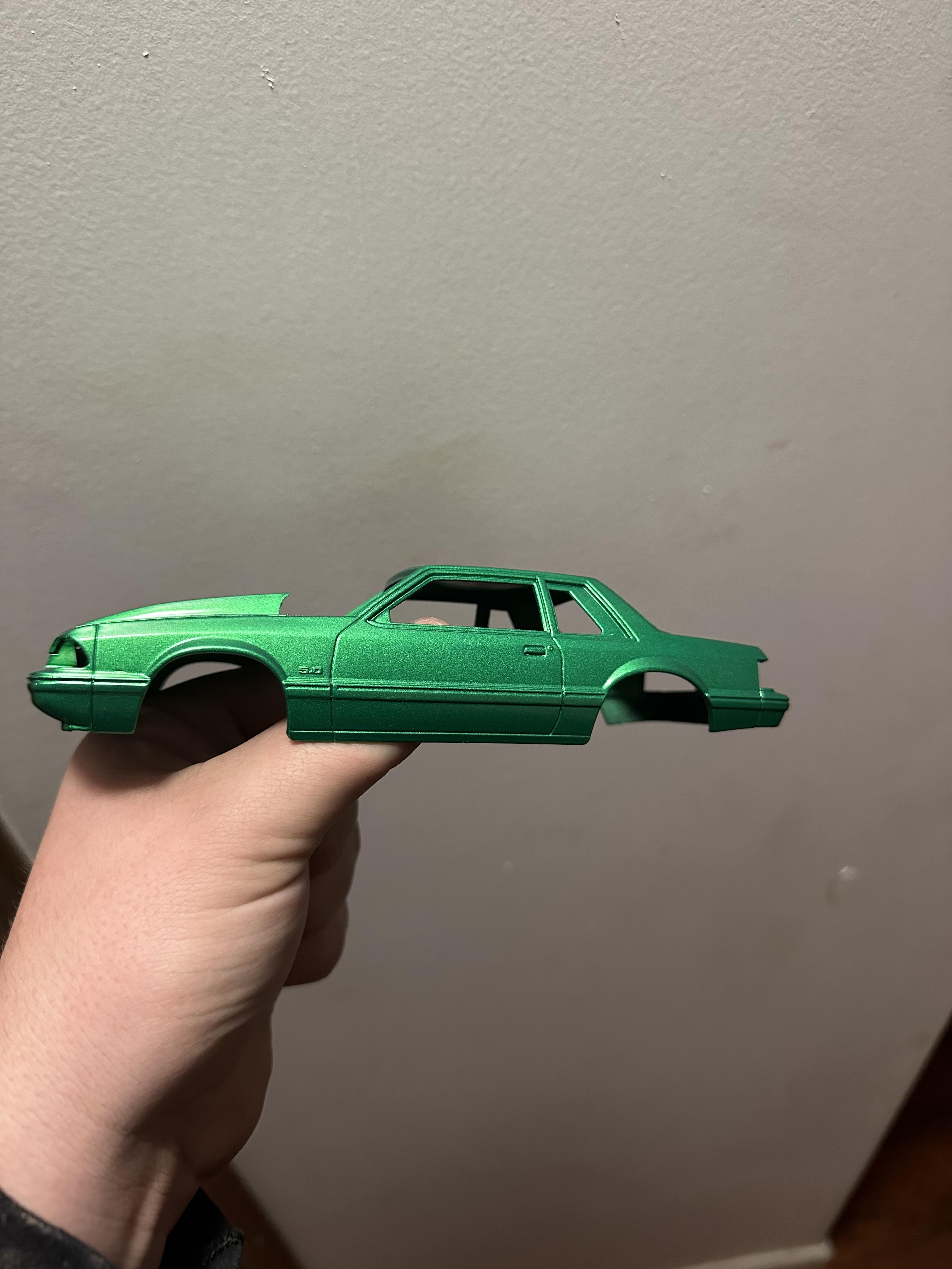

CNB25 Posted January 12, 2023 Posted January 12, 2023 (edited) I recently sprayed Nason 496-00 2K clear over Testors Extreme Lacquer that I decanted and shot out of an airbrush. The color coat looked great but when I shot the clear it caused some darker spots in the paint. I will try to upload some pictures later but any help in the meantime is appreciated! The pictures of the bronco body are after the clear I hope you can see the spots I’m talking about. The 1990 mustang is what the bronco looked like before the clear. Edited January 12, 2023 by CNB25

Ace-Garageguy Posted January 12, 2023 Posted January 12, 2023 (edited) No mystery here. The solvents in the 2K re-wetted the metallic lacquer underneath, allowing the metallic particles to fall over into the pigmented clear carrier, thus losing their reflectivity and causing local dark blotches. Either (1) the Nason 2K is just too "hot" to be used over the Testors lacquer, or 2) the 2K was applied way too wet, attempting to get it to flow out glossy, or 3) the application of the clear OR the green was uneven and too heavy in only the areas where the dark streaks appeared (which is what I suspect), or 4) the green just wasn't sufficiently dry prior to shooting the clear. If you've used this particular combination of products before with no problems, it's an application issue with this particular job. If you have NOT used this combination of materials before, this is why we continually preach "test any new combination of materials, or any change in technique, on something you don't care about BEFORE you paint a good model". This is also the reason we preach the wisdom of using products that are designed to work together. Big-car metallic basecoats are specifically designed to NOT re-wet and go mottly when urethane clears are applied over them, but without testing the Nason clear sufficiently over the Testors metallic lacquer basecoat, things like this can happen. A good primer under everything, over properly prepared plastic, MAY OR MAY NOT have an effect on the stability of the green metallic, but without testing, you're playing Russian roulette with any paint job. Edited January 13, 2023 by Ace-Garageguy CLARITY 2

peteski Posted January 13, 2023 Posted January 13, 2023 (edited) To me it looks like the metallic paint was not applied evenly over the entire body. Visually the coverage looked solid and even, but some areas have a heavier coat of paint. Then the clear partially dissolved the base layer of metallic green and some of the metallic particles and green dye got into the clear. That is why there are color variations. Or maybe the clear was applied unevenly and where it was applied heavier it partially dissolved the metallic green. If you look at the darker areas around the door line edges, you can see different color (as if the green paint was pulled from those areas). I'm also not sure if primer would have prevented this. The bottom line is that stripping and repainting seems to be the only option. Edited January 13, 2023 by peteski 1
