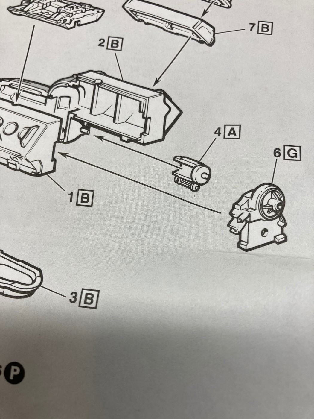

Anybody have an answer as to which way the starter would mount on a '64 389?

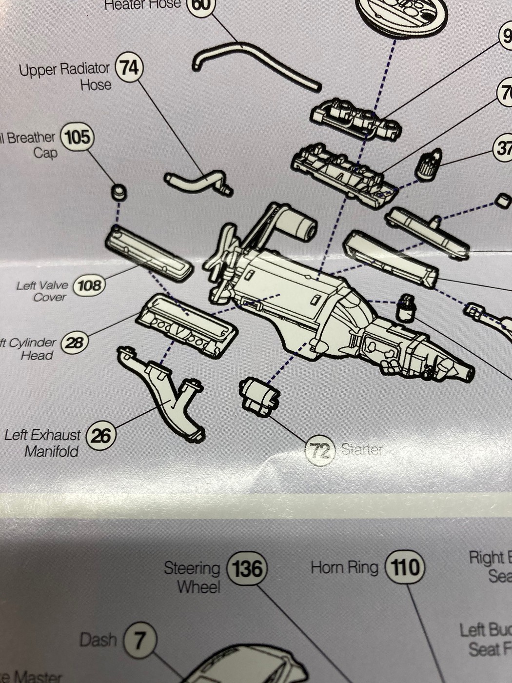

Got to looking at the instructions for the Revell '66 GTO, and it shows the starter mounting "upside down".
At least what I consider upside down.
With the solenoid on the bottom.
Anybody know if this is actually a thing?

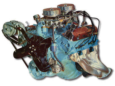

Photographic evidence: '65 389 tri power engine.
Detailing Tiemann's Tri-Power 389 - Part 2 - High Performance Pontiac ...

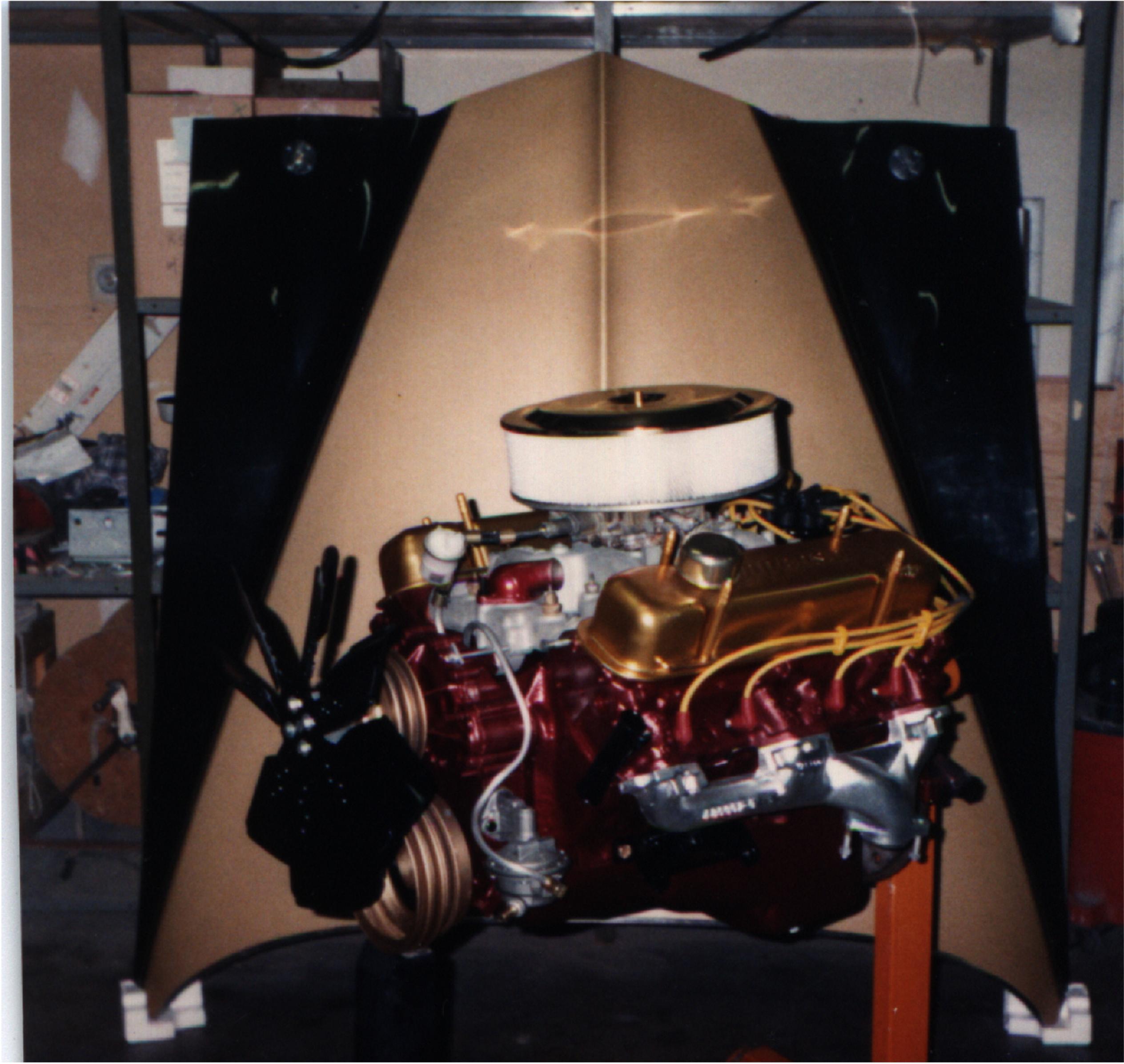

Starter with solenoid heat shield
Pontiac Starter Mounting Bracket Brace, Early
'64 Bonneville
1964 bonneville rebuild - Page 27 - Pontiac Progression Place - Forever ...
Edited by Ace-Garageguy
AND: IIRC, there are two different possible starter mountings, depending on year.
One has the unit bolted to the bellhousing with horizontal bolts.
The other mounting has vertical bolts that go up into the block, like a Chevy V8.
But either way, it's solenoid up.

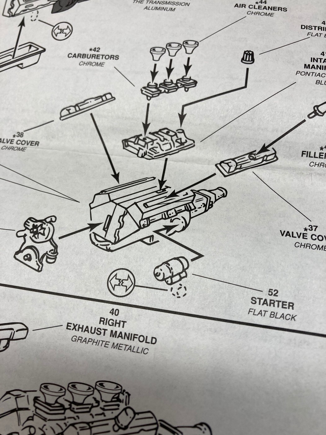

The Moebius '61 and the AMT '62 Pontiac kits both show the solenoid down as well.
Steve
