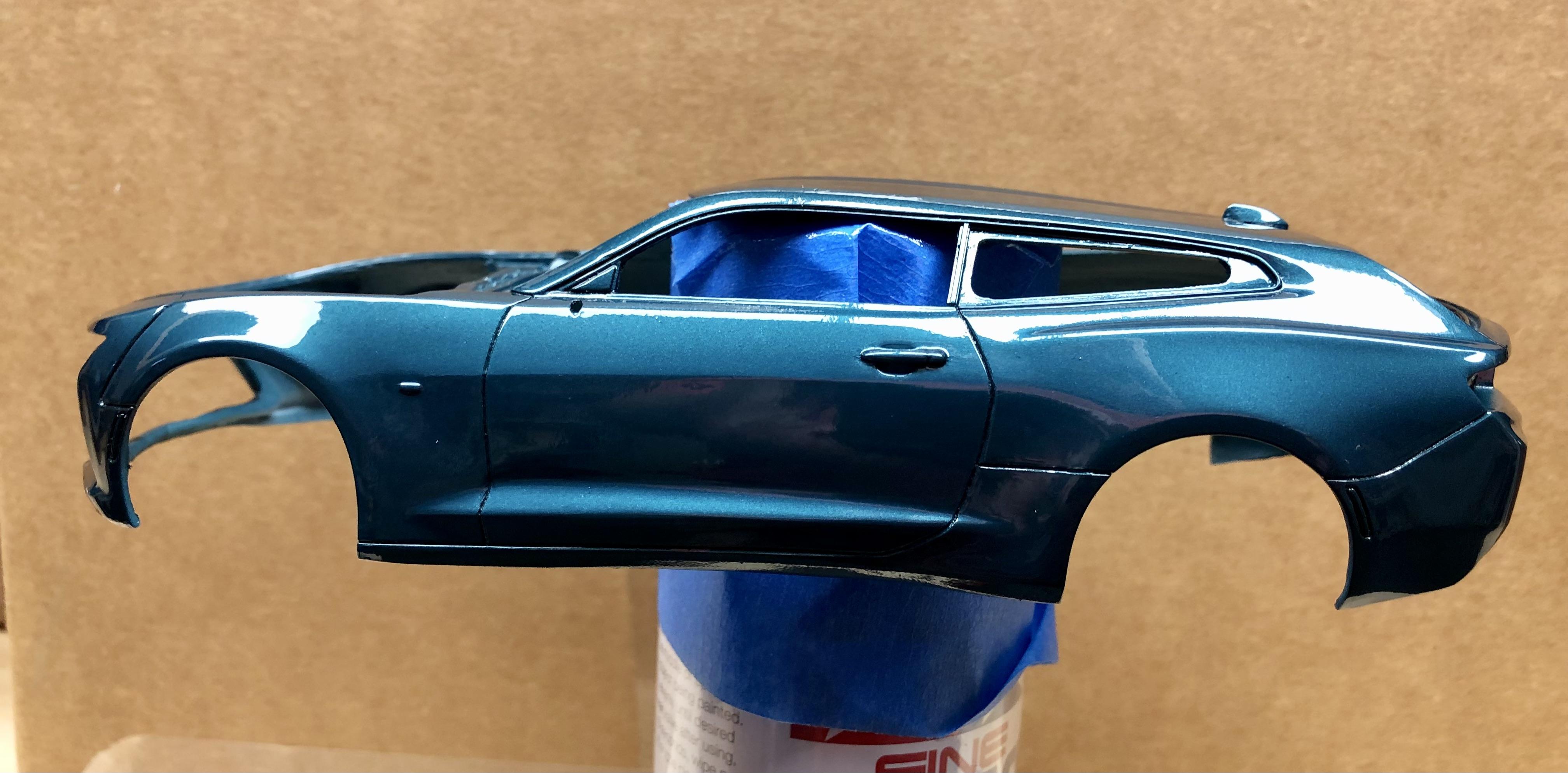

Not much **new** to report but I got a bit more dismayed on this C1 Models Shooting Brake Camaro.  Test fitted the windshield after removing just the front part from the donor glass and noted that it didn't fit.  The pillar is warped so it took a bit of creative grinding to make it so.  Mind you, it is now painted...my fault for not test fitting the windshield before paint.
Also noted the interior wasn't fitting well and found more body issues...
Then, (and I don't know why I didn't see this before) the entire drivers side is warped and at least 1/4 of an inch off!

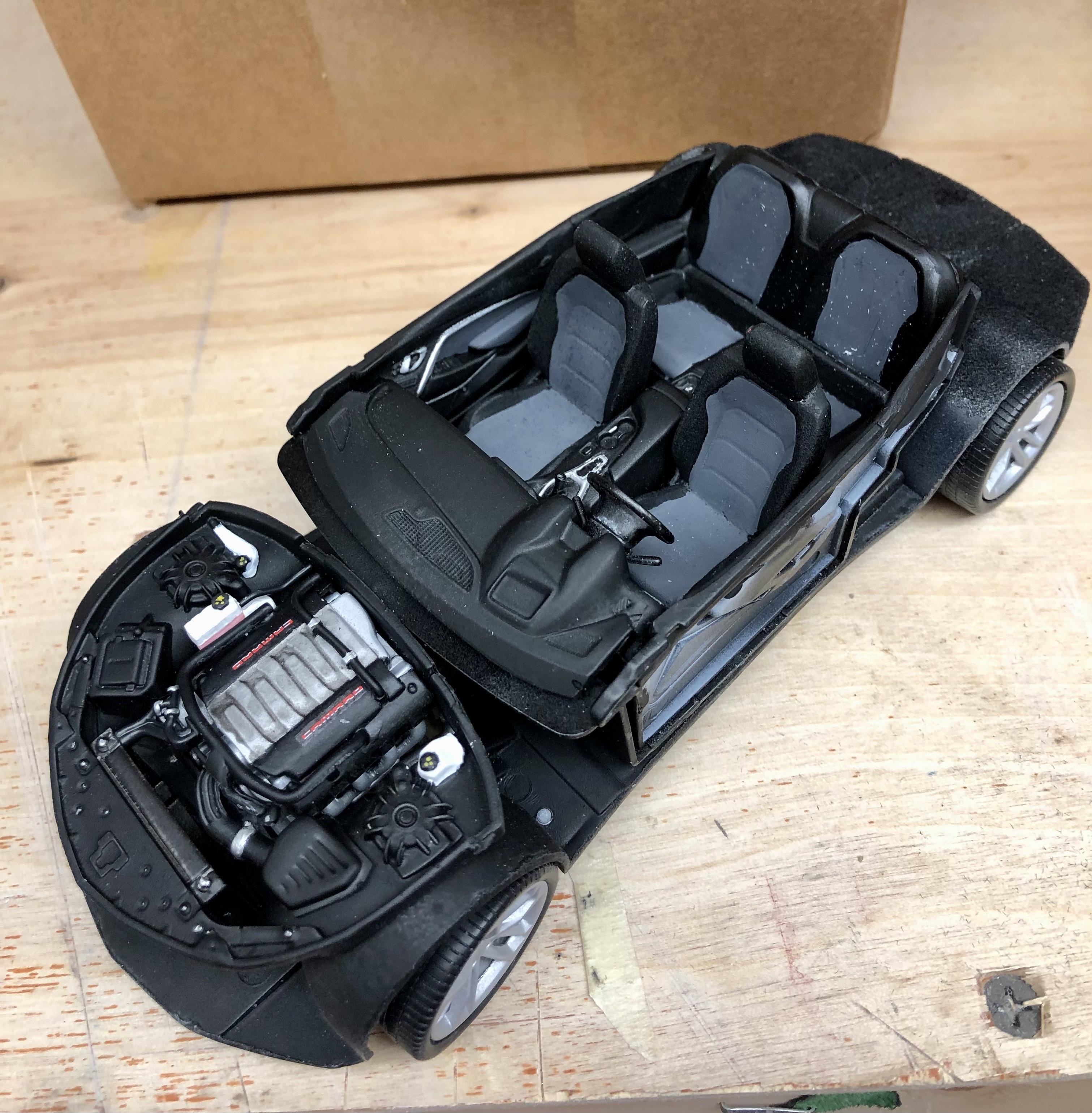

Interior and chassis are done…

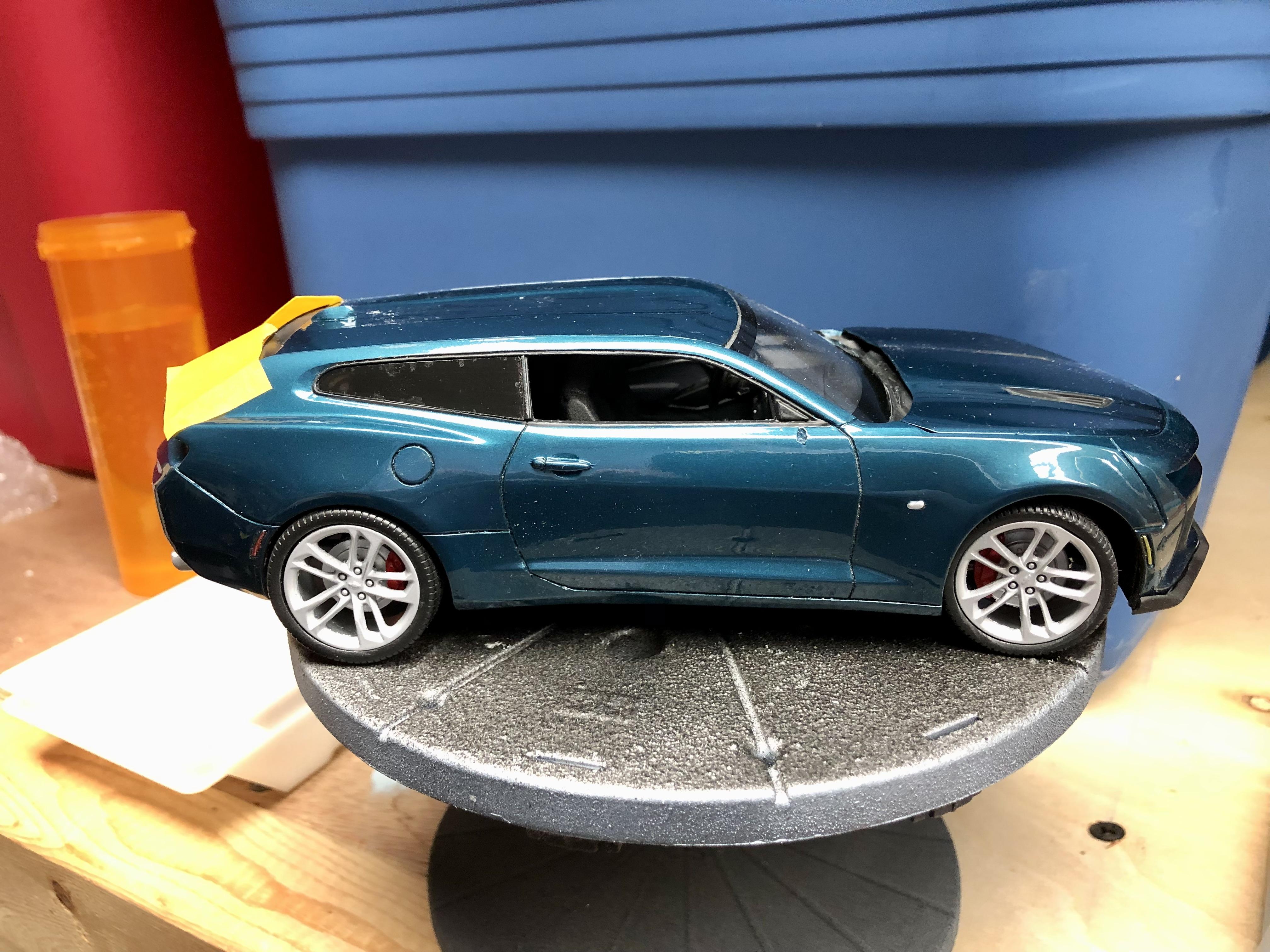

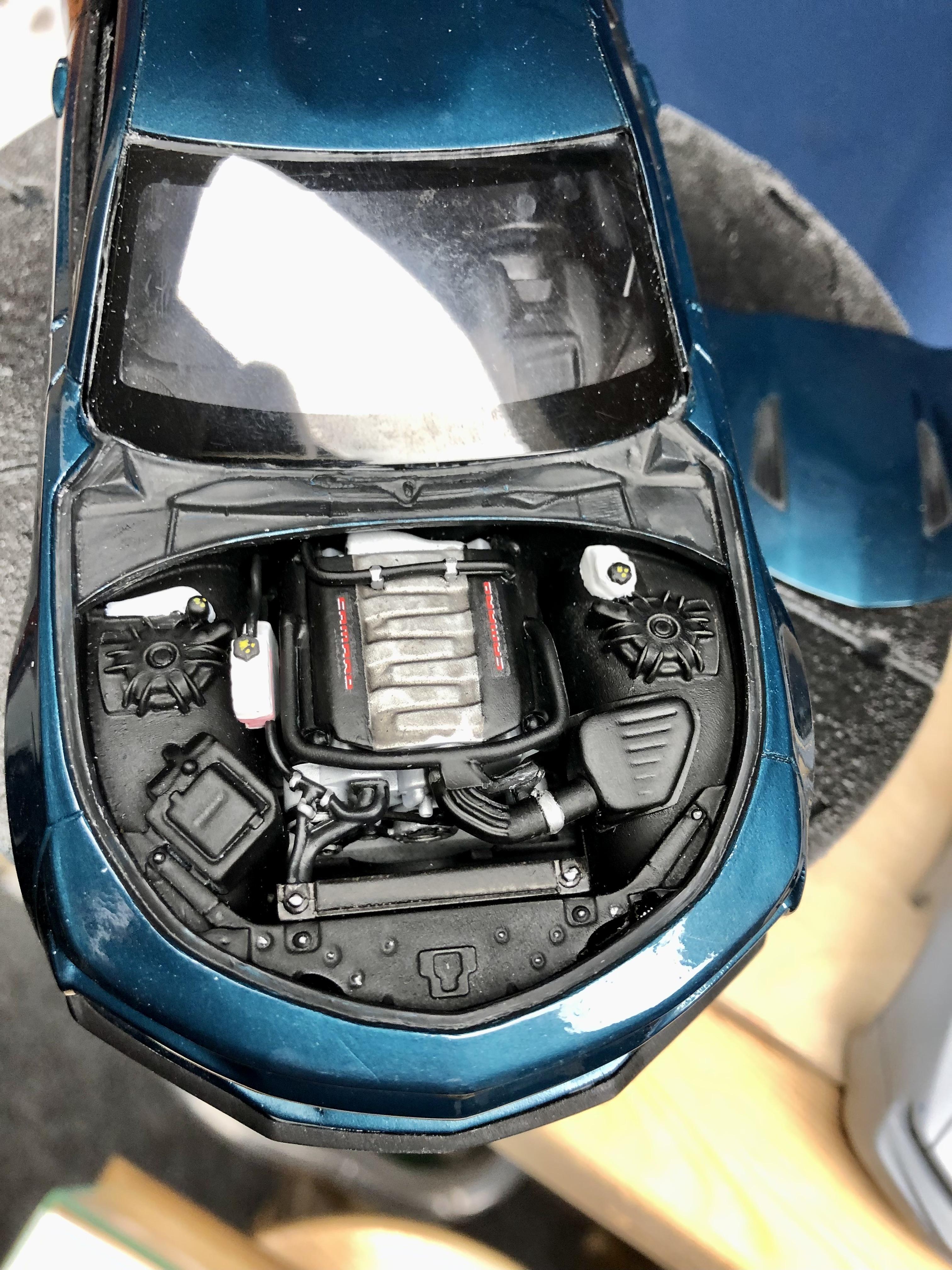

So after a bit of work straightening out a warped body, the chassis/interior and body are now one. There is still work to do (headlights, taillights, rear wind deflector, rear valance, spoiler and more) but for today, getting the body mounted was a major feat!
Side and rear windows were mounted. Rear window required to be taped down (below) and front grill work done. Suspension sits a little taller than I wanted but after the body issues encountered, I’ll take it!
Engine bay settled into place…IMG_3250.thumb.jpeg.d5e5feefbd43cae3ae5b323ad195280a.jpeg
