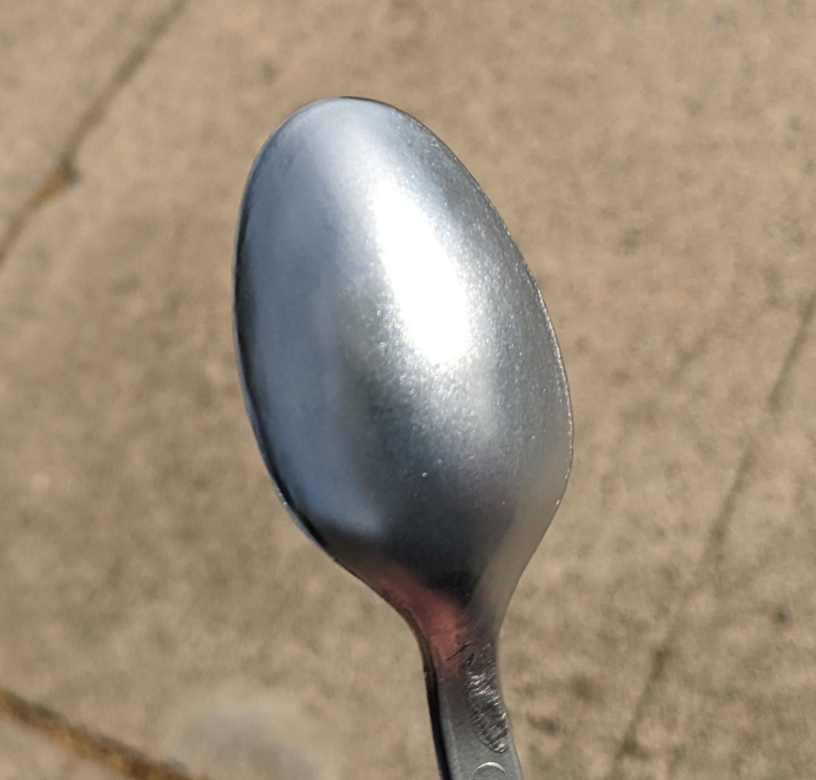

Rodent Posted April 18, 2023 Share Posted April 18, 2023 How did your test go? I painted some spoons with SpazStix black, then clear. Nice and shiny. I made some other tests, and I shot some SMS on one of them last night at 15 psi through my Paasche H. Observations: I don't know what was on the spoon, but the SpazStix went on fine. The SMS immediately started to fisheye. I put a little more on than I normally would have to try to flow out the fisheye. It really does look like (as our friends across the pond say) a dog's breakfast when you first spray it. It got shinier as it dried. About 20 hours after I shot it, I started to polish it, using the t-shirt I am currently wearing. It seems kinda soft and easy to scratch. I like the shine. I was hesitant to polish too much, but it seems to get shinier the more you polish it. If I can get around the fisheye issue, this might be good. 1 Quote Link to comment Share on other sites More sharing options...
Dpate Posted April 18, 2023 Share Posted April 18, 2023 2 hours ago, Rodent said: How did your test go? I painted some spoons with SpazStix black, then clear. Nice and shiny. I made some other tests, and I shot some SMS on one of them last night at 15 psi through my Paasche H. Observations: I don't know what was on the spoon, but the SpazStix went on fine. The SMS immediately started to fisheye. I put a little more on than I normally would have to try to flow out the fisheye. It really does look like (as our friends across the pond say) a dog's breakfast when you first spray it. It got shinier as it dried. About 20 hours after I shot it, I started to polish it, using the t-shirt I am currently wearing. It seems kinda soft and easy to scratch. I like the shine. I was hesitant to polish too much, but it seems to get shinier the more you polish it. If I can get around the fisheye issue, this might be good. That doesn't look like a chrome finish at all to me. Spazstix black base sucks. Do you got AK Xtreme metal black base or Alclad's black base? Those two are the only two black gloss bases i use for metal colors. There super easy to get a glossy smooth black base. Your spoon test looks like the chrome went on too heavy. Doesn't look bad for what it is, but doesn't have that mirror chrome finish. Quote Link to comment Share on other sites More sharing options...
Rodent Posted April 18, 2023 Share Posted April 18, 2023 50 minutes ago, Dpate said: That doesn't look like a chrome finish at all to me. Spazstix black base sucks. Do you got AK Xtreme metal black base or Alclad's black base? Those two are the only two black gloss bases i use for metal colors. There super easy to get a glossy smooth black base. Your spoon test looks like the chrome went on too heavy. Doesn't look bad for what it is, but doesn't have that mirror chrome finish. Still experimenting here. I mentioned that it fisheyed, so I wound up putting it on too heavy to compensate. Also, my phone has too good of a camera, so it magnified the flaws in the sun. I may have some Alclad base, I would have to look. Just painted another spoon with Tamiya gloss black and I am going to keep trying to see how this works out. Quote Link to comment Share on other sites More sharing options...

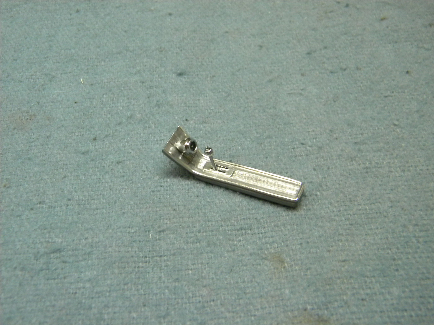

StevenGuthmiller Posted April 19, 2023 Share Posted April 19, 2023 None of these look much like chrome to me. Certainly not any better than Alclad. Alclad "Polished Aluminum" looks more like chrome than most of what I'm seeing here. A few small parts in Alclad chrome. Gauge pod and gear shift Alclad. Steve Quote Link to comment Share on other sites More sharing options...
