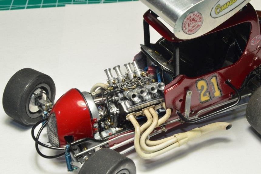

Straightliner59 Posted March 31, 2023 Posted March 31, 2023 7 hours ago, Bainford said: Or… the trick set-up is to cut the pipe off and replace it with a piece of aluminum tube. Also not difficult to do, and makes for a nice detail. That's how I did these. Not sidepipes, but the same principle. 1
atomicholiday Posted March 31, 2023 Author Posted March 31, 2023 2 hours ago, Straightliner59 said: That's how I did these. Not sidepipes, but the same principle. Those look incredible. Actually, that whole build is stunning. How do you bend the tubing without kinking i? And where can I get tubing?
Straightliner59 Posted April 1, 2023 Posted April 1, 2023 19 hours ago, atomicholiday said: Those look incredible. Actually, that whole build is stunning. How do you bend the tubing without kinking i? And where can I get tubing? There are a couple of ways to bend the tubing. I cut a piece of 1/2" aluminum rod to a length to match the diameter of the tubing (if you're using 1/4" tubing, cut the rod 1/4" long), then clamped them both in a vise, and slowly bent the tubing around the rod. The vise keeps the tubing from crimping, as long as you work carefully. I think a section of dowel would be even easier, and just as effective as the aluminum rod. You can buy the tubing at a good hobby shop, or online, if you don't have one, close by. Hope this is helpful!

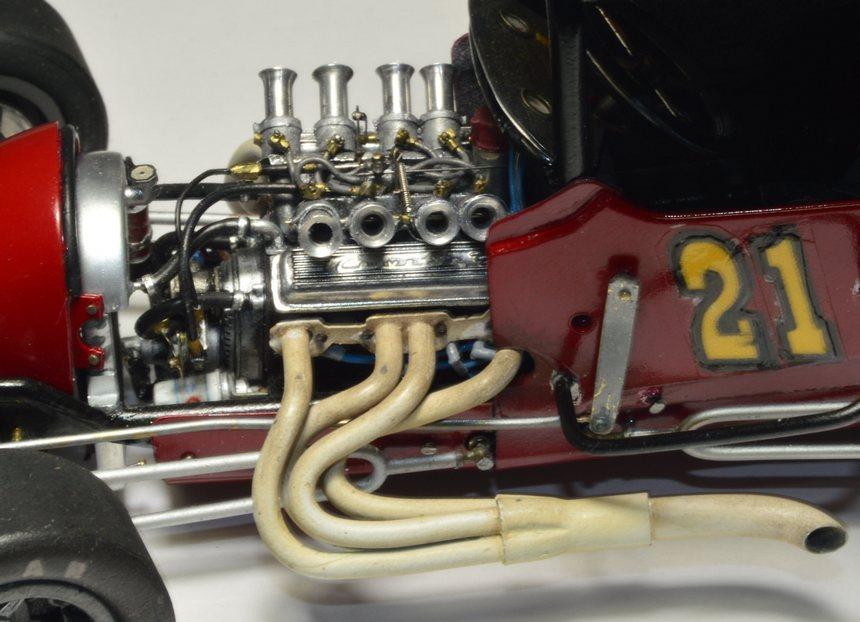

Pierre Rivard Posted April 3, 2023 Posted April 3, 2023 Jeremy, if you are not comfortable (like me) working with aluminium there is also the alternative to work with Evergreen rods and tubes. On these pics below I built the entire dumps from 3.2 mm rod, using a bit of heat to bend, then the last tip with 3.2 mm Evergreen tube. I further hollowed out the outlet with my #11 blade. Easy to build in sections, glue, sand and finish. Evergreen 4 mm also available if you want beefier pipes. 1
atomicholiday Posted April 4, 2023 Author Posted April 4, 2023 Pierre, those look great. Beautiful model too! Lots of really good ideas so far, and options I didn't know existed. I kinda want to try them all out!
