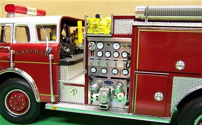

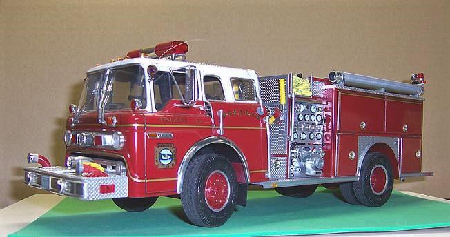

GLMFAA1 Posted April 11, 2023 Posted April 11, 2023 (edited) Not a very hard conversion to do: here are a few of mine This one was from a long time ago which I donated to a charity auction. Here are some hints: If you need some help feel free to pm me. Please make sure the hard suction ends are reversed from the instructions as they are shown the wrong way. greg Edited April 11, 2023 by GLMFAA1 addded photo 2
Chariots of Fire Posted April 12, 2023 Posted April 12, 2023 Those are all great suggestions. Don't forget those little vents right behind the door handles. They can be made using a fine black marker. Also use 1/8" sewing elastic for the cross lays and 1/4" sewing elastic for the 2-1/2" supply and heavy working lines in the hose bed. I'll post a tutorial on how to make the interior of the hose bed that will save a lot of that sewing elastic. 2

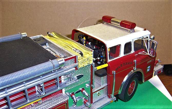

Chariots of Fire Posted April 13, 2023 Posted April 13, 2023 Here's a look at how to save on the amount of elastic used to create a full hose load. First build a box of card stock or plastic stock that fills most of the hose bed. Leave enough of the sides showing something like in the photo below. Cut small lengths of sewing elastic, glue and double them over to look like the ends of the folded hose. That's a 1/32 scale Monogram fire body in the photo and I'm using 1/8" elastic that has been stained to look like cotton jacket hose. When the short sections fill the back of the bed even with the box, begin to lay full sections of elastic over the whole thing in a couple of layers. I'd advise painting the top of the box the same color as the elastic so that the white doesn't show through. You'll notice that there are brass couplings on the hose. They are made using brass tubing with the grooves made with an SK tubing cutter. When the bed is full it will look something like this. This is a different rig than the Monogram Mack but the same principle was used to create a full hose load. The LDH is 3M tape folded in 3rd's to simulate synthetic hose. There is also some sewing piping used for the red hose. Don't forget to dirty it up a bit. Even when cleaned, the hose will retain some of the black staining and dirt left from operating in a fire situation. 2

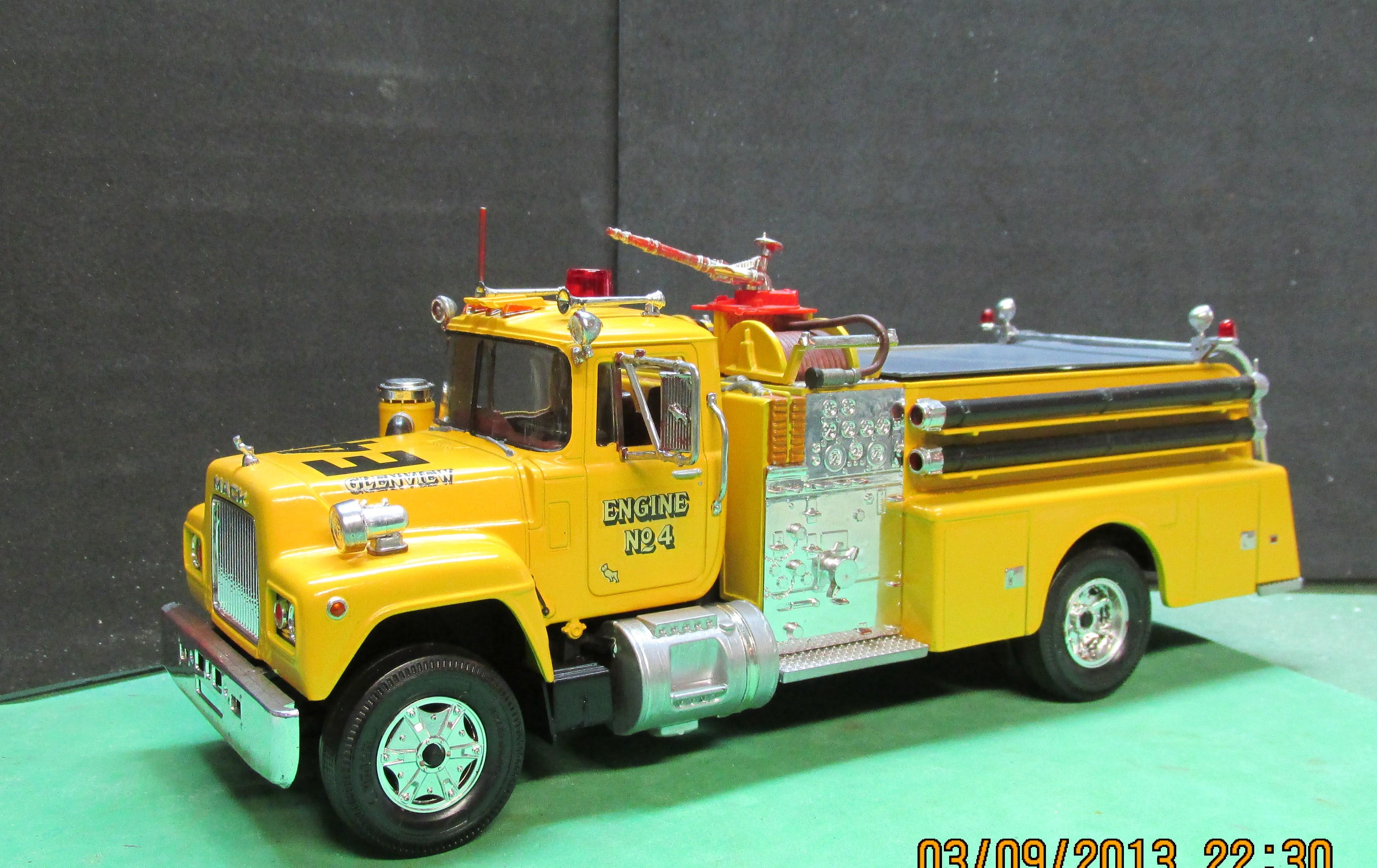

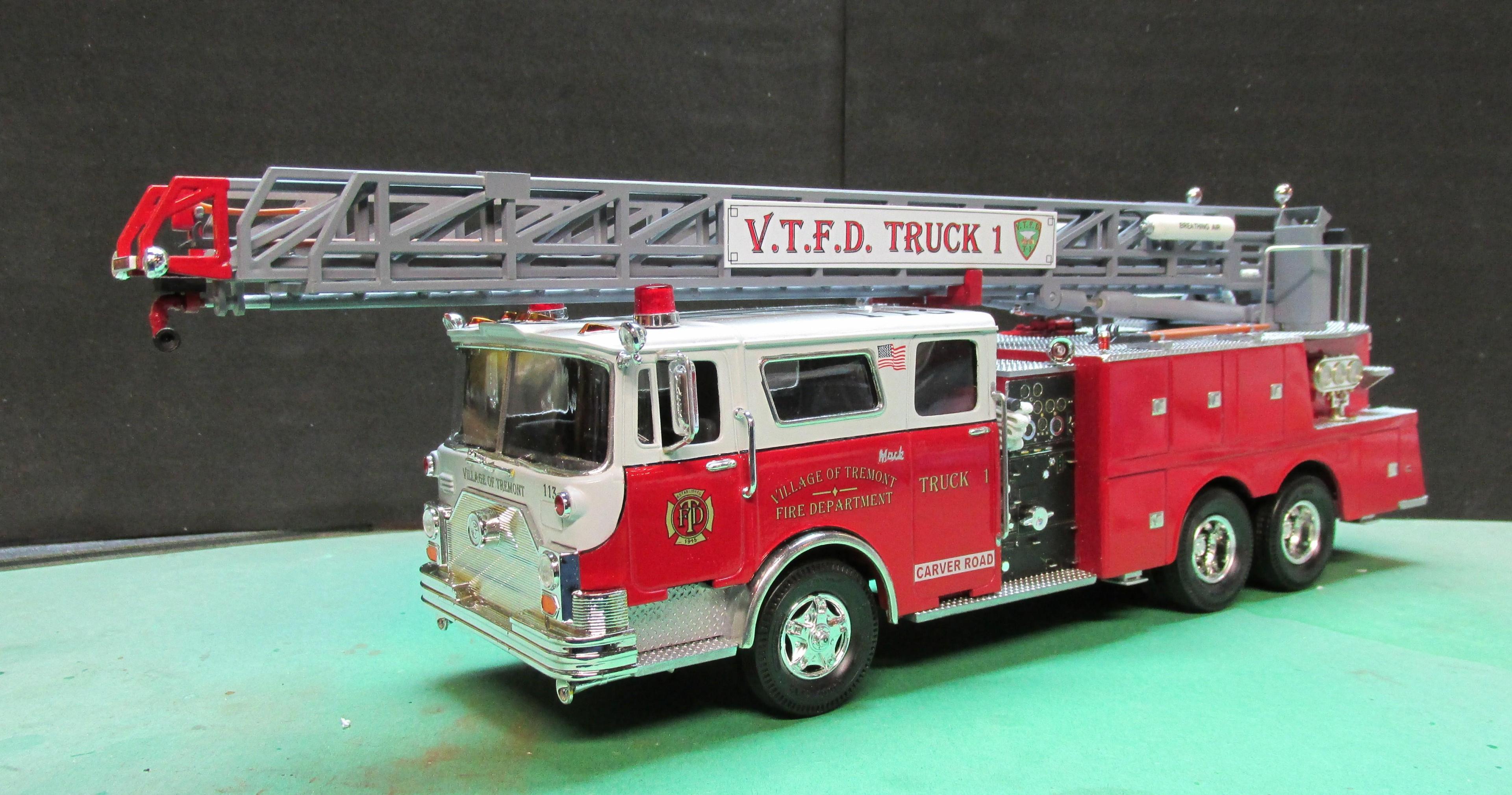

Chariots of Fire Posted April 14, 2023 Posted April 14, 2023 I wish the old Monogram CF Mack snap kits were 1/25 scale but they are not. Anyway, there is a lot of possibility with those kits. With a few adjustments and changes a decent rig can result. Here are some that date back a few years using the Monogram kits. R model Mack linked with the CF body. Two CF cabs and three CF bodies make this rear mount aerial. Closed cab CF in Providence, RI livery. Standard CF just gussied up a bit. 1

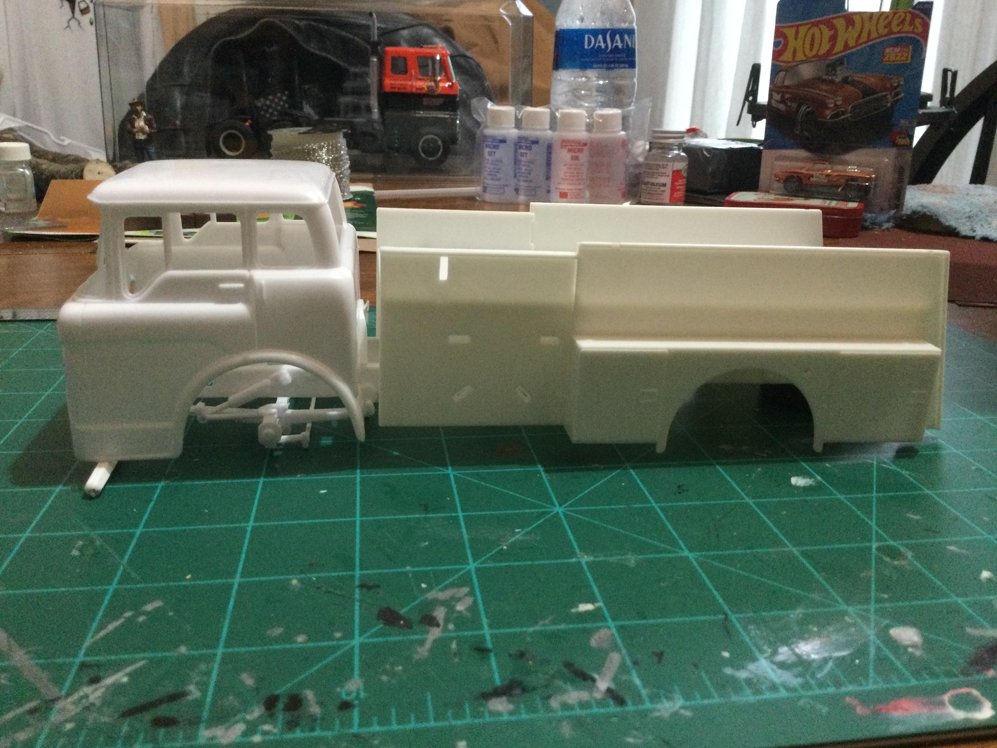

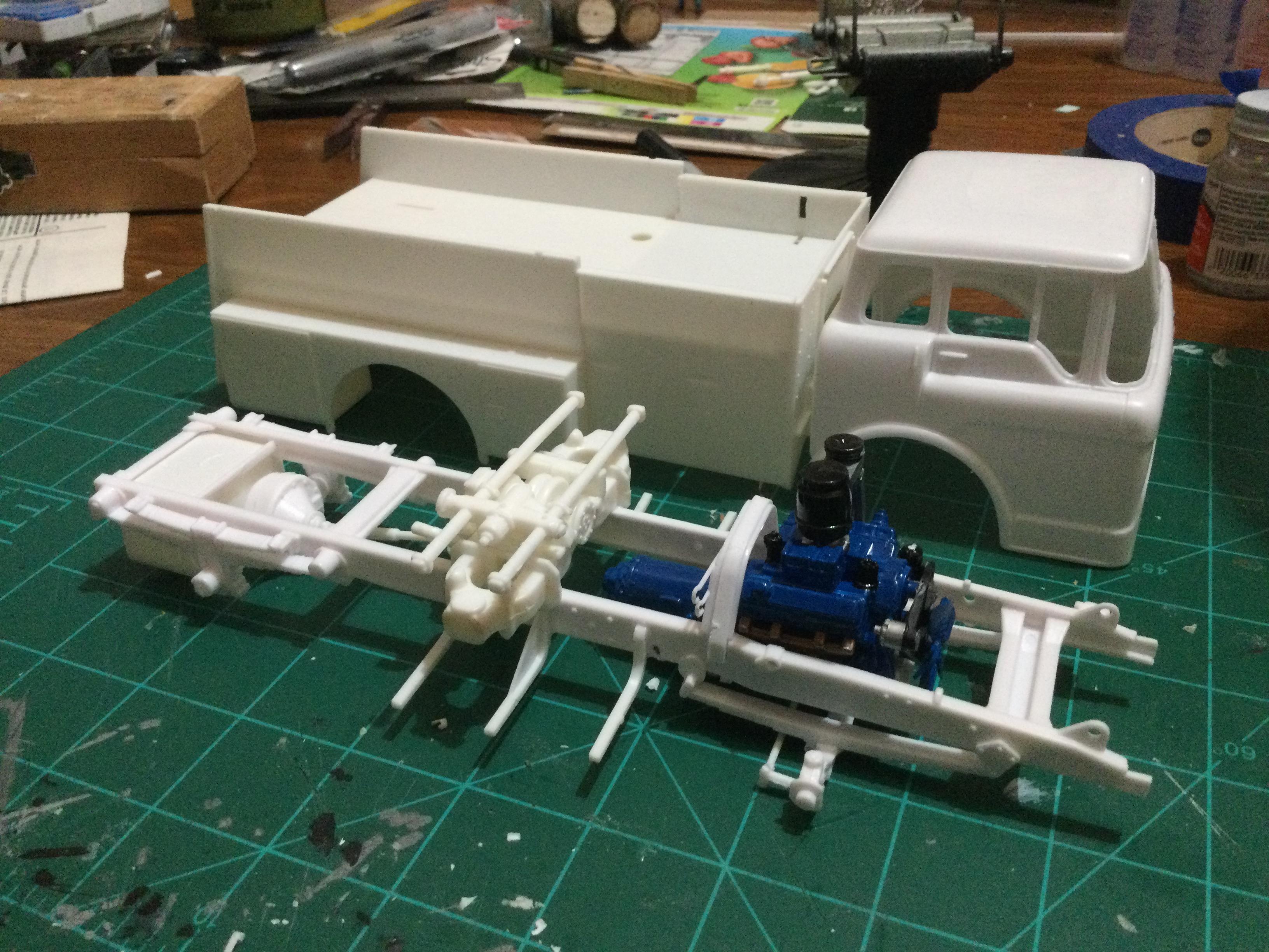

J.B. Customs Posted April 17, 2023 Author Posted April 17, 2023 It is a small start but a lot more mocking up to do 3

GLMFAA1 Posted April 21, 2023 Posted April 21, 2023 To add to Charlie's rear wheel protrusion, use the Ford wheels, on the rear brake drum take 1/8th inch off the axle shaft and reverse the brake drum rear plate that goes on the differential. so far so good to my eye. I can't tell from your picture if there are two discharges on this side. greg 1
