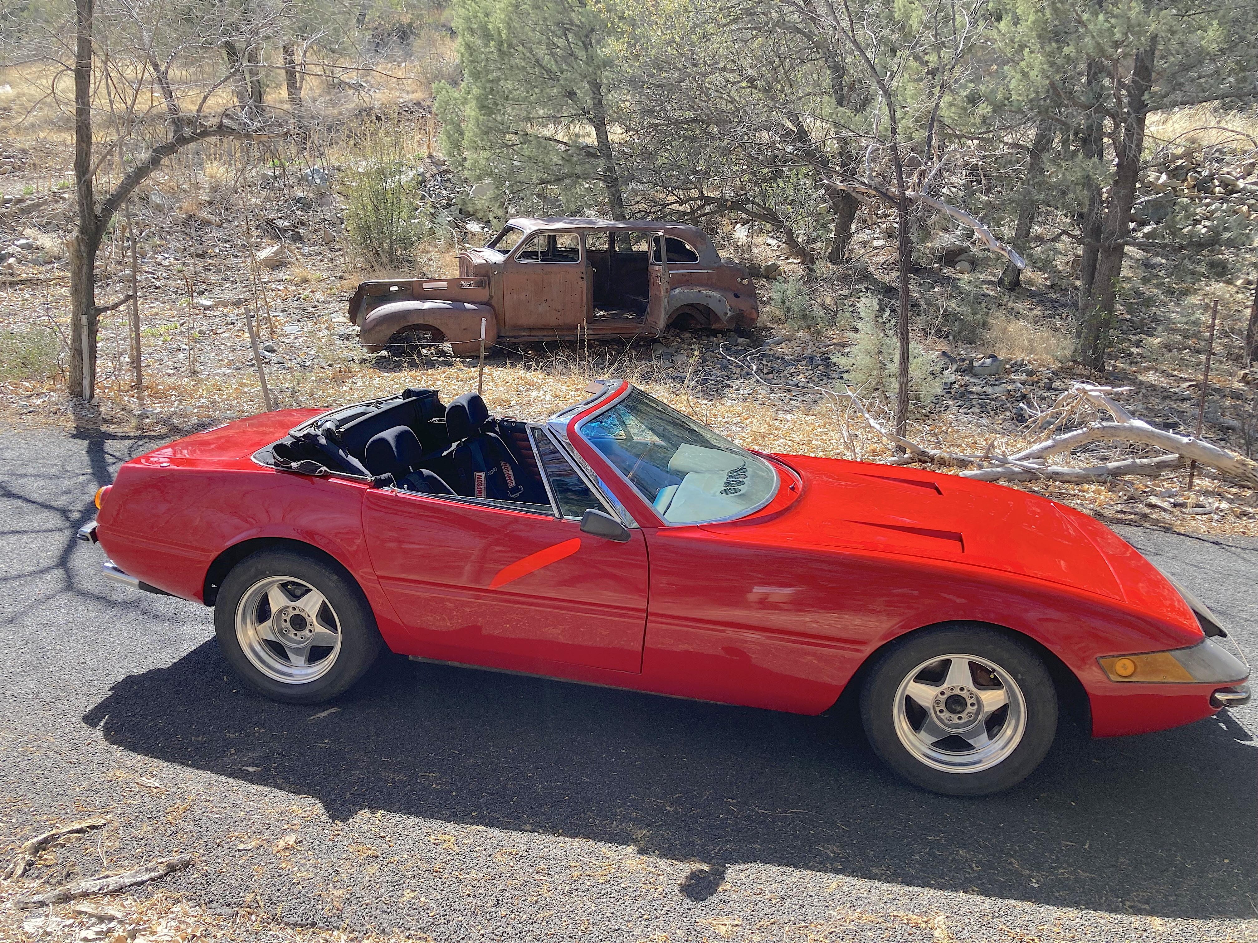

22 hours ago, 89AKurt said:
...Took the full scale kit car for my first drive yesterday. 😎
Still trying to spend your money for ya -- while the V8 in it might sound great, us multi-cylinder nuts would prefer a V12 sound. One out of a Mercedes SL600 should do, but also put the MBenz emblems on it to replace the Ferrari ones. That should send all the purists off screaming into the night. 😱😂

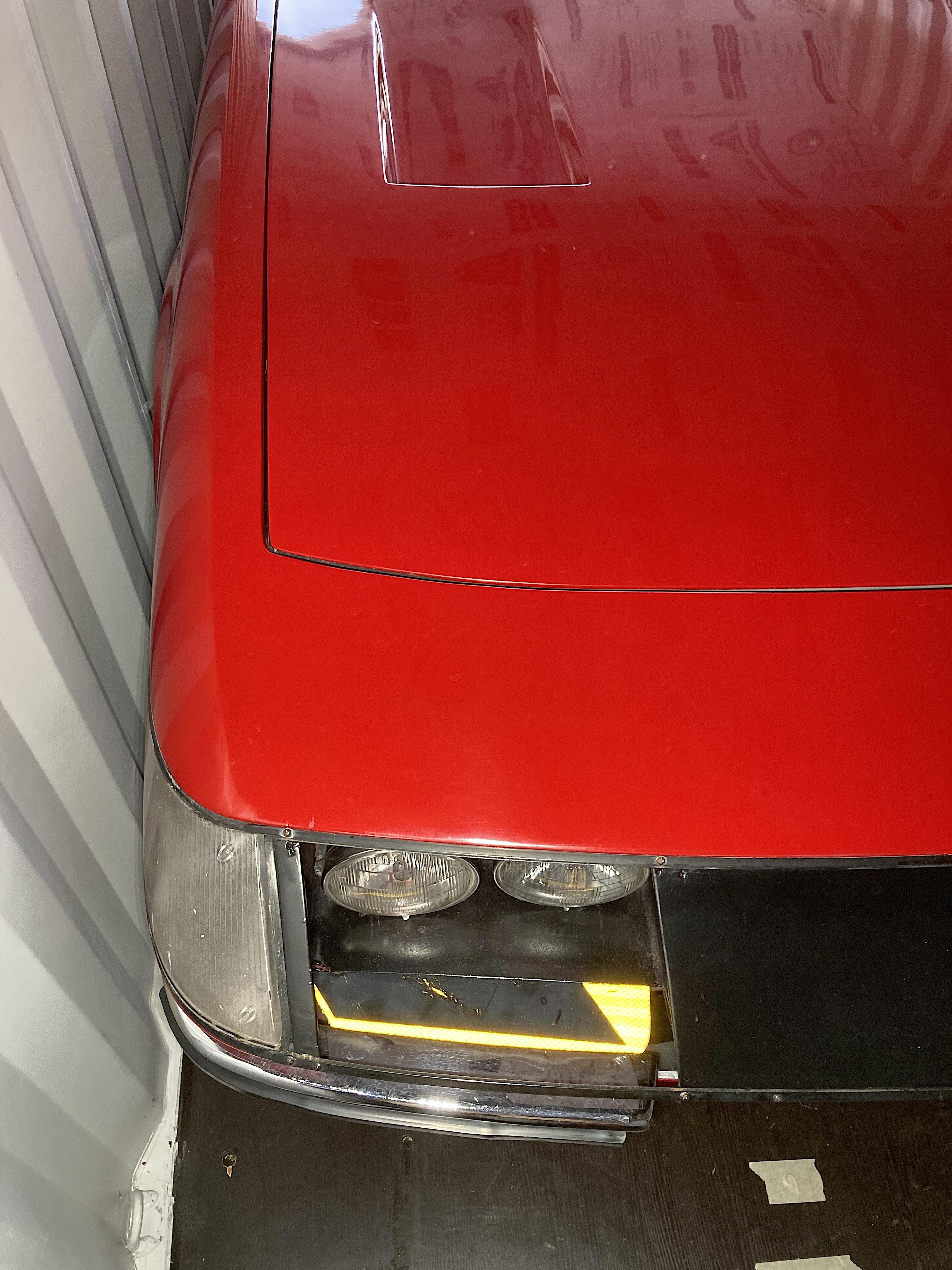

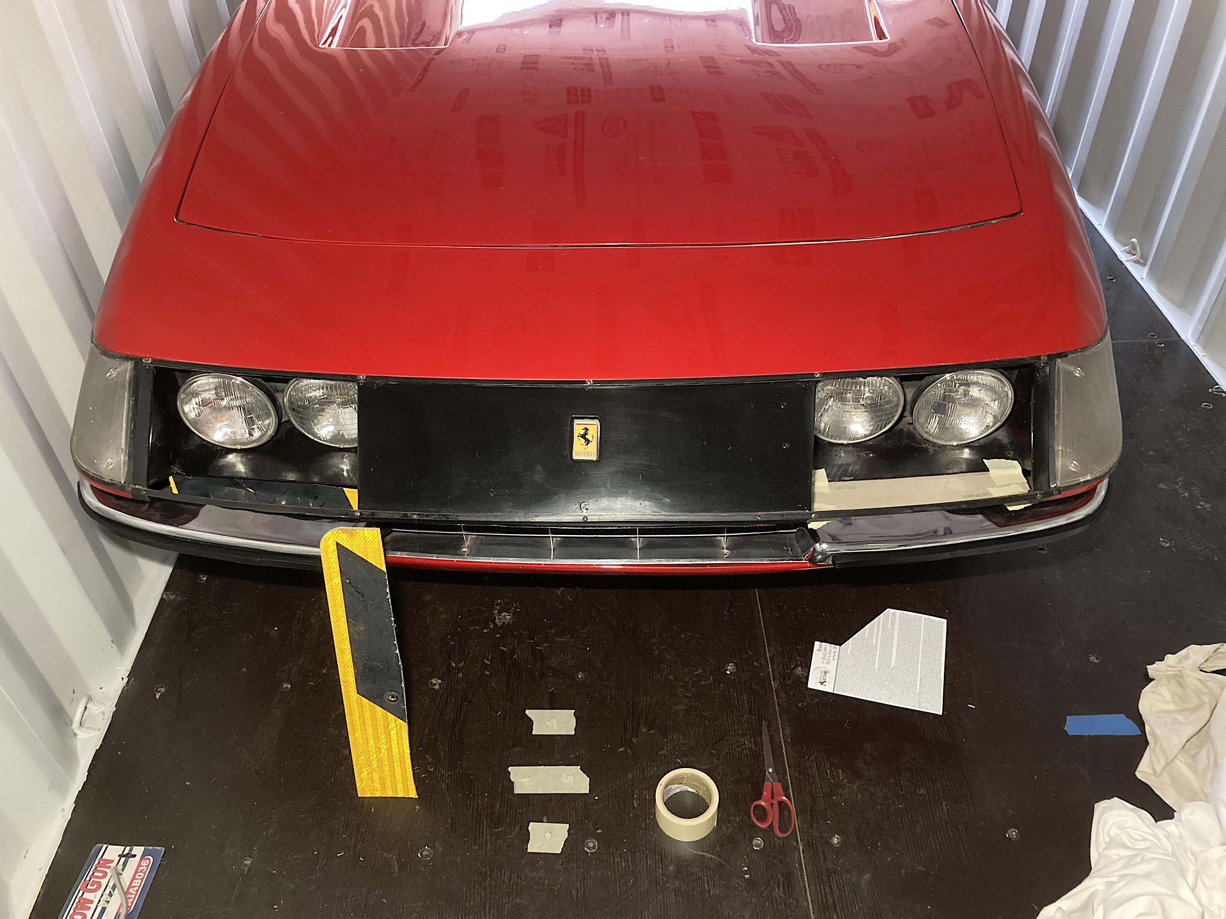

Recent stuff done on Fakerri.
The Corvette steel frame had giant flakes of whatever falling off, removed the rest of it, then the sprayed the goopiest paint I ever used, it foams up at first, then settles down.
There was no splash panel behind the passenger front wheel, had vacuumed out a couple pounds of dirt from the sill area.  Today I got a truck mudflap ( Made in the USA!), made a cardboard pattern:
Cut with the jigsaw:
I was having people bug me about "tire shine".  I remember when Armor All first came out, dad did the tires.  After a short drive on a dirt road, they were dirt color.  Did the tires, and the mirrors which need to be replaced.
Have more to go before the Williams Route 66 car show.

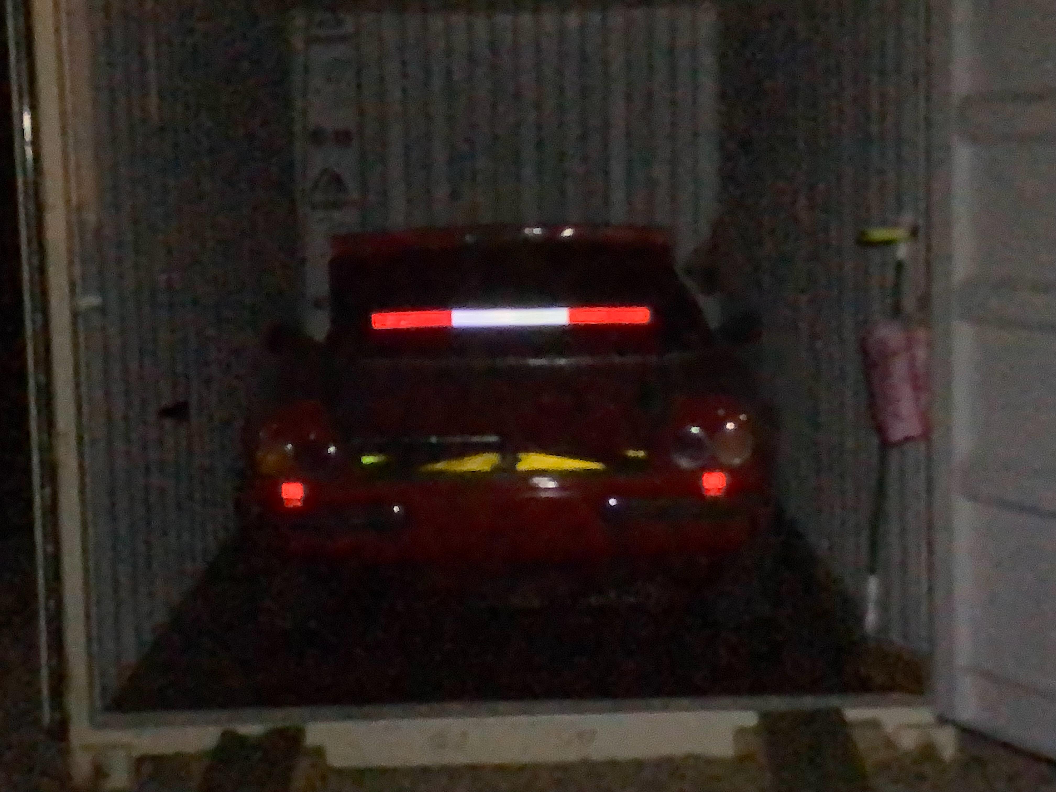

What is with me wanting to use up every bit of something, like how big is the plastic scrap pile that I harvest from when scratch-building models?  I got road signs to make the trunk/boot floor, have some left over that will fill up the giant gap in front of the headlights.  Mockup cardboard in the driver side, just a piece big enough to visualize in the other side.   This sort of modification would not take much to reverse, if I was ever to properly blow lots of money on a restoration SEMA car (ain't happening with me).  It's also going with my theme of shock value, the trunk/boot is not what you expect on a real Ferrari.
I added semi truck reflector tape for safety reasons, can just see the floor in this nightime picture:

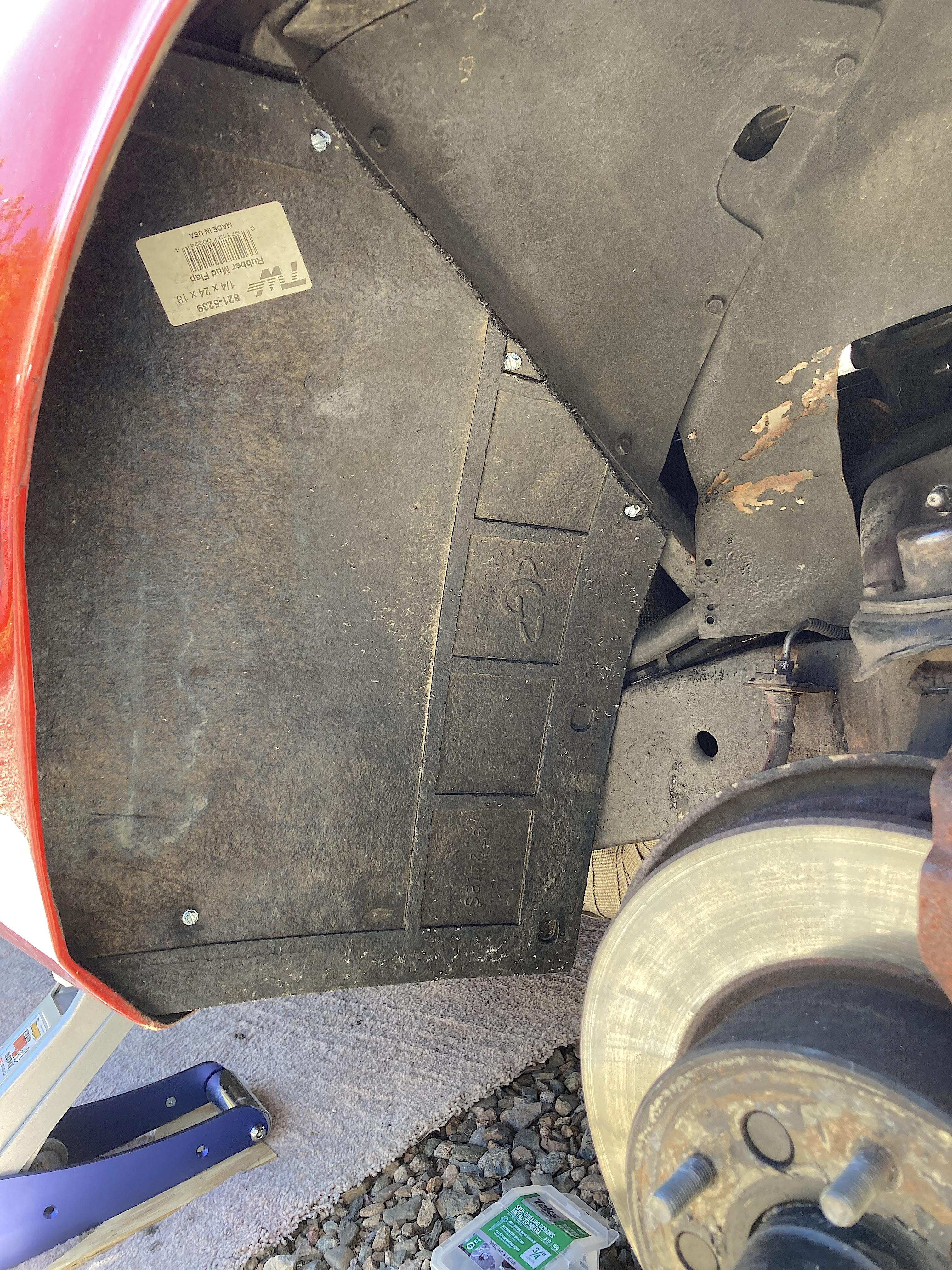

Here is something else that is like full scale scratch-building.  There was no fender liner inside the passenger front wheel well, I vacuumed out pounds of dirt from the sill area behind the wheel.  The shop fabricated aluminum panels attached to the steel square tube structure, except here.  I made a cardboard pattern, got a Made In USA truck mudflap, cut with the jigsaw, simply screwed to the tube frame.  Shouldn't squeak. 😬
I make up for this dorky cheapskate engineering by having real mechanics do things like this, new links and shocks:
I have more to do, like a proper gas tank strap, front bushings then alignment, polish then wax the body...... I'll never get on the bench at this rate. 😏

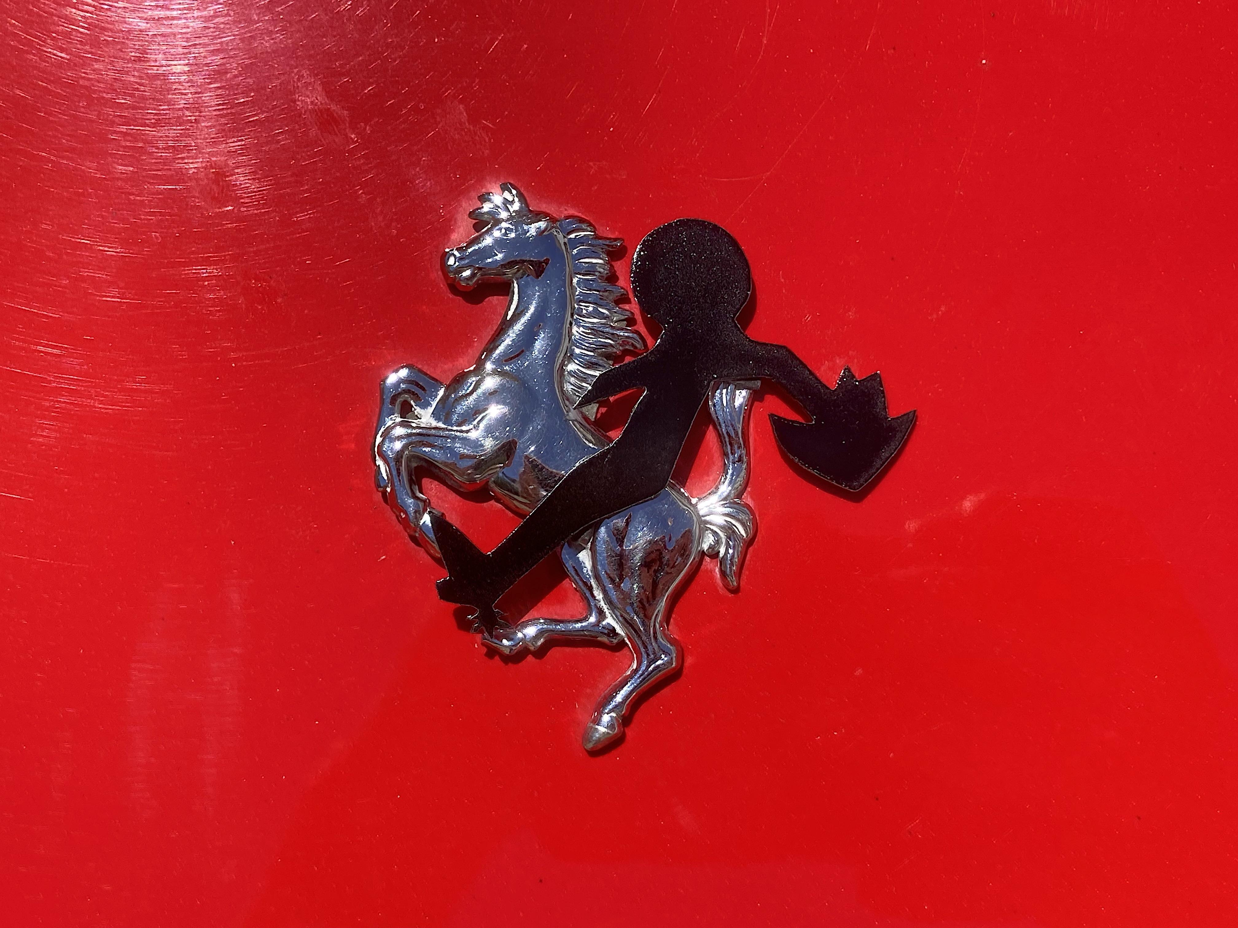

I installed the gap plates (splash pan on a '48 Chevy pickup) made with left-over sign.  The existing hole (cut off) dictated the direction of the arrow.  Can't really see unless you are looking down.
There is an odd tiny detail, let's see who spots it.  Polished/waxed the whole body yesterday.

4 hours ago, johnyrotten said:
Looks very good in that photo,  polished up nicely.  What's that just above the emblem?
Roadrunner gun sight from the looks of the rocks in that area!

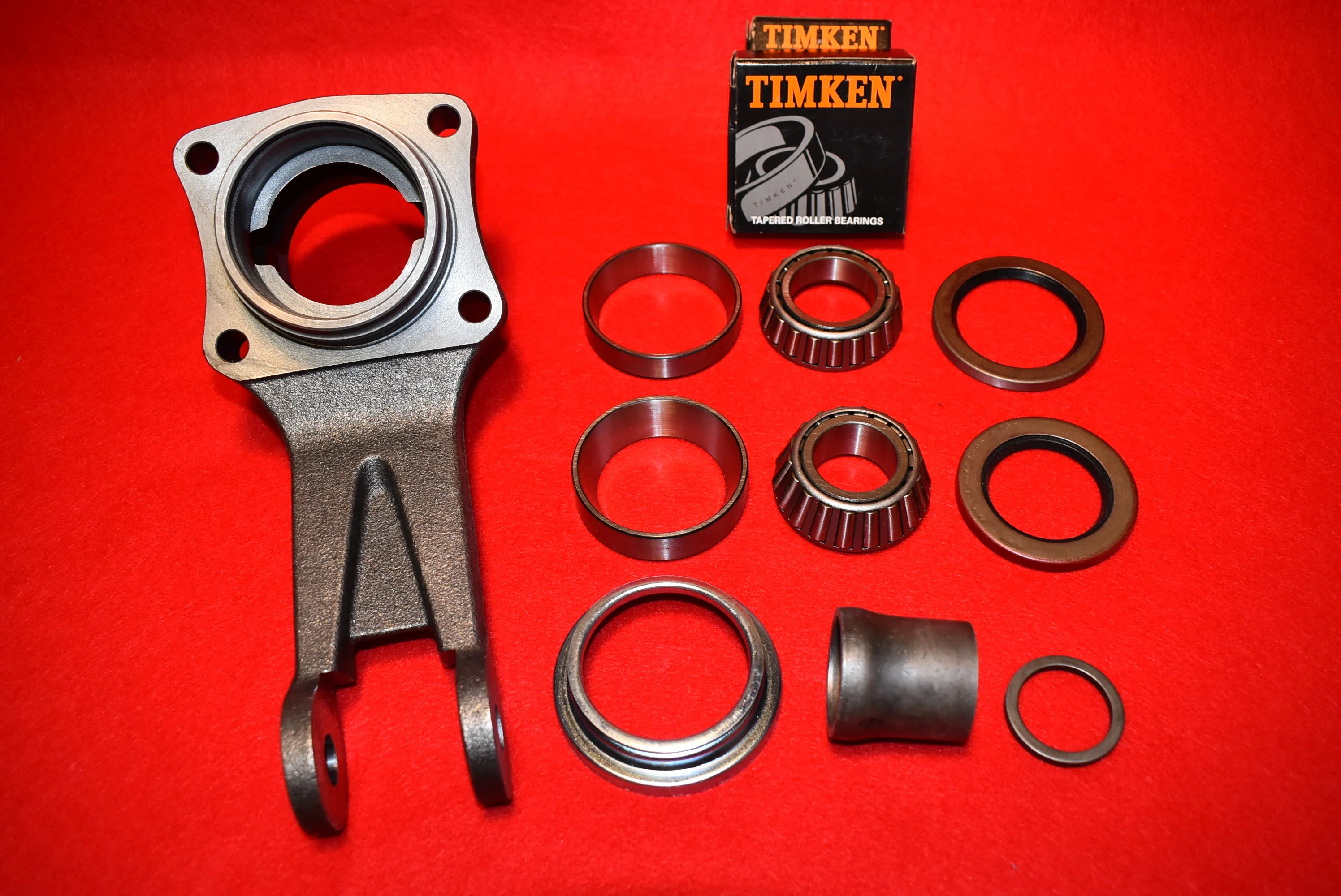

One thing I would add, the bearing supports on the rear axle are one of the most neglected parts of a C2/C3 chassis. There's no way to grease the bearings except for disassembly and then you need a press to R&I the spindle & make sure you get the endplay right during reassembly. It's one of those things that's not a problem until it is. Unless you know the history of the chassis this is something I'd look into getting done if you plan to drive the car a lot.

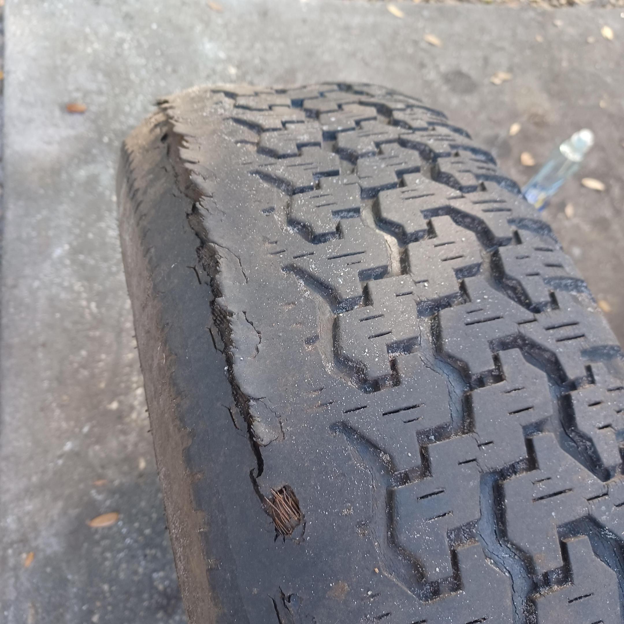

On 12/7/2024 at 9:16 PM, Tabbysdaddy said:
Reason #2 the van has been sitting so long, bad tire:
I didn't notice it because it's on the inside and the tread is thick on the outside. I'm going to write a strongly worded letter to the tire company about how their cheap tires wear out unevenly. :D
I was going to put the rear on the front and use one of the rallies that I bought for my other truck temporarily, but the rear wasn't all that great either so I swapped on two. I guess I'll have to check the condition of the two tires on the other side. :D I knew the rallies are 8 wide, I thought the aluminum ones were too but they're 6.5 wide. I'm actually liking the rallies on the van so I'm thinking of keeping them on and using the aluminum ones on the truck instead. What do you guys think?
I have all eight center caps even though there's only one of each on the rear.
Sean, my rickety old memory says that vintage of vans of all makes was notorious for not holding alignments and that can cause that type of uneven tire wear.
Thank you for posting that picture!  I was told about how much fun it is to work on this particular part of these cars, so I shall keep an ear open.  Have the front A-arm bushings replacement scheduled, then on and on.   I polished the body, needs more work.  Since Prescott is known as having the World's Oldest Rodeo, had to do this.
It has some extra camber probably from ball joints or control arm bushings but it doesn't get used much so it wasn't really a priority. It's sitting because I need to work on the brakes and I was going to look into that more while I was at it.

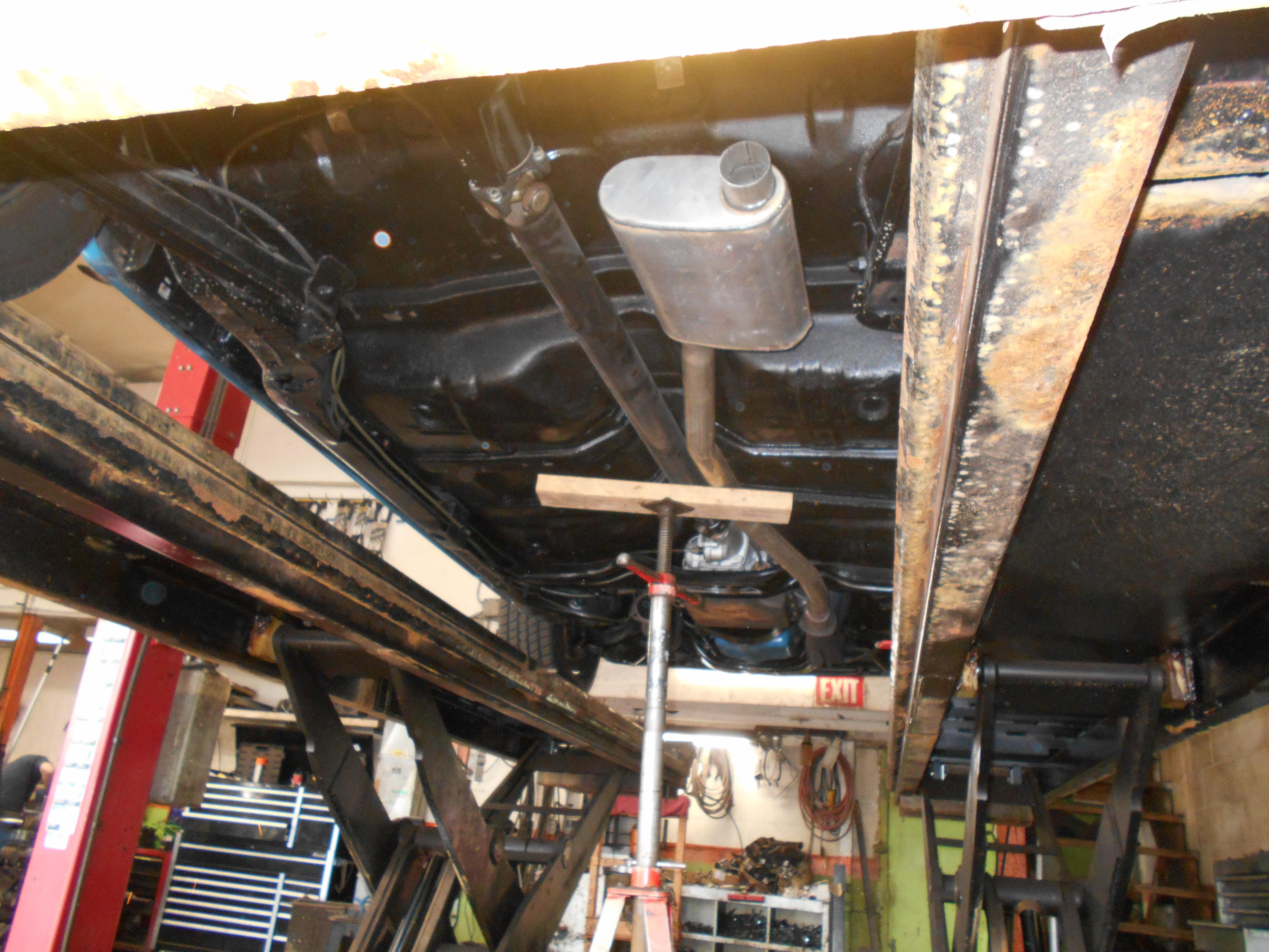

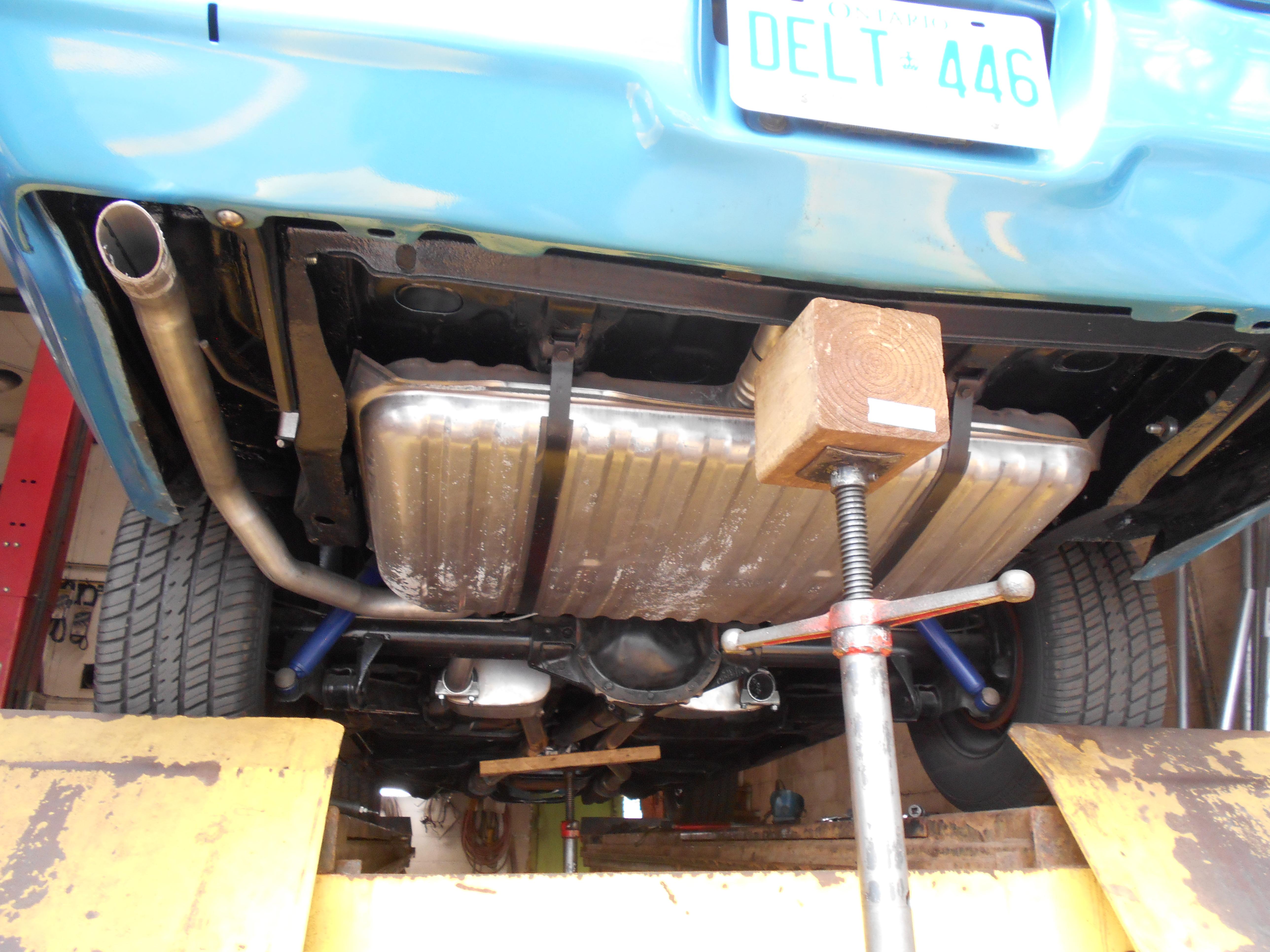

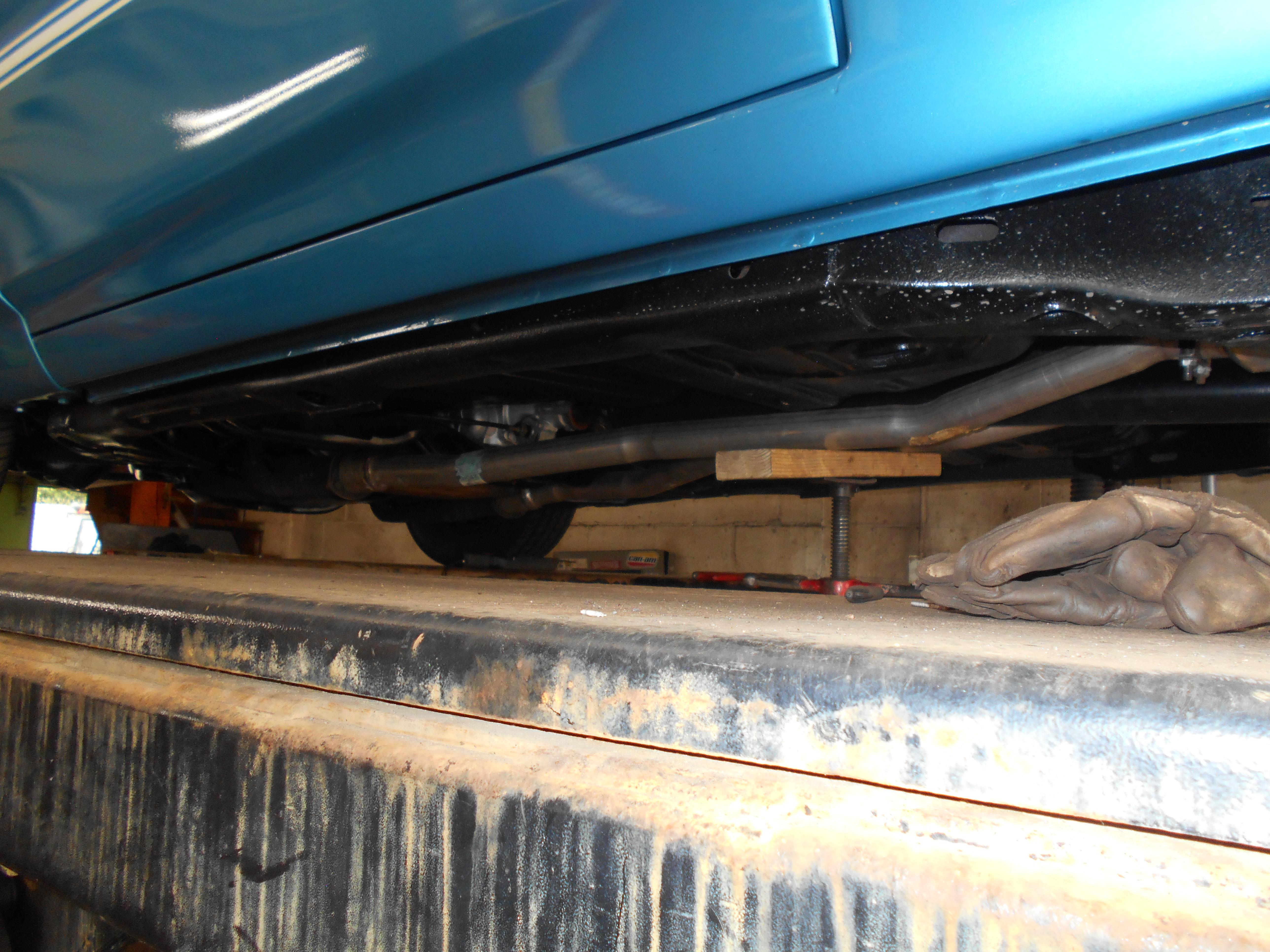

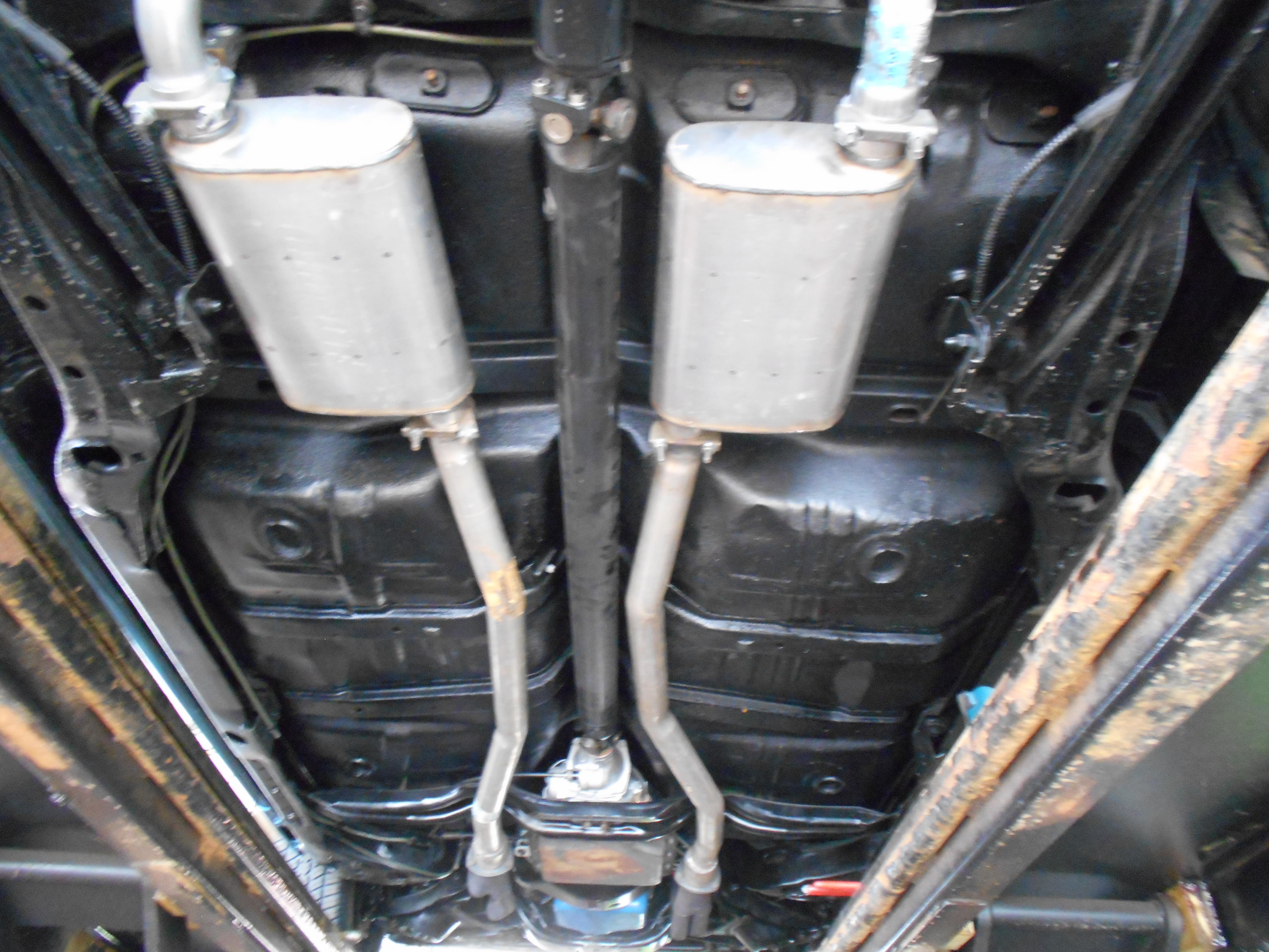

The Highway Star went into Jiggerz yesterday to get the exhaust work done. Had thrush mufflers with exhaust coming right out behind them, and in the center, which is a no-no around here, so those were taken off and new mufflers as well as exhaust pipes were installed, the pipes now going up and over the rear diff and out behind the the car on each side. Doesn't sound as rumbly now as it did, but it is legal now and still pretty nice. My dad took these photos since he brought the car in and stuck around to make sure everything was going good. Another check off the list of things needed for the safety. Went into our regular mechanic today and should come back with a wiper motor, and maybe a horn 🤞.
  • Like 5

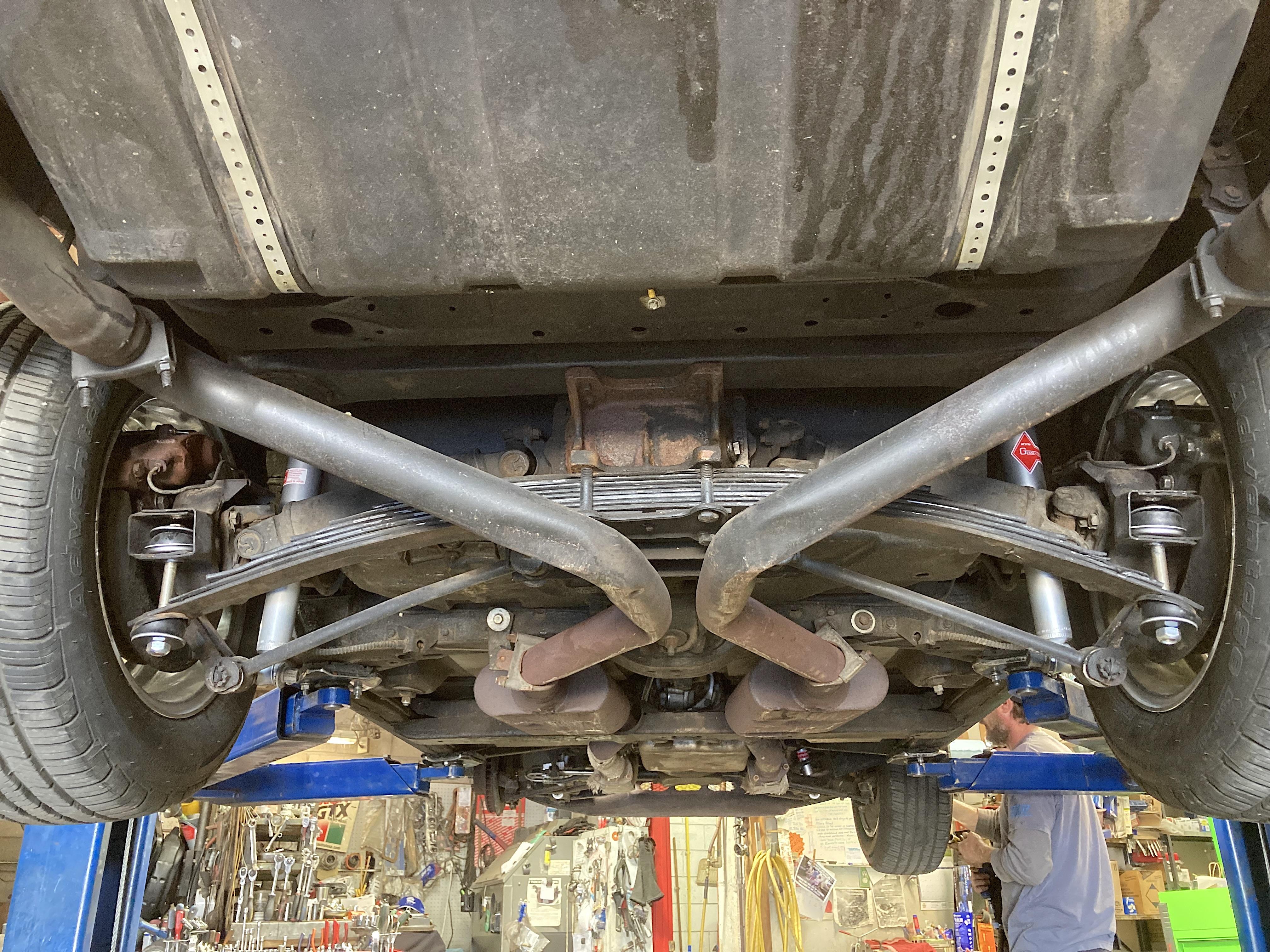

Oh man, no cutouts or flame throwers either? 🙄  I took Fakerri in to a long-time exhaust shop, he took a quick look, would prefer doing a whole system when the time comes.   I really wanted to ditch the "original" filler tube that had two right turns that foamed up the gas, so this ought to help.

My Belair had a full dual system on it when I got the car, very recently done.
AND... very quiet. I find it nice to be able to hold a conversation when I drive it.
