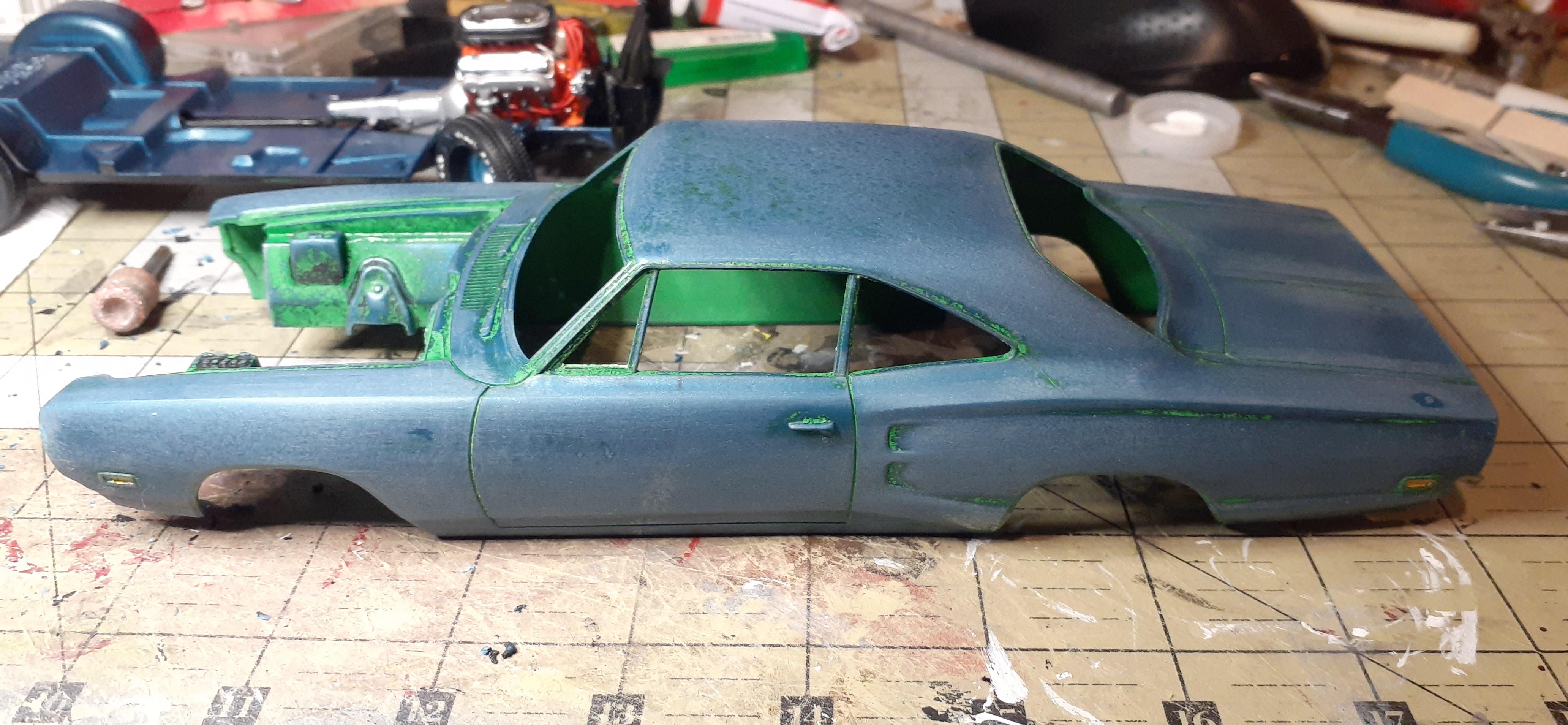

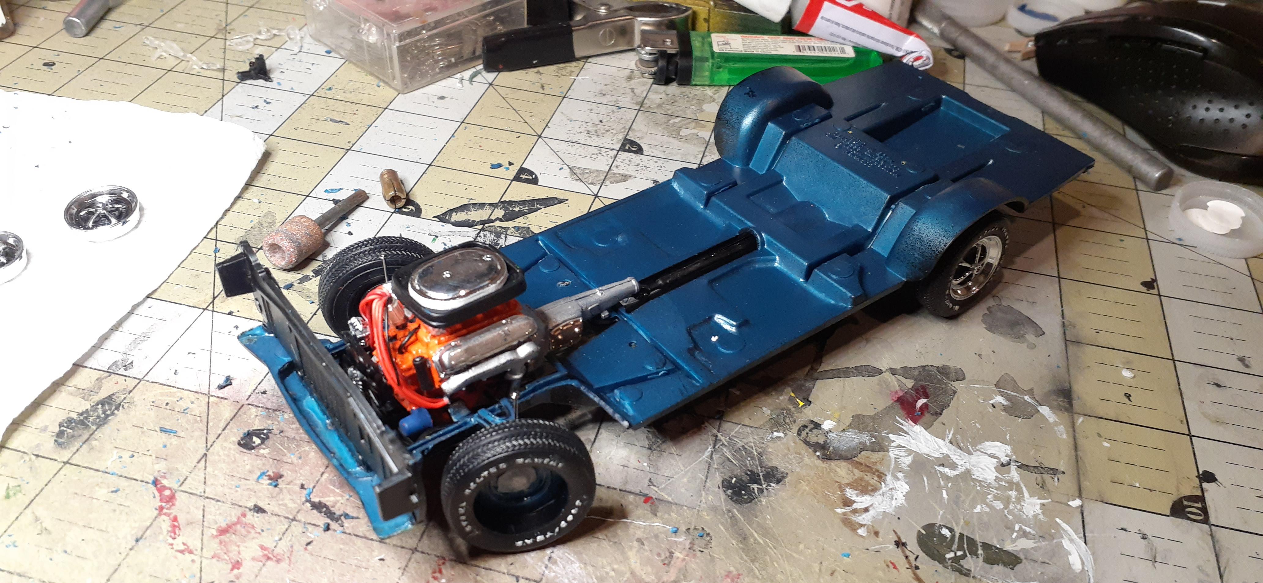

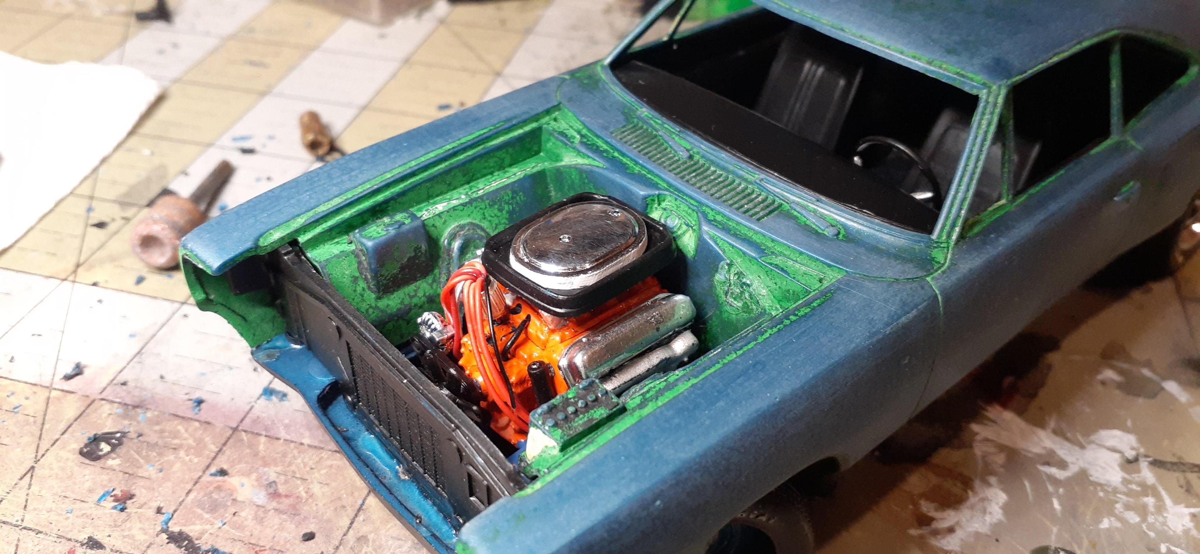

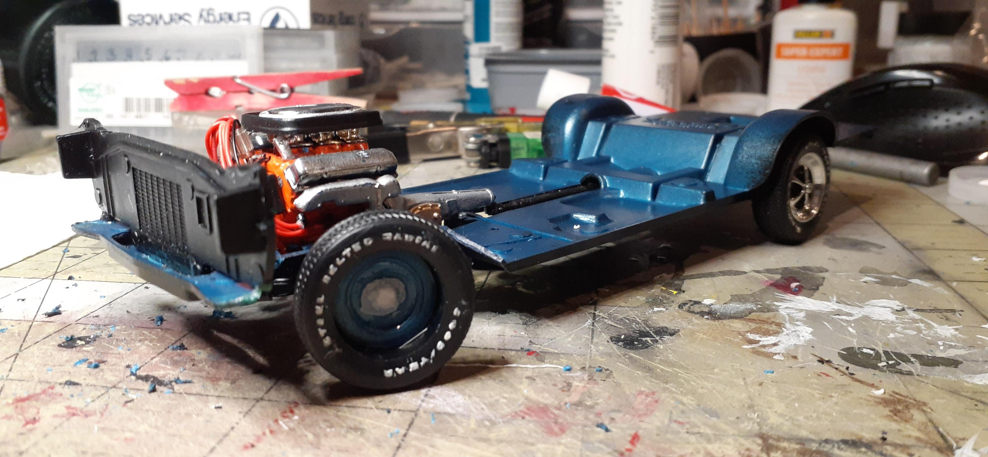

Slotto Posted May 21, 2023 Posted May 21, 2023 I picked this up at the NNL last weekend. I used to own this kit when I was a kid and remember it fondly. It was marked as built at $15. I asked the vendor if that was the best he could do and said he would take $10 for it. It appeared to be all there so I went for it. When I got home I disassembled it and sprayed the body and interior with my preferred paint remover. While the parts soaked, I freshened up the engine a bit. so far I've added a distributor, plug wires with boots, a coil, fuel lines, openings for the heater hoses and carburetor linkage with a return spring. The plan is metal flake blue exterior with black interior. 6
dwc43 Posted May 22, 2023 Posted May 22, 2023 For future reference the dist. mounts behind the water pump area at an angle not on the intake and the coil goes on the intake not the head.

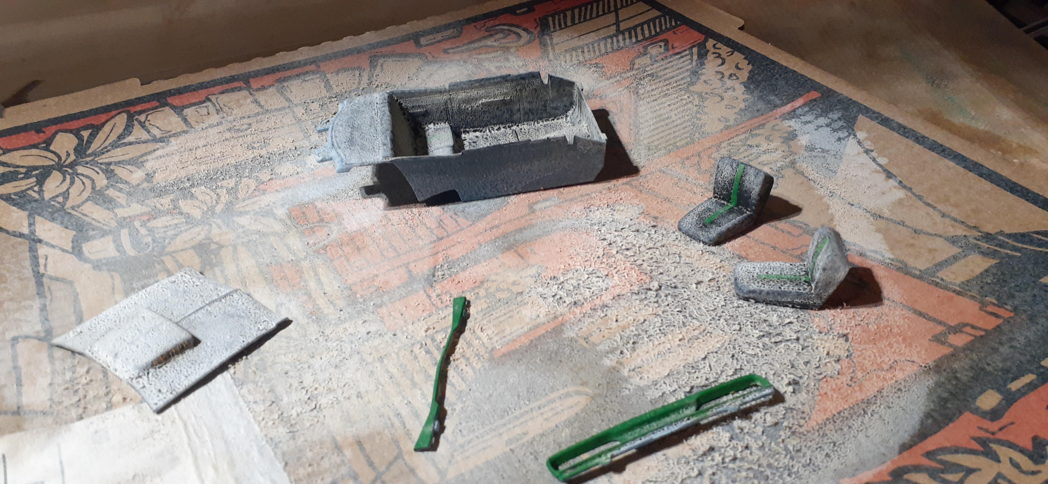

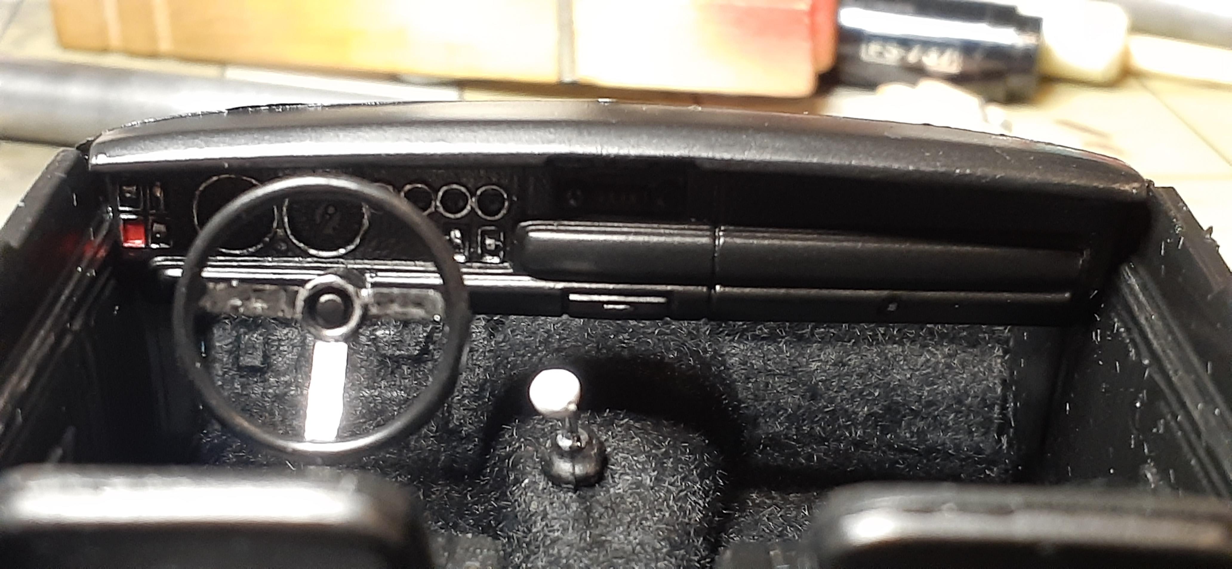

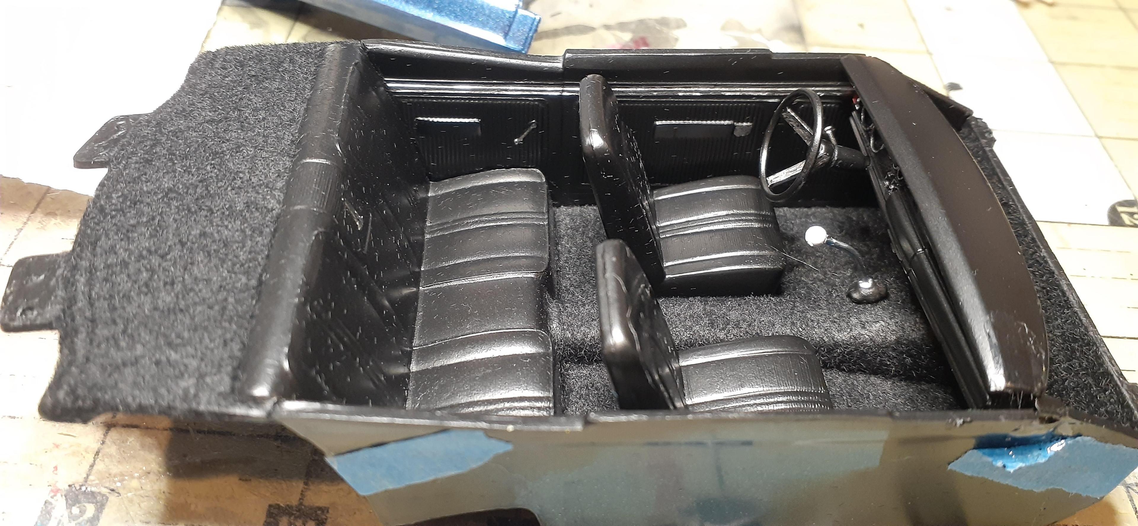

Slotto Posted May 28, 2023 Author Posted May 28, 2023 I blew the interior bucket apart so I could detail the door cards and add carpeting. The body needs a lot of cleanup.

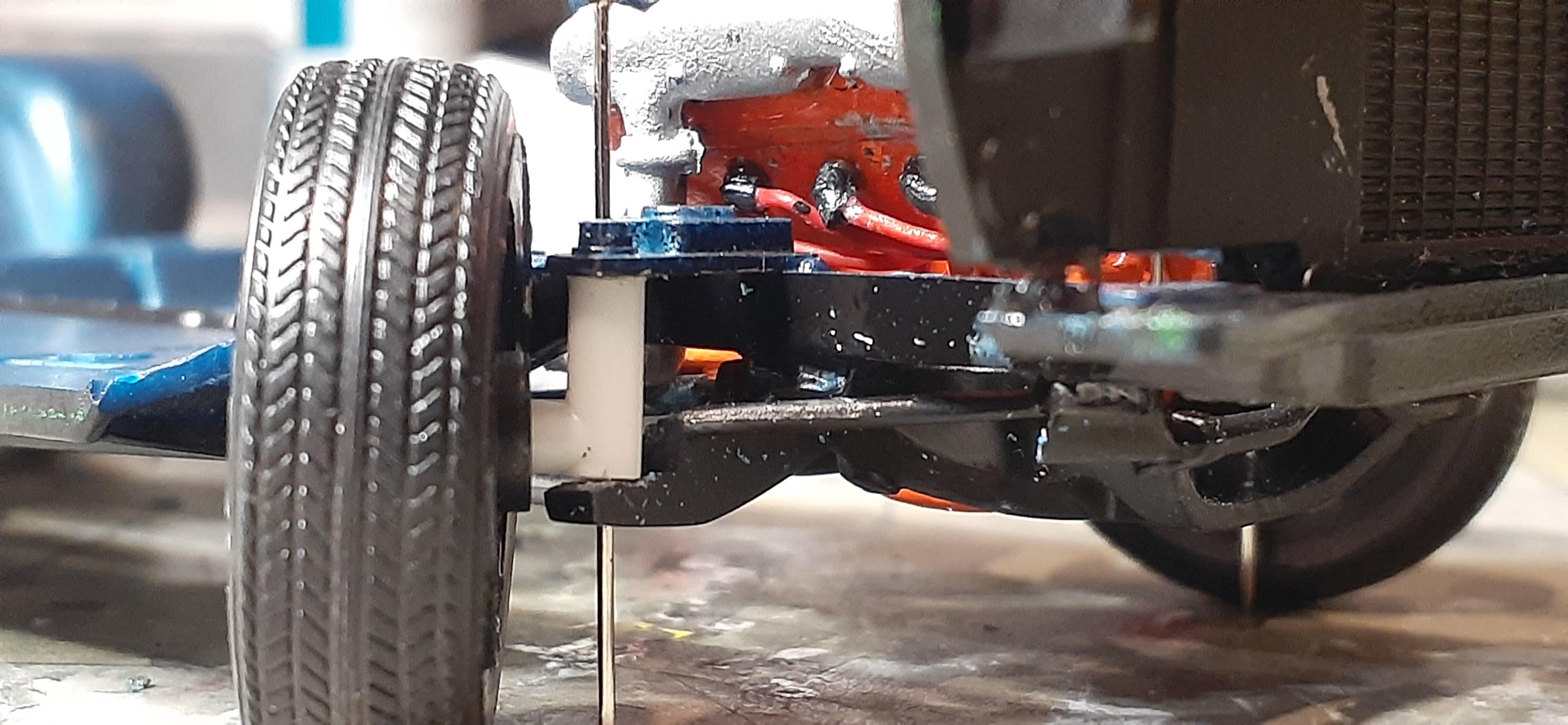

bisc63 Posted May 28, 2023 Posted May 28, 2023 Good start. These kits build up nicely, but do watch the front-to-rear spacing of the wheels within the wheel wells. I recall having to tweak the fit just a bit to get them properly centered. 1
bisc63 Posted May 29, 2023 Posted May 29, 2023 I've built this one and the Monogram 70 Roadrunner, and one had the problem more so than the other, and I'm pretty sure it was this one. Still some of my favorite kits to build.

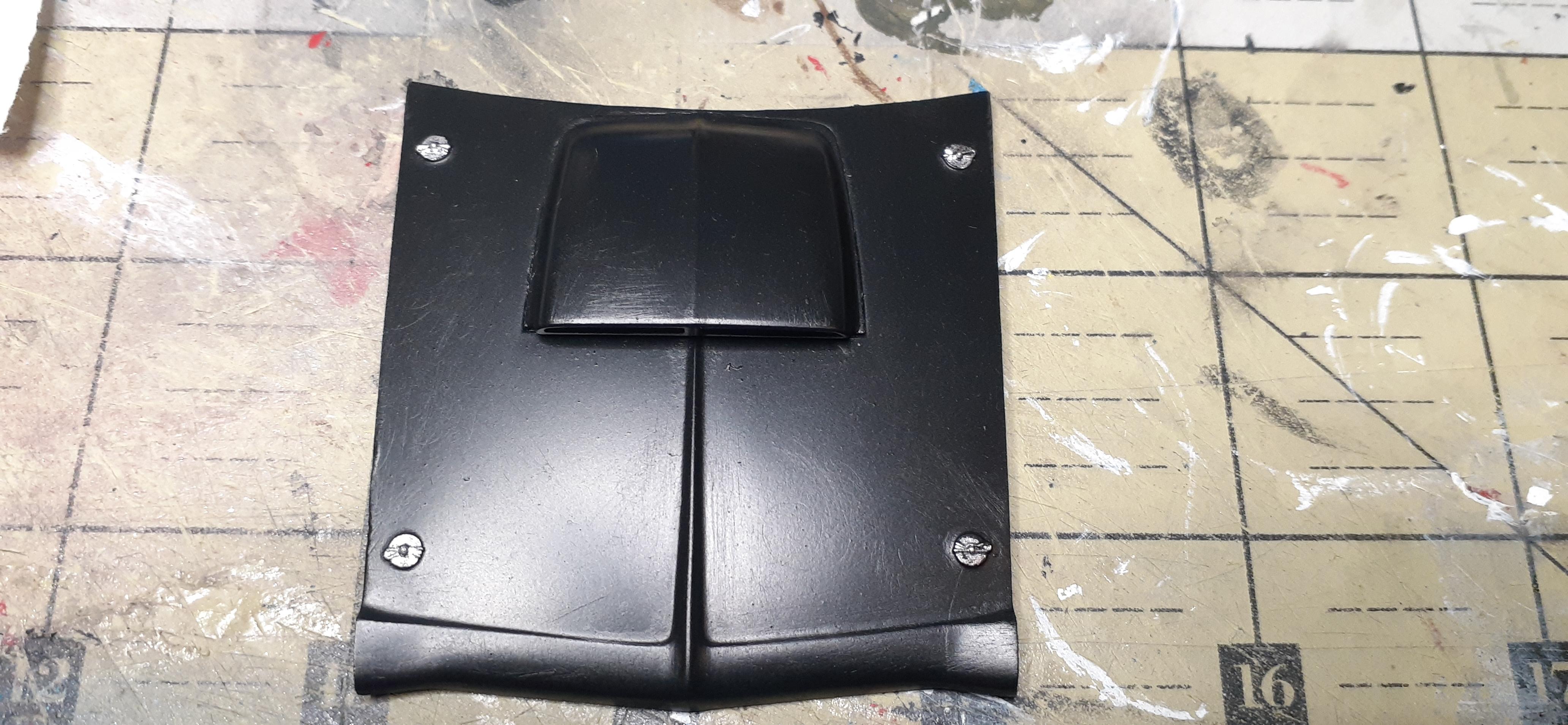

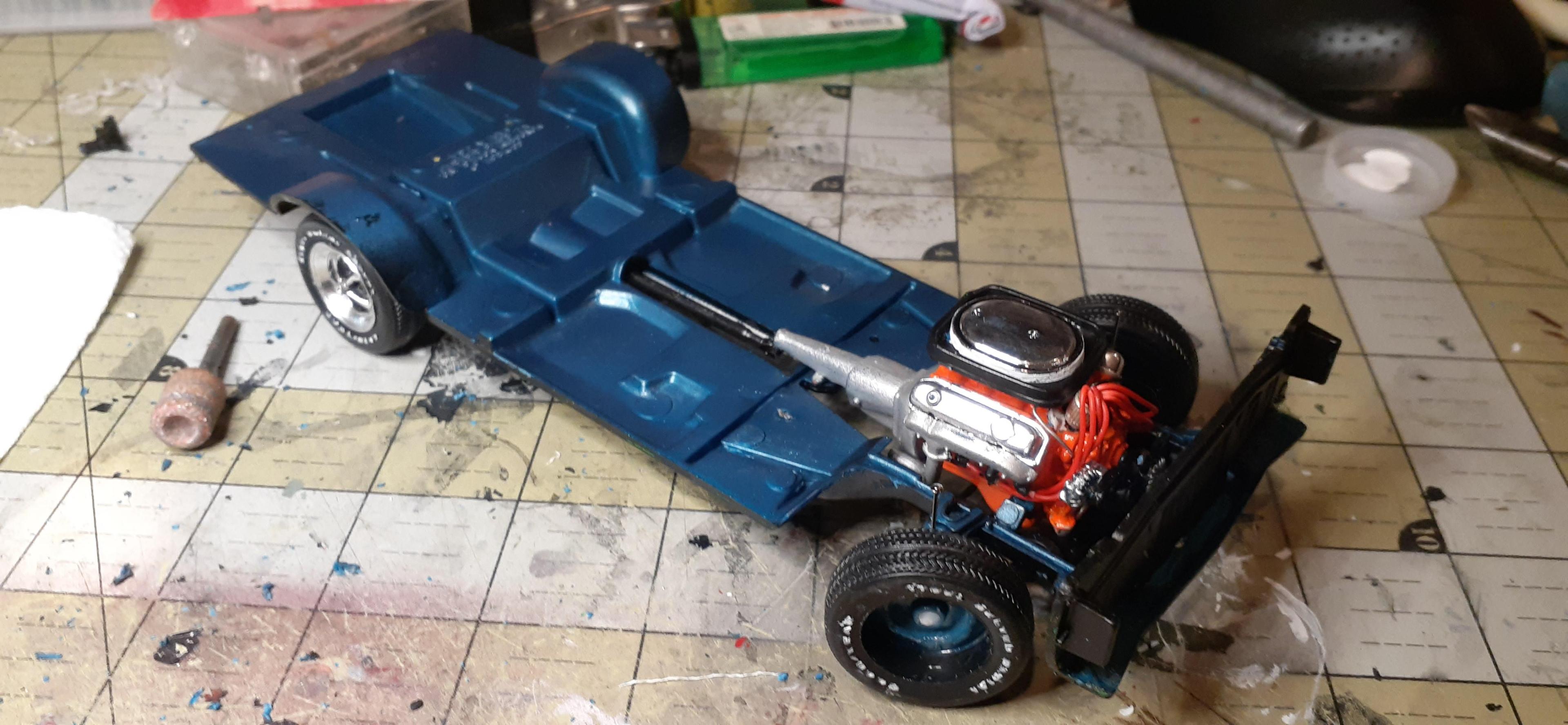

Slotto Posted May 30, 2023 Author Posted May 30, 2023 Got the hood situated as well as the interior. I need to get some wood colored enamel so I can hit that steering wheel 1

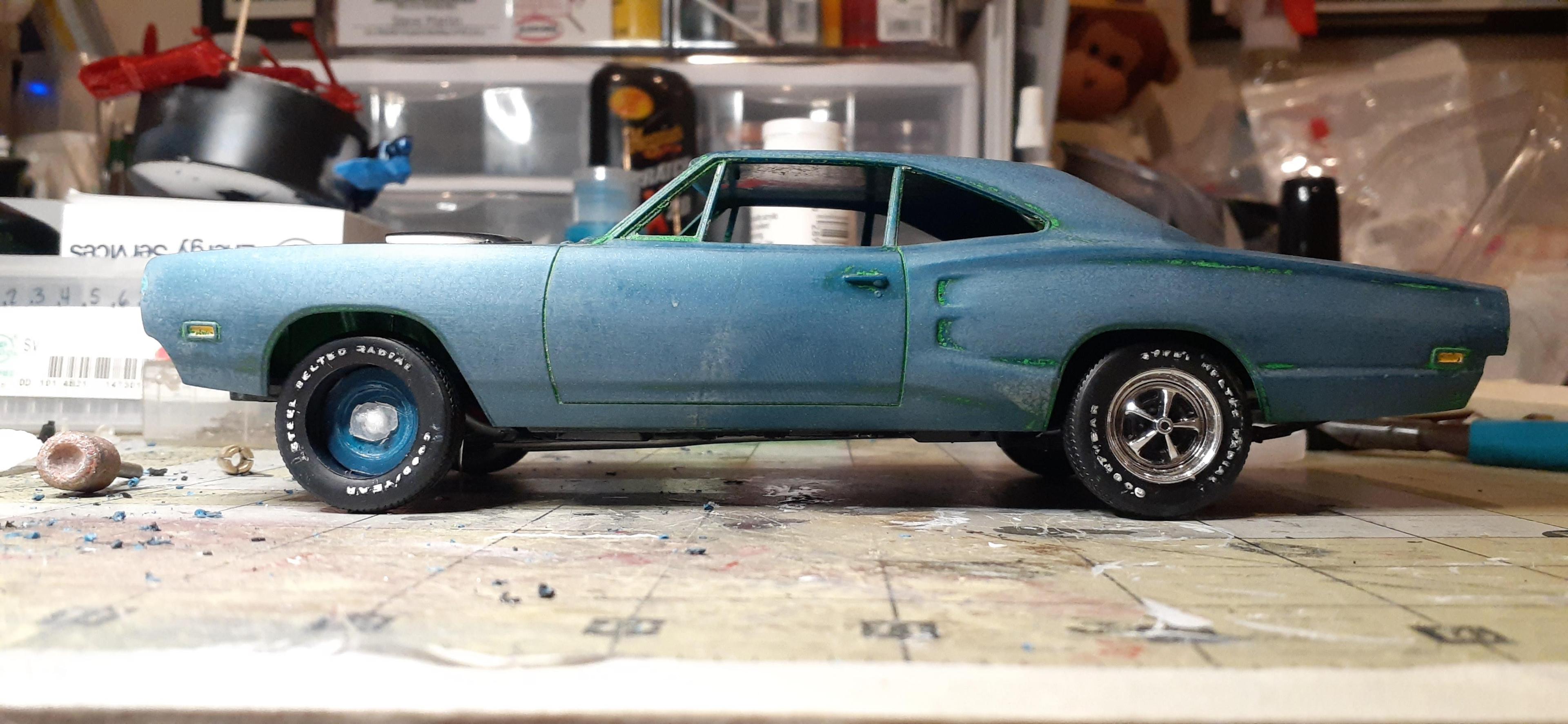

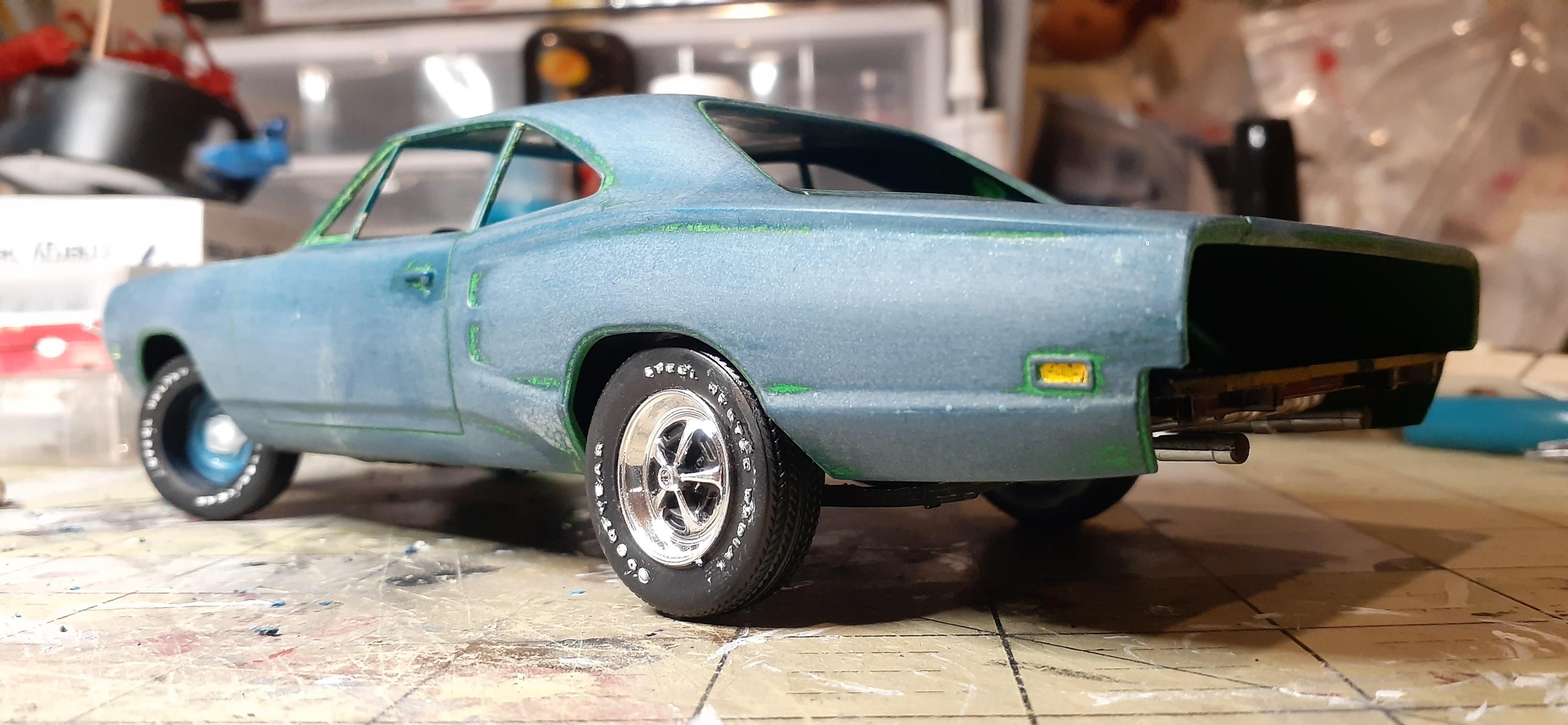

Slotto Posted May 31, 2023 Author Posted May 31, 2023 Stripped the body 2wice. I guess I'll hand tool the rest until its clean. the guy who had this before me lettered the tires. He didnt do a bad job but I think I'll look for some preprinted ones. and of course the wheels are now posable.

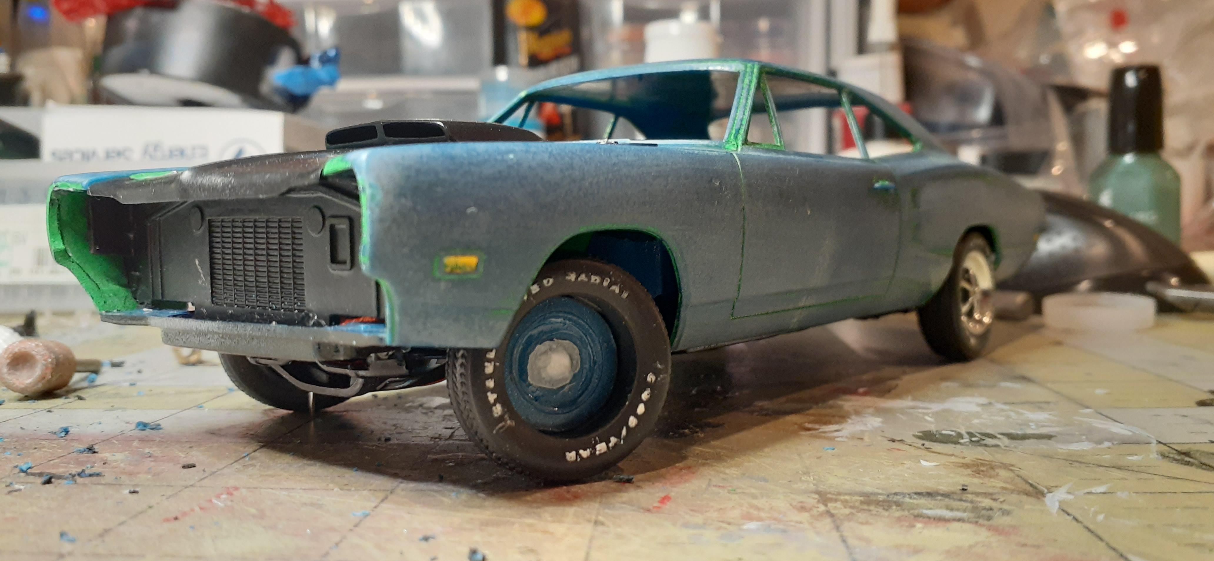

Slotto Posted May 31, 2023 Author Posted May 31, 2023 Ok, I couldn't help myself. I had to see what she looks like with the body on the chassis

bisc63 Posted June 2, 2023 Posted June 2, 2023 (edited) On 5/31/2023 at 12:07 PM, Slotto said: . I had to see what she looks like with the body on the chassis Your second pic shows what I was referring to, the kit sets the wheels a little too far to the rear. I think I just shaved a little from the front of the spring, and maybe redid the front perch. The real deal: Edited June 2, 2023 by bisc63 added info. 1
