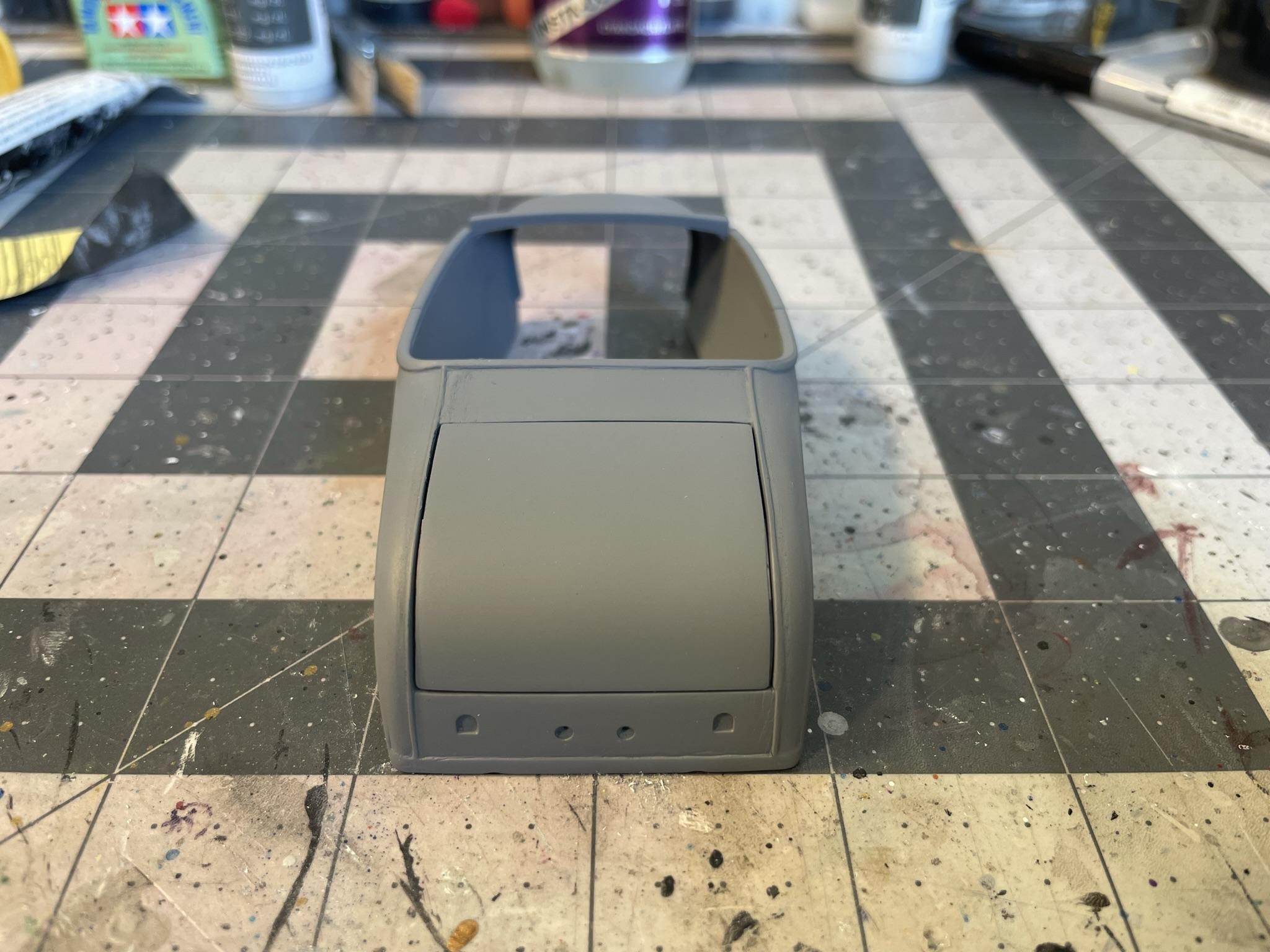

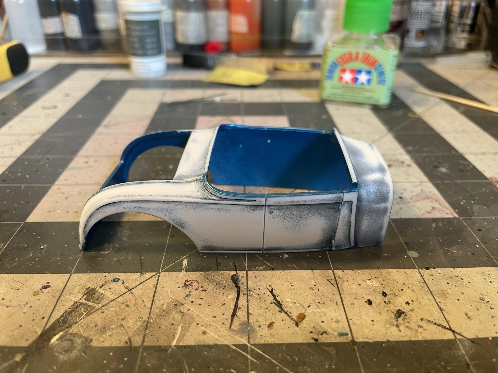

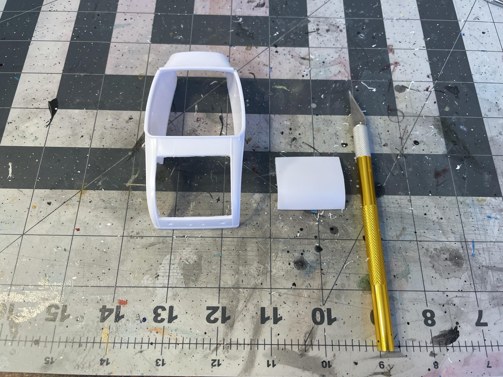

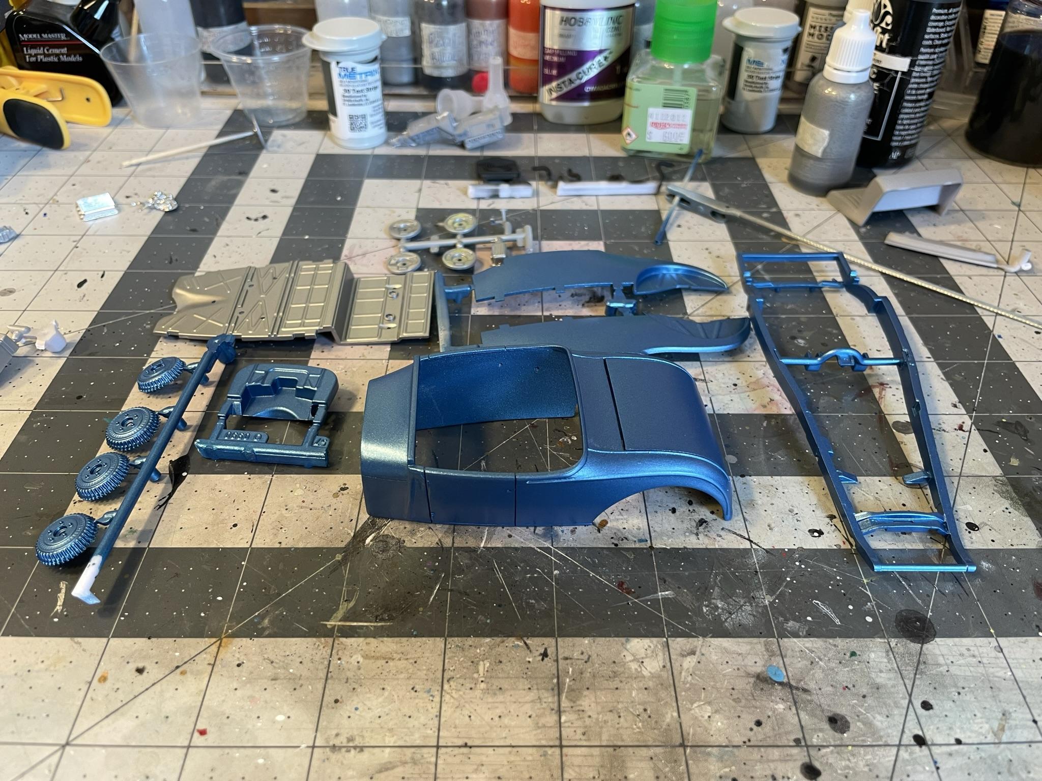

Dragonhawk1066 Posted May 29, 2023 Posted May 29, 2023 (edited) It seems like everyone else has built at least one of these, so I figure it's finally my turn. The plan is for the body to be Duplicolor Bahama Blue with Silver, Charcoal, and Black flames using a flame mask from New York Speed Shop that I bought from Iceman Collections on ebay a few years ago. I also took the plunge and cut out the trunk to attempt making hinges for an opening trunk for the very first time. After all of the body and parts prep was done, I sprayed the Stynylrez Primer on. Edited May 29, 2023 by Dragonhawk1066 4

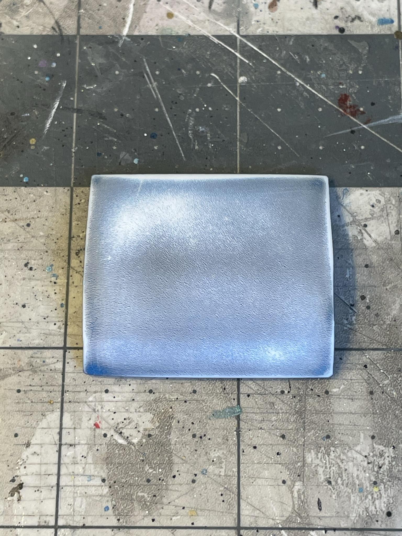

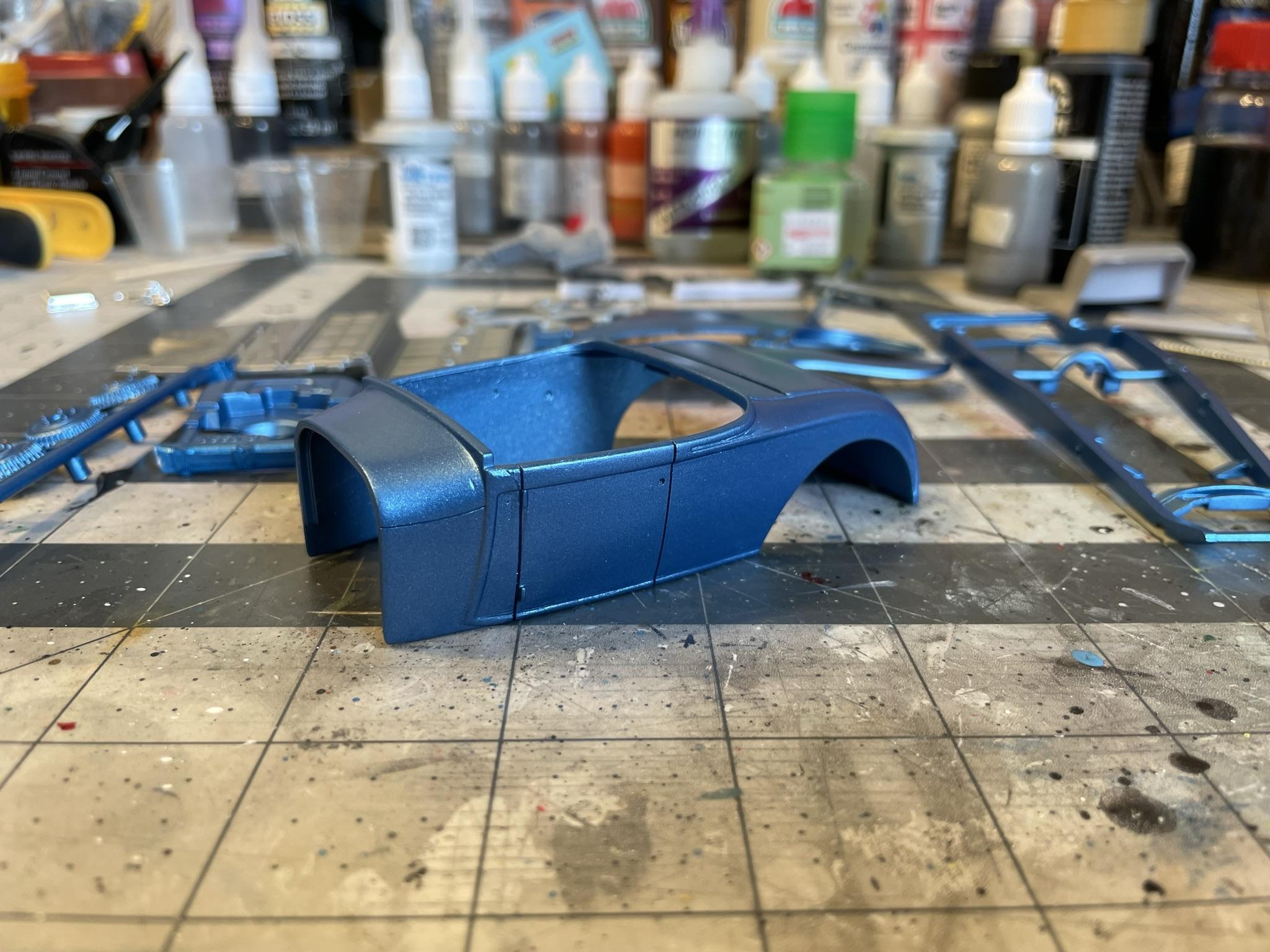

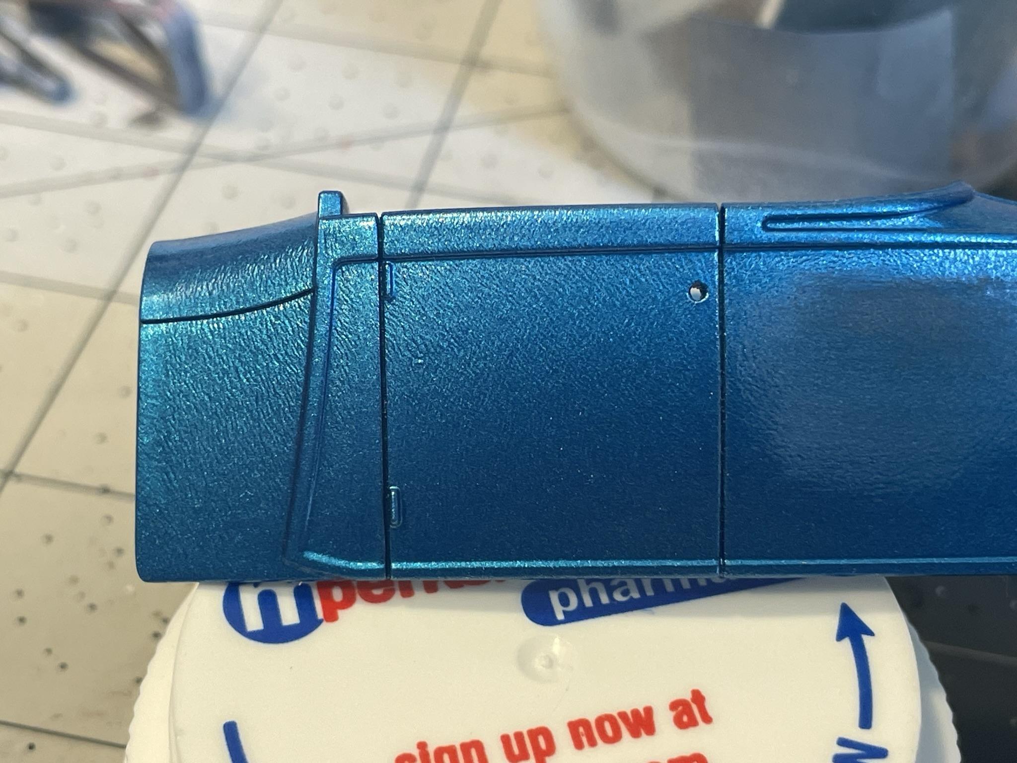

Dragonhawk1066 Posted May 29, 2023 Author Posted May 29, 2023 I made my way out to the shed to spray the Bahama Blue, and that's where disaster struck, twice. First, after spraying the first light coat I noticed a spot on each side just behind the door that wasn't present after the primer stage. I gave it another light coat and it was still there, so after a few minutes to dry I brought the body in for a quick dry-sand. I sanded it with 1500 grit and it seemed smooth enough to try another coat. It seemed to cover better, so I gave it a medium coat, then a heavy coat which appeared to do the trick. I went out to check on it a half hour later and the spots were still pretty prevalent. Not only that, but the paint dried with an alligator skin-like texture to it. I brought it back in and gave it another dry-sand, this time with 600 grit. The texture did not want to go away, so I decided to put it into an LA's Totally Awesome bath to hopefully strip the paint so I can start over with a different paint/shade of blue. 2 1
Ace-Garageguy Posted May 29, 2023 Posted May 29, 2023 Looks to me like crazing, when the lacquer topcoat solvents are just too "hot" for the primer and plastic underneath. This is a prime example of why we harp on and on and on about TEST FIRST before committing to painting a model with a combination of products that aren't designed to work together, by the same manufacturer. 3
ea0863 Posted May 29, 2023 Posted May 29, 2023 Sorry to see that Craig. Duplicolor has done that to me enough times that I avoid it now. Tamiya TS-19 might do the trick for you... 1
Dragonhawk1066 Posted May 30, 2023 Author Posted May 30, 2023 23 hours ago, Ace-Garageguy said: Looks to me like crazing, when the lacquer topcoat solvents are just too "hot" for the primer and plastic underneath. This is a prime example of why we harp on and on and on about TEST FIRST before committing to painting a model with a combination of products that aren't designed to work together, by the same manufacturer. Thing is, I did spray the Duplicolor on a couple of spoons, one with white primer and the other with gray primer to see if there was a difference in tone a couple of years ago. I'm pretty sure I used Stynylrez Primer then too and the test turned out nice and smooth.
OldNYJim Posted May 30, 2023 Posted May 30, 2023 9 minutes ago, Dragonhawk1066 said: Thing is, I did spray the Duplicolor on a couple of spoons, one with white primer and the other with gray primer to see if there was a difference in tone a couple of years ago. I'm pretty sure I used Stynylrez Primer then too and the test turned out nice and smooth. I’ve done that too…problem is, your kit isn’t made out of spoons… You MAY be able to salvage this by stripping the paint, sanding smooth and re-priming…but it won’t be a super fun process most likely… 1
Dragonhawk1066 Posted May 30, 2023 Author Posted May 30, 2023 18 hours ago, CabDriver said: I’ve done that too…problem is, your kit isn’t made out of spoons… You MAY be able to salvage this by stripping the paint, sanding smooth and re-priming…but it won’t be a super fun process most likely… Yeah, that's exactly what I did today, lots of sanding. 2
OldNYJim Posted May 30, 2023 Posted May 30, 2023 9 minutes ago, Dragonhawk1066 said: Yeah, that's exactly what I did today, lots of sanding. Awesome! Hope you managed to get it sorted ready for another shot 2
Dragonhawk1066 Posted May 30, 2023 Author Posted May 30, 2023 48 minutes ago, CabDriver said: Awesome! Hope you managed to get it sorted ready for another shot I sure hope so, my hand started cramping and the rest of my arm felt like it was going to fall off, so I hope it was worth it, lol. The LA's Totally Awesome did pretty much nothing to strip the paint after three days, so I was relegated to trying to sand the paint off. After lots of wet-sanding, starting with 220 grit, then 320 grit and finally 600 grit it feels pretty smooth. I will spray some Stynylrez Primer back on it tomorrow and see what it looks like. 2

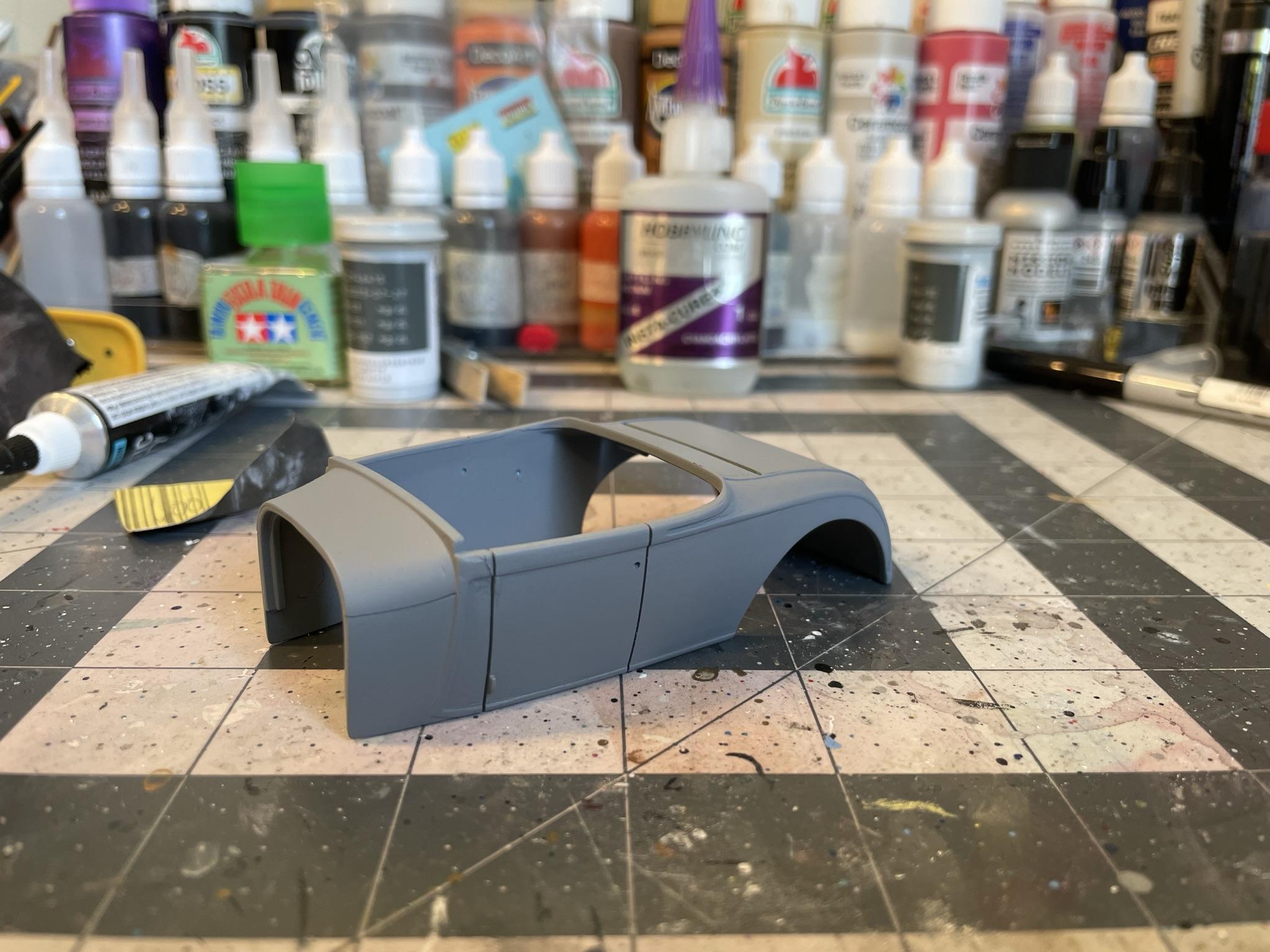

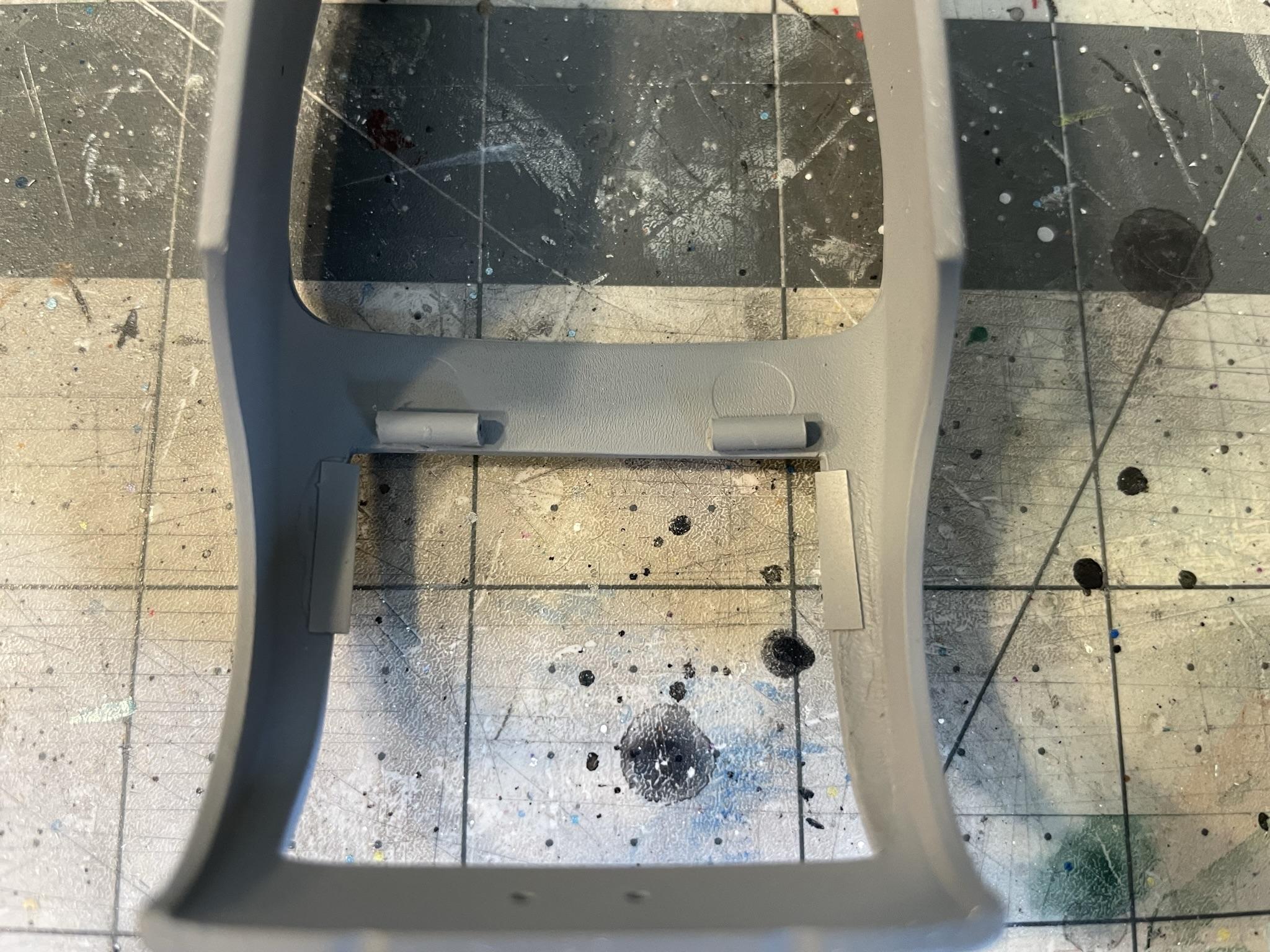

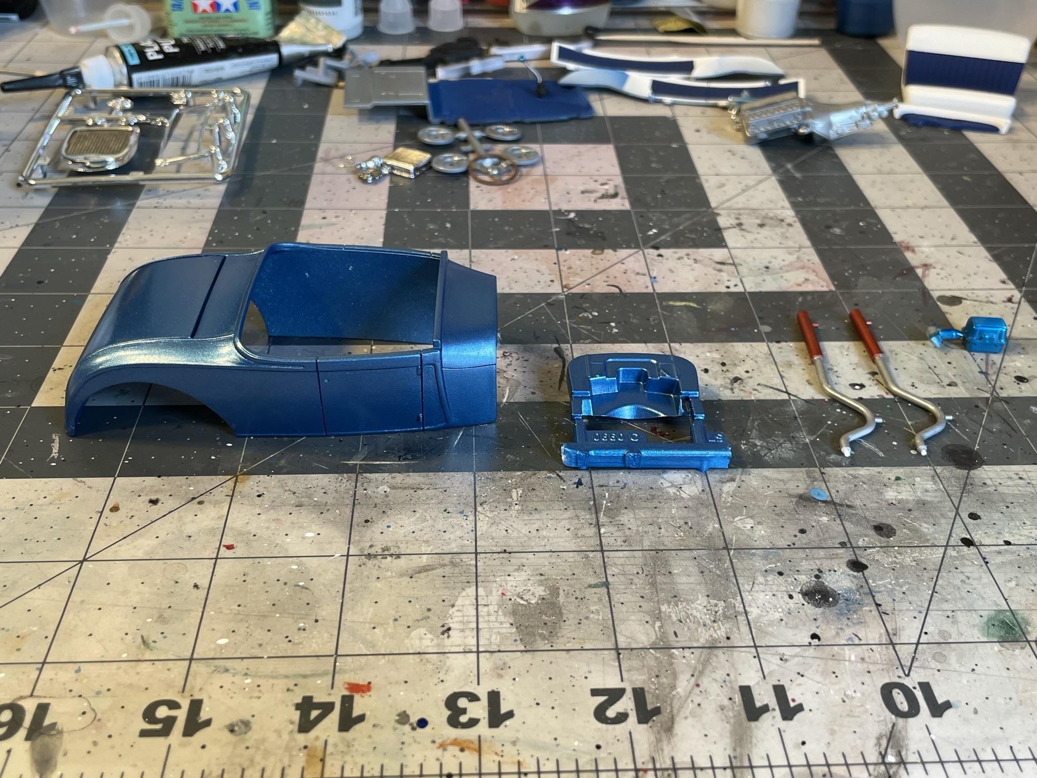

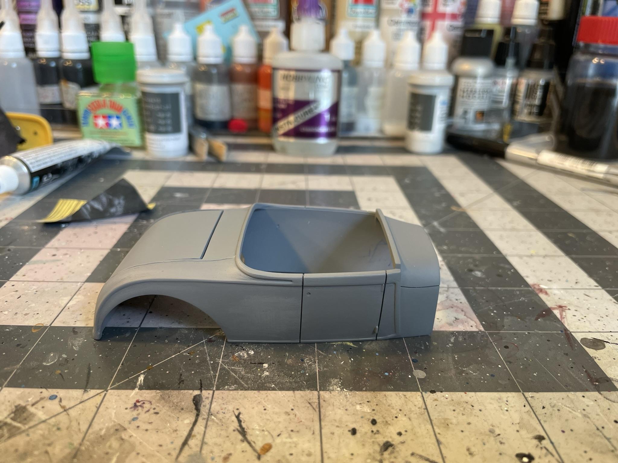

Dragonhawk1066 Posted May 31, 2023 Author Posted May 31, 2023 I re-sprayed the Stynylrez Gray Primer on the body this morning and am happy to say it meets my approval. I also measured and bent some wiring for the hinges and glued some tubing in place for them as well as some thin sheet styrene to keep the trunk in place. Now I'll work on mixing up a custom blue for it and possibly get it painted tomorrow. 2

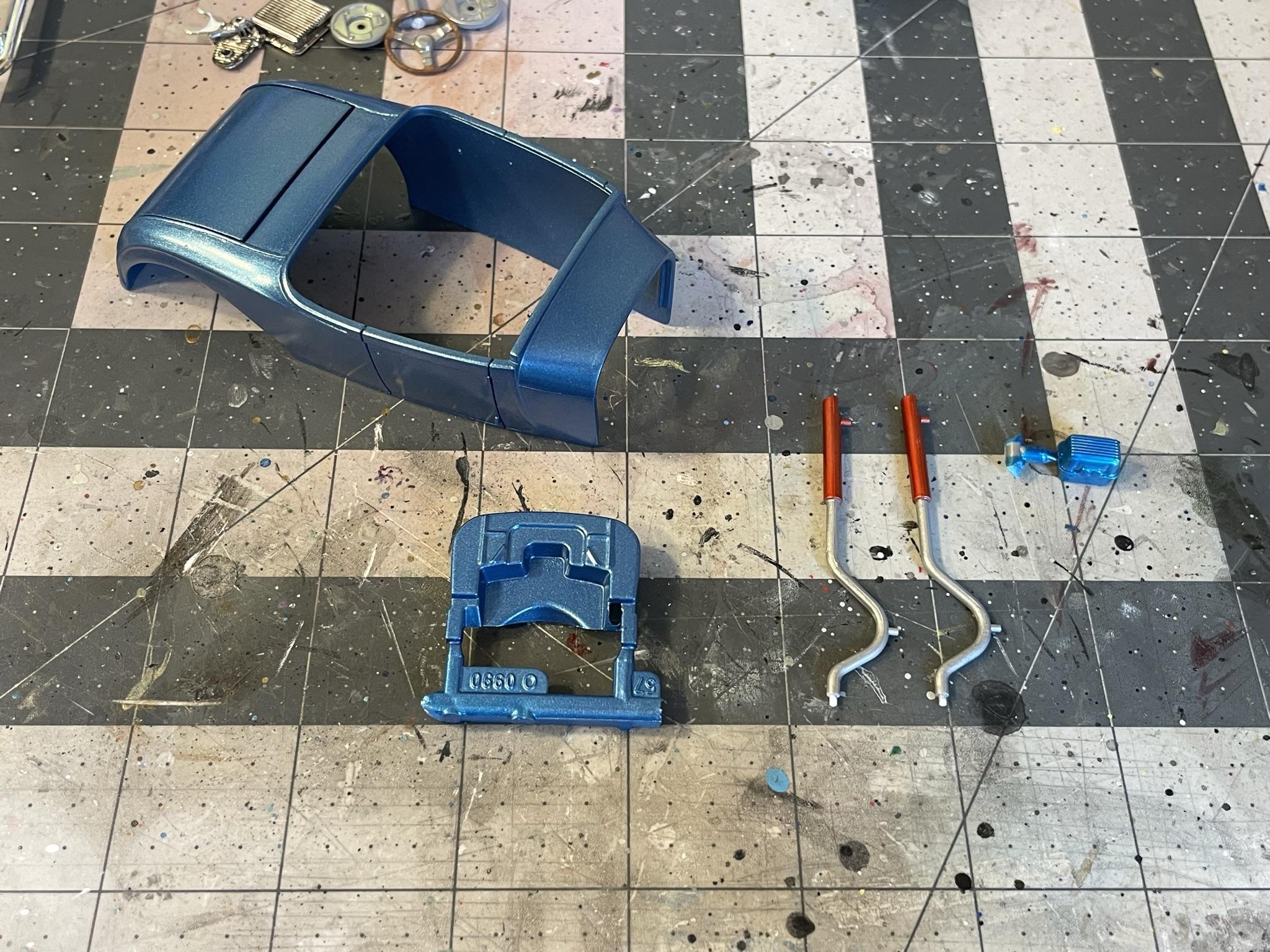

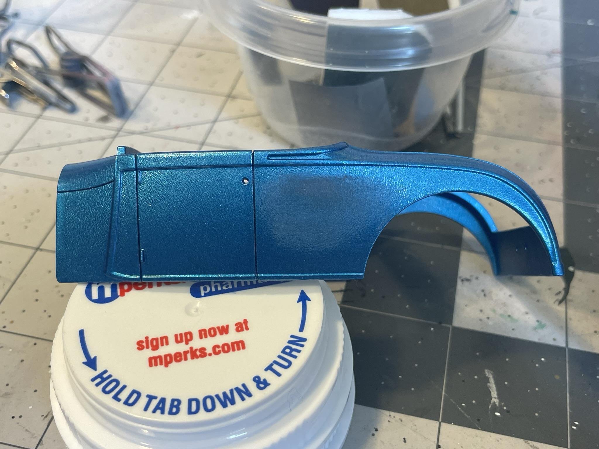

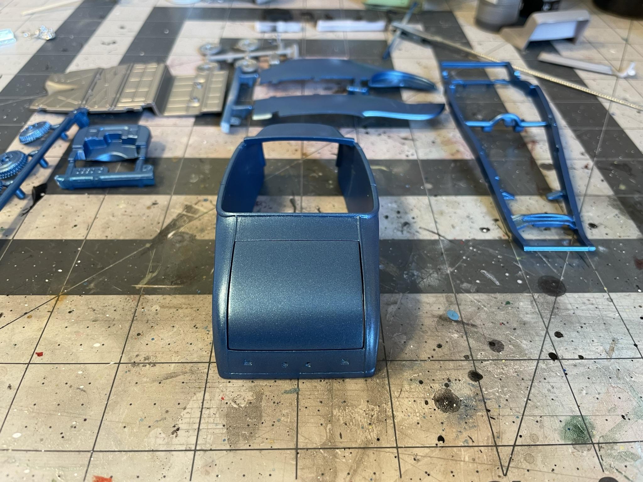

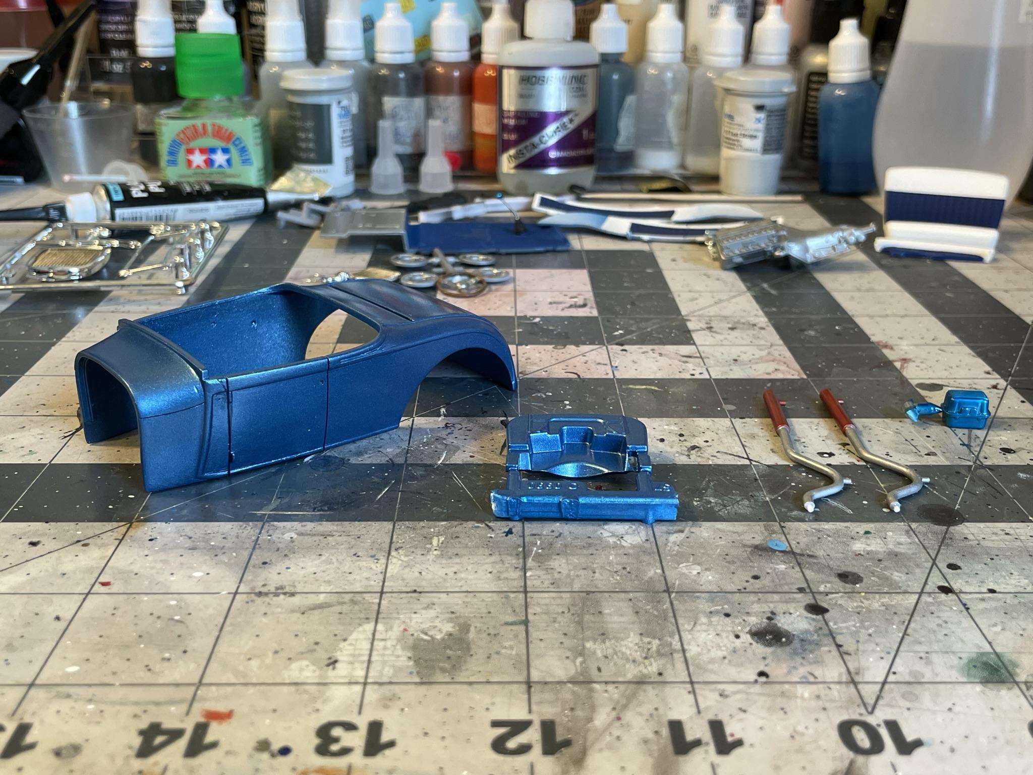

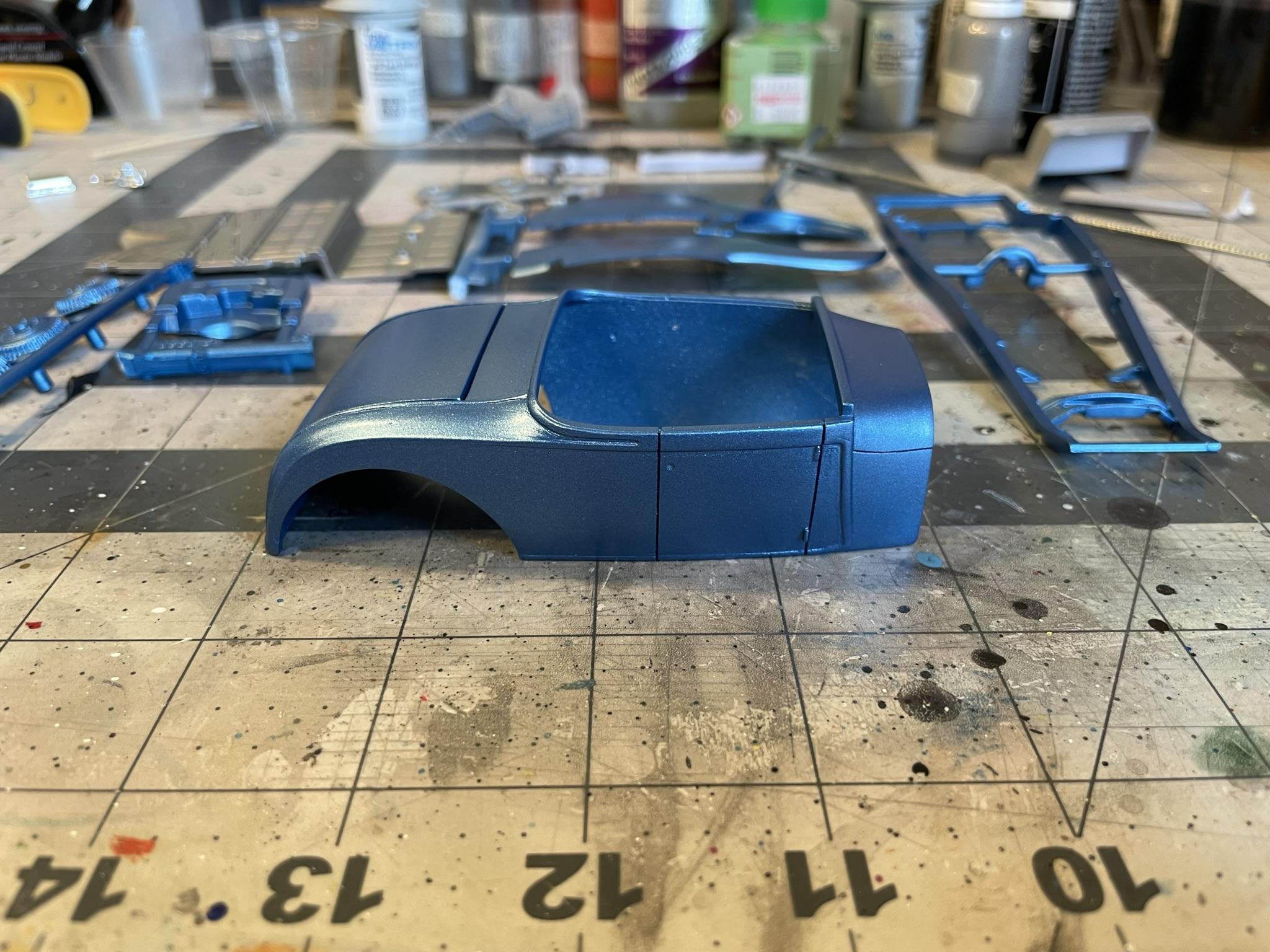

Dragonhawk1066 Posted June 3, 2023 Author Posted June 3, 2023 I mixed up a custom blue with my usual craft paint for the re-paint, especially since I threw the can of Dupli-color out. I think it came out pretty good. I'll put a coat or two of clear on it before attempting the flame mask portion of the program. 7

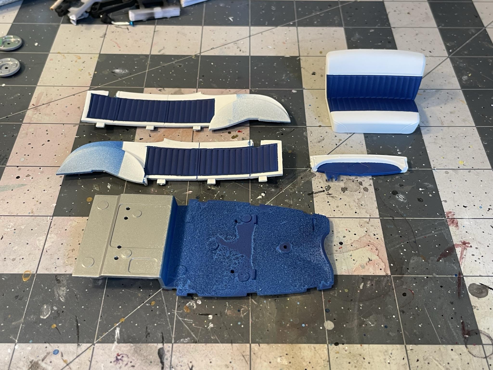

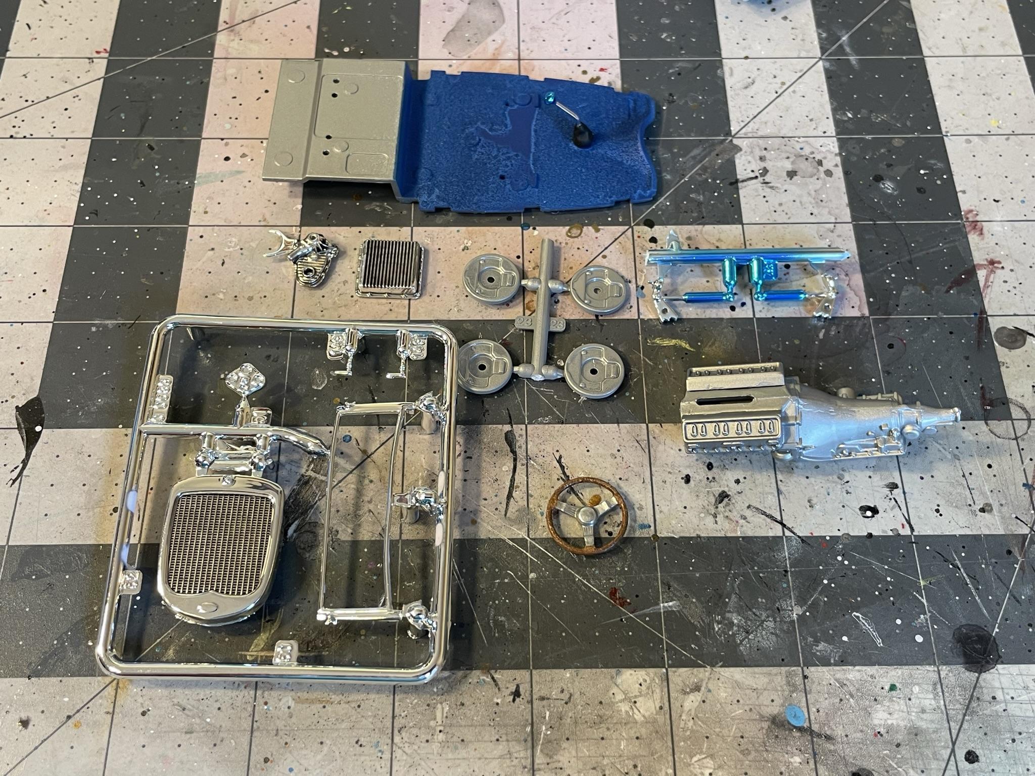

Dragonhawk1066 Posted June 5, 2023 Author Posted June 5, 2023 Today's progress on the Revell '29 Model A Roadster. I sprayed on two coats of Createx 4050 Clear in preparation for the flames. Interior is sprayed in Apple Barrel White and Admiral Blue, with white embossing powder painted Admiral Blue for the carpet, a few touch-ups are needed but nothing major. Engine is sprayed in Anita's Galvanized Tin, Tamiya Clear Blue on the shifter knob, battery box, and front shocks. Tamiya Clear Red for the mufflers and wood grain steering wheel, and Panel Line Accent on the radiator shell, timing cover and oil and transmission pans. 1
