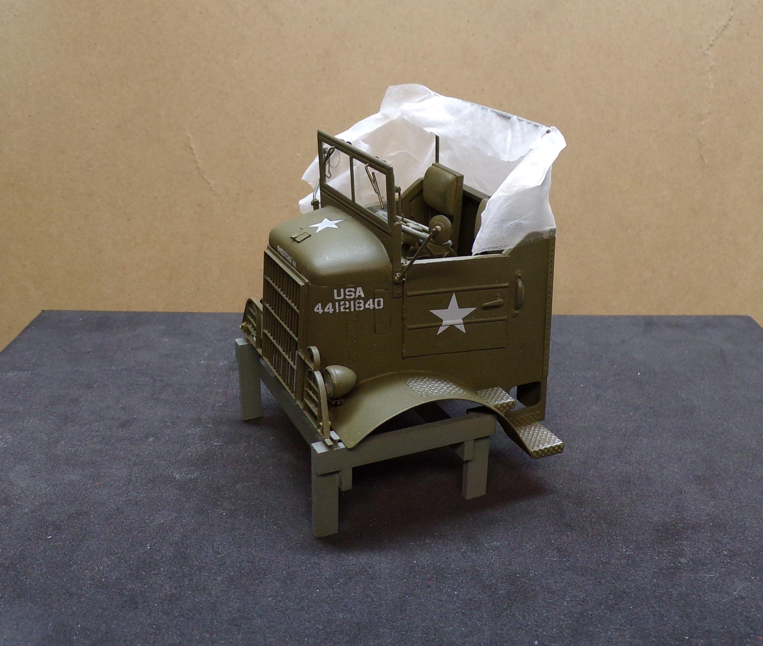

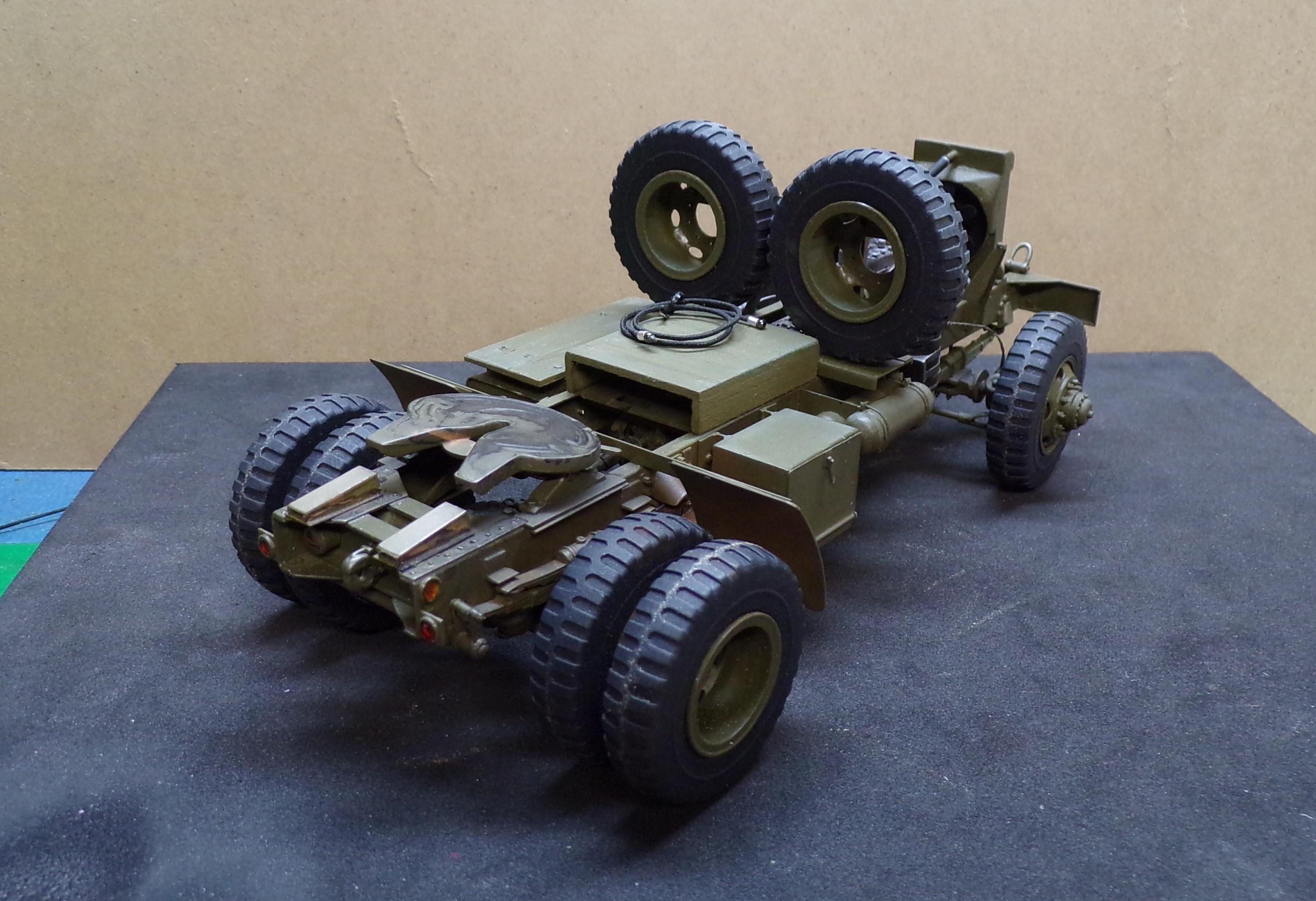

Beginning to close in on the finish line.  Still plenty to go but many of the details have been added to both the cab and chassis.  The wood decking over the gas tank and frame have been added along with door handles inside and out, rear view mirrors and the cab interior is done.  The spare tires are mounted on separate brackets that are attached to the frame.  Early versions of the U-7144 had steel deck plates but as the war wore on, wood was substituted for the steel.  It did the job for uses that did not get a lot of wear.  I used some basswood strips to form the decks and retained some of the openness of the grain for contrast.

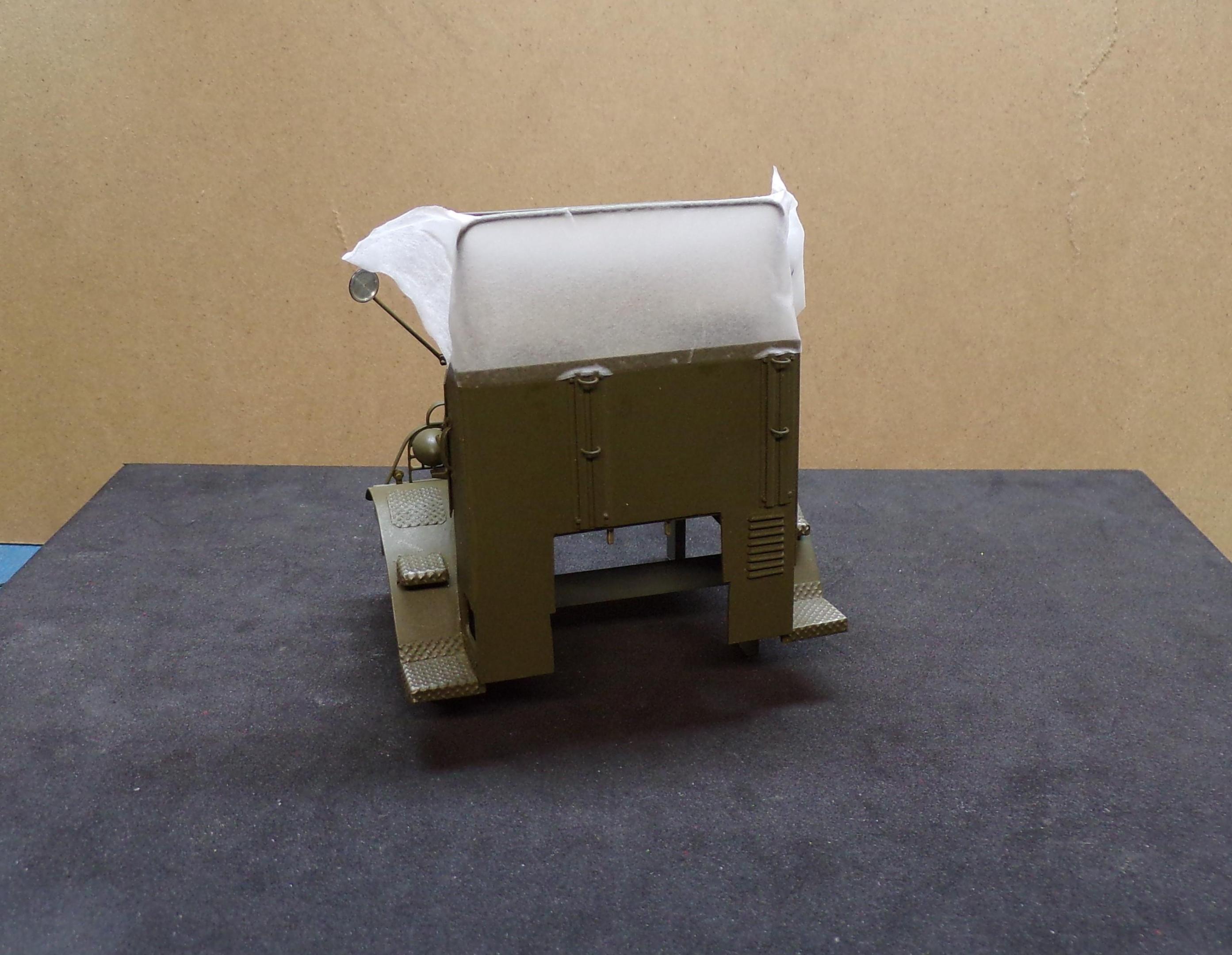

And work has begun on the soft top using two ply tissue with white glue/water mix to shrink and stiffen it.  Decals have been added and I ended up changing the windshield wipers.  The first ones didn't look that good and fortunately they were easy to remove.104.thumb.JPG.a2459439c558ca107d4ac487dd4d01a3.JPG107.thumb.JPG.4b00d2a85bed7b89992c39eeba54c000.JPG

I really like the realistic wood planks, fasteners and all, and the deck looks like the skids we sometimes see in more modern times. A close up view of those wipers reveals them to be soldered brass just bent to pivot in their mounting holes, very clever! Those mirrors look a lot more complicated, both the mount on the cowl and the swiveling head (or so it seems), very realistic even up close. Nice view of that treadplate, too, thank you! Gotta try it
Hey, Bob.  I turned the mirrors from aluminum rod.  Just drilled a small hole in the back for a pin and added the arm.  The other end of the arm fits inside a small section of square channel and with a pin through both.
