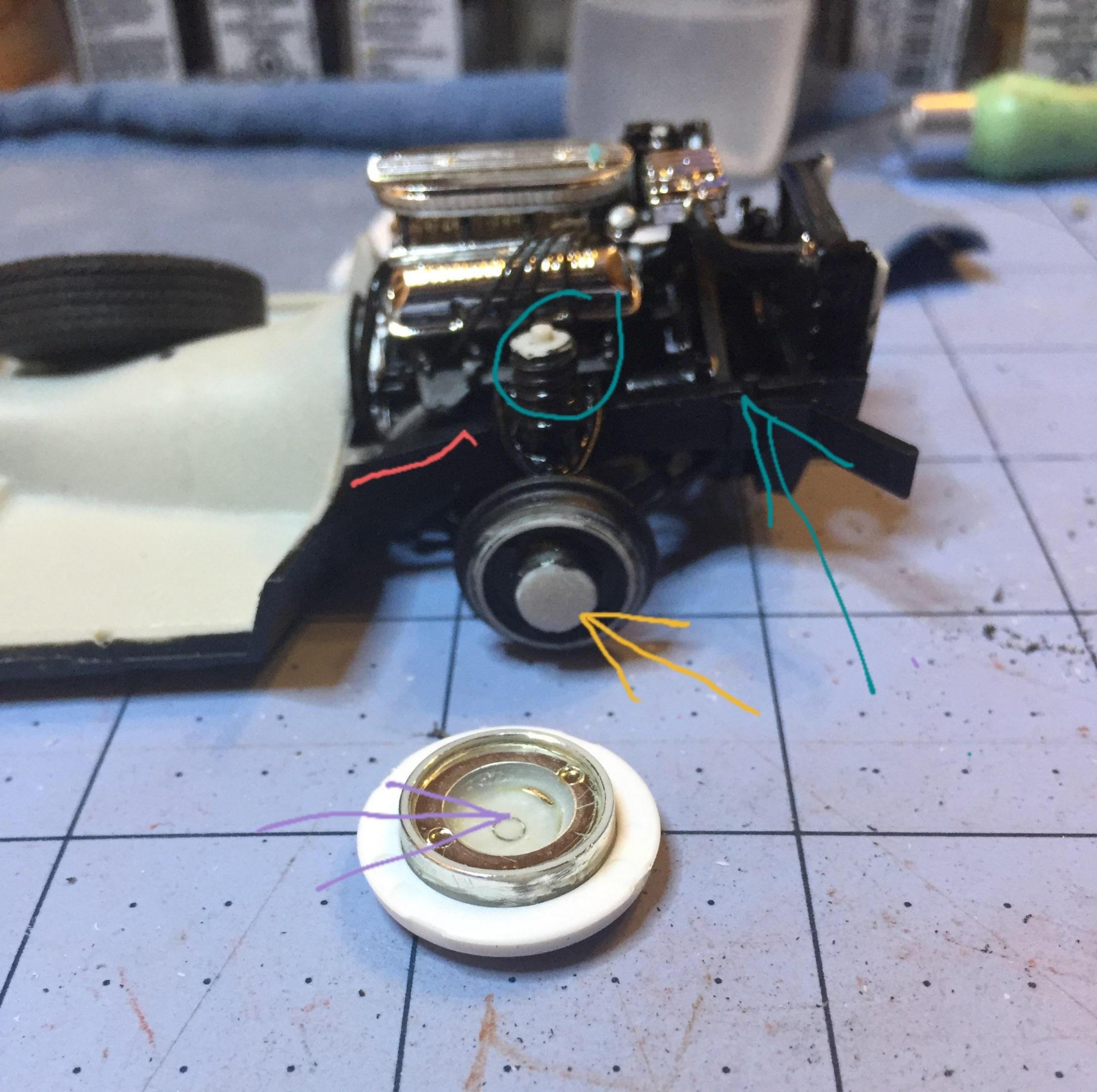

Today I got the wheels on with a little difficulty.  The kit provides a means of attachment that allows the wheels to turn using donut retainers that fit over dowels and are glued in place, capturing the wheel back/backing plate. This also allows the wheels to wobble a bit. We can't have that so the inner wheels have been glued to the spindles to eliminate the wobble. I wanted to glue the wheel halves together to keep them from falling off the car (I had to get the wheels on in order to do a mock-up.)  The donut retainers (yellow arrow) had to be ground down and the outer wheel needed a little tweeking as well (purple arrow) in order for the halves to mate cleanly.

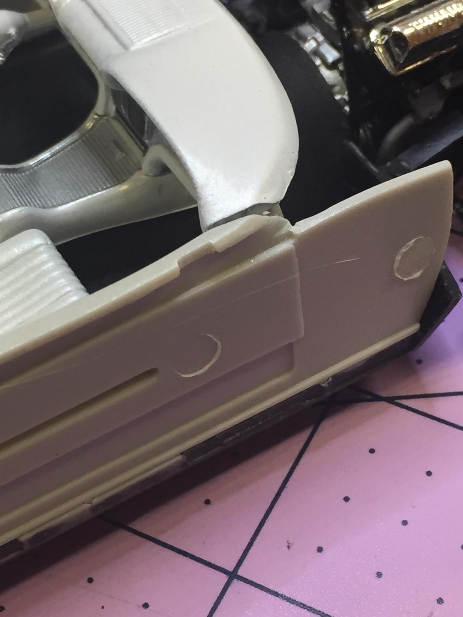

There was something interfering with the front chassis locating pins (blue arrow) entering the holes in the body. I shaved the bottom of the contact areas just ahead of the firewall (red line) and removed the pins from the coils (blue circle) just because. It seemed to work but I think I may enlarge the holes a bit. One of the motor mounts let go while I was dealing with all this ?
I wanted to check the stance and found the nose a bit high. We can't have that either. Luckily, it was easy enough to flip the spindles (which, so far, have been allowed to pivot) but I don't think this will do.  Now there's too much rake for a car like the Thunderbird.  I will look for an easy way to fix this (lowering blocks at the rear axle?)  These cars sat pretty low so lowering the rear rather than raising the front would make sense.

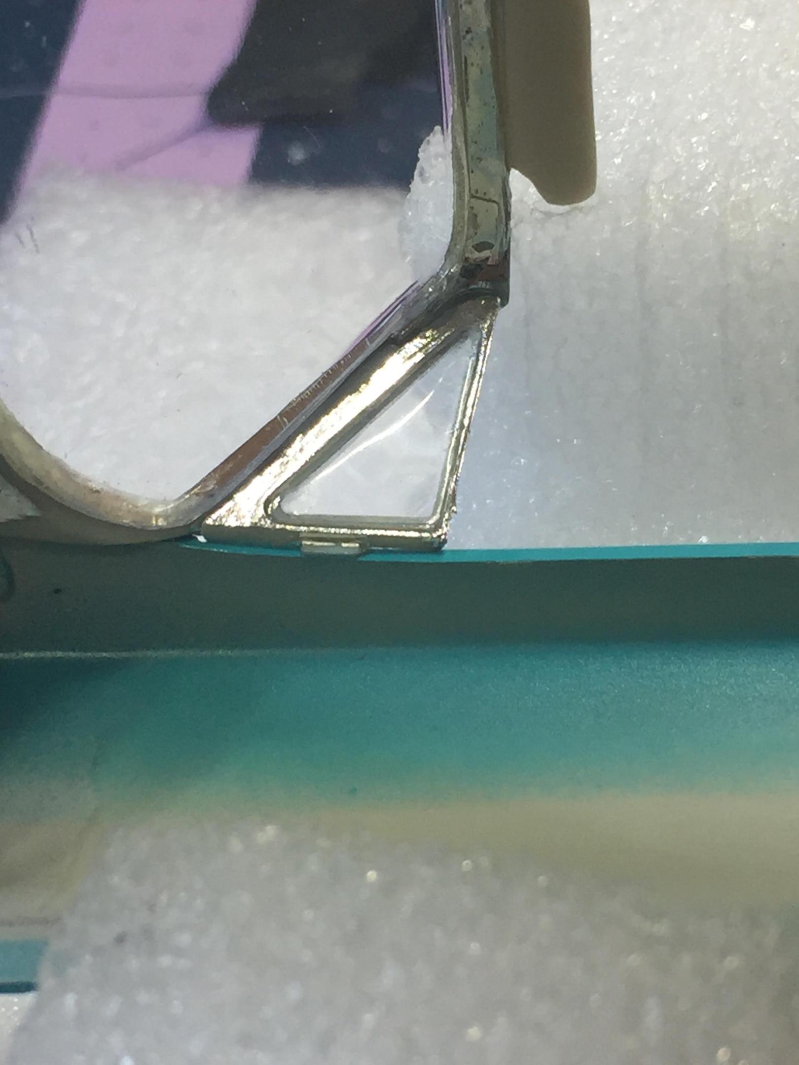

Thanks, TJ, I don't think it's a real fit issue but rather something I may have done or not done. I trial-fit most things but I may have missed something. I know about windshield/dash problems with a whole bunch of kits and I'm OK with fixing those. The fairing is probably something I did.

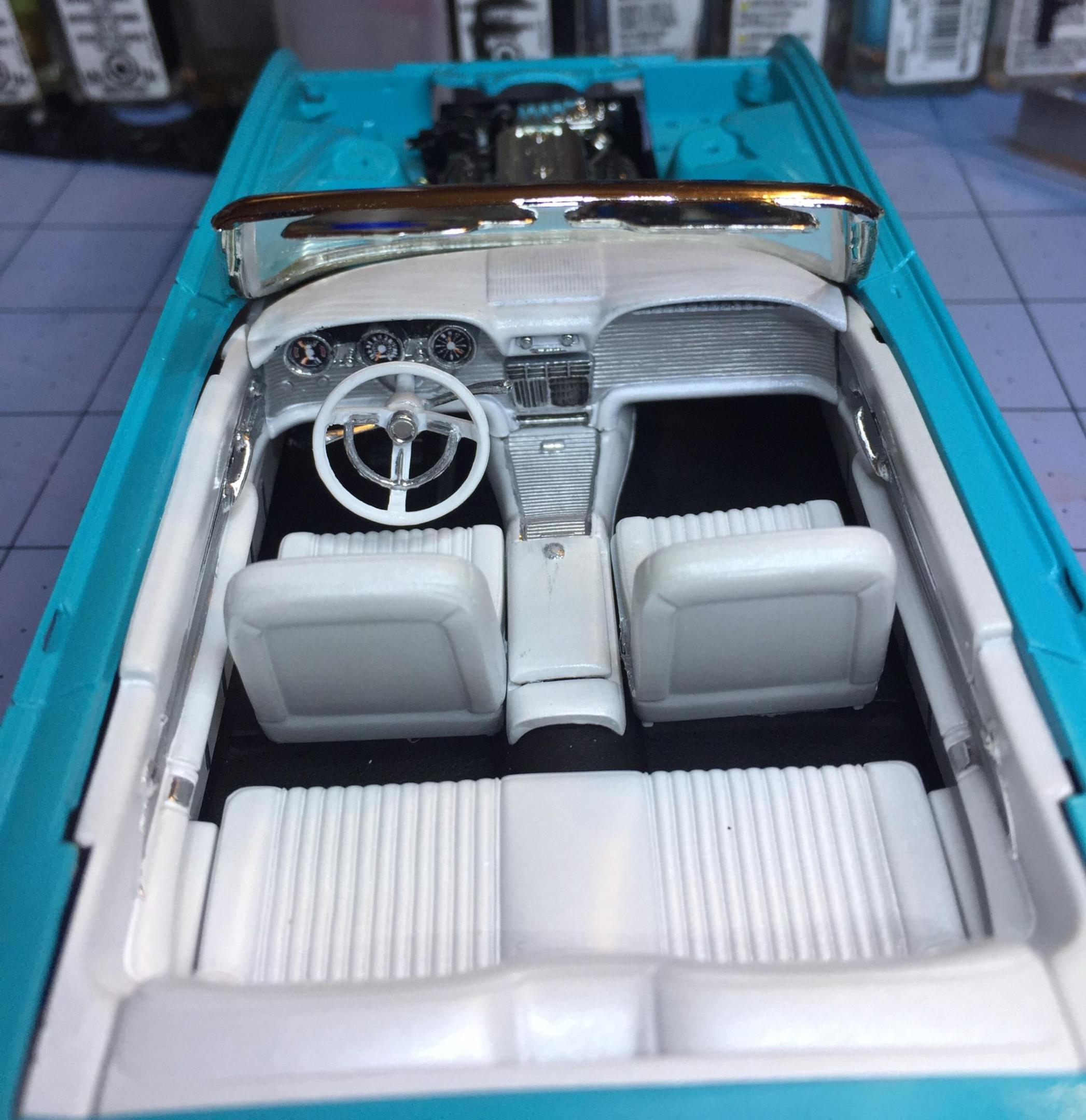

The dash was painted black first but I switched it to white and I don't like it now but it's a done deal. Everything is an experiment.  Never forget that!

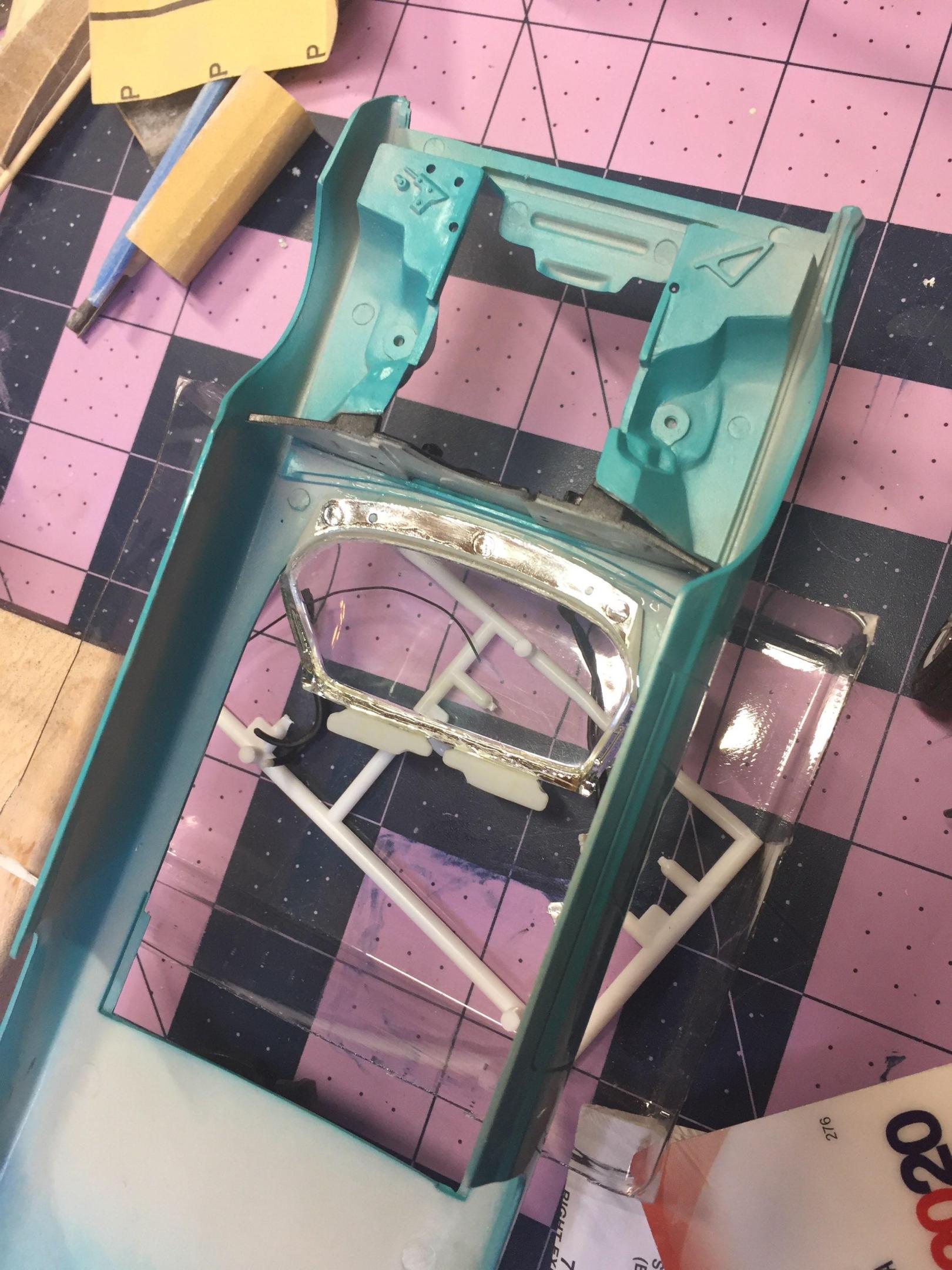

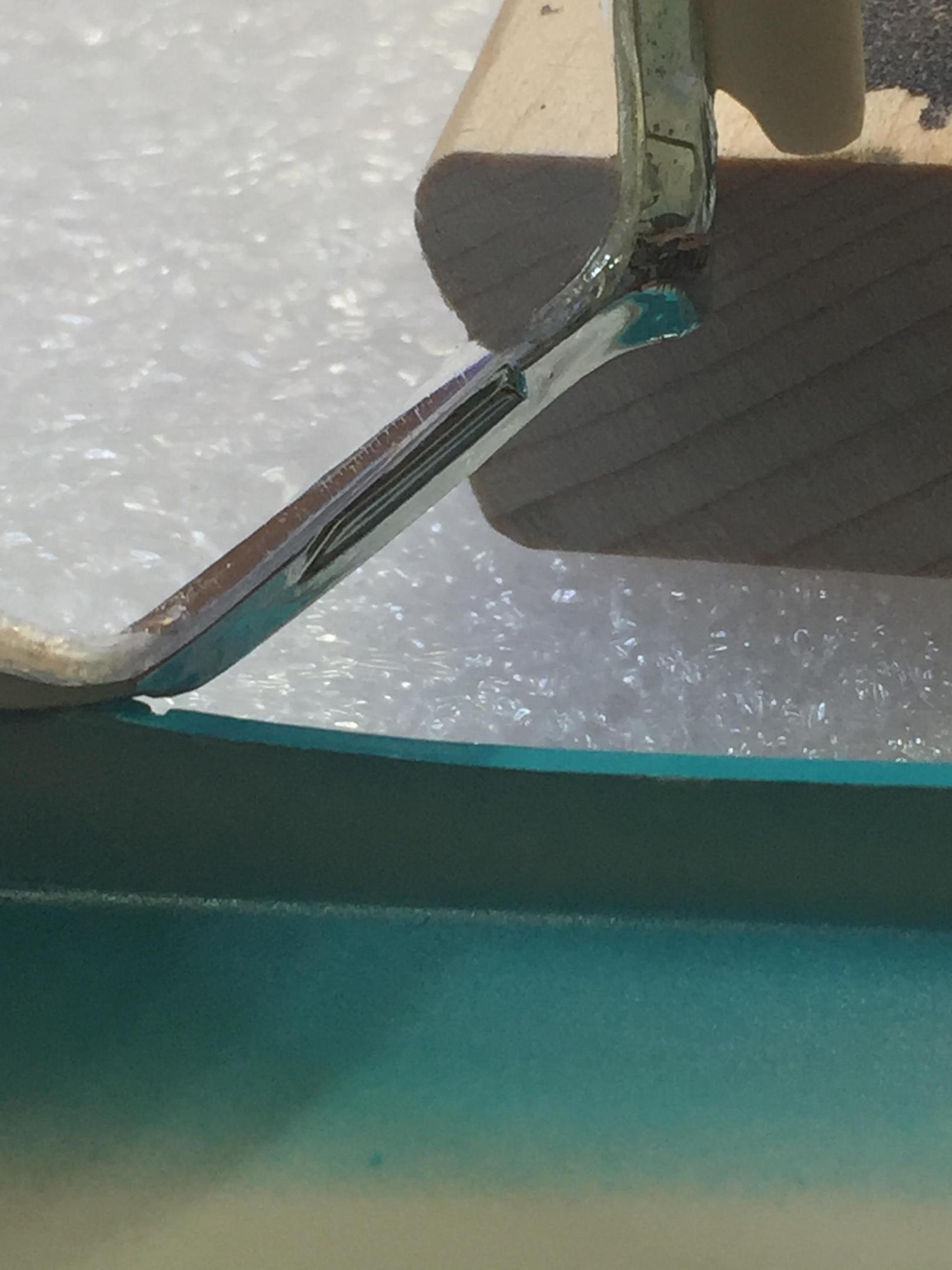

It's a plated kit part, Sonny. And it fits very tightly and must be lightly forced into place.  Mocking up is an awkward affair with this windshield.  The "glass" is pretty thin and fits the frame perfectly on a dry fit. I used the "gold" thin CA and held the glass in the frame and used the capillary action to cement the parts together. I suspect it may have moved a little during the operation.  When I install it on final assembly, I will be adding the vent window assemblies, which will establish the angle. In this mock-up, the windshield looks too high. A lower angle should make it look right. ?

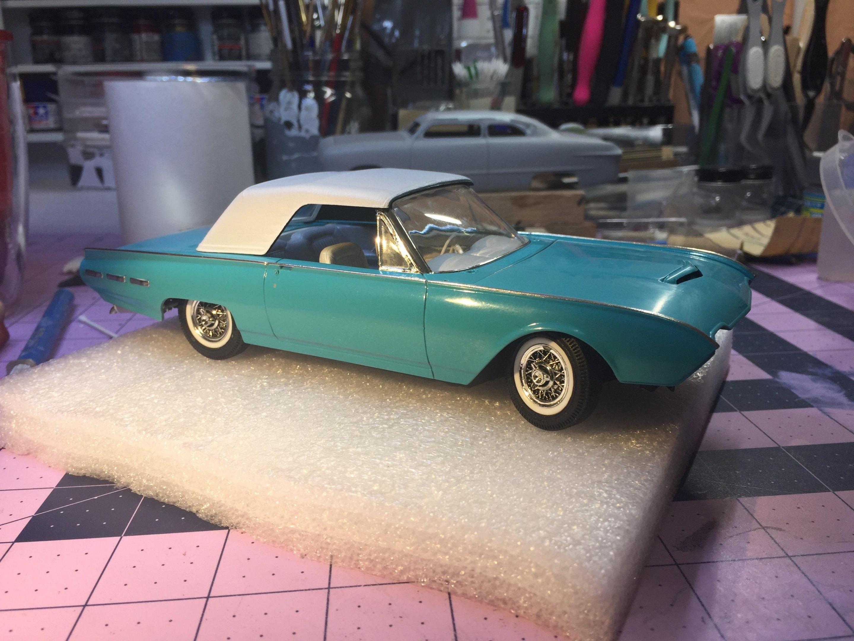

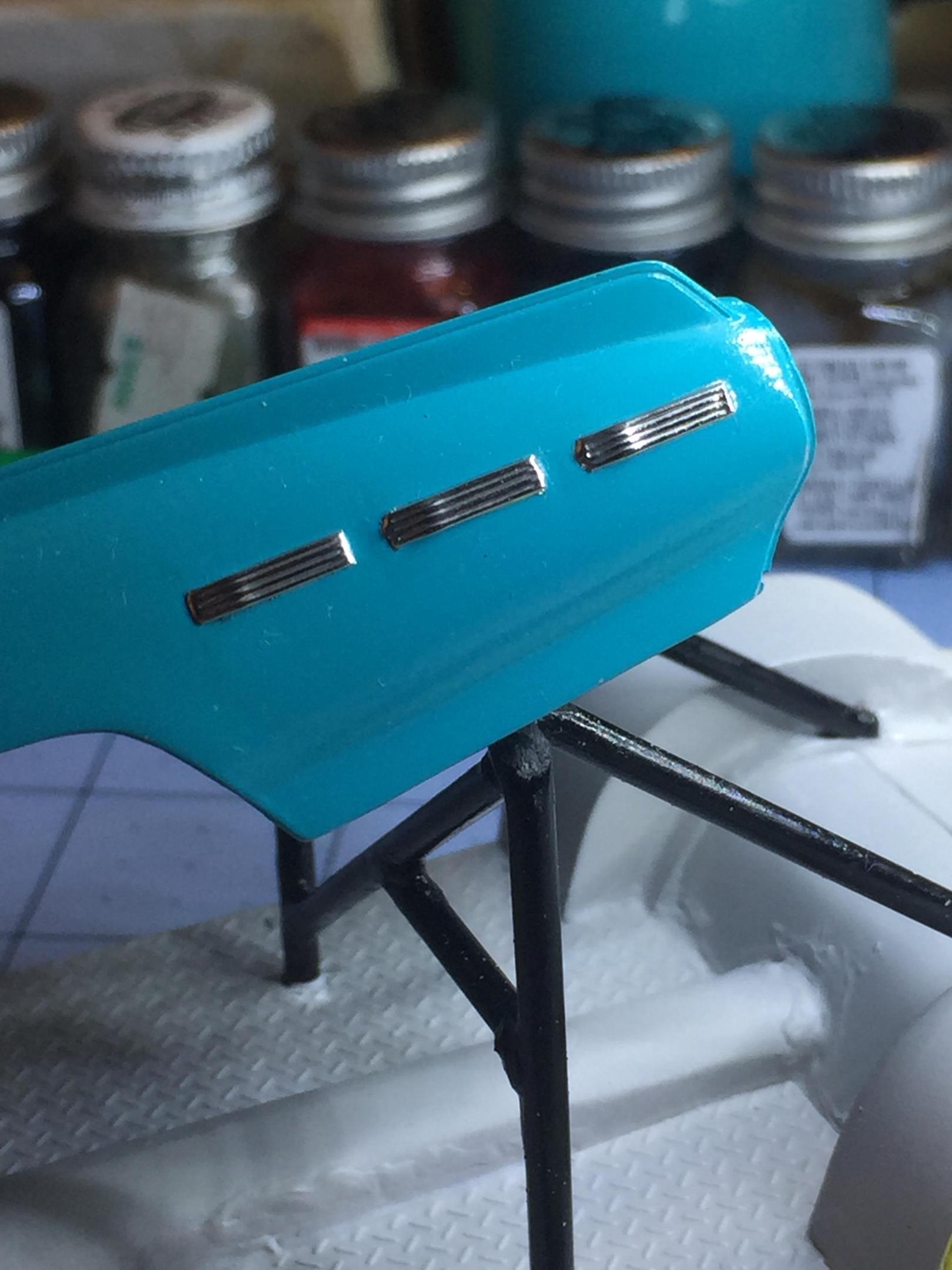

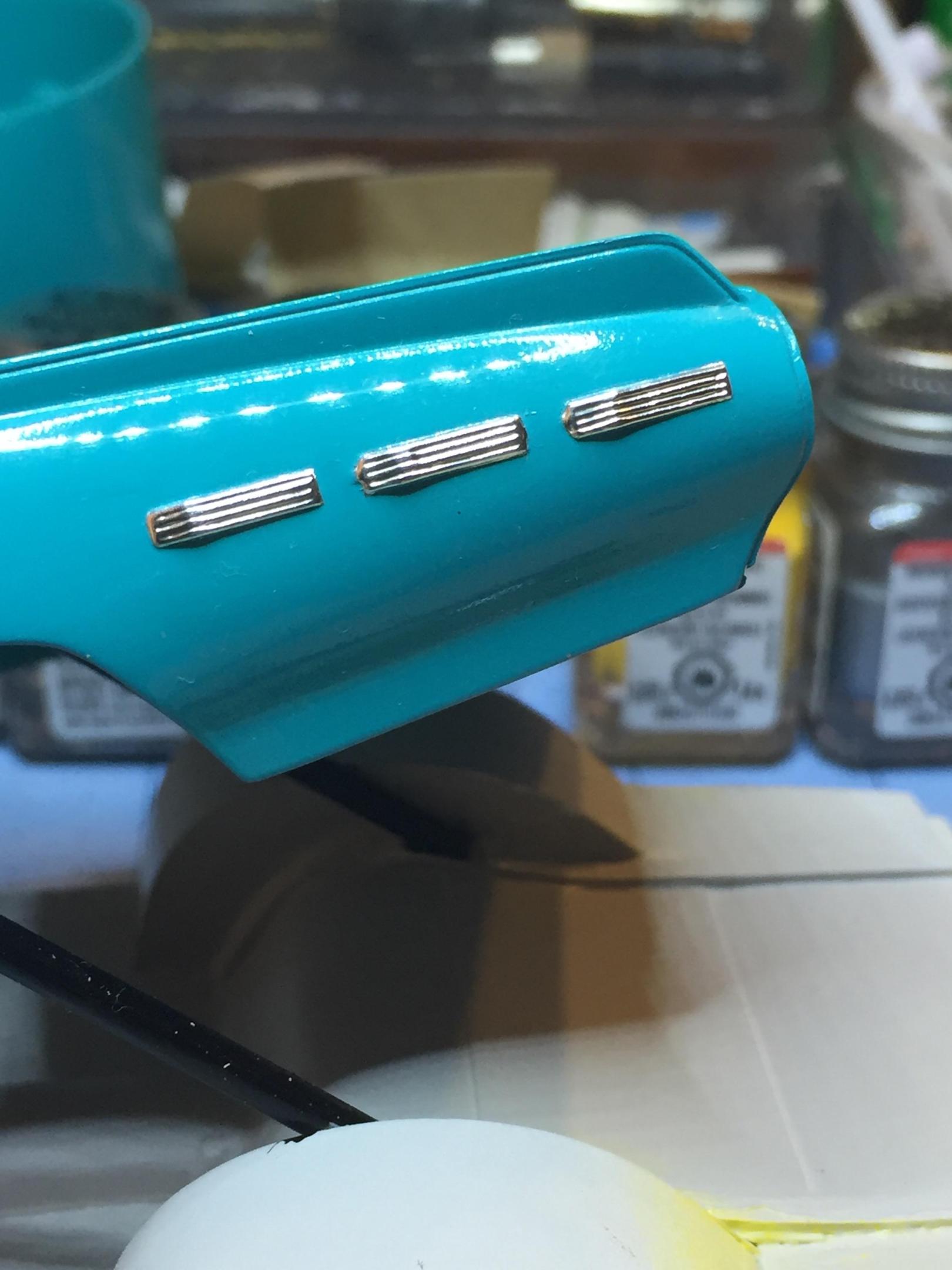

Having unfinished projects piling up can be a real detriment to one's focus. I decided it was time to clean some of it up while waiting on other projects 🥴.   There were a few that just needed a battery or radiator hoses. This '62 'Bird needed final assembly so it's back here for a while. This project goes back to August of '23.
The windshield was the first thing I needed to deal with. It can actually be "snapped into place so that's what I did. I added a bit of CA on the front edge of the assembly and let it set up overnight. This morning I added the vents which have locating lugs that fit into recesses in the windshield frame. The small tabs on the bottom of the vents will locate in notches on the door panels.
The driver's side provided an opportunity for some choice language being dispensed at high volume but I uncharacteristically resisted.
I got the body on the chassis with some very careful handling and glued and clamped the front. The front wheels are "set-able" but for now I'm allowing them to flop about till I make that decision. I added some items under the hood such as the battery, the washer reservoir bag, heater hoses and A/C lines, shock tower braces, and brake line.
There's still more work here but mainly it's paint. Oh, and I tried to polish the hood...that didn't work out. Gotta paint it again.
