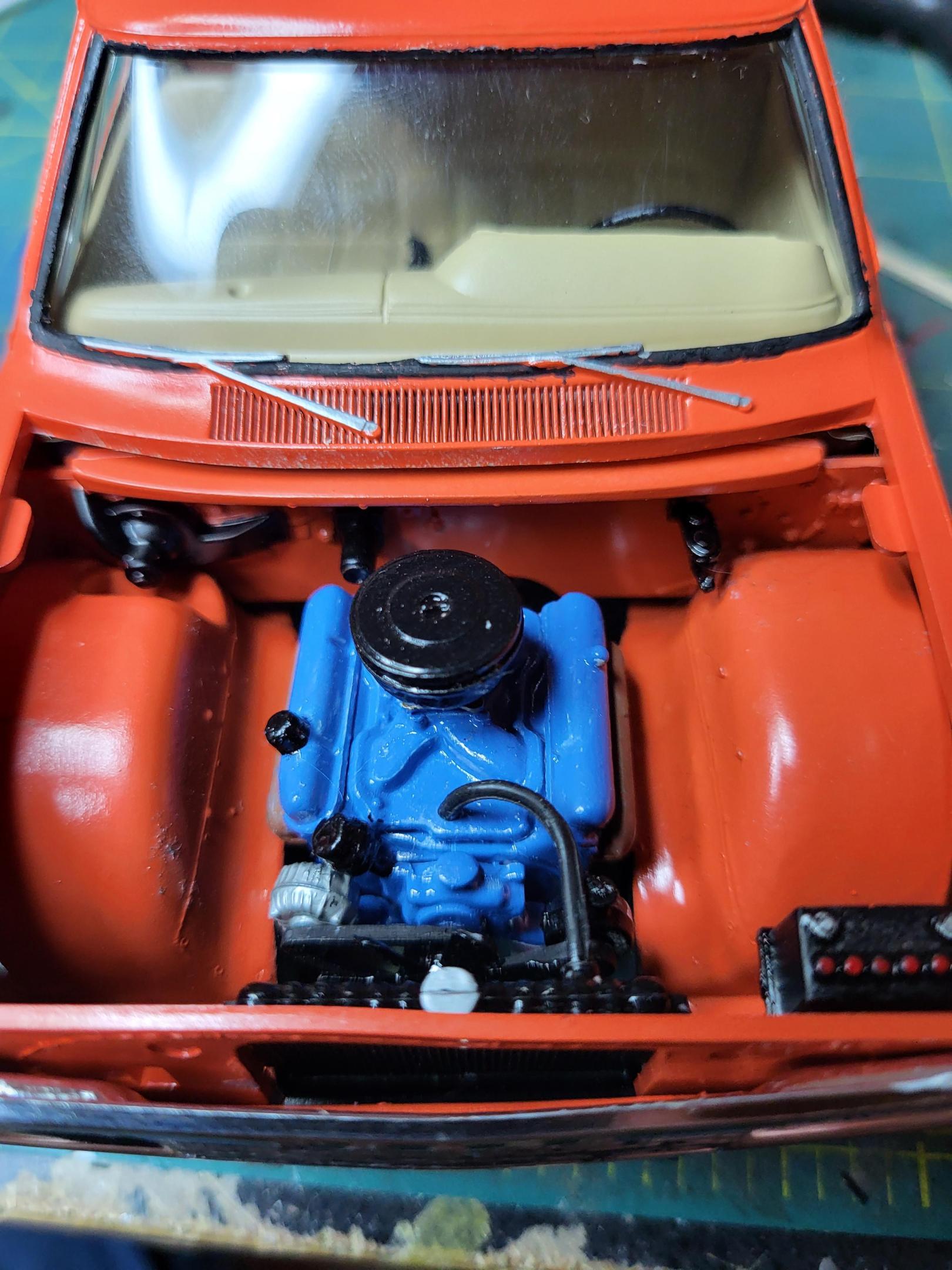

Jim B Posted July 24, 2023 Posted July 24, 2023 I used MCW enamel to paint the engine on my MPC 1978 Dodge D100, and I had a hell of a time with the paint. I'm sure part of the issue is that I was brush painting with it, and it's probably formulated to airbrush; but I cannot confirm that. Good luck with them, but I don't think I'll be using them in the near future. Why do model companies assume that everyone has an airbrush? At least it seems that way,

Jim B Posted July 24, 2023 Posted July 24, 2023 (edited) 6 hours ago, Dave G. said: It sounds like you had their lacquer which is pre thinned for airbrushing and basically brush paints lousy.. The enamel is not thinned, it should brush paint fine. It's possible, I don't know as this was the first time I've ever used MCW paints. The paint was 1402E Chrysler Engine Blue. I'll probably give it one more shot on the Slant-6 on my Lindberg 1964 Dodge 330. Edited July 24, 2023 by Jim B

Nicholas Posted July 24, 2023 Posted July 24, 2023 39 minutes ago, Jim B said: It's possible, I don't know as this was the first time I've ever used MCW paints. The paint was 1402E Chrysler Engine Blue. I'll probably give it one more shot on the Slant-6 on my Lindberg 1964 Dodge 330. the part number you gave is a enamel as by the letter E after the part number i have hand brushed their enamel line and it works great (mostly interior stuff),never tried to hand brush a body though
Jim B Posted July 24, 2023 Posted July 24, 2023 3 hours ago, Nicholas said: the part number you gave is a enamel as by the letter E after the part number i have hand brushed their enamel line and it works great (mostly interior stuff),never tried to hand brush a body though I didn't use it to brush paint a body. I used it to paint an engine.
Dave G. Posted July 24, 2023 Posted July 24, 2023 1 hour ago, Jim B said: I didn't use it to brush paint a body. I used it to paint an engine. If you used enamel straight up then next time try cutting it with about 30% mineral spirits for brushing. It should level nicely and lap strokes should blend well. At least so if it's like other enamels. 1
Jim B Posted July 24, 2023 Posted July 24, 2023 1 minute ago, Dave G. said: If you used enamel straight up then next time try cutting it with about 30% mineral spirits for brushing. It should level nicely and lap strokes should blend well. At least so if it's like other enamels. I'll give that a try next time. Couldn't hurt.

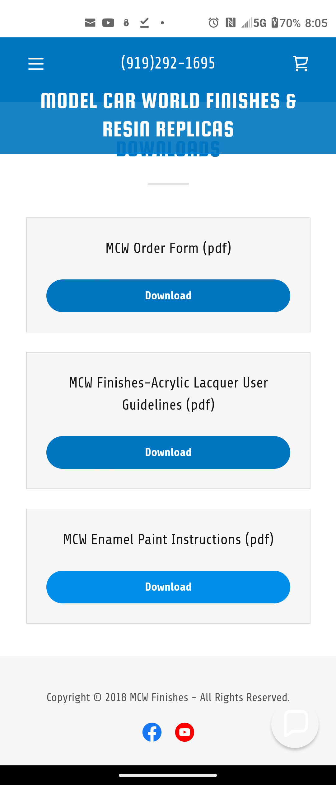

64SS350 Posted July 25, 2023 Posted July 25, 2023 If you go to his website, this is under the download section of the drop-down menu...
Dave G. Posted July 25, 2023 Posted July 25, 2023 That's why I said to check first because to my knowledge this is automotive acrylic enamel . The point is to cut it, I almost said lacquer thinner instead of mineral spirits too . I'm glad you guys corrected what to use.
