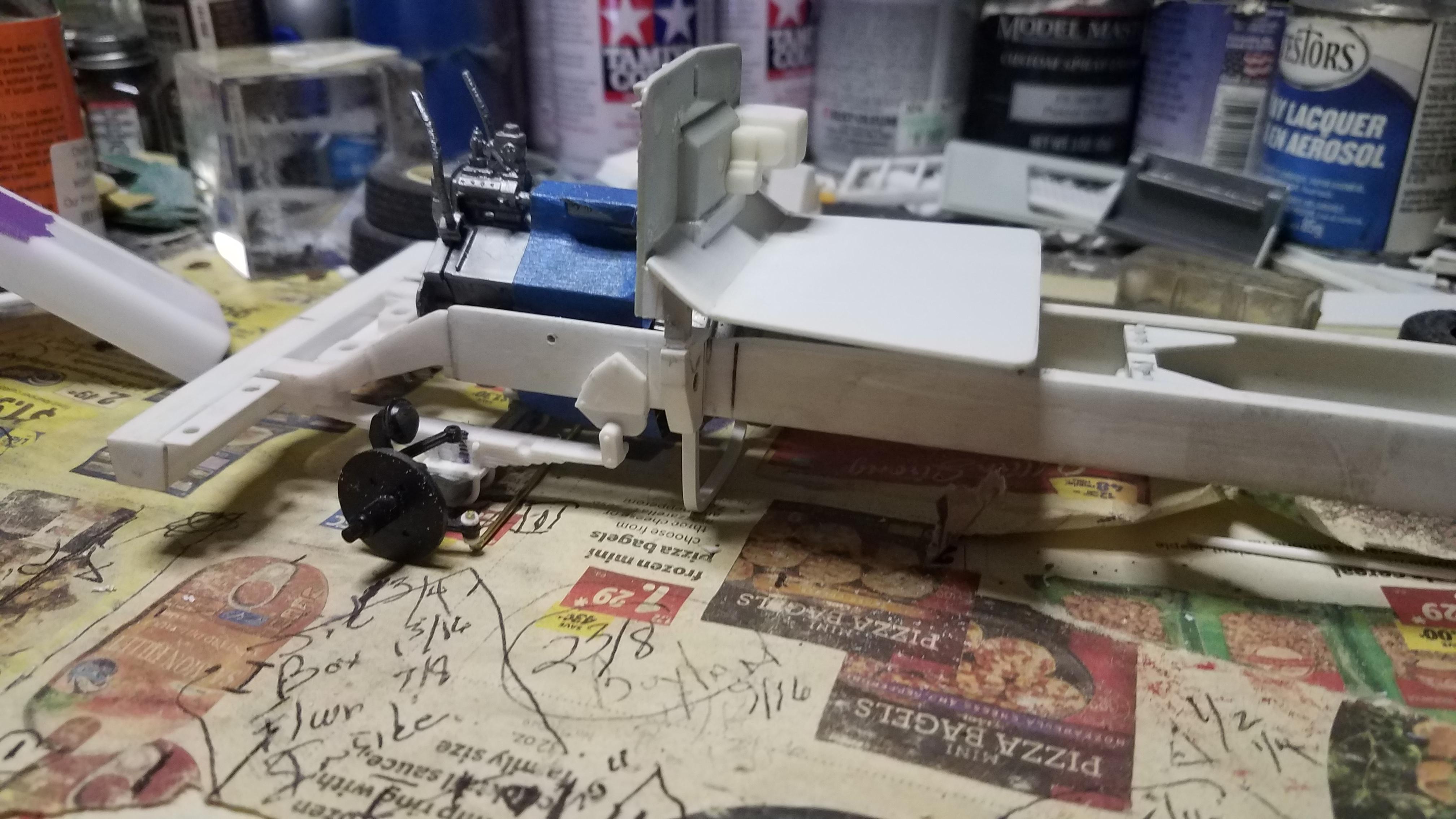

lwwoodss Posted August 25, 2023 Author Share Posted August 25, 2023 Built cab mounts, some Kenworth crossmembers and some others to hold the rear suspensions. Got part of the 5th wheel built primarily to hold the frame together since nothing is glued. Basis interior is started. All this is enough to get the cab, hood and radiator level. Next is cutting the hood and building hood slats and the cab cowl. 2 Quote Link to comment Share on other sites More sharing options...

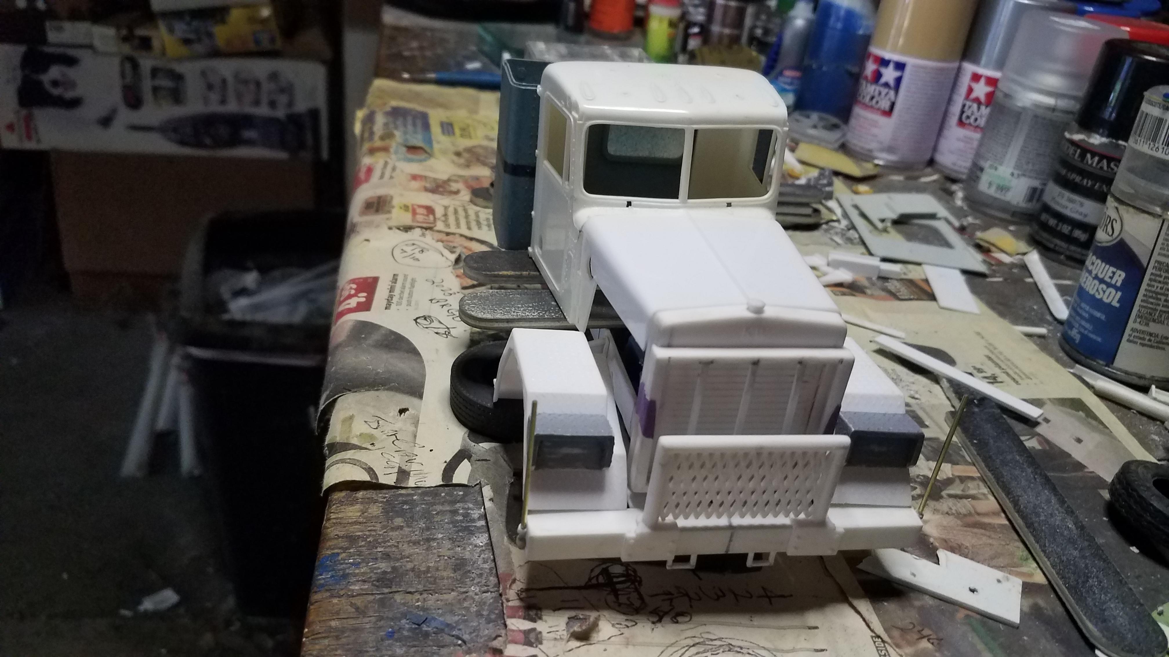

lwwoodss Posted September 3, 2023 Author Share Posted September 3, 2023 A little progress. Cut the hood so it will open. Added center spine. Cut 1/8 off each side to get rid of the bad edge where the side slats fit and replace with strip stock. Opened the left side for the second air cleaner. 1 Quote Link to comment Share on other sites More sharing options...

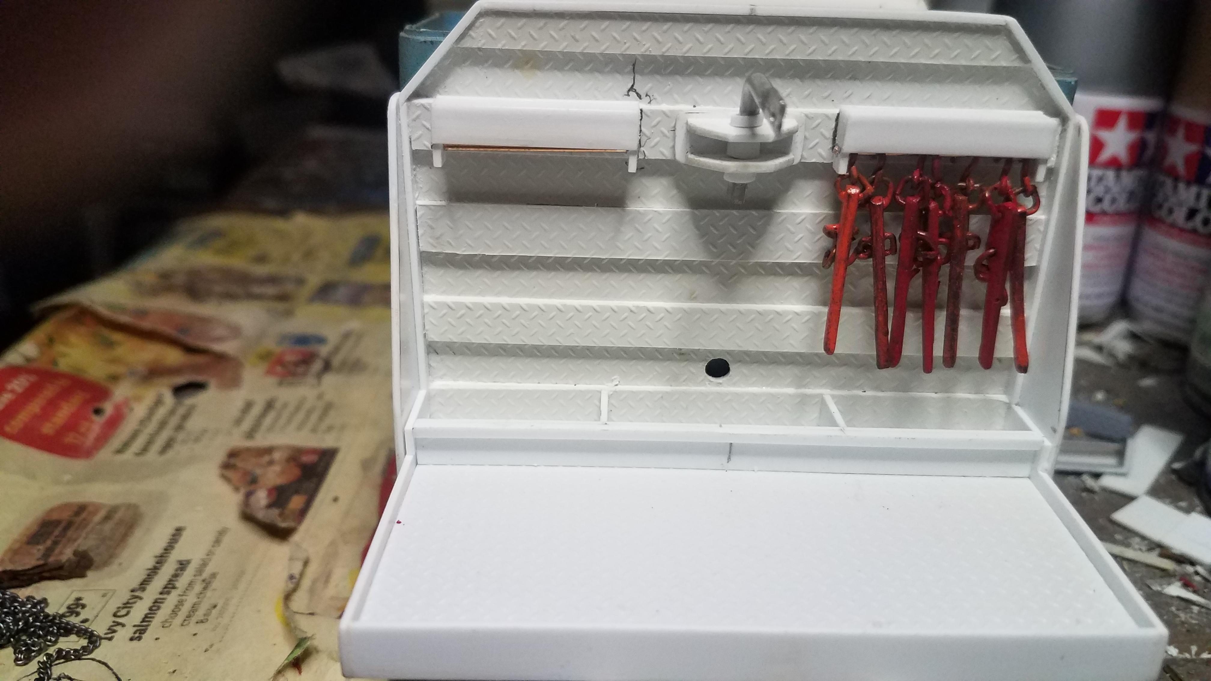

lwwoodss Posted September 9, 2023 Author Share Posted September 9, 2023 Built a headache rack/ drom deck today. Latest mock up. 1 Quote Link to comment Share on other sites More sharing options...
lwwoodss Posted September 10, 2023 Author Share Posted September 10, 2023 Built chain racks to go with the chain tray built in to deck and built a hose tender for air and electrical lines. 1 Quote Link to comment Share on other sites More sharing options...

lwwoodss Posted September 12, 2023 Author Share Posted September 12, 2023 Rebuit the chain racks they look much better. Everything is mounted to the deck. Binders added just for the photo. 1 Quote Link to comment Share on other sites More sharing options...

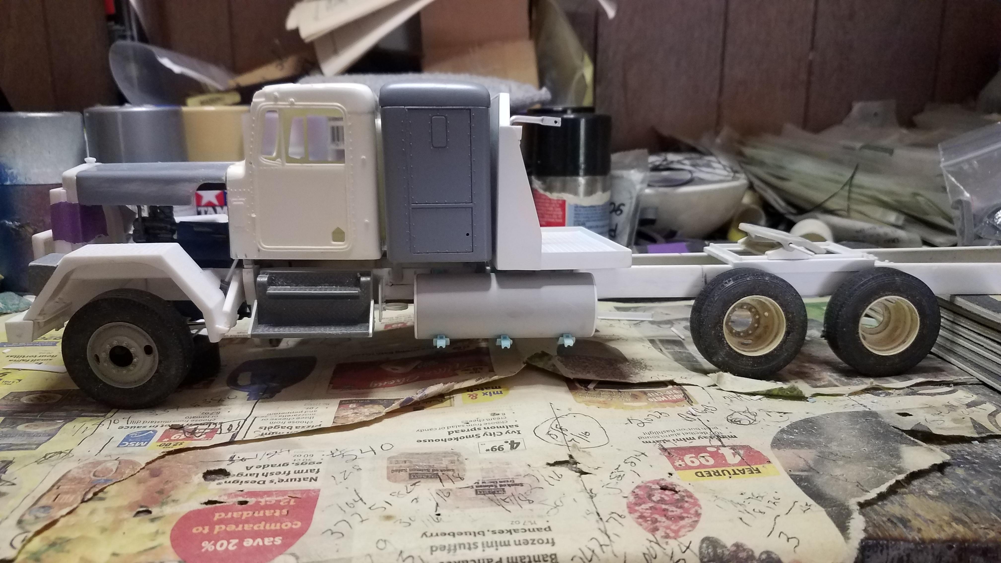

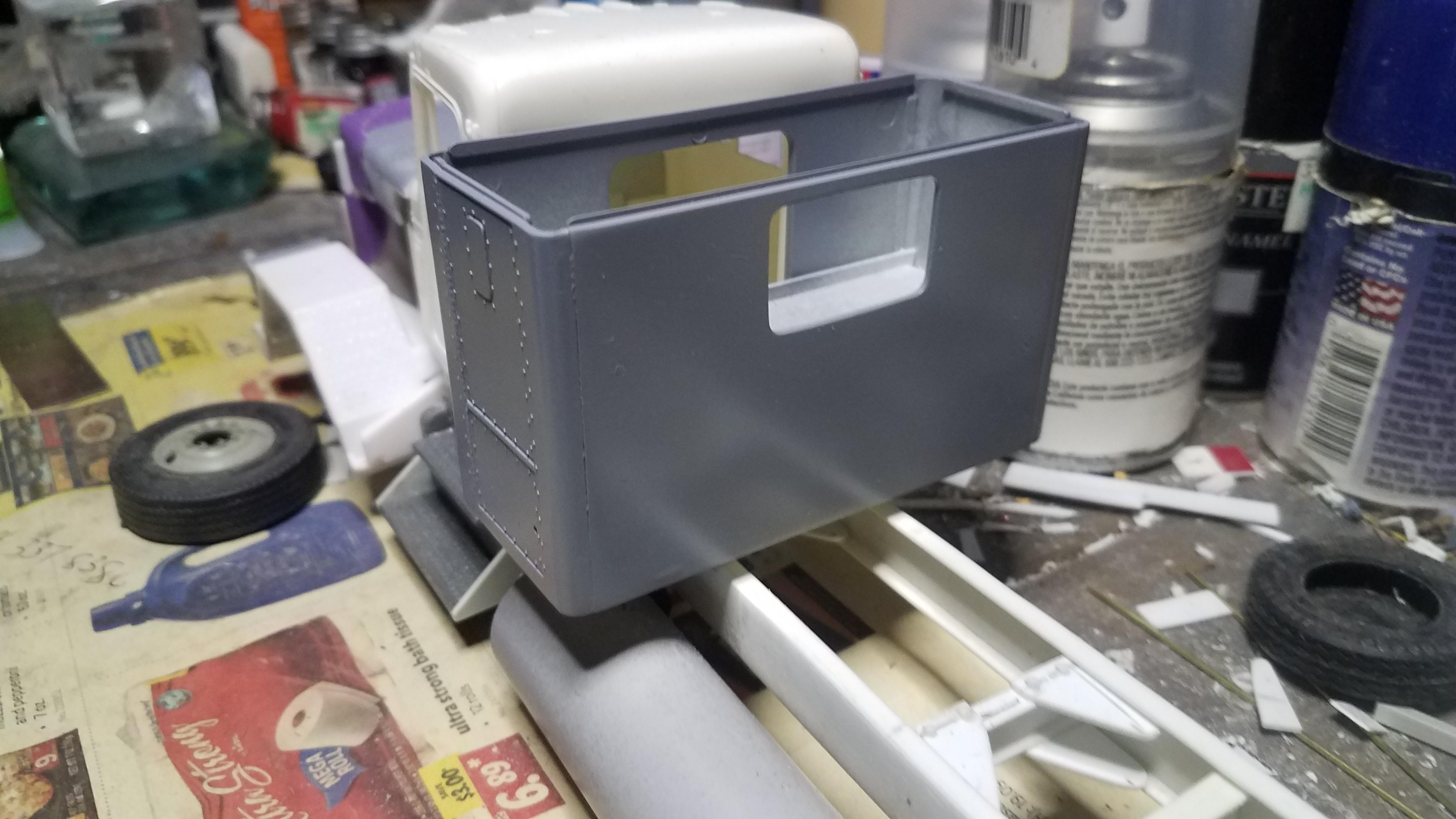

lwwoodss Posted September 17, 2023 Author Share Posted September 17, 2023 Sectioned the sleeper to 36" and added a rear window. Little seam work to do and still need to section the roof. 1 Quote Link to comment Share on other sites More sharing options...

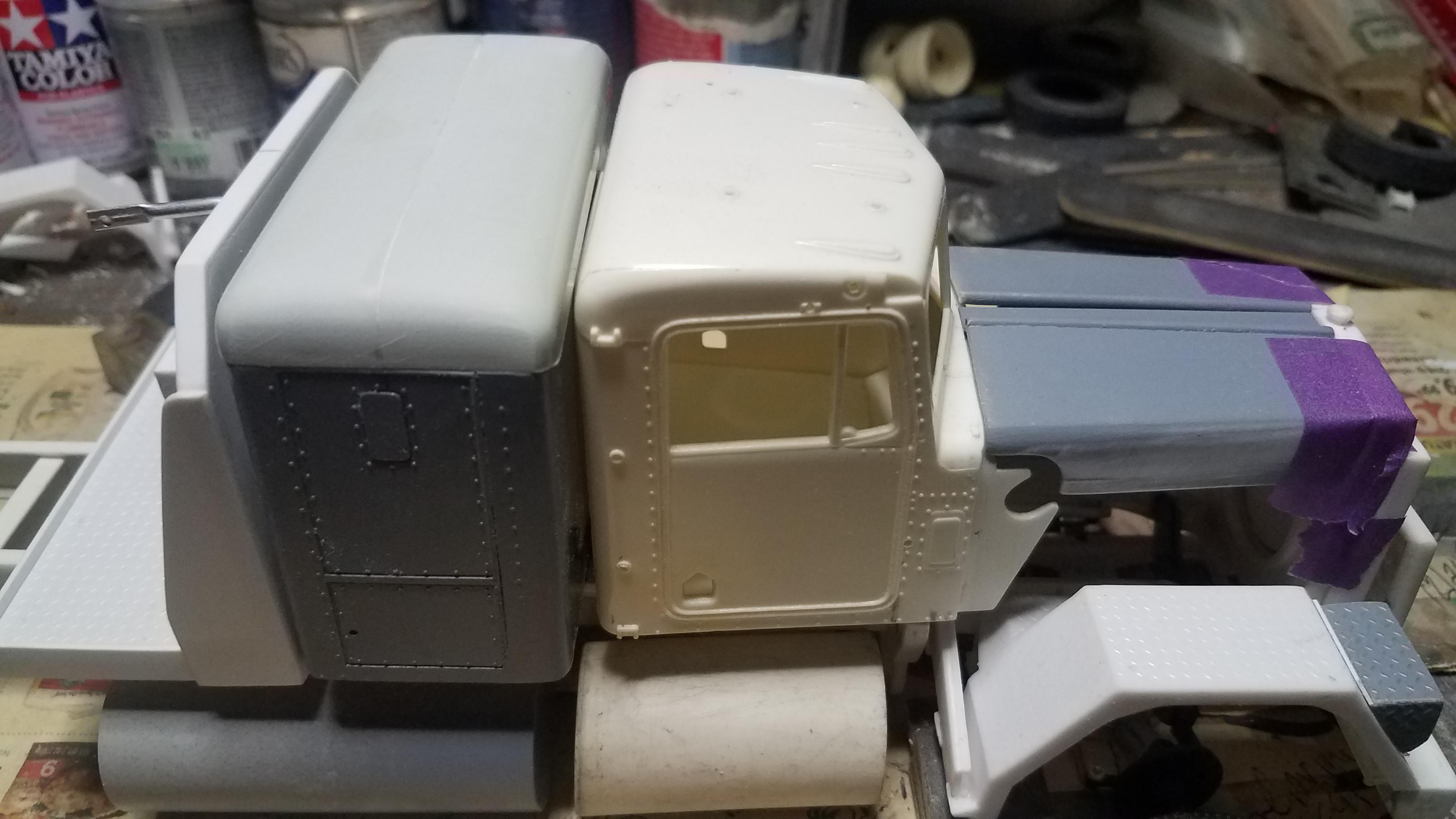

lwwoodss Posted September 19, 2023 Author Share Posted September 19, 2023 Sleeper roof sectioned. Turn out better than I thought. A little seam work to do. Quote Link to comment Share on other sites More sharing options...

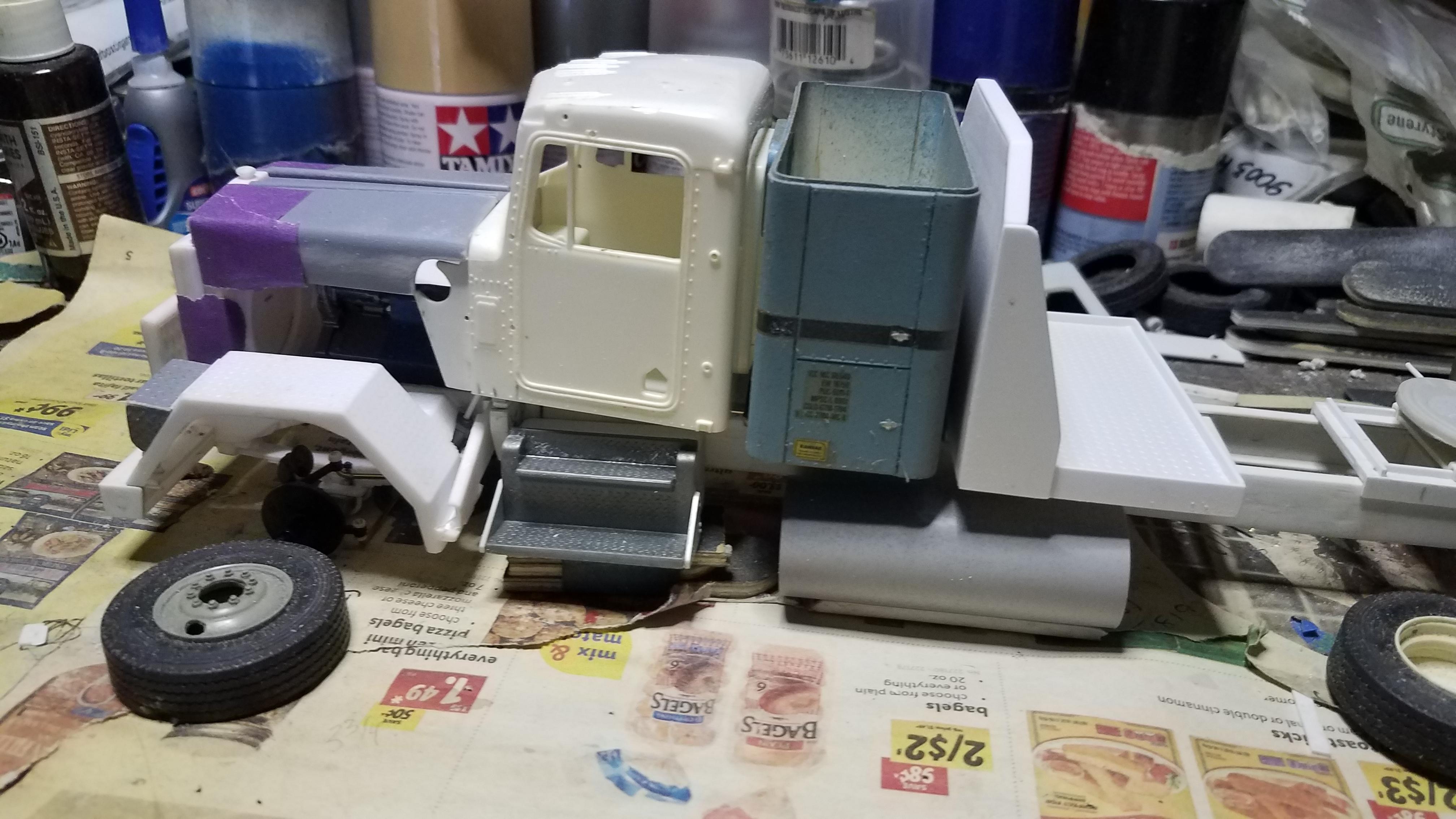

lwwoodss Posted September 30, 2023 Author Share Posted September 30, 2023 The hood was hinged today and the cab cowl was removed so that a new one can be built to accommodate the severe service air cleaners on both sides. Quote Link to comment Share on other sites More sharing options...

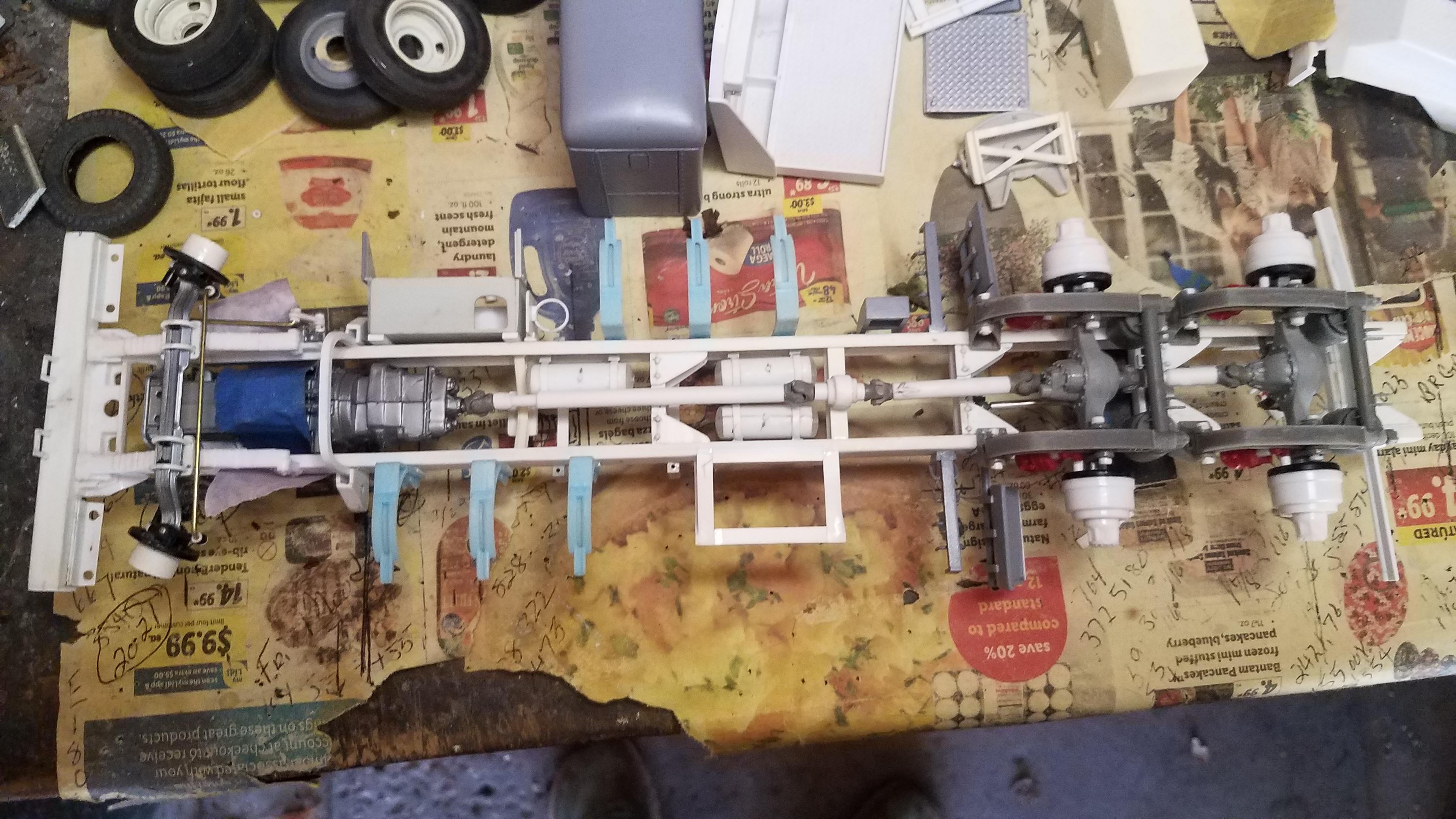

lwwoodss Posted October 21, 2023 Author Share Posted October 21, 2023 Working my way down the chassis a few items mounted. Latest mock up. 2 Quote Link to comment Share on other sites More sharing options...

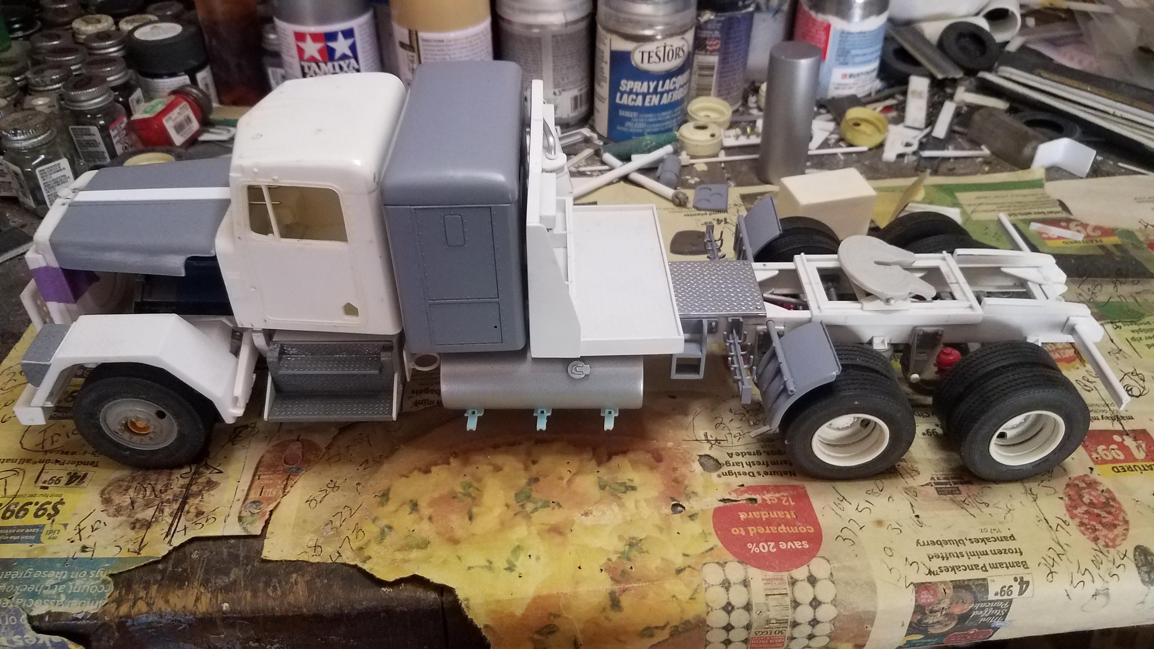

lwwoodss Posted January 13 Author Share Posted January 13 Chassis finally complete enough for primer and paint . Also current mockup Quote Link to comment Share on other sites More sharing options...
