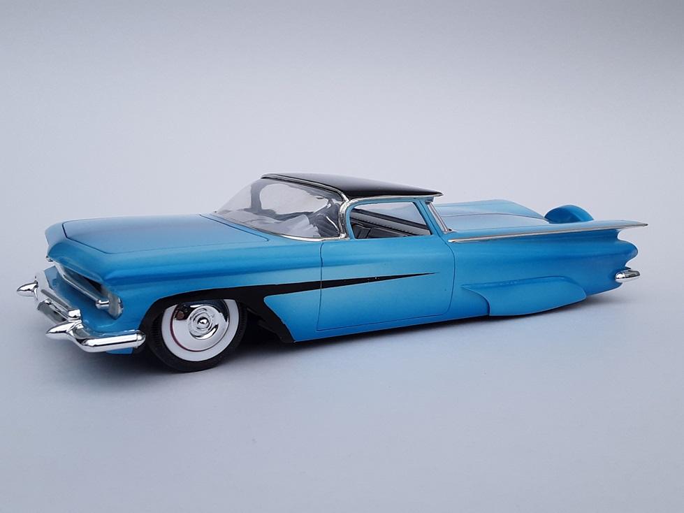

The GOOD news: This build needs some touching up including some exhaust tips, but I'm calling this guy done! I quickly took these pics outside under a gray, cloudy sky. I'll post pics with better lighting in the 'Finished' forum. The BAD news: some weird clouding/spotting in some areas started appearing over time as I let the clearcoat cure. I suspect it has something to do with using the acrylic lacquer auto reducer I used to thin the nail polish for the fades. It must be incompatible with the spray can nitrocellulose clear I used for the final coats. It's weird cuz I've used combo before but maybe it has to do with the amount of acrylic reducer I used. The worst area was around the passenger side front wheel opening which I was able to cleverly hide as a last ditch effort with a scallop design using black BMF. BUT! when I went to use I use wax and grease remover to remove the excess BMF adhesive residue from the body it reacted and brought out that cloudiness I was seeing elsewhere which I've never seen it do before (sigh). Next time I'll try using the same spray can nitro clear in the nail polish. Either way, even though I'm bummed that the paintjob went sideways on me, I am proud of the build as I was able to materialize and see my vision for it come to life. I also learned some good lessons and honed some skills on this build!  I'll just have to display it showing only the good side lol On to the next one.... ?

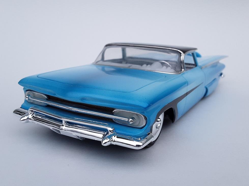

Here are the problem areas
: In my previous post you can see some areas where there are white spots here and there, and as I mentioned around the passenger wheel opening, and the big cloudy area on the passenger door. There is also a smaller but noticeable cloudy spot on the bed cover at the tip of the center behind the rear window. I may still try to touch up the small spots with a small brush if I can match the color of the fades....
