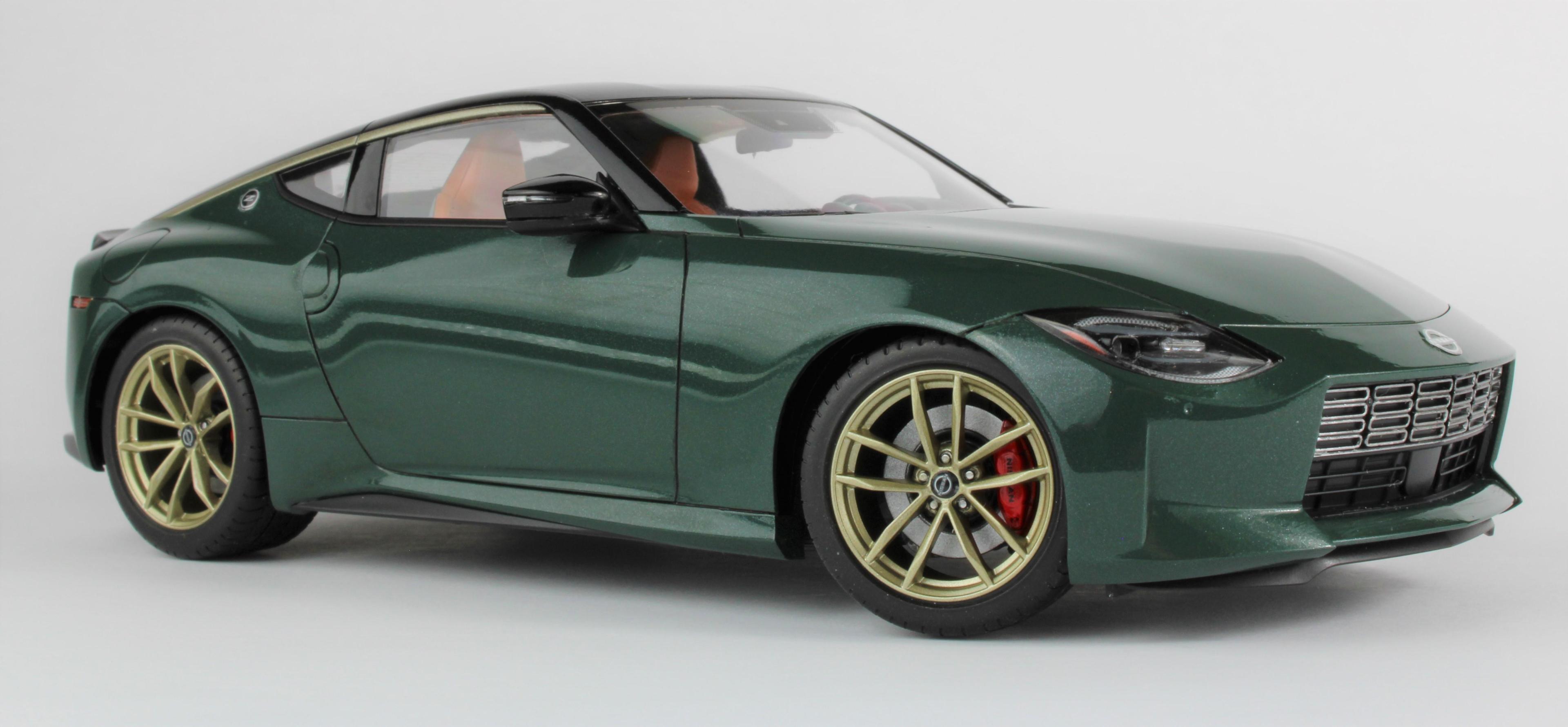

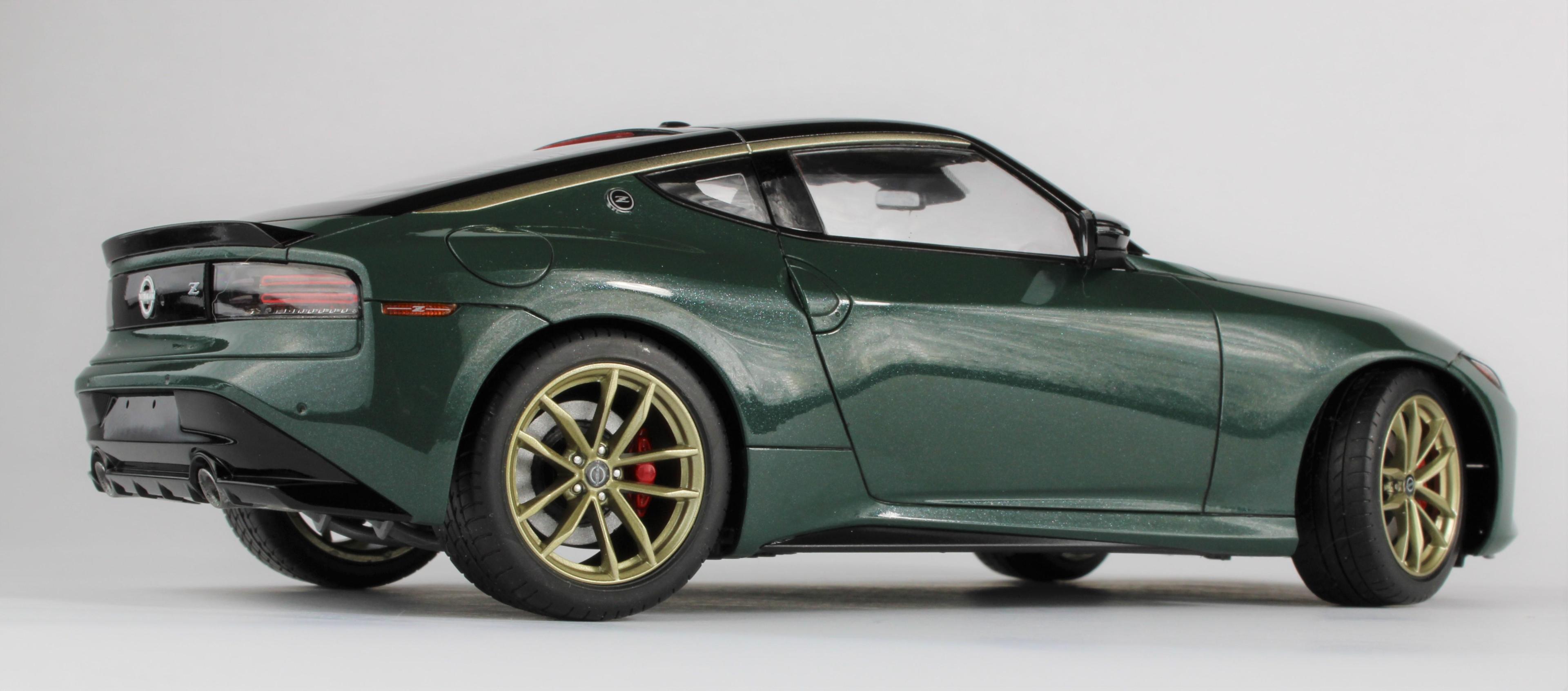

jaymcminn Posted September 4, 2023 Posted September 4, 2023 On 9/2/2023 at 6:54 PM, 64SS350 said: I painted a body with Tamiya Gunmetal Grey. Tested both clears on spoons, but the 'clear' seems glossier than the 'pearl clear'. Is this normal? The Gunmetal had approximately 24hrs to dry... Did I defeat the effect of the pearl, putting it on a dark color? If I recoat, will it gloss up? Can I use the TS-65 clear over it? Thanks..... TS-65 is more of an intermediate coat than a top coat. It won't dry as glossy as TS-13 and really needs a top coat to shine. Below is my Nissan Z which used a base coat of IJN Green followed by two coats of TS-65 and three top coats of TS-13 polished out. 2
