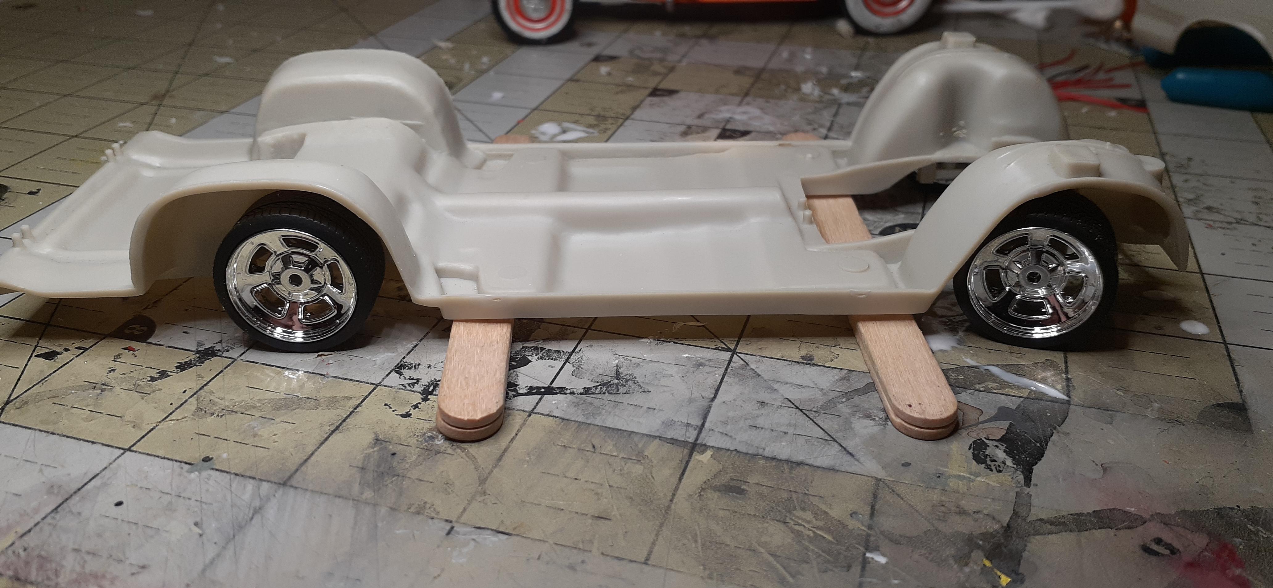

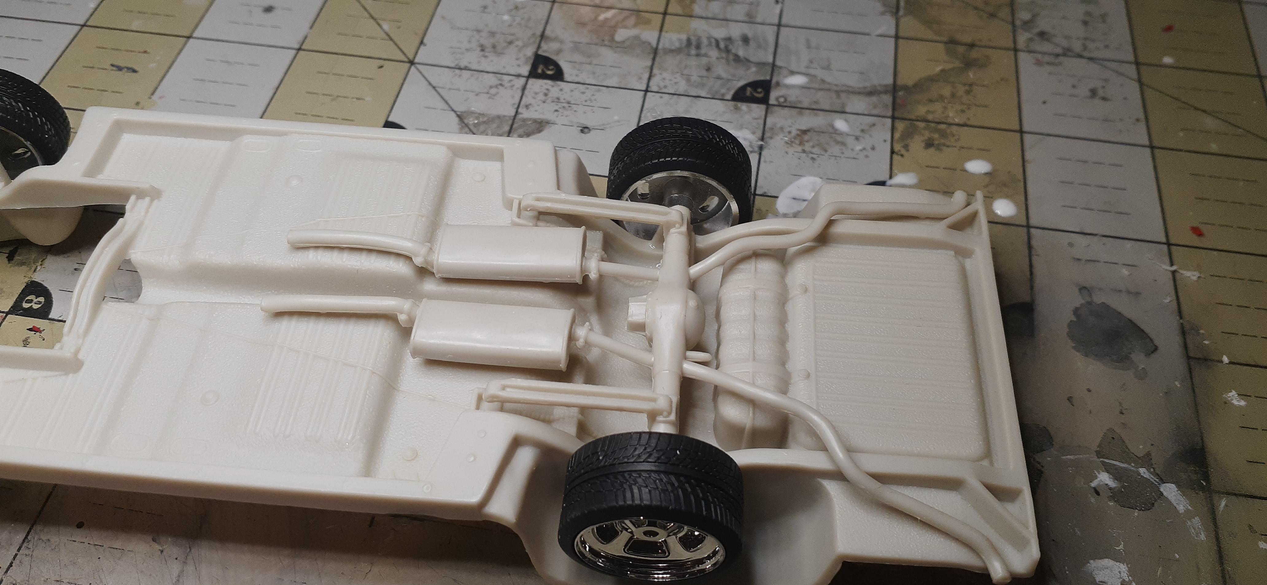

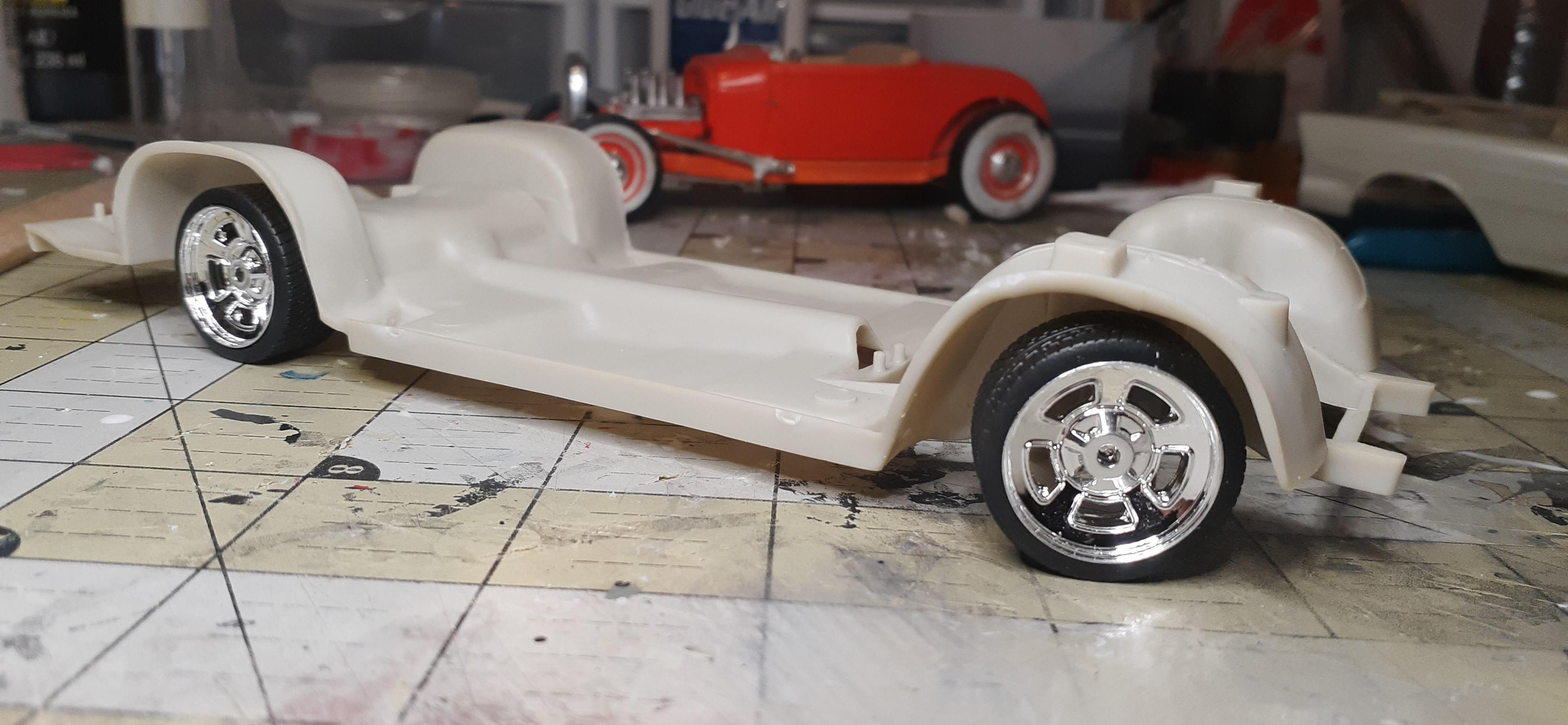

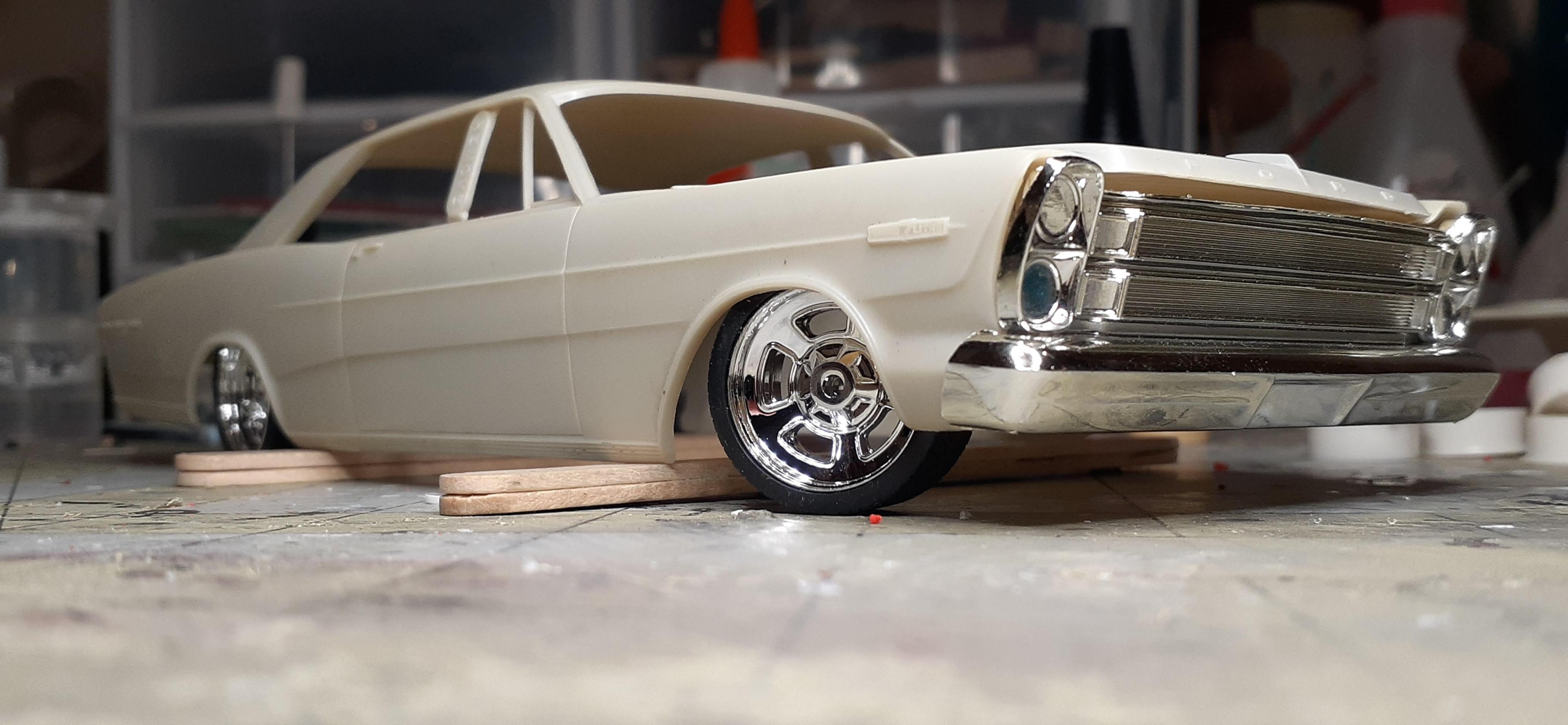

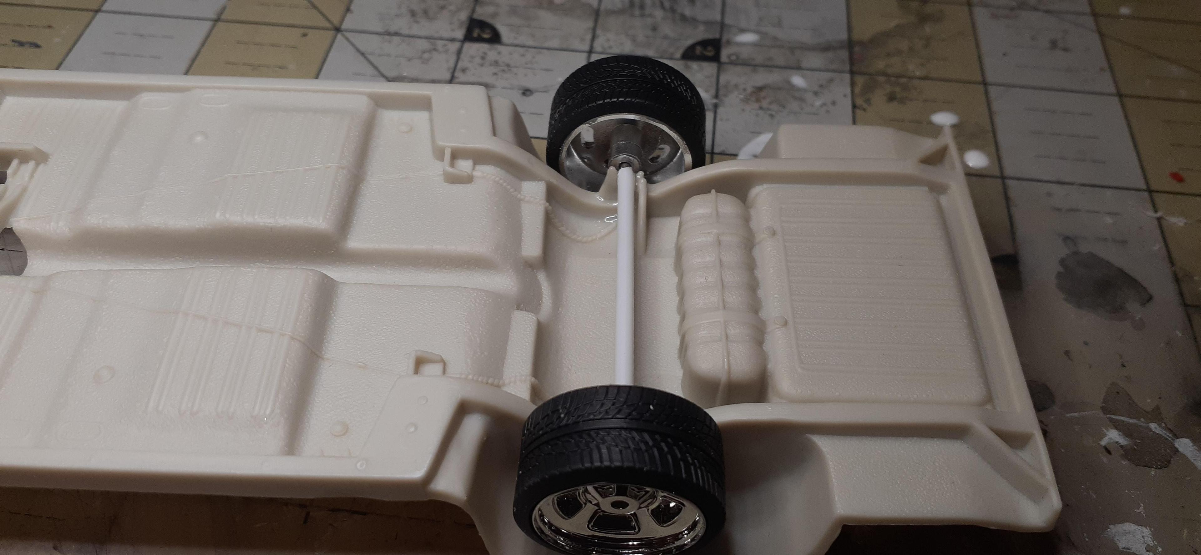

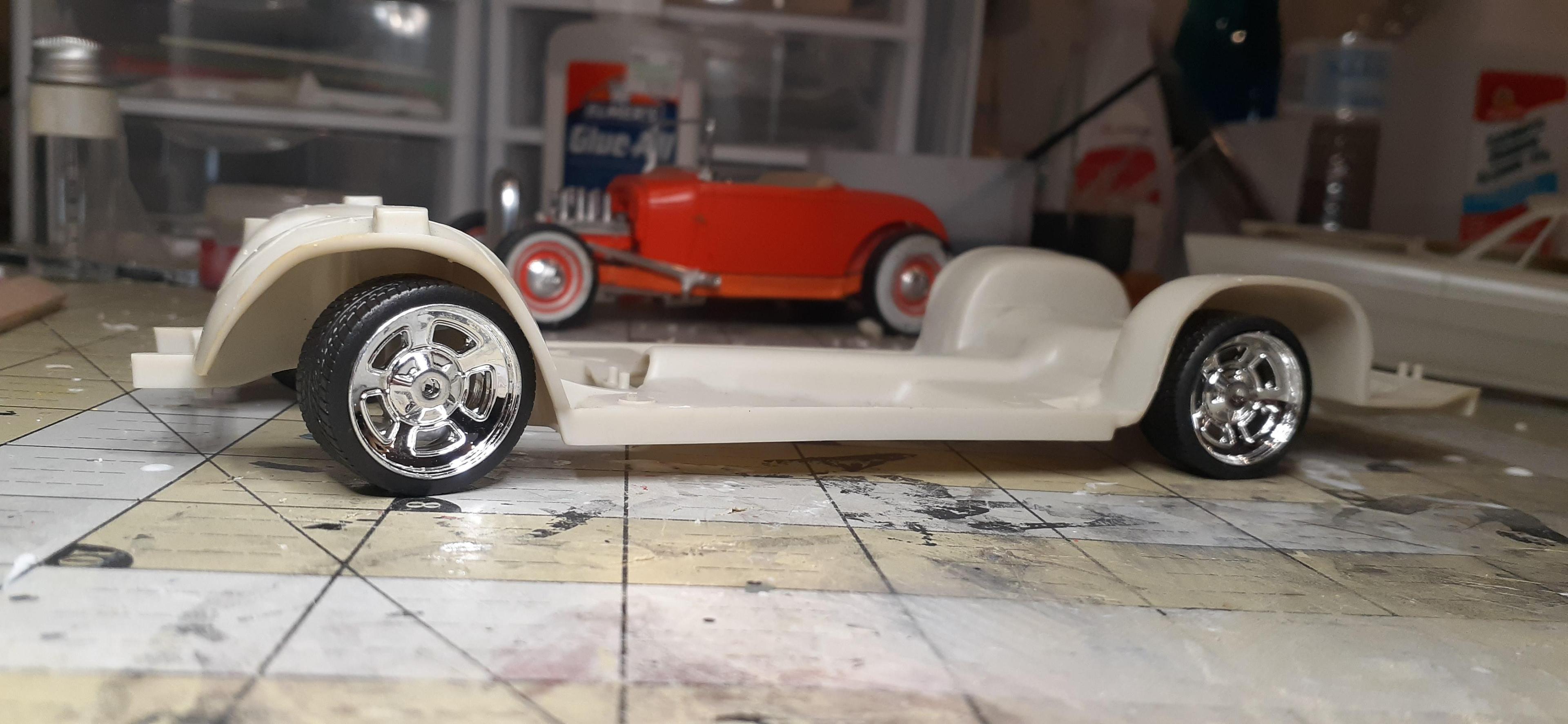

Slotto Posted September 12, 2023 Author Posted September 12, 2023 Wasting no time, I jump right in and get after the ride height. I always go for the 2 popsicle stick method. At this thickness, I always get the look I'm after. for the back, this was pretty easy. I measure to the center of the hub and mark it on the chassis sitting on the sticks. Same thing on the other side. I cut the chassis to accommodate a mini straw. It's the perfect diameter to slide an old AMT axle thru. Then glue it in place. In this case, the straw is hidden by the factory axle and pipe assembly. Next up is the front. I look to see where the hub will sit vertically on the chassis. I cut 2 pieces from the parts tree that make a "T". I cut 4 pieces of scrap plastic to act as the upper and lower control arms. Then drill out the spindles and control arms to accommodate a stick pin. I used a .65mm bit. Then assemble. If you cut your spindles to be identical, your finished product will sit flat. I know this is not up to everyone's standards, but it works for me and I'm happy with the result. 4

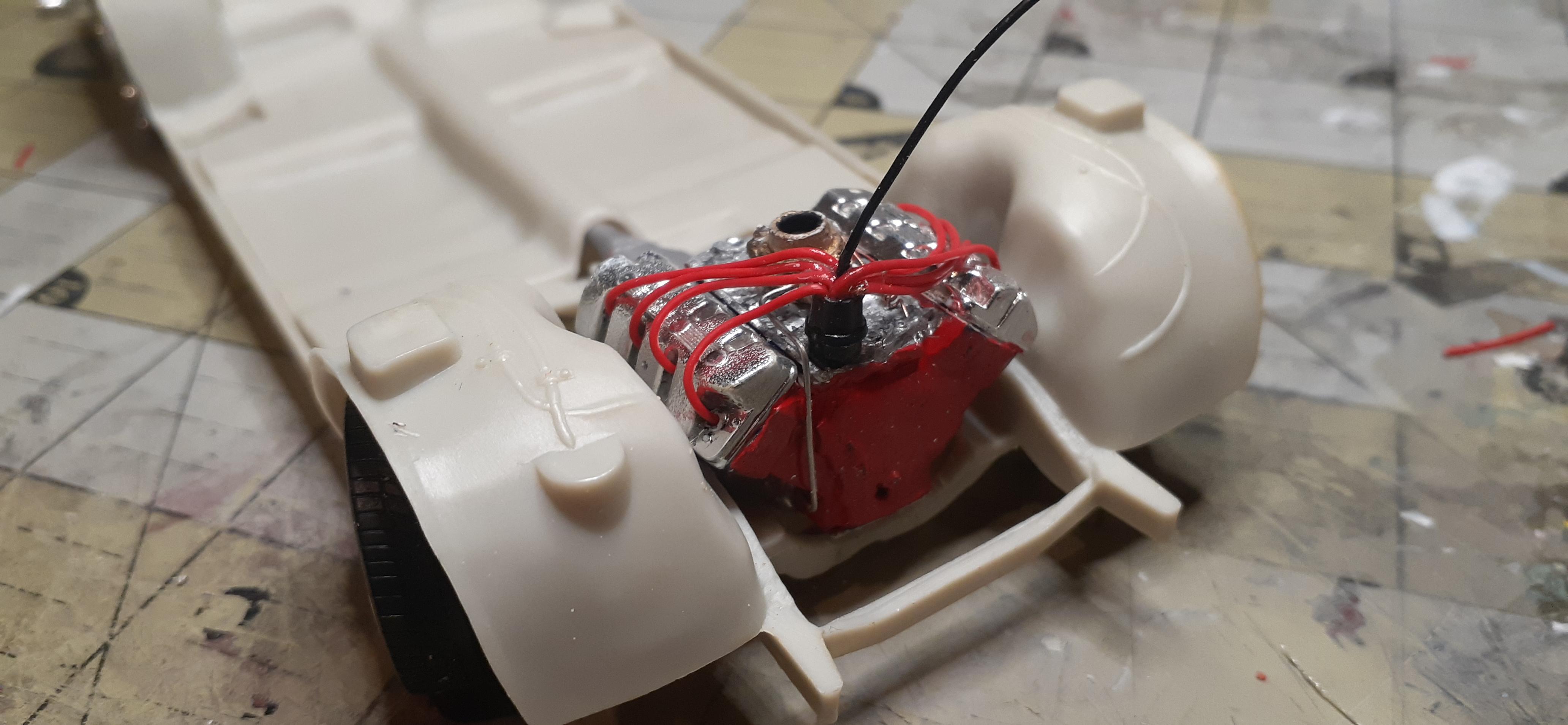

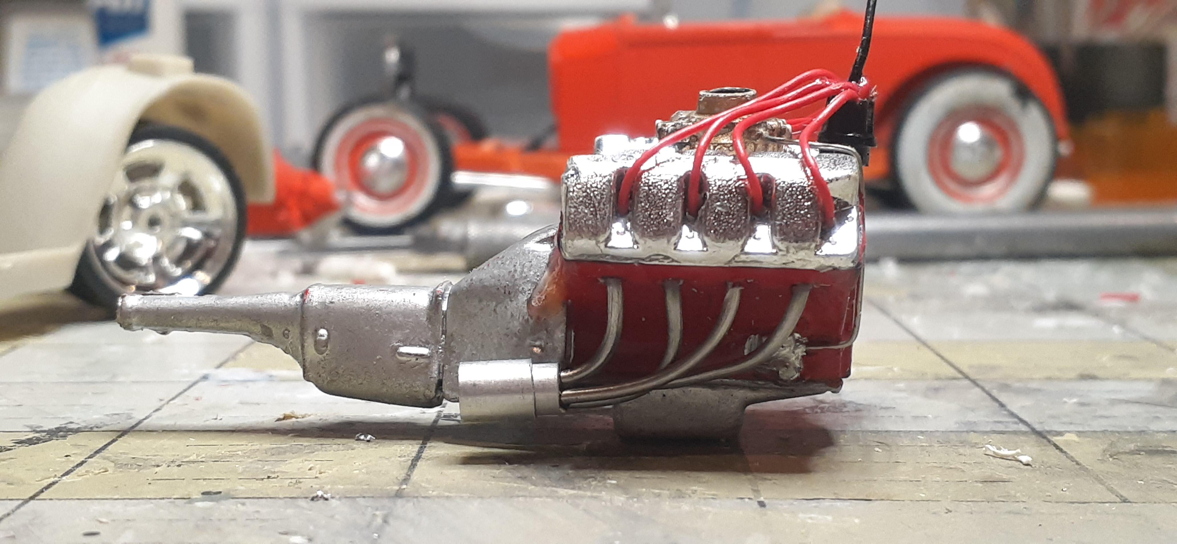

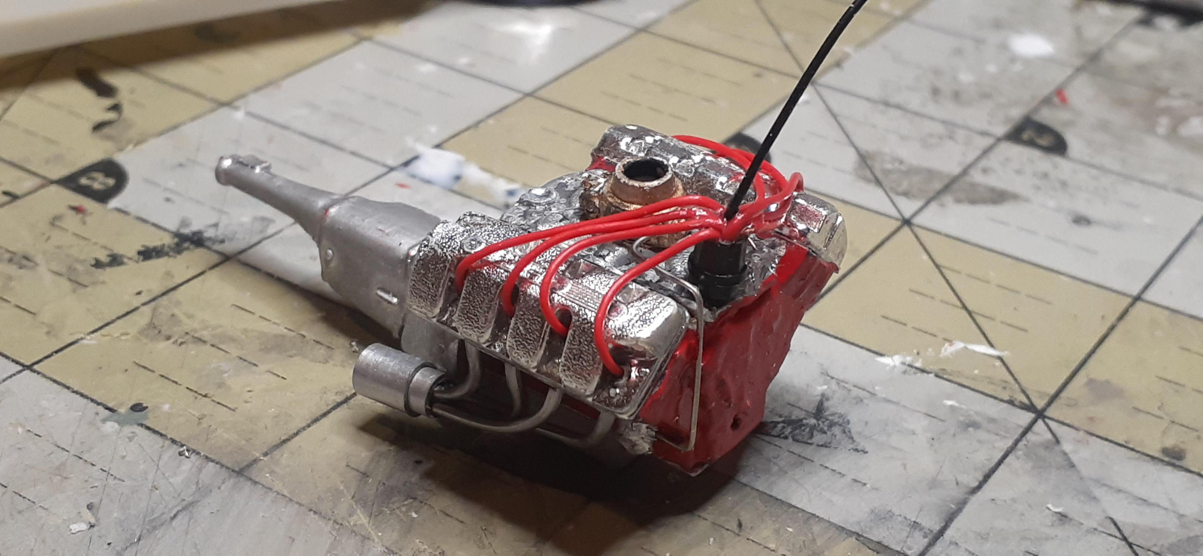

Slotto Posted September 13, 2023 Author Posted September 13, 2023 Got a little therapy in last night I blew apart the interior so I could better detail the door cards and started working on the powerplant. The headers are made from solder and the collectors are aluminum tubing It's a snug fit but its happy
Chuckyg1 Posted September 13, 2023 Posted September 13, 2023 Nice work so far. Stupid question..... How do you separate the interior door panels? 1
Slotto Posted September 14, 2023 Author Posted September 14, 2023 1 hour ago, Chuckyg1 said: Nice work so far. Stupid question..... How do you separate the interior door panels? I run a #11 exacto blade down the seams. About 4-5 passes does the trick. 1

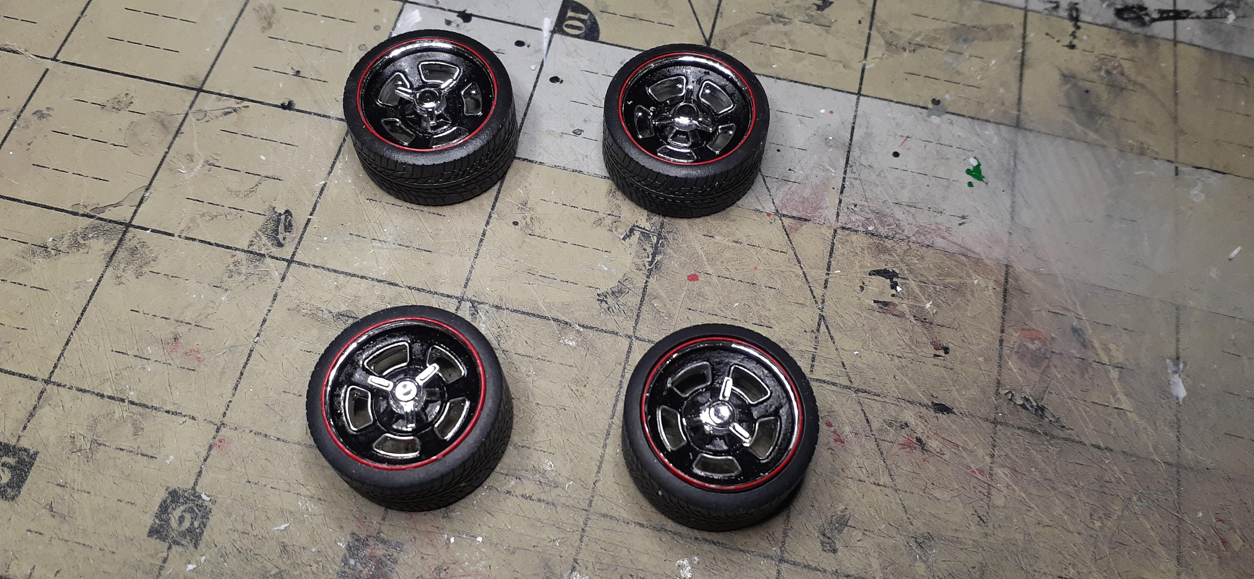

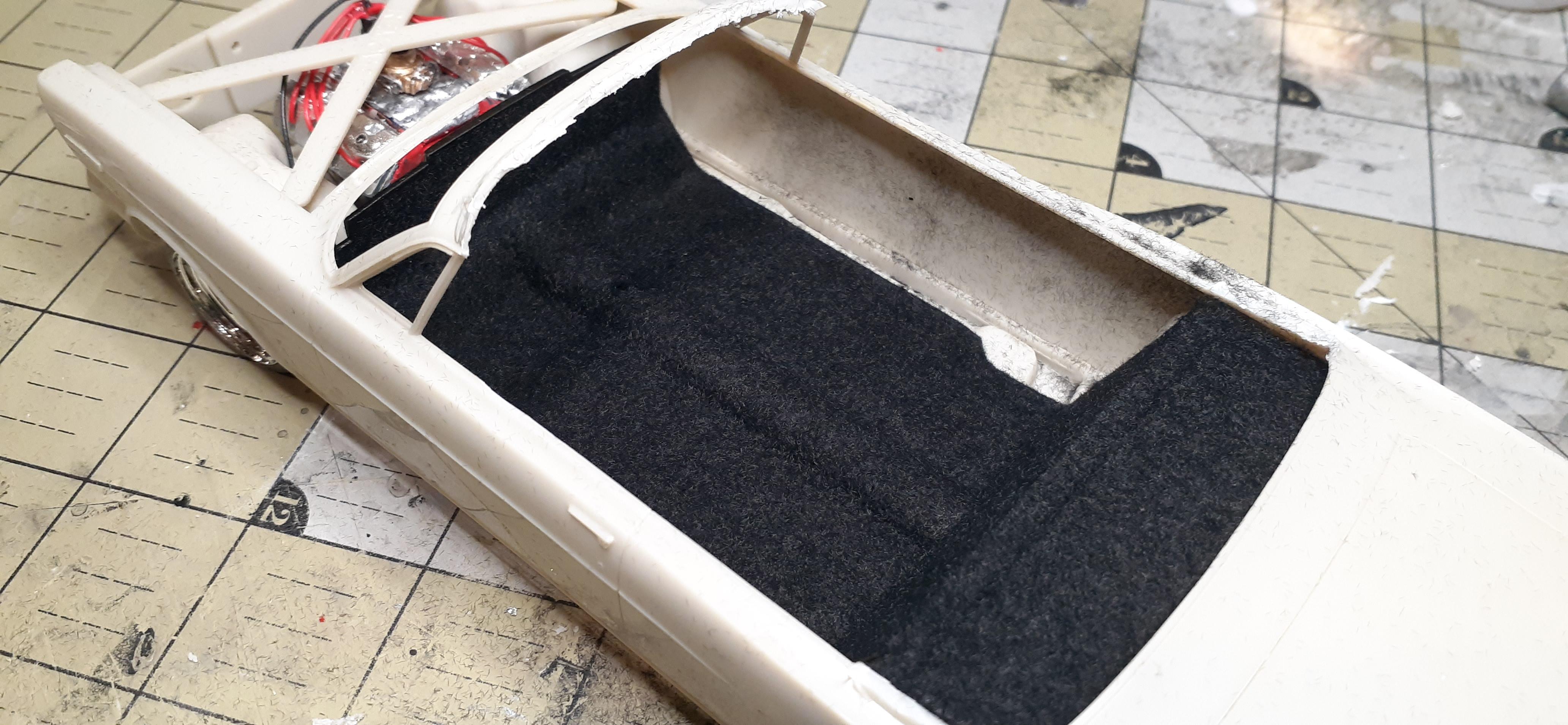

Slotto Posted September 16, 2023 Author Posted September 16, 2023 I decided to remove the top. It took a lot of thought but I pulled the trigger. No turning back now added carpet and added a little flat grey to the wheels. Still need to clean em up and add the spinners. 2

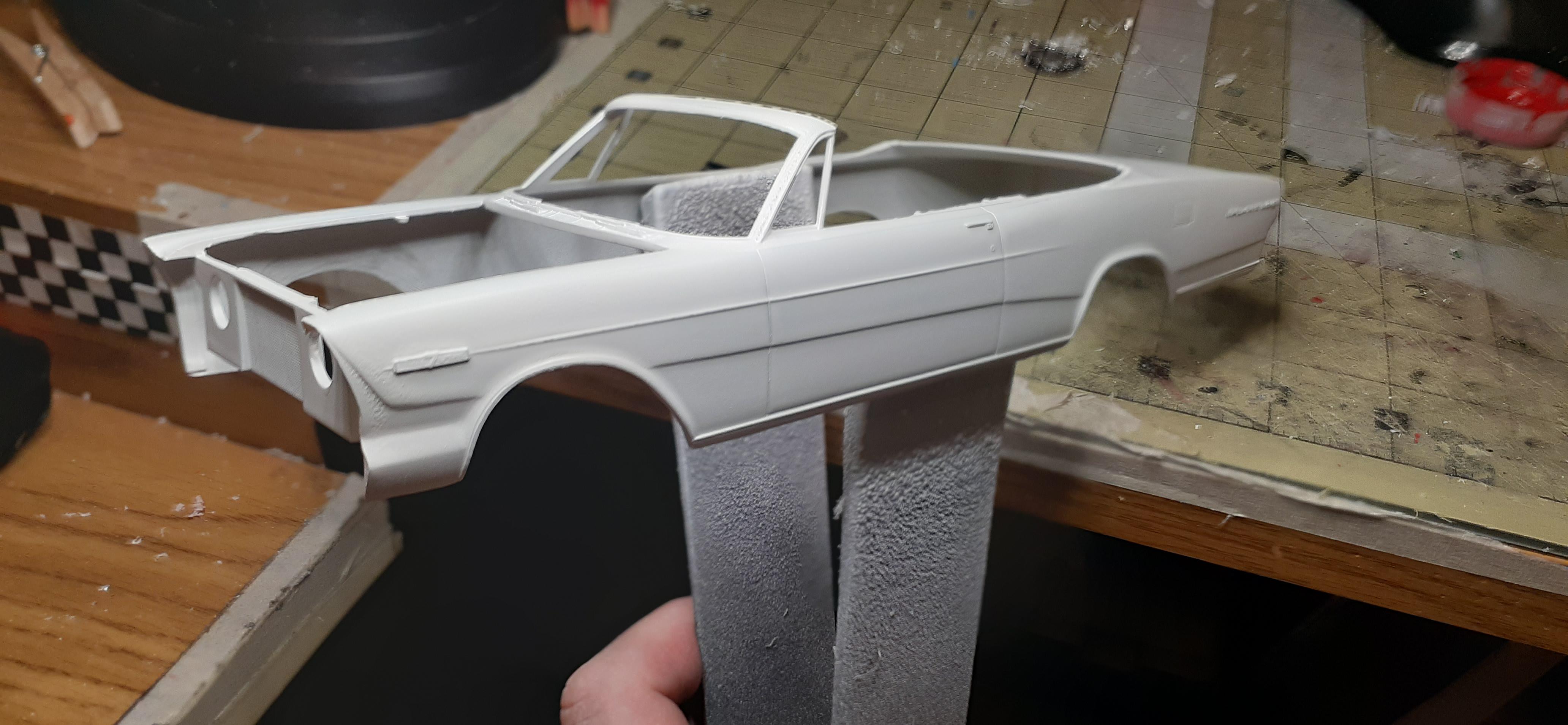

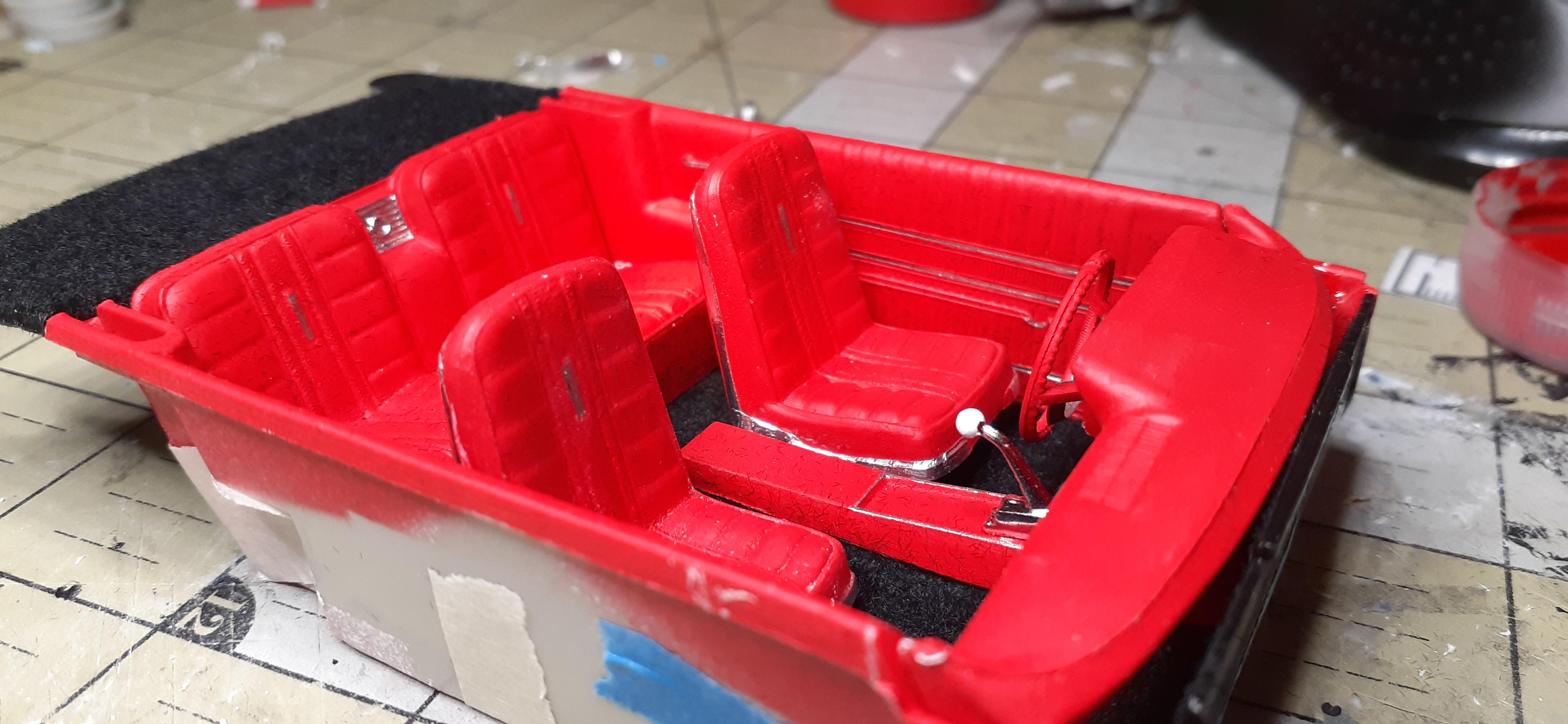

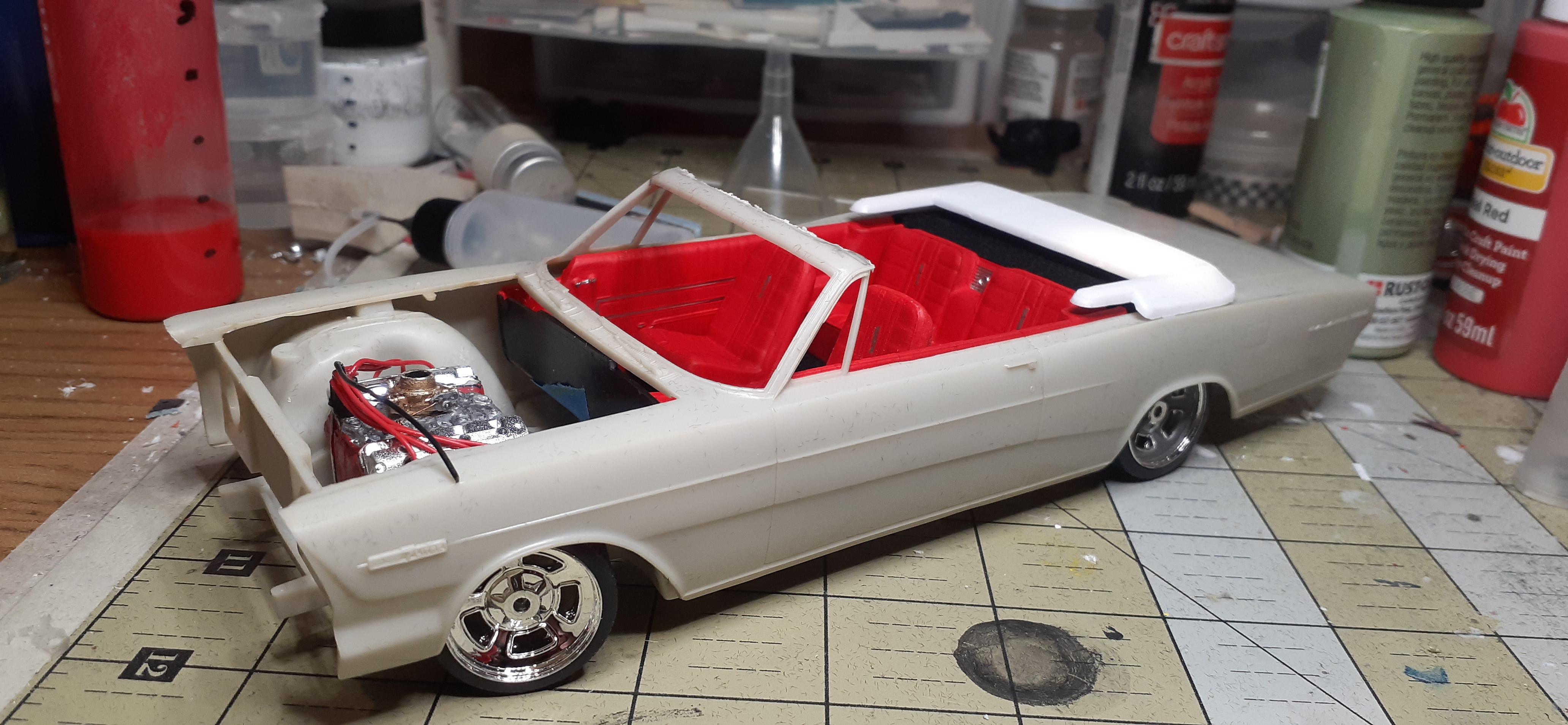

Slotto Posted September 19, 2023 Author Posted September 19, 2023 I'm calling the interior done I wasn't thrilled with the grey insert for the wheel so I brushed over them with my black airbrush mix. also got some flat white on the body. 5 small emblems were covered with BMF prior to paint. I'll brighten them up when the body cures. 3
atomicholiday Posted September 19, 2023 Posted September 19, 2023 Looks awesome. How the heck did you do the chrome piping on the door cards?? 1
Slotto Posted September 19, 2023 Author Posted September 19, 2023 4 minutes ago, atomicholiday said: How the heck did you do the chrome piping on the door cards?? ? I used a 1mm chrome pen, held my breath and made 1 slow steady pass on each line
