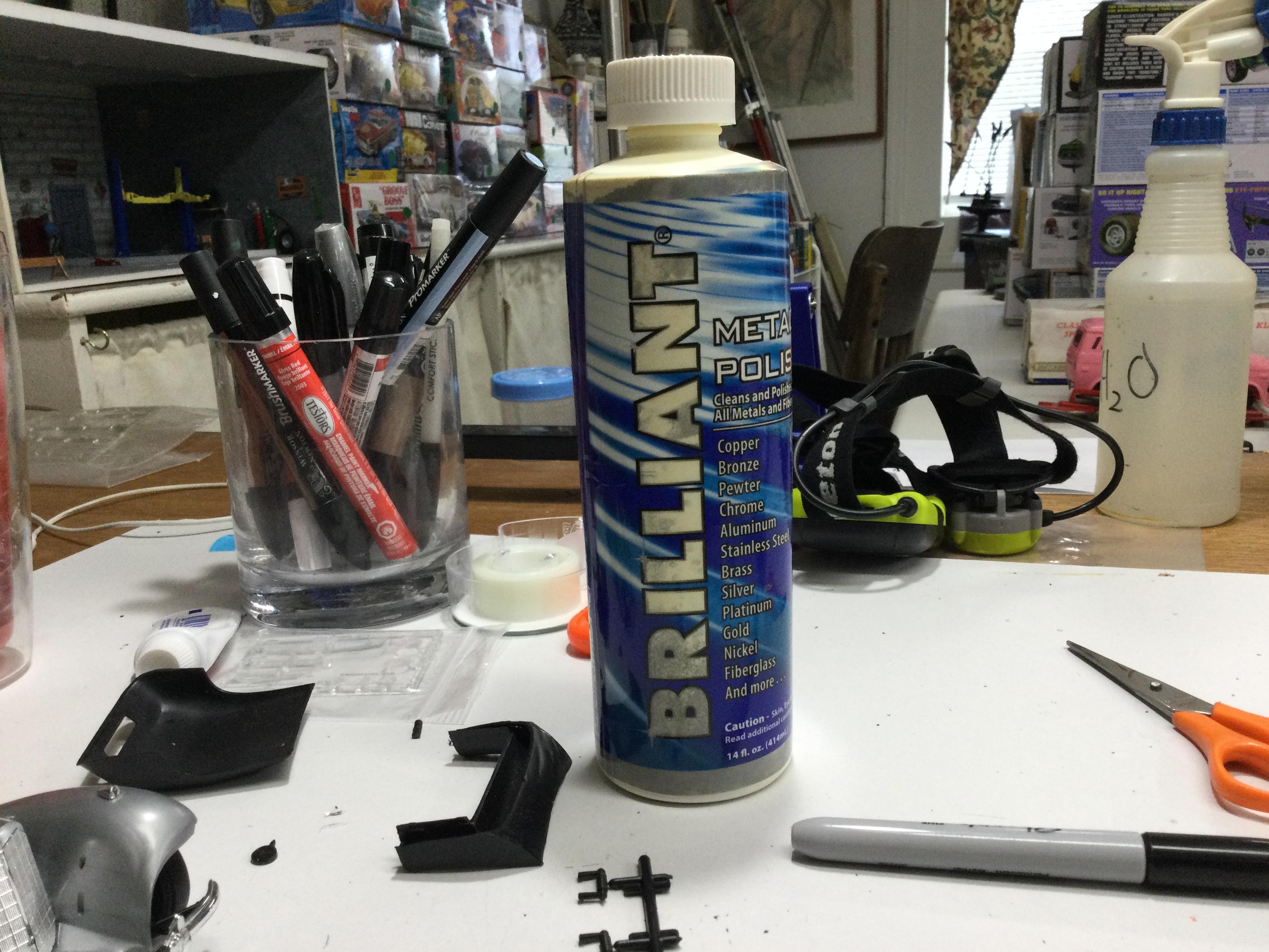

ewetwo Posted September 28, 2023 Share Posted September 28, 2023 I forgot I had this bottle of Brilliant Metal Polish. I was reading what it’s good for and among the metals it said fiberglass. I had an idea, which isn’t too often, that maybe try polishing the haze appearing on my Camry and Venza’s headlights. I should have taken before and after picture but I was running with my ‘brilliant” idea. They polished up nicely. The Venza will need a bit more polishing and I have no idea how long they will look better. But I had nothing to loose. 1 Quote Link to comment Share on other sites More sharing options...

ewetwo Posted September 29, 2023 Author Share Posted September 29, 2023 I don’t know why we have this. Maybe the wife used it in her art work. But when I saw fiberglass on there. I gave it a go on the head light fog. Cleaned it up really nice. Now to see how long they say clear. Lol. Quote Link to comment Share on other sites More sharing options...
